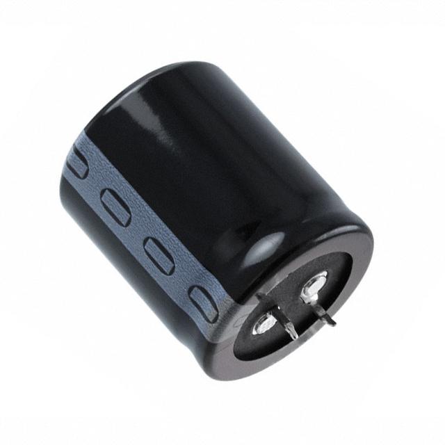

    1500 µF 200 V 铝电解电容器 径向,Can - 卡入式 85°C 时为 2000 小时
B43231B2158M000 数据手册
AEC-C_B41231_B43231.book Seite 1 Mittwoch, 16. April 2008 2:27 14 Aluminum electrolytic capacitors Alu-X product lines Snap-in capacitors Series/Type: Data Sheet Date: B41231, B43231 April 2008 © EPCOS AG 2008. Reproduction, publication and dissemination of this publication and the information contained therein without EPCOS’ prior express consent is prohibited. AEC-C_B41231_B43231.book Seite 2 Mittwoch, 16. April 2008 2:27 14 Snap-in capacitors Standard series – 85 °C Snap-in capacitors Standard series – 85 °C B41231, B43231 B41231, B43231 General-purpose grade capacitors Applications ■ Switch-mode power supplies in industrial and entertainment electronics Features ■ High ripple current capability ■ RoHS-compatible ■ Load life of 2000 h at 85 °C Construction ■ ■ ■ ■ Aluminum case, fully insulated Snap-in solder pins to hold component in place on PC-board Minus pole marking on the insulating sleeve Case with safety vent Please read Cautions and warnings and Important notes at the end of this document. 2 04/08 AEC-C_B41231_B43231.book Seite 3 Mittwoch, 16. April 2008 2:27 14 Snap-in capacitors Standard series – 85 °C B41231, B43231 Specifications and characteristics in brief Rated voltage VR 10 … 500 V DC Operating temperature range VR ≤ 250 V DC: –40 °C … +85 °C VR ≥ 315 V DC: –25 °C … +85 °C Rated capacitance CR 56 … 68000 µF (20 °C, 120 Hz) Capacitance tolerance ±20% Load life (85 °C, VR, IAC,R) M 2000 h Requirements: ∆C/C ≤ ±20% of initial value tan δ ≤ 2 times initial specified limit Ileak ≤ initial specified limit Leakage current Ileak ⎛ CR ⋅ V ------R-⎞ (20 °C, after 5 minutes) I leak ≤ 0.02 µA ⋅ ⎝ ------µF V ⎠ Dissipation factor (max.) (20 °C, 120 Hz) VR (V DC) 10 16 25 tan δ 0.50 0.50 0.40 0.40 0.30 0.25 0.20 0.15 0.12 Low temperature stability (impedance ratio) (120 Hz) VR (V DC) 10 16 ... 160 200 ... 250 315 ... 400 450 ... 500 Z ( – 25 °C ) --------------------------Z ( +20 °C ) 5 4 7 8 8 Z ( – 40 °C ) --------------------------Z ( +20 °C ) 18 15 12 – – Shelf life After storage for 1000 h at 85 °C, the capacitors shall meet the requirement of load life test after reforming process. After test: VR to be applied for 30 minutes, 24 to 48 hours before measurement. Frequency multiplier for rated ripple current ≤50 V 35 50 63 80 100 160 ... 250 ... 450 ... 200 400 500 0.15 50 Hz 120 Hz 1 kHz 10 kHz 20 kHz 0.95 1.00 1.10 1.15 1.15 63 ... 100 V 0.95 1.00 1.16 1.30 1.33 ≥160 V 0.90 1.00 1.20 1.50 1.55 Temperature multiplier for rated ripple current
B43231B2158M000
物料型号:EPCOS的铝电解电容器,产品系列/型号为B41231和B43231。
器件简介:这些是通用级别的电容器,设计用于在85°C的标准系列中工作,适用于开关电源在工业和娱乐电子设备中的应用。
引脚分配:电容器采用铝制外壳,完全绝缘的引脚,以夹子形式安装在PCB板上,负极在绝缘套上标有标记。
参数特性: - 额定电压VR:10至500VDC。 - 工作温度范围:对于额定250V DC的电容器,范围是-40°C至+85°C;对于额定315V DC的电容器,范围是-25°C至+85°C。 - 额定电容CR:56至68000μF。 - 电容公差:±20%。 - 负载寿命:在85°C、额定电压和AC.R条件下为2000小时。
功能详解:电容器具有高纹波电流能力,并且符合RoHS标准。
应用信息:适用于开关电源,特别是在工业和娱乐电子设备中。
封装信息:提供了详细的尺寸图,包括安装孔、安全阀等的尺寸,以及负极标记的位置。
注意事项:文档最后部分提到了一些警告和重要的注意事项,例如电容器的极性不能接反,纹波电流必须在允许的范围内,以及存储和操作条件等。
