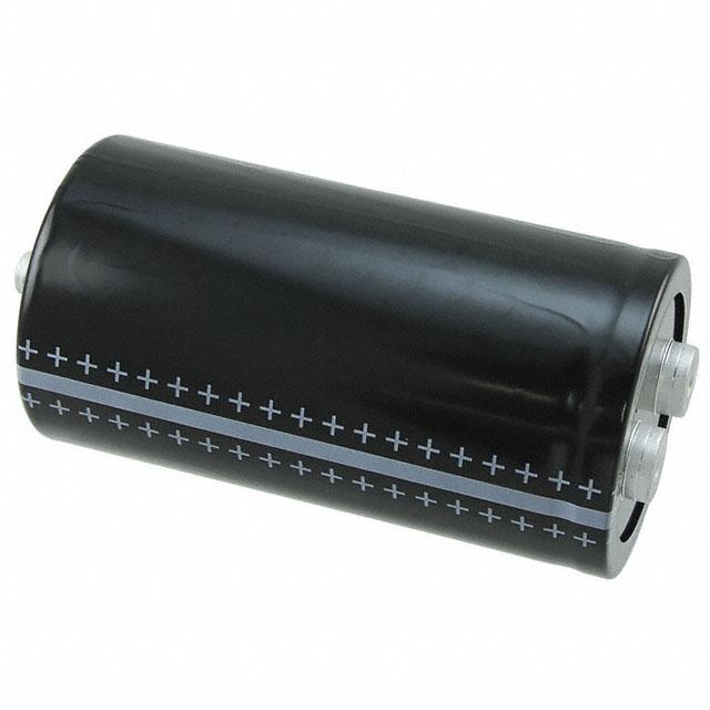

    6800 µF 350 V 铝电解电容器 径向,Can - 螺丝端子 18 毫欧 @ 100Hz 85°C 时为 10000 小时
B43457A4688M000 数据手册
Aluminum electrolytic capacitors Capacitors with screw terminals Series/Type: B43455, B43457 Date: November 2012 © EPCOS AG 2015. Reproduction, publication and dissemination of this publication, enclosures hereto and the information contained therein without EPCOS' prior express consent is prohibited. EPCOS AG is a TDK Group Company. Capacitors with screw terminals B43455, B43457 Long useful life  85 °C Long-life grade capacitors Applications Frequency converters Wind power converters Solar inverters Uninterruptible power supplies Professional power supplies Features Long useful life All-welded construction ensures reliable electrical contact PAPR terminals available (Protection Against Polarity Reversal) Version with optimized construction for base cooling (heat sink mounting) available Version with low-inductance design available Self-extinguishing electrolyte RoHS-compatible Construction Charge-discharge proof, polar Aluminum case with insulating sleeve Poles with screw terminal connections Mounting with ring clips, clamps or threaded stud The bases of types with threaded stud and d ≤ 76.9 mm are not insulated, types with d = 91 mm have fully insulated bases Please read Cautions and warnings and Important notes at the end of this document. Page 2 of 19 B43455 B43457 B43455, B43457 Long useful life  85 °C Specifications and characteristics in brief Rated voltage VR Surge voltage VS Rated capacitance CR Capacitance tolerance 350 ... 450 V DC 1.10  VR 1000 ... 15000 µF ±20%  M Dissipation factor tan δ (20 °C, 120 Hz) ≤ 0.20 Leakage current Ileak (20 °C, 5 min) Self-inductance ESL Useful life1) 85 °C; VR; IAC,R 40 °C; VR; 1.5  IAC,R d = 51.6 mm: approx. 15 nH d ≥ 64.3 mm: approx. 20 nH Capacitors with low-inductance design: d ≥ 64.3 mm: approx. 13 nH Requirements: ∆C/C ≤ ±15% of initial value tan δ ≤ 1.75 times initial specified limit Ileak ≤ initial specified limit Voltage endurance test Post test requirements: 85 °C; VR 2000 h ∆C/C ≤ ±10% of initial value tan δ ≤ 1.3 times initial specified limit Ileak ≤ initial specified limit Vibration resistance test To IEC 60068-2-6, test Fc: Frequency range 10 ... 55 Hz, displacement amplitude 0.75 mm, acceleration max. 10 g, duration 3 × 2 h. Capacitor mounted by its body which is rigidly clamped to the work surface. Characteristics at low temperature > 10000 h > 200000 h Max. impedance ratio at 100 Hz VR ≤ 400 V 450 V Z -25°C / Z 20°C Z -40°C / Z 20°C 4 16 3 12 IEC climatic category To IEC 60068-1: 25/085/56 (25 °C/+85 °C/56 days damp heat test) The capacitors can be operated in the temperature range of 40 °C to +85 °C but the impedance at 40 °C should be taken into consideration. Detail specification Sectional specification Similar to CECC 30301-803, CECC 30301-807 IEC 60384-4 1) Refer to chapter "General technical information, 5 Useful life" on how to interpret useful life. Please read Cautions and warnings and Important notes at the end of this document. Page 3 of 19 B43455, B43457 Long useful life  85 °C Ripple current capability Due to the ripple current capability of the contact elements, the following current upper limits must not be exceeded: Capacitor diameter 51.6 mm 64.3 mm 76.9 mm 91 mm IAC,max 34 A 45 A 57 A 80 A Dimensional drawings B43455 Ring clip/clamp mounting B43457 Threaded stud mounting The base of types with threaded stud and d = 91 mm is fully insulated (the lengths I and l1 are increased by 0.5 mm in these cases). For types with threaded stud and d ≤ 76 mm the base is not insulated. Also refer to the mounting instructions in chapter "Capacitors with screw terminals  Accessories". Dimensions and weights Terminal Dimensions (mm) with insulating sleeve d l ±1 l1 ±1 l2 +0/1 d1 d2 max. a +0.2/0.4 M5 M5 51.6 +0/0.8 80.7 51.6 +0/0.8 105.7 87.2 112.2 17 17 M12 M12 10.2 10.2 22.2 22.2 220 280 M5 M5 M5 64.3 +0/0.8 80.7 64.3 +0/0.8 105.7 64.3 +0/0.8 143.2 87.2 112.2 149.7 17 17 17 M12 M12 M12 13.2 13.2 13.2 28.5 28.5 28.5 370 440 630 M6 M6 M6 M6 76.9 +0/0.7 76.9 +0/0.7 76.9 +0/0.7 76.9 +0/0.7 111.5 149.0 174.5 226.5 17 17 17 17 M12 M12 M12 M12 17.7 17.7 17.7 17.7 31.7 31.7 31.7 31.7 620 840 1000 1300 105.7 143.2 168.7 220.7 Please read Cautions and warnings and Important notes at the end of this document. Page 4 of 19 Approx. weight (g) B43455, B43457 Long useful life  85 °C Terminal Dimensions (mm) with insulating sleeve d l ±1 l1 ±1 l2 +0/1 d1 d2 max. a +0.2/0.4 Approx. weight (g) M6 M6 91.0 +0/2 91.0 +0/2 17.7 17.7 1200 1900 144.5 221.0 149.8 226.3 17 17 M12 M12 31.7 31.7 For low-inductance design the following deviation applies: d = 64.3 mm: l1 0.7 mm d = 91.0 mm: l1 1.7 mm Packing Capacitor diameter d (mm) 51.6 64.3 length l (mm) all all Packing units (pcs.) 36 25 Capacitor diameter d (mm) 76.9 91.0 For ecological reasons the packing is pure cardboard. Please read Cautions and warnings and Important notes at the end of this document. Page 5 of 19 length l (mm) 105.7 - 168.7 220.7 all Packing units (pcs.) 16 12 9 B43455, B43457 Long useful life  85 °C Special designs Low-inductance design PAPR terminal style With our PAPR terminal style (Protection Against Polarity Reversal) we offer an optional mechanical feature in addition to the visual polarity marking on the cover disk and the sleeve, which prevents from mounting in reverse polarity. The non-circular shape of the terminals and their arrangement perpendicular to each other enables the user to definitely prevent wrong mounting with respect to polarity (Poka Yoke). Dimensional drawing of PAPR terminal configuration Dimensions for PAPR terminal style (mm) Can diameter d Terminal d3 ±0.1 d4 ±0.1 a +0.2/0.4 Min. reach of screw Standard For heat sink design mounting #050 #057 51.6 M5 10 13 22.2 9.5  64.3 M5 13 15 28.5 9.5 7.3 76.9 M6 13 15 31.7 12.0 9.7 91.0 M6 13 15 31.7 12.0 9.7 All other dimensions of the capacitor such as diameter d, case length l and overall length l1 are identical with those of standard capacitors of this series. Please refer to the tables “Dimensions and weights” (standard types) and “Dimensions and weights for heat sink mounting” (special designs). For heat sink mounting Design for optimal connection of capacitors to the heat sink when using base cooling with the following features (refer to chapter "General technical information, 5.2 Cooling"):  Electrical insulation of the capacitors base with 2 overlapping thermal pads for optimal heat flow (minimal thermal resistance at the capacitor base) Please read Cautions and warnings and Important notes at the end of this document. Page 6 of 19 B43455, B43457 Long useful life  85 °C  Minimal overall length tolerance (±0.35 mm) for mounting between heat sink and bus bar  Case with extra groove near the base for clamp mounting (recommended ring clamp B44030A0165B ... A0190B) This version is available only for capacitors without threaded stud and for diameters ≥ 64.3 mm. Regarding ripple current and useful life, please refer to column IAC,R(B) in the table "Technical data and ordering codes" and in the useful life curves. Dimensions and weights for heat sink mounting: Terminal Dimensions (mm) with insulating sleeve d l ±1 l1 ±0.35 d2 max. a +0.2/0.4 M5 M5 64.3 +0/0.8 64.3 +0/0.8 80.7 105.7 86.3 111.3 13.2 13.2 28.5 28.5 Min. reach of screw mm 7.3 7.3 Approx. weight g 370 440 M6 M6 76.9 +0/0.7 76.9 +0/0.7 105.7 143.2 110.6 148.1 17.7 17.7 31.7 31.7 9.7 9.7 620 840 M6 M6 91.0 +0/2 91.0 +0/2 97.0 144.5 101.4 148.9 17.7 17.7 31.7 31.7 9.7 9.7 1000 1200 Dimensions for other sizes are available upon request. Ordering codes: Design Identification in third Remark block of ordering code Low inductance (13 nH) M003 For capacitors with diameter d ≥ 64.3 mm For heat sink mounting M007 For capacitors with diameter d ≥ 64.3 mm and without threaded stud PAPR terminal style M050 Not for low inductance PAPR terminal style and heat sink mounting M057 For capacitors with diameter d ≥ 64.3 mm and without threaded stud; not for low inductance Please read Cautions and warnings and Important notes at the end of this document. Page 7 of 19 B43455, B43457 Long useful life  85 °C Accessories The following items are included in the delivery package, but are not fastened to the capacitors: For terminals Thread Toothed washers Screws/nuts Maximum torque M5 A 5.1 DIN 6797 DIN 7985 / ISO 7045-M5 × 10-5.6-Z 2.5 Nm thread depth t ≥ 8 mm M6 A 6.4 DIN 6797 DIN 7985 / ISO 7045-M6 × 12-5.6-Z 4.0 Nm thread depth t ≥ 9.5 mm For mounting M12 J 12.5 DIN 6797 Hex nut BM 12 DIN 439 10 Nm The following items must be ordered separately. For details, refer to chapter "Capacitors with screw terminals  Accessories". Item Type Ring clips B44030 Clamps for capacitors with d ≥ 64.3 mm B44030 Insulating parts B44020 Please read Cautions and warnings and Important notes at the end of this document. Page 8 of 19 B43455, B43457 Long useful life  85 °C Overview of available types VR (V DC) 350 400 450 Case dimensions d × l (mm) CR (µF) 51.6 × 80.7 1000 1500 51.6 × 80.7 51.6 × 80.7 51.6 × 105.7 64.3 × 80.7 2200 51.6 × 105.7 51.6 × 105.7 64.3 × 80.7 64.3 × 105.7 3300 64.3 × 105.7 64.3 × 105.7 64.3 × 143.2 76.9 × 105.7 4700 64.3 × 143.2 76.9 × 105.7 76.9 × 105.7 76.9 × 143.2 5600 76.9 × 105.7 76.9 × 143.2 76.9 × 168.7 6800 76.9 × 143.2 76.9 × 143.2 76.9 × 220.7 8200 76.9 × 168.7 91.0 × 144.5 76.9 × 220.7 10000 76.9 × 220.7 76.9 × 220.7 91.0 × 221.0 12000 76.9 × 220.7 91.0 × 221.0 15000 91.0 × 221.0 The capacitance and voltage ratings listed above are available in different cases upon request. Other voltage and capacitance ratings are also available upon request. Please read Cautions and warnings and Important notes at the end of this document. Page 9 of 19 B43455, B43457 Long useful life  85 °C Technical data and ordering codes CR 100 Hz 20 °C µF Case dimensions d×l mm VR = 350 V DC 1500 51.6 × 80.7 2200 51.6 × 105.7 3300 64.3 × 105.7 4700 64.3 × 143.2 4700 76.9 × 105.7 5600 76.9 × 105.7 6800 76.9 × 143.2 8200 76.9 × 168.7 10000 76.9 × 220.7 12000 76.9 × 220.7 15000 91.0 × 221.0 VR = 400 V DC 1500 51.6 × 80.7 2200 51.6 × 105.7 2200 64.3 × 80.7 3300 64.3 × 105.7 4700 76.9 × 105.7 5600 76.9 × 143.2 6800 76.9 × 143.2 8200 91.0 × 144.5 10000 76.9 × 220.7 12000 91.0 × 221.0 ESRtyp 100 Hz 20 °C mΩ Zmax 10 kHz 20 °C mΩ IAC,max 100 Hz 40 °C A IAC,R 100 Hz 85 °C A IAC,R(B) 100 Hz 85 °C A Ordering code (composition see below) 80 48 32 25 25 21 18 15 10 9 7 96 58 38 30 30 25 22 18 12 11 8 14 20 22 27 28 31 35 42 55 57 73 4.9 7.1 8.1 9.9 10.2 11.3 12.8 15.4 19.8 22.5 26.5 9.4 12.7 14.2 15.1 19.7 22.4 21.4 23.7 27.5 31.7 39.2 B4345*C4158M0## B4345*D4228M0## B4345*C4338M0## B4345*C4478M0## B4345*B4478M0## B4345*A4568M0## B4345*A4688M0## B4345*B4828M0## B4345*C4109M0## B4345*B4129M0## B4345*A4159M0## 69 59 59 36 27 22 20 17 15 12 83 71 71 43 32 26 24 20 18 14 15 18 18 25 27 31 35 40 47 54 5.4 6.5 6.4 9.0 9.9 11.4 12.6 14.5 17.1 19.6 10.9 11.6 12.3 15.9 19.3 18.8 21.9 24.6 23.8 28.5 B4345*D9158M0## B4345*B9228M0## B4345*C9228M0## B4345*A9338M0## B4345*A9478M0## B4345*A9568M0## B4345*A9688M0## B4345*A9828M0## B4345*A9109M0## B4345*A9129M0## Composition of ordering code * = Mounting style 5 = for capacitors with ring clip/clamp mounting 7 = for capacitors with threaded stud Please read Cautions and warnings and Important notes at the end of this document. ## = Design 00 = for capacitors with standard inductance 03 = for capacitors with low inductance (13 nH) (only for capacitors with diameter d ≥ 64.3 mm) 07 = for heat sink mounting (only for capacitors with diameter d ≥ 64.3 mm and without threaded stud) 50 = for terminals with PAPR style (not for low-inductance) 57 = for terminals with PAPR style and heat sink mounting (only d ≥ 64.3 mm and without threaded stud, not for low inductance) Page 10 of 19 B43455, B43457 Long useful life  85 °C Technical data and ordering codes CR 100 Hz 20 °C µF Case dimensions d×l mm VR = 450 V DC 1000 51.6 × 80.7 1500 51.6 × 105.7 1500 64.3 × 80.7 2200 64.3 × 105.7 3300 64.3 × 143.2 3300 76.9 × 105.7 4700 76.9 × 143.2 5600 76.9 × 168.7 6800 76.9 × 220.7 8200 76.9 × 220.7 10000 91.0 × 221.0 ESRtyp 100 Hz 20 °C mΩ Zmax 10 kHz 20 °C mΩ IAC,max 100 Hz 40 °C A IAC,R 100 Hz 85 °C A IAC,R(B) 100 Hz 85 °C A Ordering code (composition see below) 99 63 63 50 30 30 23 20 16 13 11 119 76 76 60 36 36 28 24 19 16 13 12 17 17 21 26 26 32 36 43 51 57 4.5 6.2 6.1 7.5 9.4 9.4 11.7 13.2 15.7 18.5 20.7 8.6 10.7 11.4 12.8 14.3 17.7 19.6 20.0 21.0 25.6 29.9 B4345*D5108M0## B4345*C5158M0## B4345*D5158M0## B4345*C5228M0## B4345*B5338M0## B4345*C5338M0## B4345*B5478M0## B4345*A5568M0## B4345*A5688M0## B4345*B5828M0## B4345*A5109M0## Composition of ordering code * = Mounting style 5 = for capacitors with ring clip/clamp mounting 7 = for capacitors with threaded stud Please read Cautions and warnings and Important notes at the end of this document. ## = Design 00 = for capacitors with standard inductance 03 = for capacitors with low inductance (13 nH) (only for capacitors with diameter d ≥ 64.3 mm) 07 = for heat sink mounting (only for capacitors with diameter d ≥ 64.3 mm and without threaded stud) 50 = for terminals with PAPR style (not for low-inductance) 57 = for terminals with PAPR style and heat sink mounting (only d ≥ 64.3 mm and without threaded stud, not for low inductance) Page 11 of 19 B43455, B43457 Long useful life  85 °C Useful life1) depending on ambient temperature TA (for natural cooling) and versus temperature of case base TB (for base cooling) under ripple current operating conditions2) Frequency factor of permissible ripple current IAC versus frequency f 1) Refer to chapter "General technical information, 5 Useful life" on how to interpret useful life. 2) The ripple current refers to IAC,R for natural cooling or IAC,R(B) for base cooling, respectively. Please read Cautions and warnings and Important notes at the end of this document. Page 12 of 19 B43455, B43457 Long useful life  85 °C Frequency characteristics of ESR Typical behavior Impedance Z versus frequency f Typical behavior at 20 °C Please read Cautions and warnings and Important notes at the end of this document. Page 13 of 19 B43455, B43457 Long useful life  85 °C Cautions and warnings Personal safety The electrolytes used by EPCOS have been optimized both with a view to the intended application and with regard to health and environmental compatibility. They do not contain any solvents that are detrimental to health, e.g. dimethyl formamide (DMF) or dimethyl acetamide (DMAC). Furthermore, some of the high-voltage electrolytes used by EPCOS are self-extinguishing. As far as possible, EPCOS does not use any dangerous chemicals or compounds to produce operating electrolytes. However, in exceptional cases, such materials must be used in order to achieve specific physical and electrical properties because no alternative materials are currently known. However, the amount of dangerous materials used in our products is limited to an absolute minimum. Materials and chemicals used in EPCOS aluminum electrolytic capacitors are continuously adapted in compliance with the EPCOS Corporate Environmental Policy and the latest EU regulations and guidelines such as RoHS, REACH/SVHC, GADSL, and ELV. MDS (Material Data Sheets) are available on the EPCOS website for all types listed in the data book. MDS for customer specific capacitors are available upon request. MSDS (Material Safety Data Sheets) are available for all of our electrolytes upon request. Nevertheless, the following rules should be observed when handling aluminum electrolytic capacitors: No electrolyte should come into contact with eyes or skin. If electrolyte does come into contact with the skin, wash the affected areas immediately with running water. If the eyes are affected, rinse them for 10 minutes with plenty of water. If symptoms persist, seek medical treatment. Avoid inhaling electrolyte vapor or mists. Workplaces and other affected areas should be well ventilated. Clothing that has been contaminated by electrolyte must be changed and rinsed in water. Please read Cautions and warnings and Important notes at the end of this document. Page 14 of 19 B43455, B43457 Long useful life  85 °C Product safety The table below summarizes the safety instructions that must be observed without fail. A detailed description can be found in the relevant sections of chapter "General technical information". Topic Safety information Polarity Make sure that polar capacitors are connected with the right polarity. Reverse voltage Voltages polarity classes should be prevented by connecting a diode. Do not mount the capacitor with the terminals (safety vent) upside down. Mounting position of screwterminal capacitors Robustness of terminals Mounting of single-ended capacitors Soldering Soldering, cleaning agents Upper category temperature Passive flammability The following maximum tightening torques must not be exceeded when connecting screw terminals: M5: 2.5 Nm M6: 4.0 Nm The internal structure of single-ended capacitors might be damaged if excessive force is applied to the lead wires. Avoid any compressive, tensile or flexural stress. Do not move the capacitor after soldering to PC board. Do not pick up the PC board by the soldered capacitor. Do not insert the capacitor on the PC board with a hole space different to the lead space specified. Do not exceed the specified time or temperature limits during soldering. Do not allow halogenated hydrocarbons to come into contact with aluminum electrolytic capacitors. Do not exceed the upper category temperature. Avoid external energy, such as fire or electricity. Please read Cautions and warnings and Important notes at the end of this document. Page 15 of 19 Reference chapter "General technical information" 1 "Basic construction of aluminum electrolytic capacitors" 3.1.6 "Reverse voltage" 11.1. "Mounting positions of capacitors with screw terminals" 11.3 "Mounting torques" 11.4 "Mounting considerations for single-ended capacitors" 11.5 "Soldering" 11.6 "Cleaning agents" 7.2 "Maximum permissible operating temperature" 8.1 "Passive flammability" B43455, B43457 Long useful life  85 °C Topic Safety information Active flammability Maintenance Avoid overload of the capacitors. Storage Make periodic inspections of the capacitors. Before the inspection, make sure that the power supply is turned off and carefully discharge the electricity of the capacitors. Do not apply any mechanical stress to the capacitor terminals. Do not store capacitors at high temperatures or high humidity. Capacitors should be stored at +5 to +35 °C and a relative humidity of ≤ 75%. Breakdown strength Do not damage the insulating sleeve, especially of insulating when ring clips are used for mounting. sleeves Please read Cautions and warnings and Important notes at the end of this document. Page 16 of 19 Reference chapter "General technical information" 8.2 "Active flammability" 10 "Maintenance" 7.3 Storage conditions Reference chapter "Capacitors with screw terminals" "Screw terminals  accessories" B43455, B43457 Long useful life  85 °C Symbols and terms Symbol English German C CR CS CS,T Cf d dmax ESL ESR ESRf Capacitance Rated capacitance Series capacitance Series capacitance at temperature T Capacitance at frequency f Case diameter, nominal dimension Maximum case diameter Self-inductance Equivalent series resistance Equivalent series resistance at frequency f Equivalent series resistance at temperature T Frequency Current Alternating current (ripple current) Root-mean-square value of alternating current Ripple current at frequency f Maximum permissible ripple current Rated ripple current Rated ripple current for base cooling Leakage current Operating leakage current Case length, nominal dimension Maximum case length (without terminals and mounting stud) Resistance Insulation resistance Balancing resistance Temperature Temperature difference Ambient temperature Case temperature Capacitor base temperature Time Period Service life (operating hours) Kapazität Nennkapazität Serienkapazität Serienkapazität bei Temperatur T Kapazität bei Frequenz f Gehäusedurchmesser, Nennmaß Maximaler Gehäusedurchmesser Eigeninduktivität Ersatzserienwiderstand Ersatzserienwiderstand bei Frequenz f ESRT f I IAC IAC,rms IAC,f IAC,max IAC,R IAC,R (B) Ileak Ileak,op l lmax R Rins Rsymm T ∆T TA TC TB t ∆t tb Please read Cautions and warnings and Important notes at the end of this document. Ersatzserienwiderstand bei Temperatur T Frequenz Strom Wechselstrom Wechselstrom, Effektivwert Wechselstrom bei Frequenz f Maximal zulässiger Wechselstrom Nennwechselstrom Nennwechselstromstrom für Bodenkühlung Reststrom Betriebsreststrom Gehäuselänge, Nennmaß Maximale Gehäuselänge (ohne Anschlüsse und Gewindebolzen) Widerstand Isolationswiderstand Symmetrierwiderstand Temperatur Temperaturdifferenz Umgebungstemperatur Gehäusetemperatur Temperatur des Becherbodens Zeit Zeitraum Brauchbarkeitsdauer (Betriebszeit) Page 17 of 19 B43455, B43457 Long useful life  85 °C Symbol V VF Vop VR VS XC XL Z ZT tan δ λ ε0 εr ω English Voltage Forming voltage Operating voltage Rated voltage, DC voltage Surge voltage Capacitive reactance Inductive reactance Impedance Impedance at temperature T Dissipation factor Failure rate Absolute permittivity Relative permittivity Angular velocity; 2  π  f German Spannung Formierspannung Betriebsspannung Nennspannung, Gleichspannung Spitzenspannung Kapazitiver Blindwiderstand Induktiver Blindwiderstand Scheinwiderstand Scheinwiderstand bei Temperatur T Verlustfaktor Ausfallrate Elektrische Feldkonstante Dielektrizitätszahl Kreisfrequenz; 2  π  f Note All dimensions are given in mm. Please read Cautions and warnings and Important notes at the end of this document. Page 18 of 19 Important notes The following applies to all products named in this publication: 1. Some parts of this publication contain statements about the suitability of our products for certain areas of application. These statements are based on our knowledge of typical requirements that are often placed on our products in the areas of application concerned. We nevertheless expressly point out that such statements cannot be regarded as binding statements about the suitability of our products for a particular customer application. As a rule, EPCOS is either unfamiliar with individual customer applications or less familiar with them than the customers themselves. For these reasons, it is always ultimately incumbent on the customer to check and decide whether an EPCOS product with the properties described in the product specification is suitable for use in a particular customer application. 2. We also point out that in individual cases, a malfunction of electronic components or failure before the end of their usual service life cannot be completely ruled out in the current state of the art, even if they are operated as specified. In customer applications requiring a very high level of operational safety and especially in customer applications in which the malfunction or failure of an electronic component could endanger human life or health (e.g. in accident prevention or lifesaving systems), it must therefore be ensured by means of suitable design of the customer application or other action taken by the customer (e.g. installation of protective circuitry or redundancy) that no injury or damage is sustained by third parties in the event of malfunction or failure of an electronic component. 3. The warnings, cautions and product-specific notes must be observed. 4. In order to satisfy certain technical requirements, some of the products described in this publication may contain substances subject to restrictions in certain jurisdictions (e.g. because they are classed as hazardous). Useful information on this will be found in our Material Data Sheets on the Internet (www.epcos.com/material). Should you have any more detailed questions, please contact our sales offices. 5. We constantly strive to improve our products. Consequently, the products described in this publication may change from time to time. The same is true of the corresponding product specifications. Please check therefore to what extent product descriptions and specifications contained in this publication are still applicable before or when you place an order. We also reserve the right to discontinue production and delivery of products. Consequently, we cannot guarantee that all products named in this publication will always be available. The aforementioned does not apply in the case of individual agreements deviating from the foregoing for customer-specific products. 6. Unless otherwise agreed in individual contracts, all orders are subject to the current version of the "General Terms of Delivery for Products and Services in the Electrical Industry" published by the German Electrical and Electronics Industry Association (ZVEI). 7. The trade names EPCOS, BAOKE, Alu-X, CeraDiode, CeraLink, CSMP, CSSP, CTVS, DeltaCap, DigiSiMic, DSSP, FilterCap, FormFit, MiniBlue, MiniCell, MKD, MKK, MLSC, MotorCap, PCC, PhaseCap, PhaseCube, PhaseMod, PhiCap, SIFERRIT, SIFI, SIKOREL, SilverCap, SIMDAD, SiMic, SIMID, SineFormer, SIOV, SIP5D, SIP5K, ThermoFuse, WindCap are trademarks registered or pending in Europe and in other countries. Further information will be found on the Internet at www.epcos.com/trademarks. Page 19 of 19
