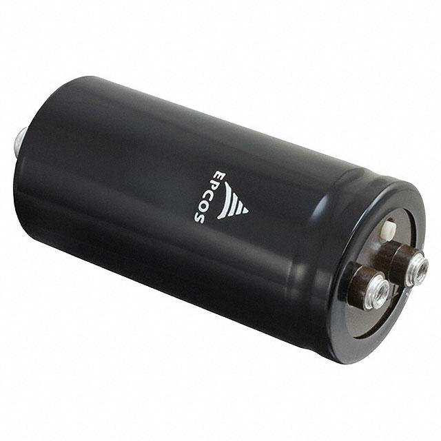

Aluminum electrolytic capacitors Capacitors with screw terminals Series/Type: B43456, B43458 Date: November 2012 © EPCOS AG 2015. Reproduction, publication and dissemination of this publication, enclosures hereto and the information contained therein without EPCOS' prior express consent is prohibited. EPCOS AG is a TDK Group Company. Capacitors with screw terminals B43456, B43458 Extremely compact  85 °C Long-life grade capacitors Applications Frequency converters Wind power converters Solar inverters Professional power supplies Uninterruptible power supplies Features High CV product, i.e. extremely compact High reliability and high ripple current capability All-welded constructions ensures reliable electrical contact PAPR terminals available (Protection Against Polarity Reversal) Version with optimized construction for base cooling (heat sink mounting) available Version with low-inductance design available RoHS-compatible Construction Charge-discharge proof, polar Aluminum case with insulating sleeve Poles with screw terminal connections Mounting with ring clips, clamps or threaded stud The bases of types with threaded stud and d ≤ 76.9 mm are not insulated, types with d = 91 mm have fully insulated bases Please read Cautions and warnings and Important notes at the end of this document. Page 2 of 22 B43456 B43458 B43456, B43458 Extremely compact  85 °C Specifications and characteristics in brief Rated voltage VR Surge voltage VS Rated capacitance CR Capacitance tolerance 350 ... 550 V DC 1.10  VR 560 ... 18000 µF ±20%  M Dissipation factor tan δ (20 °C, 120 Hz) ≤ 0.20 Leakage current Ileak (20 °C, 5 min) Self-inductance ESL d = 51.6 mm: approx. 15 nH d ≥ 64.3 mm: approx. 20 nH Capacitors with low-inductance design: d ≥ 64.3 mm: approx. 13 nH Useful life1) 85 °C; VR; IAC,R 40 °C; VR; 1.5  IAC,R 350 ... 450 V 500 ... 550 V Requirements: > 12000 h > 8000 h ∆C/C ≤ ±15% of initial value > 250000 h > 250000 h tan δ ≤ 1.75 times initial specified limit Ileak ≤ initial specified limit Voltage endurance test Post test requirements: 85 °C; VR 2000 h ∆C/C ≤ ±10% of initial value tan δ ≤ 1.3 times initial specified limit Ileak ≤ initial specified limit Vibration resistance test To IEC 60068-2-6, test Fc: Frequency range 10 ... 55 Hz, displacement amplitude 0.75 mm, acceleration max. 10 g, duration 3 × 2 h. Capacitor mounted by its body which is rigidly clamped to the work surface. Characteristics at low temperature Max. impedance ratio at 100 Hz VR ≤ 400 V ≥ 450 V 500 ... 550 V Z -25°C / Z 20°C Z -40°C / Z 20°C 3 7 3 4 9 10 IEC climatic category To IEC 60068-1: 40/085/56 (40 °C/+85 °C/56 days damp heat test) Detail specification Sectional specification Similar to CECC 30301-803, CECC 30301-807 IEC 60384-4 Ripple current capability Due to the ripple current capability of the contact elements, the following current upper limits must not be exceeded: Capacitor diameter 51.6 mm 64.3 mm 76.9 mm 91 mm IAC,max 34 A 45 A 57 A 80 A 1) Refer to chapter "General technical information, 5 Useful life" on how to interpret useful life. Please read Cautions and warnings and Important notes at the end of this document. Page 3 of 22 B43456, B43458 Extremely compact  85 °C Dimensional drawings B43456 Ring clip/clamp mounting B43458 Threaded stud mounting The base of types with threaded stud and d = 91 mm is fully insulated (the lengths I and l1 are increased by 0.5 mm in these cases). For types with threaded stud and d ≤ 76 mm the base is not insulated. Also refer to the mounting instructions in chapter "Capacitors with screw terminals  Accessories". Screw terminals with UNF threads are available upon request. Dimensions and weights Terminal Dimensions (mm) with insulating sleeve d l ±1 l1 ±1 l2 +0/1 d1 d2 max. a +0.2/0.4 M5 M5 M5 M5 51.6 +0/0.8 80.7 51.6 +0/0.8 105.7 51.6 +0/0.8 118.2 51.6 +0/0.8 130.7 87.2 112.2 124.7 137.2 17 17 17 17 M12 M12 M12 M12 10.2 10.2 10.2 10.2 22.2 22.2 22.2 22.2 220 280 320 350 M5 M5 M5 M5 M5 M5 64.3 +0/0.8 64.3 +0/0.8 64.3 +0/0.8 64.3 +0/0.8 64.3 +0/0.8 64.3 +0/0.8 80.7 96.7 105.7 118.2 130.7 143.2 87.2 103.2 112.2 124.7 137.2 149.7 17 17 17 17 17 17 M12 M12 M12 M12 M12 M12 13.2 13.2 13.2 13.2 13.2 13.2 28.5 28.5 28.5 28.5 28.5 28.5 370 400 440 510 600 630 M6 M6 M6 M6 M6 M6 M6 76.9 +0/0.7 76.9 +0/0.7 76.9 +0/0.7 76.9 +0/0.7 76.9 +0/0.7 76.9 +0/0.7 76.9 +0/0.7 105.7 118.2 130.7 143.2 168.7 190.7 220.7 111.5 124.0 136.5 149.0 174.5 196.5 226.5 17 17 17 17 17 17 17 M12 M12 M12 M12 M12 M12 M12 17.7 17.7 17.7 17.7 17.7 17.7 17.7 31.7 31.7 31.7 31.7 31.7 31.7 31.7 620 700 800 840 1000 1150 1300 Please read Cautions and warnings and Important notes at the end of this document. Page 4 of 22 Approx. weight (g) B43456, B43458 Extremely compact  85 °C Terminal Dimensions (mm) with insulating sleeve d l ±1 l1 ±1 l2 +0/1 d1 d2 max. a +0.2/0.4 Approx. weight (g) M6 M6 M6 M6 91.0 +0/2 91.0 +0/2 91.0 +0/2 91.0 +0/2 17.7 17.7 17.7 17.7 770 1200 1400 1900 97.0 144.5 170.0 221.0 102.3 149.8 175.3 226.3 17 17 17 17 M12 M12 M12 M12 31.7 31.7 31.7 31.7 For low-inductance design the following deviation applies: d = 64.3 mm: l1 0.7 mm d = 91.0 mm: l1 1.7 mm Packing Capacitor diameter d (mm) 51.6 64.3 length l (mm) all all Packing units (pcs.) 36 25 Capacitor diameter d (mm) 76.9 91.0 For ecological reasons the packing is pure cardboard. Please read Cautions and warnings and Important notes at the end of this document. Page 5 of 22 length l (mm) 105.7 - 168.7 191.0 - 220.7 all Packing units (pcs.) 16 12 9 B43456, B43458 Extremely compact  85 °C Special designs Low-inductance design PAPR terminal style With our PAPR terminal style (Protection Against Polarity Reversal) we offer an optional mechanical feature in addition to the visual polarity marking on the cover disk and the sleeve, which prevents from mounting in reverse polarity. The non-circular shape of the terminals and their arrangement perpendicular to each other enables the user to definitely prevent wrong mounting with respect to polarity (Poka Yoke). Dimensional drawing of PAPR terminal configuration Dimensions for PAPR terminal style (mm) Can diameter d Terminal d3 ±0.1 d4 ±0.1 a +0.2/0.4 Min. reach of screw Standard For heat sink design mounting #050 #057 51.6 M5 10 13 22.2 9.5  64.3 M5 13 15 28.5 9.5 7.3 76.9 M6 13 15 31.7 12.0 9.7 91.0 M6 13 15 31.7 12.0 9.7 All other dimensions of the capacitor such as diameter d, case length l and overall length l1 are identical with those of standard capacitors of this series. Please refer to the tables “Dimensions and weights” (standard types) and “Dimensions and weights for heat sink mounting” (special designs). For heat sink mounting Design for optimal connection of capacitors to the heat sink when using base cooling with the following features (refer to chapter "General technical information, 5.2 Cooling"):  Electrical insulation of the capacitors base with 2 overlapping thermal pads for optimal heat flow (minimal thermal resistance at the capacitor base) Please read Cautions and warnings and Important notes at the end of this document. Page 6 of 22 B43456, B43458 Extremely compact  85 °C  Minimal overall length tolerance (±0.35 mm) for mounting between heat sink and bus bar  Case with extra groove near the base for clamp mounting (recommended ring clamp B44030A0165B ... A0190B) This version is available only for capacitors without threaded stud and for diameters ≥ 64.3 mm. Regarding ripple current and useful life, please refer to column IAC,R(B) in the table "Technical data and ordering codes" and in the useful life curves. Dimensions and weights for heat sink mounting: Terminal Dimensions (mm) with insulating sleeve d l ±1 l1 ±0.35 d2 max. a +0.2/0.4 M5 M5 64.3 +0/0.8 64.3 +0/0.8 80.7 105.7 86.3 111.3 13.2 13.2 28.5 28.5 Min. reach of screw mm 7.3 7.3 Approx. weight g 370 440 M6 M6 76.9 +0/0.7 76.9 +0/0.7 105.7 143.2 110.6 148.1 17.7 17.7 31.7 31.7 9.7 9.7 620 840 M6 M6 91.0 +0/2 91.0 +0/2 97.0 144.5 101.4 148.9 17.7 17.7 31.7 31.7 9.7 9.7 1000 1200 Dimensions for other sizes are available upon request. Ordering codes: Design Identification in third Remark block of ordering code Low inductance (13 nH) M003 For capacitors with diameter d ≥ 64.3 mm For heat sink mounting M007 For capacitors with diameter d ≥ 64.3 mm and without threaded stud PAPR terminal style M050 Not for low inductance PAPR terminal style and heat sink mounting M057 For capacitors with diameter d ≥ 64.3 mm and without threaded stud; not for low inductance Please read Cautions and warnings and Important notes at the end of this document. Page 7 of 22 B43456, B43458 Extremely compact  85 °C Accessories The following items are included in the delivery package, but are not fastened to the capacitors: For terminals Thread Toothed washers Screws/nuts Maximum torque M5 A 5.1 DIN 6797 DIN 7985 / ISO 7045-M5 × 10-5.6-Z 2.5 Nm thread depth t ≥ 8 mm M6 A 6.4 DIN 6797 DIN 7985 / ISO 7045-M6 × 12-5.6-Z 4.0 Nm thread depth t ≥ 9.5 mm For mounting M12 J 12.5 DIN 6797 Hex nut BM 12 DIN 439 10 Nm The following items must be ordered separately. For details, refer to chapter "Capacitors with screw terminals  Accessories". Item Type Ring clips B44030 Clamps for capacitors with d ≥ 64.3 mm B44030 Insulating parts B44020 Please read Cautions and warnings and Important notes at the end of this document. Page 8 of 22 B43456, B43458 Extremely compact  85 °C Overview of available types VR (V DC) 350 400 450 500 550 Case dimensions d × l (mm) CR (µF) 560 51.6 × 80.7 680 51.6 × 105.7 820 51.6 × 80.7 1000 51.6 × 80.7 1200 1500 51.6 × 80.7 51.6 × 80.7 51.6 × 105.7 1800 2200 51.6 × 105.7 2700 51.6 × 80.7 51.6 × 105.7 51.6 × 105.7 51.6 × 118.2 64.3 × 80.7 51.6 × 105.7 64.3 × 80.7 51.6 × 130.7 64.3 × 105.7 51.6 × 130.7 64.3 × 96.7 64.3 × 118.2 64.3 × 105.7 64.3 × 130.7 76.9 × 105.7 51.6 × 105.7 64.3 × 105.7 64.3 × 118.2 76.9 × 105.7 64.3 × 143.2 76.9 × 118.2 91.0 × 97.0 51.6 × 130.7 64.3 × 105.7 64.3 × 143.2 76.9 × 105.7 76.9 × 130.7 64.3 × 105.7 76.9 × 105.7 76.9 × 130.7 76.9 × 143.2 3300 51.6 × 118.2 3900 64.3 × 105.7 4700 64.3 × 105.7 64.3 × 130.7 76.9 × 105.7 64.3 × 143.2 76.9 × 118.2 5600 76.9 × 105.7 76.9 × 118.2 76.9 × 143.2 6800 76.9 × 118.2 76.9 × 143.2 76.9 × 168.7 91.0 × 144.5 76.9 × 143.2 8200 76.9 × 143.2 76.9 × 168.7 76.9 × 220.7 10000 76.9 × 143.2 76.9 × 190.7 91.0 × 144.5 76.9 × 220.7 91.0 × 170.0 12000 91.0 × 144.5 76.9 × 220.7 91.0 × 221.0 15000 76.9 × 220.7 91.0 × 221.0 18000 91.0 × 221.0 76.9 × 168.7 The capacitance and voltage ratings listed above are available in different cases upon request. Other voltage and capacitance ratings are also available upon request. Please read Cautions and warnings and Important notes at the end of this document. Page 9 of 22 B43456, B43458 Extremely compact  85 °C Technical data and ordering codes CR 100 Hz 20 °C µF Case dimensions d×l mm VR = 350 V DC 1500 51.6 × 80.7 2200 51.6 × 105.7 3300 51.6 × 118.2 3900 64.3 × 105.7 4700 64.3 × 105.7 5600 76.9 × 105.7 6800 76.9 × 118.2 8200 76.9 × 143.2 10000 76.9 × 143.2 12000 91.0 × 144.5 15000 76.9 × 220.7 18000 91.0 × 221.0 VR = 400 V DC 1000 51.6 × 80.7 1500 51.6 × 80.7 2200 51.6 × 105.7 2700 51.6 × 130.7 3300 64.3 × 105.7 4700 64.3 × 130.7 4700 76.9 × 105.7 5600 76.9 × 118.2 ESRtyp 100 Hz 20 °C mΩ Zmax 10 kHz 20 °C mΩ IAC,max 100 Hz 40 °C A IAC,R 100 Hz 85 °C A IAC,R(B) 100 Hz 85 °C A Ordering code (composition see below) 47 28 20 17 15 14 12 11 7 6 8 5 50 31 24 20 18 17 14 12 8 7 9 7 16 21 28 32 35 43 47 57 57 77 57 80 5.7 7.6 10 12 13 15 17 20 23 28 34 38 11 14 17 21 24 30 31 36 40 53 51 60 B4345*A4158M0## B4345*A4228M0## B4345*A4338M0## B4345*A4398M0## B4345*A4478M0## B4345*A4568M0## B4345*A4688M0## B4345*A4828M0## B4345*A4109M0## B4345*A4129M0## B4345*A4159M0## B4345*A4189M0## 60 45 30 26 23 16 16 14 66 46 30 30 24 18 17 15 13 17 22 26 31 38 40 44 4.6 6.0 8.0 9.3 11 14 14 16 8.2 13 15 15 20 23 29 29 B4345*A9108M0## B4345*A9158M0## B4345*A9228M0## B4345*A9278M0## B4345*A9338M0## B4345*B9478M0## B4345*A9478M0## B4345*A9568M0## Composition of ordering code * = Mounting style 6 = for capacitors with ring clip/clamp mounting 8 = for capacitors with threaded stud Please read Cautions and warnings and Important notes at the end of this document. ## = Design 00 = for capacitors with standard inductance 03 = for capacitors with low inductance (13 nH) (only for capacitors with diameter d ≥ 64.3 mm) 07 = for heat sink mounting (only for capacitors with diameter d ≥ 64.3 mm and without threaded stud) 50 = for terminals with PAPR style (not for low-inductance) 57 = for terminals with PAPR style and heat sink mounting (only d ≥ 64.3 mm and without threaded stud, not for low inductance) Page 10 of 22 B43456, B43458 Extremely compact  85 °C Technical data and ordering codes CR 100 Hz 20 °C µF Case dimensions d×l mm VR = 400 V DC 6800 76.9 × 143.2 8200 76.9 × 168.7 10000 76.9 × 190.7 10000 91.0 × 144.5 12000 76.9 × 220.7 15000 91.0 × 221.0 VR = 450 V DC 1000 51.6 × 80.7 1500 51.6 × 105.7 2200 64.3 × 105.7 2700 64.3 × 105.7 3300 76.9 × 105.7 4700 64.3 × 143.2 4700 76.9 × 118.2 5600 76.9 × 143.2 6800 76.9 × 168.7 6800 91.0 × 144.5 8200 76.9 × 220.7 10000 76.9 × 220.7 10000 91.0 × 170.0 12000 91.0 × 221.0 ESRtyp 100 Hz 20 °C mΩ Zmax 10 kHz 20 °C mΩ IAC,max 100 Hz 40 °C A IAC,R 100 Hz 85 °C A IAC,R(B) 100 Hz 85 °C A Ordering code (composition see below) 11 10 7 6 8 6 14 11 8 7 9 11 53 57 57 71 57 80 19 21 25 25 31 35 33 34 38 49 46 57 B4345*A9688M0## B4345*A9828M0## B4345*B9109M0## B4345*A9109M0## B4345*A9129M0## B4345*A9159M0## 120 80 50 42 35 25 25 23 18 17 15 13 12 9 150 105 60 50 40 30 30 31 21 22 20 15 14 12 13 18 24 26 32 40 40 49 54 57 57 57 74 80 4.8 6.5 8.4 9.4 12 14 15 17 19 20 24 27 26 32 9.6 12 15 17 23 24 27 31 31 38 36 40 46 53 B4345*A5108M0## B4345*A5158M0## B4345*A5228M0## B4345*A5278M0## B4345*A5338M0## B4345*A5478M0## B4345*B5478M0## B4345*A5568M0## B4345*B5688M0## B4345*A5688M0## B4345*A5828M0## B4345*A5109M0## B4345*B5109M0## B4345*A5129M0## Composition of ordering code * = Mounting style 6 = for capacitors with ring clip/clamp mounting 8 = for capacitors with threaded stud Please read Cautions and warnings and Important notes at the end of this document. ## = Design 00 = for capacitors with standard inductance 03 = for capacitors with low inductance (13 nH) (only for capacitors with diameter d ≥ 64.3 mm) 07 = for heat sink mounting (only for capacitors with diameter d ≥ 64.3 mm and without threaded stud) 50 = for terminals with PAPR style (not for low-inductance) 57 = for terminals with PAPR style and heat sink mounting (only d ≥ 64.3 mm and without threaded stud, not for low inductance) Page 11 of 22 B43456, B43458 Extremely compact  85 °C Technical data and ordering codes CR 100 Hz 20 °C µF Case dimensions d×l mm VR = 500 V DC 820 51.6 × 80.7 1000 51.6 × 105.7 1200 51.6 × 105.7 1200 64.3 × 80.7 1500 51.6 × 130.7 1500 64.3 × 96.7 1800 64.3 × 105.7 2200 64.3 × 118.2 2200 76.9 × 105.7 2700 64.3 × 143.2 2700 76.9 × 105.7 3300 76.9 × 130.7 3900 76.9 × 143.2 4700 76.9 × 168.7 VR = 550 V DC 560 51.6 × 80.7 680 51.6 × 105.7 820 51.6 × 105.7 1000 51.6 × 118.2 1000 64.3 × 80.7 1200 51.6 × 130.7 ESRtyp 100 Hz 20 °C mΩ Zmax 10 kHz 20 °C mΩ IAC,max 100 Hz 40 °C A IAC,R 100 Hz 85 °C A IAC,R(B) 100 Hz 85 °C A Ordering code (composition see below) 130 105 85 85 73 73 57 45 45 38 38 35 28 25 163 131 106 106 91 91 71 56 56 48 48 44 35 31 11 13 15 15 17 16 20 23 23 27 27 29 34 38.0 3.9 4.5 5.3 5.2 6.0 5.9 7.0 8.3 8.4 9.6 9.5 10.4 12.2 13.6 7.6 7.5 9.2 9.8 9.3 10.3 12.1 13.9 14.9 14.8 18.1 17.7 20.3 21.1 B4345*A6827M0## B4345*A6108M0## B4345*A6128M0## B4345*B6128M0## B4345*A6158M0## B4345*B6158M0## B4345*A6188M0## B4345*A6228M0## B4345*B6228M0## B4345*A6278M0## B4345*B6278M0## B4345*A6338M0## B4345*A6398M0## B4345*A6478M0## 175 145 121 100 100 83 219 181 151 125 125 104 9 10 12 14 13 16 3.2 3.7 4.2 4.9 4.8 5.6 5.8 5.7 6.9 7.8 9.0 9.1 B4345*A7567M0## B4345*A7687M0## B4345*A7827M0## B4345*A7108M0## B4345*B7108M0## B4345*A7128M0## Composition of ordering code * = Mounting style 6 = for capacitors with ring clip/clamp mounting 8 = for capacitors with threaded stud Please read Cautions and warnings and Important notes at the end of this document. ## = Design 00 = for capacitors with standard inductance 03 = for capacitors with low inductance (13 nH) (only for capacitors with diameter d ≥ 64.3 mm) 07 = for heat sink mounting (only for capacitors with diameter d ≥ 64.3 mm and without threaded stud) 50 = for terminals with PAPR style (not for low-inductance) 57 = for terminals with PAPR style and heat sink mounting (only d ≥ 64.3 mm and without threaded stud, not for low inductance) Page 12 of 22 B43456, B43458 Extremely compact  85 °C Technical data and ordering codes CR 100 Hz 20 °C µF Case dimensions d×l mm VR = 550 V DC 1200 64.3 × 105.7 1500 64.3 × 118.2 1800 64.3 × 130.7 1800 76.9 × 105.7 2200 64.3 × 143.2 2200 76.9 × 118.2 2200 91.0 × 97.0 2700 76.9 × 130.7 3300 76.9 × 143.2 ESRtyp 100 Hz 20 °C mΩ 83 72 60 60 49 49 48 46 37 Zmax 10 kHz 20 °C mΩ IAC,max 100 Hz 40 °C A IAC,R 100 Hz 85 °C A IAC,R(B) 100 Hz 85 °C A Ordering code (composition see below) 104 90 75 75 61 61 60 58 46 15 17 20 20 23 23 25 25 29 5.4 6.2 7.0 7.2 8.2 8.1 8.8 8.9 10.5 8.8 9.8 11.0 12.7 12.7 12.7 17.0 15.1 17.4 B4345*B7128M0## B4345*A7158M0## B4345*A7188M0## B4345*B7188M0## B4345*A7228M0## B4345*B7228M0## B4345*C7228M0## B4345*A7278M0## B4345*A7338M0## Composition of ordering code * = Mounting style 6 = for capacitors with ring clip/clamp mounting 8 = for capacitors with threaded stud Please read Cautions and warnings and Important notes at the end of this document. ## = Design 00 = for capacitors with standard inductance 03 = for capacitors with low inductance (13 nH) (only for capacitors with diameter d ≥ 64.3 mm) 07 = for heat sink mounting (only for capacitors with diameter d ≥ 64.3 mm and without threaded stud) 50 = for terminals with PAPR style (not for low-inductance) 57 = for terminals with PAPR style and heat sink mounting (only d ≥ 64.3 mm and without threaded stud, not for low inductance) Page 13 of 22 B43456, B43458 Extremely compact  85 °C Useful life1) depending on ambient temperature TA (for natural cooling) and versus temperature of case base TB (for base cooling) under ripple current operating conditions at VR ≤ 450 V2) VR = 350 ... 450 V: Useful life1) depending on ambient temperature TA (for natural cooling) and versus temperature of case base TB (for base cooling) under ripple current operating conditions at VR ≥ 500 V2) VR ≥ 500 V: 1) Refer to chapter "General technical information, 5 Useful life" on how to interpret useful life. 2) The ripple current refers to IAC,R for natural cooling or IAC,R(B) for base cooling, respectively. Please read Cautions and warnings and Important notes at the end of this document. Page 14 of 22 B43456, B43458 Extremely compact  85 °C Frequency factor of permissible ripple current IAC versus frequency f Frequency characteristics of ESR Typical behavior Please read Cautions and warnings and Important notes at the end of this document. Page 15 of 22 B43456, B43458 Extremely compact  85 °C Impedance Z versus frequency f Typical behavior at 20 °C Please read Cautions and warnings and Important notes at the end of this document. Page 16 of 22 B43456, B43458 Extremely compact  85 °C Cautions and warnings Personal safety The electrolytes used by EPCOS have been optimized both with a view to the intended application and with regard to health and environmental compatibility. They do not contain any solvents that are detrimental to health, e.g. dimethyl formamide (DMF) or dimethyl acetamide (DMAC). Furthermore, some of the high-voltage electrolytes used by EPCOS are self-extinguishing. As far as possible, EPCOS does not use any dangerous chemicals or compounds to produce operating electrolytes. However, in exceptional cases, such materials must be used in order to achieve specific physical and electrical properties because no alternative materials are currently known. However, the amount of dangerous materials used in our products is limited to an absolute minimum. Materials and chemicals used in EPCOS aluminum electrolytic capacitors are continuously adapted in compliance with the EPCOS Corporate Environmental Policy and the latest EU regulations and guidelines such as RoHS, REACH/SVHC, GADSL, and ELV. MDS (Material Data Sheets) are available on the EPCOS website for all types listed in the data book. MDS for customer specific capacitors are available upon request. MSDS (Material Safety Data Sheets) are available for all of our electrolytes upon request. Nevertheless, the following rules should be observed when handling aluminum electrolytic capacitors: No electrolyte should come into contact with eyes or skin. If electrolyte does come into contact with the skin, wash the affected areas immediately with running water. If the eyes are affected, rinse them for 10 minutes with plenty of water. If symptoms persist, seek medical treatment. Avoid inhaling electrolyte vapor or mists. Workplaces and other affected areas should be well ventilated. Clothing that has been contaminated by electrolyte must be changed and rinsed in water. Please read Cautions and warnings and Important notes at the end of this document. Page 17 of 22 B43456, B43458 Extremely compact  85 °C Product safety The table below summarizes the safety instructions that must be observed without fail. A detailed description can be found in the relevant sections of chapter "General technical information". Topic Safety information Polarity Make sure that polar capacitors are connected with the right polarity. Reverse voltage Voltages polarity classes should be prevented by connecting a diode. Do not mount the capacitor with the terminals (safety vent) upside down. Mounting position of screwterminal capacitors Robustness of terminals Mounting of single-ended capacitors Soldering Soldering, cleaning agents Upper category temperature Passive flammability The following maximum tightening torques must not be exceeded when connecting screw terminals: M5: 2.5 Nm M6: 4.0 Nm The internal structure of single-ended capacitors might be damaged if excessive force is applied to the lead wires. Avoid any compressive, tensile or flexural stress. Do not move the capacitor after soldering to PC board. Do not pick up the PC board by the soldered capacitor. Do not insert the capacitor on the PC board with a hole space different to the lead space specified. Do not exceed the specified time or temperature limits during soldering. Do not allow halogenated hydrocarbons to come into contact with aluminum electrolytic capacitors. Do not exceed the upper category temperature. Avoid external energy, such as fire or electricity. Please read Cautions and warnings and Important notes at the end of this document. Page 18 of 22 Reference chapter "General technical information" 1 "Basic construction of aluminum electrolytic capacitors" 3.1.6 "Reverse voltage" 11.1. "Mounting positions of capacitors with screw terminals" 11.3 "Mounting torques" 11.4 "Mounting considerations for single-ended capacitors" 11.5 "Soldering" 11.6 "Cleaning agents" 7.2 "Maximum permissible operating temperature" 8.1 "Passive flammability" B43456, B43458 Extremely compact  85 °C Topic Safety information Active flammability Maintenance Avoid overload of the capacitors. Storage Make periodic inspections of the capacitors. Before the inspection, make sure that the power supply is turned off and carefully discharge the electricity of the capacitors. Do not apply any mechanical stress to the capacitor terminals. Do not store capacitors at high temperatures or high humidity. Capacitors should be stored at +5 to +35 °C and a relative humidity of ≤ 75%. Breakdown strength Do not damage the insulating sleeve, especially of insulating when ring clips are used for mounting. sleeves Please read Cautions and warnings and Important notes at the end of this document. Page 19 of 22 Reference chapter "General technical information" 8.2 "Active flammability" 10 "Maintenance" 7.3 Storage conditions Reference chapter "Capacitors with screw terminals" "Screw terminals  accessories" B43456, B43458 Extremely compact  85 °C Symbols and terms Symbol English German C CR CS CS,T Cf d dmax ESL ESR ESRf Capacitance Rated capacitance Series capacitance Series capacitance at temperature T Capacitance at frequency f Case diameter, nominal dimension Maximum case diameter Self-inductance Equivalent series resistance Equivalent series resistance at frequency f Equivalent series resistance at temperature T Frequency Current Alternating current (ripple current) Root-mean-square value of alternating current Ripple current at frequency f Maximum permissible ripple current Rated ripple current Rated ripple current for base cooling Leakage current Operating leakage current Case length, nominal dimension Maximum case length (without terminals and mounting stud) Resistance Insulation resistance Balancing resistance Temperature Temperature difference Ambient temperature Case temperature Capacitor base temperature Time Period Service life (operating hours) Kapazität Nennkapazität Serienkapazität Serienkapazität bei Temperatur T Kapazität bei Frequenz f Gehäusedurchmesser, Nennmaß Maximaler Gehäusedurchmesser Eigeninduktivität Ersatzserienwiderstand Ersatzserienwiderstand bei Frequenz f ESRT f I IAC IAC,rms IAC,f IAC,max IAC,R IAC,R (B) Ileak Ileak,op l lmax R Rins Rsymm T ∆T TA TC TB t ∆t tb Please read Cautions and warnings and Important notes at the end of this document. Ersatzserienwiderstand bei Temperatur T Frequenz Strom Wechselstrom Wechselstrom, Effektivwert Wechselstrom bei Frequenz f Maximal zulässiger Wechselstrom Nennwechselstrom Nennwechselstromstrom für Bodenkühlung Reststrom Betriebsreststrom Gehäuselänge, Nennmaß Maximale Gehäuselänge (ohne Anschlüsse und Gewindebolzen) Widerstand Isolationswiderstand Symmetrierwiderstand Temperatur Temperaturdifferenz Umgebungstemperatur Gehäusetemperatur Temperatur des Becherbodens Zeit Zeitraum Brauchbarkeitsdauer (Betriebszeit) Page 20 of 22 B43456, B43458 Extremely compact  85 °C Symbol V VF Vop VR VS XC XL Z ZT tan δ λ ε0 εr ω English Voltage Forming voltage Operating voltage Rated voltage, DC voltage Surge voltage Capacitive reactance Inductive reactance Impedance Impedance at temperature T Dissipation factor Failure rate Absolute permittivity Relative permittivity Angular velocity; 2  π  f German Spannung Formierspannung Betriebsspannung Nennspannung, Gleichspannung Spitzenspannung Kapazitiver Blindwiderstand Induktiver Blindwiderstand Scheinwiderstand Scheinwiderstand bei Temperatur T Verlustfaktor Ausfallrate Elektrische Feldkonstante Dielektrizitätszahl Kreisfrequenz; 2  π  f Note All dimensions are given in mm. Please read Cautions and warnings and Important notes at the end of this document. Page 21 of 22 Important notes The following applies to all products named in this publication: 1. Some parts of this publication contain statements about the suitability of our products for certain areas of application. These statements are based on our knowledge of typical requirements that are often placed on our products in the areas of application concerned. We nevertheless expressly point out that such statements cannot be regarded as binding statements about the suitability of our products for a particular customer application. As a rule, EPCOS is either unfamiliar with individual customer applications or less familiar with them than the customers themselves. For these reasons, it is always ultimately incumbent on the customer to check and decide whether an EPCOS product with the properties described in the product specification is suitable for use in a particular customer application. 2. We also point out that in individual cases, a malfunction of electronic components or failure before the end of their usual service life cannot be completely ruled out in the current state of the art, even if they are operated as specified. In customer applications requiring a very high level of operational safety and especially in customer applications in which the malfunction or failure of an electronic component could endanger human life or health (e.g. in accident prevention or lifesaving systems), it must therefore be ensured by means of suitable design of the customer application or other action taken by the customer (e.g. installation of protective circuitry or redundancy) that no injury or damage is sustained by third parties in the event of malfunction or failure of an electronic component. 3. The warnings, cautions and product-specific notes must be observed. 4. In order to satisfy certain technical requirements, some of the products described in this publication may contain substances subject to restrictions in certain jurisdictions (e.g. because they are classed as hazardous). Useful information on this will be found in our Material Data Sheets on the Internet (www.epcos.com/material). Should you have any more detailed questions, please contact our sales offices. 5. We constantly strive to improve our products. Consequently, the products described in this publication may change from time to time. The same is true of the corresponding product specifications. Please check therefore to what extent product descriptions and specifications contained in this publication are still applicable before or when you place an order. We also reserve the right to discontinue production and delivery of products. Consequently, we cannot guarantee that all products named in this publication will always be available. The aforementioned does not apply in the case of individual agreements deviating from the foregoing for customer-specific products. 6. Unless otherwise agreed in individual contracts, all orders are subject to the current version of the "General Terms of Delivery for Products and Services in the Electrical Industry" published by the German Electrical and Electronics Industry Association (ZVEI). 7. The trade names EPCOS, BAOKE, Alu-X, CeraDiode, CeraLink, CSMP, CSSP, CTVS, DeltaCap, DigiSiMic, DSSP, FilterCap, FormFit, MiniBlue, MiniCell, MKD, MKK, MLSC, MotorCap, PCC, PhaseCap, PhaseCube, PhaseMod, PhiCap, SIFERRIT, SIFI, SIKOREL, SilverCap, SIMDAD, SiMic, SIMID, SineFormer, SIOV, SIP5D, SIP5K, ThermoFuse, WindCap are trademarks registered or pending in Europe and in other countries. Further information will be found on the Internet at www.epcos.com/trademarks. Page 22 of 22

物料型号: - TDK B43456, B43458
器件简介: - 这些是带有螺丝端子的铝电解电容器,具有极高的CV值(电容与体积的比),非常紧凑,适用于85°C的环境温度。 - 长寿命等级的电容器,适用于变频器、风力发电转换器、太阳能逆变器和专业电源等应用。
引脚分配: - 电容器带有螺丝端子连接,可以安装在环形夹子、夹具或螺纹柱上。
参数特性: - 额定电压范围从350V DC至550V DC。 - 电容公差为+20%。 - 损耗角正切值在20°C和120Hz时不超过0.20。 - 漏电流和自感值根据电容器直径不同而有所变化。
功能详解: - 提供了详细的规格和特性简表,包括额定电压、电容公差、损耗因子、漏电流、自感等。 - 描述了电容器的构造,包括防充电证明、极性铝制外壳、带螺丝端子连接的极柱等。
应用信息: - 适用于不间断电源、变频器、风力发电转换器、太阳能逆变器和专业电源。
封装信息: - 提供了详细的尺寸图和重量信息,以及特殊设计如低电感设计和PAPR(防极性反转)端子样式。
注意事项和警告: - 强调了电解液的安全性,建议避免与眼睛或皮肤接触,并确保工作场所通风良好。 - 提供了产品安全指南,包括极性、反向电压、安装位置、螺丝端子的扭矩限制等。
订购代码: - 提供了详细的订购代码组成,包括安装风格、设计和特殊功能的代码。
重要提示: - 文档最后强调了产品适用性、安全性、存储条件和产品改进的声明。
