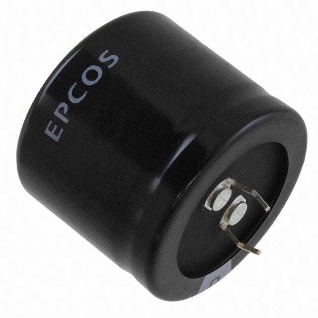

    220 µF 400 V 铝电解电容器 径向,Can - 卡入式 400 毫欧 @ 100Hz 105°C 时为 5000 小时
B43505C9227M000 数据手册
Aluminum electrolytic capacitors Snap-in capacitors Series/Type: B41505, B43505 Date: December 2010 © EPCOS AG 2010. Reproduction, publication and dissemination of this publication, enclosures hereto and the information contained therein without EPCOS' prior express consent is prohibited. Snap-in capacitors B41505, B43505 Excellent performance  105 °C Long-life grade capacitors Applications Frequency converters Professional power supplies in industrial electronics and in data processing equipment Features Long useful life High reliability Outstanding ripple current capability Low ESR Capacitors with all insulation versions pass the needle flame test according to IEC 60695-11-5 for all flame exposure times up to 120 s RoHS-compatible Construction Charge/discharge-proof, polar Aluminum case, fully insulated with PVC Version with PET insulation available (B43505 only) Version with additional PET insulation cap on terminal side available for insulating the capacitor from the PCB (B43505 only) Snap-in solder pins to hold component in place on PC-board Minus pole marking on case surface Minus pole not insulated from case Overload protection by safety vent on the base Terminals Standard version with 2 terminals, 2 lengths available: 6.3 and 4.5 mm 3 terminals to ensure correct insertion: length 4.5 mm Please read Cautions and warnings and Important notes at the end of this document. Page 2 of 22 B41505, B43505 Excellent performance  105 °C Specifications and characteristics in brief Series Rated voltage VR Surge voltage VS B41505 10 ... 100 V DC 1.15  VR B43505 200 ... 450 V DC 1.15  VR (for VR ≤ 250 V DC) 1.10  VR (for VR ≥ 400 V DC) 47 ... 1500 µF ±20%  M Rated capacitance CR Capacitance tolerance 560 ... 33000 µF ±20%  M Dissipation factor tan δ (20 °C, 100 Hz) VR = 10 V DC: tan δ ≤ 0.20 VR = 16 V DC: tan δ ≤ 0.15 VR = 25 V DC: tan δ ≤ 0.11 VR = 35 V DC: tan δ ≤ 0.10 VR = 50 V DC: tan δ ≤ 0.08 VR = 63 ... 100 V DC: tan δ ≤ 0.06 VR ≤ 400 V DC: tan δ ≤ 0.13 VR = 450 V DC: tan δ ≤ 0.17 Leakage current Ileak (5 min, 20 °C) Self-inductance ESL Useful life 105 °C, VR, IAC,R 85 °C, VR, IAC,max 40 °C, VR, 2.1  IAC,R Requirements Load life test 105 °C; VR; IAC,R Post test requirements Approx. 20 nH > 5000 h > 12000 h > 250000 h ∆C/C ≤ ±45% of initial value tan δ ≤ 3 times initial spec. limit Ileak ≤ initial specified limit > 5000 h > 11000 h > 250000 h ∆C/C ≤ ±30% of initial value tan δ ≤ 3 times initial spec. limit Ileak ≤ initial specified limit 4000 h ∆C/C ≤ ±20% of initial value tan δ ≤ 2 times initial spec. limit Ileak ≤ initial specified limit 4000 h ∆C/C ≤ ±20% of initial value tan δ ≤ 2 times initial spec. limit Ileak ≤ initial specified limit Voltage endurance test 105 °C; VR 2000 h Post test requirements ∆C/C ≤ ±15% of initial value tan δ ≤ 1.3 times initial spec. limit Ileak ≤ initial specified limit Vibration resistance test 2000 h ∆C/C ≤ ±10% of initial value tan δ ≤ 1.3 times initial spec. limit Ileak ≤ initial specified limit To IEC 60068-2-6, test Fc: Frequency range 10 Hz ... 55 Hz, displacement amplitude 0.35 mm, acceleration max. 5 g, duration 3 × 2 h. Capacitor mounted by its body which is rigidly clamped to the work surface. Please read Cautions and warnings and Important notes at the end of this document. Page 3 of 22 B41505, B43505 Excellent performance  105 °C Series Characteristics at low temperature B41505 Max. impedance ratio at 100 Hz VR 10 ... 100 V Z -25 °C / Z 20 °C 2 Z -40 °C / Z 20 °C 3 IEC climatic category To IEC 60068-1: VR ≤ 400 V DC: 40/105/56 (40 °C/+105 °C/56 days damp heat test) VR = 450 V DC: 25/105/56 (25 °C/+105 °C/56 days damp heat test) The capacitors can be operated in the temperature range of 40 °C to +105 °C but the impedance at 40 °C should be taken into consideration.  Similar to CECC 30301-809 IEC 60384-4 IEC 60384-4 Detail specification Sectional specification Please read Cautions and warnings and Important notes at the end of this document. Page 4 of 22 B43505 Max. impedance ratio at 100 Hz VR ≤ 400 V 450 V Z -25 °C / Z 20 °C 4 7 Z -40 °C / Z 20 °C 7 14 B41505, B43505 Excellent performance  105 °C Dimensional drawings Snap-in capacitors with standard insulation (PVC or PET) PET insulation is only available for B43505 Snap-in terminals, length (6.3 ±1) mm. Also available in a shorter version with a length of (4.5 1) mm. PET insulation is marked with label "PET" on the sleeve. Snap-in capacitors are also available with 3 terminals (length (4.5 1) mm). PET insulation is marked with label "PET" on the sleeve. Dimensions (mm) d +1 l ±2 22 25 22 30 22 35 22 40 22 45 25 25 25 30 25 35 25 40 25 45 Dimensions (mm) d +1 l ±2 30 25 30 30 30 35 30 40 30 45 30 50 Approx. weight (g) Packing units (pcs.) 17 23 29 36 41 46 80 80 80 80 80 80 35 35 35 35 35 29 36 41 56 70 60 60 60 60 60 Approx. weight (g) Packing units (pcs.) 9 12 15 18 20 13 17 19 22 25 160 160 160 160 160 130 130 130 130 130 Please read Cautions and warnings and Important notes at the end of this document. Page 5 of 22 30 35 40 45 50 B41505, B43505 Excellent performance  105 °C Snap-in capacitors with PVC insulation and PET insulation cap on terminal side (B43505 only) Snap-in terminals, length (6.3 +1/1.4) mm. Also available in a shorter version with a length of (4.5 1.4) mm. PET insulation cap is positioned under the insulation sleeve. Snap-in capacitors are also available with 3 terminals (length (4.5 1.4) mm). PET insulation cap is positioned under the insulation sleeve. Dimensions (mm) d +1.4 l +2.2/2 22 25 22 30 22 35 22 40 22 45 25 25 25 30 25 35 25 40 25 45 Dimensions (mm) d +1.4 l +2.2/2 30 25 30 30 30 35 30 40 30 45 30 50 Approx. Packing weight (g) units (pcs.) 17 23 29 36 41 46 80 80 80 80 80 80 35 35 35 35 35 29 36 41 56 70 60 60 60 60 60 Approx. Packing weight (g) units (pcs.) 9 12 15 18 20 13 17 19 22 25 Please read Cautions and warnings and Important notes at the end of this document. 160 160 160 160 160 130 130 130 130 130 Page 6 of 22 30 35 40 45 50 B41505, B43505 Excellent performance  105 °C Packing of snap-in capacitors For ecological reasons the packing is pure cardboard. Components can be withdrawn (in full or in part) in the correct position for insertion. Ordering codes for terminal styles and insulation features Identification in 3rd block of ordering code Snap-in capacitors Terminal version Insulation version PVC PET (B43505 only) PVC plus PET cap (B43505 only) Standard terminals 6.3 mm M000 M060 M080 Short terminals 4.5 mm M007 M067 M087 3 terminals 4.5 mm M002 M062 M082 Ordering examples: B43505A5107M007 B43505A5107M062 B43505A5107M080 } } } snap-in capacitor with short terminals and standard PVC insulation snap-in capacitor with 3 terminals and PET insulation snap-in capacitor with standard terminals and PVC insulation with additional PET insulation cap on terminal side Please read Cautions and warnings and Important notes at the end of this document. Page 7 of 22 B41505 Excellent performance  105 °C Overview of available types B41505 VR (V DC) 10 16 25 35 50 63 80 100 Case dimensions d × l (mm) CR (µF) 25 × 25 560 22 × 35 680 22 × 25 1000 25 × 25 25 × 35 30 × 30 30 × 25 1200 25 × 35 30 × 40 2200 22 × 25 22 × 35 25 × 35 30 × 30 30 × 35 30 × 50 3300 22 × 30 25 × 25 25 × 35 30 × 40 35 × 35 35 × 50 22 × 30 25 × 25 22 × 40 30 × 35 35 × 35 35 × 45 35 × 50 1500 4700 6800 22 × 25 22 × 30 25 × 30 25 × 40 30 × 50 10000 22 × 30 25 × 30 25 × 40 30 × 40 35 × 45 15000 22 × 40 25 × 40 30 × 40 35 × 40 22000 30 × 35 30 × 40 33000 30 × 45 22 × 35 35 × 45 18000 The capacitance and voltage ratings listed above are available in different cases upon request. Other voltage and capacitance ratings are also available upon request. Please read Cautions and warnings and Important notes at the end of this document. Page 8 of 22 B43505 Excellent performance  105 °C Overview of available types B43505 VR (V DC) 200 250 400 450 Case dimensions d × l (mm) CR (µF) 22 × 25 47 100 25 × 30 22 × 45 30 × 30 150 25 × 40 30 × 30 25 × 45 30 × 35 220 22 × 30 25 × 30 30 × 40 35 × 30 30 × 45 35 × 35 330 22 × 40 25 × 40 30 × 30 30 × 50 35 × 40 35 × 50 35 × 45 35 × 50 470 25 × 40 30 × 30 30 × 35 390 680 30 × 40 30 × 45 1000 35 × 45 35 × 45 1500 35 × 50 35 × 50 The capacitance and voltage ratings listed above are available in different cases upon request. Other voltage and capacitance ratings are also available upon request. Please read Cautions and warnings and Important notes at the end of this document. Page 9 of 22 B41505 Excellent performance  105 °C Technical data and ordering codes  B41505 CR 100 Hz 20 °C µF Case dimensions d×l mm VR = 10 V DC 6800 22 × 25 10000 22 × 30 15000 22 × 40 22000 30 × 35 33000 30 × 45 VR = 16 V DC 6800 22 × 30 10000 25 × 30 15000 25 × 40 22000 30 × 40 VR = 25 V DC 4700 22 × 30 4700 25 × 25 6800 25 × 30 10000 25 × 40 15000 30 × 40 VR = 35 V DC 2200 22 × 25 3300 22 × 30 3300 25 × 25 4700 22 × 40 6800 25 × 40 10000 30 × 40 15000 35 × 40 18000 35 × 45 VR = 50 V DC 2200 22 × 35 3300 25 × 35 4700 30 × 35 6800 30 × 50 10000 35 × 45 ESRtyp 100 Hz 20 °C mΩ Zmax 10 kHz 20 °C mΩ IAC,max 100 Hz 60 °C A IAC,max 100 Hz 85 °C A IAC,R1) Ordering code 100 Hz (composition see 105 °C below) A 74 53 37 26 19 78 56 39 28 20 3.6 4.6 5.9 7.7 10.2 2.8 3.6 4.6 6.0 7.8 1.4 1.8 2.3 3.0 3.9 B41505A3688M00# B41505A3109M00# B41505A3159M00# B41505A3229M00# B41505A3339M00# 46 34 24 17 49 36 26 18 4.6 5.6 7.1 9.4 3.6 4.4 5.6 7.0 1.8 2.2 2.8 3.5 B41505A4688M00# B41505A4109M00# B41505A4159M00# B41505A4229M00# 53 53 41 30 22 57 57 43 32 23 4.1 4.1 4.8 6.4 8.2 3.2 3.2 3.8 5.0 6.4 1.6 1.6 1.9 2.5 3.2 B41505A5478M00# B41505F5478M00# B41505A5688M00# B41505A5109M00# B41505A5159M00# 85 56 56 45 35 26 19 17 90 60 60 48 37 28 20 18 2.8 3.8 3.8 4.8 5.9 7.4 9.4 11.1 2.2 3.0 3.0 3.8 4.6 5.8 7.6 8.6 1.1 1.5 1.5 1.9 2.3 2.9 3.8 4.3 B41505A7228M00# B41505A7338M00# B41505F7338M00# B41505A7478M00# B41505A7688M00# B41505A7109M00# B41505A7159M00# B41505A7189M00# 85 56 42 33 25 90 60 45 35 26 3.6 4.6 5.6 7.4 9.4 2.8 3.6 4.4 5.8 7.2 1.4 1.8 2.2 2.9 3.6 B41505A6228M00# B41505A6338M00# B41505A6478M00# B41505A6688M00# B41505A6109M00# Composition of ordering code # = Terminal style 0 = snap-in standard terminals (6.3 mm) 2 = snap-in 3 terminals (4.5 mm) 7 = snap-in short terminals (4.5 mm) 1) 120-Hz conversion factor of ripple current: IAC (120 Hz) = 1.03  IAC (100 Hz) Please read Cautions and warnings and Important notes at the end of this document. Page 10 of 22 B41505 Excellent performance  105 °C Technical data and ordering codes  B41505 CR 100 Hz 20 °C µF Case dimensions d×l mm VR = 63 V DC 1000 22 × 25 1500 22 × 35 2200 25 × 35 2200 30 × 30 3300 30 × 40 4700 35 × 35 6800 35 × 50 VR = 80 V DC 1000 25 × 25 1200 30 × 25 1500 25 × 35 2200 30 × 35 3300 35 × 35 4700 35 × 45 VR = 100 V DC 560 25 × 25 680 22 × 35 1000 25 × 35 1000 30 × 30 1500 30 × 40 2200 30 × 50 3300 35 × 50 IAC,max 100 Hz 85 °C A IAC,R2) Ordering code 100 Hz (composition see 105 °C below) A 2.6 3.6 4.3 4.6 5.9 6.9 9.4 2.0 2.8 3.4 3.6 4.6 5.4 7.2 1.0 1.4 1.7 1.8 2.3 2.7 3.6 B41505A8108M00# B41505A8158M00# B41505A8228M00# B41505F8228M00# B41505A8338M00# B41505A8478M00# B41505A8688M00# 133 110 89 60 48 34 3.3 3.8 4.6 5.1 7.1 8.5 2.6 3.0 3.6 4.0 5.6 6.8 1.3 1.5 1.8 2.0 2.8 3.4 B41505A0108M00# B41505A0128M00# B41505A0158M00# B41505A0228M00# B41505A0338M00# B41505A0478M00# 190 156 106 106 70 60 40 2.6 3.1 3.6 3.8 4.8 5.9 7.7 2.0 2.4 2.8 3.0 3.8 4.6 6.0 1.0 1.2 1.4 1.5 1.9 2.3 3.0 B41505A9567M00# B41505A9687M00# B41505A9108M00# B41505F9108M00# B41505A9158M00# B41505A9228M00# B41505A9338M00# ESRtyp 100 Hz 20 °C mΩ Zmax 10 kHz 20 °C mΩ 149 100 68 80 53 42 29 159 106 72 85 56 45 31 125 104 83 56 45 32 178 146 100 100 66 56 38 IAC,max 100 Hz 60 °C A Composition of ordering code # = Terminal style 0 = snap-in standard terminals (6.3 mm) 2 = snap-in 3 terminals (4.5 mm) 7 = snap-in short terminals (4.5 mm) 2) 120-Hz conversion factor of ripple current: IAC (120 Hz) = 1.03  IAC (100 Hz) Please read Cautions and warnings and Important notes at the end of this document. Page 11 of 22 B43505 Excellent performance  105 °C Technical data and ordering codes  B43505 CR 100 Hz 20 °C µF Case dimensions d×l mm VR = 200 V DC 220 22 × 30 330 22 × 40 470 25 × 40 470 30 × 30 680 30 × 40 1000 35 × 45 1500 35 × 50 VR = 250 V DC 220 25 × 30 330 25 × 40 330 30 × 30 470 30 × 35 680 30 × 45 1000 35 × 45 VR = 400 V DC 100 25 × 30 150 25 × 40 150 30 × 30 220 30 × 40 220 35 × 30 330 30 × 50 330 35 × 40 390 35 × 45 470 35 × 50 IAC,max 100 Hz 60 °C A IAC,max 100 Hz 85 °C A IAC,R1) 100 Hz 105 °C A Ordering code (composition see below) 700 470 330 330 230 160 110 2.5 3.5 4.5 4.4 5.9 8.3 10.5 1.9 2.6 3.4 3.3 4.4 6.2 7.8 0.96 1.3 1.7 1.7 2.2 3.1 3.9 B43505E2227M0*# B43505E2337M0*# B43505E2477M0*# B43505G2477M0*# B43505E2687M0*# B43505E2108M0*# B43505E2158M0*# 580 390 390 280 190 130 700 470 470 330 230 160 2.8 3.8 3.7 4.7 6.2 8.3 2.1 2.8 2.8 3.5 4.6 6.2 1.0 1.4 1.4 1.8 2.3 3.1 B43505A2227M0*# B43505A2337M0*# B43505C2337M0*# B43505A2477M0*# B43505A2687M0*# B43505A2108M0*# 880 590 590 400 400 270 270 230 190 1090 730 730 500 500 330 330 280 240 1.8 2.5 2.5 3.3 3.3 4.5 4.5 5.1 5.9 1.4 1.9 1.9 2.5 2.5 3.3 3.4 3.8 4.4 0.70 0.95 0.94 1.3 1.3 1.7 1.7 1.9 2.2 B43505A9107M0*# B43505A9157M0*# B43505C9157M0*# B43505A9227M0*# B43505C9227M0*# B43505A9337M0*# B43505C9337M0*# B43505A9397M0*# B43505A9477M0*# ESRtyp 100 Hz 20 °C mΩ Zmax 10 kHz 20 °C mΩ 580 390 280 280 190 130 90 Composition of ordering code * = Insulation feature #= 0 = PVC insulation 6 = PET insulation 8 = PVC insulation with additional PET insulation cap on terminal side Terminal style 0 = snap-in standard terminals (6.3 mm) 2 = snap-in 3 terminals (4.5 mm) 7 = snap-in short terminals (4.5 mm) 1) 120-Hz conversion factor of ripple current: IAC (120 Hz) = 1.03  IAC (100 Hz) Please read Cautions and warnings and Important notes at the end of this document. Page 12 of 22 B43505 Excellent performance  105 °C Technical data and ordering codes  B43505 CR 100 Hz 20 °C µF Case dimensions d×l mm VR = 450 V DC 47 22 × 25 100 22 × 45 100 30 × 30 150 25 × 45 150 30 × 35 220 30 × 45 220 35 × 35 330 35 × 50 390 35 × 50 ESRtyp 100 Hz 20 °C mΩ Zmax 10 kHz 20 °C mΩ 2280 1360 1360 910 910 620 620 410 350 3390 1600 1600 1070 1070 730 730 490 410 IAC,max 100 Hz 60 °C A 1.1 2.0 2.0 2.6 2.6 3.5 3.5 4.9 5.3 Composition of ordering code * = Insulation feature #= 0 = PVC insulation 6 = PET insulation 8 = PVC insulation with additional PET insulation cap on terminal side IAC,max 100 Hz 85 °C A IAC,R2) 100 Hz 105 °C A Ordering code (composition see below) 0.83 1.5 1.5 2.0 2.0 2.6 2.7 3.7 4.0 0.41 0.75 0.76 1.0 0.99 1.3 1.3 1.8 2.0 B43505A5476M0*# B43505A5107M0*# B43505C5107M0*# B43505A5157M0*# B43505C5157M0*# B43505A5227M0*# B43505C5227M0*# B43505A5337M0*# B43505A5397M0*# Terminal style 0 = snap-in standard terminals (6.3 mm) 2 = snap-in 3 terminals (4.5 mm) 7 = snap-in short terminals (4.5 mm) 2) 120-Hz conversion factor of ripple current: IAC (120 Hz) = 1.03  IAC (100 Hz) Please read Cautions and warnings and Important notes at the end of this document. Page 13 of 22 B41505, B43505 Excellent performance  105 °C Useful life depending on ambient temperature TA under ripple current operating conditions1) VR ≤ 100 V DC Useful life depending on ambient temperature TA under ripple current operating conditions1) VR ≥ 200 V DC 1) Refer to chapter "General technical information, 5.3 Calculation of useful life" for an explanation on how to interpret the useful life graphs. Please read Cautions and warnings and Important notes at the end of this document. Page 14 of 22 B41505, B43505 Excellent performance  105 °C Frequency factor of permissible ripple current IAC versus frequency f Frequency factor of permissible ripple current IAC versus frequency f VR ≤ 100 V DC VR ≥ 200 V DC Frequency characteristic of ESR Typical behavior Frequency characteristic of ESR Typical behavior VR ≤ 100 V DC VR ≥ 200 V DC Please read Cautions and warnings and Important notes at the end of this document. Page 15 of 22 B41505, B43505 Excellent performance  105 °C Impedance Z versus frequency f Typical behavior at 20 °C VR ≤ 100 V DC Please read Cautions and warnings and Important notes at the end of this document. Impedance Z versus frequency f Typical behavior at 20 °C VR ≥ 200 V DC Page 16 of 22 B41505, B43505 Excellent performance  105 °C Cautions and warnings Personal safety The electrolytes used by EPCOS have not only been optimized with a view to the intended application, but also with regard to health and environmental compatibility. They do not contain any solvents that are detrimental to health, e.g. dimethyl formamide (DMF) or dimethyl acetamide (DMAC). Furthermore, part of the high-voltage electrolytes used by EPCOS are self-extinguishing. They contain flame-retarding substances which will quickly extinguish any flame that may have been ignited. As far as possible, EPCOS does not use any dangerous chemicals or compounds to produce operating electrolytes. However, in exceptional cases, such materials must be used in order to achieve specific physical and electrical properties because no safe substitute materials are currently known. However, the amount of dangerous materials used in our products has been limited to an absolute minimum. Nevertheless, the following rules should be observed when handling aluminum electrolytic capacitors: Any escaping electrolyte should not come into contact with eyes or skin. If electrolyte does come into contact with the skin, wash the affected parts immediately with running water. If the eyes are affected, rinse them for 10 minutes with plenty of water. If symptoms persist, seek medical treatment. Avoid breathing in electrolyte vapor or mists. Workplaces and other affected areas should be well ventilated. Clothing that has been contaminated by electrolyte must be changed and rinsed in water. Please read Cautions and warnings and Important notes at the end of this document. Page 17 of 22 B41505, B43505 Excellent performance  105 °C Product safety The table below summarizes the safety instructions that must be observed without fail. A detailed description can be found in the relevant sections of chapter "General technical information". Topic Safety information Polarity Make sure that polar capacitors are connected with the right polarity. Reverse voltage Voltages polarity classes should be prevented by connecting a diode. Do not exceed the upper category temperature. Upper category temperature Maintenance Mounting position of screwterminal capacitors Mounting of single-ended capacitors Robustness of terminals Soldering Make periodic inspections of the capacitors. Before the inspection, make sure that the power supply is turned off and carefully discharge the electricity of the capacitors. Do not apply any mechanical stress to the capacitor terminals. Do not mount the capacitor with the terminals (safety vent) upside down. Reference chapter "General technical information" 1 "Basic construction of aluminum electrolytic capacitors" 3.1.6 "Reverse voltage" 7.2 "Maximum permissible operating temperature" 10 "Maintenance" 11.1. "Mounting positions of capacitors with screw terminals" The internal structure of single-ended capacitors 11.4 might be damaged if excessive force is applied to "Mounting the lead wires. considerations for Avoid any compressive, tensile or flexural stress. single-ended capacitors" Do not move the capacitor after soldering to PC board. Do not pick up the PC board by the soldered capacitor. Do not insert the capacitor on the PC board with a hole space different to the lead space specified. The following maximum tightening torques must 11.3 not be exceeded when connecting screw "Mounting torques" terminals: M5: 2 Nm M6: 2.5 Nm Do not exceed the specified time or temperature 11.5 limits during soldering. "Soldering" Please read Cautions and warnings and Important notes at the end of this document. Page 18 of 22 B41505, B43505 Excellent performance  105 °C Topic Soldering, cleaning agents Passive flammability Active flammability Safety information Reference chapter "General technical information" Do not allow halogenated hydrocarbons to come 11.6 into contact with aluminum electrolytic capacitors. "Cleaning agents" Avoid external energy, such as fire or electricity. 8.1 "Passive flammability" Avoid overload of the capacitors. 8.2 "Active flammability" Breakdown strength Do not damage the insulating sleeve, especially of insulating when ring clips are used for mounting. sleeves Please read Cautions and warnings and Important notes at the end of this document. Page 19 of 22 Reference chapter "Capacitors with screw terminals" "Screw terminals  accessories" B41505, B43505 Excellent performance  105 °C Symbols and terms Symbol English German C CR CS CS,T Cf d dmax ESL ESR ESRf Capacitance Rated capacitance Series capacitance Series capacitance at temperature T Capacitance at frequency f Case diameter, nominal dimension Maximum case diameter Self-inductance Equivalent series resistance Equivalent series resistance at frequency f Equivalent series resistance at temperature T Frequency Current Alternating current (ripple current) Root-mean-square value of alternating current Ripple current at frequency f Maximum permissible ripple current Rated ripple current Rated ripple current for base cooling Leakage current Operating leakage current Case length, nominal dimension Maximum case length (without terminals and mounting stud) Resistance Insulation resistance Balancing resistance Temperature Temperature difference Ambient temperature Case temperature Capacitor base temperature Time Period Service life (operating hours) Kapazität Nennkapazität Serienkapazität Serienkapazität bei Temperatur T Kapazität bei Frequenz f Gehäusedurchmesser, Nennmaß Maximaler Gehäusedurchmesser Eigeninduktivität Ersatzserienwiderstand Ersatzserienwiderstand bei Frequenz f ESRT f I IAC IAC,rms IAC,f IAC,max IAC,R IAC,R (B) Ileak Ileak,op l lmax R Rins Rsymm T ∆T TA TC TB t ∆t tb Please read Cautions and warnings and Important notes at the end of this document. Ersatzserienwiderstand bei Temperatur T Frequenz Strom Wechselstrom Wechselstrom, Effektivwert Wechselstrom bei Frequenz f Maximal zulässiger Wechselstrom Nennwechselstrom Nennwechselstromstrom für Bodenkühlung Reststrom Betriebsreststrom Gehäuselänge, Nennmaß Maximale Gehäuselänge (ohne Anschlüsse und Gewindebolzen) Widerstand Isolationswiderstand Symmetrierwiderstand Temperatur Temperaturdifferenz Umgebungstemperatur Gehäusetemperatur Temperatur des Becherbodens Zeit Zeitraum Brauchbarkeitsdauer (Betriebszeit) Page 20 of 22 B41505, B43505 Excellent performance  105 °C Symbol V VF Vop VR VS XC XL Z ZT tan δ λ ε0 εr ω English Voltage Forming voltage Operating voltage Rated voltage, DC voltage Surge voltage Capacitive reactance Inductive reactance Impedance Impedance at temperature T Dissipation factor Failure rate Absolute permittivity Relative permittivity Angular velocity; 2  π  f German Spannung Formierspannung Betriebsspannung Nennspannung, Gleichspannung Spitzenspannung Kapazitiver Blindwiderstand Induktiver Blindwiderstand Scheinwiderstand Scheinwiderstand bei Temperatur T Verlustfaktor Ausfallrate Elektrische Feldkonstante Dielektrizitätszahl Kreisfrequenz; 2  π  f Note All dimensions are given in mm. Please read Cautions and warnings and Important notes at the end of this document. Page 21 of 22 Important notes The following applies to all products named in this publication: 1. Some parts of this publication contain statements about the suitability of our products for certain areas of application. These statements are based on our knowledge of typical requirements that are often placed on our products in the areas of application concerned. We nevertheless expressly point out that such statements cannot be regarded as binding statements about the suitability of our products for a particular customer application. As a rule, EPCOS is either unfamiliar with individual customer applications or less familiar with them than the customers themselves. For these reasons, it is always ultimately incumbent on the customer to check and decide whether an EPCOS product with the properties described in the product specification is suitable for use in a particular customer application. 2. We also point out that in individual cases, a malfunction of electronic components or failure before the end of their usual service life cannot be completely ruled out in the current state of the art, even if they are operated as specified. In customer applications requiring a very high level of operational safety and especially in customer applications in which the malfunction or failure of an electronic component could endanger human life or health (e.g. in accident prevention or lifesaving systems), it must therefore be ensured by means of suitable design of the customer application or other action taken by the customer (e.g. installation of protective circuitry or redundancy) that no injury or damage is sustained by third parties in the event of malfunction or failure of an electronic component. 3. The warnings, cautions and product-specific notes must be observed. 4. In order to satisfy certain technical requirements, some of the products described in this publication may contain substances subject to restrictions in certain jurisdictions (e.g. because they are classed as hazardous). Useful information on this will be found in our Material Data Sheets on the Internet (www.epcos.com/material). Should you have any more detailed questions, please contact our sales offices. 5. We constantly strive to improve our products. Consequently, the products described in this publication may change from time to time. The same is true of the corresponding product specifications. Please check therefore to what extent product descriptions and specifications contained in this publication are still applicable before or when you place an order. We also reserve the right to discontinue production and delivery of products. Consequently, we cannot guarantee that all products named in this publication will always be available. The aforementioned does not apply in the case of individual agreements deviating from the foregoing for customer-specific products. 6. Unless otherwise agreed in individual contracts, all orders are subject to the current version of the "General Terms of Delivery for Products and Services in the Electrical Industry" published by the German Electrical and Electronics Industry Association (ZVEI). 7. The trade names EPCOS, BAOKE, Alu-X, CeraDiode, CSMP, CSSP, CTVS, DeltaCap, DigiSiMic, DSSP, FormFit, MiniBlue, MiniCell, MKK, MKD, MLSC, MotorCap, PCC, PhaseCap, PhaseCube, PhaseMod, PhiCap, SIFERRIT, SIFI, SIKOREL, SilverCap, SIMDAD, SiMic, SIMID, SineFormer, SIOV, SIP5D, SIP5K, ThermoFuse, WindCap are trademarks registered or pending in Europe and in other countries. Further information will be found on the Internet at www.epcos.com/trademarks. Page 22 of 22
