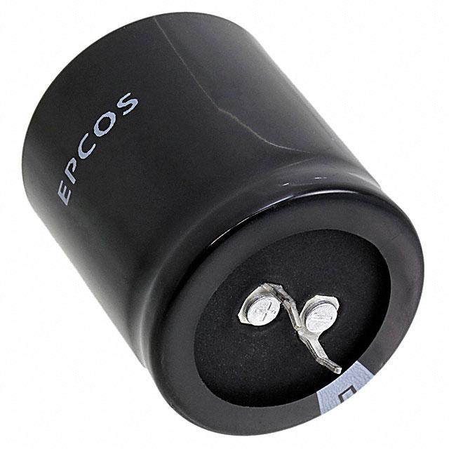

    470 µF 450 V 铝电解电容器 径向,Can - 卡入式 230 毫欧 @ 100Hz 85°C 时为 10000 小时
B43601B5477M000 数据手册
Aluminum Electrolytic Capacitors Snap-in capacitors Series/Type: B43601 Date: April 1, 2014  EPCOS AG 2015. Reproduction, publication and dissemination of this publication, enclosures hereto and the information contained therein without EPCOS' prior express consent is prohibited. EPCOS AG is a TDK Group Company. Snap-in capacitors 焊片式电容器 Long useful life and ultra compact - 85ºC B43601 长寿命体积小型 长寿命体积小型 - 85ºC Long-life grade capacitors 长寿命级电容器 Applications 应用 ■ Frequency converters ■ 变频器 ■ Uninterruptiple power supplies ■ 不间断电源 ■ Switch mode power supplies in industrial and entertainment electronics ■ 工业和消费电子产品中的开关电源 Features 特点 ■ Ultra compact ■ 体积小型 ■ High reliability ■ 可靠性高 ■ High ripple current capability ■ 耐高纹波电流能力 ■ RoHS-compatible ■ 符合RoHS要求 ■ Useful life of 10000h at 85 ºC ■ 85 ºC 10000h使用寿命 结构 ■ Charge/discharge-proof, polar ■ 耐充放电,有极性 ■ Aluminum case, fully insulated ■ 铝质外壳,整体绝缘 ■ Minus pole marking on the insulating sleeve ■ 绝缘套管上标注负极 ■ Overload protection by safety vent on the base ■ 底部安全阀过载保护 Page 2 of 9 Snap-in capacitors 焊片式电容器 Long useful life and ultra compact - 85ºC B43601 长寿命体积小型 长寿命体积小型 - 85ºC Specifications and characteristics in brief 规格性能参数一览表 Rated voltage VR 200…450 V DC 额定电压VR Surge voltage VS 1.15 ∙ VR (for VR ≤ 250V DC) 浪涌电压VS 1.10 ∙ VR (for VR ≥ 400V DC) VR ≤ 250V DC: -40 ºC…+105 ºC Operating temperature range VR ≥ 400V DC: -25 ºC…+105 ºC 工作温度范围 Rated capacitance CR 82…2700 µF 20 ºC,120 Hz 额定电容量CR Capacitance tolerance ±20% M 电容量公差 VR( V DC) 200…250 400…450 Dissipation factor(max.) 20ºC,120Hz. tanδ 0.15 0.20 损耗正切角(最大值) . Leakage current Ileak 20 ºC,after 5 minutes Ileak ≤ 0.3 ∙ ∙ +4 漏电流 Ileak μ 20 ºC,5分钟后 VR( V DC) 400...450 200…250 Low temperature stability Z (-25 ºC) 低温稳定性 7 4 120 Hz Z (+20 ºC) (max impedance ratio) Z (-40 ºC) 12 7 (最大阻抗比率) Z (+20 ºC) 10000 h Requirements 要求: Useful life 使用寿命 ≤ ±20% of initial value 初始值的±20% △C/C (85 ºC,VR,IAC,R) ≤ 2 times initial specified limit 2倍初始规定值 tanδ Ileak ≤ initial specified limit 初始规定值 After storage for 1000 h at 85 ºC, the capacitors shall meet the requirement of useful life test after reforming process. After test: VR to be applied for 30 minutes, Shelf life 24 to 48 hours before measurement. 储存寿命 85ºC高温贮存1000小时,并预处理后,电容器必须符合使用寿命测试中对其电性 能的要求。预处理方法:先加额定电压充电30分钟,恢复24至48小时后再测试。 VR( V DC) d(mm) 50Hz 120Hz 1kHz 10kHz 20kHz 22 0.75 1.00 1.52 1.68 1.69 25 0.75 1.00 1.52 1.68 1.69 200 30 0.80 1.00 1.25 1.31 1.32 35 0.85 1.00 1.14 1.17 1.17 22 0.75 1.00 1.52 1.68 1.69 25 0.75 1.00 1.52 1.68 1.69 250 Frequency multiplier for 30 0.80 1.00 1.25 1.31 1.32 rated ripple current 35 0.85 1.00 1.14 1.17 1.17 22 0.78 1.00 1.35 1.43 1.44 额定纹波电流的频率系数 25 0.78 1.00 1.35 1.43 1.44 400 30 0.80 1.00 1.25 1.31 1.32 35 0.80 1.00 1.25 1.31 1.32 22 0.78 1.00 1.35 1.43 1.44 25 0.78 1.00 1.35 1.43 1.44 450 30 0.78 1.00 1.35 1.43 1.44 35 0.80 1.00 1.25 1.31 1.32 Temperature multiplier for +40 ºC +55 ºC +70 ºC +85 ºC rated ripple current 2.2 2.1 1.7 1.0 额定纹波电流的温度系数 Sectional specification IEC 60384-4 分规范 Page 3 of 9 Snap-in capacitors 焊片式电容器 Long useful life and ultra compact - 85ºC B43601 长寿命体积小型 长寿命体积小型 - 85ºC Dimensional drawing snap-in standard terminals (6.3±1) mm snap-in short terminals (4.0±0.5) mm digit 15 of part number = 0 digit 15 of part number = 7 snap-in 3 terminals terminals (4.0±0.5) mm digit 15 of part number = 2 Page 4 of 9 Snap-in capacitors 焊片式电容器 Long useful life and ultra compact - 85ºC Technical dates and ordering codes VR CR ESRtyp Zmax Case dimensions 120Hz 120 Hz 10 kHz 20 ºC d × l 20 °C 20 °C mm µF mΩ mΩ V DC 22 x 25 200 330 270 400 22 x 30 390 240 340 22 x 35 470 190 280 25 x 25 470 190 280 22 x 35 560 160 240 25 x 30 560 160 240 22 x 40 680 130 190 25 x 35 680 130 190 30 x 25 680 130 190 22 x 50 820 110 160 25 x 40 820 110 160 30 x 30 820 110 160 25 x 45 1000 90 130 30 x 35 1000 90 130 35 x 25 1000 90 130 25 x 50 1200 80 110 30 x 40 1200 80 110 35 x 30 1200 80 110 30 x 45 1500 60 90 35 x 35 1500 60 90 30 x 50 1800 50 75 35 x 40 1800 50 75 35 x 45 2200 40 60 35 x 55 2700 30 50 22 x 25 250 270 310 460 22 x 30 330 250 370 25 x 25 330 250 370 22 x 35 390 220 320 25 x 30 390 220 320 22 x 40 470 180 260 25 x 30 470 180 260 22 x 45 560 150 220 25 x 35 560 150 220 30 x 25 560 150 220 22 x 50 680 120 180 25 x 40 680 120 180 30 x 30 680 120 180 35 x 25 680 120 180 * = Insulation feature 0 = PVC sleeve 6 = PET sleeve B43601 长寿命体积小型 长寿命体积小型 - 85ºC IAC,R IAC,R 120 Hz 120 Hz Ordering code 60 ºC 85 ºC A A 2.87 1.46 B43601A2337M0*# 3.27 1.66 B43601A2397M0*# 3.71 1.90 B43601A2477M0*# 3.53 1.80 B43601B2477M0*# 4.05 2.06 B43601A2567M0*# 4.03 2.05 B43601B2567M0*# 4.60 2.35 B43601A2687M0*# 4.59 2.34 B43601B2687M0*# 4.24 2.16 B43601C2687M0*# 5.33 2.71 B43601A2827M0*# 5.21 2.66 B43601B2827M0*# 4.86 2.47 B43601C2827M0*# 5.91 3.02 B43601A2108M0*# 5.56 2.83 B43601B2108M0*# 4.70 2.40 B43601C2108M0*# 6.63 3.38 B43601A2128M0*# 6.70 3.41 B43601B2128M0*# 5.72 2.91 B43601C2128M0*# 7.69 3.92 B43601A2158M0*# 6.61 3.38 B43601B2158M0*# 8.64 4.41 B43601A2188M0*# 7.48 3.81 B43601B2188M0*# 8.51 4.34 B43601A2228M0*# 9.89 5.04 B43601A2278M0*# 2.76 1.41 B43601E2277M0*# 3.18 1.62 B43601E2337M0*# 3.13 1.60 B43601F2337M0*# 3.58 1.82 B43601E2397M0*# 3.54 1.80 B43601F2397M0*# 4.06 2.07 B43601E2477M0*# 3.89 1.99 B43601F2477M0*# 4.55 2.32 B43601E2567M0*# 4.41 2.25 B43601F2567M0*# 4.03 2.05 B43601G2567M0*# 5.14 2.62 B43601E2687M0*# 5.01 2.55 B43601F2687M0*# 4.62 2.36 B43601G2687M0*# 4.00 2.04 B43601H2687M0*# # = Terminal style 0 = snap-in standard terminals (6.3±1) mm 2 = snap-in 3 terminals (4.0±0.5) mm 7 = snap-in short terminals (4.0±0.5) mm Page 5 of 9 Snap-in capacitors 焊片式电容器 Long useful life and ultra compact - 85ºC Technical dates and ordering codes VR CR ESRtyp Zmax Case dimensions 120Hz 120 Hz 10 kHz 20 ºC d × l 20 °C 20 °C mm µF mΩ mΩ V DC 25 x 45 250 820 100 150 30 x 35 820 100 150 35 x 30 820 100 150 25 x 55 1000 80 130 30 x 40 1000 80 130 35 x 30 1000 80 130 30 x 45 1200 70 110 35 x 35 1200 70 110 30 x 55 1500 60 85 35 x 40 1500 60 85 35 x 45 1800 50 70 35 x 55 2200 40 60 22 x 25 400 100 1030 1470 22 x 30 120 850 1220 22 x 30 150 680 980 25 x 25 150 680 980 22 x 35 180 570 820 25 x 30 180 570 820 22 x 40 220 460 670 25 x 35 220 460 670 30 x 25 220 460 670 22 x 45 270 380 550 25 x 40 270 380 550 30 x 30 270 380 550 25 x 45 330 310 450 30 x 35 330 310 450 35 x 25 330 310 450 25 x 50 390 260 380 30 x 35 390 260 380 35 x 30 390 260 380 25 x 55 470 220 320 30 x 40 470 220 320 35 x 35 470 220 320 30 x 45 560 180 270 35 x 35 560 180 270 30 x 55 680 150 220 35 x 40 680 150 220 35 x 50 820 120 180 35 x 55 1000 100 150 * = Insulation feature 0 = PVC sleeve 6 = PET sleeve B43601 长寿命体积小型 长寿命体积小型 - 85ºC IAC,R IAC,R 120 Hz 120 Hz Ordering code 60 ºC 85 ºC A A 5.65 2.88 B43601E2827M0*# 5.26 2.69 B43601F2827M0*# 4.87 2.48 B43601G2827M0*# 6.54 3.34 B43601E2108M0*# 6.40 3.25 B43601F2108M0*# 5.39 2.74 B43601G2108M0*# 7.20 3.67 B43601E2128M0*# 6.11 3.11 B43601F2128M0*# 8.45 4.31 B43601E2158M0*# 7.05 3.59 B43601F2158M0*# 7.94 4.05 B43601E2188M0*# 9.21 4.70 B43601E2228M0*# 1.73 0.89 B43601A9107M0*# 1.98 1.01 B43601A9127M0*# 2.21 1.12 B43601A9157M0*# 2.21 1.13 B43601B9157M0*# 2.51 1.28 B43601A9187M0*# 2.53 1.29 B43601B9187M0*# 2.86 1.46 B43601A9227M0*# 2.90 1.48 B43601B9227M0*# 2.77 1.41 B43601C9227M0*# 3.27 1.66 B43601A9277M0*# 3.32 1.69 B43601B9277M0*# 3.20 1.63 B43601C9277M0*# 3.77 1.93 B43601A9337M0*# 3.67 1.86 B43601B9337M0*# 3.29 1.68 B43601C9337M0*# 4.20 2.14 B43601A9397M0*# 3.99 2.03 B43601B9397M0*# 3.97 2.02 B43601C9397M0*# 4.72 2.40 B43601A9477M0*# 4.81 2.45 B43601B9477M0*# 4.51 2.30 B43601C9477M0*# 5.41 2.75 B43601A9567M0*# 4.92 2.51 B43601B9567M0*# 6.24 3.18 B43601A9687M0*# 5.60 2.85 B43601B9687M0*# 6.49 3.31 B43601A9827M0*# 7.32 3.74 B43601A9108M0*# # = Terminal style 0 = snap-in standard terminals (6.3±1) mm 2 = snap-in 3 terminals (4.0±0.5) mm 7 = snap-in short terminals (4.0±0.5) mm Page 6 of 9 Snap-in capacitors 焊片式电容器 Long useful life and ultra compact - 85ºC Technical dates and ordering codes VR CR ESRtyp Zmax Case dimensions 120Hz 120 Hz 10 kHz 20 ºC d × l 20 °C 20 °C mm µF mΩ mΩ V DC 22 x 25 450 82 1250 1860 22 x 30 100 1030 1520 22 x 30 120 850 1270 25 x 25 120 850 1270 22 x 35 150 680 1020 25 x 30 150 680 1020 22 x 40 180 570 850 25 x 35 180 570 850 30 x 25 180 570 850 22 x 50 220 460 700 25 x 40 220 460 700 30 x 30 220 460 700 35 x 25 220 460 700 25 x 45 270 380 570 30 x 35 270 380 570 35 x 30 270 380 570 25 x 50 330 310 470 30 x 40 330 310 470 35 x 30 330 310 470 30 x 45 390 260 390 35 x 35 390 260 390 30 x 50 470 220 330 35 x 40 470 220 330 30 x 55 560 180 280 35 x 45 560 180 280 35 x 50 680 150 230 * = Insulation feature 0 = PVC sleeve 6 = PET sleeve B43601 长寿命体积小型 长寿命体积小型 - 85ºC IAC,R IAC,R 120 Hz 120 Hz Ordering code 60 ºC 85 ºC A A 1.63 0.82 B43601A5826M0*# 1.87 0.95 B43601A5107M0*# 2.05 1.04 B43601A5127M0*# 2.05 1.04 B43601B5127M0*# 2.38 1.21 B43601A5157M0*# 2.39 1.22 B43601B5157M0*# 2.69 1.37 B43601A5187M0*# 2.71 1.38 B43601B5187M0*# 2.69 1.37 B43601C5187M0*# 3.12 1.59 B43601A5227M0*# 3.09 1.58 B43601B5227M0*# 3.10 1.58 B43601C5227M0*# 2.91 1.48 B43601D5227M0*# 3.52 1.79 B43601A5277M0*# 3.56 1.81 B43601B5277M0*# 3.58 1.82 B43601C5277M0*# 4.00 2.04 B43601A5337M0*# 4.33 2.20 B43601B5337M0*# 3.97 2.02 B43601C5337M0*# 4.84 2.46 B43601A5397M0*# 4.46 2.28 B43601B5397M0*# 5.45 2.78 B43601A5477M0*# 5.06 2.58 B43601B5477M0*# 6.09 3.10 B43601A5567M0*# 5.68 2.89 B43601B5567M0*# 6.41 3.27 B43601A5687M0*# # = Terminal style 0 = snap-in standard terminals (6.3±1) mm 2 = snap-in 3 terminals (4.0±0.5) mm 7 = snap-in short terminals (4.0±0.5) mm Page 7 of 9 Bar code label and marking of the capacitor 条形码标签和电容器标签 Below is an example of bar code label on package: 以下为包装箱上条形码标签示例: Brand 品牌 B43310B9688M001 (1P) Ordering code (9K) Product order number (D) Date code (yywwdd) 订购代码 订单号 日期代码(年月日) (T) Batch number (Q) Quantity 批号 数量 The two examples below shows how the capacitor sleeve are marked according to case height: 以下两个示例说明不同壳体高度电容器套管上的标签内容: Case height 壳体高度 25mm B43231-A9337-M 330µF (M) 400V25/085/56 MM.JJ EPCOS >25mm 品牌 Part number (ordering code) B43231-A9337-M 330µF (M) 400V- Rated capacitance, tolerance, rated voltage, 25/085/56 MM.JJ Climatic category, month and year of production EPCOS 20mm EP CO S Brand B43231-A9337-M 330µF (M) 400V25/085/56 MM.JJ 料号(订购代码) 额定电容、容差、额定电压 气候分类、月.年(生产日期) Brand 品牌 Part number (ordering code) 料号(订购代码) Rated capacitance, tolerance, rated voltage, Climatic category 额定电容、容差、额定电压 气候分类 Month and year of production 月.年(生产日期) Brand Part number (ordering code) Rated capacitance, tolerance, rated voltage, Climatic category 品牌 料号(订购代码) 额定电容、容差、额定电压 气候分类 Month and year of production 月.年(生产日期) The climatic category is specified according to IEC 60068–1. If there is not enough space on the case, the following codes may be used: 气候类别符合IEC 60068–1。如果壳体上没有足够空间,可使用以下代码: E.g.: 40/085/56, in coded form, would read GPF 例如:40/085/56的代码形式为GPF 1st letter (lower category temperature) 首字母(下限类别温度) Code letter 字母代码 F G H Temperature 温度(°C) -55 -40 -25 2nd letter (upper category temperature) 第二字母(上限类别温度) Code letter 代码字母 K M P S U Temperature 温度(°C) +125 +105(+100) +85 +70 +60 3rd letter (humidity) 第三字母(湿度) Letter F: withstands IEC60068-2-78 Cab (damp heat, steady state), test duration 56 days. 字母F:经受IEC 60068-2-78试验箱(湿热、恒稳态),试验周期56天。 Page 8 of 9 Important notes The following applies to all products named in this publication: 1. Some parts of this publication contain statements about the suitability of our products for certain areas of application. These statements are based on our knowledge of typical requirements that are often placed on our products in the areas of application concerned. We nevertheless expressly point out that such statements cannot be regarded as binding statements about the suitability of our products for a particular customer application. As a rule, EPCOS is either unfamiliar with individual customer applications or less familiar with them than the customers themselves. For these reasons, it is always ultimately incumbent on the customer to check and decide whether an EPCOS product with the properties described in the product specification is suitable for use in a particular customer application. 2. We also point out that in individual cases, a malfunction of electronic components or failure before the end of their usual service life cannot be completely ruled out in the current state of the art, even if they are operated as specified. In customer applications requiring a very high level of operational safety and especially in customer applications in which the malfunction or failure of an electronic component could endanger human life or health (e.g. in accident prevention or lifesaving systems), it must therefore be ensured by means of suitable design of the customer application or other action taken by the customer (e.g. installation of protective circuitry or redundancy) that no injury or damage is sustained by third parties in the event of malfunction or failure of an electronic component. 3. The warnings, cautions and product-specific notes must be observed. 4. In order to satisfy certain technical requirements, some of the products described in this publication may contain substances subject to restrictions in certain jurisdictions (e.g. because they are classed as hazardous). Useful information on this will be found in our Material Data Sheets on the Internet (www.epcos.com/material). Should you have any more detailed questions, please contact our sales offices. 5. We constantly strive to improve our products. Consequently, the products described in this publication may change from time to time. The same is true of the corresponding product specifications. Please check therefore to what extent product descriptions and specifications contained in this publication are still applicable before or when you place an order. We also reserve the right to discontinue production and delivery of products. Consequently, we cannot guarantee that all products named in this publication will always be available. The aforementioned does not apply in the case of individual agreements deviating from the foregoing for customer-specific products. 6. Unless otherwise agreed in individual contracts, all orders are subject to the current version of the “ General Terms of Delivery for Products and Services in the Electrical Industry” published by the German Electrical and Electronics Industry Association (ZVEI). 7. The trade names EPCOS, Alu-X, CeraDiode, CeraLink, CeraPlas, CSMP, CSSP, CTVS, DeltaCap, DigiSiMic, DSSP, FilterCap, FormFit, LeaXield, MiniBlue, MiniCell, MKD, MKK, MLSC, MotorCap, PCC, PhaseCap, PhaseCube, PhaseMod, PhiCap, PQSine, SIFERRIT, SIFI, SIKOREL, SilverCap, SIMDAD, SiMic, SIMID, SineFormer, SIOV, SIP5D, SIP5K, TFAP, ThermoFuse, WindCap are trademarks registered or pending in Europe and in other countries. Further information will be found on the Internet at www.epcos.com/trademarks. Page 9 of 9
