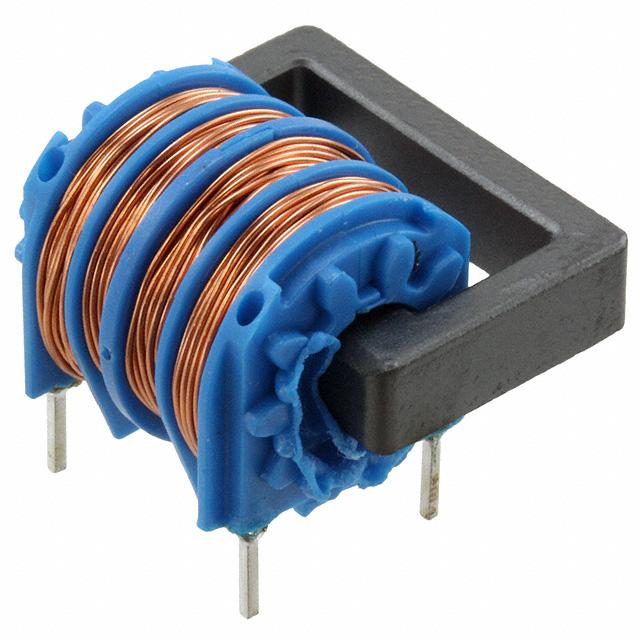

Power line chokes Current-compensated D core double chokes 250 V AC, 3.3 … 100 mH, 0.35 … 1.8 A, +40 °C Series/Type: B82731M/H Date: December 2016 a~í~=pÜÉÉí ¤EPCOS AG 2016. Reproduction, publication and dissemination of this publication, enclosures hereto and the information contained therein without EPCOS’ prior express consent is prohibited. EPCOS AG is a TDK Group Company. Power line chokes B82731M/H Current-compensated D core double chokes Rated voltage 250 V AC Rated inductance 3.3 ... 100 mH Rated current 0.35 ... 1.8 A / +40 °C Construction ■ Current-compensated double choke ■ Closed rectangular ferrite core ■ Closed plastic coil former (UL 94 V-0)1) ■ Without encapsulation ■ 2-section winding ■ Clearance and creepage distances t 3 mm B82731M Features ■ High resonance frequency due to 2-section winding ■ Approx. 1% stray inductance for symmetrical interference suppression ■ Low leakage due to closed core shape ■ High pulse strength ■ Low whirring noise ■ Suitable for wave soldering ■ Design complies with EN 60938-2 (VDE 0565-2) and UL 1283 ■ UL2) and ENEC (VDE) approvals ■ Recyclable owing to omission of encapsulation and glue ■ RoHS-compatible B82731H Applications ■ Suppression of common-mode interferences ■ Compact switch-mode power applications ■ Electronic ballasts in lamps Terminals ■ Base material CuNi18Zn20 ■ Layer composition Ni, Sn ■ Hot-dipped ■ Pins 0.6 u 0.6 (mm) ■ Lead spacing 10 u 12.5 (mm) Marking ■ B82731M: Manufacturer, rated inductance, rated current, ordering code, approval symbols, date of manufacture (WWYY) ■ B82731H: Manufacturer, ordering code Delivery mode Blister tray in cardboard box 1) Additionally certified values: Glow wire flammability index (GWFI to IEC 60695-2-12): Glow wire ignition temperature (GWIT to IEC 60695-2-13): Glow wire test (GWT to IEC 60695-2-11): Comparative tracking index (CTI to IEC 60112): Ball pressure test (BP to IEC 60695-10-2): 2) UL approval with 300 V AC. Please read Cautions and warnings and Important notes at the end of this document. 2 +850 °C +775 °C +750 °C, 2 s / 850 °C, 30 s 175 V +125 °C 12/16 Power line chokes B82731M/H Current-compensated D core double chokes Dimensional drawings and pin configurations Vertical version (B82731M) Horizontal version (B82731H) Please read Cautions and warnings and Important notes at the end of this document. 3 12/16 Power line chokes B82731M/H Current-compensated D core double chokes Technical data and measuring conditions Rated voltage VR 250 V AC (50/60 Hz) Test voltage Vtest 1500 V AC, 2 s (line/line) Rated temperature TR +40 qC Rated current IR Referred to 50 Hz and rated temperature Rated inductance LR Measured with Agilent 4284A at 10 kHz, 0.1 mA, +20 °C. Inductance is specified per winding. Inductance tolerance –30/+50% at +20 °C Inductance decrease'L/L0 < 10% at DC magnetic bias with IR, +20 °C Stray inductance Lstray,typ Measured with Agilent 4284A at 10 kHz, 5 mA, +20 qC, typ. values DC resistance Rtyp Measured at +20 °C, typical values, specified per winding Solderability (lead-free) Sn96.5Ag3.0Cu0.5: +(245 r3) °C, (3 r0.3) s Wetting of soldering area t95% (to IEC 60068-2-20, test Ta) Resistance to soldering heat (wave soldering) +(260 r5) °C, (10 r1) s (to IEC 60068-2-20, test Tb) Climatic category 40/125/56 (to IEC 60068-1) Storage conditions (packaged) –25 °C … +40 °C, d75% RH Weight Approx. 8 g Approvals IEC EN 60938-2, UL 1283 (E70122) Characteristics and ordering codes Approvals IR LR Lstray,typ Rtyp A mH PH m: Ordering code Vertical version 0.35 100 1000 4500 B82731M2351A030 B82731H2351A030 u u 0.4 68 700 3000 B82731M2401A033 B82731H2401A033 u u 0.5 47 470 2000 B82731M2501A030 B82731H2501A030 u u 0.6 39 390 1500 B82731M2601A030 B82731H2601A030 u u 0.7 27 270 1000 B82731M2701A030 B82731H2701A030 u u 0.8 22 220 800 B82731M2801A030 B82731H2801A030 u u 0.9 15 150 600 B82731M2901A030 B82731H2901A030 u u 1.1 10 100 400 B82731M2112A030 B82731H2112A030 u u Horizontal version 1.3 6.8 70 280 B82731M2132A030 B82731H2132A030 u u 1.8 3.3 35 140 B82731M2182A030 B82731H2182A030 u u u = approval granted Sample kit available. Ordering code: B82731X001 For more information refer to chapter “Sample kits”. Please read Cautions and warnings and Important notes at the end of this document. 4 12/16 Power line chokes B82731M/H Current-compensated D core double chokes Current derating Iop/IR versus ambient temperature TA Impedance |Z| versus frequency f measured with windings in parallel at +20 °C, typical values Please read Cautions and warnings and Important notes at the end of this document. 5 12/16 Cautions and warnings ■ Please note the recommendations in our Inductors data book (latest edition) and in the data sheets. – Particular attention should be paid to the derating curves given there. – The soldering conditions should also be observed. Temperatures quoted in relation to wave soldering refer to the pin, not the housing. ■ If the components are to be washed varnished it is necessary to check whether the washing varnish agent that is used has a negative effect on the wire insulation, any plastics that are used, or on glued joints. In particular, it is possible for washing varnish agent residues to have a negative effect in the long-term on wire insulation. Washing processes may damage the product due to the possible static or cyclic mechanical loads (e.g. ultrasonic cleaning). They may cause cracks to develop on the product and its parts, which might lead to reduced reliability or lifetime. ■ The following points must be observed if the components are potted in customer applications: – Many potting materials shrink as they harden. They therefore exert a pressure on the plastic housing or core. This pressure can have a deleterious effect on electrical properties, and in extreme cases can damage the core or plastic housing mechanically. – It is necessary to check whether the potting material used attacks or destroys the wire insulation, plastics or glue. – The effect of the potting material can change the high-frequency behaviour of the components. ■ Ferrites are sensitive to direct impact. This can cause the core material to flake, or lead to breakage of the core. ■ Even for customer-specific products, conclusive validation of the component in the circuit can only be carried out by the customer. Display of ordering codes for EPCOS products The ordering code for one and the same product can be represented differently in data sheets, data books, other publications and the website of EPCOS, or in order-related documents such as shipping notes, order confirmations and product labels. The varying representations of the ordering codes are due to different processes employed and do not affect the specifications of the respective products. Detailed information can be found on the Internet under www.epcos.com/orderingcodes. Please read Cautions and warnings and Important notes at the end of this document. 6 12/16 Important notes The following applies to all products named in this publication: 1. Some parts of this publication contain statements about the suitability of our products for certain areas of application. These statements are based on our knowledge of typical requirements that are often placed on our products in the areas of application concerned. We nevertheless expressly point out that such statements cannot be regarded as binding statements about the suitability of our products for a particular customer application. As a rule we are either unfamiliar with individual customer applications or less familiar with them than the customers themselves. For these reasons, it is always ultimately incumbent on the customer to check and decide whether a product with the properties described in the product specification is suitable for use in a particular customer application. 2. We also point out that in individual cases, a malfunction of electronic components or failure before the end of their usual service life cannot be completely ruled out in the current state of the art, even if they are operated as specified. In customer applications requiring a very high level of operational safety and especially in customer applications in which the malfunction or failure of an electronic component could endanger human life or health (e.g. in accident prevention or life-saving systems), it must therefore be ensured by means of suitable design of the customer application or other action taken by the customer (e.g. installation of protective circuitry or redundancy) that no injury or damage is sustained by third parties in the event of malfunction or failure of an electronic component. 3. The warnings, cautions and product-specific notes must be observed. 4. In order to satisfy certain technical requirements, some of the products described in this publication may contain substances subject to restrictions in certain jurisdictions (e.g. because they are classed as hazardous). Useful information on this will be found in our Material Data Sheets on the Internet (www.tdk-electronics.tdk.com/material). Should you have any more detailed questions, please contact our sales offices. 5. We constantly strive to improve our products. Consequently, the products described in this publication may change from time to time. The same is true of the corresponding product specifications. Please check therefore to what extent product descriptions and specifications contained in this publication are still applicable before or when you place an order. We also reserve the right to discontinue production and delivery of products. Consequently, we cannot guarantee that all products named in this publication will always be available. The aforementioned does not apply in the case of individual agreements deviating from the foregoing for customer-specific products. 6. Unless otherwise agreed in individual contracts, all orders are subject to our General Terms and Conditions of Supply. 7. Our manufacturing sites serving the automotive business apply the IATF 16949 standard. The IATF certifications confirm our compliance with requirements regarding the quality management system in the automotive industry. Referring to customer requirements and customer specific requirements (“CSR”) TDK always has and will continue to have the policy of respecting individual agreements. Even if IATF 16949 may appear to support the acceptance of unilateral requirements, we hereby like to emphasize that only requirements mutually agreed upon can and will be implemented in our Quality Management System. For clarification purposes we like to point out that obligations from IATF 16949 shall only become legally binding if individually agreed upon. 8. The trade names EPCOS, CeraCharge, CeraDiode, CeraLink, CeraPad, CeraPlas, CSMP, CTVS, DeltaCap, DigiSiMic, ExoCore, FilterCap, FormFit, LeaXield, MiniBlue, MiniCell, MKD, MKK, MotorCap, PCC, PhaseCap, PhaseCube, PhaseMod, PhiCap, PowerHap, PQSine, PQvar, SIFERRIT, SIFI, SIKOREL, SilverCap, SIMDAD, SiMic, SIMID, SineFormer, SIOV, ThermoFuse, WindCap are trademarks registered or pending in Europe and in other countries. Further information will be found on the Internet at www.tdkelectronics.tdk.com/trademarks. Release 2018-10 7 12/16
B82731H2501A030
物料型号:B82731M/H
器件简介:这些电感器是电流补偿型D型双线圈电感器,设计用于交流线路,额定电压为250V AC,额定电流从0.35A至1.8A,工作温度为+40°C。
引脚分配:文档提供了垂直版(B82731M)和水平版(B82731H)的尺寸图和引脚配置。
参数特性: - 额定电压:250V AC (50/60Hz) - 额定电流:与50Hz和额定温度相关 - 额定电感:在10kHz,0.1mA,+20°C下使用Agilent 4284A测量,每个线圈的电感值指定 - 电感公差:+20°C时为-30/+50% - 直流电阻:在+20°C下测量,每个线圈指定的典型值
功能详解:电感器具有高谐振频率,由于双线圈设计,具有约1%的漏感,适合对称干扰抑制。它们还具有低漏磁、高脉冲强度和低噪音,适合波峰焊接,符合EN 60938-2和UL 1283标准。
应用信息:适用于抑制共模干扰,紧凑的开关电源应用,以及灯具中的电子镇流器。
封装信息:电感器采用封闭的矩形铁氧体芯和封闭塑料线圈骨架,没有封装,以提高回收性。端子材料为CuNi18Zn20,表面处理为Ni和Sn热浸镀。
