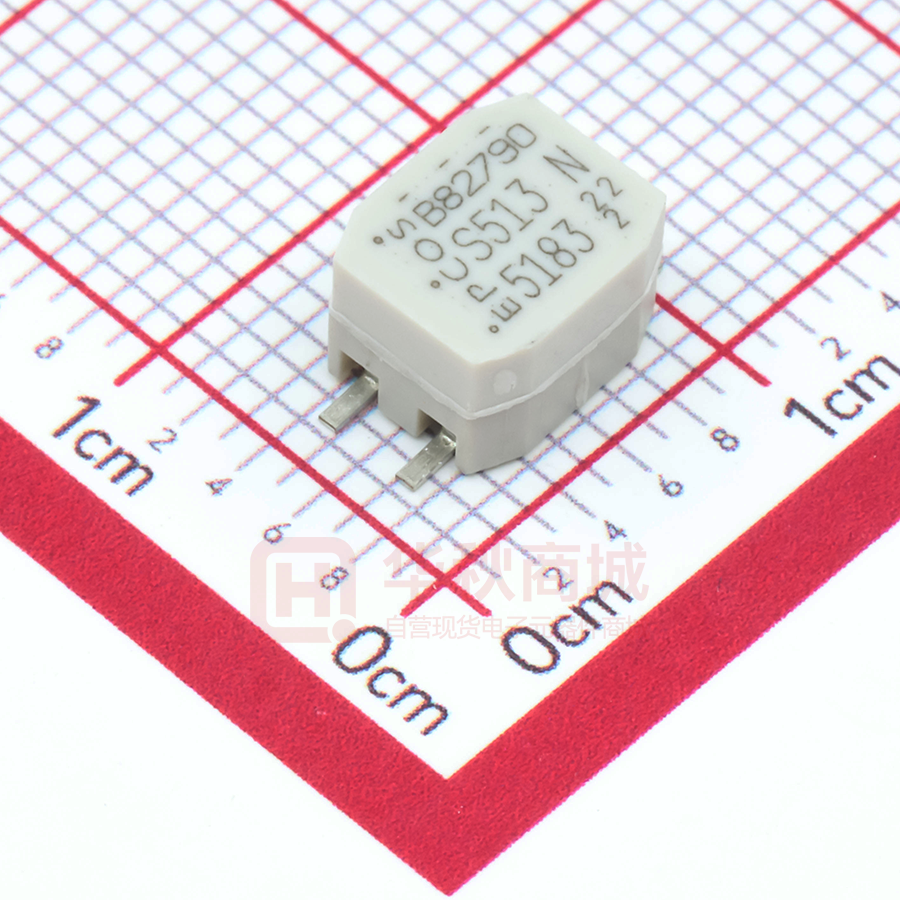

Data and signal line chokes Common-mode chokes, ring core 0.005 … 4.7 mH, 200 … 1000 mA, +60 °C Series/Type: B82790C0/S0 Date: August 2019 a~í~=pÜÉÉí ¤TDK Electronics AG 2019. Reproduction, publication and dissemination of this publication, enclosures hereto and the information contained therein without TDK Electronics’ prior express consent is prohibited. Data and signal line chokes B82790C0/S0 Common-mode chokes, ring core Rated voltage 42 V AC/80 V DC Rated inductance 0.005 ... 4.7 mH Rated current 200 ... 1000 mA Construction ■ ■ ■ ■ ■ Current-compensated ring core double choke Ferrite core PPS case (UL 94 V-0) Bifilar winding (B82790C0) Sector winding (B82790S0) Features ■ Suitable for reflow soldering ■ Qualified to AEC-Q200 ■ RoHS-compatible Function ■ B82790C0: Suppression of asymmetrical interference coupled in on lines, whereas data signals up to some MHz can pass unaffectedly. ■ B82790S0: Suppression of asymmetrical and symmetrical interference (by Lstray) coupled in on lines. The high-frequency portions of the symmetrical data signal are decreased so far that EMC problems can be significantly reduced. Applications ■ Automotive applications, e.g. CAN bus ■ Industrial applications Terminals ■ Base material CuSn6 ■ Layer composition Ni, Sn ■ Electro-plated Marking ■ Marking on component: Manufacturer, process location (coded), winding method (coded), ordering code (short form), date of manufacture (YMMD) ■ Minimum data on reel: Manufacturer, ordering code, L value and tolerance, quantity, date of packing Delivery mode and packing unit ■ 16-mm blister tape, wound on 330-mm‡reel ■ Packing unit: 1500 pcs./reel Please read Cautions and warnings and Important notes at the end of this document. 2 08/19 Data and signal line chokes B82790C0/S0 Common-mode chokes, ring core Dimensional drawing and pin configuration Layout recommendation No polarity Dimensions in mm Taping and packing Blister tape Reel Dimensions in mm Please read Cautions and warnings and Important notes at the end of this document. 3 08/19 Data and signal line chokes B82790C0/S0 Common-mode chokes, ring core Technical data and measuring conditions Rated voltage VR 42 V AC (50/60 Hz) / 80 V DC Rated temperature TR +60 °C Rated current IR Referred to 50 Hz and rated temperature Rated inductance LR Measured with Agilent 4284A at 0.1 mA, +20 °C Measuring frequency: LR d 1 mH = 100 kHz LR ! 1 mH = 10 kHz Inductance is specified per winding. Inductance tolerance r30% (LR d 0.47 mH), –30/+50% (LR t 1 mH) at +20 °C Inductance decrease 'L/L0 < 10% at DC magnetic bias with IR, +20 qC Stray inductance Lstray,typ Measured with Agilent 4284A at 5 mA, +20 °C, typ. values Measuring frequency: LR d 11 PH = 1 MHz LR > 11 PH = 100 kHz DC resistance Rtyp Measured at +20 qC, typical values, specified per winding Solderability SnPb: +(215 r3) °C, (3 r0.3) s Sn96.5Ag3.0Cu0.5: +(245 r5) °C, (3 r0.3) s Wetting of soldering area t95% (to IEC 60068-2-58) Resistance to soldering heat +(260 r5) °C, (10 r1) s (to IEC 60068-2-58) Climatic category 40/125/56 (to IEC 60068-1) Storage conditions (packaged) –25 °C … +40 °C, d75% RH Weight Approx. 0.3 g Please read Cautions and warnings and Important notes at the end of this document. 4 08/19 Data and signal line chokes B82790C0/S0 Common-mode chokes, ring core Characteristics and ordering codes LR Lstray,typ IR Rtyp Vtest mH nH mA m: V DC, 2 s Ordering code 0.005 40 1000 60 250 B82790C0502N201 0.011 50 500 80 250 B82790C0113N201 0.025 60 500 110 250 B82790C0253N201 0.025 1400 500 110 250 B82790S0253N201 0.051 70 500 140 250 B82790C0513N201 0.051 2100 500 140 250 B82790S0513N201 0.470 100 500 170 250 B82790C0474N215 1.0 100 500 170 250 B82790C0105N240 2.2 200 400 400 250 B82790C0225N265 4.7 300 200 510 250 B82790C0475N265 Types with LR t 0.47 mH: 750 V DC possible for soldering process with Pb containing solder material. For lead-free soldering please use series B82793. Please read Cautions and warnings and Important notes at the end of this document. 5 08/19 Data and signal line chokes B82790C0/S0 Common-mode chokes, ring core Insertion loss D (typical values at |Z| = 50 :, +20 °C) asymmetrical, all branches in parallel (common mode) symmetrical (differential mode) LR = 0.005 mH LR = 0.011 mH LR = 0.025 mH (low Lstray) LR = 0.025 mH (high Lstray) Please read Cautions and warnings and Important notes at the end of this document. 6 08/19 Data and signal line chokes B82790C0/S0 Common-mode chokes, ring core Insertion loss D (typical values at |Z| = 50 :, +20 °C) asymmetrical, all branches in parallel (common mode) symmetrical (differential mode) LR = 0.051 mH (low Lstray) LR = 0.051 mH (high Lstray) LR = 0.47 mH LR = 1.0 mH Please read Cautions and warnings and Important notes at the end of this document. 7 08/19 Data and signal line chokes B82790C0/S0 Common-mode chokes, ring core Insertion loss D (typical values at |Z| = 50 :, +20 °C) asymmetrical, all branches in parallel (common mode) symmetrical (differential mode) LR = 2.2 mH LR = 4.7 mH Current derating Iop/IR versus ambient temperature Please read Cautions and warnings and Important notes at the end of this document. 8 08/19 Data and signal line chokes B82790C0/S0 Common-mode chokes, ring core Recommended reflow soldering curve Pb containing solder material (based on CECC 00802 edition 2) Pb-free solder material (based on JEDEC J-STD 020D) T1 °C T2 °C T3 °C T4 °C t1 s t2 s t3 s 150 200 217 250 < 110 < 90 < 30 @ T4 –5 °C Time from +25 °C to T4: max 300 s Maximal numbers of reflow cycles: 3 Please read Cautions and warnings and Important notes at the end of this document. 9 08/19 Cautions and warnings ■ Please note the recommendations in our Inductors data book (latest edition) and in the data sheets. – Particular attention should be paid to the derating curves given there. – The soldering conditions should also be observed. Temperatures quoted in relation to wave soldering refer to the pin, not the housing. ■ If the components are to be washed varnished it is necessary to check whether the washing varnish agent that is used has a negative effect on the wire insulation, any plastics that are used, or on glued joints. In particular, it is possible for washing varnish agent residues to have a negative effect in the long-term on wire insulation. Washing processes may damage the product due to the possible static or cyclic mechanical loads (e.g. ultrasonic cleaning). They may cause cracks to develop on the product and its parts, which might lead to reduced reliability or lifetime. ■ The following points must be observed if the components are potted in customer applications: – Many potting materials shrink as they harden. They therefore exert a pressure on the plastic housing or core. This pressure can have a deleterious effect on electrical properties, and in extreme cases can damage the core or plastic housing mechanically. – It is necessary to check whether the potting material used attacks or destroys the wire, wire insulation, plastics or glue. – The effect of the potting material can change the high-frequency behaviour of the components. – Many coating materials have a negative effect (chemically and mechanically) on the winding wires, insulation materials and connecting points. Customers are always obligated to determine whether and to what extent their coating materials influence the component. Customers are responsible and bear all risk for the use of the coating material. TDK Electronics does not assume any liability for failures of our components that are caused by the coating material. ■ Ceramics / Ferrites are sensitive to direct impact. This can cause the core material to flake, or lead to breakage of the core. ■ Even for customer-specific products, conclusive validation of the component in the circuit can only be carried out by the customer. Display of ordering codes for TDK Electronics products The ordering code for one and the same product can be represented differently in data sheets, data books, other publications, on the company website, or in order-related documents such as shipping notes, order confirmations and product labels. The varying representations of the ordering codes are due to different processes employed and do not affect the specifications of the respective products. Detailed information can be found on the Internet under www.tdk-electronics.tdk.com/orderingcodes. Please read Cautions and warnings and Important notes at the end of this document. 10 08/19 Important notes The following applies to all products named in this publication: 1. Some parts of this publication contain statements about the suitability of our products for certain areas of application. These statements are based on our knowledge of typical requirements that are often placed on our products in the areas of application concerned. We nevertheless expressly point out that such statements cannot be regarded as binding statements about the suitability of our products for a particular customer application. As a rule, we are either unfamiliar with individual customer applications or less familiar with them than the customers themselves. For these reasons, it is always ultimately incumbent on the customer to check and decide whether a product with the properties described in the product specification is suitable for use in a particular customer application. 2. We also point out that in individual cases, a malfunction of electronic components or failure before the end of their usual service life cannot be completely ruled out in the current state of the art, even if they are operated as specified. In customer applications requiring a very high level of operational safety and especially in customer applications in which the malfunction or failure of an electronic component could endanger human life or health (e.g. in accident prevention or life-saving systems), it must therefore be ensured by means of suitable design of the customer application or other action taken by the customer (e.g. installation of protective circuitry or redundancy) that no injury or damage is sustained by third parties in the event of malfunction or failure of an electronic component. 3. The warnings, cautions and product-specific notes must be observed. 4. In order to satisfy certain technical requirements, some of the products described in this publication may contain substances subject to restrictions in certain jurisdictions (e.g. because they are classed as hazardous). Useful information on this will be found in our Material Data Sheets on the Internet (www.tdk-electronics.tdk.com/material). Should you have any more detailed questions, please contact our sales offices. 5. We constantly strive to improve our products. Consequently, the products described in this publication may change from time to time. The same is true of the corresponding product specifications. Please check therefore to what extent product descriptions and specifications contained in this publication are still applicable before or when you place an order. We also reserve the right to discontinue production and delivery of products. Consequently, we cannot guarantee that all products named in this publication will always be available. The aforementioned does not apply in the case of individual agreements deviating from the foregoing for customer-specific products. 6. Unless otherwise agreed in individual contracts, all orders are subject to our General Terms and Conditions of Supply. 11 08/19 Important notes 7. Our manufacturing sites serving the automotive business apply the IATF 16949 standard. The IATF certifications confirm our compliance with requirements regarding the quality management system in the automotive industry. Referring to customer requirements and customer specific requirements (“CSR”) TDK always has and will continue to have the policy of respecting individual agreements. Even if IATF 16949 may appear to support the acceptance of unilateral requirements, we hereby like to emphasize that only requirements mutually agreed upon can and will be implemented in our Quality Management System. For clarification purposes we like to point out that obligations from IATF 16949 shall only become legally binding if individually agreed upon. 8. The trade names EPCOS, CeraCharge, CeraDiode, CeraLink, CeraPad, CeraPlas, CSMP, CTVS, DeltaCap, DigiSiMic, ExoCore, FilterCap, FormFit, LeaXield, MiniBlue, MiniCell, MKD, MKK, MotorCap, PCC, PhaseCap, PhaseCube, PhaseMod, PhiCap, PowerHap, PQSine, PQvar, SIFERRIT, SIFI, SIKOREL, SilverCap, SIMDAD, SiMic, SIMID, SineFormer, SIOV, ThermoFuse, WindCap are trademarks registered or pending in Europe and in other countries. Further information will be found on the Internet at www.tdk-electronics.tdk.com/trademarks. Release 2018-10 12 08/19
