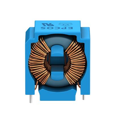

Power line chokes Current-compensated ring core double chokes 250 V AC, 0.25 … 0.9 A, 4.7 … 47 mH Series/Type: B82791G/H Date: July 2012 a~í~=pÜÉÉí © EPCOS AG 2015. Reproduction, publication and dissemination of this publication, enclosures hereto and the information contained therein without EPCOS' prior express consent is prohibited. EPCOS AG is a TDK Group Company. Power line chokes B82791G/H Current-compensated ring core double chokes Rated voltage 250 V AC Rated current 0.25 A to 0.9 A Rated inductance 4.7 mH to 47 mH Construction ■ ■ ■ ■ Current-compensated ring core double choke Ferrite core with epoxy coating (UL 94 V-0) Polycarbonate case (UL 94 V-0) Sector winding B82791G Features ■ Without potting ■ High resonance frequency due to special winding technique and omission of potting ■ Approx. 1.5% stray inductance ■ ■ ■ ■ for symmetrical interference suppression Suitable for wave soldering Design complies with EN 60938-2 (VDE 0565-2) and UL 1283 UL1) and ENEC (VDE) approvals RoHS-compatible Applications ■ Suppression of common-mode interferences ■ Electronic ballasts in lamps ■ Switch-mode power supplies Terminals ■ ■ ■ ■ ■ Base material CuNi18Zn20 Layer composition Ni, Sn Hot-dipped Pins  0.6 mm Lead spacing 10  15 (mm) or 12.7  5.08/2.54 (mm) Marking Manufacturer, approval signs, ordering code, graphic symbol, rated current, rated voltage, rated inductance, date of manufacture (YYWWD) Delivery mode Cardboard box 1) UL approval with 300 V AC. Please read Cautions and warnings and Important notes at the end of this document. 2 07/12 B82791H Power line chokes B82791G/H Current-compensated ring core double chokes Dimensional drawings and pin configurations Horizontal version (B82791G) 2.1 max. 4 ø0.6 17.5 max. 10±0.1 3 2 1 2.8+0.5 15±0.1 8 max. 17.5 max. 3 Tolerances to ISO 2768-M unless otherwise noted. Dimensions in mm. 4 2 1 IND0247-U Vertical version (B82791H) Tolerances to ISO 2768-M unless otherwise noted. Dimensions in mm. 1) Vertical version with symmetrical lead spacing (5.08 mm  12.7 mm) is available on request (B82791K). Please read Cautions and warnings and Important notes at the end of this document. 3 07/12 Power line chokes B82791G/H Current-compensated ring core double chokes Technical data and measuring conditions Rated voltage VR 250 V AC (50/60 Hz) Test voltage Vtest 1500 V AC, 2 s (line/line) Rated temperature TR +40 °C or +60 °C Rated current IR Referred to 50 Hz and rated temperature Rated inductance LR Measured with Agilent 4284A at 10 kHz, 0.1 mA, +20 °C Inductance is specified per winding. Inductance tolerance –30/50% at +20 °C Inductance decreaseL/L0 < 10% at DC magnetic bias with IR, +20 °C Stray inductance Lstray,typ Measured with Agilent 4284A at 10 kHz, 5 mA, +20 °C, typical values DC resistance Rtyp Measured at +20 °C, typ. values, specified per winding Solderability (lead-free) Sn96.5Ag3.0Cu0.5: +(245 5) °C, (3 0.3) s Wetting of soldering area 95% (to IEC 60068-2-20, test Ta) Resistance to soldering heat (wave soldering) +(260 5) °C, (10 1) s (to IEC 60068-2-20, test Tb) Climatic category 40/125/56 (to IEC 60068-1) Storage conditions (packaged) –25 °C … +40 °C, 75% RH Weight Approx. 3 g Approvals EN 60938-2, UL 1283 Characteristics and ordering codes IR LR Lstray,typ Rtyp TR Approvals Ordering code A mH H m °C Horizontal version 0.25 47 600 2400 +40 B82791G2251N020 B82791H2251N020   0.3 30 500 2200 +40 B82791G2301N001 B82791H2301N001   0.35 22 400 1900 +40 B82791G2351N001 B82791H2351N001   0.4 15 250 1350 +40 B82791G2401N001 B82791H2401N001   0.5 10 170 1000 +40 B82791G2501N001 B82791H2501N001   Vertical version 0.6 6.8 120 630 +40 B82791G2601N001 B82791H2601N001   0.7 4.7 75 440 +40 B82791G2701N001 B82791H2701N001   0.9 4.7 55 250 +60 B82791G2901N020 B82791H2901N020    = approval granted Please read Cautions and warnings and Important notes at the end of this document. 4 07/12 Power line chokes B82791G/H Current-compensated ring core double chokes Impedance |Z| versus frequency f measured with windings in parallel at +20 °C, typical values IND0624-K 10 6 Ω Impedance |Z| versus frequency f measured with windings in parallel at +20 °C, typical values B82791 | Z| 10 5 10 4 G/H2251N020 G/H2301N001 G/H2351N001 10 3 10 2 4 10 10 5 10 6 Hz 10 7 f Current derating Iop/IR versus temperature TA 5 07/12 Cautions and warnings Current-compensated ring core double chokes ■ Please note the recommendations in our Inductors data book (latest edition) and in the data sheets. – Particular attention should be paid to the derating curves given there. Derating must be applied in case the ambient temperature in the application exceeds the rated temperature of the component. – Ensure the operation temperature (which is the sum of the ambient temperature and the temperature rise caused by losses / self-heating) of the component in the application does not exceed the maximum value specified in the climatic category. – The soldering conditions should also be observed. Temperatures quoted in relation to wave soldering refer to the pin, not the housing. ■ If the components are to be washed varnished it is necessary to check whether the washing varnish agent that is used has a negative effect on the wire insulation, any plastics that are used, or on glued joints. In particular, it is possible for washing varnish agent residues to have a negative effect in the long-term on wire insulation. Washing processes may damage the product due to the possible static or cyclic mechanical loads (e.g. ultrasonic cleaning). They may cause cracks to develop on the product and its parts, which might lead to reduced reliability or lifetime. ■ The following points must be observed if the components are potted in customer applications: – Many potting materials shrink as they harden. They therefore exert a pressure on the plastic housing or core. This pressure can have a deleterious effect on electrical properties, and in extreme cases can damage the core or plastic housing mechanically. – It is necessary to check whether the potting material used attacks or destroys the wire insulation, plastics or glue. – The effect of the potting material can change the high-frequency behaviour of the components. ■ Ferrites are sensitive to direct impact. This can cause the core material to flake, or lead to breakage of the core. ■ Even for customer-specific products, conclusive validation of the component in the circuit can only be carried out by the customer. Please read Cautions and warnings and Important notes at the end of this document. 6 07/12 Important notes Current-compensated ring core double chokes The following applies to all products named in this publication: 1. Some parts of this publication contain statements about the suitability of our products for certain areas of application. These statements are based on our knowledge of typical requirements that are often placed on our products in the areas of application concerned. We nevertheless expressly point out that such statements cannot be regarded as binding statements about the suitability of our products for a particular customer application. As a rule, EPCOS is either unfamiliar with individual customer applications or less familiar with them than the customers themselves. For these reasons, it is always ultimately incumbent on the customer to check and decide whether an EPCOS product with the properties described in the product specification is suitable for use in a particular customer application. 2. We also point out that in individual cases, a malfunction of electronic components or failure before the end of their usual service life cannot be completely ruled out in the current state of the art, even if they are operated as specified. In customer applications requiring a very high level of operational safety and especially in customer applications in which the malfunction or failure of an electronic component could endanger human life or health (e.g. in accident prevention or life-saving systems), it must therefore be ensured by means of suitable design of the customer application or other action taken by the customer (e.g. installation of protective circuitry or redundancy) that no injury or damage is sustained by third parties in the event of malfunction or failure of an electronic component. 3. The warnings, cautions and product-specific notes must be observed. 4. In order to satisfy certain technical requirements, some of the products described in this publication may contain substances subject to restrictions in certain jurisdictions (e.g. because they are classed as hazardous). Useful information on this will be found in our Material Data Sheets on the Internet (www.epcos.com/material). Should you have any more detailed questions, please contact our sales offices. 5. We constantly strive to improve our products. Consequently, the products described in this publication may change from time to time. The same is true of the corresponding product specifications. Please check therefore to what extent product descriptions and specifications contained in this publication are still applicable before or when you place an order. We also reserve the right to discontinue production and delivery of products. Consequently, we cannot guarantee that all products named in this publication will always be available. The aforementioned does not apply in the case of individual agreements deviating from the foregoing for customer-specific products. 6. Unless otherwise agreed in individual contracts, all orders are subject to the current version of the “General Terms of Delivery for Products and Services in the Electrical Industry” published by the German Electrical and Electronics Industry Association (ZVEI). 7. The trade names EPCOS, BAOKE, Alu-X, CeraDiode, CeraLink, CSMP, CSSP, CTVS, DeltaCap, DigiSiMic, DSSP, FilterCap, FormFit, MiniBlue, MiniCell, MKD, MKK, MLSC, MotorCap, PCC, PhaseCap, PhaseCube, PhaseMod, PhiCap, SIFERRIT, SIFI, SIKOREL, SilverCap, SIMDAD, SiMic, SIMID, SineFormer, SIOV, SIP5D, SIP5K, ThermoFuse, WindCap are trademarks registered or pending in Europe and in other countries. Further information will be found on the Internet at www.epcos.com/trademarks. 7 07/12
