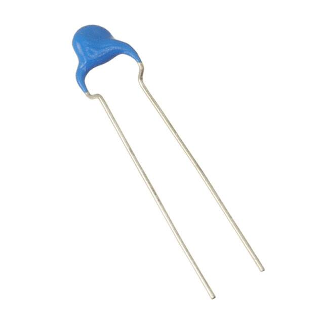

C A P A C I T O R S Disc type capacitors with leads High voltage ceramic capacitors, commercial grade, low dissipation at high frequency RoHS REACH SVHC-Free Cl Br Pb Halogen Free Lead Free CC45 series FEATURES Low dissipation factor and decreased self-heating temperature in the high frequency and high voltage application. Rated voltage of 6kV is available. Conform to RoHS directive due to lead(Pb) free of lead-wire and internal solder material. Compatible with halogen-free external resin coating. APPLICATION Snubber circuit protection of power supplies PART NUMBER CONSTRUCTION CC45 SL 3AD 101 J Y □ N A Series name Temperature characteristic Rated voltage Nominal capacitance Capacitance tolerance Class Lead-wire type Application classification Internal code SL +350 to –1,000ppm/°C 3AD 1kV DC 030 3pF C ±0.25pF G Long lead 3DD 2kV DC 220 22pF D ±0.5pF N Short lead 3FD 3kV DC 471 470pF J ±5% V Taping N A General Halogen-free 3JD 6kV DC  Please refer to P-3 ∼ 4 about the product dimensions. OPERATING TEMPERATURE RANGE Temperature characteristic SL Storage temperature (°C) –25 to +125 Operating temperature (°C) –25 to +125 The maximum operating temperature of +125°C includes capacitor self-generated heat of up to 20°C. After capacitor is mounted on board, the storage temperature range is applied. STANDARD LEAD-WIRE SHAPES Dimemsions in mm Symbol N : Bulk/short leads T 4max. 5±1 *2 25min. Vertical kink D*1 *2 T 4max. D Symbol V : Taping ø0.6±0.05 F *2 16+1.5 –0.5 *1 4max. 4max. T 4max. D*1 5±1 Symbol G : Bulk/long leads F F ø0.6±0.05 ø0.6±0.05 TDK’s standard product is vertical kink. TDK recommends short leads for bulk products. *1 Body diameter (D) is reference value if D is smaller than maximum dimension of lead to lead distance (F). *2 Coating on leads shall not extend beyond the bottom of vertical kink. RoHS Directive Compliant Product: See the following for more details. https://product.tdk.com/en/environment/rohs/index.html Halogen-free: Indicate that Cl content is less than 900ppm, Br content is less than 900ppm, and that the total Cl and Br content is less than 1500ppm. Please be sure to request delivery specifications that provide further details on the features and specifications of the products for proper and safe use. Please note that the contents may change without any prior notice due to reasons such as upgrading. (1/6) 20210729 leaddisc_commercial_cc45_en.fm C A P A C I T O R S Overview of CC45 series RECOMMENDED FLOW PROFILE Soldering Preheating Natural cooling T: Temperature T2 T1 t1 t2 t3 t: Time Preheating Temp. T1 110°C min. Time t1 30 to 60s. Peak Temp. T2 260°C Time t2 Within 10s. Natural cooling Time t3 Over 60s. MARKINGS D dimension: 6.0mm max. Item 1. Nominal capacitance Markings 47 Description 47pF 2. Capacitance tolerance J ±5% 3. Rated voltage 1KV 1kV DC Item 1. Nominal capacitance Markings 221 Description 220pF 2. Capacitance tolerance J ±5% 3. Rated voltage 2KV 2kV DC 4. Manufacturer TDK TDK Marking example 47J 1KV D dimension: 6.5mm min. Marking example 221J 2KV TDK Please be sure to request delivery specifications that provide further details on the features and specifications of the products for proper and safe use. Please note that the contents may change without any prior notice due to reasons such as upgrading. (2/6) 20210729 leaddisc_commercial_cc45_en.fm C A P A C I T O R S CC45 type RATED VOLTAGE Edc: 1kV CAPACITANCE AND DIMENSIONS Dimensions (mm) Temperature Capacitance F Capacitance characteristic tolerance Dmax. * Tmax. (applied to bulk) SL 10pF ±5% (5.5) 5.0 5.0±1.5 SL 12pF ±5% (5.5) 5.0 5.0±1.5 SL 15pF ±5% (5.5) 5.0 5.0±1.5 SL 18pF ±5% (5.5) 5.0 5.0±1.5 SL 22pF ±5% (5.5) 5.0 5.0±1.5 SL 27pF ±5% (5.5) 5.0 5.0±1.5 SL 33pF ±5% (5.5) 5.0 5.0±1.5 SL 39pF ±5% (5.5) 5.0 5.0±1.5 SL 47pF ±5% (5.5) 5.0 5.0±1.5 SL 56pF ±5% (5.5) 5.0 5.0±1.5 SL 68pF ±5% (5.5) 5.0 5.0±1.5 SL 82pF ±5% 6.0 5.0 5.0±1.5 SL 100pF ±5% 6.5 5.0 5.0±1.5 SL 120pF ±5% 7.0 5.0 5.0±1.5 SL 150pF ±5% 7.5 5.0 5.0±1.5 SL 180pF ±5% 8.0 5.0 5.0±1.5 SL 220pF ±5% 8.5 5.0 5.0±1.5 SL 270pF ±5% 9.0 5.0 5.0±1.5 SL 330pF ±5% 10.0 5.0 5.0±1.5 SL 390pF ±5% 10.5 5.0 5.0±1.5 SL 470pF ±5% 11.5 5.0 7.5±1.5 Part numbers F (applied to taping) 5.0+0.8, –0.2 5.0+0.8, –0.2 5.0+0.8, –0.2 5.0+0.8, –0.2 5.0+0.8, –0.2 5.0+0.8, –0.2 5.0+0.8, –0.2 5.0+0.8, –0.2 5.0+0.8, –0.2 5.0+0.8, –0.2 5.0+0.8, –0.2 5.0+0.8, –0.2 5.0+0.8, –0.2 5.0+0.8, –0.2 5.0+0.8, –0.2 5.0+0.8, –0.2 5.0+0.8, –0.2 5.0+0.8, –0.2 5.0+0.8, –0.2 5.0+0.8, –0.2 7.5±0.8 Taping Bulk/long leads dimensions (Symbol: G) Bulk/short leads (Symbol: N) Taping (Symbol: V) V1 V1 V1 V1 V1 V1 V1 V1 V1 V1 V1 V1 V1 V1 V1 V1 V1 V1 V1 V1 V2 CC45SL3AD100JYNNA CC45SL3AD120JYNNA CC45SL3AD150JYNNA CC45SL3AD180JYNNA CC45SL3AD220JYNNA CC45SL3AD270JYNNA CC45SL3AD330JYNNA CC45SL3AD390JYNNA CC45SL3AD470JYNNA CC45SL3AD560JYNNA CC45SL3AD680JYNNA CC45SL3AD820JYNNA CC45SL3AD101JYNNA CC45SL3AD121JYNNA CC45SL3AD151JYNNA CC45SL3AD181JYNNA CC45SL3AD221JYNNA CC45SL3AD271JYNNA CC45SL3AD331JYNNA CC45SL3AD391JYNNA CC45SL3AD471JYNNA CC45SL3AD100JYVNA CC45SL3AD120JYVNA CC45SL3AD150JYVNA CC45SL3AD180JYVNA CC45SL3AD220JYVNA CC45SL3AD270JYVNA CC45SL3AD330JYVNA CC45SL3AD390JYVNA CC45SL3AD470JYVNA CC45SL3AD560JYVNA CC45SL3AD680JYVNA CC45SL3AD820JYVNA CC45SL3AD101JYVNA CC45SL3AD121JYVNA CC45SL3AD151JYVNA CC45SL3AD181JYVNA CC45SL3AD221JYVNA CC45SL3AD271JYVNA CC45SL3AD331JYVNA CC45SL3AD391JYVNA CC45SL3AD471JYVNA Taping Bulk/long leads dimensions (Symbol: G) Bulk/short leads (Symbol: N) Taping (Symbol: V) V1 V1 V1 V1 V1 V1 V1 V1 V1 V1 V1 V1 V1 V1 V1 V1 V1 V2 V2 CC45SL3DD100JYNNA CC45SL3DD120JYNNA CC45SL3DD150JYNNA CC45SL3DD180JYNNA CC45SL3DD220JYNNA CC45SL3DD270JYNNA CC45SL3DD330JYNNA CC45SL3DD390JYNNA CC45SL3DD470JYNNA CC45SL3DD560JYNNA CC45SL3DD680JYNNA CC45SL3DD820JYNNA CC45SL3DD101JYNNA CC45SL3DD121JYNNA CC45SL3DD151JYNNA CC45SL3DD181JYNNA CC45SL3DD221JYNNA CC45SL3DD271JYNNA CC45SL3DD331JYNNA CC45SL3DD100JYVNA CC45SL3DD120JYVNA CC45SL3DD150JYVNA CC45SL3DD180JYVNA CC45SL3DD220JYVNA CC45SL3DD270JYVNA CC45SL3DD330JYVNA CC45SL3DD390JYVNA CC45SL3DD470JYVNA CC45SL3DD560JYVNA CC45SL3DD680JYVNA CC45SL3DD820JYVNA CC45SL3DD101JYVNA CC45SL3DD121JYVNA CC45SL3DD151JYVNA CC45SL3DD181JYVNA CC45SL3DD221JYVNA CC45SL3DD271JYVNA CC45SL3DD331JYVNA CC45SL3AD100JYGNA CC45SL3AD120JYGNA CC45SL3AD150JYGNA CC45SL3AD180JYGNA CC45SL3AD220JYGNA CC45SL3AD270JYGNA CC45SL3AD330JYGNA CC45SL3AD390JYGNA CC45SL3AD470JYGNA CC45SL3AD560JYGNA CC45SL3AD680JYGNA CC45SL3AD820JYGNA CC45SL3AD101JYGNA CC45SL3AD121JYGNA CC45SL3AD151JYGNA CC45SL3AD181JYGNA CC45SL3AD221JYGNA CC45SL3AD271JYGNA CC45SL3AD331JYGNA CC45SL3AD391JYGNA CC45SL3AD471JYGNA  The values in parentheses "( )" are reference values. Click the part number for details.  Reference values are applied to bulk products. Please refer to p-5 about the taping dimemsions. RATED VOLTAGE Edc: 2kV CAPACITANCE AND DIMENSIONS Dimensions (mm) Temperature Capacitance F Capacitance characteristic tolerance Dmax. * Tmax. (applied to bulk) SL 10pF ±5% (5.5) 5.0 5.0±1.5 SL 12pF ±5% (5.5) 5.0 5.0±1.5 SL 15pF ±5% (5.5) 5.0 5.0±1.5 SL 18pF ±5% (5.5) 5.0 5.0±1.5 SL 22pF ±5% (5.5) 5.0 5.0±1.5 SL 27pF ±5% (5.5) 5.0 5.0±1.5 SL 33pF ±5% (5.5) 5.0 5.0±1.5 SL 39pF ±5% (5.5) 5.0 5.0±1.5 SL 47pF ±5% (5.5) 5.0 5.0±1.5 SL 56pF ±5% 6.0 5.0 5.0±1.5 SL 68pF ±5% 6.5 5.0 5.0±1.5 SL 82pF ±5% 7.0 5.0 5.0±1.5 SL 100pF ±5% 7.5 5.0 5.0±1.5 SL 120pF ±5% 8.0 5.0 5.0±1.5 SL 150pF ±5% 8.5 5.0 5.0±1.5 SL 180pF ±5% 9.0 5.0 5.0±1.5 SL 220pF ±5% 10.0 5.0 5.0±1.5 SL 270pF ±5% 10.5 5.0 7.5±1.5 SL 330pF ±5% 11.5 5.0 7.5±1.5 Part numbers F (applied to taping) 5.0+0.8, –0.2 5.0+0.8, –0.2 5.0+0.8, –0.2 5.0+0.8, –0.2 5.0+0.8, –0.2 5.0+0.8, –0.2 5.0+0.8, –0.2 5.0+0.8, –0.2 5.0+0.8, –0.2 5.0+0.8, –0.2 5.0+0.8, –0.2 5.0+0.8, –0.2 5.0+0.8, –0.2 5.0+0.8, –0.2 5.0+0.8, –0.2 5.0+0.8, –0.2 5.0+0.8, –0.2 7.5±0.8 7.5±0.8 CC45SL3DD100JYGNA CC45SL3DD120JYGNA CC45SL3DD150JYGNA CC45SL3DD180JYGNA CC45SL3DD220JYGNA CC45SL3DD270JYGNA CC45SL3DD330JYGNA CC45SL3DD390JYGNA CC45SL3DD470JYGNA CC45SL3DD560JYGNA CC45SL3DD680JYGNA CC45SL3DD820JYGNA CC45SL3DD101JYGNA CC45SL3DD121JYGNA CC45SL3DD151JYGNA CC45SL3DD181JYGNA CC45SL3DD221JYGNA CC45SL3DD271JYGNA CC45SL3DD331JYGNA  The values in parentheses "( )" are reference values. Click the part number for details.  Reference values are applied to bulk products. Please refer to p-5 about the taping dimemsions. • For more information about products with other capacitance or other data, please contact us. Please be sure to request delivery specifications that provide further details on the features and specifications of the products for proper and safe use. Please note that the contents may change without any prior notice due to reasons such as upgrading. (3/6) 20210729 leaddisc_commercial_cc45_en.fm C A P A C I T O R S CC45 type RATED VOLTAGE Edc: 3kV CAPACITANCE AND DIMENSIONS Dimensions (mm) Temperature Capacitance F Capacitance characteristic tolerance Dmax. * Tmax. (applied to bulk) SL 10pF ±5% (5.5) 6.0 7.5±1.5 SL 12pF ±5% (5.5) 6.0 7.5±1.5 SL 15pF ±5% (5.5) 6.0 7.5±1.5 SL 18pF ±5% (5.5) 6.0 7.5±1.5 SL 22pF ±5% (5.5) 6.0 7.5±1.5 SL 27pF ±5% (5.5) 6.0 7.5±1.5 SL 33pF ±5% (6.0) 6.0 7.5±1.5 SL 39pF ±5% (6.0) 6.0 7.5±1.5 SL 47pF ±5% (6.5) 6.0 7.5±1.5 SL 56pF ±5% (7.0) 6.0 7.5±1.5 SL 68pF ±5% (7.5) 6.0 7.5±1.5 SL 82pF ±5% (8.0) 6.0 7.5±1.5 SL 100pF ±5% 8.5 6.0 7.5±1.5 SL 120pF ±5% 9.5 6.0 7.5±1.5 SL 150pF ±5% 10.0 6.0 7.5±1.5 SL 180pF ±5% 11.0 6.0 7.5±1.5 SL 220pF ±5% 12.0 6.0 7.5±1.5 Part numbers F (applied to taping) 7.5±0.8 7.5±0.8 7.5±0.8 7.5±0.8 7.5±0.8 7.5±0.8 7.5±0.8 7.5±0.8 7.5±0.8 7.5±0.8 7.5±0.8 7.5±0.8 7.5±0.8 7.5±0.8 7.5±0.8 7.5±0.8 7.5±0.8 Taping Bulk/long leads dimensions (Symbol: G) Bulk/short leads (Symbol: N) Taping (Symbol: V) V2 V2 V2 V2 V2 V2 V2 V2 V2 V2 V2 V2 V2 V2 V2 V2 V2 CC45SL3FD100JYNNA CC45SL3FD120JYNNA CC45SL3FD150JYNNA CC45SL3FD180JYNNA CC45SL3FD220JYNNA CC45SL3FD270JYNNA CC45SL3FD330JYNNA CC45SL3FD390JYNNA CC45SL3FD470JYNNA CC45SL3FD560JYNNA CC45SL3FD680JYNNA CC45SL3FD820JYNNA CC45SL3FD101JYNNA CC45SL3FD121JYNNA CC45SL3FD151JYNNA CC45SL3FD181JYNNA CC45SL3FD221JYNNA CC45SL3FD100JYVNA CC45SL3FD120JYVNA CC45SL3FD150JYVNA CC45SL3FD180JYVNA CC45SL3FD220JYVNA CC45SL3FD270JYVNA CC45SL3FD330JYVNA CC45SL3FD390JYVNA CC45SL3FD470JYVNA CC45SL3FD560JYVNA CC45SL3FD680JYVNA CC45SL3FD820JYVNA CC45SL3FD101JYVNA CC45SL3FD121JYVNA CC45SL3FD151JYVNA CC45SL3FD181JYVNA CC45SL3FD221JYVNA Taping Bulk/long leads dimensions (Symbol: G) Bulk/short leads (Symbol: N) Taping (Symbol: V) V2 V2 V2 V2 V2 V2 V2 V2 V2 V2 V2 V2 CC45SL3JD030CYNNA CC45SL3JD050DYNNA CC45SL3JD080DYNNA CC45SL3JD100JYNNA CC45SL3JD120JYNNA CC45SL3JD150JYNNA CC45SL3JD180JYNNA CC45SL3JD220JYNNA CC45SL3JD270JYNNA CC45SL3JD330JYNNA CC45SL3JD390JYNNA CC45SL3JD470JYNNA CC45SL3JD030CYVNA CC45SL3JD050DYVNA CC45SL3JD080DYVNA CC45SL3JD100JYVNA CC45SL3JD120JYVNA CC45SL3JD150JYVNA CC45SL3JD180JYVNA CC45SL3JD220JYVNA CC45SL3JD270JYVNA CC45SL3JD330JYVNA CC45SL3JD390JYVNA CC45SL3JD470JYVNA CC45SL3FD100JYGNA CC45SL3FD120JYGNA CC45SL3FD150JYGNA CC45SL3FD180JYGNA CC45SL3FD220JYGNA CC45SL3FD270JYGNA CC45SL3FD330JYGNA CC45SL3FD390JYGNA CC45SL3FD470JYGNA CC45SL3FD560JYGNA CC45SL3FD680JYGNA CC45SL3FD820JYGNA CC45SL3FD101JYGNA CC45SL3FD121JYGNA CC45SL3FD151JYGNA CC45SL3FD181JYGNA CC45SL3FD221JYGNA  The values in parentheses "( )" are reference values. Click the part number for details.  Reference values are applied to bulk products. Please refer to p-5 about the taping dimemsions. RATED VOLTAGE Edc: 6kV CAPACITANCE AND DIMENSIONS Dimensions (mm) Temperature Capacitance F Capacitance characteristic tolerance Dmax. * Tmax. (applied to bulk) SL 3pF ±0.25pF (7.5) 6.0 7.5±1.5 SL 5pF ±0.5pF (7.5) 6.0 7.5±1.5 SL 8pF ±0.5pF (7.5) 6.0 7.5±1.5 SL 10pF ±5% (7.5) 6.0 7.5±1.5 SL 12pF ±5% (7.5) 6.0 7.5±1.5 SL 15pF ±5% (7.5) 6.0 7.5±1.5 SL 18pF ±5% (7.5) 6.0 7.5±1.5 SL 22pF ±5% (7.5) 6.0 7.5±1.5 SL 27pF ±5% (7.5) 6.0 7.5±1.5 SL 33pF ±5% (7.5) 6.0 7.5±1.5 SL 39pF ±5% (8.0) 6.0 7.5±1.5 SL 47pF ±5% 8.5 6.0 7.5±1.5 Part numbers F (applied to taping) 7.5±0.8 7.5±0.8 7.5±0.8 7.5±0.8 7.5±0.8 7.5±0.8 7.5±0.8 7.5±0.8 7.5±0.8 7.5±0.8 7.5±0.8 7.5±0.8 CC45SL3JD030CYGNA CC45SL3JD050DYGNA CC45SL3JD080DYGNA CC45SL3JD100JYGNA CC45SL3JD120JYGNA CC45SL3JD150JYGNA CC45SL3JD180JYGNA CC45SL3JD220JYGNA CC45SL3JD270JYGNA CC45SL3JD330JYGNA CC45SL3JD390JYGNA CC45SL3JD470JYGNA  The values in parentheses "( )" are reference values. Click the part number for details.  Reference values are applied to bulk products. Please refer to p-5 about the taping dimemsions. • For more information about products with other capacitance or other data, please contact us. Please be sure to request delivery specifications that provide further details on the features and specifications of the products for proper and safe use. Please note that the contents may change without any prior notice due to reasons such as upgrading. (4/6) 20210729 leaddisc_commercial_cc45_en.fm C A P A C I T O R S CC45 type TAPING DIMENSIONS P T D*1 P2 h F C*2 S t W0 W L W1 H0 P1 W2 H0 A h P0 D0 ød Item Symbols Dimensions (mm) V1 V2 Body diameter D Refer to P-3~4 Body thickness T Refer to P-3~4 Lead-wire diameter ød Pitch of component P Feed hole pitch P0 Feed hole center to lead-wire P1 Feed hole center to component center P2 Lead-to lead distance F 0.6±0.05 12.7±1.0 12.7±0.3 3.85±0.7 6.35±1.3 5+0.8, –0.2 0.6±0.05 15.0±1.0 15.0±0.3 3.75±0.7 7.5±1.3 7.5±0.8 Component alignment Carrier tape width Adhesive tape width Hole position Adhesive tape position Bottom of kink from tape center Lead-wire protrusion Feed hole diameter Carrier tape thickness (Including adhesive tape) Length of snipped lead-wire h W W0 W1 W2 H0 D0 0 ±2.0 18.0+1.0,–0.5 10.0 Min. 9.0±0.5 4.0 Max. 16.0+1.5,–0.5 1.0 Max. 4.0±0.2 0 ±2.0 18.0+1.0,–0.5 10.0 Min. 9.0±0.5 4.0 Max. 16.0+1.5,–0.5 1.0 Max. 4.0±0.2 t 0.6±0.3 0.6±0.3 L 11.0 Max. 11.0 Max. Coating on lead-wire C 4.0 Max. 4.0 Max. Height of kink Spring action A S 4.0 Max. 2.0 Max. 4.0 Max. 2.0 Max. AMMO PACK INNER BOX SIZE Remarks *1 Body diameter (D) is reference value if D is smaller than maximum dimension of lead to lead distance (F). Including the slant of body Excepting the tape splicing part Including the slanting body due to bending lead-wire Measuring point is bottom kink Including the slanting body due to bending lead-wire Adhesive tape do not stick out the tape Including adhesive tape *2 Coating on leads shall not extend beyond the bottom of vertical kink. Measuring point is bottom kink PACKAGE QUANTITY Package quantity Type Bulk (pieces / bag) Taping (pieces / box) 1000 1000 320max. CC45 x. ma 340max. 60 Dimensions in mm Please be sure to request delivery specifications that provide further details on the features and specifications of the products for proper and safe use. Please note that the contents may change without any prior notice due to reasons such as upgrading. (5/6) 20210729 leaddisc_commercial_cc45_en.fm C A P A C I T O R S REMINDERS FOR USING THESE PRODUCTS Before using these products, be sure to request the delivery specifications. SAFETY REMINDERS Please pay sufficient attention to the warnings for safe designing when using this products. REMINDERS Do not use or store in locations where there are conditions such as gas corrosion (salt, acid, alkali, etc.). Before soldering, be sure to preheat components. The preheating temperature should be set so that the temperature difference between the solder temperature and product temperature does not exceed 150°C. Soldering corrections after mounting should be within the range of the conditions determined in the specifications. If overheated, a short circuit, performance deterioration, or lifespan shortening may occur. Self heating (temperature increase) occurs when the power is turned ON, so the tolerance should be sufficient for the set thermal design. Do not use for a purpose outside of the contents regulated in the delivery specifications. The products listed on this catalog are intended for use in general electronic equipment (AV equipment, telecommunications equipment, home appliances, amusement equipment, computer equipment, personal equipment, office equipment, measurement equipment, industrial robots) under a normal operation and use condition. The products are not designed or warranted to meet the requirements of the applications listed below, whose performance and/or quality require a more stringent level of safety or reliability, or whose failure, malfunction or trouble could cause serious damage to society, person or property. If you intend to use the products in the applications listed below or if you have special requirements exceeding the range or conditions set forth in the each catalog, please contact us. (1) Aerospace/aviation equipment (2) Transportation equipment (cars, electric trains, ships, etc.) (3) Medical equipment (4) Power-generation control equipment (5) Atomic energy-related equipment   (6) Seabed equipment (7) Transportation control equipment (8) Public information-processing equipment (9) Military equipment (10) Electric heating apparatus, burning equipment (11) Disaster prevention/crime prevention equipment (12) Safety equipment (13) Other applications that are not considered general-purpose applications Please refer to the guideline of notabilia for fixed ceramic capacitors issued by JEITA(Japan Electronics and Information Technology Association, EIAJ RCR-2335). This guideline describes general precautions* for using fixed ceramic capacitors. Please carefully confirm it and use capacitors safely. * Items for check, explanation/reason/concrete example and failure examples, etc. When designing your equipment even for general-purpose applications, you are kindly requested to take into consideration securing protection circuit/device or providing backup circuits in your equipment. Please be sure to request delivery specifications that provide further details on the features and specifications of the products for proper and safe use. Please note that the contents may change without any prior notice due to reasons such as upgrading. (6/6) 20210729 leaddisc_commercial_cc45_en.fm
CC45SL3AD270JYVNA
物料型号:CC45系列
器件简介:CC45系列是TDK公司生产的高压陶瓷电容器,具有低耗散因数和在高频、高电压应用中降低自热温度的特点。该系列电容器的额定电压可达6kV。
引脚分配:电容器有长引脚(G型)和短引脚(N型)两种类型,以及用于编带(V型)的规格。
参数特性: - 低耗散因数,适用于高频和高电压环境。 - 额定电压范围从1kV至6kV。 - 电容公差范围从±0.25pF至±5%。 - 工作温度范围为-25°C至+125°C。
功能详解:CC45系列电容器适用于电源供应的消振电路保护。
应用信息:主要用于电源供应的消振电路保护。
封装信息:电容器的封装类型包括长引脚、短引脚和编带封装,具体尺寸和标记方式在文档中有详细说明。
