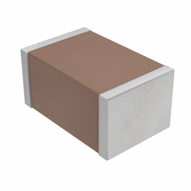

CGA4J3X5R1C335K125AB 数据手册
MULTILAYER CERAMIC CHIP CAPACITORS March 2022 MULTILAYER CERAMIC CHIP CAPACITORS Automotive grade, general (Up to 75V)  CGA series CGA1 CGA2 CGA3 CGA4 CGA5 CGA6 CGA8 CGA9 0603 [EIA 0201] 1005 [EIA 0402] 1608 [EIA 0603] 2012 [EIA 0805] 3216 [EIA 1206] 3225 [EIA 1210] 4532 [EIA 1812] 5750 [EIA 2220] * Dimensions code: JIS[EIA] (2/23) MULTILAYER CERAMIC CHIP CAPACITORS REMINDERS FOR USING THESE PRODUCTS Before using these products, be sure to request the delivery specifications. SAFETY REMINDERS Please pay sufficient attention to the warnings for safe designing when using this products. REMINDERS 1. The products listed in this specification are intended for use in automotive applications under normal operation and usage conditions. The products are not designed or warranted to meet the requirements of the applications listed below, whose performance and/or quality requires a more stringent level of safety or reliability, or whose failure, malfunction or defect could cause serious damage to society, person or property. Please understand that we are not responsible for any damage or liability caused by use of the products in any of the applications below or for any other use exceeding the range or conditions set forth in this specification sheet. If you intend to use the products in the applications listed below or if you have special requirements exceeding the range or conditions set forth in this specification, please contact us. (1) Aerospace/aviation equipment (2) Transportation equipment (electric trains, ships, etc.) (3) Medical equipment (excepting Pharmaceutical Affairs Law classification Class1,2) (4) Power-generation control equipment (5) Atomic energy-related equipment   (6) Seabed equipment (7) Transportation control equipment (8) Public information-processing equipment (9) Military equipment (10) Electric heating apparatus, burning equipment (11) Disaster prevention/crime prevention equipment (12) Safety equipment (13) Other applications that are not considered general-purpose applications When designing your equipment even for general-purpose applications, you are kindly requested to take into consideration securing protection circuit/device or providing backup circuits in your equipment. 2. 3. 4. 5. 6. 7. In addition, although the products listed in this specification are intended for use in automotive applications as described above, they are not prohibited to use in general electronic equipment, whose performance and/or quality doesn’t require a more stringent level of safety or reliability, or whose failure, malfunction or defect could not cause serious damage to society, person or property. Therefore, the description of this caution will be applied, when the products are used in general electronic equipment under a normal operation and usage conditions. We may modify products or discontinue production of a product listed in this catalog without prior notification. We provide “Delivery Specification” that explain precautions for the specifications and safety of each product listed in this catalog. We strongly recommend that you exchange these delivery specifications with customers that use one of these products. If you plan to export a product listed in this catalog, keep in mind that it may be a restricted item according to the “Foreign Exchange and Foreign Trade Control Law”. In such cases, it is necessary to acquire export permission in harmony with this law. Any reproduction or transferring of the contents of this catalog is prohibited without prior permission from our company. We are not responsible for problems that occur related to the intellectual property rights or other rights of our company or a third party when you use a product listed in this catalog. We do not grant license of these rights. This catalog only applies to products purchased through our company or one of our company’s official agencies. This catalog does not apply to products that are purchased through other third parties. Notice: Effective January 2013, TDK will use a new catalog number which adds product thickness and packaging specification detail. This new catalog number should be referenced on all catalog orders going forward, and is not applicable for OEM part number orders. Please be aware the last five digits of the catalog number will differ from the item description (internal control number) on the product label. Contact your local TDK Sales representative for more information. (Example) Catalog issued date Prior to January 2013 January 2013 and later Catalog number C1608C0G1E103J(080AA) C1608C0G1E103J080AA Item description (on delivery label) C1608C0G1E103JT000N C1608C0G1E103JT000N 20220321 / mlcc_automotive_general_en.fm (3/23) MULTILAYER CERAMIC CHIP CAPACITORS CGA series Cl Br General (Up to 75V) RoHS REACH Halogen Free SVHC-Free Pb Lead Free Type: CGA1/0603 [EIA 0201], CGA2/1005 [EIA 0402], CGA3/1608 [EIA 0603], CGA4/2012 [EIA 0805], CGA5/3216 [EIA 1206], CGA6/3225 [EIA 1210], CGA8/4532 [EIA 1812], CGA9/5750 [EIA 2220] ■ SERIES OVERVIEW General type CGA series, automotive grade of TDK's multilayer ceramic chip capacitor, is a surface-mounted component, which multilayer dielectrics and inner electrodes are stacked alternately. The monolithic structure ensures superior mechanical strength and high reliability. Also, outstanding frequency characteristics such as low ESR and low ESL are provided owing to the simpler structure than other capacitors. The capacitance range is up to 100µF and the lineup has been expanding to a range of the film capacitor and electrolytic capacitor. ■ FEATURES ■ APPLICATIONS • Superior mechanical strength and high reliability due to the monolithic structure • Outstanding frequency characteristics such as low ESR and low ESL by the simple structure • Low self-heating value and high resistance to ripple on account of the low ESR • No polarity • AEC-Q200 compliant • Smoothing and decoupling use in power lines for automotive applications such as ADAS, autonomous driving system ECU • LC resonance circuit (C0G type) • Applications requiring high reliability ■ SHAPE & DIMENSIONS ■ PRODUCT STRUCTURE W L T Sn Ni Cu G B L W T B G The structure which multilayer dielectrics and inner electrodes are stacked alternately. The monolithic and simple structure contributes to superior mechanical strength and excellent frequency characteristics. Body length Body width Body height Terminal width Terminal spacing Type L W CGA1 0.60±0.03 0.30±0.03 CGA2 1.00±0.05 0.50±0.05 CGA3 1.60±0.10 0.80±0.10 CGA4 2.00±0.20 1.25±0.20 CGA5 3.20±0.20 1.60±0.20 CGA6 3.20±0.40 2.50±0.30 CGA8 4.50±0.40 3.20±0.40 CGA9 5.70±0.40 5.00±0.40 Dimensional tolerances are typical values. T 0.30±0.03 0.50±0.05 0.80±0.10 1.25±0.20 1.60±0.20 2.50±0.30 2.50±0.30 2.50±0.30 Dimensions in mm B G 0.10 min. 0.20 min. 0.10 min. 0.30 min. 0.20 min. 0.30 min. 0.20 min. 0.50 min. 0.20 min. 1.00 min. 0.20 min. — 0.20 min. — 0.20 min. — Please be sure to request delivery specifications that provide further details on the features and specifications of the products for proper and safe use. Please note that the contents may change without any prior notice due to reasons such as upgrading. 20220321 / mlcc_automotive_general_en.fm (4/23) MULTILAYER CERAMIC CHIP CAPACITORS ■ CATALOG NUMBER CONSTRUCTION CGA 6 P 1 X7T 0G 107 M 250 A C (1) (2) (3) (4) (5) (6) (7) (8) (9) (10) (11) (1) Series (6) Rated voltage (DC) Code (2) Dimensions L x W (mm) Code 1 2 3 4 5 6 8 9 EIA 0201 0402 0603 0805 1206 1210 1812 2220 Length 0.60 1.00 1.60 2.00 3.20 3.20 4.50 5.70 Width 0.30 0.50 0.80 1.25 1.60 2.50 3.20 5.00 Terminal width 0.10 0.10 0.20 0.20 0.20 0.20 0.20 0.20 Thickness 0.30 mm 0.50 mm 0.60 mm 0.80 mm 0.85 mm 1.15 mm 1.25 mm 1.60 mm 2.00 mm 2.30 mm 2.50 mm 2.80 mm 3.20 mm (Example)0R5 = 0.5pF 101 = 100pF 225 = 2,200,000pF = 2.2µF (8) Capacitance tolerance Code C D J K M (4) Voltage condition for life test Symbol 1 2 3 Condition 1 × R.V. 2 × R.V. 1.5 × R.V. X7T Temperature coefficient or capacitance change 0±30 ppm/°C ±15% ±15% ±22% +22,-33% Tolerance ±0.25pF ±0.50pF ±5% ±10% ±20% (9) Thickness (5) Temperature characteristics Temperature characteristics C0G X5R X7R X7S Voltage (DC) 2.5V 4V 6.3V 10V 16V 25V 35V 50V 75V (7) Nominal capacitance (pF) The capacitance is expressed in three digit codes and in units of pico Farads (pF). The first and second digits identify the first and second significant figures of the capacitance. The third digit identifies the multiplier. R designates a decimal point. (3) Thickness code Code A B C E F H J L M N P Q R 0E 0G 0J 1A 1C 1E 1V 1H 1N Temperature range –55 to +125°C –55 to +85°C –55 to +125°C –55 to +125°C –55 to +125℃ Code 030 050 060 080 085 115 125 160 200 230 250 280 320 Thickness 0.30 mm 0.50 mm 0.60 mm 0.80 mm 0.85 mm 1.15 mm 1.25 mm 1.60 mm 2.00 mm 2.30 mm 2.50 mm 2.80 mm 3.20 mm (10) Packaging style Code A B K Style 178mm reel, 4mm pitch 178mm reel, 2mm pitch 178mm reel, 8mm pitch (11) Special reserved code Code A,B,C Description TDK internal code Please be sure to request delivery specifications that provide further details on the features and specifications of the products for proper and safe use. Please note that the contents may change without any prior notice due to reasons such as upgrading. 20220321 / mlcc_automotive_general_en.fm (5/23) MULTILAYER CERAMIC CHIP CAPACITORS Capacitance range chart Capacitance (pF) 1 1.5 2 2.2 3 3.3 4 4.7 5 6 6.8 7 8 9 10 12 15 18 22 27 33 39 47 56 68 82 100 150 220 330 470 680 1,000 1,500 2,200 3,300 4,700 6,800 10,000 100,000 Code CGA1/0603 [EIA 0201] C0G 1H (50V) 1E (25V) X7R 1H (50V) 1E (25V) 1C (16V) X7T 1A 0J (10V) (6.3V) 0G (4V) 010 1R5 020 2R2 030 3R3 040 4R7 050 060 6R8 070 080 090 100 120 150 180 220 270 330 390 470 560 680 820 101 151 221 331 471 681 102 152 222 332 472 682 103 104 Standard thickness   0.30mm ■ For details such as the catalog numbers, please refer to the capacitance range table on page 12 and after. Please be sure to request delivery specifications that provide further details on the features and specifications of the products for proper and safe use. Please note that the contents may change without any prior notice due to reasons such as upgrading. 20220321 / mlcc_automotive_general_en.fm (6/23) MULTILAYER CERAMIC CHIP CAPACITORS Capacitance range chart Capacitance C0G (pF) Code 1H (50V) 1 1.5 2 2.2 3 3.3 4 4.7 5 6 6.8 7 8 9 10 12 15 18 22 27 33 39 47 56 68 82 100 120 150 180 220 270 330 390 470 560 680 820 1,000 1,500 2,200 3,300 4,700 6,800 10,000 15,000 22,000 33,000 47,000 68,000 100,000 150,000 220,000 330,000 470,000 1,000,000 010 1R5 020 2R2 030 3R3 040 4R7 050 060 6R8 070 080 090 100 120 150 180 220 270 330 390 470 560 680 820 101 121 151 181 221 271 331 391 471 561 681 821 102 152 222 332 472 682 103 153 223 333 473 683 104 154 224 334 474 105 Standard thickness   CGA2/1005 [EIA 0402] X5R 1H (50V) 1V (35V) 1E (25V) X7R 1C (16V) 1A (10V) 1H (50V) 1V (35V) 1E (25V) 1C (16V) X7S 1A 0J 1C (10V) (6.3V) (16V) 1A (10V) X7T 0G (4V) 0.50mm Background gray: These products are not recommended for new designs. ■ For details such as the catalog numbers, please refer to the capacitance range table on page 12 and after. Please be sure to request delivery specifications that provide further details on the features and specifications of the products for proper and safe use. Please note that the contents may change without any prior notice due to reasons such as upgrading. 20220321 / mlcc_automotive_general_en.fm (7/23) MULTILAYER CERAMIC CHIP CAPACITORS Capacitance range chart CGA3/1608 [EIA 0603] Capacitance C0G X5R X7R (pF) 1H (50V) 1H (50V) 1H (50V) 1 1.5 2 2.2 3 3.3 4 4.7 5 6 6.8 7 8 9 10 12 15 18 22 27 33 39 47 56 68 82 100 120 150 180 220 270 330 390 470 560 680 820 1,000 1,200 1,500 1,800 2,200 2,700 3,300 3,900 4,700 5,600 6,800 8,200 10,000 15,000 22,000 33,000 47,000 68,000 Code 010 1R5 020 2R2 030 3R3 040 4R7 050 060 6R8 070 080 090 100 120 150 180 220 270 330 390 470 560 680 820 101 121 151 181 221 271 331 391 471 561 681 821 102 122 152 182 222 272 332 392 472 562 682 822 103 153 223 333 473 683 Standard thickness   0.80mm Background gray: These products are not recommended for new designs. ■ For details such as the catalog numbers, please refer to the capacitance range table on page 12 and after. Please be sure to request delivery specifications that provide further details on the features and specifications of the products for proper and safe use. Please note that the contents may change without any prior notice due to reasons such as upgrading. 20220321 / mlcc_automotive_general_en.fm (8/23) MULTILAYER CERAMIC CHIP CAPACITORS Capacitance range chart Capacitance (pF) Code 100,000 150,000 220,000 330,000 470,000 680,000 1,000,000 1,500,000 2,200,000 3,300,000 4,700,000 10,000,000 104 154 224 334 474 684 105 155 225 335 475 106 CGA3/1608 [EIA 0603] X5R X7R X7S X7T 1H 1V 1E 1C 1A 0J 1H 1V 1E 1C 0J 1C 1A 0G 1A 0J 0G (50V) (35V) (25V) (16V) (10V) (6.3V) (50V) (35V) (25V) (16V) (6.3V) (16V) (10V) (4V) (10V) (6.3V) (4V) Standard thickness   0.80mm Background gray: These products are not recommended for new designs. ■ For details such as the catalog numbers, please refer to the capacitance range table on page 12 and after. Please be sure to request delivery specifications that provide further details on the features and specifications of the products for proper and safe use. Please note that the contents may change without any prior notice due to reasons such as upgrading. 20220321 / mlcc_automotive_general_en.fm (9/23) MULTILAYER CERAMIC CHIP CAPACITORS Capacitance range chart CGA4/2012 [EIA 0805] Capacitance C0G (pF) 1H 1H 1V 1E 1C 1A 1H 1V 1E 1C 1A 0J 1E 1C 1A 0J (50V) (50V) (35V) (25V) (16V) (10V) (50V) (35V) (25V) (16V) (10V) (6.3V) (25V) (16V) (10V) (6.3V) Code 1,000 1,200 1,500 1,800 2,200 2,700 3,300 3,900 4,700 5,600 6,800 8,200 10,000 15,000 22,000 33,000 100,000 150,000 220,000 330,000 470,000 680,000 1,000,000 1,500,000 2,200,000 3,300,000 4,700,000 6,800,000 10,000,000 22,000,000 X5R X7R X7S X7T 102 122 152 182 222 272 332 392 472 562 682 822 103 153 223 333 104 154 224 334 474 684 105 155 225 335 475 685 106 226 Standard thickness   0.60 mm  0.85 mm  1.25 mm Background gray: These products are not recommended for new designs. ■ For details such as the catalog numbers, please refer to the capacitance range table on page 12 and after. Please be sure to request delivery specifications that provide further details on the features and specifications of the products for proper and safe use. Please note that the contents may change without any prior notice due to reasons such as upgrading. 20220321 / mlcc_automotive_general_en.fm (10/23) MULTILAYER CERAMIC CHIP CAPACITORS Capacitance range chart Capacitance C0G (pF) 1H (50V) 4,700 5,600 6,800 8,200 10,000 15,000 22,000 33,000 47,000 68,000 100,000 470,000 680,000 1,000,000 1,500,000 2,200,000 3,300,000 4,700,000 6,800,000 10,000,000 15,000,000 22,000,000 47,000,000 Code CGA5/3216 [EIA 1206] X5R 1H (50V) 1V (35V) 1E (25V) 1C (16V) 1H (50V) 1V (35V) X7R X7S X7T 1E (25V) 1C 0J 1A (16V) (6.3V) (10V) 0G (4V) 472 562 682 822 103 153 223 333 473 683 104 474 684 105 155 225 335 475 685 106 156 226 476 Standard thickness   0.60 mm  0.85 mm  1.15 mm  1.60 mm Background gray: These products are not recommended for new designs. ■ For details such as the catalog numbers, please refer to the capacitance range table on page 12 and after. Capacitance range chart Capacitance C0G (pF) 1H (50V) 22,000 33,000 47,000 68,000 100,000 1,000,000 1,500,000 2,200,000 3,300,000 4,700,000 6,800,000 10,000,000 15,000,000 22,000,000 33,000,000 47,000,000 100,000,000 Code CGA6/3225 [EIA 1210] X7R 1N (75V) 1H (50V) 1E (25V) X7S 1C (16V) 1H (50V) X7T 1A 0J (10V) (6.3V) 0G (4V) 0E (2.5V) 223 333 473 683 104 105 155 225 335 475 685 106 156 226 336 476 107 Standard thickness   1.25 mm  1.60 mm  2.00 mm  2.30 mm  2.50 mm Background gray: These products are not recommended for new designs. ■ For details such as the catalog numbers, please refer to the capacitance range table on page 12 and after. Please be sure to request delivery specifications that provide further details on the features and specifications of the products for proper and safe use. Please note that the contents may change without any prior notice due to reasons such as upgrading. 20220321 / mlcc_automotive_general_en.fm (11/23) MULTILAYER CERAMIC CHIP CAPACITORS Capacitance range chart Capacitance C0G (pF) 1H (50V) 47,000 68,000 100,000 150,000 220,000 1,500,000 2,200,000 3,300,000 4,700,000 6,800,000 10,000,000 15,000,000 22,000,000 33,000,000 Code CGA8/4532 [EIA 1812] X7R 1H (50V) 1E (25V) 1C (16V) 473 683 104 154 224 155 225 335 475 685 106 156 226 336 Standard thickness   1.60 mm  2.00 mm  2.30 mm  2.50 mm  2.80 mm  3.20 mm Background gray: These products are not recommended for new designs. ■ For details such as the catalog numbers, please refer to the capacitance range table on page 12 and after. Capacitance range chart Capacitance (pF) 4,700,000 6,800,000 10,000,000 15,000,000 22,000,000 47,000,000 CGA9/5750 [EIA 2220] X7R Code 1H (50V) 1V (35V) 1E (25V) 1C (16V) 475 685 106 156 226 476 Standard thickness   2.00 mm  2.30 mm  2.50 mm Background gray: These products are not recommended for new designs. ■ For details such as the catalog numbers, please refer to the capacitance range table on page 12 and after. Please be sure to request delivery specifications that provide further details on the features and specifications of the products for proper and safe use. Please note that the contents may change without any prior notice due to reasons such as upgrading. 20220321 / mlcc_automotive_general_en.fm (12/23) MULTILAYER CERAMIC CHIP CAPACITORS Capacitance range table Capacitance Dimensions 1pF 1.5pF 2pF 2.2pF 3pF 3.3pF 4pF 4.7pF 5pF 6pF 6.8pF 7pF 8pF 9pF 10pF 12pF 15pF 18pF 22pF 27pF 33pF 39pF 47pF 0603 1005 1608 0603 1005 1608 0603 1005 1608 0603 1005 1608 0603 1005 1608 0603 1005 1608 0603 1005 1608 0603 1005 1608 0603 1005 1608 0603 1005 1608 0603 1005 1608 0603 1005 1608 0603 1005 1608 0603 1005 1608 0603 1005 1608 0603 1005 1608 0603 1005 1608 0603 1005 1608 0603 1005 1608 0603 1005 1608 0603 1005 1608 0603 1005 1608 0603 1005 1608 Temperature characteristic: C0G (–55 to +125°C, 0±30ppm/°C) Thickness (mm) Capacitance tolerance Catalog number Rated voltage Edc: 50V 0.30±0.03 0.50±0.05 0.80±0.10 0.30±0.03 0.50±0.05 0.80±0.10 0.30±0.03 0.50±0.05 0.80±0.10 0.30±0.03 0.50±0.05 0.80±0.10 0.30±0.03 0.50±0.05 0.80±0.10 0.30±0.03 0.50±0.05 0.80±0.10 0.30±0.03 0.50±0.05 0.80±0.10 0.30±0.03 0.50±0.05 0.80±0.10 0.30±0.03 0.50±0.05 0.80±0.10 0.30±0.03 0.50±0.05 0.80±0.10 0.30±0.03 0.50±0.05 0.80±0.10 0.30±0.03 0.50±0.05 0.80±0.10 0.30±0.03 0.50±0.05 0.80±0.10 0.30±0.03 0.50±0.05 0.80±0.10 0.30±0.03 0.50±0.05 0.80±0.10 0.30±0.03 0.50±0.05 0.80±0.10 0.30±0.03 0.50±0.05 0.80±0.10 0.30±0.03 0.50±0.05 0.80±0.10 0.30±0.03 0.50±0.05 0.80±0.10 0.30±0.03 0.50±0.05 0.80±0.10 0.30±0.03 0.50±0.05 0.80±0.10 0.30±0.03 0.50±0.05 0.80±0.10 0.30±0.03 0.50±0.05 0.80±0.10 ±0.25pF ±0.25pF ±0.25pF ±0.25pF ±0.25pF ±0.25pF ±0.25pF ±0.25pF ±0.25pF ±0.25pF ±0.25pF ±0.25pF ±0.25pF ±0.25pF ±0.25pF ±0.25pF ±0.25pF ±0.25pF ±0.25pF ±0.25pF ±0.25pF ±0.25pF ±0.25pF ±0.25pF ±0.25pF ±0.25pF ±0.25pF ±0.50pF ±0.50pF ±0.50pF ±0.50pF ±0.50pF ±0.50pF ±0.50pF ±0.50pF ±0.50pF ±0.50pF ±0.50pF ±0.50pF ±0.50pF ±0.50pF ±0.50pF ±0.50pF ±0.50pF ±0.50pF ±5% ±5% ±5% ±5% ±5% ±5% ±5% ±5% ±5% ±5% ±5% ±5% ±5% ±5% ±5% ±5% ±5% ±5% ±5% ±5% ±5% ±5% ±5% ±5% CGA1A2C0G1H010C030BA CGA2B2C0G1H010C050BA CGA3E2C0G1H010C080AA CGA1A2C0G1H1R5C030BA CGA2B2C0G1H1R5C050BA CGA3E2C0G1H1R5C080AA CGA1A2C0G1H020C030BA CGA2B2C0G1H020C050BA CGA3E2C0G1H020C080AA CGA1A2C0G1H2R2C030BA CGA2B2C0G1H2R2C050BA CGA3E2C0G1H2R2C080AA CGA1A2C0G1H030C030BA CGA2B2C0G1H030C050BA CGA3E2C0G1H030C080AA CGA1A2C0G1H3R3C030BA CGA2B2C0G1H3R3C050BA CGA3E2C0G1H3R3C080AA CGA1A2C0G1H040C030BA CGA2B2C0G1H040C050BA CGA3E2C0G1H040C080AA CGA1A2C0G1H4R7C030BA CGA2B2C0G1H4R7C050BA CGA3E2C0G1H4R7C080AA CGA1A2C0G1H050C030BA CGA2B2C0G1H050C050BA CGA3E2C0G1H050C080AA CGA1A2C0G1H060D030BA CGA2B2C0G1H060D050BA CGA3E2C0G1H060D080AA CGA1A2C0G1H6R8D030BA CGA2B2C0G1H6R8D050BA CGA3E2C0G1H6R8D080AA CGA1A2C0G1H070D030BA CGA2B2C0G1H070D050BA CGA3E2C0G1H070D080AA CGA1A2C0G1H080D030BA CGA2B2C0G1H080D050BA CGA3E2C0G1H080D080AA CGA1A2C0G1H090D030BA CGA2B2C0G1H090D050BA CGA3E2C0G1H090D080AA CGA1A2C0G1H100D030BA CGA2B2C0G1H100D050BA CGA3E2C0G1H100D080AA CGA1A2C0G1H120J030BA CGA2B2C0G1H120J050BA CGA3E2C0G1H120J080AA CGA1A2C0G1H150J030BA CGA2B2C0G1H150J050BA CGA3E2C0G1H150J080AA CGA1A2C0G1H180J030BA CGA2B2C0G1H180J050BA CGA3E2C0G1H180J080AA CGA1A2C0G1H220J030BA CGA2B2C0G1H220J050BA CGA3E2C0G1H220J080AA CGA1A2C0G1H270J030BA CGA2B2C0G1H270J050BA CGA3E2C0G1H270J080AA CGA1A2C0G1H330J030BA CGA2B2C0G1H330J050BA CGA3E2C0G1H330J080AA CGA1A2C0G1H390J030BA CGA2B2C0G1H390J050BA CGA3E2C0G1H390J080AA CGA1A2C0G1H470J030BA CGA2B2C0G1H470J050BA CGA3E2C0G1H470J080AA Rated voltage Edc: 25V CGA1A2C0G1E010C030BA CGA1A2C0G1E1R5C030BA CGA1A2C0G1E020C030BA CGA1A2C0G1E2R2C030BA CGA1A2C0G1E030C030BA CGA1A2C0G1E3R3C030BA CGA1A2C0G1E040C030BA CGA1A2C0G1E4R7C030BA CGA1A2C0G1E050C030BA CGA1A2C0G1E060D030BA CGA1A2C0G1E6R8D030BA CGA1A2C0G1E070D030BA CGA1A2C0G1E080D030BA CGA1A2C0G1E090D030BA CGA1A2C0G1E100D030BA CGA1A2C0G1E120J030BA CGA1A2C0G1E150J030BA CGA1A2C0G1E180J030BA CGA1A2C0G1E220J030BA CGA1A2C0G1E270J030BA CGA1A2C0G1E330J030BA CGA1A2C0G1E390J030BA CGA1A2C0G1E470J030BA Click the part numbers for details. Please be sure to request delivery specifications that provide further details on the features and specifications of the products for proper and safe use. Please note that the contents may change without any prior notice due to reasons such as upgrading. 20220321 / mlcc_automotive_general_en.fm (13/23) MULTILAYER CERAMIC CHIP CAPACITORS Capacitance range table Capacitance Dimensions 56pF 68pF 82pF 100pF 120pF 150pF 180pF 220pF 270pF 330pF 390pF 470pF 560pF 680pF 820pF 1nF 1.2nF 1.5nF 1.8nF 2.2nF 2.7nF 3.3nF 3.9nF 4.7nF 5.6nF 6.8nF 8.2nF 10nF 15nF 0603 1005 1608 0603 1005 1608 0603 1005 1608 0603 1005 1608 1005 1608 1005 1608 1005 1608 1005 1608 1005 1608 1005 1608 1005 1608 1005 1608 1005 1608 1005 1608 1005 1608 1005 1608 2012 1608 2012 1608 2012 1608 2012 1608 2012 1608 2012 1608 2012 1608 2012 1608 2012 3216 1608 2012 3216 1608 2012 3216 1608 2012 3216 1608 2012 3216 2012 3216 Temperature characteristic: C0G (–55 to +125°C, 0±30ppm/°C) Thickness (mm) Capacitance tolerance Catalog number Rated voltage Edc: 50V 0.30±0.03 0.50±0.05 0.80±0.10 0.30±0.03 0.50±0.05 0.80±0.10 0.30±0.03 0.50±0.05 0.80±0.10 0.30±0.03 0.50±0.05 0.80±0.10 0.50±0.05 0.80±0.10 0.50±0.05 0.80±0.10 0.50±0.05 0.80±0.10 0.50±0.05 0.80±0.10 0.50±0.05 0.80±0.10 0.50±0.05 0.80±0.10 0.50±0.05 0.80±0.10 0.50±0.05 0.80±0.10 0.50±0.05 0.80±0.10 0.50±0.05 0.80±0.10 0.50±0.05 0.80±0.10 0.50±0.05 0.80±0.10 0.60±0.15 0.80±0.10 0.60±0.15 0.80±0.10 0.60±0.15 0.80±0.10 0.60±0.15 0.80±0.10 0.60±0.15 0.80±0.10 0.60±0.15 0.80±0.10 0.60±0.15 0.80±0.10 0.60±0.15 0.80±0.10 0.60±0.15 0.60±0.15 0.80±0.10 0.60±0.15 0.60±0.15 0.80±0.10 0.60±0.15 0.60±0.15 0.80±0.10 0.60±0.15 0.60±0.15 0.80±0.10 0.60±0.15 0.60±0.15 0.85±0.15 0.60±0.15 ±5% ±5% ±5% ±5% ±5% ±5% ±5% ±5% ±5% ±5% ±5% ±5% ±5% ±5% ±5% ±5% ±5% ±5% ±5% ±5% ±5% ±5% ±5% ±5% ±5% ±5% ±5% ±5% ±5% ±5% ±5% ±5% ±5% ±5% ±5% ±5% ±5% ±5% ±5% ±5% ±5% ±5% ±5% ±5% ±5% ±5% ±5% ±5% ±5% ±5% ±5% ±5% ±5% ±5% ±5% ±5% ±5% ±5% ±5% ±5% ±5% ±5% ±5% ±5% ±5% ±5% ±5% ±5% CGA1A2C0G1H560J030BA CGA2B2C0G1H560J050BA CGA3E2C0G1H560J080AA CGA1A2C0G1H680J030BA CGA2B2C0G1H680J050BA CGA3E2C0G1H680J080AA CGA1A2C0G1H820J030BA CGA2B2C0G1H820J050BA CGA3E2C0G1H820J080AA CGA1A2C0G1H101J030BA CGA2B2C0G1H101J050BA CGA3E2C0G1H101J080AA CGA2B2C0G1H121J050BA CGA3E2C0G1H121J080AA CGA2B2C0G1H151J050BA CGA3E2C0G1H151J080AA CGA2B2C0G1H181J050BA CGA3E2C0G1H181J080AA CGA2B2C0G1H221J050BA CGA3E2C0G1H221J080AA CGA2B2C0G1H271J050BA CGA3E2C0G1H271J080AA CGA2B2C0G1H331J050BA CGA3E2C0G1H331J080AA CGA2B2C0G1H391J050BA CGA3E2C0G1H391J080AA CGA2B2C0G1H471J050BA CGA3E2C0G1H471J080AA CGA2B2C0G1H561J050BA CGA3E2C0G1H561J080AA CGA2B2C0G1H681J050BA CGA3E2C0G1H681J080AA CGA2B2C0G1H821J050BA CGA3E2C0G1H821J080AA CGA2B2C0G1H102J050BA CGA3E2C0G1H102J080AA CGA4C2C0G1H102J060AA CGA3E2C0G1H122J080AA CGA4C2C0G1H122J060AA CGA3E2C0G1H152J080AA CGA4C2C0G1H152J060AA CGA3E2C0G1H182J080AA CGA4C2C0G1H182J060AA CGA3E2C0G1H222J080AA CGA4C2C0G1H222J060AA CGA3E2C0G1H272J080AA CGA4C2C0G1H272J060AA CGA3E2C0G1H332J080AA CGA4C2C0G1H332J060AA CGA3E2C0G1H392J080AA CGA4C2C0G1H392J060AA CGA3E2C0G1H472J080AA CGA4C2C0G1H472J060AA CGA5C2C0G1H472J060AA CGA3E2C0G1H562J080AA CGA4C2C0G1H562J060AA CGA5C2C0G1H562J060AA CGA3E2C0G1H682J080AA CGA4C2C0G1H682J060AA CGA5C2C0G1H682J060AA CGA3E2C0G1H822J080AA CGA4C2C0G1H822J060AA CGA5C2C0G1H822J060AA CGA3E2C0G1H103J080AA CGA4C2C0G1H103J060AA CGA5C2C0G1H103J060AA CGA4F2C0G1H153J085AA CGA5C2C0G1H153J060AA Rated voltage Edc: 25V CGA1A2C0G1E560J030BA CGA1A2C0G1E680J030BA CGA1A2C0G1E820J030BA CGA1A2C0G1E101J030BA ■ Gray items: These products are not recommended for new designs. Click the part numbers for details. Please be sure to request delivery specifications that provide further details on the features and specifications of the products for proper and safe use. Please note that the contents may change without any prior notice due to reasons such as upgrading. 20220321 / mlcc_automotive_general_en.fm (14/23) MULTILAYER CERAMIC CHIP CAPACITORS Capacitance range table Capacitance Dimensions 22nF 33nF 47nF 68nF 100nF 150nF 220nF 2012 3216 3225 2012 3216 3225 3216 3225 4532 3216 3225 4532 3216 3225 4532 4532 4532 Temperature characteristic: C0G (–55 to +125°C, 0±30ppm/°C) Thickness (mm) Capacitance tolerance Catalog number Rated voltage Edc: 50V 1.25±0.20 0.60±0.15 1.25±0.20 1.25±0.20 0.85±0.15 1.60±0.20 1.15±0.15 2.00±0.20 1.60±0.20 1.60±0.20 2.00±0.20 1.60±0.20 1.60±0.20 2.50±0.30 2.00±0.20 2.50±0.30 3.20±0.30 ±5% ±5% ±5% ±5% ±5% ±5% ±5% ±5% ±5% ±5% ±5% ±5% ±5% ±5% ±5% ±5% ±5% CGA4J2C0G1H223J125AA CGA5C2C0G1H223J060AA CGA6J2C0G1H223J125AA CGA4J2C0G1H333J125AA CGA5F2C0G1H333J085AA CGA6L2C0G1H333J160AA CGA5H2C0G1H473J115AA CGA6M2C0G1H473J200AA CGA8L2C0G1H473J160KA CGA5L2C0G1H683J160AA CGA6M2C0G1H683J200AA CGA8L2C0G1H683J160KA CGA5L2C0G1H104J160AA CGA6P2C0G1H104J250AA CGA8M2C0G1H104J200KA CGA8P2C0G1H154J250KA CGA8R2C0G1H224J320KA ■ Gray items: These products are not recommended for new designs. Click the part numbers for details. Please be sure to request delivery specifications that provide further details on the features and specifications of the products for proper and safe use. Please note that the contents may change without any prior notice due to reasons such as upgrading. 20220321 / mlcc_automotive_general_en.fm (15/23) MULTILAYER CERAMIC CHIP CAPACITORS Capacitance range table Capacitance Dimensions Thickness (mm) 220pF 1005 0.50±0.05 330pF 1005 0.50±0.05 470pF 1005 0.50±0.05 680pF 1005 0.50±0.05 1005 0.50±0.05 1608 0.80±0.10 1005 0.50±0.05 1608 0.80±0.10 1005 0.50±0.05 1608 0.80±0.10 1005 0.50±0.05 1608 0.80±0.10 1005 0.50±0.05 1608 0.80±0.10 1005 0.50±0.05 1608 0.80±0.10 1005 0.50±0.05 1608 0.80±0.10 1005 0.50±0.05 1608 0.80±0.10 1005 0.50±0.05 1608 0.80±0.10 1005 0.50±0.05 1608 0.80±0.10 1005 0.50±0.05 1608 0.80±0.10 1005 0.50±0.05 1608 0.80±0.10 1005 0.50±0.05 1608 0.80±0.10 1608 0.80±0.10 2012 1.25±0.20 1nF 1.5nF 2.2nF 3.3nF 4.7nF 6.8nF 10nF 15nF 22nF 33nF 47nF 68nF 100nF 150nF Temperature characteristic: X5R (–55 to +85°C, ±15%) Capacitance tolerance Catalog number Rated voltage Edc: 50V ±10% ±20% ±10% ±20% ±10% ±20% ±10% ±20% ±10% ±20% ±10% ±20% ±10% ±20% ±10% ±20% ±10% ±20% ±10% ±20% ±10% ±20% ±10% ±20% ±10% ±20% ±10% ±20% ±10% ±20% ±10% ±20% ±10% ±20% ±10% ±20% ±10% ±20% ±10% ±20% ±10% ±20% ±10% ±20% ±10% ±20% ±10% ±20% ±10% ±20% ±10% ±20% ±10% ±20% ±10% ±20% ±10% ±20% ±10% ±20% ±10% ±20% ±10% ±20% CGA2B2X5R1H221K050BA CGA2B2X5R1H221M050BA CGA2B2X5R1H331K050BA CGA2B2X5R1H331M050BA CGA2B2X5R1H471K050BA CGA2B2X5R1H471M050BA CGA2B2X5R1H681K050BA CGA2B2X5R1H681M050BA CGA2B2X5R1H102K050BA CGA2B2X5R1H102M050BA CGA3E2X5R1H102K080AA CGA3E2X5R1H102M080AA CGA2B2X5R1H152K050BA CGA2B2X5R1H152M050BA CGA3E2X5R1H152K080AA CGA3E2X5R1H152M080AA CGA2B2X5R1H222K050BA CGA2B2X5R1H222M050BA CGA3E2X5R1H222K080AA CGA3E2X5R1H222M080AA CGA2B2X5R1H332K050BA CGA2B2X5R1H332M050BA CGA3E2X5R1H332K080AA CGA3E2X5R1H332M080AA CGA2B2X5R1H472K050BA CGA2B2X5R1H472M050BA CGA3E2X5R1H472K080AA CGA3E2X5R1H472M080AA CGA2B2X5R1H682K050BA CGA2B2X5R1H682M050BA CGA3E2X5R1H682K080AA CGA3E2X5R1H682M080AA CGA2B3X5R1H103K050BB CGA2B3X5R1H103M050BB CGA3E2X5R1H103K080AA CGA3E2X5R1H103M080AA CGA2B3X5R1H153K050BB CGA2B3X5R1H153M050BB CGA3E2X5R1H153K080AA CGA3E2X5R1H153M080AA CGA2B3X5R1H223K050BB CGA2B3X5R1H223M050BB CGA3E2X5R1H223K080AA CGA3E2X5R1H223M080AA CGA2B3X5R1H333K050BB CGA2B3X5R1H333M050BB CGA3E2X5R1H333K080AA CGA3E2X5R1H333M080AA CGA2B3X5R1H473K050BB CGA2B3X5R1H473M050BB CGA3E2X5R1H473K080AA CGA3E2X5R1H473M080AA CGA2B3X5R1H683K050BB CGA2B3X5R1H683M050BB CGA3E2X5R1H683K080AA CGA3E2X5R1H683M080AA CGA2B3X5R1H104K050BB CGA2B3X5R1H104M050BB CGA3E2X5R1H104K080AA CGA3E2X5R1H104M080AA CGA3E3X5R1H154K080AB CGA3E3X5R1H154M080AB CGA4J2X5R1H154K125AA CGA4J2X5R1H154M125AA Rated voltage Edc: 35V Rated voltage Edc: 25V CGA2B3X5R1V103K050BB CGA2B3X5R1V103M050BB CGA2B2X5R1E103K050BA CGA2B2X5R1E103M050BA CGA2B3X5R1V153K050BB CGA2B3X5R1V153M050BB CGA2B2X5R1E153K050BA CGA2B2X5R1E153M050BA CGA2B3X5R1V223K050BB CGA2B3X5R1V223M050BB CGA2B2X5R1E223K050BA CGA2B2X5R1E223M050BA CGA2B3X5R1V333K050BB CGA2B3X5R1V333M050BB CGA2B2X5R1E333K050BA CGA2B2X5R1E333M050BA CGA2B3X5R1V473K050BB CGA2B3X5R1V473M050BB CGA2B2X5R1E473K050BA CGA2B2X5R1E473M050BA CGA2B3X5R1V683K050BB CGA2B3X5R1V683M050BB CGA2B3X5R1E683K050BB CGA2B3X5R1E683M050BB CGA2B3X5R1V104K050BB CGA2B3X5R1V104M050BB CGA2B3X5R1E104K050BB CGA2B3X5R1E104M050BB CGA3E2X5R1E104K080AA CGA3E2X5R1E104M080AA CGA3E2X5R1E154K080AA CGA3E2X5R1E154M080AA CGA3E3X5R1V154K080AB CGA3E3X5R1V154M080AB ■ Gray items: These products are not recommended for new designs. Click the part numbers for details. Please be sure to request delivery specifications that provide further details on the features and specifications of the products for proper and safe use. Please note that the contents may change without any prior notice due to reasons such as upgrading. 20220321 / mlcc_automotive_general_en.fm (16/23) MULTILAYER CERAMIC CHIP CAPACITORS Capacitance range table Capacitance Dimensions Thickness (mm) 1608 0.80±0.10 2012 1.25±0.20 1608 0.80±0.10 2012 1.25±0.20 1608 0.80±0.10 2012 1.25±0.20 3216 1.60+0.30,-0.10 1608 0.80±0.10 2012 1.25±0.20 3216 1.60+0.30,-0.10 1608 0.80±0.10 2012 1.25±0.20 3216 1.60+0.30,-0.10 2012 1.25±0.20 3216 1.60+0.30,-0.10 2012 1.25±0.20 3216 1.60+0.30,-0.10 2012 1.25±0.20 3216 1.60+0.30,-0.10 2012 1.25±0.20 3216 1.60+0.30,-0.10 6.8µF 3216 1.60+0.30,-0.10 10µF 3216 1.60+0.30,-0.10 220nF 330nF 470nF 680nF 1µF 1.5µF 2.2µF 3.3µF 4.7µF Temperature characteristic: X5R (–55 to +85°C, ±15%) Capacitance tolerance Catalog number Rated voltage Edc: 50V ±10% ±20% ±10% ±20% ±10% ±20% ±10% ±20% ±10% ±20% ±10% ±20% ±10% ±20% ±10% ±20% ±10% ±20% ±10% ±20% ±10% ±20% ±10% ±20% ±10% ±20% ±10% ±20% ±10% ±20% ±10% ±20% ±10% ±20% ±10% ±20% ±10% ±20% ±10% ±20% ±10% ±20% ±10% ±20% ±10% ±20% CGA3E3X5R1H224K080AB CGA3E3X5R1H224M080AB CGA4J2X5R1H224K125AA CGA4J2X5R1H224M125AA CGA3E3X5R1H334K080AB CGA3E3X5R1H334M080AB CGA4J2X5R1H334K125AA CGA4J2X5R1H334M125AA CGA3E3X5R1H474K080AB CGA3E3X5R1H474M080AB CGA4J3X5R1H474K125AB CGA4J3X5R1H474M125AB CGA5L2X5R1H474K160AA CGA5L2X5R1H474M160AA CGA3E3X5R1H684K080AB CGA3E3X5R1H684M080AB CGA4J3X5R1H684K125AB CGA4J3X5R1H684M125AB CGA5L2X5R1H684K160AA CGA5L2X5R1H684M160AA CGA3E3X5R1H105K080AB CGA3E3X5R1H105M080AB CGA4J3X5R1H105K125AB CGA4J3X5R1H105M125AB CGA5L2X5R1H105K160AA CGA5L2X5R1H105M160AA CGA4J3X5R1H155K125AB CGA4J3X5R1H155M125AB CGA5L3X5R1H155K160AB CGA5L3X5R1H155M160AB CGA4J3X5R1H225K125AB CGA4J3X5R1H225M125AB CGA5L3X5R1H225K160AB CGA5L3X5R1H225M160AB CGA4J3X5R1H335K125AB CGA4J3X5R1H335M125AB CGA5L3X5R1H335K160AB CGA5L3X5R1H335M160AB CGA4J3X5R1H475K125AB CGA4J3X5R1H475M125AB CGA5L3X5R1H475K160AB CGA5L3X5R1H475M160AB CGA5L3X5R1H685K160AB CGA5L3X5R1H685M160AB CGA5L3X5R1H106K160AB CGA5L3X5R1H106M160AB Rated voltage Edc: 35V Rated voltage Edc: 25V CGA3E3X5R1V224K080AB CGA3E3X5R1V224M080AB CGA3E2X5R1E224K080AA CGA3E2X5R1E224M080AA CGA3E3X5R1V334K080AB CGA3E3X5R1V334M080AB CGA3E3X5R1E334K080AB CGA3E3X5R1E334M080AB CGA3E3X5R1V474K080AB CGA3E3X5R1V474M080AB CGA4J3X5R1V474K125AB CGA4J3X5R1V474M125AB CGA3E3X5R1E474K080AB CGA3E3X5R1E474M080AB CGA4J2X5R1E474K125AA CGA4J2X5R1E474M125AA CGA3E3X5R1V684K080AB CGA3E3X5R1V684M080AB CGA4J3X5R1V684K125AB CGA4J3X5R1V684M125AB CGA3E3X5R1E684K080AB CGA3E3X5R1E684M080AB CGA4J2X5R1E684K125AA CGA4J2X5R1E684M125AA CGA3E3X5R1V105K080AB CGA3E3X5R1V105M080AB CGA4J3X5R1V105K125AB CGA4J3X5R1V105M125AB CGA3E3X5R1E105K080AB CGA3E3X5R1E105M080AB CGA4J2X5R1E105K125AA CGA4J2X5R1E105M125AA CGA4J3X5R1V155K125AB CGA4J3X5R1V155M125AB CGA5L3X5R1V155K160AB CGA5L3X5R1V155M160AB CGA4J3X5R1V225K125AB CGA4J3X5R1V225M125AB CGA5L3X5R1V225K160AB CGA5L3X5R1V225M160AB CGA4J3X5R1V335K125AB CGA4J3X5R1V335M125AB CGA5L3X5R1V335K160AB CGA5L3X5R1V335M160AB CGA4J3X5R1V475K125AB CGA4J3X5R1V475M125AB CGA5L3X5R1V475K160AB CGA5L3X5R1V475M160AB CGA5L3X5R1V685K160AB CGA5L3X5R1V685M160AB CGA5L3X5R1V106K160AB CGA5L3X5R1V106M160AB CGA4J3X5R1E155K125AB CGA4J3X5R1E155M125AB CGA5L2X5R1E155K160AA CGA5L2X5R1E155M160AA CGA4J3X5R1E225K125AB CGA4J3X5R1E225M125AB CGA5L2X5R1E225K160AA CGA5L2X5R1E225M160AA CGA4J3X5R1E335K125AB CGA4J3X5R1E335M125AB CGA5L2X5R1E335K160AA CGA5L2X5R1E335M160AA CGA4J3X5R1E475K125AB CGA4J3X5R1E475M125AB CGA5L2X5R1E475K160AA CGA5L2X5R1E475M160AA CGA5L3X5R1E685K160AB CGA5L3X5R1E685M160AB CGA5L3X5R1E106K160AB CGA5L3X5R1E106M160AB ■ Gray items: These products are not recommended for new designs. Click the part numbers for details. Please be sure to request delivery specifications that provide further details on the features and specifications of the products for proper and safe use. Please note that the contents may change without any prior notice due to reasons such as upgrading. 20220321 / mlcc_automotive_general_en.fm (17/23) MULTILAYER CERAMIC CHIP CAPACITORS Capacitance range table Capacitance Dimensions Thickness (mm) 33nF 1005 0.50±0.05 47nF 1005 0.50±0.05 68nF 1005 0.50±0.05 100nF 1005 0.50±0.05 150nF 1005 0.50±0.05 1005 0.50±0.05 1608 0.80±0.10 330nF 1608 0.80±0.10 470nF 1608 0.80±0.10 1608 0.80±0.10 2012 1.25±0.20 1608 0.80±0.10 2012 1.25±0.20 1608 0.80±0.10 2012 1.25±0.20 1608 0.80±0.10 2012 1.25±0.20 1608 0.80±0.10 2012 1.25±0.20 1608 0.80±0.10 2012 1.25±0.20 3216 1.60+0.30,-0.10 2012 1.25±0.20 3216 1.60+0.30,-0.10 2012 1.25±0.20 3216 1.60+0.30,-0.10 3216 3216 1.60+0.30,-0.10 1.60+0.30,-0.10 220nF 680nF 1µF 1.5µF 2.2µF 3.3µF 4.7µF 6.8µF 10µF 15µF 22µF Temperature characteristic: X5R (–55 to +85°C, ±15%) Capacitance tolerance Catalog number Rated voltage Edc: 16V ±10% ±20% ±10% ±20% ±10% ±20% ±10% ±20% ±10% ±20% ±10% ±20% ±10% ±20% ±10% ±20% ±10% ±20% ±10% ±20% ±10% ±20% ±10% ±20% ±10% ±20% ±10% ±20% ±10% ±20% ±10% ±20% ±10% ±20% ±10% ±20% ±10% ±20% ±10% ±20% ±10% ±20% ±10% ±20% ±10% ±20% ±10% ±20% ±10% ±20% ±10% ±20% ±20% ±20% CGA2B2X5R1C333K050BA CGA2B2X5R1C333M050BA CGA2B2X5R1C473K050BA CGA2B2X5R1C473M050BA CGA2B2X5R1C683K050BA CGA2B2X5R1C683M050BA CGA2B2X5R1C104K050BA CGA2B2X5R1C104M050BA CGA2B1X5R1C154K050BC CGA2B1X5R1C154M050BC CGA2B1X5R1C224K050BC CGA2B1X5R1C224M050BC CGA3E2X5R1C224K080AA CGA3E2X5R1C224M080AA CGA3E2X5R1C334K080AA CGA3E2X5R1C334M080AA CGA3E2X5R1C474K080AA CGA3E2X5R1C474M080AA CGA3E2X5R1C684K080AA CGA3E2X5R1C684M080AA CGA4J2X5R1C684K125AA CGA4J2X5R1C684M125AA CGA3E1X5R1C105K080AC CGA3E1X5R1C105M080AC CGA4J2X5R1C105K125AA CGA4J2X5R1C105M125AA CGA3E1X5R1C155K080AC CGA3E1X5R1C155M080AC CGA4J2X5R1C155K125AA CGA4J2X5R1C155M125AA CGA3E1X5R1C225K080AC CGA3E1X5R1C225M080AC CGA4J2X5R1C225K125AA CGA4J2X5R1C225M125AA CGA4J3X5R1C335K125AB CGA4J3X5R1C335M125AB Rated voltage Edc: 10V Rated voltage Edc: 6.3V CGA2B2X5R1A104K050BA CGA2B2X5R1A104M050BA CGA2B3X5R1A154K050BB CGA2B3X5R1A154M050BB CGA2B3X5R1A224K050BB CGA2B3X5R1A224M050BB CGA3E2X5R1A334K080AA CGA3E2X5R1A334M080AA CGA3E2X5R1A474K080AA CGA3E2X5R1A474M080AA CGA3E2X5R1A684K080AA CGA3E2X5R1A684M080AA CGA3E2X5R1A105K080AA CGA3E2X5R1A105M080AA CGA3E3X5R1A155K080AB CGA3E3X5R1A155M080AB CGA4J2X5R1A155K125AA CGA4J2X5R1A155M125AA CGA3E3X5R1A225K080AB CGA3E3X5R1A225M080AB CGA4J2X5R1A225K125AA CGA4J2X5R1A225M125AA CGA3E1X5R1A335K080AC CGA3E1X5R1A335M080AC CGA4J2X5R1A335K125AA CGA4J2X5R1A335M125AA CGA3E3X5R0J335K080AB CGA3E3X5R0J335M080AB CGA3E1X5R0J475K080AC CGA3E1X5R0J475M080AC CGA4J3X5R1C475K125AB CGA4J3X5R1C475M125AB CGA5L2X5R1C475K160AA CGA5L2X5R1C475M160AA CGA4J1X5R1C685K125AC CGA4J1X5R1C685M125AC CGA5L2X5R1C685K160AA CGA5L2X5R1C685M160AA CGA4J1X5R1C106K125AC CGA4J1X5R1C106M125AC CGA5L1X5R1C106K160AC CGA5L1X5R1C106M160AC CGA5L1X5R1C156M160AC CGA5L1X5R1C226M160AC CGA4J2X5R1A475K125AA CGA4J2X5R1A475M125AA CGA4J3X5R1A685K125AB CGA4J3X5R1A685M125AB CGA4J3X5R1A106K125AB CGA4J3X5R1A106M125AB ■ Gray items: These products are not recommended for new designs. Click the part numbers for details.   Please be sure to request delivery specifications that provide further details on the features and specifications of the products for proper and safe use. Please note that the contents may change without any prior notice due to reasons such as upgrading. 20220321 / mlcc_automotive_general_en.fm (18/23) MULTILAYER CERAMIC CHIP CAPACITORS Capacitance range table Capacitance Dimensions Thickness (mm) 100pF 0603 0.30±0.03 150pF 0603 0.30±0.03 0603 0.30±0.03 1005 0.50±0.05 0603 0.30±0.03 1005 0.50±0.05 0603 0.30±0.03 1005 0.50±0.05 0603 0.30±0.03 1005 0.50±0.05 0603 0.30±0.03 1005 0.50±0.05 1608 0.80±0.10 0603 0.30±0.03 1005 0.50±0.05 1608 0.80±0.10 0603 0.30±0.03 1005 0.50±0.05 1608 0.80±0.10 0603 0.30±0.03 1005 0.50±0.05 1608 0.80±0.10 1005 0.50±0.05 1608 0.80±0.10 1005 0.50±0.05 1608 0.80±0.10 1005 0.50±0.05 1608 0.80±0.10 1005 0.50±0.05 1608 0.80±0.10 1005 0.50±0.05 1608 0.80±0.10 220pF 330pF 470pF 680pF 1nF 1.5nF 2.2nF 3.3nF 4.7nF 6.8nF 10nF 15nF 22nF Temperature characteristic: X7R (–55 to +125°C, ±15%) Capacitance tolerance Catalog number Rated voltage Edc: 50V ±10% ±20% ±10% ±20% ±10% ±20% ±10% ±20% ±10% ±20% ±10% ±20% ±10% ±20% ±10% ±20% ±10% ±20% ±10% ±20% ±10% ±20% ±10% ±20% ±10% ±20% ±10% ±20% ±10% ±20% ±10% ±20% ±10% ±20% ±10% ±20% ±10% ±20% ±10% ±20% ±10% ±20% ±10% ±20% ±10% ±20% ±10% ±20% ±10% ±20% ±10% ±20% ±10% ±20% ±10% ±20% ±10% ±20% ±10% ±20% ±10% ±20% ±10% ±20% CGA1A2X7R1H101K030BA CGA1A2X7R1H101M030BA CGA1A2X7R1H151K030BA CGA1A2X7R1H151M030BA CGA1A2X7R1H221K030BA CGA1A2X7R1H221M030BA CGA2B2X7R1H221K050BA CGA2B2X7R1H221M050BA CGA1A2X7R1H331K030BA CGA1A2X7R1H331M030BA CGA2B2X7R1H331K050BA CGA2B2X7R1H331M050BA CGA1A2X7R1H471K030BA CGA1A2X7R1H471M030BA CGA2B2X7R1H471K050BA CGA2B2X7R1H471M050BA Rated voltage Edc: 35V Rated voltage Edc: 25V CGA1A2X7R1E101K030BA CGA1A2X7R1E101M030BA CGA1A2X7R1E151K030BA CGA1A2X7R1E151M030BA CGA1A2X7R1E221K030BA CGA1A2X7R1E221M030BA CGA1A2X7R1E331K030BA CGA1A2X7R1E331M030BA CGA1A2X7R1E471K030BA CGA1A2X7R1E471M030BA CGA1A2X7R1E681K030BA CGA1A2X7R1E681M030BA CGA2B2X7R1H681K050BA CGA2B2X7R1H681M050BA CGA1A2X7R1E102K030BA CGA1A2X7R1E102M030BA CGA2B2X7R1H102K050BA CGA2B2X7R1H102M050BA CGA3E2X7R1H102K080AA CGA3E2X7R1H102M080AA CGA1A2X7R1E152K030BA CGA1A2X7R1E152M030BA CGA2B2X7R1H152K050BA CGA2B2X7R1H152M050BA CGA3E2X7R1H152K080AA CGA3E2X7R1H152M080AA CGA1A2X7R1E222K030BA CGA1A2X7R1E222M030BA CGA2B2X7R1H222K050BA CGA2B2X7R1H222M050BA CGA3E2X7R1H222K080AA CGA3E2X7R1H222M080AA CGA1A2X7R1E332K030BA CGA1A2X7R1E332M030BA CGA2B2X7R1H332K050BA CGA2B2X7R1H332M050BA CGA3E2X7R1H332K080AA CGA3E2X7R1H332M080AA CGA2B2X7R1H472K050BA CGA2B2X7R1H472M050BA CGA3E2X7R1H472K080AA CGA3E2X7R1H472M080AA CGA2B2X7R1H682K050BA CGA2B2X7R1H682M050BA CGA3E2X7R1H682K080AA CGA3E2X7R1H682M080AA CGA2B3X7R1H103K050BB CGA2B3X7R1H103M050BB CGA3E2X7R1H103K080AA CGA3E2X7R1H103M080AA CGA2B3X7R1H153K050BB CGA2B3X7R1H153M050BB CGA3E2X7R1H153K080AA CGA3E2X7R1H153M080AA CGA2B3X7R1H223K050BB CGA2B3X7R1H223M050BB CGA3E2X7R1H223K080AA CGA3E2X7R1H223M080AA CGA2B3X7R1V103K050BB CGA2B3X7R1V103M050BB CGA2B2X7R1E103K050BA CGA2B2X7R1E103M050BA CGA2B3X7R1V153K050BB CGA2B3X7R1V153M050BB CGA2B2X7R1E153K050BA CGA2B2X7R1E153M050BA CGA2B3X7R1V223K050BB CGA2B3X7R1V223M050BB CGA2B2X7R1E223K050BA CGA2B2X7R1E223M050BA Click the part numbers for details. Please be sure to request delivery specifications that provide further details on the features and specifications of the products for proper and safe use. Please note that the contents may change without any prior notice due to reasons such as upgrading. 20220321 / mlcc_automotive_general_en.fm (19/23) MULTILAYER CERAMIC CHIP CAPACITORS Capacitance range table Capacitance Dimensions Thickness (mm) 1005 0.50±0.05 1608 0.80±0.10 1005 0.50±0.05 1608 0.80±0.10 1005 0.50±0.05 1608 0.80±0.10 1005 0.50±0.05 1608 0.80±0.10 2012 1.25±0.20 1005 0.50±0.05 1608 0.80±0.10 2012 1.25±0.20 1005 0.50±0.05 1608 0.80±0.10 2012 1.25±0.20 1608 0.80±0.10 2012 1.25±0.20 1608 0.80±0.10 2012 1.25±0.20 3216 1.60+0.30,-0.10 1608 0.80±0.10 2012 1.25±0.20 3216 1.60+0.30,-0.10 1608 0.80±0.10 2012 1.25±0.20 3216 1.60+0.30,-0.10 3225 1.60±0.20 2012 1.25±0.20 3216 1.60+0.30,-0.10 3225 2.00±0.20 4532 1.60±0.20 2012 1.25±0.20 3216 1.60+0.30,-0.10 3225 2.00±0.20 4532 1.60±0.20 33nF 47nF 68nF 100nF 150nF 220nF 330nF 470nF 680nF 1µF 1.5µF 2.2µF Temperature characteristic: X7R (–55 to +125°C, ±15%) Capacitance tolerance Catalog number Rated voltage Edc: 50V ±10% ±20% ±10% ±20% ±10% ±20% ±10% ±20% ±10% ±20% ±10% ±20% ±10% ±20% ±10% ±20% ±10% ±10% ±20% ±10% ±20% ±10% ±20% ±10% ±20% ±10% ±20% ±10% ±20% ±10% ±20% ±10% ±20% ±10% ±20% ±10% ±20% ±10% ±20% ±10% ±20% ±10% ±20% ±10% ±20% ±10% ±20% ±10% ±20% ±10% ±20% ±10% ±20% ±10% ±20% ±10% ±20% ±10% ±20% ±10% ±10% ±20% ±10% ±20% ±10% ±20% ±10% CGA2B3X7R1H333K050BB CGA2B3X7R1H333M050BB CGA3E2X7R1H333K080AA CGA3E2X7R1H333M080AA CGA2B3X7R1H473K050BB CGA2B3X7R1H473M050BB CGA3E2X7R1H473K080AA CGA3E2X7R1H473M080AA CGA2B3X7R1H683K050BB CGA2B3X7R1H683M050BB CGA3E2X7R1H683K080AA CGA3E2X7R1H683M080AA CGA2B3X7R1H104K050BB CGA2B3X7R1H104M050BB CGA3E2X7R1H104K080AA CGA3E2X7R1H104M080AA CGA4J2X7R1H104K125AA CGA3E3X7R1H154K080AB CGA3E3X7R1H154M080AB CGA4J2X7R1H154K125AA CGA4J2X7R1H154M125AA CGA3E3X7R1H224K080AB CGA3E3X7R1H224M080AB CGA4J2X7R1H224K125AA CGA4J2X7R1H224M125AA CGA3E3X7R1H334K080AB CGA3E3X7R1H334M080AB CGA4J2X7R1H334K125AA CGA4J2X7R1H334M125AA CGA3E3X7R1H474K080AB CGA3E3X7R1H474M080AB CGA4J3X7R1H474K125AB CGA4J3X7R1H474M125AB CGA5L2X7R1H474K160AA CGA5L2X7R1H474M160AA CGA4J3X7R1H684K125AB CGA4J3X7R1H684M125AB CGA5L2X7R1H684K160AA CGA5L2X7R1H684M160AA CGA4J3X7R1H105K125AB CGA4J3X7R1H105M125AB CGA5L3X7R1H105K160AB CGA5L3X7R1H105M160AB CGA6L2X7R1H105K160AA CGA6L2X7R1H105M160AA CGA4J3X7R1H155K125AB CGA4J3X7R1H155M125AB CGA5L3X7R1H155K160AB CGA5L3X7R1H155M160AB CGA6M2X7R1H155K200AA CGA6M2X7R1H155M200AA CGA8L2X7R1H155K160KA CGA4J3X7R1H225K125AB CGA4J3X7R1H225M125AB CGA5L3X7R1H225K160AB CGA5L3X7R1H225M160AB CGA6M3X7R1H225K200AB CGA6M3X7R1H225M200AB CGA8L2X7R1H225K160KA Rated voltage Edc: 35V Rated voltage Edc: 25V CGA2B3X7R1V333K050BB CGA2B3X7R1V333M050BB CGA2B1X7R1E333K050BC CGA2B1X7R1E333M050BC CGA2B3X7R1V473K050BB CGA2B3X7R1V473M050BB CGA2B1X7R1E473K050BC CGA2B1X7R1E473M050BC CGA2B3X7R1V683K050BB CGA2B3X7R1V683M050BB CGA2B3X7R1E683K050BB CGA2B3X7R1E683M050BB CGA2B3X7R1V104K050BB CGA2B3X7R1V104M050BB CGA2B3X7R1E104K050BB CGA2B3X7R1E104M050BB CGA3E2X7R1E104K080AA CGA3E2X7R1E104M080AA CGA2B1X7R1V154K050BC CGA2B1X7R1V154M050BC CGA3E3X7R1V154K080AB CGA3E3X7R1V154M080AB CGA2B3X7R1E154K050BB CGA2B3X7R1E154M050BB CGA3E2X7R1E154K080AA CGA3E2X7R1E154M080AA CGA2B1X7R1V224K050BC CGA2B1X7R1V224M050BC CGA3E3X7R1V224K080AB CGA3E3X7R1V224M080AB CGA2B3X7R1E224K050BB CGA2B3X7R1E224M050BB CGA3E1X7R1E224K080AC CGA3E1X7R1E224M080AC CGA4J2X7R1E224K125AA CGA3E1X7R1V334K080AC CGA3E1X7R1V334M080AC CGA3E3X7R1E334K080AB CGA3E3X7R1E334M080AB CGA3E1X7R1V474K080AC CGA3E1X7R1V474M080AC CGA4J3X7R1V474K125AB CGA4J3X7R1V474M125AB CGA3E3X7R1E474K080AB CGA3E3X7R1E474M080AB CGA4J2X7R1E474K125AA CGA4J2X7R1E474M125AA CGA3E1X7R1V684K080AC CGA3E1X7R1V684M080AC CGA4J3X7R1V684K125AB CGA4J3X7R1V684M125AB CGA3E1X7R1E684K080AC CGA3E1X7R1E684M080AC CGA4J3X7R1E684K125AB CGA4J3X7R1E684M125AB CGA3E1X7R1V105K080AC CGA3E1X7R1V105M080AC CGA4J3X7R1V105K125AB CGA4J3X7R1V105M125AB CGA3E1X7R1E105K080AC CGA3E1X7R1E105M080AC CGA4J3X7R1E105K125AB CGA4J3X7R1E105M125AB CGA5L2X7R1E105K160AA CGA5L2X7R1E105M160AA CGA4J1X7R1V155K125AC CGA4J1X7R1V155M125AC CGA5L3X7R1V155K160AB CGA5L3X7R1V155M160AB CGA4J3X7R1E155K125AB CGA4J3X7R1E155M125AB CGA5L2X7R1E155K160AA CGA5L2X7R1E155M160AA CGA4J1X7R1V225K125AC CGA4J1X7R1V225M125AC CGA5L3X7R1V225K160AB CGA5L3X7R1V225M160AB CGA4J3X7R1E225K125AB CGA4J3X7R1E225M125AB CGA5L2X7R1E225K160AA CGA5L2X7R1E225M160AA ■ Gray items: These products are not recommended for new designs. Click the part numbers for details. Please be sure to request delivery specifications that provide further details on the features and specifications of the products for proper and safe use. Please note that the contents may change without any prior notice due to reasons such as upgrading. 20220321 / mlcc_automotive_general_en.fm (20/23) MULTILAYER CERAMIC CHIP CAPACITORS Capacitance range table Capacitance Dimensions 3.3µF 4.7µF 2012 1.25±0.20 3216 1.60+0.30,-0.10 3225 2.50±0.30 4532 2.00±0.20 2012 1.25±0.20 3216 1.60+0.30,-0.10 3225 2.50±0.30 4532 6.8µF 10µF 22µF 47µF 1.60±0.20 5750 2.00±0.20 2.00±0.20 3216 1.60+0.30,-0.10 3225 2.50±0.30 4532 5750 2.50±0.30 2.50±0.30 3216 1.60+0.30,-0.10 3225 2.50±0.30 4532 2.50±0.30 2.00±0.20 2.30±0.20 2.00±0.20 2.80±0.30 2.30±0.20 2.50±0.30 2.50±0.30 2.50±0.30 2.30±0.20 5750 15µF Thickness (mm) 3225 4532 5750 3225 4532 5750 5750 Capacitance tolerance ±10% ±20% ±10% ±20% ±10% ±20% ±10% ±10% ±20% ±10% ±20% ±10% ±20% ±10% ±20% ±10% ±10% ±10% ±20% ±10% ±20% ±10% ±10% ±10% ±20% ±10% ±20% ±10% ±20% ±10% ±20% ±20% ±20% ±20% ±20% ±20% ±20% Temperature characteristic: X7R (–55 to +125°C, ±15%) Catalog number Rated voltage Edc: 75V Rated voltage Edc: 50V CGA5L3X7R1H335K160AB CGA5L3X7R1H335M160AB CGA6P3X7R1H335K250AB CGA6P3X7R1H335M250AB CGA8M2X7R1H335K200KA CGA4J1X7R1H475K125AC CGA5L3X7R1H475K160AB CGA5L3X7R1H475M160AB CGA6P3X7R1H475K250AB CGA6P3X7R1H475M250AB Rated voltage Edc: 35V Rated voltage Edc: 25V CGA4J1X7R1V335K125AC CGA4J1X7R1V335M125AC CGA5L1X7R1V335K160AC CGA5L1X7R1V335M160AC CGA4J1X7R1E335K125AC CGA4J1X7R1E335M125AC CGA5L1X7R1E335K160AC CGA5L1X7R1E335M160AC CGA4J1X7R1V475K125AC CGA4J1X7R1V475M125AC CGA5L1X7R1V475K160AC CGA5L1X7R1V475M160AC CGA4J1X7R1E475K125AC CGA4J1X7R1E475M125AC CGA5L1X7R1E475K160AC CGA5L1X7R1E475M160AC CGA8L2X7R1E475K160KA CGA8L2X7R1E475M160KA CGA8M3X7R1H475K200KB CGA9M2X7R1H475K200KA CGA8P3X7R1H685K250KB CGA9P2X7R1H685K250KA CGA5L1X7R1H106K160AC CGA5L1X7R1V685K160AC CGA5L1X7R1V685M160AC CGA5L1X7R1E685K160AC CGA5L1X7R1E685M160AC CGA6P3X7R1E685K250AB CGA6P3X7R1E685M250AB CGA5L1X7R1V106K160AC CGA5L1X7R1V106M160AC CGA5L1X7R1E106K160AC CGA5L1X7R1E106M160AC CGA6P1X7R1E106K250AC CGA6P1X7R1E106M250AC CGA8P2X7R1E106K250KA CGA9M2X7R1E106M200KA CGA6P1X7R1N106K250AC CGA6P1X7R1N106M250AC CGA9N3X7R1H106K230KB CGA9P3X7R1H226M250KB CGA9N1X7R1V476M230KC CGA6M3X7R1E156M200AB CGA8Q3X7R1E156M280KB CGA9N2X7R1E156M230KA CGA6P3X7R1E226M250AB CGA8P1X7R1E226M250KC CGA9P2X7R1E226M250KA CGA9N3X7R1E476M230KB ■ Gray items: These products are not recommended for new designs. Click the part numbers for details. Please be sure to request delivery specifications that provide further details on the features and specifications of the products for proper and safe use. Please note that the contents may change without any prior notice due to reasons such as upgrading. 20220321 / mlcc_automotive_general_en.fm (21/23) MULTILAYER CERAMIC CHIP CAPACITORS Capacitance range table Capacitance Dimensions Thickness (mm) 100pF 0603 0.30±0.03 150pF 0603 0.30±0.03 220pF 0603 0.30±0.03 330pF 0603 0.30±0.03 470pF 0603 0.30±0.03 680pF 0603 0.30±0.03 1nF 0603 0.30±0.03 1.5nF 0603 0.30±0.03 2.2nF 0603 0.30±0.03 3.3nF 0603 0.30±0.03 4.7nF 0603 0.30±0.03 6.8nF 0603 0.30±0.03 10nF 0603 0.30±0.03 33nF 1005 0.50±0.05 47nF 1005 0.50±0.05 68nF 1005 0.50±0.05 100nF 1005 0.50±0.05 150nF 1005 0.50±0.05 1005 0.50±0.05 1608 0.80±0.10 1608 0.80±0.10 220nF 330nF 470nF 1608 0.80±0.10 2012 1.25±0.20 1608 0.80±0.10 2012 1.25±0.20 1608 0.80±0.10 2012 1.25±0.20 1608 0.80±0.10 2012 1.25±0.20 1608 0.80±0.10 2012 1.25±0.20 2012 1.25±0.20 2012 1.25±0.20 3216 1.60+0.30,-0.10 680nF 1µF 1.5µF 2.2µF 3.3µF 4.7µF Temperature characteristic: X7R (–55 to +125°C, ±15%) Capacitance tolerance Catalog number Rated voltage Edc: 16V ±10% ±20% ±10% ±20% ±10% ±20% ±10% ±20% ±10% ±20% ±10% ±20% ±10% ±20% ±10% ±20% ±10% ±20% ±10% ±20% ±10% ±20% ±10% ±20% ±10% ±20% ±10% ±20% ±10% ±20% ±10% ±20% ±10% ±20% ±10% ±20% ±10% ±20% ±10% ±20% ±10% ±20% ±10% ±20% ±10% ±10% ±20% ±10% ±20% ±10% ±20% ±10% ±20% ±10% ±20% ±10% ±20% ±10% ±20% ±10% ±20% ±10% ±20% ±10% ±20% ±10% ±20% CGA1A2X7R1C101K030BA CGA1A2X7R1C101M030BA CGA1A2X7R1C151K030BA CGA1A2X7R1C151M030BA CGA1A2X7R1C221K030BA CGA1A2X7R1C221M030BA CGA1A2X7R1C331K030BA CGA1A2X7R1C331M030BA CGA1A2X7R1C471K030BA CGA1A2X7R1C471M030BA CGA1A2X7R1C681K030BA CGA1A2X7R1C681M030BA CGA1A2X7R1C102K030BA CGA1A2X7R1C102M030BA CGA1A2X7R1C152K030BA CGA1A2X7R1C152M030BA CGA1A2X7R1C222K030BA CGA1A2X7R1C222M030BA CGA1A2X7R1C332K030BA CGA1A2X7R1C332M030BA CGA1A2X7R1C472K030BA CGA1A2X7R1C472M030BA CGA1A2X7R1C682K030BA CGA1A2X7R1C682M030BA CGA2B2X7R1C333K050BA CGA2B2X7R1C333M050BA CGA2B2X7R1C473K050BA CGA2B2X7R1C473M050BA CGA2B1X7R1C683K050BC CGA2B1X7R1C683M050BC CGA2B1X7R1C104K050BC CGA2B1X7R1C104M050BC CGA2B2X7R1C154K050BA CGA2B2X7R1C154M050BA CGA2B2X7R1C224K050BA CGA2B2X7R1C224M050BA CGA3E2X7R1C224K080AA CGA3E2X7R1C224M080AA CGA3E1X7R1C334K080AC CGA3E1X7R1C334M080AC CGA3E1X7R1C474K080AC CGA3E1X7R1C474M080AC CGA4J2X7R1C474K125AA CGA3E1X7R1C684K080AC CGA3E1X7R1C684M080AC CGA4J2X7R1C684K125AA CGA4J2X7R1C684M125AA CGA3E1X7R1C105K080AC CGA3E1X7R1C105M080AC CGA4J2X7R1C105K125AA CGA4J2X7R1C105M125AA Rated voltage Edc: 10V Rated voltage Edc: 6.3V CGA1A2X7R1A103K030BA CGA1A2X7R1A103M030BA CGA1A2X7R0J103K030BA CGA1A2X7R0J103M030BA CGA2B1X7R1A154K050BC CGA2B1X7R1A154M050BC CGA2B1X7R1A224K050BC CGA2B1X7R1A224M050BC CGA2B3X7R0J154K050BB CGA2B3X7R0J154M050BB CGA2B3X7R0J224K050BB CGA2B3X7R0J224M050BB CGA3E1X7R0J155K080AC CGA3E1X7R0J155M080AC CGA4J3X7R1C155K125AB CGA4J3X7R1C155M125AB CGA3E1X7R0J225K080AC CGA3E1X7R0J225M080AC CGA4J3X7R1C225K125AB CGA4J3X7R1C225M125AB CGA4J3X7R1C335K125AB CGA4J3X7R1C335M125AB CGA4J3X7R1C475K125AB CGA4J3X7R1C475M125AB CGA5L3X7R1C475K160AB CGA5L3X7R1C475M160AB CGA4J3X7R1A335K125AB CGA4J3X7R1A475K125AB ■ Gray item: The product is not recommended for a new design. Click the part numbers for details. Please be sure to request delivery specifications that provide further details on the features and specifications of the products for proper and safe use. Please note that the contents may change without any prior notice due to reasons such as upgrading. 20220321 / mlcc_automotive_general_en.fm (22/23) MULTILAYER CERAMIC CHIP CAPACITORS Capacitance range table Capacitance Dimensions Thickness (mm) 2012 1.25±0.20 3216 1.60+0.30,-0.10 2012 1.25±0.20 3216 1.60+0.30,-0.10 3225 2.00±0.20 3225 3216 3225 4532 4532 5750 2.50±0.30 1.60+0.30,-0.10 2.50±0.30 2.30±0.20 2.50±0.30 2.30±0.20 6.8µF 10µF 15µF 22µF 33µF 47µF Capacitance tolerance ±10% ±20% ±10% ±20% ±10% ±20% ±10% ±20% ±10% ±20% ±20% ±20% ±20% ±20% ±20% ±20% Temperature characteristic: X7R (–55 to +125°C, ±15%) Catalog number Rated voltage Edc: 16V Rated voltage Edc: 6.3V CGA4J1X7R0J685K125AC CGA4J1X7R0J685M125AC CGA5L1X7R1C685K160AC CGA5L1X7R1C685M160AC CGA4J1X7R0J106K125AC CGA4J1X7R0J106M125AC CGA5L1X7R1C106K160AC CGA5L1X7R1C106M160AC CGA6M3X7R1C106K200AB CGA6M3X7R1C106M200AB CGA6P3X7R1C156M250AB CGA5L1X7R0J226M160AC CGA6P1X7R1C226M250AC CGA8N3X7R1C226M230KB CGA8P1X7R1C336M250KC CGA9N3X7R1C476M230KB ■ Gray item: The product is not recommended for a new design. Click the part numbers for details. Please be sure to request delivery specifications that provide further details on the features and specifications of the products for proper and safe use. Please note that the contents may change without any prior notice due to reasons such as upgrading. 20220321 / mlcc_automotive_general_en.fm (23/23) MULTILAYER CERAMIC CHIP CAPACITORS Capacitance range table Capacitance Dimensions Thickness (mm) 330nF 1005 0.50±0.05 470nF 1005 0.50±0.05 1.5µF 1608 0.80±0.10 2.2µF 1608 0.80±0.10 4.7µF 3225 2.30±0.20 2012 1.25±0.20 3225 2.50±0.30 2012 1.25±0.20 3225 2.50±0.30 6.8µF 10µF Temperature characteristic: X7S (–55 to +125°C, ±22%) Catalog number Rated voltage Edc: 50V Capacitance tolerance ±10% ±20% ±10% ±20% ±10% ±20% ±10% ±20% ±10% ±10% ±20% ±10% ±20% ±10% ±20% ±10% ±20% Rated voltage Edc: 25V Rated voltage Edc: 16V CGA2B1X7S1C334K050BC CGA2B1X7S1C334M050BC CGA2B1X7S1C474K050BC CGA2B1X7S1C474M050BC CGA3E1X7S1C155K080AC CGA3E1X7S1C155M080AC CGA3E1X7S1C225K080AC CGA3E1X7S1C225M080AC CGA6N3X7S1H475K230AB CGA4J1X7S1C685K125AC CGA4J1X7S1C685M125AC CGA6P3X7S1H685K250AB CGA6P3X7S1H685M250AB CGA4J1X7S1E106K125AC CGA4J1X7S1C106K125AC CGA4J1X7S1C106M125AC Rated voltage Edc: 6.3V Rated voltage Edc: 4V CGA6P3X7S1H106K250AB CGA6P3X7S1H106M250AB ■ Gray item: The product is not recommended for a new design. Click the part numbers for details. Capacitance Dimensions Thickness (mm) 330nF 1005 0.50±0.05 470nF 1005 0.50±0.05 1.5µF 1608 0.80±0.10 2.2µF 1608 0.80±0.10 6.8µF 10µF 2012 1.25±0.20 1608 0.80+0.30,-0.10 2012 1.25±0.20 15µF 22µF 3216 3216 33µF 3225 47µF 3225 1.60+0.30,-0.10 1.60+0.30,-0.10 2.00±0.20 2.50±0.30 2.50±0.30 Capacitance tolerance Catalog number Rated voltage Edc: 10V ±10% ±20% ±10% ±20% ±10% ±20% ±10% ±20% ±10% ±20% ±20% ±10% ±20% ±20% ±20% ±20% ±20% ±20% CGA2B3X7S1A334K050BB CGA2B3X7S1A334M050BB CGA2B3X7S1A474K050BB CGA2B3X7S1A474M050BB CGA3E3X7S1A155K080AB CGA3E3X7S1A155M080AB CGA3E3X7S1A225K080AB CGA3E3X7S1A225M080AB CGA4J3X7S1A685K125AB CGA4J3X7S1A685M125AB CGA3E1X7S0G106M080AC CGA4J3X7S1A106K125AB CGA4J3X7S1A106M125AB CGA5L1X7S1A156M160AC CGA5L1X7S1A226M160AC CGA6M1X7S1A336M200AC CGA6P1X7S1A476M250AC CGA6P1X7S0J336M250AC CGA6P1X7S0J476M250AC ■ Gray items: These products are not recommended for new designs. Click the part numbers for details. Capacitance range table Capacitance Dimensions 100nF 1µF 4.7µF 10µF 22µF 47µF 100µF 0603 1005 1608 1608 2012 3216 3225 Temperature characteristic: X7T (–55 to +125°C, +22, –33%) Thickness Capacitance tolerance (mm) 0.30+0.10,-0.03 ±20% 0.50+0.10,-0.05 ±20% 0.80+0.30,-0.10 ±10% 0.80+0.30,-0.10 ±20% 1.25+0.30,-0.15 ±20% 1.60+0.40,-0.10 ±20% 2.50+0.40,-0.30 ±20% Catalog number Rated voltage Edc: 10V Rated voltage Edc: 6.3V Rated voltage Edc: 4V Rated voltage Edc: 2.5V CGA1A1X7T0G104M030BC CGA2B1X7T0G105M050BC CGA3E1X7T1A475K080AC CGA3E3X7T0J475K080AB CGA3E1X7T0J106M080AC CGA3E3X7T0G106M080AB CGA4J1X7T0J226M125AC CGA5L1X7T0G476M160AC CGA6P1X7T0G107M250AC CGA6P3X7T0E107M250AB Click the part numbers for details. Please be sure to request delivery specifications that provide further details on the features and specifications of the products for proper and safe use. Please note that the contents may change without any prior notice due to reasons such as upgrading. 20220321 / mlcc_automotive_general_en.fm
物料型号:TDK的多层陶瓷片式电容器,具体型号包括CGA1至CGA9,尺寸从0603 [EIA 0201] 到5750 [EIA 2220]。
器件简介:这些电容器是用于汽车级别的通用型(最大75V)的表面安装组件,采用多层陶瓷介质和内部电极交替堆叠的单体结构,具有优越的机械强度和高可靠性。
引脚分配:根据尺寸代码,引脚宽度和引脚间距有具体的规定,例如CGA1型的引脚宽度最小为0.10mm,引脚间距最小为0.20mm。
参数特性:包括电容范围、额定电压、温度特性、电容公差等。例如,CGA系列提供了从1pF到100µF的电容范围,并且符合AEC-Q200标准。
功能详解:电容器具有低等效串联电阻(ESR)和低等效串联电感(ESL)的出色频率特性,适用于汽车应用中的平滑和去耦用途,如ADAS、自动驾驶系统ECU等。
应用信息:适用于汽车应用,包括但不限于电源线平滑、去耦、LC谐振电路等。
封装信息:提供了详细的尺寸信息和封装类型,例如CGA1型的长度为0.60±0.03mm,宽度为0.30±0.03mm,高度为0.30±0.03mm。
此外,文档还包含了关于产品使用的注意事项,包括安全提醒、产品规格变更通知、出口限制、版权声明等。强调了在设计设备时需要考虑保护电路或提供备份电路,以确保安全使用。同时,提到了产品目录编号的变更,以及对产品规格和安全使用的详细说明。
