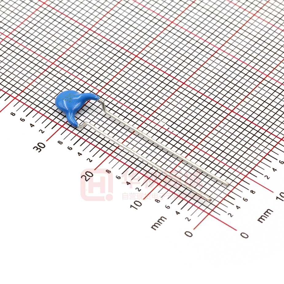

    直插陶瓷电容/独石电容 CAP_D6X5MM_TM 1nF ±10% 1KV B
CK45-B3AD102KYVNA 数据手册
C A P A C I T O R S Disc type capacitors with leads High voltage ceramic capacitors, commercial grade RoHS REACH SVHC-Free Cl Br Pb Halogen Free Lead Free CK45 series FEATURES Conform to RoHS directive due to lead(Pb) free of lead-wire and internal solder material. Compatible with halogen-free external resin coating. APPLICATION DC ballast PART NUMBER CONSTRUCTION  CK45 -B 3AD 102 K Y □ N A Series name Temperature characteristics Rated voltage Nominal capacitance Capacitance tolerance Class Lead-wire type Application classification Internal code -B ±10% 3AD 1kV DC -E +20, –55% 3DD 2kV DC 101 100pF 222 2,200pF 3FD 3kV DC 103 10,000pF K ±10% G Long lead Z +80, –20% N Short lead V Taping N A General Halogen-free Please refer to P-3~4 about the product dimensions. OPERATING TEMPERATURE RANGE Temperature characteristics B E Storage temperature (°C) –25 to +105 –25 to +105 Operating temperature (°C) –25 to +105 –25 to +105 The maximum operating temperature of +105°C includes capacitor self-generated heat of up to 20°C. After capacitor is mounted on board, the storage temperature range is applied. STANDARD LEAD-WIRE SHAPES Dimemsions in mm Symbol N : Bulk/short leads T 4max. 5±1 *2 25min. Vertical kink D*1 *2 T 4max. D Symbol V : Taping ø0.6±0.05 F *2 16+1.5 –0.5 *1 4max. 4max. T 4max. D*1 5±1 Symbol G : Bulk/long leads F F ø0.6±0.05 ø0.6±0.05 TDK’s standard product is vertical kink. TDK recommends short leads for bulk products. *1 Body diameter (D) is reference value if D is smaller than maximum dimension of lead to lead distance (F). *2 Coating on leads shall not extend beyond the bottom of vertical kink. RoHS Directive Compliant Product: See the following for more details. https://product.tdk.com/en/environment/rohs/index.html Halogen-free: Indicate that Cl content is less than 900ppm, Br content is less than 900ppm, and that the total Cl and Br content is less than 1500ppm. Please be sure to request delivery specifications that provide further details on the features and specifications of the products for proper and safe use. Please note that the contents may change without any prior notice due to reasons such as upgrading. (1/6) 20210802 leaddisc_commercial_ck45_en.fm C A P A C I T O R S Overview of CK45 series RECOMMENDED FLOW PROFILE Soldering Preheating Natural cooling T: Temperature T2 T1 t1 t2 t3 t: Time Preheating Temp. T1 110°C min. Time t1 30 to 60s. Peak Temp. T2 260°C Time t2 Within 10s. Natural cooling Time t3 Over 60s. MARKINGS D dimension: 6.0mm max. Item 1. Nominal capacitance Markings 221 Description 220pF 2. Capacitance tolerance K ±10% 3. Rated voltage 1KV 1kV DC Marking example 221K 1KV D dimension: 6.5mm min., temperature characteristic: B Item 1. Temperature characteristic Markings B Description B characteristic 2. Nominal capacitance 222 3. Capacitance tolerance K 2,200pF 4. Rated voltage 2KV ±10% Marking example B 222K 2KV 2kV DC D dimension: 6.5mm min., temperature characteristic: E Item 1. Nominal capacitance Markings 222 Description 2,200pF 2. Capacitance tolerance Z +80,-20% 3. Rated voltage 1KV 1kV DC 4. Manufacturer TDK TDK Marking example 222Z 1KV TDK Please be sure to request delivery specifications that provide further details on the features and specifications of the products for proper and safe use. Please note that the contents may change without any prior notice due to reasons such as upgrading. (2/6) 20210802 leaddisc_commercial_ck45_en.fm C A P A C I T O R S CK45 type RATED VOLTAGE Edc: 1kV CAPACITANCE AND DIMENSIONS Dimensions (mm) Temperature Capacitance F Capacitance characteristics tolerance Dmax. * Tmax. (applied to bulk) F (applied to taping) Part numbers B 100pF ±10% (5.5) 5.0 5.0±1.5 5.0+0.8,–0.2 V1 B 150pF ±10% (5.5) 5.0 5.0±1.5 5.0+0.8,–0.2 V1 B 220pF ±10% (5.5) 5.0 5.0±1.5 B 330pF ±10% (5.5) 5.0 B 470pF ±10% (5.5) 5.0 B 680pF ±10% (5.5) B 1,000pF ±10% 6.0 B 1,500pF ±10% B 2,200pF B Taping Bulk/long leads dimensions (Symbol: G) Bulk/short leads (Symbol: N) Taping (Symbol: V) CK45-B3AD101KYGNA CK45-B3AD101KYNNA CK45-B3AD101KYVNA CK45-B3AD151KYGNA CK45-B3AD151KYNNA CK45-B3AD151KYVNA 5.0+0.8,–0.2 V1 CK45-B3AD221KYGNA CK45-B3AD221KYNNA CK45-B3AD221KYVNA 5.0±1.5 5.0+0.8,–0.2 V1 CK45-B3AD331KYGNA CK45-B3AD331KYNNA CK45-B3AD331KYVNA 5.0±1.5 5.0+0.8,–0.2 V1 CK45-B3AD471KYGNA CK45-B3AD471KYNNA CK45-B3AD471KYVNA 5.0 5.0±1.5 5.0+0.8,–0.2 V1 CK45-B3AD681KYGNA CK45-B3AD681KYNNA CK45-B3AD681KYVNA 5.0 5.0±1.5 5.0+0.8,–0.2 V1 CK45-B3AD102KYGNA CK45-B3AD102KYNNA CK45-B3AD102KYVNA 7.0 5.0 5.0±1.5 5.0+0.8,–0.2 V1 CK45-B3AD152KYGNA CK45-B3AD152KYNNA CK45-B3AD152KYVNA ±10% 8.5 5.0 5.0±1.5 5.0+0.8,–0.2 V1 CK45-B3AD222KYGNA CK45-B3AD222KYNNA CK45-B3AD222KYVNA 3,300pF ±10% 9.5 5.0 5.0±1.5 5.0+0.8,–0.2 V1 CK45-B3AD332KYGNA CK45-B3AD332KYNNA CK45-B3AD332KYVNA B 4,700pF ±10% 11.0 5.0 5.0±1.5 5.0+0.8,–0.2 V1 CK45-B3AD472KYGNA CK45-B3AD472KYNNA CK45-B3AD472KYVNA E 470pF +80, –20% (5.5) 5.0 5.0±1.5 5.0+0.8, –0.2 V1 CK45-E3AD471ZYGNA CK45-E3AD471ZYNNA CK45-E3AD471ZYVNA E 1,000pF +80, –20% (5.5) 5.0 5.0±1.5 5.0+0.8, –0.2 V1 CK45-E3AD102ZYGNA CK45-E3AD102ZYNNA CK45-E3AD102ZYVNA E 2,200pF +80, –20% 6.5 5.0 5.0±1.5 5.0+0.8, –0.2 V1 CK45-E3AD222ZYGNA CK45-E3AD222ZYNNA CK45-E3AD222ZYVNA E 4,700pF +80, –20% 8.5 5.0 5.0±1.5 5.0+0.8, –0.2 V1 CK45-E3AD472ZYGNA CK45-E3AD472ZYNNA CK45-E3AD472ZYVNA E 10,000pF +80, –20% 11.0 5.0 7.5±1.5 7.5±0.8 V2 CK45-E3AD103ZYGNA CK45-E3AD103ZYNNA CK45-E3AD103ZYVNA Dimensions (mm) Temperature Capacitance F Capacitance characteristics tolerance Dmax. * Tmax. (applied to bulk) F (applied to taping) Taping Bulk/long leads dimensions (Symbol: G) Bulk/short leads (Symbol: N) Taping (Symbol: V) B 100pF ±10% (5.5) 5.0 5.0±1.5 5.0+0.8, –0.2 V1 CK45-B3DD101KYGNA CK45-B3DD101KYNNA CK45-B3DD101KYVNA B 150pF ±10% (5.5) 5.0 5.0±1.5 5.0+0.8, –0.2 V1 CK45-B3DD151KYGNA CK45-B3DD151KYNNA CK45-B3DD151KYVNA B 220pF ±10% (5.5) 5.0 5.0±1.5 5.0+0.8, –0.2 V1 CK45-B3DD221KYGNA CK45-B3DD221KYNNA CK45-B3DD221KYVNA B 330pF ±10% (5.5) 5.0 5.0±1.5 5.0+0.8, –0.2 V1 CK45-B3DD331KYGNA CK45-B3DD331KYNNA CK45-B3DD331KYVNA B 470pF ±10% (5.5) 5.0 5.0±1.5 5.0+0.8, –0.2 V1 CK45-B3DD471KYGNA CK45-B3DD471KYNNA CK45-B3DD471KYVNA B 680pF ±10% 6.5 5.0 5.0±1.5 5.0+0.8, –0.2 V1 CK45-B3DD681KYGNA CK45-B3DD681KYNNA CK45-B3DD681KYVNA B 1,000pF ±10% 7.5 5.0 5.0±1.5 5.0+0.8, –0.2 V1 CK45-B3DD102KYGNA CK45-B3DD102KYNNA CK45-B3DD102KYVNA B 1,500pF ±10% 8.5 5.0 5.0±1.5 5.0+0.8, –0.2 V1 CK45-B3DD152KYGNA CK45-B3DD152KYNNA CK45-B3DD152KYVNA  The values in parentheses "( )" are reference values. Click the part number for details.  Reference values are applied to bulk products. Please refer to p-5 about the taping dimemsions. RATED VOLTAGE Edc: 2kV CAPACITANCE AND DIMENSIONS Part numbers B 2,200pF ±10% 10.0 5.0 5.0±1.5 5.0+0.8, –0.2 V1 CK45-B3DD222KYGNA CK45-B3DD222KYNNA CK45-B3DD222KYVNA B 3,300pF ±10% 11.5 5.0 7.5±1.5 7.5±0.8 V2 CK45-B3DD332KYGNA CK45-B3DD332KYNNA CK45-B3DD332KYVNA B 4,700pF ±10% 14.0 5.0 7.5±1.5 7.5±0.8 V2 CK45-B3DD472KYGNA CK45-B3DD472KYNNA CK45-B3DD472KYVNA E 470pF +80, –20% (5.5) 5.0 5.0±1.5 5.0+0.8, –0.2 V1 CK45-E3DD471ZYGNA CK45-E3DD471ZYNNA CK45-E3DD471ZYVNA E 1,000pF +80, –20% (6.0) 5.0 5.0±1.5 5.0+0.8, –0.2 V1 CK45-E3DD102ZYGNA CK45-E3DD102ZYNNA CK45-E3DD102ZYVNA E 2,200pF +80, –20% 8.0 5.0 5.0±1.5 5.0+0.8, –0.2 V1 CK45-E3DD222ZYGNA CK45-E3DD222ZYNNA CK45-E3DD222ZYVNA E 4,700pF +80, –20% 10.5 5.0 5.0±1.5 5.0+0.8, –0.2 V1 CK45-E3DD472ZYGNA CK45-E3DD472ZYNNA CK45-E3DD472ZYVNA E 10,000pF +80, –20% 14.5 5.0 7.5±1.5 7.5±0.8 CK45-E3DD103ZYGNA CK45-E3DD103ZYNNA CK45-E3DD103ZYVNA V3  The values in parentheses "( )" are reference values. Click the part number for details.  Reference values are applied to bulk products. Please refer to p-5 about the taping dimemsions. • For more information about products with other capacitance or other data, please contact us. Please be sure to request delivery specifications that provide further details on the features and specifications of the products for proper and safe use. Please note that the contents may change without any prior notice due to reasons such as upgrading. (3/6) 20210802 leaddisc_commercial_ck45_en.fm C A P A C I T O R S CK45 type RATED VOLTAGE Edc: 3kV CAPACITANCE AND DIMENSIONS Dimensions (mm) Temperature Capacitance F Capacitance characteristics tolerance Dmax. * Tmax. (applied to bulk) F (applied to taping) Taping Bulk/long leads dimensions (Symbol: G) Part numbers Bulk/short leads (Symbol: N) Taping (Symbol: V) B 100pF ±10% (5.5) 6.0 7.5±1.5 7.5±0.8 V2 CK45-B3FD101KYGNA CK45-B3FD101KYNNA CK45-B3FD101KYVNA B 150pF ±10% (5.5) 6.0 7.5±1.5 7.5±0.8 V2 CK45-B3FD151KYGNA CK45-B3FD151KYNNA CK45-B3FD151KYVNA B 220pF ±10% (5.5) 6.0 7.5±1.5 7.5±0.8 V2 CK45-B3FD221KYGNA CK45-B3FD221KYNNA CK45-B3FD221KYVNA B 330pF ±10% (6.5) 6.0 7.5±1.5 7.5±0.8 V2 CK45-B3FD331KYGNA CK45-B3FD331KYNNA CK45-B3FD331KYVNA B 470pF ±10% (7.0) 6.0 7.5±1.5 7.5±0.8 V2 CK45-B3FD471KYGNA CK45-B3FD471KYNNA CK45-B3FD471KYVNA B 680pF ±10% (8.0) 6.0 7.5±1.5 7.5±0.8 V2 CK45-B3FD681KYGNA CK45-B3FD681KYNNA CK45-B3FD681KYVNA B 1,000pF ±10% 9.0 6.0 7.5±1.5 7.5±0.8 V2 CK45-B3FD102KYGNA CK45-B3FD102KYNNA CK45-B3FD102KYVNA B 1,500pF ±10% 10.5 6.0 7.5±1.5 7.5±0.8 V2 CK45-B3FD152KYGNA CK45-B3FD152KYNNA CK45-B3FD152KYVNA B 2,200pF ±10% 12.5 6.0 7.5±1.5 7.5±0.8 V2 CK45-B3FD222KYGNA CK45-B3FD222KYNNA CK45-B3FD222KYVNA E 470pF +80, –20% (6.0) 6.0 7.5±1.5 7.5±0.8 V2 CK45-E3FD471ZYGNA CK45-E3FD471ZYNNA CK45-E3FD471ZYVNA E 1,000pF +80, –20% (7.5) 6.0 7.5±1.5 7.5±0.8 V2 CK45-E3FD102ZYGNA CK45-E3FD102ZYNNA CK45-E3FD102ZYVNA E 2,200pF +80, –20% 9.5 6.0 7.5±1.5 7.5±0.8 V2 CK45-E3FD222ZYGNA CK45-E3FD222ZYNNA CK45-E3FD222ZYVNA E 4,700pF +80, –20% 12.5 6.0 7.5±1.5 7.5±0.8 V2 CK45-E3FD472ZYGNA CK45-E3FD472ZYNNA CK45-E3FD472ZYVNA  The values in parentheses "( )" are reference values. Click the part number for details.  Reference values are applied to bulk products. Please refer to p-5 about the taping dimemsions. • For more information about products with other capacitance or other data, please contact us. Please be sure to request delivery specifications that provide further details on the features and specifications of the products for proper and safe use. Please note that the contents may change without any prior notice due to reasons such as upgrading. (4/6) 20210802 leaddisc_commercial_ck45_en.fm C A P A C I T O R S CK45 type TAPING DIMENSIONS P P P2 T D*1 P2 h T D*1 h h S H0 H0 L W0 W W0 W ød D0 ød t P0 V1, V2 V3 Item Symbols Dimensions (mm) V1 V2 Body diameter D Refer to P-3~4 Body thickness Lead-wire diameter Pitch of component Feed hole pitch Feed hole center to lead-wire Feed hole center to component center Lead-to lead distance Component alignment Carrier tape width Adhesive tape width Hole position Adhesive tape position Bottom of kink from tape center Lead-wire protrusion Feed hole diameter Carrier tape thickness (Including adhesive tape) Length of snipped lead-wire T ød P P0 P1 P2 F h W W0 W1 W2 H0 D0 Refer to P-3~4 0.6±0.05 12.7±1.0 12.7±0.3 3.85±0.7 6.35±1.3 5+0.8, –0.2 0±2.0 18.0+1.0,–0.5 10.0 Min. 9.0±0.5 4.0 Max. 16.0+1.5,–0.5 1.0 Max. 4.0±0.2 0.6±0.05 15.0±1.0 15.0±0.3 3.75±0.7 7.5±1.3 7.5±0.8 0±2.0 18.0+1.0,–0.5 10.0 Min. 9.0±0.5 4.0 Max. 16.0+1.5,–0.5 1.0 Max. 4.0±0.2 0.6±0.05 30.0±1.0 15.0±0.3 3.75±0.7 7.5±1.3 7.5±0.8 0±2.0 18.0+1.0,–0.5 10.0 Min. 9.0±0.5 4.0 Max. 16.0+1.5,–0.5 1.0 Max. 4.0±0.2 t 0.6±0.3 0.6±0.3 0.6±0.3 L 11.0 Max. 11.0 Max. 11.0 Max. Coating on lead-wire C 4.0 Max. 4.0 Max. 4.0 Max. Height of kink Spring action A S 4.0 Max. 2.0 Max. 4.0 Max. 2.0 Max. 4.0 Max. 2.0 Max. AMMO PACK INNER BOX SIZE V3 t D0 F W1 L W1 P0 P1 C*2 A C*2 S W2 F H0 P1 W2 H0 A h Remarks *1 Body diameter (D) is reference value if D is smaller than maximum dimension of lead to lead distance (F). Including the slant of body Excepting the tape splicing part Including the slanting body due to bending lead-wire Measuring point is bottom kink Including the slanting body due to bending lead-wire Adhesive tape do not stick out the tape Including adhesive tape *2 Coating on leads shall not extend beyond the bottom of vertical kink. Measuring point is bottom kink PACKAGE QUANTITY Package quantity Type Bulk (pieces / bag) Taping (pieces / box) 1000 1000 CK45 320max.  500 pieces applies to the following part. x. ma 340max. 60 CK45-E3DD103ZYVNA Dimensions in mm Please be sure to request delivery specifications that provide further details on the features and specifications of the products for proper and safe use. Please note that the contents may change without any prior notice due to reasons such as upgrading. (5/6) 20210802 leaddisc_commercial_ck45_en.fm C A P A C I T O R S REMINDERS FOR USING THESE PRODUCTS Before using these products, be sure to request the delivery specifications. SAFETY REMINDERS Please pay sufficient attention to the warnings for safe designing when using this products. REMINDERS Do not use or store in locations where there are conditions such as gas corrosion (salt, acid, alkali, etc.). Before soldering, be sure to preheat components. The preheating temperature should be set so that the temperature difference between the solder temperature and product temperature does not exceed 150°C. Soldering corrections after mounting should be within the range of the conditions determined in the specifications. If overheated, a short circuit, performance deterioration, or lifespan shortening may occur. Self heating (temperature increase) occurs when the power is turned ON, so the tolerance should be sufficient for the set thermal design. Do not use for a purpose outside of the contents regulated in the delivery specifications. The products listed on this catalog are intended for use in general electronic equipment (AV equipment, telecommunications equipment, home appliances, amusement equipment, computer equipment, personal equipment, office equipment, measurement equipment, industrial robots) under a normal operation and use condition. The products are not designed or warranted to meet the requirements of the applications listed below, whose performance and/or quality require a more stringent level of safety or reliability, or whose failure, malfunction or trouble could cause serious damage to society, person or property. If you intend to use the products in the applications listed below or if you have special requirements exceeding the range or conditions set forth in the each catalog, please contact us. (1) Aerospace/aviation equipment (2) Transportation equipment (cars, electric trains, ships, etc.) (3) Medical equipment (4) Power-generation control equipment (5) Atomic energy-related equipment   (6) Seabed equipment (7) Transportation control equipment (8) Public information-processing equipment (9) Military equipment (10) Electric heating apparatus, burning equipment (11) Disaster prevention/crime prevention equipment (12) Safety equipment (13) Other applications that are not considered general-purpose applications Please refer to the guideline of notabilia for fixed ceramic capacitors issued by JEITA(Japan Electronics and Information Technology Association, EIAJ RCR-2335). This guideline describes general precautions* for using fixed ceramic capacitors. Please carefully confirm it and use capacitors safely. * Items for check, explanation/reason/concrete example and failure examples, etc. When designing your equipment even for general-purpose applications, you are kindly requested to take into consideration securing protection circuit/device or providing backup circuits in your equipment. Please be sure to request delivery specifications that provide further details on the features and specifications of the products for proper and safe use. Please note that the contents may change without any prior notice due to reasons such as upgrading. (6/6) 20210802 leaddisc_commercial_ck45_en.fm
CK45-B3AD102KYVNA
物料型号:CK45系列,由TDK公司生产的圆盘型引线电容器,属于高压陶瓷电容器,商业级。
器件简介:这些电容器符合RoHS指令,因为它们的引线和内部焊接材料不含铅(Pb)。它们与无卤外部树脂涂层兼容。
引脚分配:根据文档,引脚类型分为长引线(G)、短引线(N)和卷带(V)。
参数特性:包括电容公差、额定电压、温度特性等。例如,-B系列的电容公差为±10%,额定电压为1kV DC,电容值为100pF。
功能详解:文档提供了电容器的推荐焊接流程,包括预热、峰值温度和自然冷却时间。
应用信息:适用于直流镇流器(DC ballast)。
封装信息:文档详细列出了不同电容值和温度特性的电容器尺寸,以及对应的封装类型。
