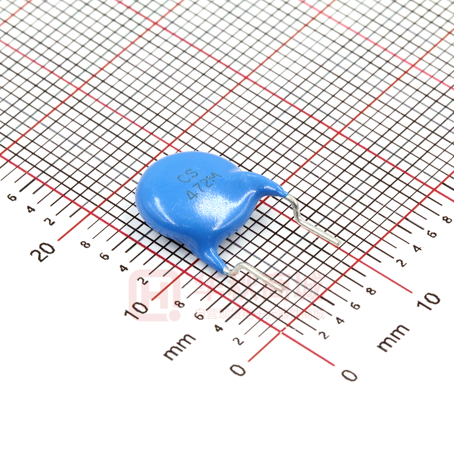

C A P A C I T O R S Disc type capacitors with leads High voltage ceramic capacitors, commercial grade, safety standard approved REACH SVHC-Free RoHS Cl Br Pb Halogen Free Lead Free CS45 series FEATURES Compliant with IEC and the safety standards of various countries. Withstand voltage is 2,600V AC. Flame-resistant reinforced outer insulation prevents fires, electrical shock, and other potential hazards. Conform to RoHS directive due to lead(Pb) free of lead-wire and internal solder material. Compatible with halogen-free external resin coating. APPLICATION Y capacitor for AC adapter, charger, power supplies PART NUMBER CONSTRUCTION * CS45 -E 2GA 102 M Series name* Temperature characteristics Rated voltage Nominal capacitance Capacitance tolerance -SL +350 to –1,000ppm/°C -B -E -F ±10% +20, –55% +30, –80% 2GA X1:440V AC Y2:300V AC - □ K A Lead-wire type Application classification Internal code 100 10pF J ±5% G Long lead 221 220pF K ±10% N Short lead 472 4,700pF M ±20% V Taping K Safety standard approved A Halogen-free Please refer to P-3 about the product dimensions. OPERATING TEMPERATURE RANGE Temperature characteristics Operating temperature (°C) Storage temperature (°C)* SL –40 to 125 –40 to 125 B –40 to 125 –40 to 125 E –40 to 125 –40 to 125 F –40 to 125 –40 to 125 The maximum operating temperature of +125°C includes capacitor self-generated heat of up to 20°C. * After capacitor is mounted on board, the storage temperature range is applied. STANDARD LEAD-WIRE SHAPES Dimemsions in mm T 25min. *2 T 4max. 4max. 5±1 *2 Vertical kink D*1 ø0.6±0.05 F *2 16+1.5 –0.5 D*1 4max. 4max. T Symbols V : Taping 4max. D*1 Symbols N : Bulk/short leads 5±1 Symbols G : Bulk/long leads F F ø0.6±0.05 ø0.6±0.05 TDK’s standard product is vertical kink. TDK recommends short leads for bulk products. *1 Body diameter (D) is reference value if D is smaller than maximum dimension of lead to lead distance (F). *2 Coating on leads shall not extend beyond the bottom of vertical kink. RoHS Directive Compliant Product: See the following for more details. https://product.tdk.com/en/environment/rohs/index.html Halogen-free: Indicate that Cl content is less than 900ppm, Br content is less than 900ppm, and that the total Cl and Br content is less than 1500ppm. Please be sure to request delivery specifications that provide further details on the features and specifications of the products for proper and safe use. Please note that the contents may change without any prior notice due to reasons such as upgrading. (1/5) 20210802 leaddisc_commercial_cs45_en.fm C A P A C I T O R S Overview of CS45 series CERTIFIED STATUS OF VARIOUS COUNTRIES Safety standard ENEC UL cUL/CSA SAA CQC IEC standard No. Standard No. Temperature characteristics Sub-class Rated voltage X1, Y2 X1:440V AC Y2:300V AC EN 60384-14 UL60384-14 IEC 60384-14 AS3250 IEC 60384-14 KTL SL,B,E,F X1 Y2 K60384-14 440V AC 300V AC Approval report No.* Taiwan Xiamen ENEC-01049 E37861 CS6268 CQC14001112768 CQC14001112449 SZ03001-12006 SU03047-12006 SZ03001-12008 SU03047-12008 * Certificate numbers shall be changed owing to the revisions of the related standards and renewal of certificate. RECOMMENDED FLOW PROFILE Soldering Preheating Natural cooling T: Temperature T2 T1 t1 t2 t3 t: Time Preheating Temp. T1 110°C min. Time t1 30 to 60s. Peak Temp. T2 260°C Time t2 Within 10s. Natural cooling Time t3 Over 60s. Please be sure to request delivery specifications that provide further details on the features and specifications of the products for proper and safe use. Please note that the contents may change without any prior notice due to reasons such as upgrading. (2/5) 20210802 leaddisc_commercial_cs45_en.fm C A P A C I T O R S CS45 type MARKINGS Item 1.Series 2.Nominal capacitance 3.Capacitance tolerance 4.Rated voltage Eac Markings CS 10 J 440∼X1 300∼Y2 Description CS45 series 10pF ±5% X1:440V AC Y2:300V AC Production base code 04 2020.4* 5.TDK’s trademark 6.Date code Marking examples Front Back CS 10J 04 (Marking position is reference.) * Year *The and month of production: last digit of year + month denoted by 1, 2, 3, 4, 5, 6, 7, 8, 9, O (October), N (November), or D (December). expression has become simplified due to a revision in the standards. RATED VOLTAGE Eac: X1:440V, Y2:300V CAPACITANCE AND DIMENSIONS Temperature characteristics Capacitance Capacitance tolerance Dimensions (mm) F Dmax. * Tmax. (applied to bulk) F (applied to taping) Part numbers Bulk/long leads (Symbols: G) Bulk/short leads (Symbols: N) Taping (Symbols: V) SL 10pF ±5% (7.0) 5.0 7.5±1.5 7.5±0.8 CS45SL2GA100J-GKA CS45SL2GA100J-NKA CS45SL2GA100J-VKA SL 15pF ±5% (7.0) 5.0 7.5±1.5 7.5±0.8 CS45SL2GA150J-GKA CS45SL2GA150J-NKA CS45SL2GA150J-VKA SL 22pF ±5% (7.0) 5.0 7.5±1.5 7.5±0.8 CS45SL2GA220J-GKA CS45SL2GA220J-NKA CS45SL2GA220J-VKA SL 33pF ±5% (7.0) 5.0 7.5±1.5 7.5±0.8 CS45SL2GA330J-GKA CS45SL2GA330J-NKA CS45SL2GA330J-VKA SL 47pF ±5% (7.0) 5.0 7.5±1.5 7.5±0.8 CS45SL2GA470J-GKA CS45SL2GA470J-NKA CS45SL2GA470J-VKA SL 68pF ±5% (7.5) 5.0 7.5±1.5 7.5±0.8 CS45SL2GA680J-GKA CS45SL2GA680J-NKA CS45SL2GA680J-VKA B 100pF ±10% (6.5) 5.0 7.5±1.5 7.5±0.8 CS45-B2GA101K-GKA CS45-B2GA101K-NKA CS45-B2GA101K-VKA B 150pF ±10% (6.5) 5.0 7.5±1.5 7.5±0.8 CS45-B2GA151K-GKA CS45-B2GA151K-NKA CS45-B2GA151K-VKA B 220pF ±10% (6.5) 5.0 7.5±1.5 7.5±0.8 CS45-B2GA221K-GKA CS45-B2GA221K-NKA CS45-B2GA221K-VKA B 330pF ±10% (6.5) 5.0 7.5±1.5 7.5±0.8 CS45-B2GA331K-GKA CS45-B2GA331K-NKA CS45-B2GA331K-VKA B 470pF ±10% (7.0) 5.0 7.5±1.5 7.5±0.8 CS45-B2GA471K-GKA CS45-B2GA471K-NKA CS45-B2GA471K-VKA B 680pF ±10% (8.0) 5.0 7.5±1.5 7.5±0.8 CS45-B2GA681K-GKA CS45-B2GA681K-NKA CS45-B2GA681K-VKA E 1,000pF ±20% (6.5) 5.0 7.5±1.5 7.5±0.8 CS45-E2GA102M-GKA CS45-E2GA102M-NKA CS45-E2GA102M-VKA E 1,500pF ±20% (7.5) 5.0 7.5±1.5 7.5±0.8 CS45-E2GA152M-GKA CS45-E2GA152M-NKA CS45-E2GA152M-VKA E 2,200pF ±20% (8.0) 5.0 7.5±1.5 7.5±0.8 CS45-E2GA222M-GKA CS45-E2GA222M-NKA CS45-E2GA222M-VKA E 3,300pF ±20% 10.0 5.0 7.5±1.5 7.5±0.8 CS45-E2GA332M-GKA CS45-E2GA332M-NKA CS45-E2GA332M-VKA E 4,700pF ±20% 11.0 5.0 7.5±1.5 7.5±0.8 CS45-E2GA472M-GKA CS45-E2GA472M-NKA CS45-E2GA472M-VKA F 10,000pF ±20% 14.5 5.0 7.5±1.5 7.5±0.8 CS45-F2GA103M-GKA CS45-F2GA103M-NKA CS45-F2GA103M-VKA * The values in parentheses "( )" are reference values. Click the part number for details. • Please refer to p-4 about the taping dimemsions. • For more information about products with other capacitance or other data, please contact us. Please be sure to request delivery specifications that provide further details on the features and specifications of the products for proper and safe use. Please note that the contents may change without any prior notice due to reasons such as upgrading. (3/5) 20210802 leaddisc_commercial_cs45_en.fm C A P A C I T O R S CS45 type TAPING DIMENSIONS P T D*1 P2 h F C*2 S t W0 W L W1 H0 P1 W2 H0 A h P0 D0 ød Item Symbols Dimensions (mm) Body diameter D Refer to P-3 Body thickness Lead-wire diameter Pitch of component Feed hole pitch T ød P P0 Refer to P-3 0.6±0.05 15.0±1.0 15.0±0.3 3.75±0.7 7.5±1.3 7.5±0.8 Feed hole center to lead-wire P1 Feed hole center to component center P2 Lead-to lead distance F Component alignment Carrier tape width Adhesive tape width Hole position Adhesive tape position Bottom of kink from tape center Lead-wire protrusion Feed hole diameter Carrier tape thickness (Including adhesive tape) Length of snipped lead-wire Coating on lead-wire Height of kink Spring action Dh W W0 W1 W2 H0 Remarks *1 Body diameter (D) is reference value if D is smaller than maximum dimension of lead to lead distance (F). Including the slant of body Excepting the tape splicing part Including the slanting body due to bending lead-wire Measuring point is bottom kink D0 0 ±2.0 18.0+1.0,–0.5 10.0 Min. 9.0±0.5 4.0 Max. 16.0+1.5,–0.5 1.0 Max. 4.0±0.2 t 0.6±0.3 Including adhesive tape L C A S 11.0 Max. 4.0 Max. 4.0 Max. 2.0 Max. *2 Coating on leads shall not extend beyond the bottom of vertical kink. Measuring point is bottom kink AMMO PACK INNER BOX SIZE Including the slanting body due to bending lead-wire Adhesive tape do not stick out the tape PACKAGE QUANTITY Package quantity Type Bulk (pieces / bag) Taping (pieces / box) 1000 1000 320max. CS45 x. ma 340max. 60 Dimensions in mm Please be sure to request delivery specifications that provide further details on the features and specifications of the products for proper and safe use. Please note that the contents may change without any prior notice due to reasons such as upgrading. (4/5) 20210802 leaddisc_commercial_cs45_en.fm C A P A C I T O R S REMINDERS FOR USING THESE PRODUCTS Before using these products, be sure to request the delivery specifications. SAFETY REMINDERS Please pay sufficient attention to the warnings for safe designing when using this products. REMINDERS Do not use or store in locations where there are conditions such as gas corrosion (salt, acid, alkali, etc.). Before soldering, be sure to preheat components. The preheating temperature should be set so that the temperature difference between the solder temperature and product temperature does not exceed 150°C. Soldering corrections after mounting should be within the range of the conditions determined in the specifications. If overheated, a short circuit, performance deterioration, or lifespan shortening may occur. Self heating (temperature increase) occurs when the power is turned ON, so the tolerance should be sufficient for the set thermal design. Do not use for a purpose outside of the contents regulated in the delivery specifications. The products listed on this catalog are intended for use in general electronic equipment (AV equipment, telecommunications equipment, home appliances, amusement equipment, computer equipment, personal equipment, office equipment, measurement equipment, industrial robots) under a normal operation and use condition. The products are not designed or warranted to meet the requirements of the applications listed below, whose performance and/or quality require a more stringent level of safety or reliability, or whose failure, malfunction or trouble could cause serious damage to society, person or property. If you intend to use the products in the applications listed below or if you have special requirements exceeding the range or conditions set forth in the each catalog, please contact us. (1) Aerospace/aviation equipment (2) Transportation equipment (cars, electric trains, ships, etc.) (3) Medical equipment (4) Power-generation control equipment (5) Atomic energy-related equipment   (6) Seabed equipment (7) Transportation control equipment (8) Public information-processing equipment (9) Military equipment (10) Electric heating apparatus, burning equipment (11) Disaster prevention/crime prevention equipment (12) Safety equipment (13) Other applications that are not considered general-purpose applications Please refer to the guideline of notabilia for fixed ceramic capacitors issued by JEITA(Japan Electronics and Information Technology Association, EIAJ RCR-2335). This guideline describes general precautions* for using fixed ceramic capacitors. Please carefully confirm it and use capacitors safely. * Items for check, explanation/reason/concrete example and failure examples, etc. When designing your equipment even for general-purpose applications, you are kindly requested to take into consideration securing protection circuit/device or providing backup circuits in your equipment. Please be sure to request delivery specifications that provide further details on the features and specifications of the products for proper and safe use. Please note that the contents may change without any prior notice due to reasons such as upgrading. (5/5) 20210802 leaddisc_commercial_cs45_en.fm

物料型号:CS45系列
器件简介:TDK的CS45系列是带有引线的圆盘型电容器,属于高压陶瓷电容器,符合商业级标准,并通过了安全标准认证。
引脚分配:根据文档中的"STANDARD LEAD-WIRE SHAPES"部分,引脚分配有长引脚(G)、短引脚(N)和编带(V)三种类型。
参数特性: - 额定电压:X1为440V AC,Y2为300V AC - 电容公差:有±5%、±10%、±20%等不同等级 - 温度特性:SL(-1,000ppm/°C)、B、E、F等不同等级 - 工作温度范围:-40至+125°C - 存储温度范围:-40至+125°C
功能详解:CS45系列电容器符合IEC和各国的安全标准,具有2600V AC的耐电压能力,增强的阻燃外绝缘可防止火灾、触电等潜在危险。它们符合RoHS指令,因为引线和内部焊料材料不含铅(Pb),并且兼容无卤外部树脂涂层。
应用信息:适用于交流适配器、充电器、电源供应器中的Y电容器。
封装信息:提供了详细的尺寸信息,包括电容器直径、引脚直径、组件间距等,以及编带封装的尺寸。
