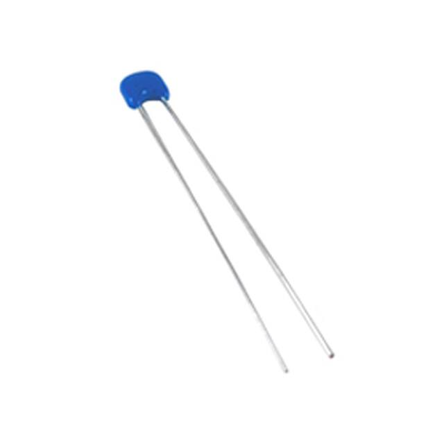

C A P A C I T O R S Disc type capacitors with leads High voltage ceramic capacitors, automotive grade, safety standard approved REACH SVHC-Free RoHS Cl Br Pb Halogen Free Lead Free CS series FEATURES AEC-Q200 compliant. 1,000 cycles guaranteed under heat shock testing at –55°C to +125°C. For use in Y capacitor for battery chargers of automobile (EV, PHEV). Compliant with IEC and the safety standards of various countries. Withstand voltage is 2,600V AC. Conform to RoHS directive due to lead(Pb) free of lead-wire and internal solder material. Compatible with halogen-free external resin coating. APPLICATION Y capacitor for automotive battery chargers or air conditioners PART NUMBER CONSTRUCTION CS 80 ZU 2GA 222 M A □ K A Series name Type Temperature characteristics Rated voltage Nominal capacitance Capacitance tolerance Grade classification Lead-wire type Application classification Internal code 45 65 70 75 80 85 95 11  SL +350 to –1,000ppm/°C B ±10% ZU (Z5U) +22, -56% 2GA X1:440V AC Y2:300V AC 100 10pF J ±5% 221 220pF K ±10% M ±20% 472 4,700pF A For use in automobiles G Long lead N Short lead V K Safety standard approved A Halogen-free Taping Please refer to P-3 about the product dimensions. OPERATING TEMPERATURE RANGE Temperature characteristics Operating temperature (°C) Storage temperature (°C) SL –55 to 125 –55 to 125 B –55 to 125 –55 to 125 ZU(Z5U) –55 to 125 –55 to 125 The maximum operating temperature of +125°C includes capacitor self-generated heat of up to 20°C. After capacitor is mounted on board, the storage temperature range is applied. STANDARD LEAD-WIRE SHAPES Dimemsions in mm 25min. *2 T 4max. 4max. 5±1 *2 Vertical kink D*1 T F *2 16+1.5 –0.5 D*1 4max. 4max. T Symbol V : Taping 4max. D*1 Symbol N : Bulk/short leads 5±1 Symbol G : Bulk/long leads ø0.6±0.05 F F ø0.6±0.05 ø0.6±0.05 TDK’s standard product is vertical kink. TDK recommends short leads for bulk products. *1 Body diameter (D) is reference value if D is smaller than maximum dimension of lead to lead distance (F). *2 Coating on leads shall not extend beyond the bottom of vertical kink. RoHS Directive Compliant Product: See the following for more details. https://product.tdk.com/en/environment/rohs/index.html Halogen-free: Indicate that Cl content is less than 900ppm, Br content is less than 900ppm, and that the total Cl and Br content is less than 1500ppm. Please be sure to request delivery specifications that provide further details on the features and specifications of the products for proper and safe use. Please note that the contents may change without any prior notice due to reasons such as upgrading. (1/5) 20210802 leaddisc_automotive_cs_en.fm C A P A C I T O R S Overview of CS series CERTIFIED STATUS OF VARIOUS COUNTRIES Safety standard IEC standard No. Standard No. BSI BS EN60384-14 IEC 60384-14 BS EN60065 (8.8, 14.2) BS EN60384-14 VDE SEV SEMKO NEMKO DEMKO FIMKO IMQ SAA CSA UL CQC Temperature characteristics Sub-class Rated voltage KM37103 EN 60384-14 X1,Y2 X1:440V AC Y2:300V AC X1 Y2 440V AC 300V AC SL,B,Z5U IEC 60384-14 CSA-E60384-14 UL60384-14 IEC 60384-14 KTL Approval report No.* Xiamen K60384-14 40017930 19.0043 1910408 P19223652 D-04986 FI 140177 V3692 CS6268 1785515 E37861 CQC10001052862 SU03047-12006 SU03047-12008 * Certificate numbers shall be changed owing to the revisions of the related standards and renewal of certificate. RECOMMENDED FLOW PROFILE Soldering Preheating Natural cooling T: Temperature T2 T1 t1 t2 t3 t: Time Preheating Temp. T1 110°C min. Time t1 30 to 60s. Peak Temp. T2 260°C Time t2 Within 10s. Natural cooling Time t3 Over 60s. Please be sure to request delivery specifications that provide further details on the features and specifications of the products for proper and safe use. Please note that the contents may change without any prior notice due to reasons such as upgrading. (2/5) 20210802 leaddisc_automotive_cs_en.fm C A P A C I T O R S CS series MARKINGS Item 1.Series 2.Nominal capacitance 3.Capacitance tolerance 4.Rated voltage Eac Markings CS 10 J 440∼X1 300∼Y2 5.TDK’s trademark 6.Date code 7.Applications Description CS series 10pF ±5% X1:440V AC Y2:300V AC Production base code 04 2020.4 For automobile — (underscore below date of production) Marking example CS10J 04 (Marking position is reference.)  Year The and month of production: last digit of year + month denoted by 1, 2, 3, 4, 5, 6, 7, 8, 9, O (October), N (November), or D (December). expression has become simplified due to a revision in the standards. RATED VOLTAGE Eac: X1:440V, Y2:300V CAPACITANCE AND DIMENSIONS Temperature characteristics Capacitance Capacitance tolerance SL SL SL SL SL SL B B B B B B Z5U Z5U Z5U Z5U Z5U 10pF 15pF 22pF 33pF 47pF 68pF 100pF 150pF 220pF 330pF 470pF 680pF 1,000pF 1,500pF 2,200pF 3,300pF 4,700pF ±5% ±5% ±5% ±5% ±5% ±5% ±10% ±10% ±10% ±10% ±10% ±10% ±20% ±20% ±20% ±20% ±20% Dimensions (mm) F Dmax. * Tmax. (applied to bulk) (7.0) 7.0 7.5±1.5 (7.0) 7.0 7.5±1.5 (7.0) 7.0 7.5±1.5 (7.0) 7.0 7.5±1.5 (8.0) 7.0 7.5±1.5 9.0 7.0 7.5±1.5 (7.0) 7.0 7.5±1.5 (7.0) 7.0 7.5±1.5 (7.0) 7.0 7.5±1.5 (7.5) 7.0 7.5±1.5 9.0 7.0 7.5±1.5 9.5 7.0 7.5±1.5 (7.0) 7.0 7.5±1.5 (8.0) 7.0 7.5±1.5 9.5 7.0 7.5±1.5 12.0 7.0 7.5±1.5 13.5 7.0 7.5±1.5 Part numbers F (applied to taping) 7.5±0.8 7.5±0.8 7.5±0.8 7.5±0.8 7.5±0.8 7.5±0.8 7.5±0.8 7.5±0.8 7.5±0.8 7.5±0.8 7.5±0.8 7.5±0.8 7.5±0.8 7.5±0.8 7.5±0.8 7.5±0.8 7.5±0.8 Bulk/long leads (Symbol: G) Bulk/short leads (Symbol: N) Taping (Symbol: V) CS45SL2GA100JAGKA CS45SL2GA150JAGKA CS45SL2GA220JAGKA CS45SL2GA330JAGKA CS45SL2GA470JAGKA CS45SL2GA680JAGKA CS65-B2GA101KAGKA CS65-B2GA151KAGKA CS65-B2GA221KAGKA CS70-B2GA331KAGKA CS75-B2GA471KAGKA CS85-B2GA681KAGKA CS65ZU2GA102MAGKA CS75ZU2GA152MAGKA CS80ZU2GA222MAGKA CS95ZU2GA332MAGKA CS11ZU2GA472MAGKA CS45SL2GA100JANKA CS45SL2GA150JANKA CS45SL2GA220JANKA CS45SL2GA330JANKA CS45SL2GA470JANKA CS45SL2GA680JANKA CS65-B2GA101KANKA CS65-B2GA151KANKA CS65-B2GA221KANKA CS70-B2GA331KANKA CS75-B2GA471KANKA CS85-B2GA681KANKA CS65ZU2GA102MANKA CS75ZU2GA152MANKA CS80ZU2GA222MANKA CS95ZU2GA332MANKA CS11ZU2GA472MANKA CS45SL2GA100JAVKA CS45SL2GA150JAVKA CS45SL2GA220JAVKA CS45SL2GA330JAVKA CS45SL2GA470JAVKA CS45SL2GA680JAVKA CS65-B2GA101KAVKA CS65-B2GA151KAVKA CS65-B2GA221KAVKA CS70-B2GA331KAVKA CS75-B2GA471KAVKA CS85-B2GA681KAVKA CS65ZU2GA102MAVKA CS75ZU2GA152MAVKA CS80ZU2GA222MAVKA CS95ZU2GA332MAVKA CS11ZU2GA472MAVKA  The values in parentheses "( )" are reference values. Click the part number for details.  Reference values are applied to bulk products. • Please refer to p-4 about the taping dimemsions. • For more information about products with other capacitance or other data, please contact us. Please be sure to request delivery specifications that provide further details on the features and specifications of the products for proper and safe use. Please note that the contents may change without any prior notice due to reasons such as upgrading. (3/5) 20210802 leaddisc_automotive_cs_en.fm C A P A C I T O R S CS series TAPING DIMENSIONS P T D*1 P2 h F C*2 S t W0 W L W1 H0 P1 W2 H0 A h P0 D0 ød Item Symbols Dimensions (mm) Body diameter D Refer to P-3 Body thickness Lead-wire diameter Pitch of component Feed hole pitch Feed hole center to lead-wire Feed hole center to component center Lead-to lead distance Component alignment Carrier tape width Adhesive tape width Hole position Adhesive tape position Bottom of kink from tape center Lead-wire protrusion Feed hole diameter Carrier tape thickness (Including adhesive tape) Length of snipped lead-wire Coating on lead-wire Height of kink Spring action T ød P P0 P1 P2 F h W W0 W1 W2 H0 D0 Refer to P-3 0.6±0.05 15.0±1.0 15.0±0.3 3.75±0.7 7.5±1.3 7.5±0.8 0±2.0 18.0+1.0,–0.5 10.0 Min. 9.0±0.5 4.0 Max. 16.0+1.5,–0.5 1.0 Max. 4.0±0.2 t 0.6±0.3 Including adhesive tape L C A S 11.0 Max. 4.0 Max. 4.0 Max. 2.0 Max. *2 Coating on leads shall not extend beyond the bottom of vertical kink. Measuring point is bottom kink AMMO PACK INNER BOX SIZE Remarks *1 Body diameter (D) is reference value if D is smaller than maximum dimension of lead to lead distance (F). Including the slant of body Excepting the tape splicing part Including the slanting body due to bending lead-wire Measuring point is bottom kink Including the slanting body due to bending lead-wire Adhesive tape do not stick out the tape PACKAGE QUANTITY Package quantity Type Taping (pieces / box) 1000 1000 320max. CS Bulk (pieces / bag) x. ma 340max. 60 Dimensions in mm Please be sure to request delivery specifications that provide further details on the features and specifications of the products for proper and safe use. Please note that the contents may change without any prior notice due to reasons such as upgrading. (4/5) 20210802 leaddisc_automotive_cs_en.fm C A P A C I T O R S REMINDERS FOR USING THESE PRODUCTS Before using these products, be sure to request the delivery specifications. SAFETY REMINDERS Please pay sufficient attention to the warnings for safe designing when using this products. REMINDERS Do not use or store in locations where there are conditions such as gas corrosion (salt, acid, alkali, etc.). Before soldering, be sure to preheat components. The preheating temperature should be set so that the temperature difference between the solder temperature and product temperature does not exceed 150°C. Soldering corrections after mounting should be within the range of the conditions determined in the specifications. If overheated, a short circuit, performance deterioration, or lifespan shortening may occur. Self heating (temperature increase) occurs when the power is turned ON, so the tolerance should be sufficient for the set thermal design. Do not use for a purpose outside of the contents regulated in the delivery specifications. The products listed on this catalog are intended for use in automotive electronic equipment under a normal operation and use condition. The products are not designed or warranted to meet the requirements of the applications listed below, whose performance and/or quality require a more stringent level of safety or reliability, or whose failure, malfunction or trouble could cause serious damage to society, person or property. If you intend to use the products in the applications listed below or if you have special requirements exceeding the range or conditions set forth in the each catalog, please contact us. (1) Aerospace/aviation equipment (2) Transportation equipment (electric trains, ships, etc.) (3) Medical equipment (4) Power-generation control equipment (5) Atomic energy-related equipment   (6) Seabed equipment (7) Transportation control equipment (8) Public information-processing equipment (9) Military equipment (10) Electric heating apparatus, burning equipment (11) Disaster prevention/crime prevention equipment (12) Safety equipment (13) Other applications that are not considered general-purpose applications Please refer to the guideline of notabilia for fixed ceramic capacitors issued by JEITA(Japan Electronics and Information Technology Association, EIAJ RCR-2335). This guideline describes general precautions* for using fixed ceramic capacitors. Please carefully confirm it and use capacitors safely. * Items for check, explanation/reason/concrete example and failure examples, etc. When designing your equipment even for general-purpose applications, you are kindly requested to take into consideration securing protection circuit/device or providing backup circuits in your equipment. Please be sure to request delivery specifications that provide further details on the features and specifications of the products for proper and safe use. Please note that the contents may change without any prior notice due to reasons such as upgrading. (5/5) 20210802 leaddisc_automotive_cs_en.fm
