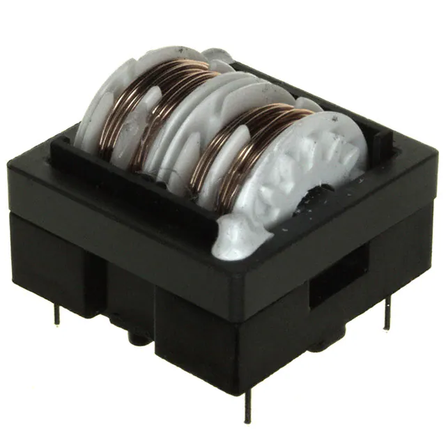

Common Mode Choke Coils(Line Filters) For power line, Closed magnetic circuit core type HF Series Type: Vertical type HF2316/HF2318 /HF2922 For large inductance HF2024/HF2422/HF2430/HF2826/HF2836/HF3545 Issue date: December 2010 • All specifications are subject to change without notice. • Conformity to RoHS Directive: This means that, in conformity with EU Directive 2002/95/EC, lead, cadmium, mercury, hexavalent chromium, and specific bromine-based flame retardants, PBB and PBDE, have not been used, except for exempted applications. (1/10) Common Mode Choke Coils(Line Filters) for AC Power Supply Conformity to RoHS Directive Closed Magnetic Circuit Core Type HF Series TDK common mode choke coils(line filters) are used in a wide range of prevention of electromagnetic interference(EMI) and radio frequency interference(RFI) from power supply lines and for prevention of multifunctioning of products such as measuring equipment and system equipment. FEATURES • Wide range of selection. • High impedance at applicable frequency. • High self-resonant frequency. PRODUCT IDENTIFICATION HF (1) (2) V - A (3) (4) Y (5) R (6) - 01 (7) (1) Core shape HF: Square shaped closed magnetic circuit core type (2) Dimensional code Width×Depth (3) External shape code V: Vertical type H: Horizontal type (4) High µ material (5) Inductance value  Example) 133:13mH (6) Rated current value Example) 3R0:3.0A (7) Product management number SELECTION CHART Series Configuration Vertical type HF Closed magnetic circuit core types Type Inductance value (mH)min. Rated current (A) Handling power∗ L×I2(mH×A2) Weight (g)typ. HF2316 HF2318 HF2922 HF2024 HF2422 HF2430 HF2826 HF2836 HF3545 1.2 to 145 1.5 to 100 3.2 to 100 0.6 to 33 2.4 to 68 2.4 to 68 1.8 to 35 1.8 to 35 4.7 to 33 0.2 to 3 0.3 to 3 0.5 to 3 0.3 to 3 0.4 to 2.5 0.4 to 2.5 1 to 4 1 to 4 1.5 to 4 10.5 13 29 7.6 15 15 35 35 75 10.5 13.5 20 10 19.5 19.5 28 30 65 Minimum package quantity (pieces/box) 800 800 440 800 540 400 480 400 140 ∗ Handling power=(Inductance value)×(Current)2. It is possible to design within the range below this value. [Example] The coil for 2A can make even the inductance of 2.5mH or less a product for handling power 10. • Conformity to RoHS Directive: This means that, in conformity with EU Directive 2002/95/EC, lead, cadmium, mercury, hexavalent chromium, and specific bromine-based flame retardants, PBB and PBDE, have not been used, except for exempted applications. • All specifications are subject to change without notice. 001-02 / 20101125 / e93_hf.fm (2/10) Closed Magnetic Circuit Core Type HF Series FEATURES • As closed magnetic circuit core as same as a toroidal core, even at its compact size, it offers large inductance and keeps the high impedance levels required in high frequency ranges. • Since it uses a closed magnetic circuit core, the leakage flux is relatively small, allowing designers to improve the mounting density of their circuits. HF2316-A(SQUARE SHAPED CLOSED MAGNETIC CIRCUIT CORE) TYPE SHAPES AND DIMENSIONS/CIRCUIT DIAGRAM TYPICAL ELECTRICAL CHARACTERISTICS IMPEDANCE vs. FREQUENCY CHARACTERISTICS 23max. 16max. 20max. 1000 ø0.8 2 15.5max. 4 10±0.5 1 Impedance (kΩ) 3.5±1 100 13±0.5 3 1 4 2 3 10 1 Weight: 10.5g typ. Recommended hole diameter: ø1.3 Dimensions in mm 0.1 0.01 Part No. HF2316-A144Y0R2-01 HF2316-A823Y0R3-01 HF2316-A533Y0R4-01 HF2316-A403Y0R5-01 HF2316-A263Y0R6-01 HF2316-A203Y0R7-01 HF2316-A153Y0R8-01 HF2316-A103Y1R0-01 HF2316-A652Y1R2-01 HF2316-A452Y1R5-01 HF2316-A242Y2R0-01 HF2316-A172Y2R5-01 HF2316-A122Y3R0-01 203Y 153Y 103Y 652Y 452Y 242Y 172Y 122Y 0.1 1 Frequency (MHz) 10 100 RATINGS ELECTRICAL CHARACTERISTICS (STANDARD LINE UP) Inductance (mH)min. 145 82 53 40 26 20 15 10 6.5 4.5 2.4 1.7 1.2 144Y 823Y 533Y 403Y 263Y DC resistance (Ω )max. 6.8 4 2.4 1.7 1.2 1 0.7 0.5 0.3 0.2 0.12 0.09 0.06 • Measuring equipment of inductance value: LCR meter(HP4261A, HP4263B or equivalent)[f=1kHz] Rated current Iac(A)max. 0.2 0.3 0.4 0.5 0.6 0.7 0.8 1 1.2 1.5 2 2.5 3 Item Standard value Conditions Rated voltage(V) 80 to 280 50Hz/60Hz Dielectric withstanding Between each winding for 2000 voltage(V) 1 minute Insulation resistance Between each winding for 100min. (MΩ ) DC.500V Temperature rise(°C) 45max. With line resistance Operating temperature Including self-temperature –20 to +120 range(°C) rise Storage temperature –20 to +85 range(°C) 260±5°C, 10±1sec Solder bath method Resistance to soldering tenperature∗1 350±5°C, 5sec max. Soldering iron method Applicable safety Electrical Appliance and Material Safety Law ("DENAN"), IEC60065, UL6500, CSA C22.2 standard∗2 ∗1 Pb free solder(Sn-3Ag-0.5Cu) ∗2 However, this product is not recognized by each regulations. PACKAGING QUANTITIES HF2316-A 800pieces/box • All specifications are subject to change without notice. 001-02 / 20101125 / e93_hf.fm (3/10) HF2318-A(SQUARE SHAPED CLOSED MAGNETIC CIRCUIT CORE) TYPE SHAPES AND DIMENSIONS/CIRCUIT DIAGRAM TYPICAL ELECTRICAL CHARACTERISTICS IMPEDANCE vs. FREQUENCY CHARACTERISTICS 23max. 18max. 22max. 1000 ø0.8 2 15.5max. 4 10±0.5 1 Impedance (kΩ) 3.5±1 100 13±0.5 3 1 4 2 3 104Y 633Y 503Y 303Y 243Y 10 1 Weight: 13.5g typ. Recommended hole diameter: ø1.3 Dimensions in mm 0.1 0.01 Part No. HF2318-A104Y0R3-01 HF2318-A633Y0R4-01 HF2318-A503Y0R5-01 HF2318-A303Y0R6-01 HF2318-A243Y0R7-01 HF2318-A213Y0R8-01 HF2318-A163Y1R0-01 HF2318-A113Y1R2-01 HF2318-A752Y1R5-01 HF2318-A322Y2R0-01 HF2318-A222Y2R5-01 HF2318-A152Y3R0-01 0.1 1 Frequency (MHz) 10 100 RATINGS ELECTRICAL CHARACTERISTICS (STANDARD LINE UP) Inductance (mH)min. 100 63 50 30 24 21 16 11 7.5 3.2 2.2 1.5 213Y 163Y 113Y 752Y 322Y 222Y 152Y DC resistance (Ω )max. 3.6 2.2 1.8 1.1 1 0.75 0.5 0.35 0.26 0.12 0.1 0.07 • Measuring equipment of inductance value: LCR meter(HP4261A, HP4263B or equivalent)[f=1kHz] Rated current Iac(A)max. 0.3 0.4 0.5 0.6 0.7 0.8 1 1.2 1.5 2 2.5 3 Item Standard value Conditions Rated voltage(V) 80 to 280 50Hz/60Hz Dielectric withstanding Between each winding for 2000 voltage(V) 1 minute Insulation resistance Between each winding for 100min. (MΩ ) DC.500V Temperature rise(°C) 45max. With line resistance Operating temperature Including self-temperature –20 to +120 range(°C) rise Storage temperature –20 to +85 range(°C) 260±5°C, 10±1sec Solder bath method Resistance to soldering tenperature∗1 350±5°C, 5sec max. Soldering iron method Applicable safety Electrical Appliance and Material Safety Law ("DENAN"), IEC60065, UL6500, CSA C22.2 standard∗2 ∗1 Pb free solder(Sn-3Ag-0.5Cu) ∗2 However, this product is not recognized by each regulations. PACKAGING QUANTITIES HF2316-A 800pieces/box • All specifications are subject to change without notice. 001-02 / 20101125 / e93_hf.fm (4/10) HF2922-A(SQUARE SHAPED CLOSED MAGNETIC CIRCUIT CORE) TYPE SHAPES AND DIMENSIONS/CIRCUIT DIAGRAM TYPICAL ELECTRICAL CHARACTERISTICS IMPEDANCE vs. FREQUENCY CHARACTERISTICS 29max. 22max. 1000 104Y 28max. 503Y ø0.8 1 Impedance (kΩ) 3.5±1 100 18max. 10±0.5 4 1 4 2 3 323Y 203Y 10 133Y 952Y 1 502Y 322Y 2 Weight: 20g typ. 3 13±0.5 Recommended hole diameter: ø1.3 Dimensions in mm Part No. HF2922-A104Y0R5-01 HF2922-A503Y0R8-01 HF2922-A323Y1R0-01 HF2922-A203Y1R2-01 HF2922-A133Y1R6-01 HF2922-A952Y2R0-01 HF2922-A502Y2R5-01 HF2922-A322Y3R0-01 DC resistance (Ω )max. 1.7 0.95 0.59 0.38 0.25 0.19 0.12 0.08 • Measuring equipment of inductance value: LCR meter(HP4261A, HP4263B or equivalent)[f=1kHz] PACKAGING QUANTITIES HF2316-A 0.1 1 Frequency (MHz) 10 100 RATINGS ELECTRICAL CHARACTERISTICS (STANDARD LINE UP) Inductance (mH)min. 100 50 32 20 13 9.5 5 3.2 0.1 0.01 440pieces/box Rated current Iac(A)max. 0.5 0.8 1 1.2 1.6 2 2.5 3 Item Standard value Conditions Rated voltage(V) 80 to 280 50Hz/60Hz Dielectric withstanding Between each winding for 2000 voltage(V) 1 minute Insulation resistance Between each winding for 100min. (MΩ ) DC.500V Temperature rise(°C) 45max. With line resistance Operating temperature Including self-temperature –20 to +120 range(°C) rise Storage temperature –20 to +85 range(°C) 260±5°C, 10±1sec Solder bath method Resistance to soldering tenperature∗1 350±5°C, 5sec max. Soldering iron method Electrical Appliance and Material Safety Applicable safety Law ("DENAN"), IEC60065, UL6500, CSA C22.2 standard∗2 ∗1 Pb free solder(Sn-3Ag-0.5Cu) ∗2 However, this product is not recognized by each regulations. • All specifications are subject to change without notice. 001-02 / 20101125 / e93_hf.fm (5/10) HF2024(SQUARE SHAPED CLOSED MAGNETIC CIRCUIT CORE) TYPE SHAPES AND DIMENSIONS/CIRCUIT DIAGRAM TYPICAL ELECTRICAL CHARACTERISTICS IMPEDANCE vs. FREQUENCY CHARACTERISTICS 22.5max. 100 24max. 4.5±1 123Y 622Y 18max. 10±0.5 ø0.8 Impedance (kΩ) 10 13±0.5 1 4 L1 L2 2 242Y 1 3 601Y Weight: 10g typ. 0.1 Recommended hole diameter: ø1.3 Dimensions in mm 0.01 Inductance (mH)min. HF2024-333Y0R3-201 HF2024-253Y0R4-T01 HF2024-183Y0R5-201 HF2024-123Y0R6-201 HF2024-123Y0R8-T01 HF2024-103Y0R7-T01 HF2024-682Y0R8-201 HF2024-622Y1R0-T01 HF2024-352Y1R3-T01 HF2024-242Y1R7-T01 HF2024-102Y2R0-T01 HF2024-601Y3R0-T01 33 25 18 12 12 10 6.8 6.2 3.5 2.4 1 0.6 0.1 1 Frequency (MHz) 10 100 RATINGS ELECTRICAL CHARACTERISTICS Part No. 0.01 DC resistance (Ω)max. 3.1 2 1.45 1.3 0.92 0.9 0.66 0.5 0.27 0.18 0.2 0.06 • Measuring equipment of inductance value: LCR meter(HP4261A, HP4263B or equivalent)[f=1kHz] Rated current Iac (A)max. 0.3 0.4 0.5 0.6 0.8 0.7 0.8 1 1.3 1.7 2 3 Item Standard value Conditions Rated voltage(V) 80 to 250 50Hz/60Hz Dielectric withstanding Between each winding for 2000 voltage(V) 1 minute Insulation resistance Between each winding for 100min. (MΩ ) DC.500V Temperature rise(°C) 50max. With line resistance Operating temperature Including self-temperature –20 to +120 range(°C) rise Storage temperature –20 to +85 range(°C) 260±5°C, 10±1sec Solder bath method Resistance to soldering tenperature∗1 350±5°C, 5sec max. Soldering iron method Applicable safety Electrical Appliance and Material Safety Law ("DENAN") standard∗2 ∗1 Pb free solder(Sn-3Ag-0.5Cu) ∗2 However, this product is not recognized by each regulations. PACKAGING QUANTITIES HF2024 800pieces/box • All specifications are subject to change without notice. 001-02 / 20101125 / e93_hf.fm (6/10) Closed Magnetic Circuit Core Type HF Series FEATURES • This series employs two outer magnetic path limbs design with windings on the center magnetic path limb of double-square shaped closed magnetic circuit ferrite core to reduce leakage flux. • This filter uses the same closed magnetic circuit core as a toroidal core and therefore, even at its compact size, it offers large inductance and suppresses noise up to in high frequency ranges. HF2422(DOUBLE-SQUARE SHAPED CLOSED MAGNETIC CIRCUIT CORE) TYPE SHAPES AND DIMENSIONS/CIRCUIT DIAGRAM TYPICAL ELECTRICAL CHARACTERISTICS IMPEDANCE vs. FREQUENCY CHARACTERISTICS 1 4 26max. 15±0.5 1000 100 21±0.5 3 26max. 22max. 1 ø0.8x4 Impedance (kΩ) 2 4 L1 L2 2 3 4±1 Weight: 19.5g typ. 10 203Y 103Y Recommended hole diameter: ø1.3 Dimensions in mm 1 0.1 0.01 Part No. Inductance (mH)min. HF2422-683Y0R4-T01 HF2422-453Y0R5-T01 HF2422-333Y0R6-T01 HF2422-253Y0R8-T01 HF2422-203Y1R0-T01 HF2422-103Y1R2-T01 HF2422-452Y1R5-T01 HF2422-392Y1R8-T01 HF2422-332Y2R0-T01 HF2422-242Y2R5-T01 68 45 33 25 20 10 4.5 3.9 3.3 2.4 452Y 392Y 332Y 242Y 0.1 1 Frequency (MHz) 10 100 RATINGS ELECTRICAL CHARACTERISTICS DC resistance (Ω)max. 2.3 1.65 1.2 0.88 0.64 0.38 0.19 0.15 0.11 0.09 • Measuring equipment of inductance value: LCR meter(HP4261A, HP4263B or equivalent)[f=1kHz] PACKAGING QUANTITIES HF2422 683Y 453Y 333Y 253Y Rated current Iac (A)max. 0.4 0.5 0.6 0.8 1 1.2 1.5 1.8 2 2.5 Item Standard value Conditions Rated voltage(V) 80 to 280 50Hz/60Hz Dielectric withstanding Between each winding for 2000 voltage(V) 1 minute Insulation resistance Between each winding for 100min. (MΩ ) DC.500V Temperature rise(°C) 50max. With line resistance Operating temperature Including self-temperature –20 to +120 range(°C) rise Storage temperature –20 to +85 range(°C) 260±5°C, 10±1sec Solder bath method Resistance to soldering tenperature∗1 350±5°C, 5sec max. Soldering iron method Applicable safety Electrical Appliance and Material Safety Law ("DENAN"), IEC60065, UL6500, CSA C22.2 standard∗2 ∗1 Pb free solder(Sn-3Ag-0.5Cu) ∗2 However, this product is not recognized by each regulations. 540pieces/box • All specifications are subject to change without notice. 001-02 / 20101125 / e93_hf.fm (7/10) 1000 683Y 453Y 4±1 31.5max. HF2430(DOUBLE-SQUARE SHAPED CLOSED MAGNETIC CIRCUIT CORE) TYPE SHAPES AND DIMENSIONS/CIRCUIT DIAGRAM TYPICAL ELECTRICAL CHARACTERISTICS IMPEDANCE vs. FREQUENCY 26max. 19max. CHARACTERISTICS 4 100 1 4 L1 2 13±0.5 3 Impedance (kΩ) 1 10±0.5 ø0.8x4 L2 2 3 Weight: 19.5g typ. 333Y 253Y 10 203Y Recommended hole diameter: ø1.3 Dimensions in mm 103Y 1 452Y 392Y 332Y 242Y 0.1 0.01 Inductance (mH)min. HF2430-683Y0R4-T01 HF2430-453Y0R5-T01 HF2430-333Y0R6-T01 HF2430-253Y0R8-T01 HF2430-203Y1R0-T01 HF2430-103Y1R2-T01 HF2430-452Y1R5-T01 HF2430-392Y1R8-T01 HF2430-332Y2R0-T01 HF2430-242Y2R5-T01 68 45 33 25 20 10 4.5 3.9 3.3 2.4 DC resistance (Ω)max. 2.3 1.65 1.2 0.88 0.64 0.38 0.19 0.15 0.11 0.09 • Measuring equipment of inductance value: LCR meter(HP4261A, HP4263B or equivalent)[f=1kHz] PACKAGING QUANTITIES HF2430 1 Frequency (MHz) 10 100 RATINGS ELECTRICAL CHARACTERISTICS Part No. 0.1 Rated current Iac (A)max. 0.4 0.5 0.6 0.8 1 1.2 1.5 1.8 2 2.5 Item Standard value Conditions Rated voltage(V) 80 to 280 50Hz/60Hz Dielectric withstanding Between each winding for 2000 voltage(V) 1 minute Insulation resistance Between each winding for 100min. (MΩ ) DC.500V Temperature rise(°C) 50max. With line resistance Operating temperature Including self-temperature –20 to +120 range(°C) rise Storage temperature –20 to +85 range(°C) 260±5°C, 10±1sec Solder bath method Resistance to soldering tenperature∗1 350±5°C, 5sec max. Soldering iron method Applicable safety Electrical Appliance and Material Safety Law ("DENAN"), IEC60065, UL6500, CSA C22.2 standard∗2 ∗1 Pb free solder(Sn-3Ag-0.5Cu) ∗2 However, this product is not recognized by each regulations. 400pieces/box • All specifications are subject to change without notice. 001-02 / 20101125 / e93_hf.fm (8/10) HF2826(DOUBLE-SQUARE SHAPED CLOSED MAGNETIC CIRCUIT CORE) TYPE SHAPES AND DIMENSIONS/CIRCUIT DIAGRAM TYPICAL ELECTRICAL CHARACTERISTICS IMPEDANCE vs. FREQUENCY CHARACTERISTICS 1 4 20±0.5 30.5max. 1000 353Y 100 2 3 24.0±0.5 26max. 1 ø0.8x4 Impedance (kΩ) 30.5max. 4 L1 2 L2 3 10 802Y Weight: 28g typ. 4±1 1 Recommended hole diameter: ø1.3 Dimensions in mm 0.1 0.01 Part No. Inductance (mH)min. HF2826-353Y1R0-T01 HF2826-253Y1R2-T01 HF2826-203Y1R5-T01 HF2826-123Y1R8-T01 HF2826-802Y2R0-T01 HF2826-562Y2R5-T01 HF2826-472Y2R8-T01 HF2826-332Y3R0-T01 HF2826-182Y4R0-T01 35 25 20 12 8 5.6 4.7 3.3 1.8 562Y 472Y 332Y 182Y 0.1 1 Frequency (MHz) 10 100 RATINGS ELECTRICAL CHARACTERISTICS DC resistance (Ω)max. 0.78 0.56 0.41 0.27 0.18 0.13 0.1 0.088 0.05 • Measuring equipment of inductance value: LCR meter(HP4261A, HP4263B or equivalent)[f=1kHz] PACKAGING QUANTITIES HF2826 253Y 203Y 480pieces/box Rated current Iac (A)max. 1 1.2 1.5 1.8 2 2.5 2.8 3 4 Item Standard value Conditions Rated voltage(V) 80 to 280 50Hz/60Hz Dielectric withstanding Between each winding for 2000 voltage(V) 1 minute Insulation resistance Between each winding for 100min. (MΩ ) DC.500V Temperature rise(°C) 50max. With line resistance Operating temperature Including self-temperature –20 to +120 range(°C) rise Storage temperature –20 to +85 range(°C) 260±5°C, 10±1sec Solder bath method Resistance to soldering tenperature∗1 350±5°C, 5sec max. Soldering iron method Applicable safety Electrical Appliance and Material Safety Law ("DENAN"), IEC60065, UL6500, CSA C22.2 standard∗2 ∗1 Pb free solder(Sn-3Ag-0.5Cu) ∗2 However, this product is not recognized by each regulations. • All specifications are subject to change without notice. 001-02 / 20101125 / e93_hf.fm (9/10) HF2836(DOUBLE-SQUARE SHAPED CLOSED MAGNETIC CIRCUIT CORE) TYPE SHAPES AND DIMENSIONS/CIRCUIT DIAGRAM TYPICAL ELECTRICAL CHARACTERISTICS IMPEDANCE vs. FREQUENCY CHARACTERISTICS 30.5max. 22max. 353Y 4±1 36max. 1000 100 203Y 4 1 L1 2 13±0.5 3 Impedance (kΩ) 4 10±0.5 ø0.8x4 1 253Y L2 3 2 Weight: 30g typ. Recommended hole diameter: ø1.2 to 1.3 Dimensions in mm 10 802Y 1 562Y 472Y 332Y 182Y 0.1 0.01 Inductance (mH)min. HF2836-353Y1R0-T01 HF2836-253Y1R2-T01 HF2836-203Y1R5-T01 HF2836-123Y1R8-T01 HF2836-802Y2R0-T01 HF2836-562Y2R5-T01 HF2836-472Y2R8-T01 HF2836-332Y3R0-T01 HF2836-182Y4R0-T01 35 25 20 12 8 5.6 4.7 3.3 1.8 DC resistance (Ω)max. 0.78 0.56 0.41 0.27 0.18 0.13 0.1 0.088 0.05 • Measuring equipment of inductance value: LCR meter(HP4261A, HP4263B or equivalent)[f=1kHz] PACKAGING QUANTITIES HF2836 1 Frequency (MHz) 10 100 RATINGS ELECTRICAL CHARACTERISTICS Part No. 0.1 800pieces/box Rated current Iac (A)max. 1 1.2 1.5 1.8 2 2.5 2.8 3 4 Item Standard value Conditions Rated voltage(V) 80 to 280 50Hz/60Hz Dielectric withstanding Between each winding for 2000 voltage(V) 1 minute Insulation resistance Between each winding for 100min. (MΩ ) DC.500V Temperature rise(°C) 50max. With line resistance Operating temperature Including self-temperature –20 to +120 range(°C) rise Storage temperature –20 to +85 range(°C) 260±5°C, 10±1sec Solder bath method Resistance to soldering tenperature∗1 350±5°C, 5sec max. Soldering iron method Applicable safety Electrical Appliance and Material Safety Law ("DENAN"), IEC60065, UL6500, CSA C22.2 standard∗2 ∗1 Pb free solder(Sn-3Ag-0.5Cu) ∗2 However, this product is not recognized by each regulations. • All specifications are subject to change without notice. 001-02 / 20101125 / e93_hf.fm (10/10) HF3545(DOUBLE-SQUARE SHAPED CLOSED MAGNETIC CIRCUIT CORE) TYPE SHAPES AND DIMENSIONS/CIRCUIT DIAGRAM TYPICAL ELECTRICAL CHARACTERISTICS IMPEDANCE vs. FREQUENCY CHARACTERISTICS 37max. 26max. 333Y 4±1 45max. 1000 100 183Y 123Y 1 4 L1 L2 2 2 21±0.5 3 Impedance (kΩ) 4 15±0.5 ø1.2x6 1 3 Weight: 65g typ. Recommended hole diameter: ø1.7 Dimensions in mm 10 1 103Y 822Y 562Y 472Y 0.1 0.01 Inductance (mH)min. HF3545-333Y1R5-T01 HF3545-223Y1R8-T01 HF3545-183Y2R0-T01 HF3545-153Y2R2-T01 HF3545-123Y2R5-T01 HF3545-103Y2R7-T01 HF3545-822Y3R0-T01 HF3545-562Y3R5-T01 HF3545-472Y4R0-T01 33 22 18 15 12 10 8.2 5.6 4.7 DC resistance (Ω)max. 0.42 0.29 0.23 0.21 0.17 0.13 0.105 0.077 0.062 • Measuring equipment of inductance value: LCR meter(HP4261A, HP4263B or equivalent)[f=1kHz] PACKAGING QUANTITIES HF3545 1 Frequency (MHz) 10 100 RATINGS ELECTRICAL CHARACTERISTICS Part No. 0.1 140pieces/box Rated current Iac (A)max. 1.5 1.8 2 2.2 2.5 2.7 3 3.5 4 Item Standard value Conditions Rated voltage(V) 80 to 280 50Hz/60Hz Dielectric withstanding Between each winding for 2000 voltage(V) 1 minute Insulation resistance Between each winding for 100min. (MΩ ) DC.500V Temperature rise(°C) 50max. With line resistance Operating temperature Including self-temperature –20 to +120 range(°C) rise Storage temperature –20 to +85 range(°C) 260±5°C, 10±1sec Solder bath method Resistance to soldering tenperature∗1 350±5°C, 5sec max. Soldering iron method Applicable safety Electrical Appliance and Material Safety Law ("DENAN"), IEC60065, UL6500, CSA C22.2 standard∗2 ∗1 Pb free solder(Sn-3Ag-0.5Cu) ∗2 However, this product is not recognized by each regulations. • All specifications are subject to change without notice. 001-02 / 20101125 / e93_hf.fm
HF2826-562Y2R5-T01
物料型号: - TDK共模扼流圈HF系列,包括垂直型和闭磁路核心型。
器件简介: - 这些扼流圈用于电源线,以预防电磁干扰(EMI)和射频干扰(RFI),适用于多种测量设备和系统设备。
引脚分配: - 文档中没有提供具体的引脚分配图,但提供了产品的外形尺寸和电路图。
参数特性: - 提供了详细的产品识别方法,包括核心形状、尺寸代码、外观形状代码、高μ材料、电感值和额定电流值。 - 列出了不同型号的电感值范围、额定电流、处理功率、重量、最小包装数量。
功能详解: - 扼流圈具有高阻抗、高自谐振频率,使用闭磁路核心,即使体积小巧,也能提供大电感,保持高频范围内的高阻抗水平。 - 闭磁路核心减少了漏磁通,允许设计者提高电路的安装密度。
应用信息: - 主要用于电源线,以减少电磁和射频干扰,适用于多种设备。
封装信息: - 提供了不同型号的尺寸、重量、推荐孔径和包装数量。
