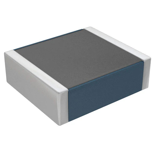

(1/3) 20010531 / e9413_acc.fm EMC Components ACC Series Ferrite Beads SMD FEATURES • With 4 types rated at 1.5A and 3 types rated at 3A, and with a range of frequency characteristics available for each type, the ACC series facilitates selection of the most appropriate part for any given application. • Effective EMC suppression over a broad band can be achieved simply be inserting this product into the DC power line on the circuit board. RECOMMENDED PC BOARD PATTERNS REFLOW AND FLOW SOLDERINGS SHAPES AND DIMENSIONS c L Resist W Terminal electrode a Ferrite b a Land pattern D Dimensions in mm T Insulation resin Dimensions in mm Shape HF201209 HF321611 HF322513 HF453215 HF575018 HF575032 HF635050 L 2±0.2 3.2±0.2 3.2±0.3 4.5±0.25 5.7±0.4 5.7±0.4 6.4±0.4 W 1.25±0.2 1.6±0.2 2.5±0.2 3.2±0.25 5±0.3 5±0.3 5±0.3 T 0.9±0.2 1.1±0.2 1.3±0.2 1.5±0.25 1.8±0.3 3.2±0.3 4.74±0.3 CIRCUIT DIAGRAM D 0.3±0.2 0.3±0.2 0.3±0.2 0.3±0.2 0.2 0.2 0.2 Type HFXXACC201209 HFXXACC321611 HFXXACC322513 HFXXACC453215 HFXXACC575018 HFXXACC575032 HFXXACC635050 b 1 2.2 2.2 3 4 4 4.5 c 1 1.4 2.3 3 5.8 5.8 5.8 ELECTRICAL CHARACTERISTICS Shape 201209 321611 No polarity 322513 453215 575018 575032 635050 ∗ • All specifications are subject to change without notice. a 1 1.1 1.1 1.5 2 2 2 Part No. Impedance (Ω)[100MHz] HF70ACC201209-X∗ HF50ACC201209-X HF30ACC201209-X HF70ACC321611-X HF50ACC321611-X HF30ACC321611-X HF70ACC322513-X HF50ACC322513-X HF30ACC322513-X HF70ACC453215-X HF50ACC453215-X HF30ACC453215-X HF70ACC575018-X HF50ACC575018-X HF30ACC575018-X HF70ACC575032-X HF50ACC575032-X HF30ACC575032-X HF70ACC635050-X HF50ACC635050-X HF30ACC635050-X 10±25% 11±25% 7±25% 26±25% 31±25% 19±25% 52±25% 60±25% 31±25% 120±25% 125±25% 70±25% 150±25% 180±25% 100±25% 300±25% 400±25% 270±25% 500±25% 600±25% 750±25% DC resistance (Ω)max. 0.03 0.03 0.03 0.04 0.04 0.04 0.05 0.05 0.05 0.05 0.05 0.05 0.04 0.04 0.04 0.04 0.04 0.04 0.04 0.04 0.04 Rated current (A)max. 1.5 1.5 1.5 1.5 1.5 1.5 1.5 1.5 1.5 1.5 1.5 1.5 3 3 3 3 3 3 3 3 3 X : Packaging style (T: Taping [ø180mm reel], TL: Taping [ø330mm reel]) (2/3) 20010531 / e9413_acc.fm EMC Components ACC Series Ferrite Beads SMD TYPICAL ELECTRICAL CHARACTERISTICS Z, X, R vs. FREQUENCY CHARACTERISTICS HF70ACC201209 HF50ACC201209 HF30ACC201209 HF70ACC321611 100 100 100 100 Z 10 Z 10 X Z, X, R(Ω) 1000 Z, X, R(Ω) 1000 Z, X, R(Ω) 1000 Z, X, R(Ω) 1000 Z 10 X Z 10 X R X 1 HF30ACC321611 100 100 Z, X, R(Ω) 1000 Z X 10 1 Z X 10 1 1000 HF30ACC322513 1 100 Z X 10 1 Z, X, R(Ω) 100 Z, X, R(Ω) 1000 R 10 100 ( Frequency MHz) 1 1 1000 HF70ACC575018 1 10 100 Frequency (MHz) 1 10 100 Frequency (MHz) 1000 10 100 Frequency (MHz) 100 X R 10 1 1 10 100 Frequency (MHz) • TEST EQUIPMENT:RF IMPEDANCE ANALYZER YHP4191A • All specifications are subject to change without notice. X 10 1000 1 1000 1 10 100 Frequency (MHz) 1000 100 X R 10 1 1 10 100 Frequency (MHz) Z 100 R 10 1 1000 1 X 10 100 Frequency (MHz) 1000 HF70ACC575032 1000 Z Z 100 X R 10 1 1000 HF30ACC453215 Z Z, X, R(Ω) Z, X, R(Ω) X 1 1000 Z R Z R HF30ACC575018 1000 100 1 X 10 100 Z 1000 HF50ACC575018 1000 10 Z HF50ACC453215 X 1000 1000 100 1 1000 Z R 10 100 Frequency (MHz) HF50ACC322513 1000 10 1 R 10 100 Frequency (MHz) HF70ACC453215 1000 1 1000 1000 R R 10 100 Frequency (MHz) 1 R 10 100 Frequency (MHz) 1 HF70ACC322513 Z, X, R(Ω) Z, X, R(Ω) 1000 1 1000 Z, X, R(Ω) HF50ACC321611 R 10 100 Frequency (MHz) 1 Z, X, R(Ω) 1000 Z, X, R(Ω) 10 100 Frequency (MHz) Z, X, R(Ω) R 1 Z, X, R(Ω) 1 1 10 100 Frequency (MHz) 1000 100 R 10 1 1 X 10 100 Frequency (MHz) 1000 (3/3) 20010531 / e9413_acc.fm EMC Components ACC Series Ferrite Beads SMD TYPICAL ELECTRICAL CHARACTERISTICS Z, X, R vs. FREQUENCY CHARACTERISTICS HF50ACC575032 HF30ACC575032 HF70ACC635050 1000 1000 X 10 1 1 10 100 Frequency (MHz) 1000 100 R 10 1 1 X 10 100 Frequency (MHz) HF30ACC635050 1000 Z, X, R(Ω) Z 100 X R 10 1 1 10 100 Frequency (MHz) 1000 • TEST EQUIPMENT:RF IMPEDANCE ANALYZER YHP4191A • All specifications are subject to change without notice. 1000 Z Z 100 Z, X, R(Ω) R Z, X, R(Ω) Z, X, R(Ω) Z 100 1000 Z Z, X, R(Ω) 1000 HF50ACC635050 R X 10 1 1 10 100 Frequency (MHz) 1000 100 X R 10 1 1 10 100 Frequency (MHz) 1000
