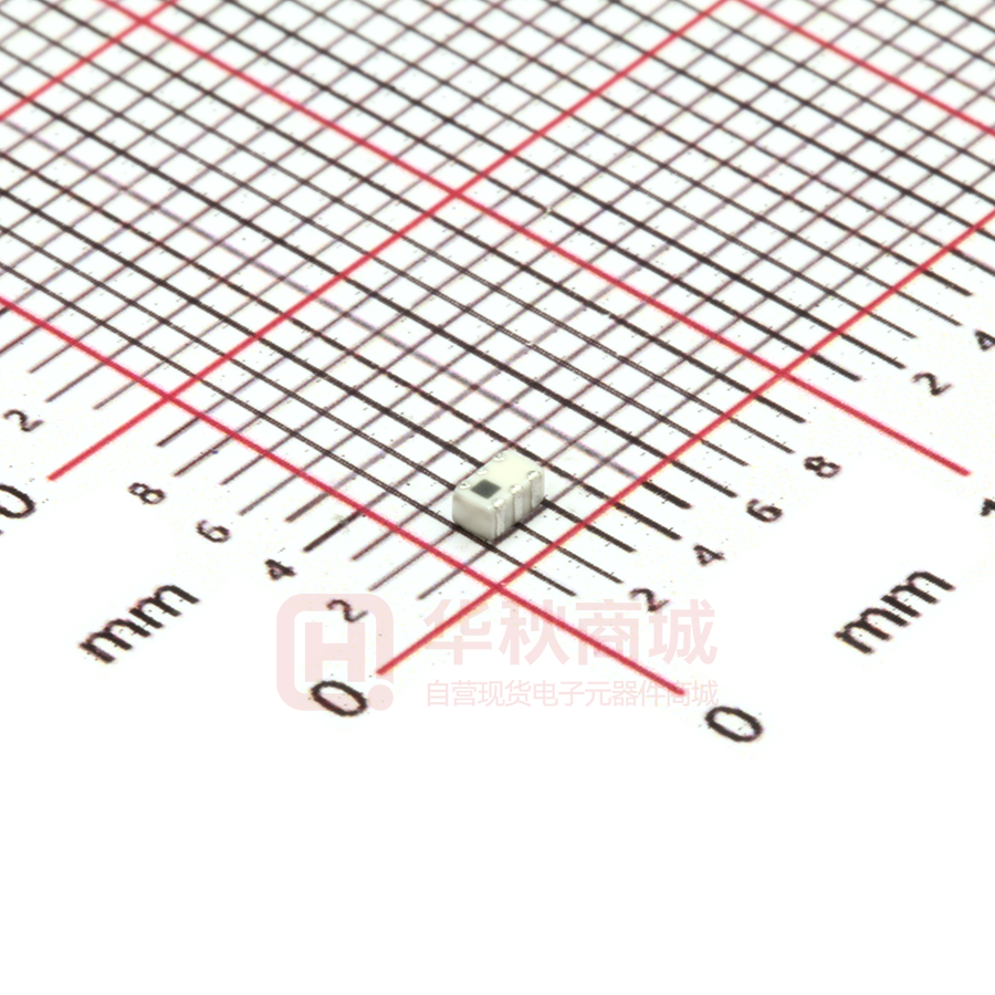

    350-470MHz多层巴伦
HHM1591D1 数据手册
The products in this catalog are not recommended for new design R F C o m p o n e n t s April 2015 Multilayer Balun For 350-470MHz HHM1591D1 2.0×1.25mm [EIA 0805]* * Dimensions Code JIS[EIA] The products in this catalog are not recommended for new design RF Components Multilayer Balun Conformity to RoHS Directive For 350-470MHz HHM1591D1 SHAPES AND DIMENSIONS 2.00±0.15 [Top view] 0.95±0.10 (5) (4) (1) (2) (3) 1.25±0.15 (6) Marking 0.65±0.20 0.30±0.20 Terminal functions 1 Unbalanced port 2 GND or DC feed+ RF GND 3 Balanced port 4 Balanced port 5 GND 6 N.C. +0.10 0.25–0.20 [Bottom view] 0.20±0.20 0.35±0.20 Dimensions in mm RECOMMENDED LAND PATTERN 0.50 0.80 0.30 0.35 Dimensions in mm RoHS Directive Compliant Product: See the following for more details related to RoHS Directive compliant products. http://product.tdk.com/en/environment/rohs/ • All specifications are subject to change without notice. • Before using these products, be sure to request the delivery specifications. 20150419 / rf_balun_hhm1591d1_en.fm The products in this catalog are not recommended for new design RF Components HHM1591D1 ELECTRICAL CHARACTERISTICS Frequency Range (MHz) Item Unbalanced Port Characteristic Impedance (:) Balanced Port Characteristic Impedance (:) Return Loss at Unbalanced Port (dB) Phase Balance (deg.) Amplitude Balance (dB) Insertion Loss (dB) 350 to 470 350 to 470 350 to 470 350 to 470 Min. Typ. Max. 8.5 170 –1.0 — 50 (Nominal) 100 (Nominal) — — — — — 190 1.0 1.5 TEMPERATURE RANGE Operating temperature (°C) –40 to +85 Storage temperature (°C) –40 to +85 • All specifications are subject to change without notice. • Before using these products, be sure to request the delivery specifications. 20150419 / rf_balun_hhm1591d1_en.fm The products in this catalog are not recommended for new design RF Components HHM1591D1 FREQUENCY CHARACTERISTICS AMPLITUDE BALANCE 0.0 5 0.5 4 1.0 3 1.5 2 Amplitude Balance (dB) Insertion Loss (dB) INSERTION LOSS 2.0 2.5 3.0 3.5 1 0 –1 –2 4.0 –3 4.5 –4 5.0 250 300 350 400 Frequency (MHz) 450 500 –5 250 550 RETURN LOSS 300 350 400 Frequency (MHz) 450 500 550 350 400 Frequency (MHz) 450 500 550 PHASE BALANCE 0 200 5 190 Phase Balance (deg.) Return Loss (dB) 10 15 20 25 30 180 170 35 40 250 300 350 400 Frequency (MHz) 450 500 550 160 250 300 • All specifications are subject to change without notice. • Before using these products, be sure to request the delivery specifications. 20150419 / rf_balun_hhm1591d1_en.fm The products in this catalog are not recommended for new design RF Components RECOMMENDED REFLOW PROFILE Preheating Soldering Peak T4 T: Temperature 3°C/sec or lower 6°C/sec or lower T3 T2 T3 t3 T1 t1 t2 t: Time Preheating Temp. T1 150°C T2 200°C Time t1 60 to 120sec Soldering Critical zone (T3 to T4) Temp. Time T3 t2 217°C 60 to 120sec t3 : Time within 5°C of actual peak temperature The maximum number of reflow is 3. • All specifications are subject to change without notice. • Before using these products, be sure to request the delivery specifications. Peak Temp. T4 240 to 260°C Time t3 30sec max. The products in this catalog are not recommended for new design RF Components REMINDERS FOR USING THESE PRODUCTS Before using these products, be sure to request the delivery specifications. SAFETY REMINDERS Please pay sufficient attention to the warnings for safe designing when using these products. REMINDERS The products listed on this catalog are intended for use in general electronic equipment (AV equipment, telecommunications equipment, home appliances, amusement equipment, computer equipment, personal equipment, office equipment, measurement equipment, industrial robots) under a normal operation and use condition. The products are not designed or warranted to meet the requirements of the applications listed below, whose performance and/or quality require a more stringent level of safety or reliability, or whose failure, malfunction or trouble could cause serious damage to society, person or property. Please understand that we are not responsible for any damage or liability caused by use of the products in any of the applications below or for any other use exceeding the range or conditions set forth in this catalog. (1) Aerospace/Aviation equipment (2) Transportation equipment (cars, electric trains, ships, etc.) (3) Medical equipment (4) Power-generation control equipment (5) Atomic energy-related equipment (6) Seabed equipment (7) Transportation control equipment (8) Public information-processing equipment (9) Military equipment (10) Electric heating apparatus, burning equipment (11) Disaster prevention/crime prevention equipment (12) Safety equipment (13) Other applications that are not considered general-purpose applications When using this product in general-purpose applications, you are kindly requested to take into consideration securing protection circuit/ equipment or providing backup circuits, etc., to ensure higher safety. • All specifications are subject to change without notice. • Before using these products, be sure to request the delivery specifications. 20150419 / rf_balun_hhm1591d1_en.fm
