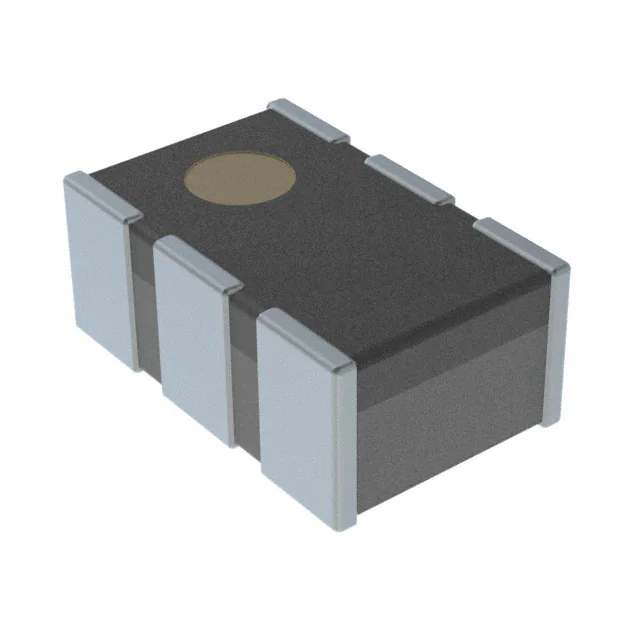

    MEM2012SC220
MEM2012SC220 数据手册
E M C C o m p o n e n t s 3-terminal filters Signal line MEM series RoHS REACH SVHC-Free Cl Br Pb Halogen Free Lead Free MEM2012SC type FEATURES Multilayer chip EMC filter. Monolithic structure makes it highly reliable. Closed magnetic circuit structure makes it possible to achieve high-density mounting without crosstalk. Has sharp attenuation characteristics with excellent EMC suppression. Wide range of products compatible with passing frequencies and attenuating frequencies. T-type circuit is used. Compatible with 1A current. Operating temperature range: –40 to +85°C APPLICATION Noise removal from signal lines of data terminals, digital cameras, computers, game machines, flat TVs, etc. Application guides: Smart phones/tablets PART NUMBER CONSTRUCTION MEM 2012 SC 100 T 001 Series name L×W×T dimensions 2.0×1.25×0.8mm Product internal code Capacitance (pF) at 1MHz Packaging style Internal code CHARACTERISTICS SPECIFICATION TABLE Capacitance Tolerance Rated voltage (%) (V)max. (pF) 10 ±30 12 22 ±30 12 47 ±30 12 100 ±30 12 150 ±30 12  Measuring frequency: 1(MHz), measuring voltage: 1(V) Rated current (A)max. 1 1 1 1 1 DC resistance [Terminal No.1 to 3] ( )max. 0.15 0.15 0.15 0.15 0.15 Part No. MEM2012SC100T001 MEM2012SC220T001 MEM2012SC470T001 MEM2012SC101T001 MEM2012SC151T001 Measurement equipment Measurement item Product No. Capacitance 4294A Frequency characteristics N5230C * Equivalent measurement equipment may be used. Manufacturer Keysight Technologies Keysight Technologies Please be sure to request delivery specifications that provide further details on the features and specifications of the products for proper and safe use. Please note that the contents may change without any prior notice due to reasons such as upgrading. (1/4) 20190207 3tf_commercial_signal_mem2012sc_en.fm E M C C o m p o n e n t s MEM2012SC type INSERTION LOSS VS. FREQUENCY CHARACTERISTICS 0 Insertion loss (dB) 10 SC151 20 SC101 SC100 SC220 SC470 30 40 50 60 1 10 100 Frequency (MHz) 1000 10000 Measurement equipment Product No. Manufacturer N5230C Keysight Technologies * Equivalent measurement equipment may be used. Please be sure to request delivery specifications that provide further details on the features and specifications of the products for proper and safe use. Please note that the contents may change without any prior notice due to reasons such as upgrading. (2/4) 20190207 3tf_commercial_signal_mem2012sc_en.fm E M C C o m p o n e n t s MEM2012SC type SHAPE & DIMENSIONS PACKAGING STYLE REEL DIMENSIONS 2±0.2 GND 5 NC 4 1 IN/OUT 2 GND 3 OUT/IN E 2.0±0.5 0.2min. 0.8+0.15, –0.2 0.2min. ø60min. 0.1min. 1.25±0.2 NC 6 1.0 0.4±0.15 0.4±0.15 0.4±0.15 Dimensions in mm 8.4 +2.0 –0.0 ø13±0.2 ø21±0.8 14.4max. ø180±2.0 RECOMMENDED LAND PATTERN Dimensions in mm 2.0±0.05 4.0±0.1 8.0±0.3 1.5 +0.1 –0 0.4 B 1.2 2.6 Dimensions in mm A K 3.5±0.05 Sprocket hole 1.75±0.1 0.5 2.2 TAPE DIMENSIONS Cavity 4.0±0.1 Dimensions in mm CIRCUIT DIAGRAM Type MEM2012SC A 1.55±0.20 160min. GND RECOMMENDED REFLOW PROFILE Preheating Soldering Taping B 2.30±0.20 K 1.10max. 200min. 300min. Drawing direction Natural cooling Peak Dimensions in mm 250 to 260°C PACKAGE QUANTITY Temperature 230°C 230°C 10s max. 60 to 120s 4,000 pcs/reel TEMPERATURE RANGE, INDIVIDUAL WEIGHT 180°C 150°C Package quantity 30 to 60s Operating Storage temperature range temperature range –40 to +85 °C –40 to +85 °C  The storage temperature range is for after the assembly. Individual weight 8 mg Time Please be sure to request delivery specifications that provide further details on the features and specifications of the products for proper and safe use. Please note that the contents may change without any prior notice due to reasons such as upgrading. (3/4) 20190207 3tf_commercial_signal_mem2012sc_en.fm E M C C o m p o n e n t s REMINDERS FOR USING THESE PRODUCTS Before using these products, be sure to request the delivery specifications. SAFETY REMINDERS Please pay sufficient attention to the warnings for safe designing when using this products. REMINDERS The storage period is less than 12 months. Be sure to follow the storage conditions (temperature: 5 to 40°C, humidity: 10 to 75% RH or less). If the storage period elapses, the soldering of the terminal electrodes may deteriorate. Do not use or store in locations where there are conditions such as gas corrosion (salt, acid, alkali, etc.). Before soldering, be sure to preheat components. The preheating temperature should be set so that the temperature difference between the solder temperature and chip temperature does not exceed 150°C. Soldering corrections after mounting should be within the range of the conditions determined in the specifications. If overheated, a short circuit, performance deterioration, or lifespan shortening may occur. When embedding a printed circuit board where a chip is mounted to a set, be sure that residual stress is not given to the chip due to the overall distortion of the printed circuit board and partial distortion such as at screw tightening portions. Self heating (temperature increase) occurs when the power is turned ON, so the tolerance should be sufficient for the set thermal design. Carefully lay out the coil for the circuit board design of the non-magnetic shield type. A malfunction may occur due to magnetic interference. Use a wrist band to discharge static electricity in your body through the grounding wire. Do not expose the products to magnets or magnetic fields. Do not use for a purpose outside of the contents regulated in the delivery specifications. The products listed on this catalog are intended for use in general electronic equipment (AV equipment, telecommunications equipment, home appliances, amusement equipment, computer equipment, personal equipment, office equipment, measurement equipment, industrial robots) under a normal operation and use condition. The products are not designed or warranted to meet the requirements of the applications listed below, whose performance and/or quality require a more stringent level of safety or reliability, or whose failure, malfunction or trouble could cause serious damage to society, person or property. If you intend to use the products in the applications listed below or if you have special requirements exceeding the range or conditions set forth in the each catalog, please contact us. (1) Aerospace/aviation equipment (2) Transportation equipment (cars, electric trains, ships, etc.) (3) Medical equipment (4) Power-generation control equipment (5) Atomic energy-related equipment   (6) Seabed equipment (7) Transportation control equipment (8) Public information-processing equipment (9) Military equipment (10) Electric heating apparatus, burning equipment (11) Disaster prevention/crime prevention equipment (12) Safety equipment (13) Other applications that are not considered general-purpose applications When designing your equipment even for general-purpose applications, you are kindly requested to take into consideration securing protection circuit/device or providing backup circuits in your equipment. Please be sure to request delivery specifications that provide further details on the features and specifications of the products for proper and safe use. Please note that the contents may change without any prior notice due to reasons such as upgrading. (4/4) 20190207 3tf_commercial_signal_mem2012sc_en.fm
