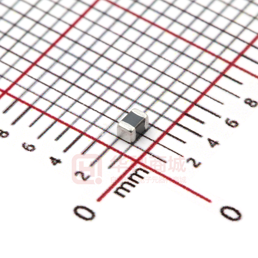

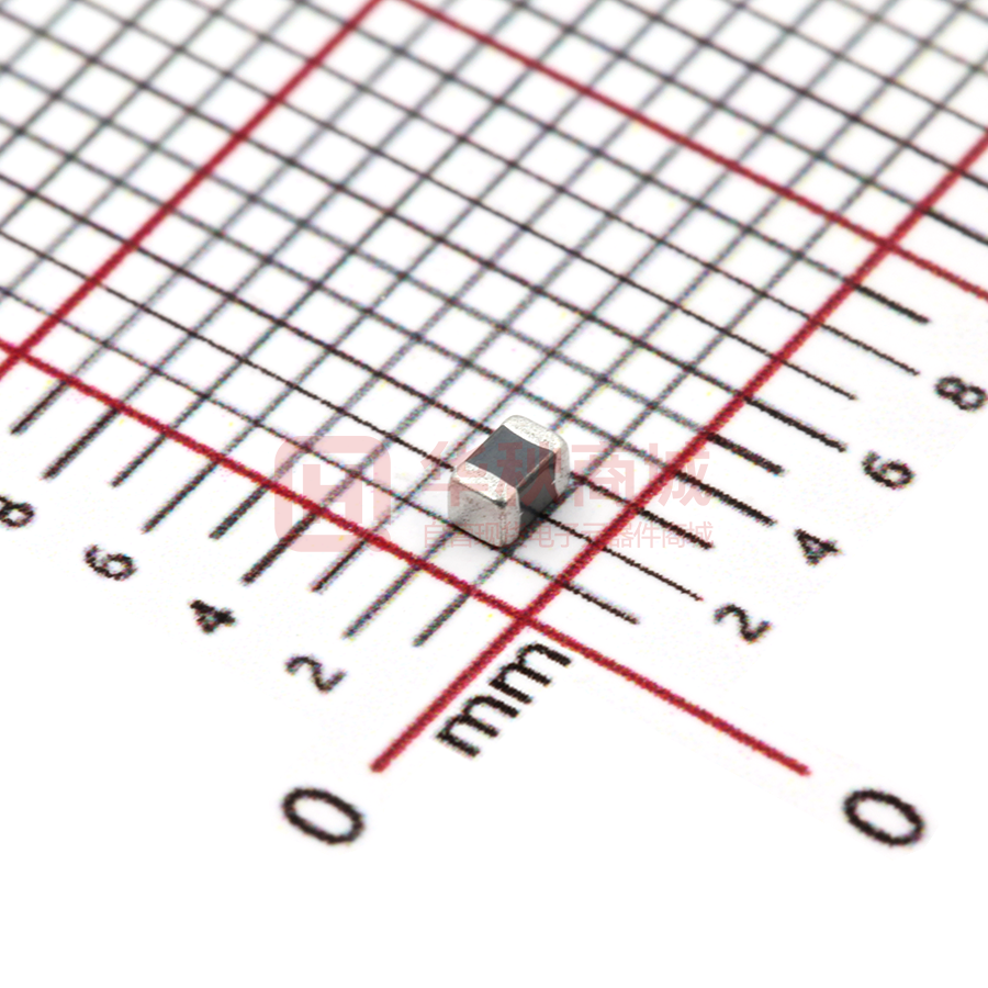

    信号/去耦电感 2.2µH ±20% 400mA 160mΩ 0805 2.00 x 1.25mm
MLZ2012M2R2HT000 数据手册
I N D U C T O R S Inductors for decoupling circuits Multilayer ferrite MLZ series RoHS REACH SVHC-Free Cl Br Pb Halogen Free Lead Free MLZ2012 type FEATURES The MLZ series include inductors for decoupling circuits that have top-class DC superimposition characteristics and low DC resistance. They are compatible with wide frequency band noise, from low to high frequency. H type products have a rated current that is equivalent to that of wound coils. W type products are the new standard type products that have both large current and low resistance. L type products have a resistance up to 60% lower than W type products. Operating temperature range: –55 to +125°C (including self-temperature rise) APPLICATION Smart phones, tablet terminals, note PCs, various modules such as camera modules, DSCs, video games, portable memory audio devices, navigation systems, PNDs, WLANs, SSDs PART NUMBER CONSTRUCTION MLZ 2012 M Series name L×W×H dimensions 2.0×1.25×0.85 mm 2.0×1.25×1.25 mm Product internal code 1R0 H T 000 Characteristic type Packaging style Internal code Inductance (µH) CHARACTERISTICS SPECIFICATION TABLE Type L Thickness L measuring conditions DC resistance Rated current T Frequency Current (Isat)1 Reference value Part No. (Itemp)2 (µH) Tolerance (mm) (MHz) (mA) ( )±30% (mA)max. (mA)typ. 1.0 ±20% 1.25 2 0.1 0.10 700 800 MLZ2012M1R0HT000 1.5 ±20% 1.25 2 0.1 0.14 550 700 MLZ2012M1R5HT000 2.2 ±20% 1.25 2 0.1 0.16 400 600 MLZ2012M2R2HT000 Ultra-large 3.3 ±20% 1.25 2 0.1 0.20 350 500 MLZ2012M3R3HT000 current 4.7 ±20% 1.25 2 0.1 0.34 300 400 MLZ2012M4R7HT000 6.8 ±20% 1.25 2 0.1 0.40 220 350 MLZ2012M6R8HT000 10 ±20% 1.25 2 0.1 0.68 200 300 MLZ2012M100HT000 0.10 ±20% 0.85 25 1.0 0.07 1000 1150 MLZ2012DR10DT000 High 0.22 ±20% 0.85 25 1.0 0.13 800 900 MLZ2012DR22DT000 frequency 0.47 ±20% 1.25 25 1.0 0.18 550 700 MLZ2012DR47DT000 1 Current assumed when inductance ratio has decreased by 50% max.. 2 Current assumed when temperature has risen to 20°C typ. (reference value). Operating temperature environment at this time: 105°C max. Measurement equipment Measurement item Product No. L 4294A+16034G DC resistance Type-7561 * Equivalent measurement equipment may be used. Manufacturer Keysight Technologies Yokogawa Please be sure to request delivery specifications that provide further details on the features and specifications of the products for proper and safe use. Please note that the contents may change without any prior notice due to reasons such as upgrading. (1/12) 20201224 inductor_commercial_decoupling_mlz2012_en.fm I N D U C T O R S MLZ2012 type CHARACTERISTICS SPECIFICATION TABLE Type L Thickness T L measuring conditions DC resistance Rated current Frequency Current (Isat)1 Reference value Part No. (Itemp)2 (µH) Tolerance (mm) (MHz) (mA) ( )±30% (mA)max. (mA)typ. 1.00 ±20% 0.85 10 1.0 0.10 280 900 MLZ2012A1R0WT000 1.50 ±20% 0.85 10 1.0 0.13 250 750 MLZ2012A1R5WT000 2.20 ±20% 0.85 10 1.0 0.15 210 650 MLZ2012A2R2WT000 3.30 ±20% 0.85 10 1.0 0.34 200 450 MLZ2012A3R3WT000 4.70 ±20% 0.85 2 0.1 0.30 180 500 MLZ2012M4R7WT000 6.80 ±20% 1.25 2 0.1 0.40 160 400 MLZ2012M6R8WT000 Large current 10.0 ±20% 1.25 2 0.1 0.47 150 350 MLZ2012M100WT000 15.0 ±20% 1.25 2 0.1 0.95 120 250 MLZ2012M150WT000 22.0 ±20% 1.25 2 0.1 1.25 100 220 MLZ2012P220WT000 22.0 ±20% 1.25 2 0.1 2.0 60 220 MLZ2012M220WT000 33.0 ±20% 1.25 2 0.1 2.60 55 190 MLZ2012M330WT000 47.0 ±20% 1.25 2 0.1 3.70 50 170 MLZ2012M470WT000 1.00 ±20% 0.85 2 0.1 0.06 220 1150 MLZ2012N1R0LT000 1.50 ±20% 0.85 2 0.1 0.10 190 900 MLZ2012N1R5LT000 2.20 ±20% 0.85 2 0.1 0.12 170 800 MLZ2012N2R2LT000 3.30 ±20% 0.85 2 0.1 0.15 130 750 MLZ2012N3R3LT000 4.70 ±20% 0.85 2 0.1 0.18 130 600 MLZ2012N4R7LT000 Low resistance 6.80 ±20% 0.85 2 0.1 0.25 110 550 MLZ2012N6R8LT000 10.0 ±20% 1.25 2 0.1 0.30 110 500 MLZ2012N100LT000 15.0 ±20% 1.25 2 0.1 0.47 90 350 MLZ2012N150LT000 22.0 ±20% 1.25 2 0.1 0.67 70 300 MLZ2012N220LT000 100.0 ±20% 1.25 2 0.1 3.50 30 140 MLZ2012N101LT000 1 Current assumed when inductance ratio has decreased by 50% max.. 2 Current assumed when temperature has risen to 20°C typ. (reference value). Operating temperature environment at this time: 105°C max. Measurement equipment Measurement item Product No. L 4294A+16034G DC resistance Type-7561 * Equivalent measurement equipment may be used. Manufacturer Keysight Technologies Yokogawa Please be sure to request delivery specifications that provide further details on the features and specifications of the products for proper and safe use. Please note that the contents may change without any prior notice due to reasons such as upgrading. (2/12) 20201224 inductor_commercial_decoupling_mlz2012_en.fm I N D U C T O R S MLZ2012 type L FREQUENCY CHARACTERISTICS H CHARACTERISTIC PRODUCT 100 M100H Inductance(μH) 10 M6R8H M4R7H M3R3H M2R2H M1R5H M1R0H 1 0.1 1 10 100 1000 Frequency(MHz) Measurement equipment Product No. Manufacturer Keysight Technologies E4991A+16192A * Equivalent measurement equipment may be used. L FREQUENCY CHARACTERISTICS D CHARACTERISTIC PRODUCT 1000 Inductance(μH) 100 10 1 DR47D DR22D DR10D 0.1 0.01 1 10 100 1000 Frequency(MHz) Measurement equipment Product No. Manufacturer E4991A+16192A Keysight Technologies * Equivalent measurement equipment may be used. Please be sure to request delivery specifications that provide further details on the features and specifications of the products for proper and safe use. Please note that the contents may change without any prior notice due to reasons such as upgrading. (3/12) 20201224 inductor_commercial_decoupling_mlz2012_en.fm I N D U C T O R S MLZ2012 type L FREQUENCY CHARACTERISTICS W CHARACTERISTIC PRODUCT 1000 M470W M330W P220W 100 M220W M150W M100W M6R8W Inductance(μH) 10 M4R7W A3R3W A2R2W 1 A1R5W A1R0W 0.1 0.01 1 10 100 1000 Frequency(MHz) Measurement equipment Product No. Manufacturer 4291B+16200A+16192A Keysight Technologies * Equivalent measurement equipment may be used. Please be sure to request delivery specifications that provide further details on the features and specifications of the products for proper and safe use. Please note that the contents may change without any prior notice due to reasons such as upgrading. (4/12) 20201224 inductor_commercial_decoupling_mlz2012_en.fm I N D U C T O R S MLZ2012 type L FREQUENCY CHARACTERISTICS L CHARACTERISTIC PRODUCT 1000 N101L 100 N220L Inductance(μH) N150L N100L 10 N6R8L N4R7L N3R3L 1 N2R2L N1R5L 0.1 N1R0L 0.01 1 10 100 1000 Frequency(MHz) Measurement equipment Product No. Manufacturer Keysight Technologies E4991A+16192A * Equivalent measurement equipment may be used. Please be sure to request delivery specifications that provide further details on the features and specifications of the products for proper and safe use. Please note that the contents may change without any prior notice due to reasons such as upgrading. (5/12) 20201224 inductor_commercial_decoupling_mlz2012_en.fm I N D U C T O R S MLZ2012 type INDUCTANCE VS. DC BIAS CHARACTERISTICS H CHARACTERISTIC PRODUCT 100 M100H Inductance(μH) 10 M6R8H M4R7H M3R3H M2R2H M1R5H M1R0H 1 0.1 0 200 400 600 800 1000 DC current(mA) Measurement equipment Product No. Manufacturer 4291B+16200A+16192A Keysight Technologies * Equivalent measurement equipment may be used. INDUCTANCE VS. DC BIAS CHARACTERISTICS D CHARACTERISTIC PRODUCT Inductance(μH) 10 1 DR47D DR22D 0.1 DR10D 0.01 0 200 400 600 800 1000 DC current(mA) Measurement equipment Product No. Manufacturer 4291B+16200A+16192A Keysight Technologies * Equivalent measurement equipment may be used. Please be sure to request delivery specifications that provide further details on the features and specifications of the products for proper and safe use. Please note that the contents may change without any prior notice due to reasons such as upgrading. (6/12) 20201224 inductor_commercial_decoupling_mlz2012_en.fm I N D U C T O R S MLZ2012 type INDUCTANCE VS. DC BIAS CHARACTERISTICS W CHARACTERISTIC PRODUCT 1000 M330W 100 Inductance(μH) M470W P220W M6R8W M220W M100W 10 M150W M4R7W A3R3W A1R5W 1 A1R0W A2R2W 0.1 0 100 200 300 400 DC current(mA) 500 600 700 Measurement equipment Product No. Manufacturer 4291B+16200A+16192A Keysight Technologies * Equivalent measurement equipment may be used. INDUCTANCE VS. DC BIAS CHARACTERISTICS L CHARACTERISTIC PRODUCT 1000 N101L Inductance(μH) 100 N220L 10 N150L N100L N6R8L N3R3L 1 N1R0L N4R7L N2R2L N1R5L 0.1 0 100 200 300 400 500 DC current(mA) Measurement equipment Product No. Manufacturer 4291B+16200A+16192A Keysight Technologies * Equivalent measurement equipment may be used. Please be sure to request delivery specifications that provide further details on the features and specifications of the products for proper and safe use. Please note that the contents may change without any prior notice due to reasons such as upgrading. (7/12) 20201224 inductor_commercial_decoupling_mlz2012_en.fm I N D U C T O R S MLZ2012 type IMPEDANCE FREQUENCY CHARACTERISTICS H CHARACTERISTIC PRODUCT 100000 M100H 10000 M6R8H M4R7H M3R3H M2R2H Impedance(Ω) M1R5H 1000 M1R0H 100 10 1 1 10 100 1000 Frequency(MHz) Measurement equipment Product No. Manufacturer E4991A+16192A Keysight Technologies * Equivalent measurement equipment may be used. IMPEDANCE FREQUENCY CHARACTERISTICS D CHARACTERISTIC PRODUCT 10000 DR47D DR22D Impedance(Ω) 1000 DR10D 100 10 1 1 10 100 1000 Frequency(MHz) Measurement equipment Product No. Manufacturer E4991A+16192A Keysight Technologies * Equivalent measurement equipment may be used. Please be sure to request delivery specifications that provide further details on the features and specifications of the products for proper and safe use. Please note that the contents may change without any prior notice due to reasons such as upgrading. (8/12) 20201224 inductor_commercial_decoupling_mlz2012_en.fm I N D U C T O R S MLZ2012 type IMPEDANCE FREQUENCY CHARACTERISTICS W CHARACTERISTIC PRODUCT 1000000 M330W 100000 P220W M220W M470W M150W 10000 M6R8W M100W Impedance(Ω) A3R3W 1000 A1R0W A1R5W A2R2W M4R7W 100 10 1 1 10 100 1000 Frequency(MHz) Measurement equipment Product No. Manufacturer E4991A+16192A Keysight Technologies * Equivalent measurement equipment may be used. Please be sure to request delivery specifications that provide further details on the features and specifications of the products for proper and safe use. Please note that the contents may change without any prior notice due to reasons such as upgrading. (9/12) 20201224 inductor_commercial_decoupling_mlz2012_en.fm I N D U C T O R S MLZ2012 type IMPEDANCE FREQUENCY CHARACTERISTICS L CHARACTERISTIC PRODUCT 100000 N101L Impedance(Ω) 10000 N220L N150L N100L 1000 N6R8L N1R0L 100 N4R7L N3R3L N2R2L N1R5L 10 1 1 10 100 1000 Frequency(MHz) Measurement equipment Product No. Manufacturer E4991A+16192A Keysight Technologies * Equivalent measurement equipment may be used. Please be sure to request delivery specifications that provide further details on the features and specifications of the products for proper and safe use. Please note that the contents may change without any prior notice due to reasons such as upgrading. (10/12) 20201224 inductor_commercial_decoupling_mlz2012_en.fm I N D U C T O R S MLZ2012 type SHAPE & DIMENSIONS t=0.85mm PACKAGING STYLE t=1.25mm REEL DIMENSIONS E 2.0±0.5 2.00±0.20 ø60min. 1.25±0.20 0.85±0.20 1.25±0.20 1.25±0.20 2.00±0.20 0.50±0.30 1.0 0.50±0.30 Dimensions in mm 8.4 +2.0 –0.0 ø13±0.2 ø21±0.8 14.4max. ø180±2.0 Dimensions in mm MLZ2012 (t=1.25) 1.0 2.0±0.05 4.0±0.1 8.0±0.3 1.5 +0.1 –0 B 1.2 0.8 Sprocket hole t RECOMMENDED LAND PATTERN 3.5±0.05 MLZ2012 (t=0.85) 1.75±0.1 TAPE DIMENSIONS 0.8 K 4.0±0.1 A K Cavity Dimensions in mm Dimensions in mm Type MLZ2012 RECOMMENDED REFLOW PROFILE Preheating Soldering t=0.85 t=1.25 160min. A 1.5±0.2 1.5±0.2 Taping Peak Temperature K 1.1 max. 1.5 max. 200min. Natural cooling 300min. Drawing direction 250 to 260°C 230°C B 2.3±0.2 2.3±0.2 Dimensions in mm 230°C PACKAGE QUANTITY Package quantity t=0.85mm t=1.25mm 4000 pcs/reel 2000 pcs/reel 180°C 10s max. 150°C TEMPERATURE RANGE, INDIVIDUAL WEIGHT 60 to 120s 30 to 60s Time Operating Storage Individual temperature range temperature range weight t=0.85mm –55 to +125 °C –55 to +125 °C 10 mg t=1.25mm –55 to +125 °C –55 to +125 °C 14 mg  Operating temperature range includes self-temperature rise.  The storage temperature range is for after the assembly. Type Please be sure to request delivery specifications that provide further details on the features and specifications of the products for proper and safe use. Please note that the contents may change without any prior notice due to reasons such as upgrading. (11/12) 20201224 inductor_commercial_decoupling_mlz2012_en.fm I N D U C T O R S REMINDERS FOR USING THESE PRODUCTS Before using these products, be sure to request the delivery specifications. SAFETY REMINDERS Please pay sufficient attention to the warnings for safe designing when using this products. REMINDERS The storage period is within 12 months. Be sure to follow the storage conditions (temperature: 5 to 40°C, humidity: 10 to 75% RH or less). If the storage period elapses, the soldering of the terminal electrodes may deteriorate. Do not use or store in locations where there are conditions such as gas corrosion (salt, acid, alkali, etc.). Before soldering, be sure to preheat components. The preheating temperature should be set so that the temperature difference between the solder temperature and chip temperature does not exceed 150°C. Soldering corrections after mounting should be within the range of the conditions determined in the specifications. If overheated, a short circuit, performance deterioration, or lifespan shortening may occur. When embedding a printed circuit board where a chip is mounted to a set, be sure that residual stress is not given to the chip due to the overall distortion of the printed circuit board and partial distortion such as at screw tightening portions. Self heating (temperature increase) occurs when the power is turned ON, so the tolerance should be sufficient for the set thermal design. Carefully lay out the coil for the circuit board design of the non-magnetic shield type. A malfunction may occur due to magnetic interference. Use a wrist band to discharge static electricity in your body through the grounding wire. Do not expose the products to magnets or magnetic fields. Do not use for a purpose outside of the contents regulated in the delivery specifications. The products listed on this catalog are intended for use in general electronic equipment (AV equipment, telecommunications equipment, home appliances, amusement equipment, computer equipment, personal equipment, office equipment, measurement equipment, industrial robots) under a normal operation and use condition. The products are not designed or warranted to meet the requirements of the applications listed below, whose performance and/or quality require a more stringent level of safety or reliability, or whose failure, malfunction or trouble could cause serious damage to society, person or property. If you intend to use the products in the applications listed below or if you have special requirements exceeding the range or conditions set forth in the each catalog, please contact us. (1) Aerospace/aviation equipment (2) Transportation equipment (cars, electric trains, ships, etc.) (3) Medical equipment (4) Power-generation control equipment (5) Atomic energy-related equipment   (6) Seabed equipment (7) Transportation control equipment (8) Public information-processing equipment (9) Military equipment (10) Electric heating apparatus, burning equipment (11) Disaster prevention/crime prevention equipment (12) Safety equipment (13) Other applications that are not considered general-purpose applications When designing your equipment even for general-purpose applications, you are kindly requested to take into consideration securing protection circuit/device or providing backup circuits in your equipment. Please be sure to request delivery specifications that provide further details on the features and specifications of the products for proper and safe use. Please note that the contents may change without any prior notice due to reasons such as upgrading. (12/12) 20201224 inductor_commercial_decoupling_mlz2012_en.fm
