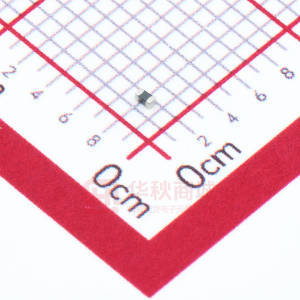

(1/3) Chip Beads(SMD) For Signal Line MMZ Series MMZ1005-E Type FEATURES • Compared with the existing MMZ1005 type, this new product has broad-band impedance values for higher frequency ranges. • Size standardized for use by automatic assembly equipment. No preferred orientation. • Electroplated terminal electrodes accommodate reflow soldering. • High reliability due to an entirely monolithic structure. • Closed magnetic circuit structure allows high-density installation while preventing crosstalk between circuits. • Low DC resistance structure of electrode prevents wasteful electric power consumption. • It is a product conforming to RoHS directive. APPLICATIONS Removal of signal line noises of cellular phones, PCs, note PCs, TVs, TV tuners, STBs, audio players, DVDs, DSCs, DVCs, game machines, digital photo frames, car navigation system, PNDs, etc. TEMPERATURE RANGES Operating/storage –55 to +125°C Conformity to RoHS Directive PRODUCT IDENTIFICATION MMZ 1005 S 601 E T (1) (2) (3) (4) (5) (6) (1) Series name (2) Dimensions L× W (3) Material code (4) Nominal impedance 601:600 Ω at 100MHz (5) Characteristic type (6) Packaging style T:Taping PACKAGING STYLE AND QUANTITIES Packaging style Taping Quantity 10000 pieces/reel SHAPES AND DIMENSIONS/RECOMMENDED PC BOARD PATTERN 1± 0.05 0.5 ± 0.05 0.5 0.1min. 0.5 ± 0.05 0.5 0.4 0.5 Weight: 1mg Dimensions in mm HANDLING AND PRECAUTIONS • Before soldering, be sure to preheat components. The preheating temperature should be set so that the temperature difference between the solder temperature and product temperature does not exceed 150°C. • After mounting components onto the printed circuit board, do not apply stress through board bending or mishandling. • Do not expose the inductors to stray magnetic fields. • Avoid static electricity discharge during handling. • When hand soldering, apply the soldering iron to the printed circuit board only. Temperature of the iron tip should not exceed 350°C. Soldering time should not exceed 3 seconds. RECOMMENDED SOLDERING CONDITION REFLOW SOLDERING ELECTRICAL CHARACTERISTICS Impedance(Ω)∗ Part No. MMZ1005S601E MMZ1005S102E MMZ1005S182E MMZ1005A601E MMZ1005A102E MMZ1005A152E MMZ1005A182E MMZ1005A222E MMZ1005D121E MMZ1005D221E MMZ1005F470E MMZ1005F750E MMZ1005F121E ∗ [100MHz] 600±25% 1000±25% 1800±25% 600±25% 1000±25% 1500±25% 1800±25% 2200±25% 120±25% 220±25% 47±25% 75±25% 120±25% [1GHz] 1000±40% 1400±40% 1800±40% 1400±40% 2000±40% 2300±40% 2700±40% 3000±40% 1000±40% 1700±40% 800±40% 1500±40% 2300±40% DC resistance (Ω)max. 0.70 1.10 1.65 0.85 1.25 1.70 2.20 2.30 0.70 1.00 0.70 1.00 1.50 Rated current (mA)max. 300 250 200 300 250 230 200 150 300 250 300 250 200 10s max. 250 to 260˚C 230˚C Natural cooling 180˚C 150˚C Preheating 60 to 120s Time(s) Soldering 30 to 60s Test equipment: E4991A or equivalent Test tool: 16192A or equivalent Test temperature: 25±10°C • Conformity to RoHS Directive: This means that, in conformity with EU Directive 2002/95/EC, lead, cadmium, mercury, hexavalent chromium, and specific bromine-based flame retardants, PBB and PBDE, have not been used, except for exempted applications. • Please contact our Sales office when your application are considered the following: The device’s failure or malfunction may directly endanger human life (e.g. application for automobile/aircraft/medical/nuclear power devices, etc.) • All specifications are subject to change without notice. 002-01 / 20090914 / e9412_mmz1005e.fm (2/3) TYPICAL ELECTRICAL CHARACTERISTICS Z, X, R vs. FREQUENCY CHARACTERISTICS MMZ1005S601E MMZ1005S102E 1000 800 Impedance(Ω) MMZ1005S182E 3000 2500 Impedance(Ω) Z R X 1600 1400 Impedance(Ω) Z 1200 1000 800 600 400 200 2000 1500 1000 500 X R Z 600 R 400 200 0 X 1 10 100 1000 Frequency (MHz) 10000 0 1 10 100 1000 Frequency (MHz) 10000 0 1 10 100 1000 Frequency (MHz) 10000 MMZ1005A601E 1600 1400 1200 Impedance(Ω) MMZ1005A102E 2500 2000 Z Impedance(Ω) Z R MMZ1005A152E 3000 2500 Impedance(Ω) 1000 800 600 400 200 0 1 10 2000 1500 1000 500 Z R 1500 1000 500 0 R X X X 100 1000 Frequency (MHz) 10000 1 10 100 1000 Frequency (MHz) 10000 0 1 10 100 1000 Frequency (MHz) 10000 MMZ1005A182E 3500 3000 Impedance(Ω) MMZ1005A222E 4500 4000 3500 Impedance(Ω) MMZ1005D121E 1200 1000 Impedance(Ω) Z R 2500 2000 1500 1000 500 0 1 10 Z R 3000 2500 2000 1500 1000 500 0 800 Z 600 400 200 R X X X 100 1000 Frequency (MHz) 10000 1 10 100 1000 Frequency (MHz) 10000 0 1 10 100 1000 Frequency (MHz) 10000 MMZ1005D221E 2000 MMZ1005F470E 1200 1000 Impedance(Ω) MMZ1005F750E 1800 1600 1400 Impedance(Ω) 1500 Impedance(Ω) Z R 800 600 400 200 X Z R 1200 1000 800 600 400 200 X ZR 1000 500 X 0 0 1 10 100 1000 Frequency (MHz) 10000 1 10 100 1000 Frequency (MHz) 10000 0 1 10 100 1000 Frequency (MHz) 10000 • All specifications are subject to change without notice. 002-01 / 20090914 / e9412_mmz1005e.fm (3/3) TYPICAL ELECTRICAL CHARACTERISTICS Z, X, R vs. FREQUENCY CHARACTERISTICS MMZ1005F121E 3000 2500 Impedance(Ω) 2000 1500 1000 500 X ZR 0 1 10 100 1000 Frequency (MHz) 10000 PACKAGING STYLES REEL DIMENSIONS 1.0 2.0± 0.5 ø13± 0.2 ø21± 0.8 ø180± 2.0 8.4 +2.0 –0.0 14.4max. ø60min. Dimensions in mm TAPE DIMENSIONS 1.5 +0.1 –0.0 1.75±0.1 300min. Dimensions in mm 1.15±0.1 3.5±0.05 8.0±0.3 0.8max. 0.65± 0.1 4.0± 0.1 2.0± 0.05 2.0± 0.05 160min. Taping 200min. Drawing direction Sprocket hole Cavity • All specifications are subject to change without notice. 002-01 / 20090914 / e9412_mmz1005e.fm
