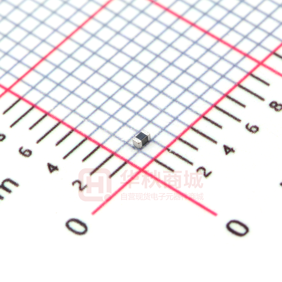

    贴片磁珠 0402 600Ω@100MHz ±25% 300mA 520mΩ
MMZ1005S601CT000 数据手册
E M C C o m p o n e n t s Chip beads For general signal line MMZ series RoHS REACH SVHC-Free Cl Br Pb Halogen Free Lead Free MMZ1005 type FEATURES Noise reduction solution for general signal line. Various frequency characteristics with 5 materials of different features for countermeasures against everything from general signals to high-speed signals. Operating temperature range: –55 to +125°C APPLICATION Noise removal for mobile devices such as smartphones and tablet terminals, and various modules. Noise removal for PCs and recorders, household appliances such as STBs, smart grids, and industrial equipment. PART NUMBER CONSTRUCTION MMZ 1005 S 800 C T 000 Series name L×W×T dimensions 1.0×0.5x0.5 mm Material name Impedance () at 100MHz Characteristic type Packaging style Internal code CHARACTERISTICS SPECIFICATION TABLE Impedance [100MHz] ( ) 80 120 600 80 120 240 600 1000 40 80 120 240 300 470 600 1000 1500 1800 Tolerance ±25% ±25% ±25% ±25% ±25% ±25% ±25% ±25% ±25% ±25% ±25% ±25% ±25% ±25% ±25% ±25% ±25% ±25% DC resistance Rated current Part No. ( )max. 0.19 0.25 0.85 0.12 0.22 0.28 0.52 0.75 0.10 0.17 0.18 0.26 0.38 0.47 0.54 0.70 1.00 0.85 (mA)max. 450 400 200 500 500 400 300 200 550 450 400 300 250 250 250 200 100 150 MMZ1005B800CT000 MMZ1005B121CT000 MMZ1005B601CT000 MMZ1005S800CT000 MMZ1005S121CT000 MMZ1005S241CT000 MMZ1005S601CT000 MMZ1005S102CT000 MMZ1005Y400CT000 MMZ1005Y800CT000 MMZ1005Y121CT000 MMZ1005Y241CT000 MMZ1005Y301CT000 MMZ1005Y471CT000 MMZ1005Y601CT000 MMZ1005Y102CT000 MMZ1005Y152CT000 MMZ1005Y182CT000 Measurement equipment Measurement item Product No. Impedance E4991A+16192A DC resistance Type-7556 * Equivalent measurement equipment may be used. Manufacturer Keysight Technologies Yokogawa Please be sure to request delivery specifications that provide further details on the features and specifications of the products for proper and safe use. Please note that the contents may change without any prior notice due to reasons such as upgrading. (1/7) 20190424 beads_commercial_signal_mmz1005_en.fm E M C C o m p o n e n t s MMZ1005 type CHARACTERISTICS SPECIFICATION TABLE Impedance [100MHz] ( ) 10 22 33 68 120 240 33 47 56 Tolerance ±5 ±25% ±25% ±25% ±25% ±25% ±25% ±25% ±25% DC resistance Rated current Part No. ( )max. 0.10 0.17 0.24 0.38 0.60 0.90 0.50 0.60 0.70 (mA)max. 500 400 400 400 350 200 200 100 100 MMZ1005D100CT000 MMZ1005D220CT000 MMZ1005D330CT000 MMZ1005D680CT000 MMZ1005D121CT000 MMZ1005D241CT000 MMZ1005F330CT000 MMZ1005F470CT000 MMZ1005F560CT000 Measurement equipment Measurement item Product No. Impedance E4991A+16192A DC resistance Type-7556 * Equivalent measurement equipment may be used. Manufacturer Keysight Technologies Yokogawa Please be sure to request delivery specifications that provide further details on the features and specifications of the products for proper and safe use. Please note that the contents may change without any prior notice due to reasons such as upgrading. (2/7) 20190424 beads_commercial_signal_mmz1005_en.fm E M C C o m p o n e n t s MMZ1005 type Z VS. FREQUENCY CHARACTERISTICS (BY SERIES) MMZ1005B series MMZ1005S series 800 MMZ1005Y series 1400 700 2200 1200 1800 MMZ1005Y152C MMZ1005B601C MMZ1005S601C 400 300 Impedance (Ω) 500 MMZ1005S241C 800 MMZ1005S121C MMZ1005S800C 600 MMZ1005B121C 1 10 100 1000 Frequency (MHz) MMZ1005Y471C 1200 MMZ1005Y301C MMZ1005Y241C MMZ1005Y121C 800 MMZ1005Y800C 1000 200 MMZ1005B800C 0 1400 400 200 100 MMZ1005Y601C 600 MMZ1005Y400C 400 200 MMZ1005Y102C 1600 1000 Impedance (Ω) Impedance (Ω) 600 MMZ1005Y182C 2000 MMZ1005S102C 0 10000 MMZ1005D series 1 10 100 1000 Frequency (MHz) 10000 0 1 10 100 1000 Frequency (MHz) 10000 MMZ1005F series 3000 1200 2500 1000 MMZ1005F560C 2000 Impedance (Ω) Impedance (Ω) MMZ1005D241C MMZ1005D121C 1500 MMZ1005D680C MMZ1005D330C 1000 800 600 MMZ1005F470C 400 MMZ1005D220C 500 0 0 1 10 100 1000 Frequency (MHz) MMZ1005F330C 200 MMZ1005D100C 10000 1 10 100 1000 Frequency (MHz) 10000 Please be sure to request delivery specifications that provide further details on the features and specifications of the products for proper and safe use. Please note that the contents may change without any prior notice due to reasons such as upgrading. (3/7) 20190424 beads_commercial_signal_mmz1005_en.fm E M C C o m p o n e n t s MMZ1005 type Z, X, R VS. FREQUENCY CHARACTERISTICS MMZ1005B121CT000 120 Impedance (Ω) 80 R Z 60 40 X 20 1 10 100 1000 Frequency (MHz) 10000 MMZ1005S800CT000 R X 100 1000 Frequency (MHz) 10000 1 10 100 1000 Frequency (MHz) 10000 900 800 700 600 500 400 300 200 100 0 R X 10 R 100 50 X 10 100 1000 Frequency (MHz) 10000 MMZ1005S102CT000 Z 1 Z 150 1 100 1000 Frequency (MHz) 10000 1400 1200 1000 800 600 400 200 0 R 400 350 300 250 200 150 100 50 0 80 70 60 50 40 30 20 10 0 X 10 100 1000 Frequency (MHz) 10000 MMZ1005Y121CT000 X 1 10 100 1000 Frequency (MHz) MMZ1005Y301CT000 400 Impedance (Ω) 500 Z 300 200 0 X R 1 10 Z 150 R 100 50 1 10 100 Frequency (MHz) X 1000 1000 100 Frequency (MHz) 10000 10 100 1000 Frequency (MHz) 10000 R Z X 1 10 100 1000 Frequency (MHz) 10000 Z R X 1 10 100 1000 Frequency (MHz) 10000 800 700 600 500 400 300 200 100 0 400 Z 300 R 200 100 X 0 10000 MMZ1005Y471CT000 600 100 200 0 10000 X 500 Impedance (Ω) Impedance (Ω) R R MMZ1005Y241CT000 250 Z Z MMZ1005Y400CT000 Z 1 800 700 600 500 400 300 200 100 0 1 MMZ1005S241CT000 200 0 Impedance (Ω) Impedance (Ω) Impedance (Ω) 10 Impedance (Ω) Z MMZ1005Y800CT000 Impedance (Ω) 1 250 MMZ1005S601CT000 160 140 120 100 80 60 40 20 0 X MMZ1005S121CT000 Impedance (Ω) Impedance (Ω) 160 140 120 100 80 60 40 20 0 R Z Impedance (Ω) 0 180 160 140 120 100 80 60 40 20 0 1 10 100 1000 Frequency (MHz) 10000 MMZ1005Y601CT000 1200 1000 Impedance (Ω) Impedance (Ω) 100 MMZ1005B601CT000 Impedance (Ω) MMZ1005B800CT000 Z R X 1 10 100 1000 Frequency (MHz) 10000 800 Z 600 R 400 200 0 X 1 10 100 1000 Frequency (MHz) Please be sure to request delivery specifications that provide further details on the features and specifications of the products for proper and safe use. Please note that the contents may change without any prior notice due to reasons such as upgrading. 10000 (4/7) 20190424 beads_commercial_signal_mmz1005_en.fm E M C C o m p o n e n t s MMZ1005 type Z, X, R VS. FREQUENCY CHARACTERISTICS Z MMZ1005Y152CT000 R X 1 10 100 1000 Frequency (MHz) 10000 10000 R X Z 100 R 100 1000 Frequency (MHz) 10000 50 Z 300 R 200 100 0 10 100 1000 Frequency (MHz) 50 X 10 100 1000 Frequency (MHz) 10000 1 600 400 Z 200 1 10 10 X 100 1000 Frequency (MHz) 10000 MMZ1005D241CT000 X 100 1000 Frequency (MHz) R 10000 2000 1500 1000 Z R 500 0 1 10 X 100 1000 Frequency (MHz) 10000 MMZ1005F560CT000 1200 1000 Impedance (Ω) R 0 10000 MMZ1005F470CT000 Z 1 100 1000 Frequency (MHz) 2500 1000 900 800 700 600 500 400 300 200 100 0 10000 R 100 800 0 100 1000 Frequency (MHz) Z 3000 10000 MMZ1005F330CT000 700 600 500 400 300 200 100 0 10 X 1 10 150 1000 Impedance (Ω) 400 1 MMZ1005D121CT000 500 X 200 Impedance (Ω) 10 R 250 X 1 Z 300 150 0 2200 2000 1800 1600 1400 1200 1000 800 600 400 200 0 1 MMZ1005D330CT000 Impedance (Ω) Z 600 Impedance (Ω) X 100 1000 Frequency (MHz) 200 MMZ1005D680CT000 Impedance (Ω) 10 R Impedance (Ω) 70 60 50 40 30 20 10 0 Z MMZ1005Y182CT000 MMZ1005D220CT000 Impedance (Ω) Impedance (Ω) MMZ1005D100CT000 1800 1600 1400 1200 1000 800 600 400 200 0 1 Impedance (Ω) 1400 1200 1000 800 600 400 200 0 Impedance (Ω) Impedance (Ω) MMZ1005Y102CT000 Z R 1 10 X 100 1000 Frequency (MHz) 10000 800 600 400 Z 200 0 R 1 X 10 100 1000 Frequency (MHz) Please be sure to request delivery specifications that provide further details on the features and specifications of the products for proper and safe use. Please note that the contents may change without any prior notice due to reasons such as upgrading. 10000 (5/7) 20190424 beads_commercial_signal_mmz1005_en.fm E M C C o m p o n e n t s MMZ1005 type PACKAGING STYLE SHAPE & DIMENSIONS REEL DIMENSIONS 1±0.05 0.5±0.05 ø60min. 0.5±0.05 2.0±0.5 1.0 8.4 +2.0 –0.0 ø13±0.2 0.1min. ø21±0.8 Dimensions in mm 14.4max. ø180±2.0 Dimensions in mm 2.0±0.05 4.0±0.1 8.0±0.3 0.4 B 0.5 3.5±0.05 1.5 +0.1 –0 0.5 Sprocket hole 1.75±0.1 TAPE DIMENSIONS RECOMMENDED LAND PATTERN 0.5 K Dimensions in mm A Cavity 2.0±0.05 Type MMZ1005 RECOMMENDED REFLOW PROFILE Preheating Soldering Natural cooling 160min. Dimensions in mm A 0.65±0.1 Taping B 1.15±0.1 K 0.8max. 200min. Peak 250 to 260°C Temperature 230°C 230°C 300min. Drawing direction Dimensions in mm PACKAGE QUANTITY 180°C 10s 150°C 60 to 120s 30 to 60s Time Package quantity 10,000 pcs/reel TEMPERATURE RANGE, INDIVIDUAL WEIGHT Operating Storage temperature range temperature range –55 to +125°C –55 to +125°C  The storage temperature range is for after the assembly. Individual weight 1 mg Please be sure to request delivery specifications that provide further details on the features and specifications of the products for proper and safe use. Please note that the contents may change without any prior notice due to reasons such as upgrading. (6/7) 20190424 beads_commercial_signal_mmz1005_en.fm E M C C o m p o n e n t s REMINDERS FOR USING THESE PRODUCTS Before using these products, be sure to request the delivery specifications. SAFETY REMINDERS Please pay sufficient attention to the warnings for safe designing when using this products. REMINDERS The storage period is within 12 months. Be sure to follow the storage conditions (temperature: 5 to 40°C, humidity: 10 to 75% RH or less). If the storage period elapses, the soldering of the terminal electrodes may deteriorate. Do not use or store in locations where there are conditions such as gas corrosion (salt, acid, alkali, etc.). Before soldering, be sure to preheat components. The preheating temperature should be set so that the temperature difference between the solder temperature and chip temperature does not exceed 150°C. Soldering corrections after mounting should be within the range of the conditions determined in the specifications. If overheated, a short circuit, performance deterioration, or lifespan shortening may occur. When embedding a printed circuit board where a chip is mounted to a set, be sure that residual stress is not given to the chip due to the overall distortion of the printed circuit board and partial distortion such as at screw tightening portions. Self heating (temperature increase) occurs when the power is turned ON, so the tolerance should be sufficient for the set thermal design. Carefully lay out the coil for the circuit board design of the non-magnetic shield type. A malfunction may occur due to magnetic interference. Use a wrist band to discharge static electricity in your body through the grounding wire. Do not expose the products to magnets or magnetic fields. Do not use for a purpose outside of the contents regulated in the delivery specifications. The products listed on this catalog are intended for use in general electronic equipment (AV equipment, telecommunications equipment, home appliances, amusement equipment, computer equipment, personal equipment, office equipment, measurement equipment, industrial robots) under a normal operation and use condition. The products are not designed or warranted to meet the requirements of the applications listed below, whose performance and/or quality require a more stringent level of safety or reliability, or whose failure, malfunction or trouble could cause serious damage to society, person or property. If you intend to use the products in the applications listed below or if you have special requirements exceeding the range or conditions set forth in the each catalog, please contact us. (1) Aerospace/aviation equipment (2) Transportation equipment (cars, electric trains, ships, etc.) (3) Medical equipment (4) Power-generation control equipment (5) Atomic energy-related equipment   (6) Seabed equipment (7) Transportation control equipment (8) Public information-processing equipment (9) Military equipment (10) Electric heating apparatus, burning equipment (11) Disaster prevention/crime prevention equipment (12) Safety equipment (13) Other applications that are not considered general-purpose applications When designing your equipment even for general-purpose applications, you are kindly requested to take into consideration securing protection circuit/device or providing backup circuits in your equipment. Please be sure to request delivery specifications that provide further details on the features and specifications of the products for proper and safe use. Please note that the contents may change without any prior notice due to reasons such as upgrading. (7/7) 20190424 beads_commercial_signal_mmz1005_en.fm
