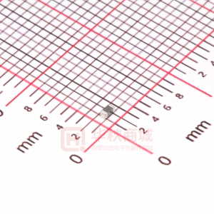

(1/8) Chip Beads(SMD) For Signal Line MMZ Series MMZ1608 Type FEATURES • Chip bead(impeder), MMZ series offers 7 construction materials. • Size standardized for use by automatic assembly equipment. No preferred orientation. • Either flow or reflow soldering methods can be used due to electroplating of the terminal electrodes. • High reliability due to an entirely monolithic structure. • Closed magnetic circuit structure allows high-density installation while preventing crosstalk between circuits. • Low DC resistance structure of electrode prevents wasteful electric power consumption. • The products contain no lead and also support lead-free soldering. • It is a product conforming to RoHS directive. APPLICATIONS Removal of signal line noises of cellular phones, PCs, note PCs, TVs, TV tuners, STBs, audio players, DVDs, DSCs, DVCs, game machines, digital photo frames, car navigation system, PNDs, etc. PRODUCT IDENTIFICATION MMZ 1608 R 121 A T (1) (2) (3) (4) (5) (6) (1) Series name (2) Dimensions L×W (3) Material code (4) Nominal impedance 121:120Ω at 100MHz (5) Characteristic type (6) Packaging style T:Taping HANDLING AND PRECAUTIONS • Before soldering, be sure to preheat components. The preheating temperature should be set so that the temperature difference between the solder temperature and product temperature does not exceed 150°C. • After mounting components onto the printed circuit board, do not apply stress through board bending or mishandling. • Do not expose the inductors to stray magnetic fields. • Avoid static electricity discharge during handling. • When hand soldering, apply the soldering iron to the printed circuit board only. Temperature of the iron tip should not exceed 350°C. Soldering time should not exceed 3 seconds. Conformity to RoHS Directive SHAPES AND DIMENSIONS/RECOMMENDED PC BOARD PATTERN 1.6 ± 0.15 0.8 ± 0.15 0.3 ± 0.2 T 0.6 0.8 0.6 Thickness(T) 0.6±0.15mm 0.8±0.15mm Weight 3mg 4mg 0.8 Dimensions in mm TEMPERATURE RANGES Operating/storage –55 to +125°C PACKAGING STYLE AND QUANTITIES Packaging style Taping Quantity 4000 pieces/reel RECOMMENDED SOLDERING CONDITION REFLOW SOLDERING 10s max. 250 to 260˚C 230˚C Natural cooling 180˚C 150˚C Preheating 60 to 120s Time(s) Soldering 30 to 60s • Conformity to RoHS Directive: This means that, in conformity with EU Directive 2002/95/EC, lead, cadmium, mercury, hexavalent chromium, and specific bromine-based flame retardants, PBB and PBDE, have not been used, except for exempted applications. • Please contact our Sales office when your application are considered the following: The device’s failure or malfunction may directly endanger human life (e.g. application for automobile/aircraft/medical/nuclear power devices, etc.) • All specifications are subject to change without notice. 012-01 / 20100324 / e9412_mmz1608.fm (2/8) MATERIAL CHARACTERISTICS B material: This type is perfectly suited for fast digital signals. By equalizing R components and X components that beads possess at a frequency of 5MHz, it is able to suppress overshooting, undershooting and ringing of fast digital signals. R material: For wide frequency applications calling for broad impedance characteristics. For digital signal line applications calling requiring good waveform integrity. Impedance values selected for effectiveness at 10 to 200MHz. S material: Standard type that features impedance characteristics similar to those of a typical ferrite core. For signal line applications in which the blocking region is near 100MHz. Impedance values selected for effectiveness at 40 to 300MHz. Y material: High frequency range type intended for the 100MHz region and above. For signal line applications in which the signal frequency is far from the cutoff frequency. Impedance values selected for effectiveness at 80 to 400MHz. A material: This high-impedance product is based on the impedance frequency characteristics of our Y-material. The product offers excellent impedance characteristics, which is greater than 2500Ω, in the vicinity of 100MHz range (MMZ1608A252B). Q material:For high-band applications designed for 100MHz and above. Impedance values selected for effectiveness at 100 to 800MHz. D material: For applications calling for low insertion loss at low frequencies and sharply increasing impedance at high frequencies. Designed for high impedance at high frequencies (300MHz to 1GHz) for signal line applications. F material: This new product inherits the characteristic of our D-material, namely its sharp impedance rise time, and its impedance peak frequency has been shifted higher into range. The product offers excellent noise suppression from 600MHz to as high as in the GHz range. TYPICAL MATERIAL CHARACTERISTICS 2500 A 2000 Impedance(Ω) 1500 1000 500 B 0 10 100 Frequency(MHz) 1000 R S Y Q D F ELECTRICAL CHARACTERISTICS Part No. MMZ1608B121C MMZ1608B221C MMZ1608B301C MMZ1608B471C MMZ1608B601C MMZ1608B102C MMZ1608R150A MMZ1608R300A MMZ1608R600A MMZ1608R121A MMZ1608R301A MMZ1608R471A MMZ1608R601A MMZ1608R102A MMZ1608S400A MMZ1608S800A MMZ1608S121A MMZ1608S181A MMZ1608S221A MMZ1608S301A MMZ1608S471A MMZ1608S601A MMZ1608S102A MMZ1608S202A MMZ1608Y150B MMZ1608Y300B MMZ1608Y600B MMZ1608Y121B MMZ1608Y221B MMZ1608Y301B MMZ1608Y471B MMZ1608Y601B MMZ1608Y751B MMZ1608Y102B MMZ1608Y152B MMZ1608A182B MMZ1608A222B MMZ1608A252B MMZ1608Q121B MMZ1608Q221B MMZ1608Q331B MMZ1608Q471B MMZ1608Q601B MMZ1608Q102B MMZ1608D050C MMZ1608D100C MMZ1608D220C MMZ1608D500C MMZ1608D800C MMZ1608D800B MMZ1608D121C MMZ1608D121B MMZ1608D241C MMZ1608D301B MMZ1608F030B MMZ1608F470B MMZ1608F750B MMZ1608F121B ∗ Impedance (Ω ) [100MHz]∗ 120±25% 220±25% 300±25% 470±25% 600±25% 1000±25% 15±25% 30±25% 60±25% 120±25% 300±25% 470±25% 600±25% 1000±25% 40±25% 80±25% 120±25% 180±25% 220±25% 300±25% 470±25% 600±25% 1000±25% 2000±25% 15±25% 30±25% 60±25% 120±25% 220±25% 300±25% 470±25% 600±25% 750±25% 1000±25% 1500±25% 1800±25% 2200±25% 2500±25% 120±25% 220±25% 330±25% 470±25% 600±25% 1000±25% 5±2Ω 10±5Ω 22±25% 50±25% 80±25% 80±25% 120±25% 120±25% 240±25% 300±25% 3typ. 47±25% 75±25% 120±25% Rated DC resistance current (Ω )max. (mA)max. 0.15 600 0.25 500 0.25 500 0.30 500 0.40 500 0.60 300 0.05 1500 0.05 1500 0.10 800 0.18 500 0.25 500 0.30 500 0.40 500 0.50 400 0.10 600 0.15 500 0.15 500 0.20 500 0.20 500 0.30 500 0.30 500 0.35 500 0.50 400 0.90 200 0.05 1500 0.05 1500 0.15 500 0.20 500 0.30 500 0.30 500 0.35 500 0.40 500 0.45 500 0.50 400 0.60 300 0.80 200 0.80 200 0.80 200 0.30 500 0.40 500 0.50 400 0.70 300 0.80 200 1.00 200 0.05 700 0.10 500 0.20 500 0.25 500 0.30 500 0.30 500 0.30 400 0.30 400 0.60 300 0.70 300 0.05 700 0.40 500 0.55 300 0.75 200 Product’s thickness T(mm) 0.6 0.6 0.6 0.6 0.6 0.8 0.8 0.8 0.8 0.8 0.8 0.8 0.8 0.8 0.8 0.8 0.8 0.8 0.8 0.8 0.8 0.8 0.8 0.8 0.8 0.8 0.8 0.8 0.8 0.8 0.8 0.8 0.8 0.8 0.8 0.8 0.8 0.8 0.8 0.8 0.8 0.8 0.8 0.8 0.8 0.6 0.6 0.6 0.6 0.8 0.6 0.8 0.8 0.8 0.8 0.8 0.8 0.8 Test equipment: E4991A or equivalent Test tool: 16192A or equivalent Test temperature: 25±10°C • All specifications are subject to change without notice. 012-01 / 20100324 / e9412_mmz1608.fm (3/8) TYPICAL ELECTRICAL CHARACTERISTICS Z, X, R vs. FREQUENCY CHARACTERISTICS MMZ1608B121C MMZ1608B221C 200 300 250 Impedance(Ω) Impedance(Ω) MMZ1608B301C 400 200 Z Impedance(Ω) 150 Z 300 Z 100 150 R 200 R R 100 50 X 50 X 100 X 0 1 10 100 1000 Frequency (MHz) 10000 0 1 10 100 1000 Frequency (MHz) 10000 0 1 10 100 1000 Frequency (MHz) 10000 MMZ1608B471A 600 500 Impedance(Ω) MMZ1608B601C 800 700 Impedance(Ω) MMZ1608B102C 1200 1000 Impedance(Ω) 600 500 400 300 200 Z R X 400 Z 800 600 Z 300 200 100 0 10 R R 400 200 X X 100 10000 0 1 10 100 1000 Frequency (MHz) 10000 100 1000 Frequency (MHz) 0 10 100 1000 Frequency (MHz) 10000 MMZ1608R150A 30 25 Impedance(Ω) MMZ1608R300A 60 50 Impedance(Ω) MMZ1608R600A 120 100 Impedance(Ω) 20 15 10 5 0 1 10 Z R X 40 30 Z 80 60 40 20 Z R X 20 R 10 10000 0 1 10 X 100 1000 Frequency (MHz) 100 1000 Frequency (MHz) 10000 0 1 10 100 1000 Frequency (MHz) 10000 MMZ1608R121A 200 MMZ1608R301A 400 MMZ1608R471A 600 500 Impedance(Ω) Impedance(Ω) Impedance(Ω) 150 300 Z R 400 Z 100 Z R X 200 300 R 200 100 50 100 X X 0 1 10 100 1000 Frequency (MHz) 10000 0 1 10 100 1000 Frequency (MHz) 10000 0 10 100 1000 Frequency (MHz) 10000 • All specifications are subject to change without notice. 012-01 / 20100324 / e9412_mmz1608.fm (4/8) TYPICAL ELECTRICAL CHARACTERISTICS Z, X, R vs. FREQUENCY CHARACTERISTICS MMZ1608R601A MMZ1608R102A 1000 800 Impedance(Ω) MMZ1608S400A 60 50 Impedance(Ω) Z R 1200 1000 Impedance(Ω) 600 400 200 X Z R 800 600 Z R 40 30 20 10 400 200 X X 0 1 10 100 1000 Frequency (MHz) 10000 0 1 10 100 1000 Frequency (MHz) 10000 0 1 10 100 1000 Frequency (MHz) 10000 MMZ1608S800A 120 100 Z Impedance(Ω) MMZ1608S121A 200 MMZ1608S181A 300 250 Impedance(Ω) 80 60 40 20 0 1 10 Impedance(Ω) 150 R Z R 200 150 100 50 Z R 100 X 50 X X 100 1000 Frequency (MHz) 10000 0 1 10 100 1000 Frequency (MHz) 10000 0 10 100 1000 Frequency (MHz) 10000 MMZ1608S221A 300 250 Impedance(Ω) MMZ1608S301A 400 MMZ1608S471A 600 500 Impedance(Ω) 200 150 100 X Z R Impedance(Ω) 300 Z 400 Z 200 R X 300 R 200 100 X 100 50 0 1 10 100 1000 Frequency (MHz) 10000 0 1 10 100 1000 Frequency (MHz) 10000 0 1 10 100 1000 Frequency (MHz) 10000 MMZ1608S601A 800 MMZ1608S102A 1200 1000 MMZ1608S202A 2500 2000 Z Impedance(Ω) Z Impedance(Ω) Impedance(Ω) 600 Z R 800 600 400 R 1500 1000 500 0 R X 400 200 X X 200 10000 0 1 10 100 1000 Frequency (MHz) 10000 0 1 10 100 1000 Frequency (MHz) 1 10 100 1000 Frequency (MHz) 10000 • All specifications are subject to change without notice. 012-01 / 20100324 / e9412_mmz1608.fm (5/8) TYPICAL ELECTRICAL CHARACTERISTICS Z, X, R vs. FREQUENCY CHARACTERISTICS MMZ1608Y150B MMZ1608Y300B 30 25 Impedance(Ω) Impedance(Ω) MMZ1608Y600B 120 100 Impedance(Ω) 60 50 40 Z 20 15 10 5 0 1 10 100 1000 Frequency (MHz) 10000 Z R X 80 Z 30 R 60 40 20 R 20 10 0 1 10 X X 100 1000 Frequency (MHz) 10000 0 1 10 100 1000 Frequency (MHz) 10000 MMZ1608Y121B 300 250 Impedance(Ω) MMZ1608Y221B 400 350 Impedance(Ω) Z MMZ1608Y301B 600 500 Impedance(Ω) 300 250 200 150 100 50 200 150 100 50 0 1 10 100 1000 Frequency (MHz) 10000 Z R X 400 300 Z R X R X 200 100 0 1 10 100 1000 Frequency (MHz) 10000 0 1 10 100 1000 Frequency (MHz) 10000 MMZ1608Y471B 800 700 MMZ1608Y601B 800 700 Impedance(Ω) MMZ1608Y751B 1000 800 Impedance(Ω) Z R Impedance(Ω) 600 500 400 300 200 100 0 1 10 100 1000 Frequency (MHz) 10000 X Z R 600 500 400 300 200 100 0 1 10 100 1000 Frequency (MHz) 10000 X 600 400 Z R X 200 0 1 10 100 1000 Frequency (MHz) 10000 MMZ1608Y102B 1200 1000 Impedance(Ω) MMZ1608Y152B 1600 1400 Impedance(Ω) Z R 1200 1000 800 600 400 200 X Z R 800 600 400 200 0 1 10 X 100 1000 Frequency (MHz) 10000 0 1 10 100 1000 Frequency (MHz) 10000 • All specifications are subject to change without notice. 012-01 / 20100324 / e9412_mmz1608.fm (6/8) TYPICAL ELECTRICAL CHARACTERISTICS Z, X, R vs. FREQUENCY CHARACTERISTICS MMZ1608A182B MMZ1608A222B 2000 Z R MMZ1608A252B 3000 2500 ZR Impedance(Ω) 2500 2000 Impedance(Ω) Impedance(Ω) 1500 2000 1500 1000 1500 1000 500 0 ZR 1000 X 500 X X 500 1 10 100 1000 Frequency (MHz) 10000 0 1 10 100 1000 Frequency (MHz) 10000 0 1 10 100 1000 Frequency (MHz) 10000 MMZ1608Q121B 400 MMZ1608Q221B 600 500 MMZ1608Q331B 800 700 Impedance(Ω) Z R Impedance(Ω) Impedance(Ω) 300 Z R 600 500 400 300 200 100 400 300 200 100 Z R 200 100 X X X 0 1 10 100 1000 Frequency (MHz) 10000 0 1 10 100 1000 Frequency (MHz) 10000 0 1 10 100 1000 Frequency (MHz) 10000 MMZ1608Q471B 1200 1000 Impedance(Ω) Z MMZ1608Q601B 1600 1400 Impedance(Ω) MMZ1608Q102B 2000 Impedance(Ω) 1200 1000 800 600 400 X Z R 1500 Z R 800 R 600 400 200 0 1 10 X 1000 500 X 200 10000 0 1 10 100 1000 Frequency (MHz) 0 100 1000 Frequency (MHz) 10000 1 10 100 1000 Frequency (MHz) 10000 MMZ1608D050C 30 25 Impedance(Ω) MMZ1608D100C 100 80 Impedance(Ω) MMZ1608D220C 200 20 15 10 5 0 1 10 100 1000 Frequency (MHz) 10000 Z R X 60 Z Impedance(Ω) 150 Z 40 20 0 R X 100 R 50 X 1 10 100 1000 Frequency (MHz) 10000 0 1 10 100 1000 Frequency (MHz) 10000 • All specifications are subject to change without notice. 012-01 / 20100324 / e9412_mmz1608.fm (7/8) TYPICAL ELECTRICAL CHARACTERISTICS Z, X, R vs. FREQUENCY CHARACTERISTICS MMZ1608D500C MMZ1608D800C 400 600 500 Impedance(Ω) Z R Impedance(Ω) MMZ1608D800B 800 700 Z R Impedance(Ω) 300 600 500 400 300 200 100 X Z R 400 300 200 100 200 100 X X 0 1 10 100 1000 Frequency (MHz) 10000 0 1 10 100 1000 Frequency (MHz) 10000 0 1 10 100 1000 Frequency (MHz) 10000 MMZ1608D121C 800 700 Impedance(Ω) MMZ1608D121B 800 700 Impedance(Ω) MMZ1608D241C 1200 1000 Z R Impedance(Ω) 600 500 400 300 200 100 0 1 10 100 1000 Frequency (MHz) 10000 X Z R 600 500 400 300 200 100 0 1 10 X 800 600 400 200 Z R X 100 1000 Frequency (MHz) 10000 0 1 10 100 1000 Frequency (MHz) 10000 MMZ1608D301B 3000 2500 MMZ1608F030B 50 40 Impedance(Ω) MMZ1608F470B 1000 800 Z R X Impedance(Ω) Impedance(Ω) 2000 1500 1000 Z R X 30 20 10 0 1 600 400 Z 500 0 1 10 100 1000 Frequency (MHz) 10000 200 R 10 100 1000 Frequency (MHz) 10000 0 X 1 10 100 1000 Frequency (MHz) 10000 MMZ1608F750B 2000 MMZ1608F121B 6000 5000 Impedance(Ω) Impedance(Ω) 1500 4000 3000 2000 R 1000 500 Z 1000 Z X 0 1 X 10 100 1000 Frequency (MHz) R 10000 0 1 10 100 1000 Frequency (MHz) 10000 • All specifications are subject to change without notice. 012-01 / 20100324 / e9412_mmz1608.fm (8/8) PACKAGING STYLES REEL DIMENSIONS 1.0 2.0± 0.5 ø13± 0.2 ø21± 0.8 ø180± 2.0 8.4 +2.0 –0.0 14.4max. ø60min. Dimensions in mm TAPE DIMENSIONS Sprocket hole 1.5 +0.1 –0.0 Cavity 1.75±0.1 300min. Dimensions in mm 1.9±0.2 3.5±0.05 8.0±0.3 1.1max. 1.1± 0.2 4.0± 0.1 2.0± 0.05 4.0± 0.1 160min. Taping 200min. Drawing direction • All specifications are subject to change without notice. 012-01 / 20100324 / e9412_mmz1608.fm
