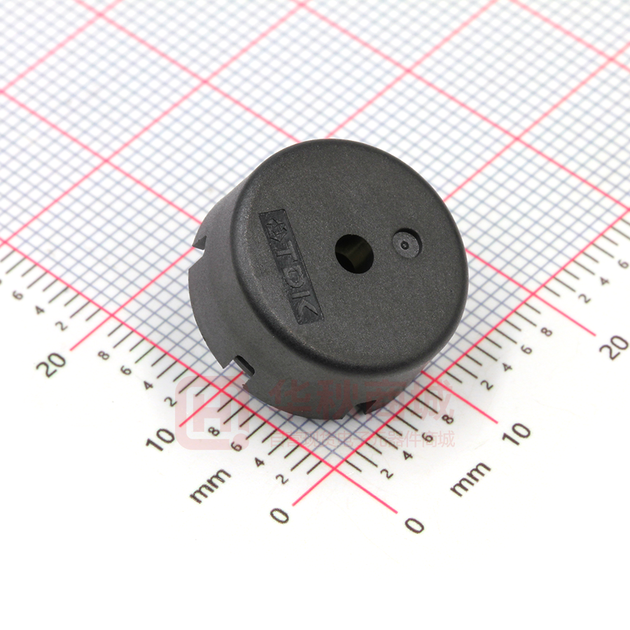

PS1720P02
PS1720P02
    TDK(东电化)
    MIC_D17X8MM_TM
    压电 蜂鸣器 传感器,外部驱动 3 V - 2kHz 70dB @ 3V,10cm 通孔 PC 引脚
PS1720P02 数据手册
Piezoelectronic Buzzers Pin terminal/Lead Without oscillator circuit PS series Issue date: July 2008 • All specifications are subject to change without notice. • Conformity to RoHS Directive: This means that, in conformity with EU Directive 2002/95/EC, lead, cadmium, mercury, hexavalent chromium, and specific bromine-based flame retardants, PBB and PBDE, have not been used, except for exempted applications. (1/6) Piezoelectronic Buzzers(without circuit) PS Series(Pin Terminal/Lead) FEATURES APPLICATIONS Conformity to RoHS Directive • The PS series are high-performance buzzers that employ unimorph piezoelectric elements and are designed for easy incorporation into various circuits. • They feature extremely low power consumption in comparison to electromagnetic units. • Because these buzzers are designed for external excitation, the same part can serve as both a musical tone oscillator and a buzzer. • They can be used with automated inserters. Moisture-resistant models are also available. • The lead wire type(PS1550L40N) with both-sided adhesive tape installed easily is prepared. SPECIFICATIONS AND CHARACTERISTICS Type PS12 Type PS14 Type PS17 Type PS19 Type PS1920P02 Others Type PS12 Type PS14 Type PS17 Type PS19 Type Others PS1550L40N Part No. PS1240P02BT PS1240P02CT3 PS1440P02BT PS1420P02CT PS1720P02 PS1927P02 PS1920P02 PS1550L40N Part No. PS1240P02BT PS1240P02CT3 PS1440P02BT PS1420P02CT PS1720P02 PS1927P02 External dimensions Outer diameter Height (mm) (mm) ø12.2 6.5 ø12.2 3.5 ø14 8 ø14 11 ø17 8 10.5 ø19 [excluding terminal] 10.5 ø19 [excluding terminal] ø15 1.6 Applications For warning and alarm sounds of home appliances(air conditioners, refrigerators, fan forced heaters, cordless telephones, etc.) For potted circuit (washing machines, drying machines, hot water supply systems, etc.) Digital camera Electric ranges, washing machines, computer terminals, various devices that require speech synthesis output. SOUND MEASURING METHOD Piezoelectric buzzer DC power supply Driver circuit Measuring distance 10cm Anechoic chamber Frequency counter Recorder Standard microphone AMP Filter (A curve) Testing input voltage Pitch (mm) 5 5 5 5 10 20 20 — Characteristics Sound pressure (dB(A)/10cm) 70 min. 60 min. 75 min. 70 min. 70 min. 90 min. 80 min. Frequency (kHz) 4 4 4 2 2 2.7 2 Input voltage (Vo-p)[Rectangular wave] 3 3 3 5 3 10 10 Depend on the installation condition Features • Compact • Automatic mountable • 12.7mm pitch radial taping • Thin type • Automatic mountable • 12.7mm pitch radial taping • High sound pressure • Automatic mountable • 15mm pitch radial taping • Low frequency tone • Automatic mountable • 15mm pitch radial taping • Low frequency tone • High sound pressure • High sound pressure • Water-proof processing element • Low frequency tone • Water-proof processing element • Compact, Thin type • Fix in both-sided adhesive tape • Conformity to RoHS Directive: This means that, in conformity with EU Directive 2002/95/EC, lead, cadmium, mercury, hexavalent chromium, and specific bromine-based flame retardants, PBB and PBDE, have not been used, except for exempted applications. • All specifications are subject to change without notice. 006-02 / 20080717 / ef532_ps.fm (2/6) PIN TERMINAL TYPE PS12 TYPE PS1240P02BT FEATURES • Miniature size(ø12.2× T6.5mm). • High cost performance. • Suitable for automatic radial taping machine(12.7mm-pitch). SHAPES AND DIMENSIONS 6.5 ± 0.3 ø12.2 ± 0.3 12.7±1 SPECIFICATIONS AND CHARACTERISTICS Sound pressure Temperature Operating Storage range Maximum input voltage Minimum delivery unit 70dBA/ 10cm min. –20 to +70°C –30 to +80°C 30V0-P max. 2500 pieces [at 4kHz, 3V0-P rectangular wave, measuring temperature: 25±5°C, humidity: 60±10%] [without DC bias] [500 pieces/1 reel× 5 reels] 0.5 ± 0.2 FREQUENCY SOUND PRESSURE CHARACTERISTICS SINE WAVE DRIVE SQUARE WAVE DRIVE 90 at 3Vrms sine wave 80 at 3V0-P square wave 18+2, –0 0.65+0, –0.1 Sound pressure (dB/10cm) 80 Sound pressure (dB/10cm) 2000 5000 Frequency (Hz) 10000 70 5 ± 0.5 12.7± 0.3 ø4 ± 0.2 Dimensions in mm 70 60 60 1000 50 1000 2000 5000 Frequency (Hz) 10000 PS1240P02CT3 FEATURES • Thin type(ø12.2× T3.5mm). • Suitable for automatic radial taping machine(12.7mm-pitch). SHAPES AND DIMENSIONS 3.5 ± 0.3 0.5 ± 0.3 ø12.2 ± 0.5 12.7±1 SPECIFICATIONS AND CHARACTERISTICS Sound pressure Temperature Operating Storage range Maximum input voltage Minimum delivery unit 60dBA/ 10cm min. –20 to +70°C –30 to +80°C 30V0-P max. 2500 pieces [at 4kHz, 3V0-P rectangular wave, measuring temperature: 25±5°C, humidity: 60±10%] [without DC bias] [500 pieces/1 reel× 5 reels] 18+2, –0 0.65+0, –0.1 FREQUENCY SOUND PRESSURE CHARACTERISTICS SINE WAVE DRIVE SQUARE WAVE DRIVE 90 at 3Vrms sine wave 80 at 3V0-P square wave 5 ± 0.5 12.7± 0.3 ø4 ± 0.2 Sound pressure (dB/10cm) Sound pressure (dB/10cm) 80 70 Dimensions in mm 70 60 60 1000 2000 5000 Frequency (Hz) 10000 50 1000 2000 5000 Frequency (Hz) 10000 • All specifications are subject to change without notice. 006-02 / 20080717 / ef532_ps.fm (3/6) PS14 TYPE PS1440P02BT FEATURES • High sound pressure. • Miniature size(ø14× T8mm). • Suitable for automatic radial taping machine(15mm-pitch). SHAPES AND DIMENSIONS 8± 0.5 ø14 ± 0.5 15 ±1 0.5 ± 0.2 SPECIFICATIONS AND CHARACTERISTICS Sound pressure Temperature Operating range Storage Maximum input voltage Minimum delivery unit 75dBA/ 10cm min. –20 to +70°C –30 to +80°C 30V0-P max. 1750 pieces [at 4kHz, 3V0-P rectangular wave, measuring temperature: 25±5°C, humidity: 60±10%] [without DC bias] [350 pieces/1 reel× 5 reels] FREQUENCY SOUND PRESSURE CHARACTERISTICS SINE WAVE DRIVE SQUARE WAVE DRIVE 100 at 3Vrms sine wave 90 at 3V0-P square wave 18+2, –0 0.65+0, –0.1 Sound pressure (dB/10cm) Sound pressure (dB/10cm) 90 80 5 ± 0.5 15 ± 0.3 ø4 ± 0.2 Dimensions in mm 80 70 70 1000 2000 5000 Frequency (Hz) 10000 60 1000 2000 5000 Frequency (Hz) 10000 PS1420P02CT FEATURES • Low frequency tone(2kHz). • Suitable for automatic radial taping machine(15mm-pitch). SHAPES AND DIMENSIONS 11± 0.5 ø14 ± 0.5 15 ±1 SPECIFICATIONS AND CHARACTERISTICS Sound pressure Temperature Operating range Storage Maximum input voltage Minimum delivery unit 70dBA/ 10cm min. –20 to +70°C –30 to +80°C 30V0-P max. 1750 pieces [at 2kHz, 5V0-P rectangular wave, measuring temperature: 25±5°C, humidity: 60±10%] [without DC bias] [350 pieces/1 reel× 5 reels] 0.5 ± 0.2 FREQUENCY SOUND PRESSURE CHARACTERISTICS SINE WAVE DRIVE SQUARE WAVE DRIVE 90 at 3Vrms sine wave 80 at 3V0-P square wave 18+2, –0 0.65+0, –0.1 Sound pressure (dB/10cm) Sound pressure (dB/10cm) 5 ± 0.5 15 ± 0.3 ø4 ± 0.2 80 70 Dimensions in mm 70 60 60 1000 2000 5000 Frequency (Hz) 10000 50 1000 2000 5000 Frequency (Hz) 10000 • All specifications are subject to change without notice. 006-02 / 20080717 / ef532_ps.fm (4/6) PS17 TYPE PS1720P02 FEATURES • Low frequency tone. • High sound pressure. SHAPES AND DIMENSIONS ø17 8 0.5 A SPECIFICATIONS AND CHARACTERISTICS Sound pressure 70dBA/ 10cm min. [at 2kHz, 3V0-P rectangular wave, measuring temperature: 25±5°C, humidity: 60±10%] 4 10 Temperature Operating –20 to +70°C range Storage –30 to +80°C Maximum input voltage 30V0-P max. Minimum delivery unit 1500 pieces [without DC bias] 10 FREQUENCY SOUND PRESSURE CHARACTERISTICS SINE WAVE DRIVE SQUARE WAVE DRIVE 90 at 3Vrms sine wave 80 at 3V0-P square wave A 0.4 ± 0.1 0.65+0, –0.1 Tolerance: ± 0.3 Dimensions in mm Sound pressure (dB/10cm) Sound pressure (dB/10cm) 80 70 70 60 60 1000 2000 5000 Frequency (Hz) 10000 50 1000 2000 5000 Frequency (Hz) 10000 PS19 TYPE PS1920P02 FEATURES • Low frequency tone(2kHz). • Piezo element is coated with water proof processing. SHAPES AND DIMENSIONS 23max. SPECIFICATIONS AND CHARACTERISTICS Sound pressure Temperature Operating range Storage Maximum input voltage Minimum delivery unit 80dBA/ 10cm min. –20 to +70°C –30 to +80°C 20V0-P max. 600 pieces [at 2kHz, 10V0-P rectangular wave, measuring temperature: 25±5°C, humidity: 60±10%] [without DC bias] FREQUENCY SOUND PRESSURE CHARACTERISTICS SINE WAVE DRIVE SQUARE WAVE DRIVE 90 at 3Vrms sine wave 80 at 3V0-P square wave 7.4 9.5 10.5 Sound hole Sound pressure (dB/10cm) Sound pressure (dB/10cm) 2000 5000 Frequency (Hz) 10000 1.26 Dimensions in mm ø19 23 20 80 70 • It considers that water escapes from sound release hole and please decide an attachment angle. 70 60 60 1000 50 1000 2000 5000 Frequency (Hz) 10000 • All specifications are subject to change without notice. 006-02 / 20080717 / ef532_ps.fm (5/6) PS19 TYPE PS1927P02 FEATURES • High sound pressure. • Piezo element is coated with water proof processing. SHAPES AND DIMENSIONS 23max. SPECIFICATIONS AND CHARACTERISTICS Sound pressure Temperature Operating range Storage Maximum input voltage Minimum delivery unit 90dBA/ 10cm min. –20 to +70°C –30 to +80°C 20V0-P max. 600 pieces [at 2.7kHz, 10V0-P rectangular wave, measuring temperature: 25±5°C, humidity: 60±10%] [without DC bias] FREQUENCY SOUND PRESSURE CHARACTERISTICS SINE WAVE DRIVE SQUARE WAVE DRIVE 100 at 3Vrms sine wave 90 at 3V0-P square wave ø19 7.4 9.5 10.5 Sound hole Sound pressure (dB/10cm) Sound pressure (dB/10cm) 2000 5000 Frequency (Hz) 10000 2.1 Dimensions in mm 23 20 90 80 • It considers that water escapes from sound release hole and please decide an attachment angle. 80 70 70 1000 60 1000 2000 5000 Frequency (Hz) 10000 LEAD WIRE TYPE PS15 TYPE PS1550L40N FEATURES • Miniature size(ø15× T1.6mm). • High cost performance. • The installation of this type is easy with both-sided tape. • This product adopts an excellent both-sided adhesive tape in bonding and the sound characteristic. SHAPES AND DIMENSIONS ø15 ± 0.3 40 ± 5 SPECIFICATIONS AND CHARACTERISTICS Temperature Operating range Storage Maximum input voltage Minimum delivery unit –20 to +70°C –30 to +80°C 20V0-P max. 4000 pieces [without DC bias] FREQUENCY SOUND PRESSURE CHARACTERISTICS SINE WAVE DRIVE SQUARE WAVE DRIVE 100 at 2.83Vrms sine wave 90 at 3V0-P square wave Sound pressure (dB/10cm) Sound pressure (dB/10cm) Black 2 ± 1.5 90 80 Red 0.2 ± 0.1 ø10 ± 0.3 ø14 ± 0.3 UL1571 AWG32 Both-sided adhesive tape 0.75 ± 0.3 80 70 Metal 70 1000 2000 5000 Frequency (Hz) 10000 60 1000 2000 5000 Frequency (Hz) 10000 Element Dimensions in mm ∗ The frequency characteristic changes depending on the case shape and the installation method. • All specifications are subject to change without notice. 006-02 / 20080717 / ef532_ps.fm (6/6) PRECAUTIONS FOR USE • Do not apply DC bias to the piezoelectric buzzer; otherwise insulation resistance may become low and affect the performance. • Do not supply any voltage higher than applicable to the piezoelectric buzzer. • Do not use the piezoelectric buzzer outdoors. It is designed for indoor use. If the piezoelectric buzzer has to be used outdoors, provide it with waterproofing measures; it will not operate normally if subjected to moisture. • Do not wash the piezoelectric buzzer with solvent or allow gas to enter it while washing; any solvent that enters it may stay inside a long time and damage it. • A piezoelectric ceramic material of approximately 100µm thick is used in the sound generator of the buzzer. Do not press the sound generator through the sound release hole otherwise the ceramic material may break. Do not stack the piezoelectric buzzers without packing. • Do not apply any mechanical force to the piezoelectric buzzer; otherwise the case may deform and result in improper operation. • Do not place any shielding material or the like just in front of the sound release hole of the buzzer; otherwise the sound pressure may vary and result in unstable buzzer operation. Make sure that the buzzer is not affected by a standing wave or the like. • Be sure to solder the buzzer terminal at 350°C max.(80W max.)(soldering iron trip) within 5 seconds using a solder containg silver. • Avoid using the piezoelectric buzzer for a long time where any corrosive gas (H2S, etc.) exists; otherwise the parts or sound generator may corroded and result in improper operation. • Be careful not to drop the piezoelectric buzzer. RECOMMENDED OPERATING CIRCUIT EXAMPLE VCC Piezoelectric buzzer Tr (Equivalent to C1815) GND C-MOS, etc R ∗ Resistor to do charging and discharging to a piezoelectric element (Value of about 1kΩ is good efficiency). • All specifications are subject to change without notice. 006-02 / 20080717 / ef532_ps.fm R∗
