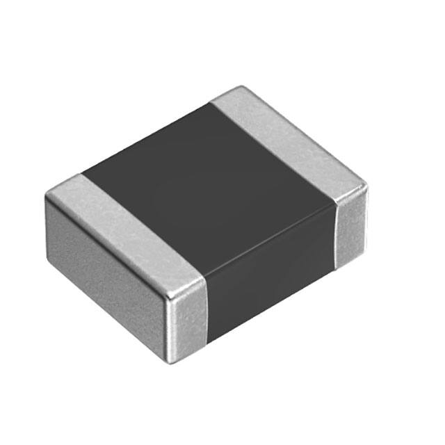

    FIXED IND 1.5UH 3.2A 57MOHM SMD
TFM322512ALMA1R5MTAA 数据手册
I N D U C T O R S Inductors for power circuits Thin-film metal magnetic material TFM-ALMA series (for automotive) RoHS REACH SVHC-Free Cl Br Pb Halogen Free Lead Free AEC-Q200 TFM322512ALMA type FEATURES By using metal magnetic material with high Saturation magnetic flux density the excellent DC bias characteristics needed for inductors for power circuits can be achieved. With the same product shape and terminal structure as general chip parts it has excellent mounting stability characteristics and can also be mounted to general-purpose land patterns. By using a closed magnetic circuit structure leakage flux is minimized. Compliant with AEC-Q200 APPLICATION ADAS ECU, in-Vehicle camera (view camera, sensing camera), radar, meter cluster, automotive communication module Other power supply circuit uses PART NUMBER CONSTRUCTION TFM 322512 ALM A 1R0 M T AA Series name L×W×H dimensions 3.2×2.5×1.2 mm Characteristic type Automotive use Inductance (µH) Inductance tolerance Packaging style Internal code CHARACTERISTICS SPECIFICATION TABLE L (µH) 0.10 0.15 0.22 0.33 0.47 0.68 1.0 1.5 2.2 3.3 4.7 6.8 10  Tolerance ±20% ±20% ±20% ±20% ±20% ±20% ±20% ±20% ±20% ±20% ±20% ±20% ±20% L measuring frequency DC resistance Rated current (MHz) 1 1 1 1 1 1 1 1 1 1 1 1 1 (m )max. 8 9 11 15 21 30 37 57 77 113 151 260 360 Isat (A)max. 14 12 10 8.6 6.9 5.5 4.6 4.0 3.3 2.5 2.2 1.8 1.6 (m )typ. 3 5 6 10 16 23 30 46 64 97 127 220 305 (A)typ. 16 14 12 9.5 7.6 6.1 5.1 4.5 3.6 2.8 2.5 2.1 1.8 Rated voltage Itemp (A)max. 8.0 8.0 7.0 6.0 5.3 4.4 4.0 3.2 2.7 2.3 1.9 1.4 1.2 (A)typ. 13 11 9.5 7.3 6.1 5.0 4.4 3.5 3.0 2.5 2.1 1.6 1.4 (V)max. 20 20 20 20 20 20 20 20 20 20 20 20 20 Part No. TFM322512ALMAR10MTAA TFM322512ALMAR15MTAA TFM322512ALMAR22MTAA TFM322512ALMAR33MTAA TFM322512ALMAR47MTAA TFM322512ALMAR68MTAA TFM322512ALMA1R0MTAA TFM322512ALMA1R5MTAA TFM322512ALMA2R2MTAA TFM322512ALMA3R3MTAA TFM322512ALMA4R7MTAA TFM322512ALMA6R8MTAA TFM322512ALMA100MTAA Rated current: smaller value of either Isat or Itemp. Isat: When based on the inductance change rate (30% below the initial L value) Itemp: When based on the temperature increase (temperature increase of 40°C by self heating) Please contact us for the rated current vs. temperature characteristics (derating) at a product temperature of 85°C or higher. Measurement equipment Measurement item Product No. L 4294A DC resistance Digital Milliohm Meter Rated current Isat 4285A+42841A+42842C * Equivalent measurement equipment may be used. Manufacturer Keysight Technologies Keysight Technologies Please be sure to request delivery specifications that provide further details on the features and specifications of the products for proper and safe use. Please note that the contents may change without any prior notice due to reasons such as upgrading. (1/4) 20220902 inductor_automotive_power_tfm322512alma_en.fm I N D U C T O R S TFM322512ALMA type L FREQUENCY CHARACTERISTICS 100 6R8 4R7 10 3R3 2R2 Inductance(µH) 1R5 1R0 1 R68 R47 R33 R22 R15 0.1 R10 0.01 0.1 1 10 100 Frequency(MHz) Measurement equipment Product No. Manufacturer 4294A Keysight Technologies * Equivalent measurement equipment may be used. INDUCTANCE VS. DC BIAS CHARACTERISTICS 100 10 100 Inductance(µH) 6R8 4R7 3R3 2R2 1R5 1 1R0 R68 R47 R33 R22 R15 0.1 0.01 R10 0 2 4 6 8 10 DC current(A) 12 14 16 18 Measurement equipment Product No. Manufacturer 4285A+42841A+42842C Keysight Technologies * Equivalent measurement equipment may be used. Please be sure to request delivery specifications that provide further details on the features and specifications of the products for proper and safe use. Please note that the contents may change without any prior notice due to reasons such as upgrading. (2/4) 20220902 inductor_automotive_power_tfm322512alma_en.fm I N D U C T O R S TFM322512ALMA type SHAPE & DIMENSIONS PACKAGING STYLE REEL DIMENSIONS 3.20±0.20 1.20max. ø60min. 2.50±0.20 1.0 0.60±0.30 2.0±0.5 8.4 +2.0 –0.0 ø13±0.2 14.4max. ø21±0.8 0.60±0.30 ø180±2.0 Dimensions in mm Dimensions in mm 1.5 +0.1 –0 2.0±0.05 4.0±0.1 2.5 B 8.0±0.2 RECOMMENDED LAND PATTERN 4.0±0.1 A K 3.5±0.1 Sprocket hole 1.75±0.1 TAPE DIMENSIONS Cavity Dimensions in mm 0.8 2.0 0.8 Type TFM322512ALMA Dimensions in mm 160min. A 2.8 Taping B 3.5 K 1.4 200min. RECOMMENDED REFLOW PROFILE Preheating Soldering Natural cooling 300min. Drawing direction Peak Dimensions in mm 250 to 260°C PACKAGE QUANTITY Temperature 230°C 230°C 10s max. 60 to 120s 2000 pcs/reel TEMPERATURE RANGE, INDIVIDUAL WEIGHT 180°C 150°C Package quantity 30 to 50s Operating Storage Individual temperature range temperature range weight –55 to +150 °C –55 to +150 °C 0.052 g  Operating temperature range includes self-temperature rise.  The storage temperature range is for after the assembly. Time Please be sure to request delivery specifications that provide further details on the features and specifications of the products for proper and safe use. Please note that the contents may change without any prior notice due to reasons such as upgrading. (3/4) 20220902 inductor_automotive_power_tfm322512alma_en.fm I N D U C T O R S REMINDERS FOR USING THESE PRODUCTS Before using these products, be sure to request the delivery specifications. SAFETY REMINDERS Please pay sufficient attention to the warnings for safe designing when using this products. REMINDERS The storage period is within 6 months. Be sure to follow the storage conditions (temperature: 5 to 40°C, humidity: 20 to 75% RH or less). If the storage period elapses, the soldering of the terminal electrodes may deteriorate. Do not use or store in locations where there are conditions such as gas corrosion (salt, acid, alkali, etc.). Before soldering, be sure to preheat components. The preheating temperature should be set so that the temperature difference between the solder temperature and chip temperature does not exceed 150°C. Soldering corrections after mounting should be within the range of the conditions determined in the specifications. If overheated, a short circuit, performance deterioration, or lifespan shortening may occur. When embedding a printed circuit board where a chip is mounted to a set, be sure that residual stress is not given to the chip due to the overall distortion of the printed circuit board and partial distortion such as at screw tightening portions. Self heating (temperature increase) occurs when the power is turned ON, so the tolerance should be sufficient for the set thermal design. Carefully lay out the coil for the circuit board design of the non-magnetic shield type. A malfunction may occur due to magnetic interference. Use a wrist band to discharge static electricity in your body through the grounding wire. Do not expose the products to magnets or magnetic fields. Do not use for a purpose outside of the contents regulated in the delivery specifications. The products described in this catalog are intended to be installed in automobiles or automotive electronic equipment (AV equipment, telecommunications equipment, home appliances, amusement equipment, computer equipment, personal equipment, office equipment, measurement equipment, industrial robots) and to be used in automobiles (including the case where the said automotive product is mounted in a vehicle) or standard applications as general electronic equipment in automotive applications or standard applications as general electronic equipment in automotive applications in accordance with the scope and conditions described in this specification, while the said automotive or general electronic equipment including the said product is intended to be used in the usual operation and usage methods, respectively. Other than automotive or automotive products are not designed or warranted to meet the requirements of the applications listed below, whose performance and/or quality requires a more stringent level of safety or reliability, or whose failure, malfunction or defect could cause serious damage to society, person or property. Please understand that we are not responsible for any damage or liability caused by use of the products in any of the applications below or for any other use exceeding the range or conditions set forth in this specification sheet. If you intend to use the products in the applications listed below or if you have special requirements exceeding the range or conditions set forth in this specification, please contact us. (1) Aerospace/aviation equipment (2) Transportation equipment (electric trains, ships, etc.) (3) Medical equipment (4) Power-generation control equipment (5) Atomic energy-related equipment   (6) Seabed equipment (7) Transportation control equipment (8) Public information-processing equipment (9) Military equipment (10) Electric heating apparatus, burning equipment (11) Disaster prevention/crime prevention equipment (12) Safety equipment (13) Other applications that are not considered general-purpose applications When designing your equipment even for general-purpose applications, you are kindly requested to take into consideration securing protection circuit/device or providing backup circuits in your equipment. Please be sure to request delivery specifications that provide further details on the features and specifications of the products for proper and safe use. Please note that the contents may change without any prior notice due to reasons such as upgrading. (4/4) 20220902 inductor_automotive_power_tfm322512alma_en.fm
