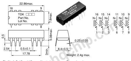

LAN Components Common-Mode Filters DIP FEATURES • These parts conform to ISO8802-3 (IEEE802.3)10BASE-T. • Transfer molded for highest quality and dimensional accuracy. • They employ toroidal ferrite cores. SHAPES AND DIMENSIONS/CIRCUIT DIAGRAM 22.86max. 16 TDK Part No. Lot No. 1 0.5 8 5.08max. 1 0.25 ± 0.05 8.4 ± 0.5 Weight: 2.4g max. Dimensions in mm Tolerance: ± 0.25 2 3 9 7.8max. TLA Series TLA490LP 16 15 14 11 10 9 N1 N2 N3 N1 N2 N3 6 7 8 17.78 •Pin No.4, 5, 12 and 13 are without pin. TEMPERATURE RANGES Operating Storage 0 to +70°C –40 to +100°C ELECTRICAL CHARACTERISTICS Part No. TLA490LP Turns ratio N1:N2:N3 1 :1:1 Inductance (µH) N1 85±20% DC resistance (Ω)max. N1 0.25 N2 0.25 N3 0.25 Insulation resistance (MΩ)min. [DC.100V] 100 Withstand voltage Erms(V) [50Hz, 60s] 100 3min. 2.54 0.5 ± 0.1 D321_TLA490LP 980513 Specifications which provide more details for the proper and safe use of the described product are available upon request. All specifications are subject to change without notice.

器件简介: - TLA490LP是一款共模滤波器,符合ISO8802-3 (IEEE802.3)10BASE-T标准,采用传递模塑技术以保证最高质量和尺寸精度,使用环形铁氧体磁芯。
引脚分配: - 引脚编号4、5、12和13没有引脚。尺寸以毫米为单位,公差为±0.25mm。

封装信息: - 封装形式为DIP,具体尺寸和电路图可以通过提供的链接查看:![fig_17149](https://p3-flow-imagex-sign.byteimg.com/ocean-cloud-tos/pdf/efc38d1c53aa536f3e3dea7cca73bd2b_0_1200.jpg~tplv-a9rns2rl98-resize-crop:57:312:502:522:445:210.jpeg?rk3s=1567c5c4&x-expires=1770452540&x-signature=TLEPLcSw5bTMR4wNvCZPUNDiyLc%3D)。
