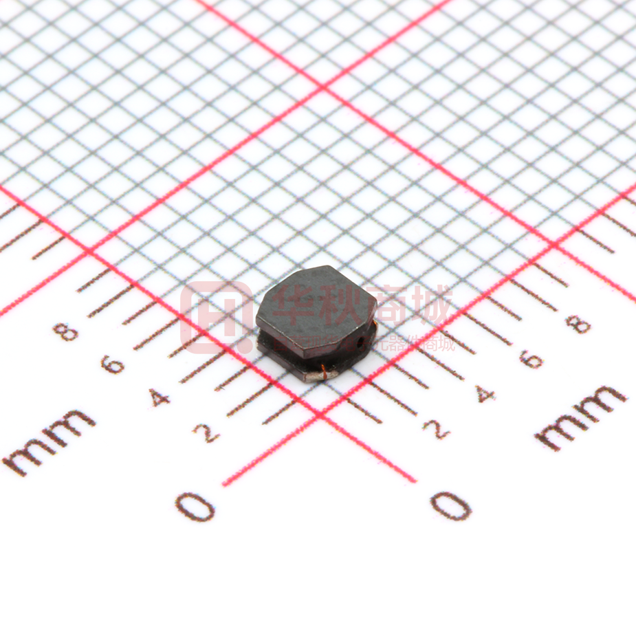

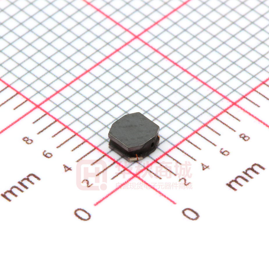

Inductors for power circuits
Wound ferrite
Overview of VLS3012E type
FEATURES
Magnetic shield type wound inductor for power circuits.
Low-profile product.
High magnetic shield construction and compatible with high-density mounting.
APPLICATION
Smart phones, tablet terminals, HDDs, SSDs, DVCs, DSCs, mobile display panels, portable game devices, compact power supply
modules, other

VLS3012E type
3.0±0.1
SHAPE & DIMENSIONS
(0.9)
(1.2)
(0.9)
1.2max.
3.0±0.1
Dimensions in mm
3.0
RECOMMENDED LAND PATTERN
1.0
1.0
1.0
Dimensions in mm
