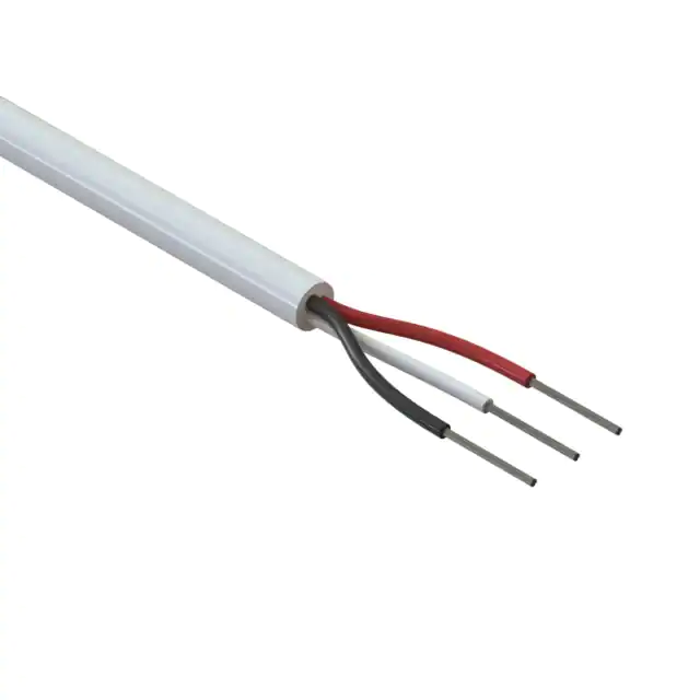

Conductor Conductor count: 3 Gauge: 22 AWG 0.34 mm2 Material: tinned copper strands Strand size: Ø 0.16 x 17 Resistance at 20 °C: 59.4 Ω /km max Insulator Material: PVC Color: black, white, red Diameter: Ø 1.35 ±0.1 mm Nominal thickness: 0.28 mm Resistance at 20 °C: 10 MΩ /km min Outer jacket Material: PVC Color: white Diameter: Ø 4.5 ±0.2 mm Nominal thickness: 0.80 mm Tests Insulation tensile strength: 2.11 kgf/mm2 Jacket tensile strength: 1.05 kgf/mm2 After aging at 113 ±2 °C for 7 days: Minimum tensile strength 70 % original Minimum elongation 65 % original Heat shock: 121 ±1 °C /1 hour, no observed degradation Deformation: 121 ±1 °C /1 hour, ≤ 50 % Cold bend: -10 ±2 °C /1 hour, no observed cracking A A1 Date: 06/25/2014 09/05/2018 Conductor Description: Verified: Increased operating temperature range PS Digitally signed by GL Date: 2018.09.05 16:21:09 -07'00' Digitally signed by PS Date: 2018.09.05 17:07:18 -07'00' Dimensions are in millimeters. Tolerances: X: 0.5 mm X.X: 0.3 mm X.XX: 0.05 mm 4 17 6x Notes: Prepared: GL Initial release 5 Jacket Insulation 0. 1 Revision: 4.5 ±0.20 1.35 ±0.10 Wire marking: E339579 UL AWM STYLE 2464 22 AWG 80°C 300V VW-1 - - - cUL AWM I/II A 80°C 300V FT1 LF TENSILITY RoHS and REACH compliant Function test: no open, no short circuit, no intermittent tel fax Description: Wire, 3C TS, 22 AWG, UL2464, 300V, 80C, 4.5 mm, VW-1, PVC, white 3 2 1.541.323.3228 1.541.323.4202 Size: Part number: A 30-00372 Scale: 800 web 877.670.7118 tensility.com Sheet 1 of 1 10:1 1 To see a custom version of this cable assembly, call Tensility at 541-323-3228 or email engineering@tensility.com Ratings Voltage: 300 V Temperature: -25 ~ 80 °C Flammability: VW-1
