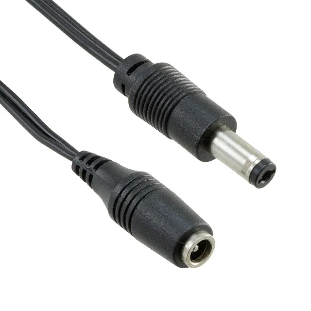

    CABLE ASSY 5.5X2.1MM M/F 3'
CA-2216 数据手册
part number: CA-2216 description: Extension cable, 5.5 x 2.1 mm dc jack to P5 plug, 3 feet, 18 AWG, zip cord date: unit: page: rev: 01/19/09 mm 1 of 2 A Specifications: plug description (1) plug overmold (2,5) receptacle description (6) cable description (3) cable outer diameter cable material cable color cable gauge cable length twist tie (4) max voltage max current 2.10 x 5.50 x 22 ±0.5, nickel-plated, with black insulator 30P, black PVC (including strain relief) 2.10 x 5.50, nickel-plated 0.16 x 41, 2 conductor, black twin wire 4.4 ± 0.1 (each conductor 2.2) UL 2468 black AWG #18 915 ±50 black 36 Vdc 3A Notes: RoHS compliant Function test: no open, no reversed polarity, no short circuit, no INT Hi-Pot test: 600 Vac, 05 mA, 1 second Mechanical drawing: tolerance X: ±0.5 mm .X: ±0.25 mm .XX: ±0.05 mm 29033 Avenue Sherman Ste 203 Valencia, CA 91355 ph 661.702.0035 fx 661.702.0038 www.tensility.com part number: CA-2216 description: Extension cable, 5.5 x 2.1 mm dc jack to P5 plug, 3 feet, 18 AWG, zip cord date: unit: page: rev: 01/19/09 mm 2 of 2 A Revision notes: Rev A Date Description January 19, 2009 Re-issued; original specification issued by CUI, re-issued by Tensility without any material or mechanical changes. tolerance X: ±0.5 mm .X: ±0.25 mm .XX: ±0.05 mm 29033 Avenue Sherman Ste 203 Valencia, CA 91355 ph 661.702.0035 fx 661.702.0038 www.tensility.com
