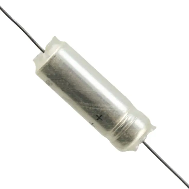

    钽电容 轴向 1mF ±10% 15V 1.2Ω Ф10.31 x 30.91mm -
109D108X9015K2 数据手册
109D www.vishay.com Vishay Wet Tantalum Capacitors Sintered Anode TANTALEX™ Capacitors for Operation to +125 °C, Elastomer-Sealed FEATURES • Axial through-hole terminations: standard tin / lead (SnPb), 100 % tin (RoHS-compliant) available Available • Vishay Sprague model 109D tubular Available elastomer-sealed, sintered anode TANTALEX capacitors fill the basic requirements for applications where a superior quality, reliable design for industrial, automotive and Available telecommunications application is desired • Model 109D capacitors are the commercial equivalents of Tansitor style WC, UWC, Mallory-NACC style TLS, TLH and the military style CL64 and CL65, designed to meet the performance requirements of military specification MIL-DTL-3965 • Material categorization: for definitions of compliance please see www.vishay.com/doc?99912 Note * This datasheet provides information about parts that are RoHS-compliant and / or parts that are non RoHS-compliant. For example, parts with lead (Pb) terminations are not RoHS-compliant. Please see the information / tables in this datasheet for details PERFORMANCE CHARACTERISTICS Operating Temperature: -55 °C to +85 °C  (to +125 °C with voltage derating) Following the life test: 1. DCL shall not exceed the initial requirements or 1 μA, whichever is greater. Capacitance Tolerance: at 120 Hz, +25 °C. ± 20 % standard. ± 10 %, ± 5 % available as special. 2. The ESR shall meet the initial requirement. DC Leakage Current (DCL max.): at +25 °C, +85 °C, +125 °C: leakage current shall not exceed the values listed in the Standard Ratings tables. Life Test: capacitors are capable of withstanding a 2000 h life test at a temperature of +85 °C or +125 °C at the applicable DC working voltage. 3. Change in capacitance shall not exceed 10 % from the initial measurement. For capacitors with voltage ratings of 15 VDC and below, change in capacitance shall not exceed + 10 %, - 25 % from the initial measurement. ORDERING INFORMATION 109D 207 X0 006 C 0 E3 MODEL CAPACITANCE CAPACITANCE TOLERANCE DC VOLTAGE RATING AT +85 °C CASE CODE STYLE NUMBER RoHS-COMPLIANT This is expressed in picofarads. The first two digits are the significant figures. The third is the number of zeros to follow X0 = ± 20 % X9 = ± 10 % X5 = ± 5 % special order This is expressed in volts. To complete the three-digit block, zeros precede the voltage rating. A decimal point is indicated by an “R” (6R3 = 6.3 V) See Ratings and Case Codes table 0 = no outer sleeve Standard 2 = outer plastic film insulation E3 = 100 % tin termination (RoHS-compliant) Blank = SnPb termination (standard design) Note • Packaging: the use of formed plastic trays for packaging these axial lead components is standard. Tape and reel is not available due to the unit weight Revision: 05-Feb-2020 Document Number: 40023 1 For technical questions, contact: tantalum@vishay.com THIS DOCUMENT IS SUBJECT TO CHANGE WITHOUT NOTICE. THE PRODUCTS DESCRIBED HEREIN AND THIS DOCUMENT ARE SUBJECT TO SPECIFIC DISCLAIMERS, SET FORTH AT www.vishay.com/doc?91000 109D www.vishay.com Vishay DIMENSIONS in inches [millimeters] L - + 0.250 [6.35] max. 0.025 [0.635] dia. (no. 22 AWG) tinned solderable leads WITH PLASTIC-FILM INSULATING SLEEVE BARE TUBE CASE CODE D D L LEAD LENGTH L (1) D MAX. C 0.188 ± 0.016 [4.78 ± 0.41] 0.453 + 0.031 / - 0.016 [11.51 + 0.79 / - 0.41] 0.219 [5.56] 0.608 [15.45] 1.500 ± 0.250 [38.10 ± 6.35] F 0.281 ± 0.016 [7.14 ± 0.41] 0.641 + 0.031 / - 0.016 [16.28 + 0.79 / - 0.41] 0.312 [7.92] 0.796 [20.22] 2.250 ± 0.250 [57.15 ± 6.35] T 0.375 ± 0.016 [9.53 ± 0.41] 0.766 + 0.031 / - 0.016 [19.46 + 0.79 / - 0.41] 0.406 [10.31] 0.921 [23.40] 2.250 ± 0.250 [57.15 ± 6.35] K (2) 0.375 ± 0.016 [9.53 ± 0.41] 1.062 + 0.031 / - 0.016 [26.97 + 0.79 / - 0.41] 0.406 [10.31] 1.217 [30.91] 2.250 ± 0.250 [57.15 ± 6.35] Notes (1) For reference only (2) Replaces previous W case RATINGS AND CASE CODES (Standard) μF 6V 8V 10 V 15 V 20 V 25 V 30 V 35 V 50 V 60 V 75 V 100 V C 2.5 3.0 C 3.5 C 3.6 C C 4.0 4.5 C 4.7 C 5.0 C 6.8 C 7.0 C 8.0 C 8.2 C 9.0 F C 10 C F 11 F 13 F 14 F C 15 C F 18 T C 20 22 C 25 C F C F F F C 27 30 125 V C 1.7 T C C T 33 C F 39 F 40 F T 43 T 47 C 50 56 60 Revision: 05-Feb-2020 F F T C T K T Document Number: 40023 2 For technical questions, contact: tantalum@vishay.com THIS DOCUMENT IS SUBJECT TO CHANGE WITHOUT NOTICE. THE PRODUCTS DESCRIBED HEREIN AND THIS DOCUMENT ARE SUBJECT TO SPECIFIC DISCLAIMERS, SET FORTH AT www.vishay.com/doc?91000 109D www.vishay.com Vishay RATINGS AND CASE CODES (Standard) μF 6V 68 70 82 86 100 110 120 140 150 160 170 180 220 250 270 290 300 330 350 390 430 540 560 750 850 1200 C 8V 10 V 15 V 20 V 25 V 30 V 35 V F F 50 V 60 V 75 V 100 V 125 V T F T K F F/T T K F T F K T K T F F T T F T F T T K T K T K T T K T K K K RATINGS AND CASE CODES (Extended) μF 2.0 6.8 8.2 10 12 15 18 22 27 33 39 47 56 68 82 86 100 110 120 140 150 160 6V 8V 10 V 15 V 20 V 25 V 30 V 35 V 50 V 60 V 75 V 100 V 125 V C C C C C C C C C C C C C C C C C C F C F F C F F C F C F T T F T T K K T C C F T C F F C Revision: 05-Feb-2020 K T C F T Document Number: 40023 3 For technical questions, contact: tantalum@vishay.com THIS DOCUMENT IS SUBJECT TO CHANGE WITHOUT NOTICE. THE PRODUCTS DESCRIBED HEREIN AND THIS DOCUMENT ARE SUBJECT TO SPECIFIC DISCLAIMERS, SET FORTH AT www.vishay.com/doc?91000 109D www.vishay.com Vishay RATINGS AND CASE CODES (Extended) μF 6V 180 200 220 250 270 330 350 390 470 510 540 560 680 750 820 1000 1200 1500 1800 2200 8V 10 V 15 V 20 V C 25 V 30 V F F F F F F 35 V T T T K F F 50 V T 60 V 75 V T T T K K K 100 V 125 V T F F F F T T T K T T F T K K F F T T/K K T K T/K K K K STANDARD RATINGS MAX. DCL MAX. ESR MAX. IMP. (μA) AT CAPACITANCE CASE AT +25 °C AT -55 °C (1) (μF) CODE PART NUMBER 120 Hz 120 Hz +25 °C +85 °C () () +125 °C 30 68 140 270 290 330 560 1200 C C F F T T T K 109D306X0006C0 109D686X0006C0 109D147X0006F0 109D277X0006F0 109D297X0006T0 109D337X0006T0 109D567X0006T0 109D128X0006K0 22 25 56 220 290 430 850 C C C F T T K 109D226X0008C0 109D256X0008C0 109D566X0008C0 109D227X0008F0 109D297X0008T0 109D437X0008T0 109D857X0008K0 20 47 100 180 250 390 750 C C F F T T K 109D206X0010C0 109D476X0010C0 109D107X0010F0 109D187X0010F0 109D257X0010T0 109D397X0010T0 109D757X0010K0 6 VDC AT +85 °C; 7 VDC AT +125 °C 4.2 100 1.0 2.0 4.0 60 1.0 2.0 2.0 40 1.0 3.0 4.0 25 1.0 7.0 2.0 24 2.0 7.0 2.1 20 2.0 7.9 3.0 25 2.0 13 1.6 20 3.0 14 8 VDC AT +85 °C; 5 VDC AT +125 °C 6.0 115 1.0 2.0 4.2 100 1.0 2.0 4.0 59 1.0 2.0 4.0 30 1.0 7.0 2.0 24 2.0 9.5 3.2 25 2.0 14 1.0 22 4.0 16 10 VDC AT +85 °C; 7 VDC AT +125 °C 5.0 175 1.0 2.0 5.0 100 1.0 2.0 2.1 60 1.0 4.0 4.0 40 1.0 7.0 2.0 30 2.0 10 3.0 25 2.0 16 1.0 23 4.0 16 MAX. CAPACITANCE CHANGE (%) AT MAX. RMS RIPPLE CURRENT 120 Hz (mA) -55 °C +85 °C +125 °C -40 -40 -40 -44 -70 -44 -64 -80 +10.5 +14 +14 +17.5 +20 +14 +17.5 +25 +12 +16 +16 +20 +20 +16 +20 +25 140 160 330 270 410 410 340 530 -40 -40 -40 -44 -70 -64 -80 +10.5 +10.5 +14 +17.5 +20 +17.5 +25 +12 +12 +16 +20 +20 +20 +25 130 140 160 270 410 410 670 -32 -36 -36 -36 -40 -64 -80 +10.5 +14 +14 +14 +14 +17.5 +25 +12 +16 +16 +16 +16 +20 +25 140 160 270 270 410 340 670 Note (1) Part numbers shown are for units with ± 20 % capacitance tolerance and uninsulated capacitors. For ± 10 % units, change the digit following the letter “X” from “0” to “9”. For units with outer plastic-film insulation, substitute “2” for “0” at the end of the part number. For RoHS-compliant add “E3” Revision: 05-Feb-2020 Document Number: 40023 4 For technical questions, contact: tantalum@vishay.com THIS DOCUMENT IS SUBJECT TO CHANGE WITHOUT NOTICE. THE PRODUCTS DESCRIBED HEREIN AND THIS DOCUMENT ARE SUBJECT TO SPECIFIC DISCLAIMERS, SET FORTH AT www.vishay.com/doc?91000 109D www.vishay.com Vishay STANDARD RATINGS MAX. DCL MAX. ESR MAX. IMP. (μA) AT CAPACITANCE CASE AT +25 °C AT -55 °C (1) PART NUMBER (μF) CODE 120 Hz 120 Hz +85 °C +25 °C +125 °C () () MAX. CAPACITANCE CHANGE (%) AT -55 °C +85 °C +125 °C MAX. RMS RIPPLE CURRENT 120 Hz (mA) 15 VDC AT +85 °C; 10 VDC AT +125 °C 15 C 109D156X0015C0 6.0 155 1.0 2.0 -24 +10.5 +12 130 33 C 109D336X0015C0 5.0 90 1.0 2.0 -28 +14 +16 160 70 F 109D706X0015F0 3.6 75 1.0 4.0 -28 +14 +16 270 120 F 109D127X0015F0 4.0 50 1.0 7.0 -28 +17.5 +20 270 270 T 109D277X0015T0 3.0 30 2.0 16 -56 +17.5 +20 340 540 K 109D547X0015K0 1.2 23 6.0 24 -80 +25 +25 610 20 VDC AT +85 °C; 13 VDC AT +125 °C 27 C 109D276X0020C0 5.0 100 1.0 2.0 -20 +11 +14 160 220 T 109D227X0020T0 4.0 3 2.0 16 -48 +13 +15 410 130 25 VDC AT +85 °C; 15 VDC AT +125 °C 10 C 109D106X0025C0 6.0 220 1.0 2.0 -16 +8 +9 22 C 109D226X0025C0 5.0 140 1.0 3.0 -20 +10.5 +12 160 50 F 109D506X0025F0 4.0 70 1.0 5.0 -28 +13 +15 270 100 F 109D107X0025F0 4.0 50 1.0 10 -28 +13 +15 270 100 T 109D107X0025T0 4.0 45 2.0 10 -48 +13 +15 410 180 T 109D187X0025T0 4.0 32 2.0 18 -48 +13 +15 340 220 F 109D227X0025F0 2.6 36 3.2 16 -60 +13 +16 300 350 K 109D357X0025K0 1.3 24 7.0 28 -70 +25 +25 580 30 VDC AT +85 °C; 20 VDC AT +125 °C 7.0 C 109D705X0030C0 8.0 275 1.0 2.0 -16 +8 +12 110 8.0 C 109D805X0030C0 7.5 275 1.0 2.0 -16 +8 +12 130 15 C 109D156X0030C0 8.0 175 1.0 2.0 -20 +10.5 +12 160 40 F 109D406X0030F0 4.0 65 1.0 5.0 -24 +10.5 +12 270 68 F 109D686X0030F0 6.0 60 1.0 8.0 -24 +13 +15 270 100 T 109D107X0030T0 6.0 40 2.0 12 -28 +10.5 +12 410 150 T 109D157X0030T0 4.1 35 2.0 18 -48 +13 +15 340 300 K 109D307X0030K0 1.6 25 8.0 32 -60 +25 +25 550 68 F 109D686X0035F0 -24 +12 +15 270 35 VDC AT +85 °C; 22 VDC AT +125 °C 6.0 60 1.0 8 120 T 109D127X0035T0 4.0 38 2.0 16 -30 +13 +15 410 270 K 109D277X0035K0 2.2 23 8.0 32 -45 +20 +25 500 4.5 C 109D455X0050C0 -16 +5 +6 110 50 VDC AT +85 °C; 30 VDC AT +125 °C 9.0 400 1.0 2.0 5.0 C 109D505X0050C0 9.0 400 1.0 2.0 -16 +5 +6 130 10 C 109D106X0050C0 8.0 250 1.0 2.0 -24 +8 +9 160 22 F 109D226X0050F0 7.0 95 1.0 4.0 -20 +10.5 +12 230 25 F 109D256X0050F0 6.0 95 1.0 5.0 -20 +10.5 +12 270 47 F 109D476X0050F0 6.0 70 1.0 9.0 -28 +13 +15 270 60 T 109D606X0050T0 3.0 45 2.0 12 -16 +10.5 +12 410 82 T 109D826X0050T0 4.0 45 2.0 16 -32 +13 +15 340 160 K 109D167X0050K0 2.2 27 8.0 32 -50 +25 +25 460 Note (1) Part numbers shown are for units with ± 20 % capacitance tolerance and uninsulated capacitors. For ± 10 % units, change the digit following the letter “X” from “0” to “9”. For units with outer plastic-film insulation, substitute “2” for “0” at the end of the part number. For RoHS-compliant add “E3” Revision: 05-Feb-2020 Document Number: 40023 5 For technical questions, contact: tantalum@vishay.com THIS DOCUMENT IS SUBJECT TO CHANGE WITHOUT NOTICE. THE PRODUCTS DESCRIBED HEREIN AND THIS DOCUMENT ARE SUBJECT TO SPECIFIC DISCLAIMERS, SET FORTH AT www.vishay.com/doc?91000 109D www.vishay.com Vishay STANDARD RATINGS MAX. DCL MAX. ESR MAX. IMP. (μA) AT CAPACITANCE CASE AT +25 °C AT -55 °C (1) PART NUMBER (μF) CODE 120 Hz 120 Hz +85 °C +25 °C +125 °C () () MAX. CAPACITANCE CHANGE (%) AT -55 °C +85 °C +125 °C MAX. RMS RIPPLE CURRENT 120 Hz (mA) 60 VDC AT +85 °C; 40 VDC AT +125 °C 4.0 C 109D405X0060C0 10.0 550 1.0 2.0 -16 +5 +6 110 8.2 C 109D825X0060C0 8.0 275 1.0 2.0 -24 +8 +9 140 20 F 109D206X0060F0 5.0 105 1.0 5.0 -16 +10.5 +12 270 39 F 109D396X0060F0 7.0 90 1.0 9.0 -28 +10.5 +12 230 50 T 109D506X0060T0 4.0 50 2.0 12 -16 +10.5 +12 410 68 T 109D686X0060T0 6.0 50 2.0 16 -32 +10.5 +12 340 140 K 109D147X0060K0 2.4 28 8.0 32 -40 +20 +20 430 75 VDC AT +85 °C; 50 VDC AT +125 °C 3.5 C 109D355X0075C0 10.0 650 1.0 2.0 -16 +5 +6 110 6.8 C 109D685X0075C0 8.0 300 1.0 2.0 -20 +8 +9 140 13 F 109D136X0075F0 6.0 160 1.0 4.0 -16 +8 +9 190 15 F 109D156X0075F0 6.5 150 1.0 5.0 -16 +8 +9 270 33 F 109D336X0075F0 7.0 90 1.0 10 -24 +10.5 +15 230 40 T 109D406X0075T0 5.0 60 2.0 12 -16 +10.5 +12 410 56 T 109D566X0075T0 6.0 60 2.0 17 -28 +10.5 +15 300 110 K 109D117X0075K0 3.1 29 9.0 36 -35 +20 +20 400 2.5 C 109D255X0100C0 26.5 950 1.0 2.0 -16 +7 +8 100 3.0 C 109D305X0100C0 10.0 800 1.0 2.0 -16 +7 +8 110 4.7 C 109D475X0100C0 10.0 500 1.0 2.0 -16 +7 +8 130 10 F 109D106X0100F0 6.0 215 1.0 4.0 -16 +7 +8 190 11 F 109D116X0100F0 6.0 200 1.0 4.0 -16 +7 +8 230 22 F 109D226X0100F0 7.0 100 1.0 9.0 -16 +7 +8 230 30 T 109D306X0100T0 4.0 80 2.0 12 -16 +7 +8 340 43 T 109D436X0100T0 6.0 70 2.0 17 -20 +7 +8 300 86 K 109D866X0100K0 3.1 30 9.0 36 -25 +15 +15 400 100 VDC AT +85 °C; 65 VDC AT +125 °C 125 VDC AT +85 °C; 85 VDC AT +125 °C 1.7 C 109D175X0125C0 54.6 1250 1.0 2.0 -16 +7 +8 100 3.6 C 109D365X0125C0 15.0 600 1.0 2.0 -16 +7 +8 110 9.0 F 109D905X0125F0 15.0 240 1.0 5.0 -16 +7 +8 210 14 F 109D146X0125F0 12.0 167 1.0 7.0 -16 +7 +8 190 18 T 109D186X0125T0 11.0 129 2.0 9.0 -16 +7 +8 340 25 T 109D256X0125T0 10.0 93 2.0 13 -16 +7 +8 260 56 K 109D566X0125K0 4.1 3.2 10 40 -25 +15 +15 400 Note (1) Part numbers shown are for units with ± 20 % capacitance tolerance and uninsulated capacitors. For ± 10 % units, change the digit following the letter “X” from “0” to “9”. For units with outer plastic-film insulation, substitute “2” for “0” at the end of the part number. For RoHS-compliant add “E3” Revision: 05-Feb-2020 Document Number: 40023 6 For technical questions, contact: tantalum@vishay.com THIS DOCUMENT IS SUBJECT TO CHANGE WITHOUT NOTICE. THE PRODUCTS DESCRIBED HEREIN AND THIS DOCUMENT ARE SUBJECT TO SPECIFIC DISCLAIMERS, SET FORTH AT www.vishay.com/doc?91000 109D www.vishay.com Vishay EXTENDED RATINGS CAPACITANCE CASE PART NUMBER (1) (μF) CODE 140 820 1500 2200 C F T K 109D147X0006C2 109D827X0006F0 109D158X0006T0 109D228X0006K0 180 470 680 1800 C F F K 109D187X0008C0 109D477X0008F0 109D687X0008F0 109D188X0008K0 100 120 150 390 470 560 1000 1200 1200 1500 C C C F F F T K T K 109D107X0010C0 109D127X0010C0 109D157X0010C0 109D397X0010F0 109D477X0010F0 109D567X0010F0 109D108X0010T0 109D128X0010K0 109D128X0010T0 109D158X0010K0 68 82 100 270 330 390 510 540 820 820 1000 C C C F F F T T T K K 109D686X0015C0 109D826X0015C0 109D107X0015C0 109D277X0015F0 109D337X0015F0 109D397X0015F0 109D517X0015T0 109D547X0015T0 109D827X0015T0 109D827X0015K0 109D108X0015K0 56 82 220 330 C C F F 109D566X0020C0 109D826X0020C0 109D227X0020F0 109D337X0020F0 47 68 180 270 350 560 680 750 C C F F T T K K 109D476X0025C0 109D686X0025C0 109D187X0025F0 109D277X0025F0 109D357X0025T0 109D567X0025T0 109D687X0025K0 109D757X0025K2 MAX. DCL MAX. ESR MAX. IMP. (μA) AT AT +25 °C AT -55 °C 120 Hz 120 Hz +85 °C +25 °C () () +125 °C 6 VDC AT +85 °C; 7 VDC AT +125 °C 3.0 54 2.0 9.0 2.5 18 3.0 14 1.5 18 5.0 20 1.0 13 6.0 24 8 VDC AT +85 °C; 5 VDC AT +125 °C 3.0 45 2.0 9.0 2.5 25 3.0 14 2.5 22 3.0 14 1.0 14 7.0 25 10 VDC AT +85 °C; 7 VDC AT +125 °C 3.0 60 2.0 9.0 4.0 60 2.0 9.0 3.0 54 2.0 9.0 2.5 30 3.0 16 2.5 30 3.0 16 2.5 27 3.0 16 1.5 20 5.0 20 1.0 18 7.0 25 1.5 18 5.0 20 1.0 15 7.0 25 15 VDC AT +85 °C; 10 VDC AT +125 °C 4.0 80 2.0 9.0 4.0 80 2.0 9.0 4.0 72 2.0 9.0 2.5 35 3.0 16 2.5 35 3.0 16 2.5 31 3.0 16 1.8 25 6.0 24 1.8 22 6.0 24 1.8 22 6.0 24 1.2 20 8.0 32 1.2 17 8.0 32 20 VDC AT +85 °C; 13 VDC AT +125 °C 4.3 90 2.0 9.0 4.3 81 2.0 9.0 2.7 35 3.0 16 2.7 31 3.0 16 25 VDC AT +85 °C; 15 VDC AT +125 °C 4.3 100 2.0 9.0 4.3 90 2.0 9.0 2.7 37 3.0 16 2.7 33 3.0 16 1.8 27 7.0 28 1.8 24 7.0 28 1.2 19 8.0 32 1.0 18 8.0 29 MAX. CAPACITANCE CHANGE (%) AT MAX. RMS RIPPLE CURRENT 120 Hz (mA) -55 °C +85 °C +125 °C -45 -88 -90 -90 +13 +16 +20 +25 +16 +20 +25 +30 160 300 480 670 -60 -75 -90 -60 +13 +16 +16 +20 +16 +20 +20 +30 180 300 300 670 -50 -45 -55 -70 -65 -77 -75 -75 -88 -88 +13 +13 +13 +16 +16 +16 +20 +30 +20 +25 +16 +16 +16 +20 +20 +20 +25 +30 +25 +30 160 160 180 300 300 300 480 670 480 670 -40 -38 -44 -60 -60 -66 -65 -77 -77 -70 -77 +13 +13 +13 +16 +16 +16 +20 +20 +20 +30 +25 +16 +16 +16 +20 +20 +20 +25 +25 +25 +30 +30 140 160 160 300 300 300 340 440 440 610 610 -38 -43 -60 -66 +13 +13 +16 +16 +16 +16 +20 +20 140 160 300 300 -35 -40 -55 -62 -60 -72 -72 -60 +12 +12 +13 +13 +20 +20 +25 +25 +15 +15 +16 +16 +25 +25 +30 +25 140 160 300 300 440 440 610 610 Note (1) Part numbers shown are for units with ± 20 % capacitance tolerance and uninsulated capacitors. For ± 10 % units, change the digit following the letter “X” from “0” to “9”. For units with outer plastic-film insulation, substitute “2” for “0” at the end of the part number. For RoHS-compliant add “E3” Revision: 05-Feb-2020 Document Number: 40023 7 For technical questions, contact: tantalum@vishay.com THIS DOCUMENT IS SUBJECT TO CHANGE WITHOUT NOTICE. THE PRODUCTS DESCRIBED HEREIN AND THIS DOCUMENT ARE SUBJECT TO SPECIFIC DISCLAIMERS, SET FORTH AT www.vishay.com/doc?91000 109D www.vishay.com Vishay EXTENDED RATINGS MAX. DCL MAX. ESR MAX. IMP. (μA) AT AT +25 °C AT -55 °C CAPACITANCE CASE PART NUMBER (1) 120 Hz 120 Hz (μF) CODE +85 °C +25 °C () () +125 °C 39 47 56 150 180 220 330 390 470 560 C C C F F F T T T K 109D396X0030C0 109D476X0030C0 109D566X0030C0 109D157X0030F0 109D187X0030F0 109D227X0030F0 109D337X0030T0 109D397X0030T0 109D477X0030T0 109D567X0030K0 33 47 120 220 390 470 C C F T T K 109D336X0035C0 109D476X0035C0 109D127X0035F0 109D227X0035T0 109D337X0035T0 109D477X0035K0 22 33 82 120 160 250 270 330 C C F F T T T K 109D226X0050C0 109D336X0050C0 109D826X0050F0 109D127X0050F0 109D167X0050T0 109D257X0050T0 109D277X0050T0 109D337X0050K0 18 27 68 100 140 220 270 C C F F T T K 109D186X0060C0 109D276X0060C0 109D686X0060F0 109D107X0060F0 109D147X0060T0 109D227X0060T0 109D277X0060K0 12 15 22 47 56 82 110 180 200 220 270 C C C F F F T T T K K 109D126X0075C0 109D156X0075C0 109D226X0075C0 109D476X0075F0 109D566X0075F0 109D826X0075F0 109D117X0075T0 109D187X0075T0 109D207X0075T0 109D227X0075K0 109D277X0075K2 30 VDC AT +85 °C; 20 VDC AT +125 °C 5.2 110 2.0 9.0 5.2 100 2.0 9.0 5.2 100 2.0 9.0 2.5 40 3.0 9.0 2.5 40 3.0 16 2.5 36 3.0 16 1.8 28 8.0 16 1.8 28 8.0 32 1.8 25 8.0 32 1.3 20 9.0 32 35 VDC AT +85 °C; 22 VDC AT +125 °C 5.2 130 2.0 9.0 5.2 115 2.0 9.0 2.5 45 3.0 16 1.8 30 8.0 32 1.8 27 8.0 32 1.3 21 9.0 36 50 VDC AT +85 °C; 30 VDC AT +125 °C 5.0 150 2.0 9.0 5.0 135 2.0 9.0 2.5 55 4.0 24 2.5 49 4.0 24 1.8 32 6.0 32 1.8 29 8.0 32 1.8 29 8.0 32 1.5 22 9.0 36 60 VDC AT +85 °C; 40 VDC AT +125 °C 5.0 160 3.0 12 5.0 144 3.0 12 3.0 60 3.0 20 2.5 54 4.0 20 2.0 32 8.0 32 1.8 29 8.0 32 1.5 23 9.0 36 75 VDC AT +85 °C; 50 VDC AT +125 °C 5.0 175 2.0 12 5.0 160 2.0 12 5.0 157 3.0 12 3.0 75 4.0 24 3.0 70 4.0 24 2.5 63 4.0 24 2.0 33 9.0 36 1.8 30 9.0 36 1.8 29 8.0 32 2.2 24 10 40 1.3 24 10 40 MAX. CAPACITANCE CHANGE (%) AT MAX. RMS RIPPLE CURRENT 120 Hz (mA) -55 °C +85 °C +125 °C -28 -30 -38 -40 -45 -60 -45 -50 -65 -65 +10 +10 +12 +12 +13 +13 +20 +20 +20 +25 +12 +12 +15 +15 +16 +16 +25 +25 +25 +30 140 140 140 300 300 300 440 440 550 590 -30 -35 -45 -45 -58 -58 +10 +10 +13 +20 +20 +25 +12 +12 +16 +25 +25 +30 140 140 300 440 440 590 -24 -29 -35 -42 -35 -40 -46 -46 +10 +10 +10 +12 +20 +20 +20 +25 +12 +12 +15 +15 +25 +25 +25 +30 140 140 300 300 420 440 440 550 -20 -24 -30 -36 -30 -40 -45 +10 +10 +12 +12 +16 +16 +20 +12 +12 +15 +15 +20 +20 +25 140 140 270 300 420 440 550 -12 -14 -19 -18 -20 -30 -25 -35 -40 -40 -40 +8 +10 +10 +10 +12 +12 +16 +16 +20 +20 +20 +10 +12 +12 +12 +15 +15 +20 +20 +25 +25 +25 140 140 140 270 270 300 420 440 440 450 450 Note (1) Part numbers shown are for units with ± 20 % capacitance tolerance and uninsulated capacitors. For ± 10 % units, change the digit following the letter “X” from “0” to “9”. For units with outer plastic-film insulation, substitute “2” for “0” at the end of the part number. For RoHS-compliant add “E3” Revision: 05-Feb-2020 Document Number: 40023 8 For technical questions, contact: tantalum@vishay.com THIS DOCUMENT IS SUBJECT TO CHANGE WITHOUT NOTICE. THE PRODUCTS DESCRIBED HEREIN AND THIS DOCUMENT ARE SUBJECT TO SPECIFIC DISCLAIMERS, SET FORTH AT www.vishay.com/doc?91000 109D www.vishay.com Vishay EXTENDED RATINGS MAX. DCL MAX. ESR MAX. IMP. (μA) AT AT +25 °C AT -55 °C CAPACITANCE CASE PART NUMBER (1) 120 Hz 120 Hz (μF) CODE +85 °C +25 °C () () +125 °C MAX. CAPACITANCE CHANGE (%) AT -55 °C +85 °C +125 °C MAX. RMS RIPPLE CURRENT 120 Hz (mA) 100 VDC AT +85 °C; 65 VDC AT +125 °C 2.0 C 109D205X0100C0 14.0 870 3.0 12 -20 +12 +12 100 8.2 C 109D825X0100C0 6.0 250 3.0 12 -12 +12 +12 130 10 C 109D106X0100C0 6.0 200 3.0 12 -17 +10 +12 130 33 F 109D336X0100F0 3.5 85 4.0 24 -18 +15 +15 250 39 F 109D396X0100F0 3.5 80 5.0 24 -20 +12 +15 250 56 T 109D566X0100T0 2.2 45 9.0 36 -20 +15 +15 400 68 T 109D686X0100T0 2.2 40 10 40 -30 +14 +16 400 86 T 109D866X0100T0 3.2 30 10 40 -25 +15 +15 370 120 K 109D127X0100K0 2.8 30 12 48 -35 +15 +17 440 6.8 C 109D685X0125C0 -14 +10 +12 130 125 VDC AT +85 °C; 85 VDC AT +125 °C 11.7 300 3.0 12 27 F 109D276X0125F0 3.5 90 5.0 24 -18 +12 +15 250 39 T 109D396X0125T0 2.2 60 10 40 -16 +14 +16 400 47 T 109D476X0125T0 2.2 50 10 40 -26 +14 +16 400 56 K 109D566X0125K0 4.1 32 10 40 -25 +15 +15 330 82 K 109D826X0125K0 2.8 32 12 48 -30 +15 +17 440 Note (1) Part numbers shown are for units with ± 20 % capacitance tolerance and uninsulated capacitors. For ± 10 % units, change the digit following the letter “X” from “0” to “9”. For units with outer plastic-film insulation, substitute “2” for “0” at the end of the part number. For RoHS-compliant add “E3” Revision: 05-Feb-2020 Document Number: 40023 9 For technical questions, contact: tantalum@vishay.com THIS DOCUMENT IS SUBJECT TO CHANGE WITHOUT NOTICE. THE PRODUCTS DESCRIBED HEREIN AND THIS DOCUMENT ARE SUBJECT TO SPECIFIC DISCLAIMERS, SET FORTH AT www.vishay.com/doc?91000 Legal Disclaimer Notice www.vishay.com Vishay Disclaimer ALL PRODUCT, PRODUCT SPECIFICATIONS AND DATA ARE SUBJECT TO CHANGE WITHOUT NOTICE TO IMPROVE RELIABILITY, FUNCTION OR DESIGN OR OTHERWISE. Vishay Intertechnology, Inc., its affiliates, agents, and employees, and all persons acting on its or their behalf (collectively, “Vishay”), disclaim any and all liability for any errors, inaccuracies or incompleteness contained in any datasheet or in any other disclosure relating to any product. Vishay makes no warranty, representation or guarantee regarding the suitability of the products for any particular purpose or the continuing production of any product. To the maximum extent permitted by applicable law, Vishay disclaims (i) any and all liability arising out of the application or use of any product, (ii) any and all liability, including without limitation special, consequential or incidental damages, and (iii) any and all implied warranties, including warranties of fitness for particular purpose, non-infringement and merchantability. Statements regarding the suitability of products for certain types of applications are based on Vishay’s knowledge of typical requirements that are often placed on Vishay products in generic applications. Such statements are not binding statements about the suitability of products for a particular application. It is the customer’s responsibility to validate that a particular product with the properties described in the product specification is suitable for use in a particular application. Parameters provided in datasheets and / or specifications may vary in different applications and performance may vary over time. All operating parameters, including typical parameters, must be validated for each customer application by the customer’s technical experts. Product specifications do not expand or otherwise modify Vishay’s terms and conditions of purchase, including but not limited to the warranty expressed therein. Except as expressly indicated in writing, Vishay products are not designed for use in medical, life-saving, or life-sustaining applications or for any other application in which the failure of the Vishay product could result in personal injury or death. Customers using or selling Vishay products not expressly indicated for use in such applications do so at their own risk. Please contact authorized Vishay personnel to obtain written terms and conditions regarding products designed for such applications. No license, express or implied, by estoppel or otherwise, to any intellectual property rights is granted by this document or by any conduct of Vishay. Product names and markings noted herein may be trademarks of their respective owners. © 2021 VISHAY INTERTECHNOLOGY, INC. ALL RIGHTS RESERVED Revision: 01-Jan-2021 1 Document Number: 91000

物料型号:Vishay 109D系列
器件简介:Vishay Sprague模型109D是管状弹性体密封、烧结阳极TANTALEX电容器,适用于工业、汽车和电信应用,要求有高质量和可靠的设计。
引脚分配:轴向通孔端子,标准锡/铅(SnPb),100%锡(符合RoHS)可选。
参数特性: - 工作温度范围:-55°C 至 +85°C(通过电压降额可至+125°C) - 电容公差:在120Hz,+25°C时,标准为±20%,也可提供±10%和±5%的特殊规格。 - DC漏电流(DCL max.):在+25°C、+85°C、+125°C时,漏电流不应超过标准等级表中列出的值。 - 寿命测试:电容器能够在+85°C或+125°C的温度下,承受2000小时的寿命测试,在适用的直流工作电压下。
功能详解: - 电容器在经过寿命测试后,应满足以下条件: 1. DCL不应超过初始要求或1μA,以较大者为准。 2. ESR应满足初始要求。 3. 电容变化不应超过初始测量值的10%。
应用信息:适用于需要高性能、高可靠性的场合,如工业、汽车和电信应用。
封装信息:提供不同尺寸和电压等级的封装选项,包括塑料膜绝缘套和无外皮膜的选项。标准封装为成型塑料托盘,由于单位重量原因,不提供胶带和卷轴包装。
