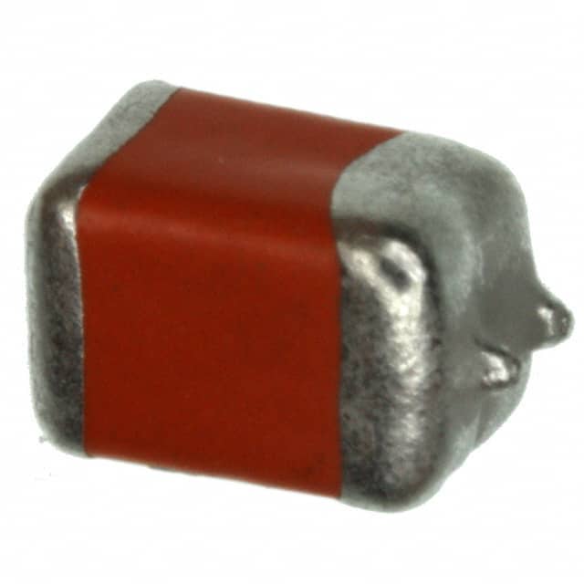

DLA 13008 www.vishay.com Vishay Solid Tantalum Chip Capacitors TANTAMOUNT™, Conformal Coated Case, Ultra Low ESR, DLA Approved FEATURES • High reliability • Surge current testing per MIL-PRF-55365 options • Ultra-low ESR • Tin / lead (SnPb) termination PERFORMANCE CHARACTERISTICS Capacitance Tolerance: ± 10 %, ± 20 % standard www.vishay.com/doc?40211 Operating Temperature: -55 °C to +125 °C (above 85 °C, voltage derating is required) Voltage Rating: 4 VDC to 63 VDC Moisture Sensitivity Level 2a Capacitance Range: 10 μF to 1500 μF ORDERING INFORMATION 13008 -001 K E S A /HR DRAWING NUMBER DASH NUMBER CAPACITANCE TOLERANCE TERMINATION RELIABILITY LEVEL SURGE CURRENT PACKAGING K = ± 10 % M = ± 20 % E = solder plated (Sn/Pb solder) S = voltage aging A = 10 cycles at +25 °C B = 10 cycles at -55 °C / +85 °C (after voltage aging) C = 10 cycles at -55 °C / +85 °C (before voltage aging) Z = no surge Blank = full 7" reel /HR = half 7" reel DIMENSIONS in inches [millimeters] J Tantalum wire nib identifies anode (+) terminal W D L H B A CASE CODE V D E R F Z M H N L (MAX.) 0.299 [7.6] 0.299 [7.6] 0.299 [7.6] 0.299 [7.6] 0.299 [7.6] 0.299 [7.6] 0.315 [8.0] 0.315 [8.0] 0.315 [8.0] W 0.173 ± 0.016 [4.4 ± 0.4] 0.173 ± 0.016 [4.4 ± 0.4] 0.173 ± 0.016 [4.4 ± 0.4] 0.238 ± 0.016 [6.0 ± 0.4] 0.238 ± 0.016 [6.0 ± 0.4] 0.238 ± 0.016 [6.0 ± 0.4] 0.260 + 0.016 / - 0.024 [6.6 + 0.4 / - 0.6] 0.260 + 0.016 / - 0.024 [6.6 + 0.4 / - 0.6] 0.260 + 0.016 / - 0.024 [6.6 + 0.4 / - 0.6] H 0.079 [2.0 max.] 0.138 [3.5 max.] 0.157 ± 0.016 [4.0 ± 0.4] 0.142 ± 0.016 [3.6 ± 0.4] 0.185 ± 0.016 [4.7 ± 0.4] 0.236 ± 0.016 [6.0 ± 0.4] 0.142 ± 0.016 [3.6 ± 0.4] 0.205 ± 0.016 [5.2 ± 0.4] 0.252 ± 0.016 [6.4 ± 0.4] A 0.051 ± 0.012 [1.3 ± 0.3] 0.051 ± 0.012 [1.3 ± 0.3] 0.051 ± 0.012 [1.3 ± 0.3] 0.051 ± 0.012 [1.3 ± 0.3] 0.055 ± 0.016 [1.4 ± 0.4] 0.055 ± 0.016 [1.4 ± 0.4] 0.051 ± 0.012 [1.3 ± 0.3] 0.055 ± 0.016 [1.4 ± 0.4] 0.056 ± 0.017 [1.4 ± 0.4] B 0.181 ± 0.024 [4.6 ± 0.6] 0.181 ± 0.024 [4.6 ± 0.6] 0.181 ± 0.024 [4.6 ± 0.6] 0.181 ± 0.024 [4.6 ± 0.6] 0.181 ± 0.024 [4.6 ± 0.6] 0.181 ± 0.024 [4.6 ± 0.6] 0.197 ± 0.024 [5.0 ± 0.6] 0.197 ± 0.024 [5.0 ± 0.6] 0.196 ± 0.025 [5.0 ± 0.6] D (REF.) 0.252 [6.4] 0.252 [6.4] 0.252 [6.4] 0.244 [6.2] 0.244 [6.2] 0.244 [6.2] 0.260 [6.6] 0.260 [6.6] 0.259 [6.6] J (MAX.) 0.004 [0.1] 0.004 [0.1] 0.004 [0.1] 0.004 [0.1] 0.004 [0.1] 0.004 [0.1] 0.004 [0.1] 0.004 [0.1] 0.004 [0.1] Note • The anode termination (D less B) will be a minimum of 0.012" [0.3 mm] Revision: 17-Jul-2018 Document Number: 40164 1 For technical questions, contact: tantalum@vishay.com THIS DOCUMENT IS SUBJECT TO CHANGE WITHOUT NOTICE. THE PRODUCTS DESCRIBED HEREIN AND THIS DOCUMENT ARE SUBJECT TO SPECIFIC DISCLAIMERS, SET FORTH AT www.vishay.com/doc?91000 DLA 13008 www.vishay.com Vishay RATINGS AND CASE CODES μF 10 15 22 33 47 68 100 150 220 330 470 680 1000 1500 4V 6.3 V V E E R V E E/R R 10 V E E R F 16 V 20 V E F H 25 V 35 V E/R R F Z/N R F F R F F M R F/H 50 V 63 V D R F STANDARD RATINGS MAX. DCL (μA) AT CAPACITANCE (μF) CASE CODE 470 680 1000 1000 1500 V E E R R 330 470 680 1000 V E E R 330 470 680 1000 E E R F 220 330 470 E F H 220 330 330 R F H 68 100 150 220 R F F M 47 68 100 R F F PART NUMBER +25 °C +85 °C +125 °C 4 VDC AT +85 °C; 2.7 VDC AT +125 °C 13008-001(1)ES(2)/(3) 18.8 188.0 225.6 13008-002(1)ES(2)/(3) 27.2 272.0 326.4 13008-003(1)ES(2)/(3) 40.0 400.0 480.0 13008-004(1)ES(2)/(3) 40.0 400.0 480.0 13008-005(1)ES(2)/(3) 60.0 600.0 720.0 6.3 VDC AT +85 °C; 4 VDC AT +125 °C 13008-010(1)ES(2)/(3) 20.8 208.0 249.6 13008-011(1)ES(2)/(3) 29.6 296.0 355.2 13008-012(1)ES(2)/(3) 42.8 428.0 513.6 13008-013(1)ES(2)/(3) 63.0 630.0 756.0 10 VDC AT +85 °C; 7 VDC AT +125 °C 13008-020(1)ES(2)/(3) 33.0 330.0 396.0 13008-021(1)ES(2)/(3) 47.0 470.0 564.0 13008-022(1)ES(2)/(3) 68.0 680.0 816.0 13008-023(1)ES(2)/(3) 100.0 10 000 12 000 16 VDC AT +85 °C; 10 VDC AT +125 °C 13008-030(1)ES(2)/(3) 35.2 352.0 422.4 13008-031(1)ES(2)/(3) 52.8 528.0 633.6 13008-032(1)ES(2)/(3) 75.2 752.0 902.4 20 VDC AT +85 °C; 13 VDC AT +125 °C 13008-040(1)ES(2)/(3) 44.0 440.0 528.0 13008-041(1)ES(2)/(3) 66.0 660.0 792.0 13008-042(1)ES(2)/(3) 66.0 660.0 792.0 25 VDC AT +85 °C; 17 VDC AT +125 °C 13008-050-(1)ES(2)/(3) 17.0 170.0 204.0 13008-051-(1)ES(2)/(3) 25.0 250.0 300.0 13008-052-(1)ES(2)/(3) 37.5 375.0 450.0 13008-053-(1)ES(2)/(3) 55.0 550.0 660.0 35 VDC AT +85 °C; 23 VDC AT +125 °C 13008-060(1)ES(2)/(3) 16.5 165.0 198.0 13008-061(1)ES(2)/(3) 23.8 238.0 285.6 13008-062MES(2)/(3) 35.0 350.0 420.0 MAX. DF (%) AT MAX. ESR AT +25 °C 100 kHz (m) +25 °C +85 °C +125 °C -55 °C 8 6 8 8 8 10 8 10 10 10 12 10 12 12 12 60 25 20 18 24 8 6 6 8 10 8 8 10 12 10 10 12 56 30 25 31 6 6 6 20 8 8 8 24 10 10 10 30 35 28 28 120 8 10 14 10 12 17 12 15 21 60 100 100 8 10 10 10 12 12 12 15 15 80 100 100 6 8 8 8 8 10 10 10 10 12 12 12 100 100 80 100 6 6 8 8 8 10 10 10 12 100 100 100 Note • Part number definitions: (1) Capacitance tolerance: K, M (2) Surge current: A, B, C, Z (3) Packaging: blank, /HR Revision: 17-Jul-2018 Document Number: 40164 2 For technical questions, contact: tantalum@vishay.com THIS DOCUMENT IS SUBJECT TO CHANGE WITHOUT NOTICE. THE PRODUCTS DESCRIBED HEREIN AND THIS DOCUMENT ARE SUBJECT TO SPECIFIC DISCLAIMERS, SET FORTH AT www.vishay.com/doc?91000 DLA 13008 www.vishay.com Vishay STANDARD RATINGS MAX. DCL (μA) AT CAPACITANCE (μF) CASE CODE 15 15 22 33 47 47 E R R F Z N 10 15 22 D R F PART NUMBER +25 °C +85 °C MAX. DF (%) AT +125 °C MAX. ESR AT +25 °C 100 kHz (m) +25 °C +85 °C +125 °C -55 °C 6 6 6 6 6 6 8 8 8 8 8 8 10 10 10 10 10 10 350 250 220 150 240 150 6 6 6 8 8 8 10 10 10 400 400 250 50 VDC AT +85 °C; 33 VDC AT +125 °C 13008-070(1)ES(2)/(3) 7.5 75.0 90.0 13008-071(1)ES(2)/(3) 7.5 75.0 90.0 13008-072(1)ES(2)/(3) 11.0 110.0 132.0 13008-073(1)ES(2)/(3) 16.5 165.0 198.0 13008-074(1)ES(2)/(3) 23.5 235.0 282.0 13008-075(1)ES(2)/(3) 23.5 235.0 282.0 63 VDC AT +85 °C; 42 VDC AT +125 °C 13008-080(1)ES(2)/(3) 10.0 100.0 120.0 13008-081(1)ES(2)/(3) 9.5 95.0 114.0 13008-082(1)ES(2)/(3) 13.9 139.0 166.8 Note • Part number definitions: (1) Capacitance tolerance: K, M (2) Surge current: A, B, C, Z (3) Packaging: blank, /HR POWER DISSIPATION CASE CODE V D E R, F, M Z H N MAXIMUM PERMISSIBLE POWER DISSIPATION AT +25 °C (W) IN FREE AIR 0.141 0.215 0.240 0.250 0.265 0.265 0.280 STANDARD PACKAGING QUANTITY CASE CODE V D E R F Z M H N UNITS PER REEL 7" FULL REEL 1000 400 500 300 250 250 200 200 200 7" HALF REEL 500 200 250 150 125 125 100 100 100 PRODUCT INFORMATION Conformal Coated Guide Pad Dimensions www.vishay.com/doc?40150 Packaging Dimensions Moisture Sensitivity (MSL) www.vishay.com/doc?40135 SELECTOR GUIDES Solid Tantalum Selector Guide www.vishay.com/doc?49053 FAQ Frequently Asked Questions Revision: 17-Jul-2018 www.vishay.com/doc?40110 Document Number: 40164 3 For technical questions, contact: tantalum@vishay.com THIS DOCUMENT IS SUBJECT TO CHANGE WITHOUT NOTICE. THE PRODUCTS DESCRIBED HEREIN AND THIS DOCUMENT ARE SUBJECT TO SPECIFIC DISCLAIMERS, SET FORTH AT www.vishay.com/doc?91000 Conformal Coated Guide www.vishay.com Vishay Sprague Guide for Conformal Coated Tantalum Capacitors INTRODUCTION Tantalum electrolytic capacitors are the preferred choice in applications where volumetric efficiency, stable electrical parameters, high reliability, and long service life are primary considerations. The stability and resistance to elevated temperatures of the tantalum / tantalum oxide / manganese dioxide system make solid tantalum capacitors an appropriate choice for today's surface mount assembly technology. Vishay Sprague has been a pioneer and leader in this field, producing a large variety of tantalum capacitor types for consumer, industrial, automotive, military, and aerospace electronic applications. Tantalum is not found in its pure state. Rather, it is commonly found in a number of oxide minerals, often in combination with Columbium ore. This combination is known as “tantalite” when its contents are more than one-half tantalum. Important sources of tantalite include Australia, Brazil, Canada, China, and several African countries. Synthetic tantalite concentrates produced from tin slags in Thailand, Malaysia, and Brazil are also a significant raw material for tantalum production. Electronic applications, and particularly capacitors, consume the largest share of world tantalum production. Other important applications for tantalum include cutting tools (tantalum carbide), high temperature super alloys, chemical processing equipment, medical implants, and military ordnance. Vishay Sprague is a major user of tantalum materials in the form of powder and wire for capacitor elements and rod and sheet for high temperature vacuum processing. THE BASICS OF TANTALUM CAPACITORS Most metals form crystalline oxides which are non-protecting, such as rust on iron or black oxide on copper. A few metals form dense, stable, tightly adhering, electrically insulating oxides. These are the so-called “valve” metals and include titanium, zirconium, niobium, tantalum, hafnium, and aluminum. Only a few of these permit the accurate control of oxide thickness by electrochemical means. Of these, the most valuable for the electronics industry are aluminum and tantalum. Capacitors are basic to all kinds of electrical equipment, from radios and television sets to missile controls and automobile ignitions. Their function is to store an electrical charge for later use. Capacitors consist of two conducting surfaces, usually metal plates, whose function is to conduct electricity. They are separated by an insulating material or dielectric. The dielectric used in all tantalum electrolytic capacitors is tantalum pentoxide. Tantalum pentoxide compound possesses high-dielectric strength and a high-dielectric constant. As capacitors are being manufactured, a film of tantalum pentoxide is applied to their electrodes by means of an electrolytic process. The film is applied in various thicknesses and at various voltages and although transparent to begin with, it takes on different colors as light refracts through it. This coloring occurs on the tantalum electrodes of all types of tantalum capacitors. Revision: 10-Mar-2020 Rating for rating, tantalum capacitors tend to have as much as three times better capacitance / volume efficiency than aluminum electrolytic capacitors. An approximation of the capacitance / volume efficiency of other types of capacitors may be inferred from the following table, which shows the dielectric constant ranges of the various materials used in each type. Note that tantalum pentoxide has a dielectric constant of 26, some three times greater than that of aluminum oxide. This, in addition to the fact that extremely thin films can be deposited during the electrolytic process mentioned earlier, makes the tantalum capacitor extremely efficient with respect to the number of microfarads available per unit volume. The capacitance of any capacitor is determined by the surface area of the two conducting plates, the distance between the plates, and the dielectric constant of the insulating material between the plates. COMPARISON OF CAPACITOR DIELECTRIC CONSTANTS DIELECTRIC Air or vacuum e DIELECTRIC CONSTANT 1.0 Paper 2.0 to 6.0 Plastic 2.1 to 6.0 Mineral oil 2.2 to 2.3 Silicone oil 2.7 to 2.8 Quartz 3.8 to 4.4 Glass 4.8 to 8.0 Porcelain 5.1 to 5.9 Mica 5.4 to 8.7 Aluminum oxide 8.4 Tantalum pentoxide 26 Ceramic 12 to 400K In the tantalum electrolytic capacitor, the distance between the plates is very small since it is only the thickness of the tantalum pentoxide film. As the dielectric constant of the tantalum pentoxide is high, the capacitance of a tantalum capacitor is high if the area of the plates is large: eA C = ------t where C = capacitance e = dielectric constant A = surface area of the dielectric t = thickness of the dielectric Tantalum capacitors contain either liquid or solid electrolytes. In solid electrolyte capacitors, a dry material (manganese dioxide) forms the cathode plate. A tantalum lead is embedded in or welded to the pellet, which is in turn connected to a termination or lead wire. The drawings show the construction details of the surface mount types of tantalum capacitors shown in this catalog. Document Number: 40150 1 For technical questions, contact: tantalum@vishay.com THIS DOCUMENT IS SUBJECT TO CHANGE WITHOUT NOTICE. THE PRODUCTS DESCRIBED HEREIN AND THIS DOCUMENT ARE SUBJECT TO SPECIFIC DISCLAIMERS, SET FORTH AT www.vishay.com/doc?91000 Conformal Coated Guide www.vishay.com SOLID ELECTROLYTE TANTALUM CAPACITORS Solid electrolyte capacitors contain manganese dioxide, which is formed on the tantalum pentoxide dielectric layer by impregnating the pellet with a solution of manganous nitrate. The pellet is then heated in an oven, and the manganous nitrate is converted to manganese dioxide. The pellet is next coated with graphite, followed by a layer of metallic silver, which provides a conductive surface between the pellet and the can in which it will be enclosed. After assembly, the capacitors are tested and inspected to assure long life and reliability. It offers excellent reliability and high stability for consumer and commercial electronics with the added feature of low cost. Surface mount designs of “Solid Tantalum” capacitors use lead frames or lead frameless designs as shown in the accompanying drawings. TANTALUM CAPACITORS FOR ALL DESIGN CONSIDERATIONS Solid electrolyte designs are the least expensive for a given rating and are used in many applications where their very small size for a given unit of capacitance is of importance. They will typically withstand up to about 10 % of the rated DC working voltage in a reverse direction. Also important are their good low temperature performance characteristics and freedom from corrosive electrolytes. Vishay Sprague patented the original solid electrolyte capacitors and was the first to market them in 1956. Vishay Sprague has the broadest line of tantalum capacitors and has continued its position of leadership in this field. Data sheets covering the various types and styles of Vishay Sprague capacitors for consumer and entertainment electronics, industry, and military applications are available where detailed performance characteristics must be specified. Vishay Sprague TYPE 194D SnPb or Gold Plated Ni Cathode End Cap Termination SnPb or Gold Plated Ni Anode End Cap Termination Cathode Backfill Conductive Silver Epoxy Adhesive Sintered Tantalum Pellet MnO2/Carbon/ Silver Coating Sponge Teflon Anode Backfill TYPE T96 Intermediate Cathode Silver Fuse Cathode Termination (Silver + Ni/Sn or Ni/SnPb Plating) Encapsulation MnO2/Carbon/ Silver Coating Epoxy Tower/ Sponge Teflon Anode Termination (Silver + Ni/Sn or Sintered Tantalum Ni/SnPb Plating) Pellet TYPE 195D, 572D, 591D, 592D / W, 594D, 595D, 695D, T95, 14002 Cathode Termination (Silver + Ni/Sn/Plating) Encapsulation TYPE T98 Encapsulation Anode Termination (Silver + Ni/Sn/Plating) Intermediate Cathode Silver Fuse MnO2 /Carbon/Silver Coating Sintered Tantalum Pellet Sponge Teflon/Epoxy Tower TYPE 597D / T97 / 13008 Cathode Termination (Silver + Ni/Sn/Plating) Encapsulation Anode Termination (Silver + Ni/Sn/Plating) Cathode Termination (Silver + Ni/Sn or Ni/SnPb Plating) Encapsulation MnO2/Carbon/ Silver Coating Epoxy Tower/ Sponge Teflon Anode Termination (Silver + Ni/Sn or Sintered Tantalum Ni/SnPb Plating) Pellet MnO2/Carbon/Silver Coating Sintered Tantalum Pellet Revision: 10-Mar-2020 Silver Epoxy Sponge Teflon/Epoxy Tower Document Number: 40150 2 For technical questions, contact: tantalum@vishay.com THIS DOCUMENT IS SUBJECT TO CHANGE WITHOUT NOTICE. THE PRODUCTS DESCRIBED HEREIN AND THIS DOCUMENT ARE SUBJECT TO SPECIFIC DISCLAIMERS, SET FORTH AT www.vishay.com/doc?91000 Conformal Coated Guide www.vishay.com Vishay Sprague COMMERCIAL PRODUCTS SOLID TANTALUM CAPACITORS - CONFORMAL COATED SERIES 592W 592D 591D 595D 594D PRODUCT IMAGE Surface mount TANTAMOUNT™ chip, conformal coated TYPE FEATURES Low profile, robust design for use in pulsed applications Low profile, maximum CV Low profile, low ESR, maximum CV Maximum CV Low ESR, maximum CV TEMPERATURE RANGE -55 °C to +125 °C (above 40 °C, voltage deratig is required) CAPACITANCE RANGE 330 μF to 2200 μF 1 μF to 2200 μF 1 μF to 1500 μF 0.1 μF to 1500 μF 1 μF to 1500 μF 6 V to 10 V 4 V to 50 V 4 V to 50 V 4 V to 50 V 4 V to 50 V ± 20 % ± 10 %, ± 20 % ± 10 %, ± 20 % ± 10 %, ± 20 % ± 10 %, ± 20 % VOLTAGE RANGE CAPACITANCE TOLERANCE -55 °C to +125 °C (above 85 °C, voltage derating is required) LEAKAGE CURRENT 0.01 CV or 0.5 μA, whichever is greater DISSIPATION FACTOR 14 % to 45 % 4 % to 50 % 4 % to 50 % 4 % to 20 % 4 % to 20 % CASE CODES C, M, X S, A, B, C, D, R, M, X A, B, C, D, R, M T, S, A, B, C, D, G, M, R B, C, D, R TERMINATION 100 % matte tin 100 % matte tin standard, tin / lead and gold plated available SOLID TANTALUM CAPACITORS - CONFORMAL COATED SERIES 597D 572D 695D 195D 194D US and European case sizes Industrial version of CWR06 / CWR16 PRODUCT IMAGE TYPE FEATURES TANTAMOUNT™ chip, conformal coated Ultra low ESR, maximum CV, multi-anode TEMPERATURE RANGE CAPACITANCE RANGE VOLTAGE RANGE Low profile, maximum CV Pad compatible with 194D and CWR06 -55 °C to +125 °C (above 85 °C, voltage derating is required) 10 μF to 2200 μF 2.2 μF to 220 μF 0.1 μF to 270 μF 0.1 μF to 330 μF 0.1 μF to 330 μF 4 V to 75 V 4 V to 35 V 4 V to 50 V 2 V to 50 V 4 V to 50 V CAPACITANCE TOLERANCE ± 10 %, ± 20 % LEAKAGE CURRENT 0.01 CV or 0.5 μA, whichever is greater DISSIPATION FACTOR 6 % to 20 % 6 % to 26 % 4 % to 8 % 4 % to 8 % 4 % to 10 % CASE CODES V, D, E, R, F, Z, M, H P, Q, S, A, B, T A, B, D, E, F, G, H C, S, V, X, Y, Z, R, A, B, D, E, F, G, H A, B, C, D, E, F, G, H TERMINATION 100 % matte tin standard, tin / lead solder plated available 100 % matte tin standard, gold plated available Revision: 10-Mar-2020 100 % matte tin standard, tin / lead and gold plated available Gold plated standard; tin / lead solder plated and hot solder dipped available Document Number: 40150 3 For technical questions, contact: tantalum@vishay.com THIS DOCUMENT IS SUBJECT TO CHANGE WITHOUT NOTICE. THE PRODUCTS DESCRIBED HEREIN AND THIS DOCUMENT ARE SUBJECT TO SPECIFIC DISCLAIMERS, SET FORTH AT www.vishay.com/doc?91000 Conformal Coated Guide www.vishay.com Vishay Sprague HIGH RELIABILITY PRODUCTS SOLID TANTALUM CAPACITORS - CONFORMAL COATED SERIES CWR06 CWR16 CWR26 13008 14002 PRODUCT IMAGE TYPE FEATURES TANTAMOUNT™ chip, conformal coated MIL-PRF-55365/4 qualified TEMPERATURE RANGE CAPACITANCE RANGE VOLTAGE RANGE CAPACITANCE TOLERANCE LEAKAGE CURRENT DISSIPATION FACTOR CASE CODES TERMINATION MIL-PRF-55365/13 MIL-PRF-55365/13 qualified qualified DLA approved -55 °C to +125 °C (above 85 °C, voltage derating is required) 0.10 μF to 100 μF 0.33 μF to 330 μF 10 μF to 100 μF 10 μF to 1500 μF 4.7 μF to 680 μF 4 V to 50 V 4 V to 35 V 15 V to 35 V 4 V to 63 V 4 V to 50 V ± 5 %, ± 10 %, ± 20 % ± 5 %, ± 10 %, ± 20 % ± 5 %, ± 10 %, ± 20 % ± 10 %, ± 20 % ± 10 %, ± 20 % 0.01 CV or 1.0 μA, whichever is greater 6 % to 10 % 6 % to 10 % A, B, C, D, E, F, G, H A, B, C, D, E, F, G, H 0.01 CV or 0.5 μA, whichever is greater 6 % to 12 % 6 % to 20 % 6 % to 14 % F, G, H V, E, F, R, Z, D, M, H, N B, C, D, R Gold plated; tin / lead; tin / lead solder fused Tin / lead SOLID TANTALUM CAPACITORS - CONFORMAL COATED SERIES T95 T96 T97 T98 PRODUCT IMAGE TYPE FEATURES TANTAMOUNT™ chip, Hi-Rel COTS, conformal coated TEMPERATURE RANGE CAPACITANCE RANGE VOLTAGE RANGE CAPACITANCE TOLERANCE High reliability, built in fuse High reliability CASE CODES TERMINATION Revision: 10-Mar-2020 High reliability, ultra low ESR, built in fuse, multi-anode -55 °C to +125 °C (above 85 °C, voltage derating is required) 0.15 μF to 680 μF 10 μF to 680 μF 10 μF to 2200 μF 10 μF to 1500 μF 4 V to 50 V 4 V to 50 V 4 V to 75 V 4 V to 75 V ± 10 %, ± 20 % ± 10 %, ± 20 % ± 10 %, ± 20 % ± 10 %, ± 20 % LEAKAGE CURRENT DISSIPATION FACTOR High reliability, ultra low ESR, multi-anode 0.01 CV or 0.5 μA, whichever is greater 4 % to 14 % 6 % to 14 % 6 % to 20 % 6 % to 10 % A, B, C, D, R, S, V, X, Y, Z R V, E, F, R, Z, D, M, H, N V, E, F, R, Z, M, H 100 % matte tin, tin / lead Document Number: 40150 4 For technical questions, contact: tantalum@vishay.com THIS DOCUMENT IS SUBJECT TO CHANGE WITHOUT NOTICE. THE PRODUCTS DESCRIBED HEREIN AND THIS DOCUMENT ARE SUBJECT TO SPECIFIC DISCLAIMERS, SET FORTH AT www.vishay.com/doc?91000 Conformal Coated Guide www.vishay.com Vishay Sprague TAPE AND REEL PACKAGING in inches [millimeters] 0.157 ± 0.004 [4.0 ± 0.10] T2 (max.) Deformation between embossments 0.024 [0.600] max. 0.059 + 0.004 - 0.0 [1.5 + 0.10 - 0.0] Top cover tape A0 K0 B1 (max.) (6) Top cover tape For tape feeder reference only including draft. Concentric around B0 0.004 [0.10] max. 10 pitches cumulative tolerance on tape ± 0.008 [0.200] Embossment 0.079 ± 0.002 0.069 ± 0.004 [2.0 ± 0.05] [1.75 ± 0.10] 0.030 [0.75] min. (3) B0 F 20° W Maximum component rotation 0.030 [0.75] min. (4) (Side or front sectional view) Center lines of cavity P1 USER DIRECTION OF FEED D1 (min.) for components (5) . 0.079 x 0.047 [2.0 x 1.2] and larger Maximum cavity size (1) Cathode (-) R min. Anode (+) DIRECTION OF FEED 20° maximum component rotation Typical component cavity center line B0 A0 (Top view) Typical component center line Bending radius (2) 3.937 [100.0] 0.039 [1.0] max. Tape 0.039 [1.0] max. 0.9843 [250.0] Camber (Top view) Allowable camber to be 0.039/3.937 [1/100] Non-cumulative over 9.843 [250.0] R minimum: 8 mm = 0.984" (25 mm) 12 mm and 16 mm = 1.181" (30 mm) Tape and reel specifications: all case sizes are available on plastic embossed tape per EIA-481. Standard reel diameter is 7" (178 mm). Lengthwise orientation at capacitors in tape Cathode (-) DIRECTION OF FEED Anode (+) H-Case only Notes • Metric dimensions will govern. Dimensions in inches are rounded and for reference only (1) A , B , K , are determined by the maximum dimensions to the ends of the terminals extending from the component body and / or the body 0 0 0 dimensions of the component. The clearance between the ends of the terminals or body of the component to the sides and depth of the cavity (A0, B0, K0) must be within 0.002" (0.05 mm) minimum and 0.020" (0.50 mm) maximum. The clearance allowed must also prevent rotation of the component within the cavity of not more than 20° (2) Tape with components shall pass around radius “R” without damage. The minimum trailer length may require additional length to provide “R” minimum for 12 mm embossed tape for reels with hub diameters approaching N minimum (3) This dimension is the flat area from the edge of the sprocket hole to either outward deformation of the carrier tape between the embossed cavities or to the edge of the cavity whichever is less (4) This dimension is the flat area from the edge of the carrier tape opposite the sprocket holes to either the outward deformation of the carrier tape between the embossed cavity or to the edge of the cavity whichever is less (5) The embossed hole location shall be measured from the sprocket hole controlling the location of the embossment. Dimensions of embossment location shall be applied independent of each other (6) B dimension is a reference dimension tape feeder clearance only 1 Revision: 10-Mar-2020 Document Number: 40150 5 For technical questions, contact: tantalum@vishay.com THIS DOCUMENT IS SUBJECT TO CHANGE WITHOUT NOTICE. THE PRODUCTS DESCRIBED HEREIN AND THIS DOCUMENT ARE SUBJECT TO SPECIFIC DISCLAIMERS, SET FORTH AT www.vishay.com/doc?91000 Conformal Coated Guide www.vishay.com Vishay Sprague CARRIER TAPE DIMENSIONS in inches [millimeters] TAPE WIDTH W D0 8 mm 0.315 + 0.012 / - 0.004 [8.0 + 0.3 / - 0.1] 12 mm 0.479 + 0.012 / - 0.004 [12.0 + 0.3 / - 0.1] 16 mm 0.635 + 0.012 / - 0.004 [16.0 + 0.3 / - 0.1] 24 mm 0.945 ± 0.012 [24.0 ± 0.3] P2 F 0.078 ± 0.0019 [2.0 ± 0.05] 0.059 + 0.004 / - 0 [1.5 + 0.1 / - 0] E1 0.14 ± 0.0019 [3.5 ± 0.05] 0.216 ± 0.0019 [5.5 ± 0.05] 0.078 ± 0.004 [2.0 ± 0.1] E2 min. 0.246 [6.25] 0.324 ± 0.004 [1.75 ± 0.1] 0.403 [10.25] 0.295 ± 0.004 [7.5 ± 0.1] 0.570 [14.25] 0.453 ± 0.004 [11.5 ± 0.1] 0.876 [22.25] CARRIER TAPE DIMENSIONS in inches [millimeters] TYPE 592D 592W 591D 595D 594D 695D Revision: 10-Mar-2020 CASE CODE TAPE WIDTH W IN mm A 8 B 12 P1 K0 max. B1 max. 0.157 ± 0.004 [4.0 ± 0.10] 0.058 [1.47] 0.149 [3.78] 0.088 [2.23] 0.166 [4.21] C 12 0.088 [2.23] 0.290 [7.36] D 12 0.088 [2.23] 0.300 [7.62] M 16 0.091 [2.30] 0.311 [7.90] R 12 0.088 [2.23] 0.296 [7.52] S 8 T 12 X 24 A 8 B 12 C 12 D 12 G 12 H 12 M 12 R 12 S 8 T 8 A 8 B 12 D 12 E 12 0.315 ± 0.004 [8.0 ± 0.10] 0.157 ± 0.004 [4.0 ± 0.10] 0.472 ± 0.004 [12.0 ± 0.10] 0.157 ± 0.004 [4.0 ± 0.10] 0.315 ± 0.004 [8.0 ± 0.10] 0.058 [1.47] 0.139 [3.53] 0.088 [2.23] 0.166 [4.21] 0.011 [2.72] 0.594 [15.1] 0.063 [1.60] 0.152 [3.86] 0.088 [2.23] 0.166 [4.21] 0.118 [2.97] 0.290 [7.36] 0.119 [3.02] 0.296 [7.52] 0.111 [2.83] 0.234 [5.95] 0.098 [2.50] 0.232 [5.90] 0.157 ± 0.004 [4.0 ± 0.10] 0.085 [2.15] 0.152 [3.85] 0.315 ± 0.004 [8.0 ± 0.10] 0.148 [3.78] 0.296 [7.52] 0.058 [1.47] 0.149 [3.78] 0.157 ± 0.004 [4.0 ± 0.10] 0.157 ± 0.004 [4.0 ± 0.10] 0.054 [1.37] 0.093 [2.36] 0.058 [1.47] 0.139 [3.53] 0.059 [1.50] 0.189 [4.80] 0.063 [1.62] 0.191 [4.85] 0.074 [1.88] 0.239 [6.07] 0.075 [1.93] 0.259 [6.58] F 12 0.315 ± 0.004 [8.0 ± 0.10] G 12 0.157 ± 0.004 [4.0 ± 0.10] 0.109 [2.77] 0.301 [7.65] H 16 0.315 ± 0.004 [8.0 ± 0.10] 0.124 [3.15] 0.31 [7.87] Document Number: 40150 6 For technical questions, contact: tantalum@vishay.com THIS DOCUMENT IS SUBJECT TO CHANGE WITHOUT NOTICE. THE PRODUCTS DESCRIBED HEREIN AND THIS DOCUMENT ARE SUBJECT TO SPECIFIC DISCLAIMERS, SET FORTH AT www.vishay.com/doc?91000 Conformal Coated Guide www.vishay.com Vishay Sprague CARRIER TAPE DIMENSIONS in inches [millimeters] TYPE A B C D E TAPE WIDTH W IN mm 8 12 8 12 12 F 12 G 12 H (1) 12 R 12 S V X Y Z A B P P Q S T A B C D E F G H D E F H M N R 8 8 12 12 12 8 12 8 8 8 8 12 8 12 12 12 12 12 16 16 16 16 16 16 16 16 16 V 12 Z 16 A B C D R S V X Y Z B C D R 8 12 12 12 12 8 8 12 12 12 12 12 12 12 CASE CODE 195D 572D 194D CWR06 CWR16 CWR26 597D T97 13008 T95 14002 T96 R 16 T98 F M Z 16 16 16 P1 K0 max. B1 max. 0.157 ± 0.004 [4.0 ± 0.10] 0.058 [1.47] 0.059 [1.50] 0.054 [1.37] 0.067 [1.70] 0.074 [1.88] 0.139 [3.53] 0.189 [4.80] 0.093 [2.36] 0.179 [4.55] 0.239 [6.07] 0.076 [1.93] 0.259 [6.58] 0.109 [2.77] 0.301 [7.65] 0.122 [3.11] 0.163 [4.14] 0.315 ± 0.004 [8.0 ± 0.10] 0.157 ± 0.004 [4.0 ± 0.10] 0.472 ± 0.004 [12.0 ± 0.1] 0.315 ± 0.004 [8.0 ± 0.10] 0.157 ± 0.004 [4.0 ± 0.10] 0.157 ± 0.004 [4.0 ± 0.10] 0.157 ± 0.004 [4.0 ± 0.10] 0.315 ± 0.004 [8.0 ± 0.10] 0.317 ± 0.004 [8.0 ± 0.10] 0.476 ± 0.004 [12.0 ± 0.1] 0.317 ± 0.004 [8.0 ± 0.10] 0.476 ± 0.004 [12.0 ± 0.1] 0.157 ± 0.004 [4.0 ± 0.10] 0.317 ± 0.004 [8.0 ± 0.10] 0.157 ± 0.004 [4.0 ± 0.10] 0.157 ± 0.004 [4.0 ± 0.10] 0.317 ± 0.004 [8.0 ± 0.10] 0.476 ± 0.004 [12.0 ± 0.1] 0.476 ± 0.004 [12.0 ± 0.1] 0.149 [3.78] 0.296 [7.52] 0.058 [1.47] 0.060 [1.52] 0.069 [1.75] 0.089 [2.26] 0.114 [2.89] 0.058 [1.47] 0.087 [2.20] 0.043 [1.10] 0.052 [1.32] 0.054 [1.37] 0.058 [1.47] 0.061 [1.55] 0.069 [1.75] 0.073 [1.85] 0.069 [1.75] 0.068 [1.72] 0.074 [1.88] 0.091 [2.31] 0.134 [3.40] 0.129 [3.28] 0.150 [3.80] 0.173 [4.40] 0.205 [5.20] 0.224 [5.70] 0.193 [4.90] 0.283 [7.20] 0.159 [4.05] 0.149 [3.78] 0.150 [3.80] 0.296 [7.52] 0.296 [7.52] 0.288 [7.31] 0.149 [3.78] 0.166 [4.21] 0.102 [2.60] 0.106 [2.70] 0.140 [3.55] 0.149 [3.78] 0.164 [4.16] 0.139 [3.53] 0.189 [4.80] 0.244 [6.20] 0.191 [4.85] 0.239 [6.07] 0.262 [6.65] 0.289 [7.34] 0.319 [8.10] 0.313 [7.95] 0.343 [8.70] 0.309 [7.85] 0.313 [7.95] 0.339 [8.60] 0.323 [8.20] 0.313 [7.95] 0.088 [2.23] 0.300 [7.62] 0.239 [6.06] 0.311 [7.90] 0.063 [1.60] 0.088 [2.23] 0.117 [2.97] 0.119 [3.02] 0.149 [3.78] 0.058 [1.47] 0.060 [1.52] 0.069 [1.75] 0.089 [2.26] 0.114 [2.89] 0.088 [2.23] 0.117 [2.97] 0.119 [3.02] 0.149 [3.78] 0.152 [3.86] 0.166 [4.21] 0.290 [7.36] 0.296 [7.52] 0.296 [7.52] 0.149 [3.78] 0.150 [3.80] 0.296 [7.52] 0.296 [7.52] 0.288 [7.31] 0.166 [4.21] 0.290 [7.36] 0.296 [7.52] 0.296 [7.52] 0.159 [4.05] 0.313 [7.95] 0.239 [6.06] 0.193 [4.90] 0.272 [6.90] 0.311 [7.90] 0.339 [8.60] 0.307 [7.80] Note (1) H case only, packaging code T: lengthwise orientation at capacitors in tape Revision: 10-Mar-2020 Document Number: 40150 7 For technical questions, contact: tantalum@vishay.com THIS DOCUMENT IS SUBJECT TO CHANGE WITHOUT NOTICE. THE PRODUCTS DESCRIBED HEREIN AND THIS DOCUMENT ARE SUBJECT TO SPECIFIC DISCLAIMERS, SET FORTH AT www.vishay.com/doc?91000 Conformal Coated Guide www.vishay.com Vishay Sprague PAD DIMENSIONS in inches [millimeters] B C B A CASE CODE WIDTH (A) PAD METALLIZATION (B) SEPARATION (C) 592D / W - 591D A 0.075 [1.9] 0.050 [1.3] 0.050 [1.3] B 0.118 [3.0] 0.059 [1.5] 0.059 [1.5] C 0.136 [3.5] 0.090 [2.3] 0.122 [3.1] D 0.180 [4.6] 0.090 [2.3] 0.134 [3.4] M 0.256 [6.5] R 0.240 [6.1] Anode pad: 0.095 [2.4] Cathode pad: 0.067 [1.7] Anode pad: 0.095 [2.4] Cathode pad: 0.067 [1.7] 0.138 [3.5] 0.118 [3.0] S 0.067 [1.7] 0.032 [0.8] 0.043 [1.1] X 0.310 [7.9] 0.120 [3.0] 0.360 [9.2] T 0.059 [1.5] 0.028 [0.7] 0.024 [0.6] S 0.067 [1.7] 0.032 [0.8] 0.043 [1.1] A 0.083 [2.1] 0.050 [1.3] 0.050 [1.3] 595D - 594D B 0.118 [3.0] 0.059 [1.5] 0.059 [1.5] C 0.136 [3.5] 0.090 [2.3] 0.122 [3.1] D 0.180 [4.6] 0.090 [2.3] 0.134 [3.4] G 0.156 [4.05] 0.090 [2.3] 0.082 [2.1] M 0.110 [2.8] 0.087 [2.2] 0.134 [3.4] R 0.248 [6.3] 0.090 [2.3] 0.140 [3.6] 0.028 [0.7] 195D A 0.067 [1.7] 0.043 [1.1] B 0.063 [1.6] 0.047 [1.2] 0.047 [1.2] C 0.059 [1.5] 0.031 [0.8] 0.024 [0.6] D 0.090 [2.3] 0.055 [1.4] 0.047 [1.2] E 0.090 [2.3] 0.055 [1.4] 0.079 [2.0] F 0.140 [3.6] 0.063 [1.6] 0.087 [2.2] G 0.110 [2.8] 0.059 [1.5] 0.126 [3.2] H 0.154 [3.9] 0.063 [1.6] 0.140 [3.6] N 0.244 [6.2] 0.079 [2.0] 0.118 [3.0] R 0.248 [6.3] 0.090 [2.3] 0.140 [3.6] S 0.079 [2.0] 0.039 [1.0] 0.039 [1.0] V 0.114 [2.9] 0.039 [1.0] 0.039 [1.0] X 0.118 [3.0] 0.067 [1.7] 0.122 [3.1] Y 0.118 [3.0] 0.067 [1.7] 0.122 [3.1] Z 0.118 [3.0] 0.067 [1.7] 0.122 [3.1] Revision: 10-Mar-2020 Document Number: 40150 8 For technical questions, contact: tantalum@vishay.com THIS DOCUMENT IS SUBJECT TO CHANGE WITHOUT NOTICE. THE PRODUCTS DESCRIBED HEREIN AND THIS DOCUMENT ARE SUBJECT TO SPECIFIC DISCLAIMERS, SET FORTH AT www.vishay.com/doc?91000 Conformal Coated Guide www.vishay.com Vishay Sprague PAD DIMENSIONS in inches [millimeters] B C B A CASE CODE WIDTH (A) PAD METALLIZATION (B) SEPARATION (C) 0.50 [1.3] 0.70 [1.8] 0.70 [1.8] 0.70 [1.8] 0.70 [1.8] 0.70 [1.8] 0.70 [1.8] 0.90 [2.3] 0.040 [1.0] 0.055 [1.4] 0.120 [3.0] 0.070 [1.8] 0.120 [3.0] 0.140 [3.6] 0.170 [4.3] 0.170 [4.3] 0.059 [1.5] 0.090 [2.3] 0.090 [2.3] 0.090 [2.3] 0.040 [1.02] 0.040 [1.02] 0.065 [1.65] 0.059 [1.5] 0.120 [3.1] 0.136 [3.47] 0.140 [3.6] 0.040 [1.02] 0.040 [1.02] 0.122 [3.1] 0.059 [1.5] 0.090 [2.3] 0.090 [2.3] 0.090 [2.3] 0.059 [1.5] 0.120 [3.1] 0.136 [3.47] 0.140 [3.6] 0.090 [2.3] 0.140 [3.6] 0.090 [2.3] 0.090 [2.3] 0.090 [2.3] 0.140 [3.6] 0.140 [3.6] 0.140 [3.6] CWR06 / CWR16 / CWR26 - 194D - 695D A 0.065 [1.6] B 0.065 [1.6] C 0.065 [1.6] D 0.115 [2.9] E 0.115 [2.9] F 0.150 [3.8] G 0.125 [3.2] H 0.165 [4.2] T95 B 0.120 [3.0] C 0.136 [3.5] D 0.180 [4.6] R 0.248 [6.3] S 0.080 [2.03] V 0.114 [2.9] X, Y, Z 0.114 [2.9] 14002 B 0.120 [3.0] C 0.136 [3.5] D 0.180 [4.6] R 0.248 [6.3] T96 R 0.248 [6.3] 597D - T97 - T98 - 13008 D, E, V 0.196 [4.9] F, R, Z 0.260 [6.6] M, H, N 0.284 [7.2] PAD DIMENSIONS in inches [millimeters] B C B1 A CASE CODE 572D A Q S B P T Revision: 10-Mar-2020 WIDTH (A) PAD METALLIZATION (B) PAD METALLIZATION (B1) SEPARATION (C) 0.079 [2.0] 0.079 [2.0] 0.079 [2.0] 0.110 [2.8] 0.055 [1.4] 0.110 [2.8] 0.039 [1.0] 0.039 [1.0] 0.039 [1.0] 0.039 [1.0] 0.024 [0.6] 0.035 [0.9] 0.035 [0.9] 0.035 [0.9] 0.035 [0.9] 0.035 [0.9] 0.024 [0.6] 0.031 [0.8] 0.047 [1.2] 0.047 [1.2] 0.047 [1.2] 0.055 [1.4] 0.035 [0.9] 0.055 [1.4] Document Number: 40150 9 For technical questions, contact: tantalum@vishay.com THIS DOCUMENT IS SUBJECT TO CHANGE WITHOUT NOTICE. THE PRODUCTS DESCRIBED HEREIN AND THIS DOCUMENT ARE SUBJECT TO SPECIFIC DISCLAIMERS, SET FORTH AT www.vishay.com/doc?91000 Conformal Coated Guide www.vishay.com Vishay Sprague RECOMMENDED REFLOW PROFILES Capacitors should withstand reflow profile as per J-STD-020 standard, three cycles. Tp tp TEMPERATURE (°C) Max. ramp-up rate = 3 °C/s Max. ramp-down rate = 6 °C/s TL Ts max. TC - 5 °C tL Preheat area Ts min. ts 25 Time 25 °C to peak TIME (s) PROFILE FEATURE SnPb EUTECTIC ASSEMBLY LEAD (Pb)-FREE ASSEMBLY Temperature min. (Ts min.) 100 °C 150 °C Temperature max. (Ts max.) 150 °C 200 °C 60 s to 120 s 60 s to 120 s 3 °C/s max. 3 °C/s max. 183 °C 217 °C 60 s to 150 s 60 s to 150 s Preheat / soak Time (ts) from (Ts min. to Ts max.) Ramp-up Ramp-up rate (TL to Tp) Liquidus temperature (TL) Time (tL) maintained above TL Peak package body temperature (Tp) Time (tp)* within 5 °C of the specified classification temperature (Tc) Depends on type and case – see table below 20 s 30 s Ramp-down rate (Tp to TL) 6 °C/s max. 6 °C/s max. Time 25 °C to peak temperature 6 min max. 8 min max. Ramp-down PEAK PACKAGE BODY TEMPERATURE (Tp) TYPE / CASE CODE PEAK PACKAGE BODY TEMPERATURE (Tp) SnPb EUTECTIC PROCESS LEAD (Pb)-FREE PROCESS 591D / 592D - all cases, except X25H, M and R cases 235 °C 260 °C 591D / 592D - X25H, M and R cases 220 °C 250 °C 594D / 595D - all cases except C, D, and R 235 °C 260 °C 594D / 595D - C, D, and R case 220 °C 250 °C n/a 260 °C 572D all cases T95 A, B, S, V, X, Y cases 235 °C 260 °C T95 C, D, R, and Z cases 220 °C 250 °C 14002 B case 235 °C n/a 14002 C, D, and R cases 220 °C n/a T96 R case 220 °C 250 °C 195D all cases, except G, H, R, and Z 235 °C 260 °C 195D G, H, R, and Z cases 220 °C 250 °C 695D all cases, except G and H cases 235 °C 260 °C 695D G, H cases 220 °C 250 °C 597D, T97, T98 all cases, except V case 220 °C 250 °C 597D, T97, T98 V case 235 °C 260 °C 194D all cases, except H and G cases 235 °C 260 °C 194D H and G cases 220 °C 250 °C Revision: 10-Mar-2020 Document Number: 40150 10 For technical questions, contact: tantalum@vishay.com THIS DOCUMENT IS SUBJECT TO CHANGE WITHOUT NOTICE. THE PRODUCTS DESCRIBED HEREIN AND THIS DOCUMENT ARE SUBJECT TO SPECIFIC DISCLAIMERS, SET FORTH AT www.vishay.com/doc?91000 Conformal Coated Guide www.vishay.com Vishay Sprague GUIDE TO APPLICATION 1. AC Ripple Current: the maximum allowable ripple current shall be determined from the formula: I RM S = 5. Power Dissipation: power dissipation will be affected by the heat sinking capability of the mounting surface. Non-sinusoidal ripple current may produce heating effects which differ from those shown. It is important that the equivalent IRMS value be established when calculating permissible operating levels. (Power dissipation calculated using derating factor (see paragraph 4)). 6. 6.1 Attachment: Soldering: capacitors can be attached by conventional soldering techniques: vapor phase, convection reflow, infrared reflow, and hot plate methods. The soldering profile charts show recommended time / temperature conditions for soldering. Preheating is recommended. The recommended maximum ramp rate is 2 °C per second. Attachment with a soldering iron is not recommended due to the difficulty of controlling temperature and time at temperature. The soldering iron must never come in contact with the capacitor. For details see www.vishay.com/doc?40214. 7. Recommended Mounting Pad Geometries: the nib must have sufficient clearance to avoid electrical contact with other components. The width dimension indicated is the same as the maximum width of the capacitor. This is to minimize lateral movement. 8. Cleaning (Flux Removal) After Soldering: TANTAMOUNT™ capacitors are compatible with all commonly used solvents such as TES, TMS, Prelete, Chlorethane, Terpene and aqueous cleaning media. However, CFC / ODS products are not used in the production of these devices and are not recommended. Solvents containing methylene chloride or other epoxy solvents should be avoided since these will attack the epoxy encapsulation material. P -----------R ESR where, P= power dissipation in W at +25 °C as given in the tables in the product datasheets (Power Dissipation). RESR = the capacitor equivalent series resistance at the specified frequency 2. AC Ripple Voltage: the maximum allowable ripple voltage shall be determined from the formula: V RMS = I RM S x Z or, from the formula: P V R MS = Z -----------R ESR where, P= power dissipation in W at +25 °C as given in the tables in the product datasheets (Power Dissipation). RESR = the capacitor equivalent series resistance at the specified frequency Z= the capacitor impedance at the specified frequency 2.1 The sum of the peak AC voltage plus the applied DC voltage shall not exceed the DC voltage rating of the capacitor. 2.2 The sum of the negative peak AC voltage plus the applied DC voltage shall not allow a voltage reversal exceeding 10 % of the DC working voltage at +25 °C. 3. Reverse Voltage: solid tantalum capacitors are not intended for use with reverse voltage applied. However, they have been shown to be capable of withstanding momentary reverse voltage peaks of up to 10 % of the DC rating at 25 °C and 5 % of the DC rating at +85 °C. 4. Temperature Derating: if these capacitors are to be operated at temperatures above +25 °C, the permissible RMS ripple current shall be calculated using the derating factors as shown: TEMPERATURE +25 °C +85 °C +125 °C Revision: 10-Mar-2020 DERATING FACTOR 1.0 0.9 0.4 Document Number: 40150 11 For technical questions, contact: tantalum@vishay.com THIS DOCUMENT IS SUBJECT TO CHANGE WITHOUT NOTICE. THE PRODUCTS DESCRIBED HEREIN AND THIS DOCUMENT ARE SUBJECT TO SPECIFIC DISCLAIMERS, SET FORTH AT www.vishay.com/doc?91000 Typical Performance Characteristics www.vishay.com Vishay Sprague Solid Tantalum Chip Capacitors MIL-PRF-55365 Qualified and DLA Approved ELECTRICAL PERFORMANCE CHARACTERISTICS ITEM PERFORMANCE CHARACTERISTICS Category temperature range -55 °C to +85 °C (to +125 °C with voltage derating) Capacitance tolerance ± 20 %, ± 10 %, tested via bridge method, at 25 °C, 120 Hz Dissipation factor Limit per Standard Ratings table. Tested via bridge method, at 25 °C, 120 Hz ESR Limit per Standard Ratings table. Tested via bridge method, at 25 °C, 100 kHz Leakage current After application of rated voltage applied to capacitors for 5 min using a steady source of power with 1 kΩ resistor in series with the capacitor under test, leakage current at 25 °C is not more than described in Standard Ratings table of appropriate datasheet. Note that the leakage current varies with temperature and applied voltage. See graph below for the appropriate adjustment factor. Reverse voltage Capacitors are capable of withstanding peak voltages in the reverse direction equal to: 10 % of the DC rating at +25 °C 5 % of the DC rating at +85 °C 1 % of the DC rating at +125 °C Vishay does not recommend intentional or repetitive application of reverse voltage. Ripple current For maximum ripple current values calculation (at 25 °C) refer to “Guide to Application” part of product guide which is linked with relevant datasheet. If capacitors are to be used at temperatures above +25 °C, the permissible ripple current (or voltage) shall be calculated using the derating factors: 1.0 at +25 °C 0.9 at +85 °C 0.4 at +125 °C Maximum operating and surge voltages vs. temperature Recommended voltage derating guidelines (below 85 °C) +85 °C +125 °C RATED VOLTAGE (V) SURGE VOLTAGE (V) CATEGORY VOLTAGE (V) 4.0 5.3 2.7 6.3 8.0 4.0 6.7 10 13.3 15 / 16 20 10 20 26.7 13.3 25 33.3 16.7 35 46.7 23.3 50 66.7 33.3 VOLTAGE RAIL CAPACITOR VOLTAGE RATING ≤ 3.3 6.3 5 10 10 20 12 25 15 35 ≥ 24 50 or series configuration Notes • All information presented in this document reflects typical performance characteristics • For more information about recommended voltage derating see: www.vishay.com/doc?40246 Revision: 22-Jul-2020 Document Number: 40211 1 For technical questions, contact: tantalum@vishay.com THIS DOCUMENT IS SUBJECT TO CHANGE WITHOUT NOTICE. THE PRODUCTS DESCRIBED HEREIN AND THIS DOCUMENT ARE SUBJECT TO SPECIFIC DISCLAIMERS, SET FORTH AT www.vishay.com/doc?91000 Typical Performance Characteristics www.vishay.com Vishay Sprague TYPICAL LEAKAGE CURRENT - TEMPERATURE FACTOR 100 Leakage Current Factor +125 °C 10 +85 °C +55 °C +25 °C 1.0 0 °C 0.1 -55 °C 0.01 0.001 0 10 20 30 40 50 60 70 80 90 100 Percent of Rated Voltage Notes • At +25 °C, the leakage current shall not exceed the value listed in the Standard Ratings table • At +85 °C, the leakage current shall not exceed 10 times the value listed in the Standard Ratings table • At +125 °C, the leakage current shall not exceed 12 times the value listed in the Standard Ratings table ENVIRONMENTAL PERFORMANCE CHARACTERISTICS ITEM CONDITION POST TEST PERFORMANCE Moisture resistance MIL-STD-202, method 106, 20 cycles Capacitance change Dissipation factor Leakage current Within ± 15 % of initial value Shall not exceed 150 % of initial limit Shall not exceed 200 % of initial limit Visual examination: there shall be no evidence of harmful corrosion, mechanical damage, or obliteration of marking (if applicable) Stability at low and high temperatures MIL-PRF-55365 Step Test Temperature (°C) 1 +25 ± 3 2 -55 + 0 / - 6 3 +25 ± 3 4 +85 + 4 / - 0 5 +125 + 4 / - 0 6 +25 ± 3 Delta cap limit at -55 °C is ± 10 % (20 % for CWR15) of initial value Delta cap limit at 85 °C is ± 10 % (15 % for CWR15) of initial value Delta cap limit at 125 °C is ± 15 % (20 % for CWR15) of initial value Delta cap at step 3 and final step 25 °C is ± 5 % (10 % for CWR15) of initial value DCL at 85 °C: 10 x initial specified value DCL at 125 °C: 12 x initial specified value DCL at 25 °C: initial specified value at rated voltage DF change: refer to performance specification sheet for applicable capacitor style Surge voltage MIL-PRF-55365 1000 successive test cycles at 85 °C of applicable surge voltage (as specified in the table above), in series with a 33 Ω resistor at the rate of 30 s ON, 30 s OFF Capacitance change Dissipation factor Leakage current Within ± 5 % of initial value Initial specified limit Initial specified limit Life test at +85 °C MIL-STD-202, method 108 2000 h application of rated voltage at 85 °C Capacitance change Dissipation factor Leakage current Within ± 5 % (10 % for CWR15) of initial value Initial specified limit Shall not exceed 200 % of initial limit There shall be no evidence of harmful corrosion or obliteration of marking (if applicable), mechanical damage, intermittent shorts, or permanent shorts or opens Life test at +125 °C MIL-STD-202, method 108 2000 h application 2/3 of rated voltage at 125 °C Capacitance change Dissipation factor Leakage current Within ± 5 % (10 % for CWR15) of initial value Initial specified limit Shall not exceed 200 % of initial limit There shall be no evidence of harmful corrosion or obliteration of marking (if applicable), mechanical damage, intermittent shorts, or permanent shorts or opens Revision: 22-Jul-2020 Document Number: 40211 2 For technical questions, contact: tantalum@vishay.com THIS DOCUMENT IS SUBJECT TO CHANGE WITHOUT NOTICE. THE PRODUCTS DESCRIBED HEREIN AND THIS DOCUMENT ARE SUBJECT TO SPECIFIC DISCLAIMERS, SET FORTH AT www.vishay.com/doc?91000 Typical Performance Characteristics www.vishay.com Vishay Sprague MECHANICAL PERFORMANCE CHARACTERISTICS ITEM CONDITION POST TEST PERFORMANCE Vibration MIL-STD-202, method 204, condition D, 10 Hz to 2000 Hz, 20 g peak, in 2 directions, 4 hours in each, at rated voltage Measurements during vibration: During the last cycle of each plane, electrical measurements shall be made to determine the intermittent open or short circuits. Intermittent contact and arcing shall also be determined. Measurements after vibration: not applicable Visual examination after test: there shall be no evidence of mechanical damage Thermal shock (mounted) MIL-STD-202, method 107 -65 °C / +125 °C, for 10 cycles, 30 min at each temperature Capacitance change Dissipation factor Leakage current Within ± 5 % of initial value Initial specified limit Initial specified limit Visual examination: there shall be no evidence of harmful corrosion, mechanical damage, or obliteration of marking (if applicable) Resistance to soldering heat MIL-STD-202, method 210, condition J (convection reflow, 235 °C ± 5 °C), one heat cycle Capacitance change Dissipation factor Leakage current Within ± 5 % of initial value Initial specified limit Initial specified limit Visual examination: there shall be no evidence of mechanical damage MIL-STD-202, method 208, ANSI/J-STD-002, test B (dip- and look, 245 °C ± 5 °C). Preconditioning per category C (steam aging, 8 hours). Does not apply to gold terminations. Solder coating of all capacitors shall meet specified requirements. Resistance to solvents MIL-STD-202, method 215 There shall be no mechanical or visual damage to capacitors post-conditioning. Body marking shall remain legible and shall not smear. Flammability Encapsulation materials meet UL 94 V-0 with an oxygen index of 32 % Solderability Revision: 22-Jul-2020 There shall be no mechanical or visual damage to capacitors post-conditioning. Document Number: 40211 3 For technical questions, contact: tantalum@vishay.com THIS DOCUMENT IS SUBJECT TO CHANGE WITHOUT NOTICE. THE PRODUCTS DESCRIBED HEREIN AND THIS DOCUMENT ARE SUBJECT TO SPECIFIC DISCLAIMERS, SET FORTH AT www.vishay.com/doc?91000 Legal Disclaimer Notice www.vishay.com Vishay Disclaimer ALL PRODUCT, PRODUCT SPECIFICATIONS AND DATA ARE SUBJECT TO CHANGE WITHOUT NOTICE TO IMPROVE RELIABILITY, FUNCTION OR DESIGN OR OTHERWISE. Vishay Intertechnology, Inc., its affiliates, agents, and employees, and all persons acting on its or their behalf (collectively, “Vishay”), disclaim any and all liability for any errors, inaccuracies or incompleteness contained in any datasheet or in any other disclosure relating to any product. Vishay makes no warranty, representation or guarantee regarding the suitability of the products for any particular purpose or the continuing production of any product. To the maximum extent permitted by applicable law, Vishay disclaims (i) any and all liability arising out of the application or use of any product, (ii) any and all liability, including without limitation special, consequential or incidental damages, and (iii) any and all implied warranties, including warranties of fitness for particular purpose, non-infringement and merchantability. Statements regarding the suitability of products for certain types of applications are based on Vishay’s knowledge of typical requirements that are often placed on Vishay products in generic applications. Such statements are not binding statements about the suitability of products for a particular application. It is the customer’s responsibility to validate that a particular product with the properties described in the product specification is suitable for use in a particular application. Parameters provided in datasheets and / or specifications may vary in different applications and performance may vary over time. All operating parameters, including typical parameters, must be validated for each customer application by the customer’s technical experts. Product specifications do not expand or otherwise modify Vishay’s terms and conditions of purchase, including but not limited to the warranty expressed therein. Except as expressly indicated in writing, Vishay products are not designed for use in medical, life-saving, or life-sustaining applications or for any other application in which the failure of the Vishay product could result in personal injury or death. Customers using or selling Vishay products not expressly indicated for use in such applications do so at their own risk. Please contact authorized Vishay personnel to obtain written terms and conditions regarding products designed for such applications. No license, express or implied, by estoppel or otherwise, to any intellectual property rights is granted by this document or by any conduct of Vishay. Product names and markings noted herein may be trademarks of their respective owners. © 2021 VISHAY INTERTECHNOLOGY, INC. ALL RIGHTS RESERVED Revision: 01-Jan-2021 1 Document Number: 91000

物料型号:Vishay品牌的固体钽电容,型号包括13008-001、13008-002等,具体型号根据电容容量、电压等级和容差等参数有所不同。
器件简介:Vishay的TANTAMOUNT™系列固体钽电容,具有超低等效串联电阻(ESR),符合DLA标准,适用于表面贴装技术,具有高可靠性和稳定性。
引脚分配:文档中提到了钽电容的阳极(+)和阴极(-)端点,阳极端点通过钽线突出显示。
参数特性: - 工作温度范围:-55°C至+125°C(超过85°C时需要电压降额) - 电容范围:10μF至1500μF - 电容公差:±10%或±20%标准 - 电压等级:4VDC至63VDC - 湿度敏感性等级:2a
功能详解:钽电容具有高可靠性,通过MIL-PRF-55365选项的浪涌电流测试,低ESR,锡/铅(SnPb)端点处理。
应用信息:适用于需要高可靠性、稳定电气参数、长寿命的应用,如消费电子、工业、汽车、军事和航空电子应用。
封装信息:提供了不同尺寸的封装信息,包括长度、宽度、高度等,以及对应的案例代码。
