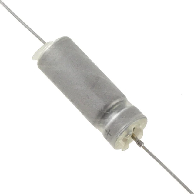

135D www.vishay.com Vishay Wet Tantalum Capacitors Tantalum-Case with Glass-to-Tantalum Hermetic Seal for -55 °C to +200 °C Operation FEATURES PERFORMANCE CHARACTERISTICS Operating Temperature: -55 °C to +85 °C  (to +200 °C with voltage derating) Capacitance Tolerance: at 120 Hz, +25 °C ± 20 % standard. ± 10 %, ± 5 % available as special. DC Leakage Current (DCL Max.): at +25 °C and above: leakage current shall not exceed the values listed in the Standard Ratings table. Life Test: capacitors are capable of withstanding a 2000 h life test at a temperature of +85 °C or +125 °C at the applicable rated DC working voltage. Following life test: 1. DCL, measured at +85 °C rated voltage, shall not be in excess of the original requirement. 2. The equivalent series resistance shall not exceed 150 % of the initial requirement. 3. Change in capacitance shall not exceed 10 % from the initial measurement. • Axial through-hole terminations: standard tin / lead (SnPb), 100 % tin (RoHS-compliant) available Available • Standard and extended ratings Available • Model 135D tantalum-case electrolytic capacitors incorporate the advantages of all the varieties of electrolytic capacitors and eliminate most of the disadvantages. These Available units have a 3 V reverse voltage capability at +85 °C and a higher ripple current capability than any other electrolytic type with similar combinations of capacitance and case size. • Designed for the aerospace applications, this capacitor was developed under partial sponsorship of the Marshall Space Flight Center, National Aeronautics and Space Administration. The capacitors have a high resistance to damage from shock and vibration. Extended range ratings and high temperature designs are available. • Model 135D capacitors are commercial equivalents of Tansitor style; AQ, AR, HAQ, HAR, Mallory-NACC Style; TLT, TXT, THT, THX and Military Style CLR79 and CLR81, designed to meet the performance requirements of Military Specification MIL-PRF-39006/22/25. Capacitors to meet MIL-PRF-39006/22/25 should be ordered by part numbers shown in that specification. • Material categorization: for definitions of compliance please see www.vishay.com/doc?99912 Note * This datasheet provides information about parts that are RoHS-compliant and / or parts that are non RoHS-compliant. For example, parts with lead (Pb) terminations are not RoHS-compliant. Please see the information / tables in this datasheet for details ORDERING INFORMATION 135D 306 X0 006 C 2 E3 MODEL CAPACITANCE CAPACITANCE TOLERANCE DC VOLTAGE RATING AT +85 °C CASE CODE STYLE NUMBER RoHSCOMPLIANT This is expressed in picofarads. The first two digits are the significant figures. The third is the number of zeros to follow. X0 = ± 20 % X9 = ± 10 % X5 = ± 5 % This is expressed in volts. To complete the three-digit block, zeros precede the voltage rating. See Ratings and Case Codes table Standard temperature (max. +125 °C) 0 = no insulating sleeve 2 = polyester insulation sleeve 3 = high temperature film insulation E3 = 100 % tin termination (RoHS-compliant design) Blank = SnPb termination (standard design) High temperature (max. +200 °C) 6 = high temperature film insulation 8 = no insulating sleeve Note • Packaging: the use of formed plastic trays for packaging these axial lead components is standard. Tape and reel is not available due to the unit weight. Revision: 01-Mar-2019 Document Number: 40024 1 For technical questions, contact: tantalum@vishay.com THIS DOCUMENT IS SUBJECT TO CHANGE WITHOUT NOTICE. THE PRODUCTS DESCRIBED HEREIN AND THIS DOCUMENT ARE SUBJECT TO SPECIFIC DISCLAIMERS, SET FORTH AT www.vishay.com/doc?91000 135D www.vishay.com Vishay DIMENSIONS in inches [millimeters] Tantalum feed-through 0.078 [1.98] max. dia. Style CLR79 Style CLR81 Term. loc. within 0.031 [0.79] R of true position 0.250 [6.35] max. Terminal welded to case - + D dia. 0.094 [2.38] max. E Case Circuit diagram External weld L 0.025 ± 0.002 [0.64 ± 0.05] E Glass Insulating sleeve BARE CASE C F T K WITH INSULATING SLEEVE D L D (MAX.) L (1) E LEAD LENGTH 0.188 ± 0.016 [4.78 ± 0.41] 0.281 ± 0.016 [7.14 ± 0.41] 0.375 ± 0.016 [9.53 ± 0.41] 0.375 ± 0.016 [9.53 ± 0.41] 0.453 + 0.031 / - 0.016 [11.51 + 0.79 / - 0.41] 0.641 + 0.031 / -0.016 [16.28 + 0.79 / -0.41] 0.766 + 0.031 / - 0.016 [19.46 + 0.79 / - 0.41] 1.062 + 0.031 / - 0.016 [26.97 + 0.79 / - 0.41] 0.219 [5.56] 0.312 [7.92] 0.406 [10.31] 0.406 [10.31] 0.565 [14.35] 0.785 [19.94] 0.95 [24.13] 1.31 [33.27] 1.500 ± 0.250 [38.10 ± 6.35] 2.250 ± 0.250 [57.15 ± 6.35] 2.250 ± 0.250 [57.15 ± 6.35] 2.250 ± 0.250 [57.15 ± 6.35] CASE CODE WEIGHT (oz. / g) (Max.) 0.09 [2.6] 0.22 [6.2] 0.41 [11.6] 0.62 [17.7] Note (1) Typical length, for reference only STANDARD RATINGS CAPACITANCE (μF) CASE CODE 30 68 140 270 330 560 1200 C C F F T T K 25 56 120 220 290 430 850 C C F F T T K 20 47 100 180 250 390 750 C C F F T T K PART NUMBER (1) MAX. ESR AT +25 °C 120 Hz () MAX. IMP. AT -55 °C 120 Hz () MAX. DCL (μA) AT +25 °C +85 °C +125 °C 6 VDC AT +85 °C; 4 VDC AT +125 °C; 3.6 VDC AT +200 °C 135D306X0006C2 4.0 100 1.0 2.0 135D686X0006C2 3.2 60 1.0 2.0 135D147X0006F2 2.0 40 1.0 3.0 135D277X0006F2 2.2 25 1.0 6.5 135D337X0006T2 1.4 20 2.0 7.9 135D567X0006T2 1.3 25 2.0 13.0 135D128X0006K2 1.0 20 3.0 14.0 8 VDC AT +85 °C; 5 VDC AT +125 °C; 4.8 VDC AT +200 °C 135D256X0008C2 4.0 100 1.0 2.0 135D566X0008C2 3.3 59 1.0 2.0 135D127X0008F2 2.6 50 1.0 2.0 135D227X0008F2 2.4 30 1.0 7.0 135D297X0008T2 1.8 25 2.0 6.0 135D437X0008T2 1.4 25 2.0 14.0 135D857X0008K2 1.0 22 4.0 16.0 10 VDC AT +85 °C; 7 VDC AT +125 °C; 6 VDC AT +200 °C 135D206X0010C2 4.0 120 1.0 2.0 135D476X0010C2 3.7 90 1.0 2.0 135D107X0010F2 2.4 60 1.0 4.0 135D187X0010F2 2.2 40 1.0 7.0 135D257X0010T2 1.8 30 2.0 10.0 135D397X0010T2 1.5 25 2.0 16.0 135D757X0010K2 1.0 23 4.0 16.0 MAX. CAPACITANCE CHANGE (%) AT MAX. RIPPLE 40 kHz IRMS (mA) -55 °C +85 °C +125 °C -40 -40 -40 -44 -44 -64 -80 +10.5 +14 +14 +17.5 +14 +17.5 +25 +12 +16 +16 +20 +16 +20 +25 820 960 1200 1375 1800 1900 2265 -40 -40 -44 -44 -64 -64 -80 +10.5 +14 +17.5 +17.5 +17.5 +17.5 +25 +12 +16 +20 +20 +20 +20 +25 820 900 1230 1370 1770 1825 2330 -32 -36 -36 -36 -40 -64 -80 +10.5 +14 +14 +14 +14 +17.5 +25 +12 +16 +16 +16 +16 +20 +25 820 855 1200 1365 1720 1800 2360 Note Part numbers are for units with ± 20 % capacitance tolerance, standard +125 °C maximum temperature, standard polyesterfilm insulation, and tin-lead terminations. For other capacitance tolerances, other maximum temperatures, insulation and termination options, please consult Ordering Information on first page for proper part number. (1) Revision: 01-Mar-2019 Document Number: 40024 2 For technical questions, contact: tantalum@vishay.com THIS DOCUMENT IS SUBJECT TO CHANGE WITHOUT NOTICE. THE PRODUCTS DESCRIBED HEREIN AND THIS DOCUMENT ARE SUBJECT TO SPECIFIC DISCLAIMERS, SET FORTH AT www.vishay.com/doc?91000 135D www.vishay.com Vishay STANDARD RATINGS CAPACITANCE (μF) CASE CODE 15 33 70 120 170 270 540 C C F F T T K 10 22 50 100 120 180 350 C C F F T T K 8 15 22 40 68 100 150 300 C C F F F T T K 15 68 270 C F K 5 10 25 47 60 82 160 C C F F T T K 4 8.2 20 39 50 68 140 C C F F T T K 3.5 6.8 15 33 40 56 C C F F T T PART NUMBER (1) MAX. ESR AT +25 °C 120 Hz () MAX. IMP. AT -55 °C 120 Hz () MAX. DCL (μA) AT +25 °C +85 °C +125 °C 15 VDC AT +85 °C; 10 VDC AT +125 °C; 9 VDC AT +200 °C 135D156X0015C2 4.4 155 1.0 2.0 135D336X0015C2 4.0 90 1.0 2.0 135D706X0015F2 2.8 75 1.0 4.0 135D127X0015F2 2.6 50 1.0 7.0 135D177X0015T2 2.4 35 2.0 10.0 135D277X0015T2 2.2 30 2.0 16.0 135D547X0015K2 1.0 23 6.0 24.0 25 VDC AT +85 °C; 15 VDC AT +125 °C; 12 VDC AT +200 °C 135D106X0025C2 5.3 220 1.0 2.0 135D226X0025C2 4.2 140 1.0 2.0 135D506X0025F2 3.0 70 1.0 2.0 135D107X0025F2 2.8 50 1.0 10.0 135D127X0025T2 2.6 38 2.0 6.0 135D187X0025T2 2.2 32 2.0 18.0 135D357X0025K2 1.3 24 7.0 28.0 30 VDC AT +85 °C; 20 VDC AT +125 °C; 18 VDC AT +200 °C 135D805X0030C2 6.6 275 1.0 2.0 135D156X0030C2 6.2 175 1.0 2.0 135D226X0030F2 4.6 95 1.0 5.0 135D406X0030F2 4.0 65 1.0 5.0 135D686X0030F2 2.9 60 1.0 8.0 135D107X0030T2 2.7 40 2.0 12.0 135D157X0030T2 2.3 35 2.0 18.0 135D307X0030K2 1.4 25 8.0 32.0 35 VDC AT +85 °C; 22 VDC AT +125 °C; 21 VDC AT +200 °C 135D156X0035C2 6.2 175 0.75 1.5 135D686X0035F2 2.9 60 1.0 2.0 135D277X0035K2 1.4 26 3.0 12.0 50 VDC AT +85 °C; 30 VDC AT +125 °C; 30 VDC AT +200 °C 135D505X0050C2 8.0 400 1.0 2.0 135D106X0050C2 6.4 250 1.0 2.0 135D256X0050F2 4.6 95 1.0 5.0 135D476X0050F2 3.7 70 1.0 9.0 135D606X0050T2 2.9 45 2.0 12.0 135D826X0050T2 2.5 45 2.0 16.0 135D167X0050K2 1.5 27 8.0 32.0 60 VDC AT +85 °C; 40 VDC AT +125 °C; 36 VDC AT +200 °C 135D405X0060C2 9.3 550 1.0 2.0 135D825X0060C2 6.6 275 1.0 2.0 135D206X0060F2 4.7 105 1.0 5.0 135D396X0060F2 3.4 90 1.0 9.0 135D506X0060T2 2.9 50 2.0 12.0 135D686X0060T2 2.5 50 2.0 16.0 135D147X0060K2 1.5 28 8.0 32.0 75 VDC AT +85 °C; 50 VDC AT +125 °C; 45 VDC AT +200 °C 135D355X0075C2 9.5 650 1.0 2.0 135D685X0075C2 6.8 300 1.0 2.0 135D156X0075F2 5.3 150 1.0 5.0 135D336X0075F2 4.2 90 1.0 10.0 135D406X0075T2 3.0 60 2.0 12.0 135D566X0075T2 2.6 60 2.0 17.0 MAX. CAPACITANCE CHANGE (%) AT MAX. RIPPLE 40 kHz IRMS (mA) -55 °C +85 °C +125 °C -24 -28 -28 -28 -32 -56 -80 +10.5 +14 +14 +17.5 +14 +17.5 +25 +12 +16 +16 +20 +16 +20 +25 780 820 1150 1450 1480 1740 2330 -16 -20 -28 -28 -32 -48 -70 +8 +10.5 +13 +13 +13 +13 +25 +9 +12 +15 +15 +15 +15 +25 715 800 1130 1435 1450 1525 1970 -16 -20 -20 -24 -24 -28 -48 -60 +8 +10.5 +10.5 +10.5 +13 +10.5 +13 +25 +12 +12 +12 +12 +15 +12 +15 +25 640 780 1005 1120 1285 1450 1525 1950 -20 -24 -58 +10.5 +13 +25 +12 +15 +25 660 1195 1950 -16 -24 -20 -28 -16 -32 -50 +5 +8 +10.5 +13 +10.5 +13 +25 +6 +9 +12 +15 +12 +15 +25 580 715 1005 1155 1335 1400 1900 -16 -24 -16 -28 -16 -32 -40 +5 +8 +8 +10.5 +10.5 +10.5 +20 +6 +9 +9 +15 +12 +15 +20 525 625 930 1110 1330 1365 1850 -16 -20 -16 -24 -16 -28 +5 +8 +8 +10.5 +10.5 +10.5 +6 +9 +9 +15 +12 +15 525 610 890 1000 1250 1335 Note Part numbers are for units with ± 20 % capacitance tolerance, standard +125 °C maximum temperature, standard polyesterfilm insulation, and tin-lead terminations. For other capacitance tolerances, other maximum temperatures, insulation and termination options, please consult Ordering Information on first page for proper part number. (1) Revision: 01-Mar-2019 Document Number: 40024 3 For technical questions, contact: tantalum@vishay.com THIS DOCUMENT IS SUBJECT TO CHANGE WITHOUT NOTICE. THE PRODUCTS DESCRIBED HEREIN AND THIS DOCUMENT ARE SUBJECT TO SPECIFIC DISCLAIMERS, SET FORTH AT www.vishay.com/doc?91000 135D www.vishay.com Vishay STANDARD RATINGS CAPACITANCE (μF) CASE CODE 110 K 2.2 2.5 3.9 4.7 11 22 30 43 82 86 C C C C F F T T K K 1.7 3.6 9 14 18 25 56 C C F F T T K PART NUMBER (1) MAX. ESR AT +25 °C 120 Hz () MAX. IMP. AT -55 °C 120 Hz () MAX. DCL (μA) AT +25 °C +85 °C +125 °C 135D117X0075K2 1.5 29 9.0 36.0 100 VDC AT +85 °C; 65 VDC AT +125 °C; 60 VDC AT +200 °C 135D225X0100C2 10.6 950 1.0 2.0 135D255X0100C2 10.6 950 1.0 2.0 135D395X0100C2 10.0 600 1.0 2.0 135D475X0100C2 8.5 500 1.0 2.0 135D116X0100F2 6.0 200 1.0 4.0 135D226X0100F2 4.8 100 1.0 9.0 135D306X0100T2 3.3 80 2.0 12.0 135D436X0100T2 2.6 70 2.0 17.0 135D826X0100K2 1.6 39 3.0 24 135D866X0100K2 1.6 30 9.0 36.0 125 VDC AT +85 °C; 85 VDC AT +125 °C; 75 VDC AT +200 °C 135D175X0125C2 15.6 1250 1.0 2.0 135D365X0125C2 10.0 600 1.0 2.0 135D905X0125F2 7.4 240 1.0 5.0 135D146X0125F2 5.7 167 1.0 7.0 135D186X0125T2 3.7 129 2.0 9.0 135D256X0125T2 3.2 93 2.0 13.0 135D566X0125K2 1.6 32 10.0 40.0 -55 °C +85 °C +125 °C -35 +20 +20 MAX. RIPPLE 40 kHz IRMS (mA) 1850 -16 -16 -16 -16 -16 -16 -16 -20 -24 -25 +7 +7 +7 +7 +7 +7 +7 +7 +18 +15 +8 +8 +8 +8 +8 +8 +8 +8 +18 +15 505 505 520 565 835 965 1240 1335 1860 1800 -16 -16 -16 -16 -16 -16 -25 +7 +7 +7 +7 +7 +7 +15 +8 +8 +8 +8 +8 +8 +15 415 520 755 860 1130 1200 1800 MAX. CAPACITANCE CHANGE (%) AT Note Part numbers are for units with ± 20 % capacitance tolerance, standard +125 °C maximum temperature, standard polyesterfilm insulation, and tin-lead terminations. For other capacitance tolerances, other maximum temperatures, insulation and termination options, please consult Ordering Information on first page for proper part number. (1) EXTENDED RATINGS CAPACITANCE (μF) CASE CODE PART NUMBER (1) 220 560 820 1200 1500 2200 C F F T T K 180 680 1500 1800 C F T K 120 150 390 470 560 1200 C C F F F T MAX. ESR MAX. IMP. AT +25 °C AT -55 °C 120 Hz 120 Hz () () MAX. DCL (μA) AT +25 °C +85 °C +125 °C 6 VDC AT +85 °C; 4 VDC AT +125 °C; 3.6 VDC AT +200 °C 135D227X0006C2 3.0 36 2.0 9.0 135D567X0006F2 2.5 21 3.0 9.0 135D827X0006F2 2.5 18 3.0 14 135D128X0006T2 1.5 18 5.0 18.0 135D158X0006T2 1.5 18 5.0 20.0 135D228X0006K2 1.0 13 6.0 24.0 8 VDC AT +85 °C; 5 VDC AT +125 °C; 4.8 VDC AT +200 °C 135D187X0008C2 3.0 45 2.0 9.0 135D687X0008F2 2.5 22 3.0 14.0 135D158X0008T2 1.5 18 5.0 20.0 135D188X0008K2 1.0 14 7.0 25.0 10 VDC AT +85 °C; 7 VDC AT +125 °C; 6 VDC AT +200 °C 135D127X0010C2 3.2 54 2.0 6.0 135D157X0010C2 3.0 54 2.0 9.0 135D397X0010F2 2.5 27 3.0 9.0 135D477X0010F2 2.5 27 3.0 16.0 135D567X0010F2 2.5 27 3.0 16.0 135D128X0010T2 1.5 18 5.0 20.0 MAX. CAPACITANCE CHANGE (%) AT MAX. RIPPLE 40 kHz IRMS +125 °C (mA) -55 °C +85 °C -64 -77 -88 -88 -90 -90 +13 +16 +16 +20 +20 +25 +16 +20 +20 +25 +25 +30 1000 1500 1500 1900 1900 2300 -60 -83 -90 -90 +13 +16 +20 +25 +16 +20 +25 +30 1000 1500 1900 2300 -40 -55 -66 -66 -77 -88 +14 +13 +16 +16 +16 +20 +16 +16 +20 +20 +20 +25 900 900 1470 1450 1450 1850 Note Part numbers are for units with ± 20 % capacitance tolerance, standard +125 °C maximum temperature, standard polyesterfilm insulation, and tin-lead terminations. For other capacitance tolerances, other maximum temperatures, insulation and termination options, please consult Ordering Information on first page for proper part number. (1) Revision: 01-Mar-2019 Document Number: 40024 4 For technical questions, contact: tantalum@vishay.com THIS DOCUMENT IS SUBJECT TO CHANGE WITHOUT NOTICE. THE PRODUCTS DESCRIBED HEREIN AND THIS DOCUMENT ARE SUBJECT TO SPECIFIC DISCLAIMERS, SET FORTH AT www.vishay.com/doc?91000 135D www.vishay.com Vishay EXTENDED RATINGS CAPACITANCE (μF) CASE CODE PART NUMBER (1) MAX. ESR MAX. IMP. AT +25 °C AT -55 °C 120 Hz 120 Hz () () MAX. DCL (μA) AT +25 °C +85 °C +125 °C MAX. CAPACITANCE CHANGE (%) AT -55 °C +85 °C 1500 K 135D158X0010K2 1.0 15 7.0 25.0 15 VDC AT +85 °C; 10 VDC AT +125 °C; 9 VDC AT +200 °C -88 +25 MAX. RIPPLE 40 kHz IRMS +125 °C (mA) +30 2300 82 C 135D826X0015C2 3.9 72 2.0 6.0 -35 +12 +16 100 C 135D107X0015C2 3.9 72 2.0 9.0 -44 +13 +16 900 900 270 F 135D277X0015F2 2.5 31 3.0 9.0 -62 +16 +15 1450 390 F 135D397X0015F2 2.5 31 3.0 16.0 -66 +16 +20 1450 680 T 135D687X0015T2 1.8 22 6.0 18.0 -74 +20 +25 1800 820 T 135D827X0015T2 1.8 22 6.0 24.0 -77 +20 +25 1800 1000 K 135D108X0015K2 1.2 17 8.0 32.0 -77 +25 +30 2330 47 C 135D476X0025C2 5.2 100 2.0 6.0 -23 +12 +15 800 56 C 135D566X0025C2 4.3 90 2.0 6.0 -25 +12 +15 850 25 VDC AT +85 °C; 15 VDC AT +125 °C; 12 VDC AT +200 °C 68 C 135D686X0025C2 4.3 90 2.0 9.0 -40 +12 +15 850 180 F 135D187X0025F2 2.7 33 3.0 9.0 -54 +13 +15 1400 270 F 135D277X0025F2 2.7 33 3.0 16.0 -62 +13 +16 1400 390 T 135D397X0025T2 1.8 25 6.0 18.0 -55 +18 +25 1500 470 T 135D477X0025T2 1.8 24 6.0 18.0 -65 +18 +25 1750 560 T 135D567X0025T2 1.8 24 7.0 28.0 -72 +20 +25 1750 680 K 135D687X0025K2 1.2 19 8.0 32.0 -72 +25 +30 2100 820 K 135D827X0025K2 1.3 26 8.0 32.0 -80 +25 +25 2100 800 30 VDC AT +85 °C; 20 VDC AT +125 °C; 18 VDC AT +200 °C 47 C 135D476X0030C2 5.2 100 2.0 6.0 -23 +12 +15 56 C 135D566X0030C2 5.2 100 2.0 9.0 -38 +12 +15 800 150 F 135D157X0030F2 2.5 36 3.0 9.0 -42 +13 +15 1200 220 F 135D227X0030F2 2.5 36 3.0 16.0 -60 +13 +16 1200 300 T 135D307X0030T2 2.2 44 3.0 12.0 -60 +15 +15 1559 390 T 135D397X0030T2 1.8 25 6.0 18.0 -55 +18 +25 1500 470 T 135D477X0030T2 1.8 25 8.0 32.0 -65 +20 +25 1500 560 K 135D567X0030K2 1.3 20 9.0 36.0 -65 +25 +30 2000 39 C 135D396X0035C2 4.1 61 2.0 6.0 -22 +12 +14 820 120 F 135D127X0035F2 2.5 31 3.0 10.0 -40 +13 +15 1315 35 VDC AT +85 °C; 22 VDC AT +125 °C; 21 VDC AT +200 °C 330 T 135D337X0035T2 1.8 20 6.0 18.0 -50 +16 +25 1640 370 K 135D377X0035K2 1.3 15 9.0 36.0 -60 +25 +30 2040 39 C 135D396X0040C2 4.1 61 2.0 6.0 -22 +12 +14 820 220 K 135D227X0040K2 1.6 27 3.0 22.0 -58 +23 +23 1900 40 VDC AT +85 °C; 25 VDC AT +125 °C; 20 VDC AT +200 °C 370 K 135D377X0040K2 1.5 30 5.0 25.0 -75 +25 +25 1900 470 K 135D477X0040K2 1.3 30 9.0 35.0 -80 +25 +25 2040 33 C 135D336X0050C2 5.0 135 2.0 9.0 -29 +10 +12 700 100 F 135D107X0050F2 2.8 49 4.0 12.0 -36 +13 +15 1200 120 F 135D127X0050F2 2.5 49 4.0 24.0 -42 +12 +15 1200 270 T 135D277X0050T2 2.0 30 8.0 32.0 -46 +20 +25 1450 50 VDC AT +85 °C; 30 VDC AT +125 °C; 30 VDC AT +200 °C Note (1) Part numbers are for units with ± 20 % capacitance tolerance, standard +125 °C maximum temperature, standard polyesterfilm insulation, and tin-lead terminations. For other capacitance tolerances, other maximum temperatures, insulation and termination options, please consult Ordering Information on first page for proper part number. Revision: 01-Mar-2019 Document Number: 40024 5 For technical questions, contact: tantalum@vishay.com THIS DOCUMENT IS SUBJECT TO CHANGE WITHOUT NOTICE. THE PRODUCTS DESCRIBED HEREIN AND THIS DOCUMENT ARE SUBJECT TO SPECIFIC DISCLAIMERS, SET FORTH AT www.vishay.com/doc?91000 135D www.vishay.com Vishay EXTENDED RATINGS CAPACITANCE (μF) CASE CODE PART NUMBER (1) 330 K 135D337X0050K2 MAX. ESR MAX. IMP. AT +25 °C AT -55 °C 120 Hz 120 Hz () () 1.5 30 MAX. DCL (μA) AT MAX. CAPACITANCE CHANGE (%) AT +25 °C +85 °C +125 °C -55 °C +85 °C 9.0 36.0 -46 +25 MAX. RIPPLE 40 kHz IRMS +125 °C (mA) +30 1900 700 60 VDC AT +85 °C; 40 VDC AT +125 °C; 36 VDC AT +200 °C 18 C 135D186X0060C2 7.0 160 2.0 12.0 -20 +7 +8 27 C 135D276X0060C2 5.0 144 3.0 12.0 -24 +10 +12 700 82 F 135D826X0060F2 2.9 54 4.0 16.0 -30 +15 +15 1100 100 F 135D107X0060F2 2.5 54 4.0 20.0 -36 +12 +15 1100 220 T 135D227X0060T2 1.8 29 8.0 32.0 -40 +16 +20 1400 270 K 135D277X0060K2 1.4 23 9.0 36.0 -45 +20 +25 1850 330 K 135D337X0060K2 1.3 31 10.0 40.0 -72 +25 +25 1850 715 63 VDC AT +85 °C; 40 VDC AT +125 °C; 31 VDC AT +200 °C 10 C 135D106X0063C2 5.3 250 1.0 2.0 -20 +8 +9 27 C 135D276X0063C2 5.0 144 3.0 12.0 -24 +10 +12 700 100 F 135D107X0063F2 2.5 54 2.0 12.0 -36 +12 +15 1100 5.6 C 135D565X0075C2 14.2 475 2.0 5.0 -17 +8 +8 600 12 C 135D126X0075C2 5.1 157 3.0 12.0 -19 +10 +12 600 22 C 135D226X0075C2 5.1 157 3.0 12.0 -19 +10 +12 600 68 F 135D686X0075F2 3.0 63 4.0 16.0 -25 +12 +15 1000 75 VDC AT +85 °C; 50 VDC AT +125 °C; 45 VDC AT +200 °C 82 F 135D826X0075F2 2.5 63 4.0 24.0 -30 +12 +15 1000 110 F 135D117X0075F2 2.5 54 4.0 20.0 -36 +12 +15 1100 180 T 135D187X0075T2 2.2 30 9.0 36.0 -35 +16 +20 1300 200 K 135D207X0075K2 18 24 10.0 40.0 -40 +20 +25 1800 220 K 135D227X0075K2 1.8 24 10.0 40.0 -40 +20 +25 1800 300 K 135D307X0075K2 1.8 32 12.0 48.0 -60 +22 +22 2000 5.6 C 135D565X0100C2 14 475 2.0 5.0 -17 +8 +8 565 10 C 135D106X0100C2 5.9 200 3.0 12.0 -17 +10 +12 800 39 F 135D396X0100F2 3.5 80 5.0 24.0 -20 +12 +15 1300 47 T 135D476X0100T2 2.5 70 2.0 10.0 -23 +10 +10 1390 56 T 135D566X0100T2 2.4 50 5.0 20.0 -25 +12 +12 1400 68 T 135D686X0100T2 2.2 40 10.0 40.0 -30 +14 +16 1600 120 K 135D127X0100K2 2.7 30 12.0 48.0 -35 +15 +17 2000 3.9 C 135D395X0125C2 20.4 557 2.0 5.0 -16 +7 +8 495 6.8 C 135D685X0125C2 11.7 300 3.0 12.0 -14 +10 +12 700 15 F 135D156X0125F2 5.3 167 1.0 7.0 -16 +7 +8 1200 27 F 135D276X0125F2 3.5 90 5.0 24.0 -18 +12 +15 1200 47 T 135D476X0125T2 2.2 50 10.0 40.0 -26 +14 +16 1500 56 T 135D566X0125T2 2.2 50 10.0 40.0 -26 +14 +16 1500 68 K 135D686X0125K2 2.2 32 11.0 44.0 -28 +15 +16 1850 82 K 135D826X0125K2 2.8 32 12.0 48.0 -30 +15 +17 1900 100 VDC AT +85 °C; 65 VDC AT +125 °C; 60 VDC AT +200 °C 125 VDC AT +85 °C; 85 VDC AT +125 °C; 75 VDC AT +200 °C Note (1) Part numbers are for units with ± 20 % capacitance tolerance, standard +125 °C maximum temperature, standard polyesterfilm insulation, and tin-lead terminations. For other capacitance tolerances, other maximum temperatures, insulation and termination options, please consult Ordering Information on first page for proper part number. Revision: 01-Mar-2019 Document Number: 40024 6 For technical questions, contact: tantalum@vishay.com THIS DOCUMENT IS SUBJECT TO CHANGE WITHOUT NOTICE. THE PRODUCTS DESCRIBED HEREIN AND THIS DOCUMENT ARE SUBJECT TO SPECIFIC DISCLAIMERS, SET FORTH AT www.vishay.com/doc?91000 135D www.vishay.com Vishay TYPICAL CURVES OF IMPEDANCE AS A FUNCTION OF FREQUENCY AT VARIOUS TEMPERATURES “C” Case 33 μF, 50 V Capacitors “K” Case 56 μF, 125 V Capacitors 100 10 Impedance (Ω) Impedance (Ω) 100 - 55 °C - 40 °C - 20 °C 1.0 + 125 °C 0.1 100 1K + 85 °C 10 - 55 °C - 40 °C 1.0 - 20 °C + 25 °C 100K 10K Frequency (Hz) + 25 °C + 125 °C 1M 10M 0.1 100 + 85 °C 1K 100K 10K Frequency (Hz) 1M 10M PERFORMANCE CHARACTERISTICS 1. Operating Temperature: capacitors are designed to operate over a temperature range of -55 °C to +200 °C. 3.2 Surge Voltage Test: capacitors shall withstand the surge voltage applied through a 1000  ± 10 % resistor in series with the capacitor and voltage source at the rate of one-half minute on, four and one-half minutes off, for 1000 successive test cycles at +85 °C or +125 °C. UP TO +85 °C (V) AT +125 °C (V) AT +200 °C (V) 6 4 3.6 8 5 4.8 10 7 6 15 10 9 25 15 12 30 20 18 35 22 21 40 25 20 50 30 30 60 40 36 63 40 31 4.1 Measurements shall be made by the bridge method at or referred to a frequency of 120 Hz at a temperature of +25 °C. The maximum voltage applied to the capacitors during measurement shall be 1 VRMS. Measurement accuracy of the bridge shall be within ± 2 %. 75 50 45 5. 100 65 60 125 85 75 Capacitance Change With Temperature: the capacitance change with temperature shall not exceed the values given in the Standard Ratings table for each capacitor. 6. Equivalent Series Resistance: measurements shall be made by the bridge method at, or referred to, a frequency of 120 Hz at a temperature of +25 °C. A maximum of 1 VRMS shall be applied during measurement. 2. DC Working Voltage: the DC working voltage is the maximum operating voltage for continuous duty at the rated temperature. 3. Surge Voltage: the surge voltage rating is the maximum voltage to which the capacitors should be subjected under any conditions. This includes transients and peak ripple at the highest line voltage. 3.1 The surge voltage of capacitors is 115 % of rated DC working voltage. Revision: 01-Mar-2019 3.3 Following the surge voltage test, the capacitance at +25 °C shall not have changed by more than ± 10 % and the equivalent series resistance and DC leakage current will not exceed the values shown in the Standard Ratings table for each capacitor. 4. Capacitance Tolerance: the capacitance of all capacitors shall be within the specified tolerance limits of the nominal rating. 6.1 The equivalent series resistance shall not exceed the maximum value in ohms listed in the Standard Ratings table for each capacitor. Document Number: 40024 7 For technical questions, contact: tantalum@vishay.com THIS DOCUMENT IS SUBJECT TO CHANGE WITHOUT NOTICE. THE PRODUCTS DESCRIBED HEREIN AND THIS DOCUMENT ARE SUBJECT TO SPECIFIC DISCLAIMERS, SET FORTH AT www.vishay.com/doc?91000 135D www.vishay.com 6.2 The dissipation factor may be calculated from the equivalent series resistance and capacitance values as shown: 2fRC DF = ----------------4 10 where: Vishay TYPICAL LEAKAGE CURRENT FACTOR RANGE 1.0 0.9 0.8 0.7 0.6 DF = dissipation Factor in % R = ESR in  0.5 C = capacitance in μF 0.4 f = frequency in Hz At 120 Hz, the above equation becomes:  For example, percent dissipation factor of a 30 μF, 6 V capacitor, which has a maximum ESR of 4.0  at +25 °C and 120 Hz, would be calculated as shown: 4 x 30 2 x 120 x 4 x 30 DF = --------------------------------------------- = ---------------- = 9.05 % 4 13.26 10 7. Leakage Current: measurements shall be made at the applicable rated working voltage at +25 °C ± 5 °C through application of a steady source of power, such as a regulated power supply. A 1000  resistor to limit the charging current shall be connected in series with each capacitor under test. Rated working voltage shall be applied to capacitors for 5 minutes before making leakage current measurements. 7.1 The maximum leakage current for any capacitor shall not exceed the maximum value in microamperes listed in the Standard Ratings and Extended Ratings table for each capacitor. LEAKAGE CURRENT FACTOR RxC DF = --------------13.26 0.3 0.2 0.1 0.09 0.08 0.07 0.06 0.05 0.04 0.03 0.02 0.01 0 10 Note • Leakage current varies with applied voltage. See graph next column for the appropriate adjustment factor 8. 9. Low Temperature Impedance: the impedance of any capacitor at -55 °C at 120 Hz, shall not exceed the values given in the Standard Ratings and Extended Ratings tables. Life Test: capacitors are capable of withstanding a 2000 h life test at a temperature of +85 °C or +125 °C at the applicable rated DC working voltage. 9.1 Following the life test, the capacitors shall be returned to 25 °C ± 5 °C. The leakage current, measured at the +85 °C rated voltage, shall not be in excess of the original requirement; the capacitance value shall not exceed 150 % of the initial requirement; the capacitance value shall not change more than 10 % from the initial measurement. Revision: 01-Mar-2019 20 30 40 50 60 70 80 90 100 PERCENT OF RATED VOLTAGE 9.3 Capacitors are capable of withstanding life test at the following conditions: TEMPERATURE HOURS % RATED VOLTAGE +175 °C 2000 50 +175 °C 300 65 +200 °C 300 60 9.4 Following the life test, the capacitors shall be returned to +25 °C ± 5 °C. The leakage current, at the rated voltage shall not exceed 200 % of the original requirement or 10 μA, whichever is greater; the equivalent series resistance shall not be greater than 200 % of the original requirement; the capacitance value shall not increase by more than 10 % or decrease by more than 20 % from the initial measurement. Document Number: 40024 8 For technical questions, contact: tantalum@vishay.com THIS DOCUMENT IS SUBJECT TO CHANGE WITHOUT NOTICE. THE PRODUCTS DESCRIBED HEREIN AND THIS DOCUMENT ARE SUBJECT TO SPECIFIC DISCLAIMERS, SET FORTH AT www.vishay.com/doc?91000 135D www.vishay.com 10. Ripple Life Test at +85 °C: capacitors shall be tested in accordance with Military Specification MIL-PRF-39006 except that: a) Operation conditions: this test shall be run at a frequency of 40 kHz ± 2 kHz sinusoidal and at the RMS ripple current levels specified in the Standard Ratings and Extended Ratings table. b) Applied DC voltage shall be reduced so that the peak AC voltage plus DC voltage shall not exceed the rated voltage of the capacitor in either the forward or reverse direction. 10.1 When tested as specified above, capacitors shall meet the following requirements: Vishay 14. 14.1 Electrical measurements made during the test shall show no intermittent contacts, open circuits or short circuits. 15. Pull Test: leads shall withstand a tensile stress of 3 lbs. (1.4 kg) for 30 s applied axially in accordance with MIL-STD-202, method 211, test condition A. 16. Lead Bend Test: leads shall meet the bend test specified in Military Standard MIL-STD-202, method 211 A, condition C except that the number of bends shall be 4. 17. Moisture Resistance: capacitors shall withstand the moisture resistance cycling test specified in Military Standard MIL-STD-202, method 106, without departure from the original limits of capacitance, equivalent series resistance and DC leakage current. 18. Reduced Pressure: capacitors shall be stabilized at a reduced atmospheric pressure of 0.82" [20.83 mm] of mercury for a period of 5 min. Rated DC voltage shall be applied for 1 min. Capacitors shall not flash over nor shall end seals be damaged by this nor should the capacitors be electrically effected insofar as capacitance, equivalent series resistance or leakage current is concerned. 19. Seal Test: a) The DC leakage current at +25 °C and at +85 °C shall not exceed the original requirements. b) The capacitance shall not change more than ± 15 % from the initial measured value. c) The dissipation factor shall not exceed the original requirements. d) Visual examination: there shall be no damage, obliteration of marking or leakage of electrolyte. 11. Reverse Voltage Test: capacitors shall withstand a reverse voltage of 3 VDC at +85 °C or 2 V at +125 °C for 2000 h. The capacitors shall then be restabilized for 24 h at 85 °C with rated DC forward potential applied through a 1000  resistor. 11.1 Following the reverse voltage test, the DC leakage current shall not be in excess of the original requirement; the equivalent series resistance shall not exceed 200 % of the initial requirement; the capacitance value shall not be less than 90 % of the initial measurement. 12. Mechanical Shock Test: capacitors shall withstand a shock of 500 g when tested in accordance with method 213 of MIL-STD-202, test condition D. 12.1 Following the mechanical shock test, capacitors shall be examined for evidence of mechanical damage and leakage of electrolyte. Capacitance, equivalent series resistance, and DC leakage current shall meet the initial requirements. 13. High Frequency Vibration: capacitors shall withstand vibration from 10 Hz to 2000 Hz at 80 g without internal damage when tested in accordance with MIL-STD-202, method 204, test condition H. Electrical measurements made while under these conditions shall show no intermittent contacts, open circuits or short circuits. Random Vibration: capacitors shall withstand random vibration at all levels up to 51 g RMS overall when tested in accordance with MIL-STD-202, method 214, test condition II K. The test shall be conducted for 1.5 h in each of three mutually perpendicular directions. 19.1 Capacitors shall be tested in accordance with MIL-STD-202, method 112, test condition C, procedure IIIa. Specimens shall be pressurized at 4 atmospheres (gage) for 4 h. 20. Thermal Shock: capacitors shall be subjected to 300 cycles of thermal shock in accordance with Military specification MIL-PRF-39006. 20.1 Following the thermal shock test, capacitor leakage current shall not exceed twice the initial requirement. 21. Marking: capacitors shall be marked with Vishay identification; capacitors type (135D); rated capacitance and tolerance (the tolerance shall be coded, using the list shown in How to Order); rated DC working voltage at +85 °C; the standard EIA date code of manufacture. 21.1 Polarity shall be indicated by plus signs (+) adjacent to the positive terminal. 13.1 Capacitors shall be securely fastened by means of suitable component clips or brackets. Revision: 01-Mar-2019 Document Number: 40024 9 For technical questions, contact: tantalum@vishay.com THIS DOCUMENT IS SUBJECT TO CHANGE WITHOUT NOTICE. THE PRODUCTS DESCRIBED HEREIN AND THIS DOCUMENT ARE SUBJECT TO SPECIFIC DISCLAIMERS, SET FORTH AT www.vishay.com/doc?91000 135D www.vishay.com Vishay GUIDE TO APPLICATION 1. AC Ripple Current: subjecting a capacitor to an AC voltage causes an AC current to flow through it. The amplitude of the current is dependent on the impedance of the capacitor at the frequency of the applied signal: There will be a point at the lower frequency and capacitance values when the peak AC voltage will be the limiting factor on the ripple current - not its heating effects. For example: V I = --Z given a 25 μF, 8 V capacitor in the “C” case code and assuming a ripple current application at a frequency of 120 Hz, the total maximum allowable peak to peak voltage at +25 °C is: where: I = ripple current V = applied AC voltage 8 V F + 3 V R = 11 V pp Z = impedance of capacitor (frequency dependent) This current causes heating in the capacitor because of I2R losses (R is the equivalent series resistance at the applied frequency). This heating or power dissipation, is one of the limiting factors of the capacitor’s ripple current rating. CASE CODE MAXIMUM PERMISSIBLE POWER DISSIPATION AT +25 °C (W) IN FREE AIR C 1.00 F 1.55 T 1.75 K 1.95 These power dissipation ratings are based on a calculated +50 °C internal temperature rise in still air. The maximum allowable ripple currents given in the Standard and Extended Ratings tables are based on these ratings and the maximum equivalent series resistance at that frequency. The relationship is written as follows: In order to allow the full swing of 11 Vpp and not exceed rated forward or rated reverse, a DC bias of 2.5 V is assumed to be applied. From the “Standard Ratings Table”, the maximum ripple current at 40 kHz is 0.820 A. Compensating for the lower frequency from the “Ripple Current Multipliers” tables: I RMS (120 Hz) = 0.820 A x 0.6 = 0.492 A RMS This current rating is calculated strictly on the basis of maximum power dissipation. Now calculate what impressed voltage this amount of current will cause across this capacitor. Assuming a sinusoidal voltage, calculate the rated peak to peak current: I pp =  I RMS x 2 2  = 0.492 x 2.828 = 1.39 A pp V pp  impressed  =  I pp x Z C   120 Hz  where: 2 Z C  120Hz  =   ESR  + (X C (120 Hz) 2 2 P = I R where: P = maximum power ESR = 4  (from “Standard Ratings” table) XC = I = maximum ripple current R = equivalent series resistance Therefore: Therefore: ZC = I = P ---R I is in ARMS 2. AC Ripple Voltage: in operation, the peak voltage across the capacitor (DC working voltage plus peak ripple voltage) must not exceed the rated working voltage of the capacitor. The DC component of the applied voltage should be sufficiently large to prevent polarity reversal in excess of 3 V at +85 °C or 2 V at 125 °C. 2 V pp  impressed  = 1.39  A pp x 53.3   R is in  P is in W 2  4  +  53.1  = 53.3  and where: Revision: 01-Mar-2019 1 1 = = 53.1  -6 2fC 2     120   25 x 10  = 74.1 V pp  11 V pp Therefore, the peak voltage of the capacitor is the limiting factor for the ripple current and can be calculated as follows: V Cpp  allowed  11.0 V Max. I pp = ----------------------------------------- = ------------------ = 0.206 A pp 53.3  ZC or 0.206 --------------- = 0.073 A RMS at 120 Hz 2 2 Document Number: 40024 10 For technical questions, contact: tantalum@vishay.com THIS DOCUMENT IS SUBJECT TO CHANGE WITHOUT NOTICE. THE PRODUCTS DESCRIBED HEREIN AND THIS DOCUMENT ARE SUBJECT TO SPECIFIC DISCLAIMERS, SET FORTH AT www.vishay.com/doc?91000 135D www.vishay.com Vishay Verifying that the 40 kHz rating does not exceed the peak voltage limitations: I rated = 0.820 A RMS I pp  rated  = 0.820 x 2 2 = 2.32 A pp Z C (40 kHz) 2 =   ESR  40 kHz   + (X C (40 Hz) This ripple current, will cause heating, which adds to the ambient temperature. The higher ambient temperatures, voltage derating or current derating is required (see “Ripple Current Multipliers” tables). Also shown are the multipliers for ripple currents at various requencies, caused by the frequency dependence of the (ESR) equivalent series resistance. (see “Typical ESR as a Function of Frequency” chart) 2 where: ESR  40 kHz  = 4   120 Hz  x 0.34  from Extended Ratings table) = 1.36   and: TYP. ESR AS A FUNCTION OF FREQUENCY EQUIVALENT SERIES RESISTANCE RATIO 1 X C (40 kHz) = ------------2fC  1 = ------------------------------------------------------------------------------ = 0.159  3 -6 2 x  40 x 10  x  25 x 10  thus: ZC =  40kHz  2 3. Ripple Current Multipliers: the “Standard and Extended Ratings” tables list the maximum permissible RMS ripple current at 40 kHz for each rating. These values are based on the maximum power dissipation allowed at that frequency. 2  1.36  +  0.159  = 1.37  Therefore the impressed voltage is: V Cpp = Z Cpp I pp = 1.37  x 2.32 A pp = 3.18 V pp and: 3.18 V  11 V 1.4 1.2 1.0 0.8 0.6 0.4 0.2 0 10 100 1K 10K FREQUENCY (Hz) 1M 40K 100K Therefore, if the capacitor is biased between -1.41 VDC and +6.41 VDC , it can withstand the rated ripple current, which is based only on the maximum allowable power dissipation. RIPPLE CURRENT MULTIPLIERS (120 Hz to 1 kHz) RIPPLE CURRENT MULTIPLIERS % OF +85 °C RATED PEAK VOLTAGE  -55 °C +85 °C +125 °C  -55 °C +85 °C +125 °C  -55 °C +85 °C +125 °C 100 0.60 0.39 - 0.71 0.43 - 0.72 0.45 - 90 0.60 0.46 - 0.71 0.55 - 0.72 0.55 - 80 0.60 0.52 - 0.71 0.62 - 0.72 0.62 - 70 0.60 0.58 - 0.71 0.69 - 0.72 0.70 -  67 0.60 0.60 0.27 0.71 0.71 0.32 0.72 0.72 0.32 120 Hz 800 Hz 1 kHz RIPPLE CURRENT MULTIPLIERS (10 kHz to 100 kHz) RIPPLE CURRENT MULTIPLIERS % OF +85 °C RATED PEAK VOLTAGE  -55 °C +85 °C +125 °C  -55 °C +85 °C +125 °C  -55 °C +85 °C +125 °C 100 0.88 0.55 - 1.0 0.63 - 1.1 0.69 - 90 0.88 0.67 - 1.0 0.77 - 1.1 0.85 - 80 0.88 0.76 - 1.0 0.87 - 1.1 0.96 - 70 0.88 0.85 - 1.0 0.97 - 1.1 1.07 -  67 0.88 0.88 0.40 1.0 1.0 0.45 1.1 1.1 0.50 10 kHz Revision: 01-Mar-2019 40 kHz 100 kHz Document Number: 40024 11 For technical questions, contact: tantalum@vishay.com THIS DOCUMENT IS SUBJECT TO CHANGE WITHOUT NOTICE. THE PRODUCTS DESCRIBED HEREIN AND THIS DOCUMENT ARE SUBJECT TO SPECIFIC DISCLAIMERS, SET FORTH AT www.vishay.com/doc?91000 135D www.vishay.com Vishay For example: 4. Storage Life: a storage life of 10 years or more, with no voltage at room temperature, may be expected. 56 μF VC1 R 5. Series Operation: these capacitors may be used in some series applications. For such an application to achieve a high voltage rating (e.g. 28 μF, 250 V using two 56 μF, 125 V capacitors), a suitable balancing network of resistors in parallel with the capacitors is required to evenly distribute the voltage across each capacitor. The value of the appropriate resistor will be dependent on the DC leakage current of the capacitors and, as recommended value, it should be selected to allow a current equal to 10 times the DC leakage current limit (see Standard Ratings and Extended Ratings table at the appropriate temperature) to flow parallel to each capacitor. V = 250 VDC 125 V 56 μF R VC2 125 V For example: VC 125 V R = -------------------- = ------------------------ = 625 k 10 I DCL 200  μA  where: VC = voltage across capacitor IDCL = DC leakage current at +85 °C from Standard Ratings and Extended Ratings table 6. Special Applications: Vishay product specialists will, on request, furnish recommendations for your particular application. TYPICAL CURVES OF IMPEDANCE, AS A FUNCTION OF FREQUENCY “C” Case 33 μF, 50 V Capacitors (Extended Ratings) 10 - 55 °C - 40 °C - 20 °C 1.0 100 Impedance (Ω) Impedance (Ω) 100 “C” Case 22 μF, 75 V Capacitors (Extended Ratings) 10 - 55 °C - 40 °C - 20 °C 1.0 + 25 °C + 25 °C + 125 °C 0.1 100 1K + 125 °C + 85 °C 10K 100K Frequency (Hz) 1M 0.1 100 10M “C” Case 3.6 μF, 125 V Capacitors 100 400 1K + 85 °C 10K 100K Frequency (Hz) 1M 10M “F” Case 560 μF, 6 V Capacitors (Extended Ratings) 10 - 55 °C 1.0 - 40 °C - 20 °C + 25 °C + 125 °C 0.2 100 1K Revision: 01-Mar-2019 10K 100K Frequency (Hz) Impedance (Ω) Impedance (Ω) 100 - 55 °C 10 - 40 °C - 20 °C 1.0 + 25 °C + 125 °C + 85 °C 1M + 85 °C 10M 0.1 100 1K 10K 100K Frequency (Hz) 1M 10M Document Number: 40024 12 For technical questions, contact: tantalum@vishay.com THIS DOCUMENT IS SUBJECT TO CHANGE WITHOUT NOTICE. THE PRODUCTS DESCRIBED HEREIN AND THIS DOCUMENT ARE SUBJECT TO SPECIFIC DISCLAIMERS, SET FORTH AT www.vishay.com/doc?91000 135D www.vishay.com Vishay TYPICAL CURVES OF IMPEDANCE, AS A FUNCTION OF FREQUENCY “F” Case 180 μF, 25 V Capacitors (Extended Ratings) “F” Case 180 μF, 10 V Capacitors 100 10 Impedance (Ω) Impedance (Ω) 100 - 55 °C - 40 °C - 20 °C 1.0 - 55 °C 10 - 40 °C - 20 °C 1.0 + 25 °C + 25 °C + 125 °C 0.1 100 1K Revision: 01-Mar-2019 + 125 °C + 85 °C 10K 100K Frequency (Hz) 1M 10M 0.1 100 1K + 85 °C 10K 100K Frequency (Hz) 1M 10M Document Number: 40024 13 For technical questions, contact: tantalum@vishay.com THIS DOCUMENT IS SUBJECT TO CHANGE WITHOUT NOTICE. THE PRODUCTS DESCRIBED HEREIN AND THIS DOCUMENT ARE SUBJECT TO SPECIFIC DISCLAIMERS, SET FORTH AT www.vishay.com/doc?91000 Legal Disclaimer Notice www.vishay.com Vishay Disclaimer ALL PRODUCT, PRODUCT SPECIFICATIONS AND DATA ARE SUBJECT TO CHANGE WITHOUT NOTICE TO IMPROVE RELIABILITY, FUNCTION OR DESIGN OR OTHERWISE. Vishay Intertechnology, Inc., its affiliates, agents, and employees, and all persons acting on its or their behalf (collectively, “Vishay”), disclaim any and all liability for any errors, inaccuracies or incompleteness contained in any datasheet or in any other disclosure relating to any product. Vishay makes no warranty, representation or guarantee regarding the suitability of the products for any particular purpose or the continuing production of any product. To the maximum extent permitted by applicable law, Vishay disclaims (i) any and all liability arising out of the application or use of any product, (ii) any and all liability, including without limitation special, consequential or incidental damages, and (iii) any and all implied warranties, including warranties of fitness for particular purpose, non-infringement and merchantability. Statements regarding the suitability of products for certain types of applications are based on Vishay’s knowledge of typical requirements that are often placed on Vishay products in generic applications. Such statements are not binding statements about the suitability of products for a particular application. It is the customer’s responsibility to validate that a particular product with the properties described in the product specification is suitable for use in a particular application. Parameters provided in datasheets and / or specifications may vary in different applications and performance may vary over time. All operating parameters, including typical parameters, must be validated for each customer application by the customer’s technical experts. Product specifications do not expand or otherwise modify Vishay’s terms and conditions of purchase, including but not limited to the warranty expressed therein. Except as expressly indicated in writing, Vishay products are not designed for use in medical, life-saving, or life-sustaining applications or for any other application in which the failure of the Vishay product could result in personal injury or death. Customers using or selling Vishay products not expressly indicated for use in such applications do so at their own risk. Please contact authorized Vishay personnel to obtain written terms and conditions regarding products designed for such applications. No license, express or implied, by estoppel or otherwise, to any intellectual property rights is granted by this document or by any conduct of Vishay. Product names and markings noted herein may be trademarks of their respective owners. © 2021 VISHAY INTERTECHNOLOGY, INC. ALL RIGHTS RESERVED Revision: 01-Jan-2021 1 Document Number: 91000

物料型号:VISHAY 135D系列
器件简介:Vishay的135D系列是湿式钽电容,采用钽壳体与玻璃至钽的密封工艺,设计用于-55°C至+200°C的工作温度范围。这些电容器符合RoHS标准,并且有无卤素版本。
引脚分配:标准通孔端子,有锡/铅(SnPb)和100%锡(RoHS兼容)两种选项。
参数特性: - 工作温度:-55°C至+85°C(通过电压降额可至+200°C) - 电容公差:在120Hz和+25°C下,标准为±20%,也可提供±10%和±5%的特别定制。 - DC漏电流(DCL最大值):在+25°C及以上,漏电流不得超过标准额定表中列出的值。 - 寿命测试:电容器能够在+85°C或+125°C的温度下,承受2000小时的寿命测试。
功能详解: - 135D系列钽壳电容器结合了所有类型的电解电容器的优点,并消除了大部分缺点。这些单元在+85°C下具有3V的反向电压能力和比其他任何类型的电解电容器更高的纹波电流能力。 - 设计用于航空应用,该电容器在马歇尔航天飞行中心和美国国家航空航天局的部分赞助下开发。电容器具有高抗冲击和振动损伤的能力。 - 提供扩展范围的额定值和高温设计。
应用信息: - 适用于需要高可靠性和高温性能的应用场合,如航空、军事和工业设备。
封装信息: - 提供多种尺寸和封装风格,包括CLR79、CLR81等军事规格风格,以及商业等效型号。
