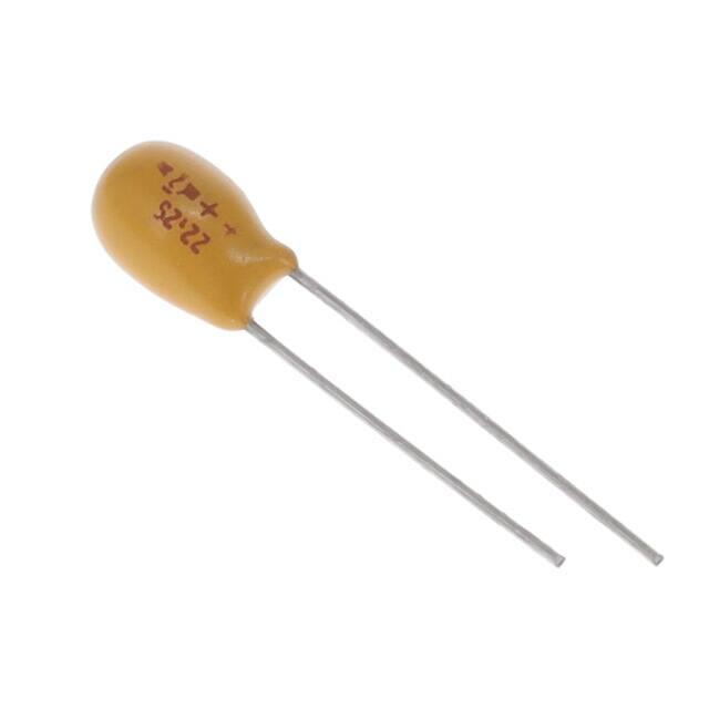

199D www.vishay.com Vishay Sprague Solid-Electrolyte TANTALEX™ Capacitors, Resin-Coated, Radial-Lead FEATURES • Terminations: tin / lead (SnPb), 100 % tin (Sn) • Economy and high performance are combined Available in these radial-lead, solid-electrolyte TANTALEX™ capacitors • Rugged, reliable capacitors featuring low Available leakage current and low dissipation factor • Six miniature case sizes and five lead styles. All case sizes are available in standard tape and reel packaging per EIA-468 • Standard ratings include replacements for type 196D capacitors • Lead (Pb)-free capacitors have “L” in body marking • Material categorization: for definitions of compliance please see www.vishay.com/doc?99912 Note * This datasheet provides information about parts that are RoHS-compliant and / or parts that are non RoHS-compliant. For example, parts with lead (Pb) terminations are not RoHS-compliant. Please see the information / tables in this datasheet for details APPLICATIONS Suitable for a broad range of consumer, commercial and industrial equipment PERFORMANCE CHARACTERISTICS Operating Temperature: -55 °C to +85 °C  (to +125 °C with voltage derating) Capacitance Tolerance: at 120 Hz, +25 °C, ± 20 %, ± 10 % standard. ± 5 % available as special Dissipation Factor: at 120 Hz, +25 °C. Dissipation factor, shall not exceed the values listed in the Standard Ratings tables. DC Leakage Current (DCL Max.): at +25 °C: leakage current shall not exceed the values listed in the Standard Ratings tables. at +85 °C: leakage current shall not exceed 10 times the values listed in the Standard Ratings tables. at +125 °C: leakage shall not exceed 15 times the values listed in the Standard Ratings tables. Life Test: capacitors shall withstand rated DC voltage applied at +85 °C for 1000 h with a circuit resistance not greater than 3 . Following the life test: 1. DCL shall not exceed 125 % of the initial requirements 2. Dissipation factor shall meet the initial requirement 3. Change in capacitance shall not exceed ± 10 % ORDERING INFORMATION 199D 475 X9 003 A 1 (1) V1 E3 MODEL CAPACITANCE CAPACITANCE TOLERANCE DC VOLTAGE RATING AT +85 °C CASE CODE LEAD STYLE PACKAGING RoHSCOMPLIANT This is expressed in picofarads. The first two digits are the significant figures. The third is the number of zeros to follow. X0 = ± 20 % X9 = ± 10 % ** X5 = ± 5 % ** Special Order This is expressed in V. To complete the three-digit block, zeros precede the voltage rating. A decimal point is indicated by an “R” (6R3 = 6.3 V). See Ratings and Case Codes table. V1 = bulk B1 = tape and reel A1 = tape / ammo box E3 = 100 % tin termination (RoHS-compliant) Blank = tin / lead termination Note (1) See lead styles table Revision: 04-Aug-2020 Document Number: 40020 1 For technical questions, contact: tantalum@vishay.com THIS DOCUMENT IS SUBJECT TO CHANGE WITHOUT NOTICE. THE PRODUCTS DESCRIBED HEREIN AND THIS DOCUMENT ARE SUBJECT TO SPECIFIC DISCLAIMERS, SET FORTH AT www.vishay.com/doc?91000 199D www.vishay.com Vishay Sprague LEAD STYLE CONFIGURATIONS AND CODES STRAIGHT UNEVEN LEADS CODES 1, 3, AND Y STRAIGHT EVEN LEADS CODES 2, 4, AND 5 D D + + 3±1 H “OUTSIDE HOCKEY STICK” CODES 6 AND 7 + + H1 1.1 ± 0.05 L P P 6.35 max. D + + L L “HAIRPIN” CODES X, Z D D + + H “SNAP-IN” CODE 9 H H L P H1 L P P Notes • Wire diameter (nominal) 0.020" (0.51 mm) • L = lead length • P = pitch or lead spacing AVAILABLE LEAD STYLES AND PACKAGING TYPES PER CASE SIZE LEAD STYLE / CASE 1 2 3 4 5 6 Bulk Bulk Reel Ammo - - Bulk Reel Ammo - Bulk 7 9 X Y Z Bulk Reel Ammo Bulk Reel Ammo Bulk Reel Ammo Bulk Bulk Reel Ammo - - - - - A B C D E F Bulk / Reel Ammo Bulk Reel Ammo - DIMENSIONS FOR LEAD STYLES 1, 2, 3, 4, 5, Y, 6 in inches [millimeters] LEAD STYLE 1, 2, 3, 4 1, 3 2, 4 5, Y 6 CASE D (max.) P (1) ± 0.024 [0.60] H (max.) L (2) (min.) L (2) ± 0.118 [3.0] P (1) ± 0.03 [0.76] L (2) ± 0.118 [3.0] P (1) ± 0.024 [0.60] H1 (max.) L (2) A 0.173 [4.40] 0.100 [2.54] 0.280 [7.11] 0.591 [15.0] 0.748 [19.0] 0.125 [3.18] 0.748 [19.0] 0.200 [5.08] 0.378 [9.61] 0.240 ± 0.030 [6.1 ± 0.76] B 0.197 [5.00] 0.100 [2.54] 0.300 [7.62] 0.591 [15.0] 0.748 [19.0] 0.125 [3.18] 0.748 [19.0] 0.200 [5.08] 0.398 [10.11] 0.240 ± 0.030 [6.1 ± 0.76] C 0.217 [5.50] 0.100 [2.54] 0.360 [9.14] 0.591 [15.0] 0.748 [19.0] 0.125 [3.18] 0.748 [19.0] 0.200 [5.08] 0.458 [11.64] 0.240 ± 0.030 [6.1 ± 0.76] D 0.236 [6.00] 0.100 [2.54] 0.400 [10.16] 0.591 [15.0] 0.748 [19.0] 0.125 [3.18] 0.748 [19.0] 0.200 [5.08] 0.498 [12.66] 0.240 ± 0.030 [6.1 ± 0.76] E 0.339 [8.60] 0.200 [5.08] 0.492 [12.50] 0.591 [15.0] 0.748 [19.0] n/a n/a 0.200 [5.08] 0.591 [15.00] 1.0 ± 0.122 [25.4 ± 3.1] F 0.378 [9.60] 0.200 [5.08] 0.650 [16.50] 0.591 [15.0] 0.748 [19.0] n/a n/a 0.200 [5.08] 0.748 [19.00] 1.0 ± 0.122 [25.4 ± 3.1] Notes (1) Pitch or lead spacing P measured within 0.05" [1.27 mm] of the body of the capacitor or from the bottom of the crimp (2) Lead length L is for bulk packaging Revision: 04-Aug-2020 Document Number: 40020 2 For technical questions, contact: tantalum@vishay.com THIS DOCUMENT IS SUBJECT TO CHANGE WITHOUT NOTICE. THE PRODUCTS DESCRIBED HEREIN AND THIS DOCUMENT ARE SUBJECT TO SPECIFIC DISCLAIMERS, SET FORTH AT www.vishay.com/doc?91000 199D www.vishay.com Vishay Sprague DIMENSIONS FOR LEAD STYLES 7, 9, X, Z in inches [millimeters] LEAD STYLE 7 9 H1 max. L (2) ± 0.03 [0.76] P (1) ± 0.024 [0.60] X, Z H1 max. L (2) ± 0.03 [0.76] D max. H max. X Z H1 max. L (2) ± 0.125 [3.175] P (1) ± 0.024 [0.60] P (1) ± 0.024 [0.60] CASE D max. P (1) ± 0.024 [0.60] A 0.173 [4.40] 0.25 [6.35] 0.378 [9.61] 0.240 ± 0.030 [6.1 ± 0.76] 0.200 [5.08] 0.398 [10.11] 0.240 [6.10] 0.173 [4.40] 0.280 [7.11] 0.340 [8.64] 0.750 [19.05] 0.100 [2.54] 0.125 [3.175] B 0.197 [5.00] 0.25 [6.35] 0.398 0.240 ± 0.030 [10.12] [6.1 ± 0.76] 0.200 [5.08] 0.418 [10.62] 0.240 [6.10] 0.197 [5.00] 0.300 [7.62] 0.360 [9.14] 0.750 [19.05] 0.100 [2.54] 0.125 [3.175] C 0.217 [5.50] 0.25 [6.35] 0.458 0.240 ± 0.030 [11.64] [6.1 ± 0.76] 0.200 [5.08] 0.478 [12.14] 0.240 [6.10] 0.217 [5.50] 0.360 [9.14] 0.420 [10.67] 0.750 [19.05] 0.100 [2.54] 0.125 [3.175] D 0.236 [6.00] 0.25 [6.35] 0.498 0.240 ± 0.030 [12.66] [6.1 ± 0.76] 0.200 [5.08] 0.518 [13.16] 0.240 [6.10] 0.236 [6.00] 0.400 [10.16] 0.460 [11.68] 0.750 [19.05] 0.100 [2.54] 0.125 [3.175] Notes (1) Pitch or lead spacing P measured within 0.05" [1.27 mm] of the body of the capacitor or from the bottom of the crimp (2) Lead length L is for bulk packaging 199D OBSOLETE VS. CURRENT ORDERING CROSS REFERENCE OBSOLETE NEW DESCRIPTION A1 1V1 PITCH 0.100, UNEVEN STRAIGHT LEADS, BULK CASES A - D A1 3V1 PITCH 0.200, UNEVEN STRAIGHT LEADS, BULK, CASES E, F A1 2V1 PITCH 0.100, EVEN STRAIGHT LEADS, BULK, CASES A - D A6 2B1 PITCH 0.100, EVEN STRAIGHT LEADS, REEL POSITIVE LEADER, CASES A - D A6 2A1 PITCH 0.100, EVEN STRAIGHT LEADS, AMMO, CASES A - D A1 4V1 PITCH 0.200, EVEN STRAIGHT LEADS, BULK, CASES E, F A6 4B1 PITCH 0.200, EVEN STRAIGHT LEADS, REEL POSITIVE LEADER, CASES E, F A6 4A1 PITCH 0.200, EVEN STRAIGHT LEADS, AMMO, CASES E, F A2 5V1 PITCH 0.125, EVEN STRAIGHT LEADS, BULK, CASES A - D A7 5B1 PITCH 0.125, EVEN STRAIGHT LEADS, REEL POSITIVE LEADER, CASES A - D A7 5A1 PITCH 0.125, EVEN STRAIGHT LEADS, AMMO, CASES A - D PITCH 0.125, UNEVEN STRAIGHT LEADS, BULK, CASES A - D A2 YV1 B1 XV1 PITCH 0.100, HAIRPIN LEADS, BULK CASES A - D B6 XB1 PITCH 0.100, HAIRPIN LEADS, REEL POSITIVE LEADER, CASES A - D B6 XA1 PITCH 0.100, HAIRPIN LEADS, AMMO, CASES A - D B2 ZV1 PITCH 0.125, HAIRPIN LEADS, BULK, CASES A - D B7 ZB1 PITCH 0.125, HAIRPIN LEADS, REEL POSITIVE LEADER, CASES A - D B7 ZA1 PITCH 0.125, HAIRPIN LEADS, AMMO, CASES A - D E2 6V1 PITCH 0.200, HOCKEY STICK LEADS, BULK, CASES A - F E7 6B1 PITCH 0.200, HOCKEY STICK LEADS, REEL POSITIVE LEADER, CASES A - F E7 6A1 PITCH 0.200, HOCKEY STICK LEADS, AMMO, CASES A - F E3 7V1 PITCH 0.250, HOCKEY STICK LEADS, BULK, CASES A - D E8 7B1 PITCH 0.250, HOCKEY STICK LEADS, REEL POSITIVE LEADER, CASES A - D E8 7A1 PITCH 0.250, HOCKEY STICK LEADS, AMMO, CASES A - D G2 9V1 PITCH 0.200, SNAP-IN LEADS, BULK, CASES A - D G7 9B1 PITCH 0.200, SNAP-IN LEADS, REEL POSITIVE LEADER, CASES A - D G7 9A1 PITCH 0.200, SNAP-IN LEADS, AMMO, CASES A - D E4 Revision: 04-Aug-2020 OBSOLETE Document Number: 40020 3 For technical questions, contact: tantalum@vishay.com THIS DOCUMENT IS SUBJECT TO CHANGE WITHOUT NOTICE. THE PRODUCTS DESCRIBED HEREIN AND THIS DOCUMENT ARE SUBJECT TO SPECIFIC DISCLAIMERS, SET FORTH AT www.vishay.com/doc?91000 199D www.vishay.com Vishay Sprague STANDARD RATINGS CAPACITANCE (μF) CASE CODE PART NUMBER MAX. DCL AT +25 °C (μA) MAX. DF AT +25 °C 120 Hz (%) 3 VDC AT +85 °C, SURGE = 3.6 V; 2 VDC AT +125 °C, SURGE = 2.4 V 4.7 A 199D475(1)003A(2)(3) 0.5 6 6.8 A 199D685(1)003A(2)(3) 0.5 6 10 A 199D106(1)003A(2)(3) 0.5 8 15 A 199D156(1)003A(2)(3) 0.5 8 22 B 199D226(1)003B(2)(3) 0.6 8 33 B 199D336(1)003B(2)(3) 1.0 8 47 C 199D476(1)003C(2)(3) 1.4 8 68 C 199D686(1)003C(2)(3) 2.0 8 100 D 199D107(1)003D(2)(3) 3.0 10 150 D 199D157(1)003D(2)(3) 4.0 10 220 E 199D227(1)003E(2)(3) 5.0 10 330 E 199D337(1)003E(2)(3) 6.0 10 470 F 199D477(1)003F(2)(3) 8.0 10 680 F 199D687(1)003F(2)(3) 10.0 10 6.3 VDC AT +85 °C, SURGE = 8 V; 4 VDC AT +125 °C, SURGE = 5 V 4.7 A 199D475(1)6R3A(2)(3) 0.5 6 6.8 A 199D685(1)6R3A(2)(3) 0.5 6 10 B 199D106(1)6R3B(2)(3) 0.6 8 15 B 199D156(1)6R3B(2)(3) 0.9 8 22 C 199D226(1)6R3C(2)(3) 1.3 8 33 C 199D336(1)6R3C(2)(3) 2.0 8 47 D 199D476(1)6R3D(2)(3) 2.9 8 68 D 199D686(1)6R3D(2)(3) 4.0 8 100 D 199D107(1)6R3D(2)(3) 5.0 10 150 E 199D157(1)6R3E(2)(3) 6.0 10 220 E 199D227(1)6R3E(2)(3) 7.0 10 330 F 199D337(1)6R3F(2)(3) 8.0 10 10 VDC AT +85 °C, SURGE = 13 V; 7 VDC AT +125 °C, SURGE = 9 V 3.3 A 199D335(1)010A(2)(3) 0.5 6 4.7 A 199D475(1)010A(2)(3) 0.5 6 6.8 B 199D685(1)010B(2)(3) 0.6 6 10 B 199D106(1)010B(2)(3) 1.0 8 15 C 199D156(1)010C(2)(3) 1.5 8 22 C 199D226(1)010C(2)(3) 2.0 8 33 D 199D336(1)010D(2)(3) 3.0 8 39 D 199D396(1)010D(2)(3) 3.9 8 47 D 199D476(1)010D(2)(3) 4.0 8 68 D 199D686(1)010D(2)(3) 5.0 8 100 E 199D107(1)010E(2)(3) 6.0 10 150 E 199D157(1)010E(2)(3) 7.0 10 220 F 199D227(1)010F(2)(3) 8.0 10 Note • Part number definitions: (1) For capacitance tolerance: X0 = ± 20 %, X9 = ± 10 % or X5 = 5 % (2) To specify lead style / spacing / packaging insert the last three characters in the part number. Use the appropriate code shown in the Current Ordering Cross Reference table and explained in the Ordering Information and Lead Styles table (3) E3 = RoHS-compliant 100 % tin leads. Blank or no suffix = standard tin / lead termination Revision: 04-Aug-2020 Document Number: 40020 4 For technical questions, contact: tantalum@vishay.com THIS DOCUMENT IS SUBJECT TO CHANGE WITHOUT NOTICE. THE PRODUCTS DESCRIBED HEREIN AND THIS DOCUMENT ARE SUBJECT TO SPECIFIC DISCLAIMERS, SET FORTH AT www.vishay.com/doc?91000 199D www.vishay.com Vishay Sprague STANDARD RATINGS CAPACITANCE (μF) CASE CODE PART NUMBER MAX. DCL AT +25 °C (μA) MAX. DF AT +25 °C 120 Hz (%) 16 VDC AT +85 °C, SURGE = 20 V; 10 VDC AT +125 °C, SURGE = 12 V 2.2 A 199D225(1)016A(2)(3) 0.5 6 3.3 A 199D335(1)016A(2)(3) 0.5 6 4.7 B 199D475(1)016B(2)(3) 0.7 6 6.8 B 199D685(1)016B(2)(3) 1.0 6 10 C 199D106(1)016C(2)(3) 1.5 8 15 C 199D156(1)016C(2)(3) 2.4 8 22 D 199D226(1)016D(2)(3) 3.5 8 33 D 199D336(1)016D(2)(3) 4.0 8 47 E 199D476(1)016E(2)(3) 5.0 8 68 E 199D686(1)016E(2)(3) 6.0 8 100 F 199D107(1)016F(2)(3) 7.0 10 150 F 199D157(1)016F(2)(3) 8.0 10 20 VDC AT +85 °C, SURGE = 26 V; 13 VDC AT +125 °C, SURGE = 16 V 1.0 A 199D105(1)020A(2)(3) 0.5 4 2.7 B 199D275(1)020B(2)(3) 0.7 6 3.3 B 199D335(1)020B(2)(3) 0.8 6 4.7 B 199D475(1)020B(2)(3) 1.0 6 6.8 C 199D685(1)020C(2)(3) 1.5 6 10 C 199D106(1)020C(2)(3) 2.0 8 15 D 199D156(1)020D(2)(3) 2.5 8 22 D 199D226(1)020D(2)(3) 3.0 8 33 E 199D336(1)020E(2)(3) 4.0 8 47 E 199D476(1)020E(2)(3) 5.0 8 68 F 199D686(1)020F(2)(3) 6.0 8 100 F 199D107(1)020F(2)(3) 7.0 10 25 VDC AT +85 °C, SURGE = 33 V; 17 VDC AT +125 °C, SURGE = 21 V 1.0 A 199D105(1)025A(2)(3) 0.5 4 1.5 A 199D155(1)025A(2)(3) 0.5 6 2.2 A 199D225(1)025A(2)(3) 0.5 6 3.3 B 199D335(1)025B(2)(3) 0.8 6 4.7 B 199D475(1)025B(2)(3) 1.0 6 6.8 C 199D685(1)025C(2)(3) 1.5 6 10 C 199D106(1)025C(2)(3) 2.5 8 15 D 199D156(1)025D(2)(3) 3.0 8 22 D 199D226(1)025D(2)(3) 4.0 8 33 E 199D336(1)025E(2)(3) 5.0 8 47 E 199D476(1)025E(2)(3) 6.0 8 68 F 199D686(1)025F(2)(3) 7.0 8 Note • Part number definitions: (1) For capacitance tolerance: X0 = ± 20 %, X9 = ± 10 % or X5 = 5 % (2) To specify lead style / spacing / packaging insert the last three characters in the part number. Use the appropriate code shown in the Current Ordering Cross Reference table and explained in the Ordering Information and Lead Styles table (3) E3 = RoHS-compliant 100 % tin leads. Blank or no suffix = standard tin / lead termination Revision: 04-Aug-2020 Document Number: 40020 5 For technical questions, contact: tantalum@vishay.com THIS DOCUMENT IS SUBJECT TO CHANGE WITHOUT NOTICE. THE PRODUCTS DESCRIBED HEREIN AND THIS DOCUMENT ARE SUBJECT TO SPECIFIC DISCLAIMERS, SET FORTH AT www.vishay.com/doc?91000 199D www.vishay.com Vishay Sprague STANDARD RATINGS CAPACITANCE (μF) CASE CODE PART NUMBER MAX. DCL AT +25 °C (μA) MAX. DF AT +25 °C 120 Hz (%) 35 VDC AT +85 °C, SURGE = 46 V; 23 VDC AT +125 °C, SURGE = 28 V 0.10 A 199D104(1)035A(2)(3) 0.5 4 0.15 A 199D154(1)035A(2)(3) 0.5 4 0.22 A 199D224(1)035A(2)(3) 0.5 4 0.33 A 199D334(1)035A(2)(3) 0.5 4 0.47 A 199D474(1)035A(2)(3) 0.5 4 0.68 A 199D684(1)035A(2)(3) 0.5 4 1.0 A 199D105(1)035A(2)(3) 0.5 4 1.5 A 199D155(1)035A(2)(3) 0.5 6 1.8 B 199D185(1)035B(2)(3) 0.7 6 2.2 B 199D225(1)035B(2)(3) 0.7 6 6 3.3 B 199D335(1)035B(2)(3) 1.0 4.7 C 199D475(1)035C(2)(3) 1.5 6 5.6 D 199D565(1)035D(2)(3) 1.9 6 6.8 D 199D685(1)035D(2)(3) 2.3 6 10 D 199D106(1)035D(2)(3) 3.5 8 15 E 199D156(1)035E(2)(3) 4.0 8 22 E 199D226(1)035E(2)(3) 5.0 8 33 F 199D336(1)035F(2)(3) 6.0 8 47 F 199D476(1)035F(2)(3) 7.0 8 0.10 A 199D104(1)050A(2)(3) 0.5 4 0.15 A 199D154(1)050A(2)(3) 0.5 4 0.22 A 199D224(1)050A(2)(3) 0.5 4 0.33 A 199D334(1)050A(2)(3) 0.5 4 0.47 A 199D474(1)050A(2)(3) 0.5 4 0.68 A 199D684(1)050A(2)(3) 0.5 4 50 VDC AT +85 °C, SURGE = 65 V; 33 VDC AT +125 °C, SURGE = 40 V 1.0 B 199D105(1)050B(2)(3) 0.5 4 1.5 C 199D155(1)050C(2)(3) 0.7 6 2.2 C 199D225(1)050C(2)(3) 1.1 6 3.3 D 199D335(1)050D(2)(3) 1.5 6 4.7 D 199D475(1)050D(2)(3) 2.0 6 6.8 F 199D685(1)050F(2)(3) 3.0 6 10 F 199D106(1)050F(2)(3) 4.0 8 15 F 199D156(1)050F(2)(3) 5.0 8 22 F 199D226(1)050F(2)(3) 6.0 8 Note • Part number definitions: (1) For capacitance tolerance: X0 = ± 20 %, X9 = ± 10 % or X5 = 5 % (2) To specify lead style / spacing / packaging insert the last three characters in the part number. Use the appropriate code shown in the Current Ordering Cross Reference table and explained in the Ordering Information and Lead Styles table (3) E3 = RoHS-compliant 100 % tin leads. Blank or no suffix = standard tin / lead termination Revision: 04-Aug-2020 Document Number: 40020 6 For technical questions, contact: tantalum@vishay.com THIS DOCUMENT IS SUBJECT TO CHANGE WITHOUT NOTICE. THE PRODUCTS DESCRIBED HEREIN AND THIS DOCUMENT ARE SUBJECT TO SPECIFIC DISCLAIMERS, SET FORTH AT www.vishay.com/doc?91000 199D www.vishay.com Vishay Sprague STANDARD TAPE AND REEL / AMMO BOX PACKAGING DIMENSIONS PER EIA-468 in inches [millimeters] Lead style 2, 4, 5 Lead style 6, 7 Lead style X, Z P H1 W2 H0 W1 W P0 F SYMBOL DESCRIPTION DIMENSIONS TOLERANCE P Component pitch 0.500 [12.7] ± 0.039 [± 1.0] P0 Feed hole pitch 0.500 [12.7] ± 0.012 [± 0.3] +0.039 / -0.020 [+1.0 / -0.5] W Tape width 0.709 [18.0] W0 Hold down tape width 0.20 [5.0] Minimum W1 Feed hole position 0.354 [9.0] +0.030 / -0.020 [+0.075 / -0.5] Maximum W2 Hold down tape position 0.118 [3.0] H1 Overall component height above tape central line 1.27 [32.26] Maximum D0 Feed hole diameter 0.157 [4.0] ± 0.012 [± 0.3] t Tape thickness 0.028 [0.7] Maximum H0 Height to seating plane 0.63 [16.0] ± 0.02 [± 0.5] F Pitch or lead wire spacing See “Dimensions for Lead Styles” tables Tape and Reel Packaging: type 199D radial-leaded tantalum capacitors, all lead styles except 1, 3, and Y are available taped and reeled per EIA-468. CASE CODE A Quantity per box bulk Quantity per box ammopack B C 1000 2500 D E 500 2000 Quantity per reel 1500 F 100 1000 1000 500 500 PRODUCT INFORMATION Mounting of Through Hole Components www.vishay.com/doc?40108 Solid Tantalum Capacitors (With MnO2 Electrolyte) Voltage Derating www.vishay.com/doc?40246 SELECTOR GUIDES Quick Reference Guide www.vishay.com/doc?40037 Selector Guide www.vishay.com/doc?49054 Parameter Comparison Guide www.vishay.com/doc?40033 FAQ Frequently Asked Questions Revision: 04-Aug-2020 www.vishay.com/doc?40110 Document Number: 40020 7 For technical questions, contact: tantalum@vishay.com THIS DOCUMENT IS SUBJECT TO CHANGE WITHOUT NOTICE. THE PRODUCTS DESCRIBED HEREIN AND THIS DOCUMENT ARE SUBJECT TO SPECIFIC DISCLAIMERS, SET FORTH AT www.vishay.com/doc?91000 Legal Disclaimer Notice www.vishay.com Vishay Disclaimer ALL PRODUCT, PRODUCT SPECIFICATIONS AND DATA ARE SUBJECT TO CHANGE WITHOUT NOTICE TO IMPROVE RELIABILITY, FUNCTION OR DESIGN OR OTHERWISE. Vishay Intertechnology, Inc., its affiliates, agents, and employees, and all persons acting on its or their behalf (collectively, “Vishay”), disclaim any and all liability for any errors, inaccuracies or incompleteness contained in any datasheet or in any other disclosure relating to any product. Vishay makes no warranty, representation or guarantee regarding the suitability of the products for any particular purpose or the continuing production of any product. To the maximum extent permitted by applicable law, Vishay disclaims (i) any and all liability arising out of the application or use of any product, (ii) any and all liability, including without limitation special, consequential or incidental damages, and (iii) any and all implied warranties, including warranties of fitness for particular purpose, non-infringement and merchantability. Statements regarding the suitability of products for certain types of applications are based on Vishay’s knowledge of typical requirements that are often placed on Vishay products in generic applications. Such statements are not binding statements about the suitability of products for a particular application. It is the customer’s responsibility to validate that a particular product with the properties described in the product specification is suitable for use in a particular application. Parameters provided in datasheets and / or specifications may vary in different applications and performance may vary over time. All operating parameters, including typical parameters, must be validated for each customer application by the customer’s technical experts. Product specifications do not expand or otherwise modify Vishay’s terms and conditions of purchase, including but not limited to the warranty expressed therein. Except as expressly indicated in writing, Vishay products are not designed for use in medical, life-saving, or life-sustaining applications or for any other application in which the failure of the Vishay product could result in personal injury or death. Customers using or selling Vishay products not expressly indicated for use in such applications do so at their own risk. Please contact authorized Vishay personnel to obtain written terms and conditions regarding products designed for such applications. No license, express or implied, by estoppel or otherwise, to any intellectual property rights is granted by this document or by any conduct of Vishay. Product names and markings noted herein may be trademarks of their respective owners. © 2021 VISHAY INTERTECHNOLOGY, INC. ALL RIGHTS RESERVED Revision: 01-Jan-2021 1 Document Number: 91000
199D226X9025D1V1
物料型号:VISHAY 199D
器件简介:Vishay Sprague生产的Solid-Electrolyte TANTALEX™ Capacitors,树脂涂层,径向引脚。这些电容器结合了经济性和高性能,具有低漏电流和低耗散因子。
引脚分配:文档中提供了多种引脚样式和代码,包括直引脚、曲引脚、快插式和发夹式引脚。
参数特性: - 工作温度:-55°C 至 +85°C(通过电压降额可至+125°C) - 寿命测试:在+85°C下施加额定直流电压1000小时,电路电阻不超过3Ω - 电容公差:在120Hz,+25°C下,标准为±20%,±10%或±5%(特殊订单) - 耗散因子:在120Hz,+25°C下,不应超过标准等级表中列出的值 - DC漏电流(最大值):在+25°C下,漏电流不应超过标准等级表中列出的值
功能详解:文档提供了详细的电容器性能参数和测试条件,包括在不同温度和电压条件下的漏电流和耗散因子的最大值。
应用信息:适用于广泛的消费类、商业和工业设备。
封装信息:提供了六种小型封装尺寸和五种引脚样式,所有封装尺寸均可用标准胶带和卷轴包装,符合EIA-468标准。
