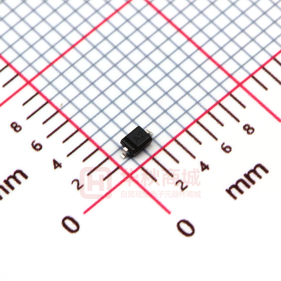

    功率:200mW 直流反向耐压(Vr):100V 平均整流电流(Io):150mA 正向压降(Vf):1.2V@100mA 反向电流(Ir):100uA@100V 反向恢复时间(trr):4ns 工作...
1N4148WS-E3-18 数据手册
1N4148WS www.vishay.com Vishay Semiconductors Small Signal Fast Switching Diode FEATURES • Silicon epitaxial planar diode • Fast switching diodes • AEC-Q101 qualified available • Base P/N-E3 - RoHS-compliant, commercial grade • Base P/N-HE3 - RoHS-compliant, AEC-Q101 qualified MARKING (example only) XY • Material categorization: for definitions of compliance please see www.vishay.com/doc?99912 MECHANICAL DATA 22610 Bar = cathode marking XY = type code Case: SOD-323 DESIGN SUPPORT TOOLS click logo to get started Packaging codes / options: Weight: approx. 4.3 mg 18/10K per 13" reel (8 mm tape), 10K/box 08/3K per 7" reel (8 mm tape), 15K/box Models Available PARTS TABLE PART 1N4148WS ORDERING CODE CIRCUIT CONFIGURATION TYPE MARKING REMARKS Single A2 Tape and reel 1N4148WS-E3-08 or 1N4148WS-E3-18 1N4148WS-HE3-08 or 1N4148WS-HE3-18 ABSOLUTE MAXIMUM RATINGS (Tamb = 25 °C, unless otherwise specified) PARAMETER TEST CONDITION SYMBOL VALUE VR 75 VRRM 100 f ≥ 50 Hz IF(AV) 150 t < 1 s and Tj = 25 °C IFSM 350 Ptot 200 mW SYMBOL VALUE UNIT RthJA 650 K/W Tj 150 °C Storage temperature range Tstg -65 to +150 °C Operating temperature range Top -55 to +150 °C Reverse voltage Repetitive peak reverse voltage Average rectified current half wave rectification with resistive load (1) Surge forward current Power dissipation (1) UNIT V mA Note (1) Valid provided that electrodes are kept at ambient temperature. THERMAL CHARACTERISTICS (Tamb = 25 °C, unless otherwise specified) PARAMETER TEST CONDITION Thermal resistance junction to ambient air (1) Junction temperature Note (1) Valid provided that electrodes are kept at ambient temperature Rev. 2.3, 06-Jul-17 Document Number: 85751 1 For technical questions within your region: DiodesAmericas@vishay.com, DiodesAsia@vishay.com, DiodesEurope@vishay.com THIS DOCUMENT IS SUBJECT TO CHANGE WITHOUT NOTICE. THE PRODUCTS DESCRIBED HEREIN AND THIS DOCUMENT ARE SUBJECT TO SPECIFIC DISCLAIMERS, SET FORTH AT www.vishay.com/doc?91000 1N4148WS www.vishay.com Vishay Semiconductors ELECTRICAL CHARACTERISTICS (Tamb = 25 °C, unless otherwise specified) PARAMETER TEST CONDITION SYMBOL MAX. UNIT IF = 10 mA VF 1 V IF = 100 mA VF 1.2 V VR = 20 V IR 25 nA Forward voltage VR = 75 V IR 5 IR 100 VR = 20 V, Tj = 150 °C IR 50 Diode capacitance Reverse recovery time TYP. VR = 100 V Leakage current Voltage rise when switching ON MIN. μA VF = VR = 0 V CD 4 pF Tested with 50 mA pulses, tp = 0.1 μs, rise time < 30 ns, fp = (5 to 100) kHz Vfr 2.5 V IF = 10 mA, iR = 1 mA, VR = 6 V, RL = 100 Ω trr 4 ns TYPICAL CHARACTERISTICS (Tamb = 25 °C, unless otherwise specified) 250 Ptot - Power Dissipation (mW) 103 102 Tj = 100 °C Tj = 25 °C IF (mA) 10 1 10-1 200 150 100 50 10-2 0 1 0 Fig. 1 - Forward Characteristics 50 100 150 200 Tamb - Ambient Temperature (°C) 20324 VF (V) 17437 0 2 Fig. 3 - Admissible Power Dissipation vs. Ambient Temperature 104 Tj = 25 °C 5 2 10 f = 1 MHz 3 1.0 CD (VR) 2 102 5 CD (0 V) 5 Rf (Ω) Tj = 25 °C 1.1 f = 1 kHz 2 0.9 0.8 10 5 0.7 2 10-2 17438 10-1 1 10 102 IF (mA) Fig. 2 - Dynamic Forward Resistance vs. Forward Current 0 17440 2 4 6 8 10 VR (V) Fig. 4 - Relative Capacitance vs. Reverse Voltage Rev. 2.3, 06-Jul-17 Document Number: 85751 2 For technical questions within your region: DiodesAmericas@vishay.com, DiodesAsia@vishay.com, DiodesEurope@vishay.com THIS DOCUMENT IS SUBJECT TO CHANGE WITHOUT NOTICE. THE PRODUCTS DESCRIBED HEREIN AND THIS DOCUMENT ARE SUBJECT TO SPECIFIC DISCLAIMERS, SET FORTH AT www.vishay.com/doc?91000 1N4148WS www.vishay.com Vishay Semiconductors 104 5 2 103 IR (nA) 5 2 102 5 2 10 5 VR = 20 V 2 1 100 0 17441 200 Tj (°C) Fig. 5 - Leakage Current vs. Junction Temperature 100 5 4 3 2 I IFRM (A) 1 T = 1/fP IFRM 10 5 4 3 2 n = tP/T tP n=0 t T 0.1 0.2 0.5 5 4 3 2 0.1 10-5 17442 2 5 10-4 2 5 10-3 2 5 10-2 2 5 10-1 2 5 1 2 5 10 tP (s) Fig. 6 - Admissible Repetitive Peak Forward Current vs. Pulse Duration Rev. 2.3, 06-Jul-17 Document Number: 85751 3 For technical questions within your region: DiodesAmericas@vishay.com, DiodesAsia@vishay.com, DiodesEurope@vishay.com THIS DOCUMENT IS SUBJECT TO CHANGE WITHOUT NOTICE. THE PRODUCTS DESCRIBED HEREIN AND THIS DOCUMENT ARE SUBJECT TO SPECIFIC DISCLAIMERS, SET FORTH AT www.vishay.com/doc?91000 1N4148WS www.vishay.com Vishay Semiconductors 0.1 [0.004] max. 0.15 [0.006] 0.10 [0.004] 0.2 [0.008] 0.8 [0.031] 1.15 [0.045] PACKAGE DIMENSIONS in millimeters (inches): SOD-323 0° - 8° 0.40 [0.016] 0.25 [0.010] 1.95 [0.077] 2.50 [0.098] 1.1 [0.043] 0.20 [0.008] 0.40 [0.016] 2.85 [0.112] 1.5 [0.059] 1.60 [0.063] Cathode bar Footprint recommendation: 1.6 [0.063] Document no.: S8-V-3910.02-001 (4) Created - Date: 24.August.2004 Rev. 6 - Date: 23.Sept.2016 17443 0.8 [0.031] 0.6 [0.024] 0.8 [0.031] Rev. 2.3, 06-Jul-17 Document Number: 85751 4 For technical questions within your region: DiodesAmericas@vishay.com, DiodesAsia@vishay.com, DiodesEurope@vishay.com THIS DOCUMENT IS SUBJECT TO CHANGE WITHOUT NOTICE. THE PRODUCTS DESCRIBED HEREIN AND THIS DOCUMENT ARE SUBJECT TO SPECIFIC DISCLAIMERS, SET FORTH AT www.vishay.com/doc?91000 Legal Disclaimer Notice www.vishay.com Vishay Disclaimer  ALL PRODUCT, PRODUCT SPECIFICATIONS AND DATA ARE SUBJECT TO CHANGE WITHOUT NOTICE TO IMPROVE RELIABILITY, FUNCTION OR DESIGN OR OTHERWISE. Vishay Intertechnology, Inc., its affiliates, agents, and employees, and all persons acting on its or their behalf (collectively, “Vishay”), disclaim any and all liability for any errors, inaccuracies or incompleteness contained in any datasheet or in any other disclosure relating to any product. Vishay makes no warranty, representation or guarantee regarding the suitability of the products for any particular purpose or the continuing production of any product. To the maximum extent permitted by applicable law, Vishay disclaims (i) any and all liability arising out of the application or use of any product, (ii) any and all liability, including without limitation special, consequential or incidental damages, and (iii) any and all implied warranties, including warranties of fitness for particular purpose, non-infringement and merchantability. Statements regarding the suitability of products for certain types of applications are based on Vishay’s knowledge of typical requirements that are often placed on Vishay products in generic applications. Such statements are not binding statements about the suitability of products for a particular application. It is the customer’s responsibility to validate that a particular product with the properties described in the product specification is suitable for use in a particular application. Parameters provided in datasheets and / or specifications may vary in different applications and performance may vary over time. All operating parameters, including typical parameters, must be validated for each customer application by the customer’s technical experts. Product specifications do not expand or otherwise modify Vishay’s terms and conditions of purchase, including but not limited to the warranty expressed therein. Except as expressly indicated in writing, Vishay products are not designed for use in medical, life-saving, or life-sustaining applications or for any other application in which the failure of the Vishay product could result in personal injury or death. Customers using or selling Vishay products not expressly indicated for use in such applications do so at their own risk. Please contact authorized Vishay personnel to obtain written terms and conditions regarding products designed for such applications. No license, express or implied, by estoppel or otherwise, to any intellectual property rights is granted by this document or by any conduct of Vishay. Product names and markings noted herein may be trademarks of their respective owners. © 2017 VISHAY INTERTECHNOLOGY, INC. ALL RIGHTS RESERVED Revision: 08-Feb-17 1 Document Number: 91000
