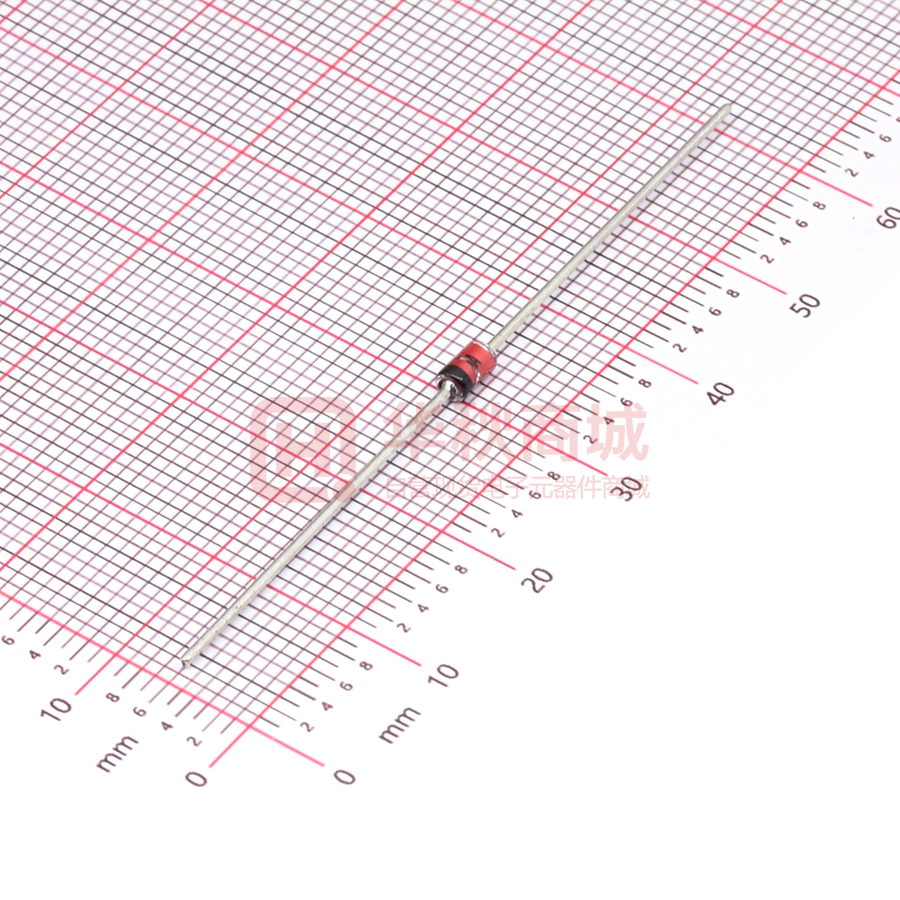

1N4728A to 1N4761A www.vishay.com Vishay Semiconductors Zener Diodes FEATURES • Silicon planar power Zener diodes • For use in stabilizing and clipping circuits with high power rating • Standard Zener voltage tolerance is ± 5 % • Material categorization: for definitions of compliance please see www.vishay.com/doc?99912 APPLICATIONS LINKS TO ADDITIONAL RESOURCES • Voltage stabilization 3D 3D 3D Models PRIMARY CHARACTERISTICS PARAMETER VALUE VZ range nom. 3.3 to 75 V Test current IZT 3.3 to 76 mA VZ specification Thermal equilibrium Circuit configuration UNIT Single ORDERING INFORMATION DEVICE NAME 1N4728A to 1N4761A 1N4728A to 1N4761A ORDERING CODE TAPED UNITS PER REEL MINIMUM ORDER QUANTITY 1N4728A to 1N4761A -series-TR 5000 per 13" reel 25 000/box 1N4728A to 1N4761A-series-TAP 5000 per ammopack (52 mm tape) 25 000/box PACKAGE PACKAGE NAME WEIGHT MOLDING COMPOUND FLAMMABILITY RATING MOISTURE SENSITIVITY LEVEL SOLDERING CONDITIONS DO-41 (DO-204AL) 310 mg UL 94 V-0 MSL level 1 (according J-STD-020) Peak temperature max. 260 °C ABSOLUTE MAXIMUM RATINGS (Tamb = 25 °C, unless otherwise specified) PARAMETER Power dissipation TEST CONDITION SYMBOL VALUE UNIT Valid provided that leads at a distance of 4 mm from case are kept at ambient temperature Ptot 1300 mW IZ PV/VZ mA RthJA 110 K/W Zener current Valid provided that leads at a distance of 4 mm Thermal resistance junction to ambient air from case are kept at ambient temperature Junction temperature Storage temperature range Forward voltage (max.) IF = 200 mA Tj 175 °C Tstg -65 to +175 °C VF 1.2 V Rev. 2.5. 25-Nov -2021 Document Number: 85816 1 For technical questions within your region: DiodesAmericas@vishay.com, DiodesAsia@vishay.com, DiodesEurope@vishay.com THIS DOCUMENT IS SUBJECT TO CHANGE WITHOUT NOTICE. THE PRODUCTS DESCRIBED HEREIN AND THIS DOCUMENT ARE SUBJECT TO SPECIFIC DISCLAIMERS, SET FORTH AT www.vishay.com/doc?91000 1N4728A to 1N4761A www.vishay.com Vishay Semiconductors ELECTRICAL CHARACTERISTICS (Tamb = 25 °C, unless otherwise specified) ZENER VOLTAGE RANGE (1) PART NUMBER TEST CURRENT VZ at IZT1 IZT1 IZT2 V mA mA NOM. REVERSE LEAKAGE CURRENT DYNAMIC RESISTANCE f = 1 kHz IR at VR ZZT at IZT1 ZZK at IZT2 IR IZM Ω mA mA μA V MAX. TYP. MAX. SURGE CURRENT (3) REGULATOR CURRENT (2) MAX. 1N4728A 3.3 76 1 100 1 10 400 1380 276 1N4729A 3.6 69 1 100 1 10 400 1260 252 1N4730A 3.9 64 1 50 1 9 400 1190 234 1N4731A 4.3 58 1 10 1 9 400 1070 217 1N4732A 4.7 53 1 10 1 8 500 970 193 1N4733A 5.1 49 1 10 1 7 550 890 178 1N4734A 5.6 45 1 10 2 5 600 810 162 1N4735A 6.2 41 1 10 3 2 700 730 146 1N4736A 6.8 37 1 10 4 3.5 700 660 133 1N4737A 7.5 34 0.5 10 5 4 700 605 121 1N4738A 8.2 31 0.5 10 6 4.5 700 550 110 1N4739A 9.1 28 0.5 10 7 5 700 500 100 1N4740A 10 25 0.25 10 7.6 7 700 454 91 1N4741A 11 23 0.25 5 8.4 8 700 414 83 1N4742A 12 21 0.25 5 9.1 9 700 380 76 1N4743A 13 19 0.25 5 9.9 10 700 344 69 1N4744A 15 17 0.25 5 11.4 14 700 304 61 1N4745A 16 15.5 0.25 5 12.2 16 700 285 57 1N4746A 18 14 0.25 5 13.7 20 750 250 50 1N4747A 20 12.5 0.25 5 15.2 22 750 225 45 1N4748A 22 11.5 0.25 5 16.7 23 750 205 41 1N4749A 24 10.5 0.25 5 18.2 25 750 190 38 1N4750A 27 9.5 0.25 5 20.6 35 750 170 34 1N4751A 30 8.5 0.25 5 22.8 40 1000 150 30 1N4752A 33 7.5 0.25 5 25.1 45 1000 135 27 1N4753A 36 7 0.25 5 27.4 50 1000 125 25 1N4754A 39 6.5 0.25 5 29.7 60 1000 115 23 1N4755A 43 6 0.25 5 32.7 70 1500 110 22 1N4756A 47 5.5 0.25 5 35.8 80 1500 95 19 1N4757A 51 5 0.25 5 38.8 95 1500 90 18 1N4758A 56 4.5 0.25 5 42.6 110 2000 80 16 1N4759A 62 4 0.25 5 47.1 125 2000 70 14 1N4760A 68 3.7 0.25 5 51.7 150 2000 65 13 1N4761A 75 3.3 0.25 5 56 175 2000 60 12 Notes (1) Based on DC measurement at thermal equilibrium while maintaining the lead temperature (T ) at 30 °C + 1 °C, 9.5 mm (3/8") from the L diode body (2) Valid provided that electrodes at a distance of 4 mm from case are kept at ambient temperature (3) t = 10 ms. p Rev. 2.5. 25-Nov -2021 Document Number: 85816 2 For technical questions within your region: DiodesAmericas@vishay.com, DiodesAsia@vishay.com, DiodesEurope@vishay.com THIS DOCUMENT IS SUBJECT TO CHANGE WITHOUT NOTICE. THE PRODUCTS DESCRIBED HEREIN AND THIS DOCUMENT ARE SUBJECT TO SPECIFIC DISCLAIMERS, SET FORTH AT www.vishay.com/doc?91000 1N4728A to 1N4761A www.vishay.com Vishay Semiconductors BASIC CHARACTERISTICS (Tamb = 25 °C, unless otherwise specified) Ptot - Power Dissipation (mW) 1400 1200 1000 800 600 400 200 0 0 50 100 150 200 Tamb- Ambient Temperature (°C) Fig. 1 - Admissible Power Dissipation vs. Ambient Temperature Ptot = f (Tamb) PACKAGE DIMENSIONS in millimeters (inches): DO-41 (DO-204AL)_1N47xx 4.1 max. [0.161] 3.3 min. [0.128] 26 min. [1.024] Ø 2.1 min. [0.081] 26 min. [1.024] Ø 2.6 max. [0.102] Ø 0.86 max. [0.034] Ø 0.7 min. [0.027] Cathode Identification Document no. S8-V-3901.04-001(4) Rev. 1 - Date: 30. Nov. 2011 22624 Rev. 2.5. 25-Nov -2021 Document Number: 85816 3 For technical questions within your region: DiodesAmericas@vishay.com, DiodesAsia@vishay.com, DiodesEurope@vishay.com THIS DOCUMENT IS SUBJECT TO CHANGE WITHOUT NOTICE. THE PRODUCTS DESCRIBED HEREIN AND THIS DOCUMENT ARE SUBJECT TO SPECIFIC DISCLAIMERS, SET FORTH AT www.vishay.com/doc?91000 Legal Disclaimer Notice www.vishay.com Vishay Disclaimer ALL PRODUCT, PRODUCT SPECIFICATIONS AND DATA ARE SUBJECT TO CHANGE WITHOUT NOTICE TO IMPROVE RELIABILITY, FUNCTION OR DESIGN OR OTHERWISE. Vishay Intertechnology, Inc., its affiliates, agents, and employees, and all persons acting on its or their behalf (collectively, “Vishay”), disclaim any and all liability for any errors, inaccuracies or incompleteness contained in any datasheet or in any other disclosure relating to any product. Vishay makes no warranty, representation or guarantee regarding the suitability of the products for any particular purpose or the continuing production of any product. To the maximum extent permitted by applicable law, Vishay disclaims (i) any and all liability arising out of the application or use of any product, (ii) any and all liability, including without limitation special, consequential or incidental damages, and (iii) any and all implied warranties, including warranties of fitness for particular purpose, non-infringement and merchantability. Statements regarding the suitability of products for certain types of applications are based on Vishay's knowledge of typical requirements that are often placed on Vishay products in generic applications. Such statements are not binding statements about the suitability of products for a particular application. It is the customer's responsibility to validate that a particular product with the properties described in the product specification is suitable for use in a particular application. Parameters provided in datasheets and / or specifications may vary in different applications and performance may vary over time. All operating parameters, including typical parameters, must be validated for each customer application by the customer's technical experts. Product specifications do not expand or otherwise modify Vishay's terms and conditions of purchase, including but not limited to the warranty expressed therein. Hyperlinks included in this datasheet may direct users to third-party websites. These links are provided as a convenience and for informational purposes only. Inclusion of these hyperlinks does not constitute an endorsement or an approval by Vishay of any of the products, services or opinions of the corporation, organization or individual associated with the third-party website. Vishay disclaims any and all liability and bears no responsibility for the accuracy, legality or content of the third-party website or for that of subsequent links. Except as expressly indicated in writing, Vishay products are not designed for use in medical, life-saving, or life-sustaining applications or for any other application in which the failure of the Vishay product could result in personal injury or death. Customers using or selling Vishay products not expressly indicated for use in such applications do so at their own risk. Please contact authorized Vishay personnel to obtain written terms and conditions regarding products designed for such applications. No license, express or implied, by estoppel or otherwise, to any intellectual property rights is granted by this document or by any conduct of Vishay. Product names and markings noted herein may be trademarks of their respective owners. © 2022 VISHAY INTERTECHNOLOGY, INC. ALL RIGHTS RESERVED Revision: 01-Jan-2022 1 Document Number: 91000

封装信息: - 封装类型为DO-41 (DO-204AL),重量为310毫克,阻燃等级为UL94V-0,湿度敏感等级为MSL 1级,焊接条件为峰值温度最高260°C。
