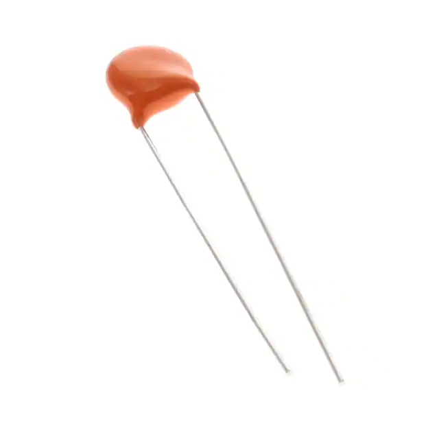

    TFUNK(威世)
    插件,P=6.4mm
    等级:X1,Y2 2.2NF ±20% 400V
30LVD22-R 数据手册
30LV Series www.vishay.com Vishay Cera-Mite EMI Suppression Capacitor, Ceramic Disc, Class X1, 400 VAC, Class Y2, 300 VAC FEATURES • Complying with IEC 60384-14 • High reliability • Complete range of capacitance values • Radial leads • Singlelayer AC disc safety capacitors • Material categorization: for definitions of compliance please see www.vishay.com/doc?99912 APPLICATIONS • X1/Y2 according to IEC 60384-14 • Line-to-line filtering (Class X) QUICK REFERENCE DATA DESCRIPTION • Line-to-ground filtering (Class Y) VALUE Ceramic Class • Primary and secondary coupling (SMPS) 1 2 C0G, C0G, U2J, P3K, U2J, P3K, R3L, S3L R3L, S3L Ceramic Dielectric Voltage (VAC) 300 400 Min. Capacitance (pF) 10 Max. Capacitance (pF) 68 Mounting • EMI / RFI suppression and filtering X7R, Y5U X7R, Y5U 300 400 100 15 000 Radial INSULATION RESISTANCE Min. 1000 F DESIGN The capacitors consist of a ceramic disc of which both sides are silver-plated. Connection leads are made of tinned copper having a diameter of 0.032" (0.81 mm) or 0.025" (0.64 mm). The capacitors may be supplied with radial kinked or straight leads having a lead spacing of 0.375" (9.5 mm) or 0.250" (6.4 mm). The standard tolerance is ± 20 %. Coating is made of flame retardant epoxy resin in accordance with “UL 94 V-0.” CAPACITANCE RANGE TOLERANCE ON CAPACITANCE ± 10 %; ± 20 % 10 pF to 0.015 μF RATED VOLTAGE DISSIPATION FACTOR IEC 60384-14: 2.0 % max. at 1 kHz; 1 V • X1:400 VAC, 50 Hz CERAMIC DIELECTRIC C0G, U2J, P3K, R3L (Class 1) X7R, Y5U (Class 2) CLIMATIC CATEGORY ACC. TO EN 60068-1 25/125/21 OPERATING TEMPERATURE RANGE -30 °C to +125 °C (1) Note (1) For explanation about the difference of operating temperature range and temperature characteristic of capacitance please see www.vishay.com/doc?48299) Revision: 30-Sep-2021 • Y2: 300 VAC, 50 Hz DIELECTRIC STRENGTH BETWEEN LEADS Component test, 100 % test at production line: 2500 VAC, 50 Hz, 2 s As repeated test at customer side admissible only once with: 2250 VAC, 50 Hz, 2 s Random sampling test (destructive test): 2500 VAC, 50 Hz, 60 s DIELECTRIC STRENGTH OF BODY INSULATION 2300 VAC, 50 Hz, 60 s (destructive test) Document Number: 23103 1 For technical questions, contact: ceramitesupport@vishay.com THIS DOCUMENT IS SUBJECT TO CHANGE WITHOUT NOTICE. THE PRODUCTS DESCRIBED HEREIN AND THIS DOCUMENT ARE SUBJECT TO SPECIFIC DISCLAIMERS, SET FORTH AT www.vishay.com/doc?91000 30LV Series www.vishay.com Vishay Cera-Mite DIMENSIONS in inches (millimeters) 1.250 min. (32) D max. LS Tinned Copper Leads Ø T max. 0.125 max. (3.2) ORDERING INFORMATION, CERAMIC X1/Y2 CAPACITORS 30LV C (pF) TOL. (%) Dmax. DIAMETER INCH (mm) Tmax. THICKNESS INCH (mm) AWG 10 ± 10 0.330 (8.4) 0.190 (4.8) 15 ± 10 0.330 (8.4) 22 ± 10 33 INCH (mm) LS LEAD SPACE INCH (mm) ORDERING CODE 22 0.025 (0.64) 0.250 (6.4) 30LVQ10-R 0.200 (5.1) 22 0.025 (0.64) 0.250 (6.4) 30LVQ15-R 0.330 (8.4) 0.185 (4.7) 22 0.025 (0.64) 0.250 (6.4) 30LVQ22-R ± 10 0.330 (8.4) 0.190 (4.8) 22 0.025 (0.64) 0.250 (6.4) 30LVQ33-R 47 ± 10 0.330 (8.4) 0.170 (4.3) 22 0.025 (0.64) 0.250 (6.4) 30LVQ47-R 68 ± 10 0.330 (8.4) 0.175 (4.4) 22 0.025 (0.64) 0.250 (6.4) 30LVQ68-R WIRE SIZE C0G U2J P3K R3L S3L X7R 100 0.330 (8.4) 0.200 (5.1) 30LVT10-R 150 0.330 (8.4) 0.180 (4.6) 30LVT15-R 220 0.330 (8.4) 0.190 (4.8) 30LVT22-R 0.330 (8.4) 0.210 (5.3) 0.330 (8.4) 0.180 (4.6) 560 0.330 (8.4) 0.190 (4.8) 30LVT56-R 680 0.330 (8.4) 0.180 (4.6) 30LVTT68-R 1000 0.365 (9.3) 0.185 (4.7) 30LVTD10-R 1500 0.460 (11.7) 0.180 (4.6) 30LVTD15-R 330 470 ± 10 30LVT33-R 22 0.025 (0.64) 0.250 (6.4) 30LVT47-R Y5U 680 0.330 (8.4) 0.210 (5.3) 30LVT68-R 1000 0.330 (8.4) 0.215 (5.5) 30LVD10-R 1500 0.330 (8.4) 0.195 (5.0) 30LVD15-R 2000 0.400 (10.2) 0.210 (5.3) 30LVD20-R 2200 0.400 (10.2) 0.200 (5.1) 30LVD22-R 0.430 (10.9) 0.200 (5.1) 0.430 (10.9) 0.200 (5.1) 3000 0.460 (11.7) 0.200 (5.1) 30LVD30-R 3200 0.460 (11.7) 0.200 (5.1) 30LVD32-R 3300 0.460 (11.7) 0.195 (5.0) 30LVD33-R 3900 0.490 (12.4) 0.200 (5.1) 30LVD39-R 4000 0.530 (13.5) 0.210 (5.3) 30LVD40-R 2700 2800 Revision: 30-Sep-2021 ± 20 22 0.025 (0.64) 0.250 (6.4) 30LVD27-R 30LVD28-R Document Number: 23103 2 For technical questions, contact: ceramitesupport@vishay.com THIS DOCUMENT IS SUBJECT TO CHANGE WITHOUT NOTICE. THE PRODUCTS DESCRIBED HEREIN AND THIS DOCUMENT ARE SUBJECT TO SPECIFIC DISCLAIMERS, SET FORTH AT www.vishay.com/doc?91000 30LV Series www.vishay.com Vishay Cera-Mite ORDERING INFORMATION, CERAMIC X1/Y2 CAPACITORS 30LV Dmax. DIAMETER INCH (mm) Tmax. THICKNESS INCH (mm) 4700 0.620 (15.7) 0.230 (5.8) 30LVD47-R 5000 0.620 (15.7) 0.225 (5.7) 30LVD50-R 5500 0.560 (14.2) 0.195 (5.0) 30LVD55-R 5600 0.560 (14.2) 0.205 (5.2) 30LVD56-R C (pF) TOL. (%) WIRE SIZE AWG INCH (mm) LS LEAD SPACE INCH (mm) ORDERING CODE Y5U 6800 0.620 (15.7) 0.215 (5.5) 8000 0.680 (17.3) 0.205 (5.2) 30LVD80-R 9000 0.720 (18.3) 0.210 (5.3) 30LVD90-R 10 000 0.790 (20.1) 0.225 (5.7) 30LVS10-R 15 000 0.900 (22.9) 0.210 (5.3) 30LVS15-R ± 20 20 0.032 (0.81) 0.375 (9.5) 30LVD68-R Notes • Alternate lead spacings of 7.5 mm and 10 mm are available bulk or tape and reel on request • Minimum lead clearance according to IEC 60384-14: 0.118" (3 mm) TAPE AND REEL OPTIONS Part number codes and specifications for tape and reel packaging are found in the general information document www.vishay.com/doc?23140. APPROVALS IEC 60384-14 - Safety tests This approval together with CB test certificate substitutes all national approvals. CB Certificate (www.vishay.com/doc?22228) Y2-capacitor: CB test certificate: DE1-63499 10 pF to 15 nF 300 VAC (1) Y2-capacitor: CB test certificate: DE1-63499 10 pF to 15 nF 250 VAC (1) X1-capacitor: CB test certificate: DE1-63499 10 pF to 15 nF 400 VAC Y2-capacitor: VDE marks approval: 40003992 10 pF to 15 nF 300 VAC (1) Y2-capacitor: VDE marks approval: 40003992 10 pF to 15 nF 250 VAC (1) X1-capacitor: VDE marks approval: 40003992 10 pF to 15 nF 400 VAC VDE (www.vishay.com/doc?22229) DIN EN 60384-14 VDE 0565-1-1 - Safety tests Underwriters Laboratories Inc. (www.vishay.com/doc?22230) Y2-capacitor: UL test certificate: E99264 10 pF to 15 nF 300 VAC X1-capacitor: UL test certificate: E99264 10 pF to 15 nF 400 VAC UL 60384-14, CSA E60384-1, CSA E60384-14 Fixed capacitors for electromagnetic interference suppression and connection to the supply mains. Note (2) LS  7.5 mm: 300 V ; 5.0 mm  LS < 7.5 mm: 250 V AC AC Revision: 30-Sep-2021 Document Number: 23103 3 For technical questions, contact: ceramitesupport@vishay.com THIS DOCUMENT IS SUBJECT TO CHANGE WITHOUT NOTICE. THE PRODUCTS DESCRIBED HEREIN AND THIS DOCUMENT ARE SUBJECT TO SPECIFIC DISCLAIMERS, SET FORTH AT www.vishay.com/doc?91000 30LV Series www.vishay.com Vishay Cera-Mite MARKING Sample CM 30LV 222M IEC 60384-14 Y2 300V~ X1 400V~ XX - XXX Notes • Marking IEC 60384-14 does not apply for Ø  9 mm • “XX - XXX” is a placeholder for date code and lot number: “XX -” is the year and month according to IEC 60062 “- XXX” is the last 3 digits of the lot number CAPACITANCE CHANGE VS. TEMPERATURE (TYPICAL) Axis Title Axis Title 50 10000 1000 0 NP0 100 -5 2nd line Capacitance Change ΔC/C (%) 5 1st line 2nd line 2nd line ΔC/C - Capacitance Change (%) N750 10000 40 ▬▬▬ 30 ▬▬▬ ▬▬▬ 20 1000 10 0 -10 -20 100 -30 -40 -50 10 -10 -55 -35 -15 5 25 45 65 10 -60 -55 -35 -15 85 105 125 Temperature (°C) 5 Axis Title 10 1000 1st line 2nd line 5 X7R -5 -10 100 -15 -20 -25 10 -30 25 45 65 Temperature (°C) Revision: 30-Sep-2021 85 105 125 85 105 125 10000 40 20 0 1000 Y5U 1st line 2nd line 15 2nd line ΔC/C - Capacitance Change (%) 20 5 65 Axis Title 25 -55 -35 -15 45 60 10000 0 25 Temperature (°C) 30 2nd line ΔC/C - Capacitance Change (%) N1500 N2200 N3300 1st line 2nd line 10 -20 -40 100 -60 -80 10 -100 -55 -35 -15 5 25 45 65 85 105 125 Temperature (°C) Document Number: 23103 4 For technical questions, contact: ceramitesupport@vishay.com THIS DOCUMENT IS SUBJECT TO CHANGE WITHOUT NOTICE. THE PRODUCTS DESCRIBED HEREIN AND THIS DOCUMENT ARE SUBJECT TO SPECIFIC DISCLAIMERS, SET FORTH AT www.vishay.com/doc?91000 30LV Series www.vishay.com Vishay Cera-Mite AC CURRENT VS. VOLTAGE (TYPICAL) Axis Title Axis Title 90 ▬▬▬ ▬▬▬ 80 ▬▬▬ ▬▬▬ 70 ▬▬▬ ▬▬▬ 30LVQ10-R 30LVQ15-R 30LVQ22-R 30LVQ33-R 30LVQ47-R 30LVQ68-R ▬▬▬ ▬▬▬ ▬▬▬ 2nd line AC Current (μA) RMS ▬▬▬ 1000 60 1st line 2nd line 2nd line AC Current (μA) RMS 2.0 10000 50 40 100 30 1.5 ▬▬▬ ▬▬▬ ▬▬▬ ▬▬▬ 30LVT68-R 30LVD10-R 30LVD15-R 30LVD20-R 30LVD22-R 30LVD27-R 30LVD28-R 30LVD30-R 10000 ▬▬▬ ▬▬▬ 30LVD32-R 30LVD33-R 1000 1st line 2nd line 100 1.0 100 0.5 20 10 0 500 1000 1500 2000 10 2500 0 0 500 1000 Axis Title 10000 ▬▬▬ ▬▬▬ ▬▬▬ ▬▬▬ 1.0 ▬▬▬ ▬▬▬ 30LVT10-R 30LVT15-R 30LVT22-R 30LVT33-R 30LVT47-R 30LVT56-R 30LVTT68-R 30LVTD10-R 30LVTD15-R ▬▬▬ ▬▬▬ 8 2nd line AC Current (mA) RMS ▬▬▬ 10000 10 1000 1st line 2nd line 2nd line AC Current (μA) RMS ▬▬▬ 1.5 10 2500 Axis Title 2.0 ▬▬▬ 2000 AC Voltage (V) RMS AC Voltage (V) RMS ▬▬▬ 1500 100 0.5 ▬▬▬ ▬▬▬ ▬▬▬ ▬▬▬ 6 30LVD47-R 30LVD50-R 30LVD55-R 30LVT56-R 30LVD68-R 30LVD80-R 30LVD90-R ▬▬▬ ▬▬▬ 30LVS10-R 30LVDS15-R 1000 1st line 2nd line 0 4 100 2 0 0 500 1000 1500 2000 0 10 2500 0 500 1000 1500 2000 10 2500 AC Voltage (V) RMS AC Voltage (V) RMS INSERTION LOSS VS. FREQUENCY (Typical) Axis Title 10000 20 1000 1st line 2nd line 2nd line Insertion Loss (dB) 10 30 40 100 50 30LVQ68-R 30LVQ47-R 30LVQ33-R 30LVQ10-R 30LVQ15-R 30LVQ22-R 100 1 10 100 10 1000 Frequency (MHz) Revision: 30-Sep-2021 Document Number: 23103 5 For technical questions, contact: ceramitesupport@vishay.com THIS DOCUMENT IS SUBJECT TO CHANGE WITHOUT NOTICE. THE PRODUCTS DESCRIBED HEREIN AND THIS DOCUMENT ARE SUBJECT TO SPECIFIC DISCLAIMERS, SET FORTH AT www.vishay.com/doc?91000 30LV Series www.vishay.com Vishay Cera-Mite Axis Title 10000 20 1000 1st line 2nd line 2nd line Insertion Loss (dB) 10 30 30LVT10-R 30LVT15-R 30LVT22-R 30LVT33-R 30LVT47-R 40 50 30LVTD15-R 30LVTD10-R 30LVTT68-R 30LVT56-R 100 100 10 0.1 1 10 100 Frequency (MHz) Axis Title 10000 20 1000 1st line 2nd line 2nd line Insertion Loss (dB) 10 30 40 100 50 30LVD33-R 30LVD32-R 30LVD30-R 30LVD28-R 30LVD27-R 100 0.1 30LVT68-R 30LVD10-R 30LVD15-R 30LVD20-R 30LVD22-R 1 10 10 Frequency (MHz) Axis Title 10000 20 1000 1st line 2nd line 2nd line Insertion Loss (dB) 10 30 40 50 100 0.01 100 30LVD39-R 30LVD40-R 30LVD47-R 30LVD50-R 30LVD55-R 30LVD56-R 30LVS15-R 30LVS10-R 30LVD90-R 30LVD80-R 30LVD68-R 0.1 1 10 10 Frequency (MHz) Revision: 30-Sep-2021 Document Number: 23103 6 For technical questions, contact: ceramitesupport@vishay.com THIS DOCUMENT IS SUBJECT TO CHANGE WITHOUT NOTICE. THE PRODUCTS DESCRIBED HEREIN AND THIS DOCUMENT ARE SUBJECT TO SPECIFIC DISCLAIMERS, SET FORTH AT www.vishay.com/doc?91000 30LV Series www.vishay.com Vishay Cera-Mite STORAGE The capacitors must not be stored in a corrosive atmosphere, where sulphide or chloride gas, acid, alkali or salt are present. Exposure of the components to moisture, should be avoided. The solderability of the leads is not affected by storage of up to 24 months (temperature +10 °C to +40 °C, relative humidity up to 60 % RH). Class 2 ceramic dielectric capacitors are also subject to aging see general information (www.vishay.com/doc?23140). SOLDERING SOLDERING SPECIFICATIONS Soldering test for capacitors with wire leads: (according to IEC 60068-2-20, solder bath method) Soldering temperature Soldering duration Distance from component body SOLDERABILITY RESISTANCE TO SOLDERING HEAT (235 ± 5) °C (260 ± 5) °C (2 ± 0.5) s (10 ± 1) s  2 mm  5 mm SOLDERING RECOMMENDATIONS Ceramic capacitors are very sensitive to rapid changes in temperature (thermal shock) therefore the solder heat resistance specification (see table above) should not be exceeded. Exposing the capacitor to excessive heating may result in thermal shocks that can crack the ceramic body. Similarly, excessive heating can cause the internal solder junction to melt. When soldering radial leaded ceramic capacitors with a soldering iron, it should be performed under the following conditions and should not exceed: • Maximum temperature of iron-tip: 400 °C • Maximum soldering iron wattage: 50 W • Maximum soldering time: 3.5 s Failure to follow the above cautions may result, in worst case, in short circuit or cause fuming or thermo-mechanical damage when the product is used. Leaded ceramic capacitors are not designed for reflow process or dipping the body into a solder melt. CLEANING The components should be cleaned immediately following the soldering operation with vapor degreasers. CLEANING (ULTRASONIC CLEANING) To perform ultrasonic cleaning, observe the following conditions: • Maximum rinse bath capacity output: 20 W/liter • Maximum rinsing time: 300 s • Do not vibrate the PCB/PWB directly • Excessive ultrasonic cleaning may lead to mechanical damage SOLVENT RESISTANCE The coating and marking of the capacitors are resistant to the following test method: IEC 60068-2-45 (method XA) MOUNTING We do not recommend modifying the lead terminals, e.g. bending or cropping. This action could break the coating or crack the ceramic insert. In order to avoid such failures we are offering different lead wire designs (e.g. straight, inline, inside crimp, outside crimp etc.) If however, the lead must be modified in any way, we recommend support of the lead with a clamping fixture next to the coating. If a defined product stop is required for mounting on a PCB, a mechanically formed product stop or a mounting tool should be used. Revision: 30-Sep-2021 Document Number: 23103 7 For technical questions, contact: ceramitesupport@vishay.com THIS DOCUMENT IS SUBJECT TO CHANGE WITHOUT NOTICE. THE PRODUCTS DESCRIBED HEREIN AND THIS DOCUMENT ARE SUBJECT TO SPECIFIC DISCLAIMERS, SET FORTH AT www.vishay.com/doc?91000 30LV Series www.vishay.com Vishay Cera-Mite OPERATING VOLTAGE In case the voltage is applied to the circuit, starting as well as stopping, may generate irregular voltage for a transit period because of resonance or switching. Be sure to use a capacitor with a rated voltage range that includes these irregular voltages. OPERATING TEMPERATURE AND SELF-GENERATED HEAT Keep the surface temperature of a capacitor below the upper limit of its rated operating temperature range. Be sure to take into account the heat generated by the capacitor itself. When the capacitor is used in a high frequency, pulse, or similar application, it may have self-generated heat due to dielectric dissipation. Temperature increase due to self-generated heating should not exceed 20 °C while operating at an atmosphere temperature of 25 °C. When measuring, the surface temperature, make sure that the capacitor is not affected by radiant, conductive and convective heat by its surroundings. Excessive heat may lead to thermo-mechanical deterioration of the capacitor's characteristics and reliability. RELATED DOCUMENTS General Information www.vishay.com/doc?23140 CB Test Certificate www.vishay.com/doc?22228 VDE Marks Approval www.vishay.com/doc?22229 UL Test Certificate www.vishay.com/doc?22230 Revision: 30-Sep-2021 Document Number: 23103 8 For technical questions, contact: ceramitesupport@vishay.com THIS DOCUMENT IS SUBJECT TO CHANGE WITHOUT NOTICE. THE PRODUCTS DESCRIBED HEREIN AND THIS DOCUMENT ARE SUBJECT TO SPECIFIC DISCLAIMERS, SET FORTH AT www.vishay.com/doc?91000 Legal Disclaimer Notice www.vishay.com Vishay Disclaimer ALL PRODUCT, PRODUCT SPECIFICATIONS AND DATA ARE SUBJECT TO CHANGE WITHOUT NOTICE TO IMPROVE RELIABILITY, FUNCTION OR DESIGN OR OTHERWISE. Vishay Intertechnology, Inc., its affiliates, agents, and employees, and all persons acting on its or their behalf (collectively, “Vishay”), disclaim any and all liability for any errors, inaccuracies or incompleteness contained in any datasheet or in any other disclosure relating to any product. Vishay makes no warranty, representation or guarantee regarding the suitability of the products for any particular purpose or the continuing production of any product. To the maximum extent permitted by applicable law, Vishay disclaims (i) any and all liability arising out of the application or use of any product, (ii) any and all liability, including without limitation special, consequential or incidental damages, and (iii) any and all implied warranties, including warranties of fitness for particular purpose, non-infringement and merchantability. Statements regarding the suitability of products for certain types of applications are based on Vishay's knowledge of typical requirements that are often placed on Vishay products in generic applications. Such statements are not binding statements about the suitability of products for a particular application. It is the customer's responsibility to validate that a particular product with the properties described in the product specification is suitable for use in a particular application. Parameters provided in datasheets and / or specifications may vary in different applications and performance may vary over time. All operating parameters, including typical parameters, must be validated for each customer application by the customer's technical experts. Product specifications do not expand or otherwise modify Vishay's terms and conditions of purchase, including but not limited to the warranty expressed therein. Hyperlinks included in this datasheet may direct users to third-party websites. These links are provided as a convenience and for informational purposes only. Inclusion of these hyperlinks does not constitute an endorsement or an approval by Vishay of any of the products, services or opinions of the corporation, organization or individual associated with the third-party website. Vishay disclaims any and all liability and bears no responsibility for the accuracy, legality or content of the third-party website or for that of subsequent links. Except as expressly indicated in writing, Vishay products are not designed for use in medical, life-saving, or life-sustaining applications or for any other application in which the failure of the Vishay product could result in personal injury or death. Customers using or selling Vishay products not expressly indicated for use in such applications do so at their own risk. Please contact authorized Vishay personnel to obtain written terms and conditions regarding products designed for such applications. No license, express or implied, by estoppel or otherwise, to any intellectual property rights is granted by this document or by any conduct of Vishay. Product names and markings noted herein may be trademarks of their respective owners. © 2024 VISHAY INTERTECHNOLOGY, INC. ALL RIGHTS RESERVED Document Number: 91000 1 For technical questions, contact: THIS DOCUMENT IS SUBJECT TO CHANGE WITHOUT NOTICE. THE PRODUCTS DESCRIBED HEREIN AND THIS DOCUMENT ARE SUBJECT TO SPECIFIC DISCLAIMERS, SET FORTH AT www.vishay.com/doc?91000 Revision: 01-Jan-2024
