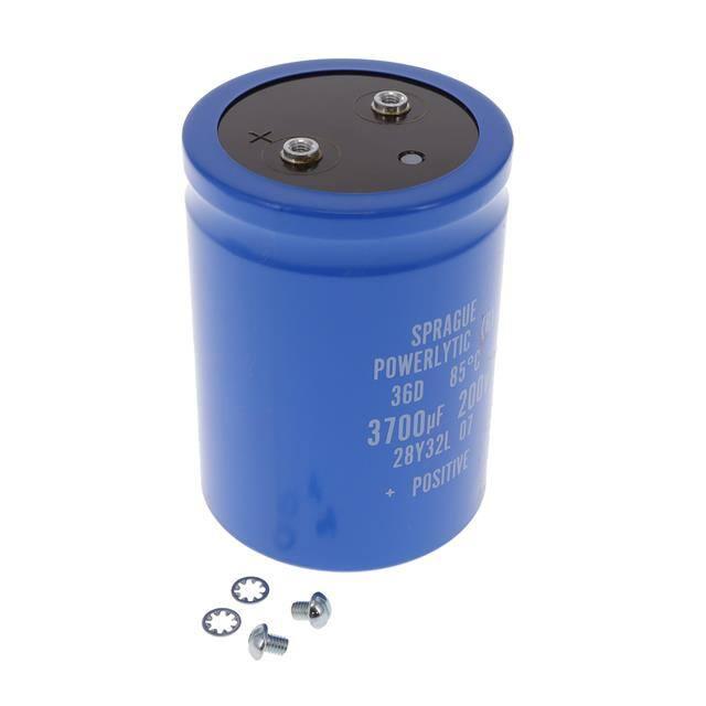

    TFUNK(威世)
    螺栓,D78.2xL108mm
    3700 µF 200 V 铝电解电容器 径向,Can - 螺丝端子 85°C 时为 1000 小时
36D372F200DC2A 数据手册
36D, 36DE, 36DX www.vishay.com Vishay Sprague Aluminum Capacitors Powerlytic™, Large Can FEATURES • • • • • • Useful life: 1000 h at +85 °C High capacitance per case size High ripple current Low leakage current Long shelf life and operating life Type 36D ratings recommended for replacement applications only. For new designs, see type 36DY • Screw terminal • Material categorization: for definitions of compliance please see www.vishay.com/doc?99912 QUICK REFERENCE DATA DESCRIPTION VALUE Nominal case size  Ø D x L in inches (mm) 1.453 x 2.250 (36.9 x 57.2) to 3.078 x 8.750 (78.2 x 222.3) Operating temperature -40 °C to +85 °C (36DX) -40 °C to +95 °C (36DE) Rated capacitance range, CR 190 μF to 50 000 μF +75 %, -10 % (10 WVDC to 100 WVDC) +50 %, -10 % (200 WVDC to 450 WVDC) Tolerance on CR Rated voltage range, UR 10 WVDC to 450 WVDC 1000 h: CAP ± 15 % from initial measurement. ESR 1.5 x initial specified limit Life validation test at 85 °C 36D DC leakage current 36DE, 36DX I = k CV I in μA, C in μF, V in Volts k = 6.0 at +25 °C, k = 36 at +65 °C, k = 50 at +85 °C k = 4.0 at +25 °C, k = 32 at +85 °C DIMENSIONS in inches (millimeters) LARGE CAN CAPACITORS CASE CODE NOMINAL D ± 0.032 (0.8) L ± 0.063 (1.6) WITH INSULATION SLEEVE D (Max.) L (Max.) P TERMINAL H (Max.) TERMINAL SPACING M ± 0.016 (0.4) TYPICAL WEIGHT (g) AN 1.375 (35.0) 1.625 (41.0) 1.453 (36.9) 1.750 (44.5) 1.849 (47.0) 0.500 (12.7) 43.0 AY 1.375 (35.0) 1.875 (48.0) 1.453 (36.9) 2.000 (50.8) 1.099 (53.3) 0.500 (12.7) 54.0 AA 1.375 (35.0) 2.125 (54.0) 1.453 (36.9) 2.250 (57.2) 1.349 (59.7) 0.500 (12.7) 63.0 AM 1.375 (35.0) 2.625 (67.0) 1.453 (36.9) 2.750 (69.9) 1.849 (72.4) 0.500 (12.7) 82.0 AB 1.375 (35.0) 3.125 (79.0) 1.453 (36.9) 3.250 (82.6) 1.349 (85.1) 0.500 (12.7) 105.0 AL 1.375 (35.0) 3.625 (92.0) 1.453 (36.9) 3.750 (95.3) 1.849 (97.8) 0.500 (12.7) 122.0 AC 1.375 (35.0) 4.125 (105.0) 1.453 (36.9) 4.250 (108.0) 1.349 (110.5) 0.500 (12.7) 129.0 AD 1.375 (35.0) 4.625 (117.0) 1.453 (36.9) 4.750 (120.7) 1.849 (123.2) 0.500 (12.7) 162.0 AE 1.375 (35.0) 5.125 (130.0) 1.453 (36.9) 5.250 (133.4) 1.349 (125.9) 0.500 (12.7) 179.0 AF 1.375 (35.0) 5.625 (143.0) 1.453 (36.9) 5.750 (146.1) 1.849 (148.6) 0.500 (12.7) 201.0 EN 1.750 (44.0) 1.625 (41.0) 1.828 (46.4) 1.750 (44.5) 1.849 (47.0) 0.750 (19.1) 71.0 EA 1.750 (44.0) 2.125 (54.0) 1.828 (46.4) 2.250 (57.2) 2.349 (59.7) 0.750 (19.1) 102.0 EM 1.750 (44.0) 2.625 (67.0) 1.828 (46.4) 2.750 (69.9) 2.849 (72.4) 0.750 (19.1) 133.0 EB 1.750 (44.0) 3.125 (79.0) 1.828 (46.4) 3.250 (82.6) 3.349 (85.1) 0.750 (19.1) 167.0 EL 1.750 (44.0) 3.625 (92.0) 1.828 (46.4) 3.750 (95.3) 3.849 (97.8) 0.750 (19.1) 198.0 EC 1.750 (44.0) 4.125 (105.0) 1.828 (46.4) 4.250 (108.0) 4.349 (110.5) 0.750 (19.1) 230.0 ED 1.750 (44.0) 4.625 (117.0) 1.828 (46.4) 4.750 (120.7) 4.849 (123.2) 0.750 (19.1) 252.0 Revision: 20-Jul-16 Document Number: 42066 1 For technical questions, contact: aluminumcaps4@vishay.com THIS DOCUMENT IS SUBJECT TO CHANGE WITHOUT NOTICE. THE PRODUCTS DESCRIBED HEREIN AND THIS DOCUMENT ARE SUBJECT TO SPECIFIC DISCLAIMERS, SET FORTH AT www.vishay.com/doc?91000 36D, 36DE, 36DX www.vishay.com Vishay Sprague DIMENSIONS in inches (millimeters) LARGE CAN CAPACITORS NOMINAL CASE CODE D ± 0.032 (0.8) WITH INSULATION SLEEVE L ± 0.063 (1.6) D (Max.) L (Max.) P TERMINAL H (Max.) TERMINAL SPACING M ± 0.016 (0.4) TYPICAL WEIGHT (g) 269.0 EE 1.750 (44.0) 5.125 (130.0) 1.828 (46.4) 5.250 (133.4) 5.349 (135.9) 0.750 (19.1) EF 1.750 (44.0) 5.625 (143.0) 1.828 (46.4) 5.750 (146.1) 5.849 (148.6) 0.750 (19.1) 318.0 BY 2.000 (51.0) 1.875 (48.0) 2.078 (52.8) 2.000 (50.8) 2.099 (53.3) 0.875 (22.2) 113.0 BA 2.000 (51.0) 2.125 (54.0) 2.078 (52.8) 2.250 (57.2) 2.349 (59.7) 0.875 (22.2) 133.0 BM 2.000 (51.0) 2.625 (67.0) 2.078 (52.8) 2.750 (69.9) 2.849 (72.4) 0.875 (22.2) 176.0 BB 2.000 (51.0) 3.125 (79.0) 2.078 (52.8) 3.250 (82.6) 3.349 (85.1) 0.875 (22.2) 213.0 BL 2.000 (51.0) 3.625 (92.0) 2.078 (52.8) 3.750 (95.3) 3.849 (97.8) 0.875 (22.2) 261.0 BC 2.000 (51.0) 4.125 (105.0) 2.078 (52.8) 4.250 (108.0) 4.349 (110.5) 0.875 (22.2) 381.0 BD 2.000 (51.0) 4.625 (117.0) 2.078 (52.8) 4.750 (120.7) 4.849 (123.2) 0.875 (22.2) 326.0 BE 2.000 (51.0) 5.125 (130.0) 2.078 (52.8) 5.250 (133.4) 5.349 (135.9) 0.875 (22.2) 337.0 BF 2.000 (51.0) 5.625 (143.0) 2.078 (52.8) 5.750 (146.1) 5.849 (148.6) 0.875 (22.2) 408.0 CB 2.500 (64.0) 3.125 (79.0) 2.578 (65.5) 3.250 (82.6) n/a 1.125 (28.6) 329.0 CL 2.500 (64.0) 3.625 (92.0) 2.578 (65.5) 3.750 (95.3) n/a 1.125 (28.6) 400.0 CC 2.500 (64.0) 4.125 (105.0) 2.578 (65.5) 4.250 (108.0) n/a 1.125 (28.6) 473.0 CD 2.500 (64.0) 4.625 (117.0) 2.578 (65.5) 4.750 (120.7) n/a 1.125 (28.6) 562.0 CE 2.500 (64.0) 5.125 (130.0) 2.578 (65.5) 5.250 (133.4) n/a 1.125 (28.6) 607.0 675.0 CF 2.500 (64.0) 5.625 (143.0) 2.578 (65.5) 5.750 (146.1) n/a 1.125 (28.6) DB 3.000 (76.0) 3.125 (79.0) 3.078 (78.2) 3.250 (82.6) n/a 1.250 (31.8) 496.0 DL 3.000 (76.0) 3.625 (92.0) 3.078 (78.2) 3.750 (95.3) n/a 1.250 (31.8) 598.0 DC 3.000 (76.0) 4.125 (105.0) 3.078 (78.2) 4.250 (108.0) n/a 1.250 (31.8) 700.0 DD 3.000 (76.0) 4.625 (117.0) 3.078 (78.2) 4.750 (120.7) n/a 1.250 (31.8) 802.0 DE 3.000 (76.0) 5.125 (130.0) 3.078 (78.2) 5.250 (133.4) n/a 1.250 (31.8) 944.0 DF 3.000 (76.0) 5.625 (143.0) 3.078 (78.2) 5.750 (146.1) n/a 1.250 (31.8) 1004.0 DJ 3.000 (76.0) 8.625 (219.0) 3.078 (78.2) 8.750 (222.3) n/a 1.250 (31.8) 1403.0 DIMENSIONS in inches (millimeters) BRACKETS (RoHS-COMPLIANT) TYPE PART NUMBER A B C FIGURE NUMBER 2 Feet 1245860035A 1.375 (34.9) 1.781 (45.2) 2.218 (56.3) 1 3 Feet 1245860036A 2.000 (50.8) 2.500 (63.5) 2.875 (73.0) 2 3 Feet 1245860037A 2.500 (63.5) 3.000 (76.2) 3.375 (85.7) 2 3 Feet 1245860038A 3.000 (76.2) 3.500 (88.9) 3.875 (98.4) 2 SCREW INSERT TERMINAL DIMENSIONS TERMINAL CODE THREAD THREAD DEPTH HEIGHT J ± 0.032 (0.81) DIAMETER S ± 0.010 (0.25) DIAMETER T ± 0.010 (0.25) NOTES All cases codes A 10-32 NF-28 0.219 (5.6) 0.063 (1.6) 0.313 (8.0) 0.438 (11.1) B 10-32 NF-28 0.375 (9.5) 0.250 (6.4) 0.313 (8.0) 0.438 (11.1) All cases codes D 1/4-28 NF-28 0.344 (8.7) 0.093 (2.4) 0.688 (17.5) - C and D dia. codes only Revision: 20-Jul-16 Document Number: 42066 2 For technical questions, contact: aluminumcaps4@vishay.com THIS DOCUMENT IS SUBJECT TO CHANGE WITHOUT NOTICE. THE PRODUCTS DESCRIBED HEREIN AND THIS DOCUMENT ARE SUBJECT TO SPECIFIC DISCLAIMERS, SET FORTH AT www.vishay.com/doc?91000 36D, 36DE, 36DX www.vishay.com Vishay Sprague DIMENSIONS AND AVAILABLE FORMS SCREW INSERT TERMINALS M S T J L Nom. PVC sleeve L Max. Vent M D Nom. Insulation disc D Max. LARGE CAN BRACKETS B B 0.187 [4.8] 0.25 [6.3] A 30° 0.375 [9.5] 30° 0.218 [5.5] 0.125 [3.2] 0.312 [7.9] 0.250 [6.3] 0.281 [7.1] 30° 15° A 0.406 [10.3] 0.406 [10.3] 0.125 [3.2] C 0.176 [4.5] 2 holes 0.149 [3.8] dia. 0.562 [14.3] 0.035 [0.9] 0.500 [12.7] 0.156 [4.0] 0.750 [19.1] 0.125 [28.6] 0.750 [19.1] 0.281 [7.1] 0.375 [9.5] 0.035 [0.9] C 2 holes 0.201 [5.1] dia. ORDERING EXAMPLE Electrolytic capacitor 36DX series: 36DX 392 G 075 BB 2 A DESCRIPTION CODE 36DX 392 G 075 BB 2 A Revision: 20-Jul-16 EXPLANATION Product type Capacitance value (3900 μF) Tolerance (G = -10 % / +75 %; F = -10 % / +50 %) Voltage rating at 85 °C (75 V) Can size (see dimensions table) PVC insulating sleeve Terminal code (low insert 10-32 screw thread) Document Number: 42066 3 For technical questions, contact: aluminumcaps4@vishay.com THIS DOCUMENT IS SUBJECT TO CHANGE WITHOUT NOTICE. THE PRODUCTS DESCRIBED HEREIN AND THIS DOCUMENT ARE SUBJECT TO SPECIFIC DISCLAIMERS, SET FORTH AT www.vishay.com/doc?91000 36D, 36DE, 36DX www.vishay.com Vishay Sprague ELECTRICAL DATA AND ORDERING INFORMATION (original / improved ratings) CAPACITANCE (μF) CASE CODE PART NUMBER TYPE 36D 15 VDC AT +85 °C, SURGE = 18 V 13 000 AC 36D133G015AC2A 25 VDC AT +85 °C, SURGE = 30 V 2700 AA 36D272G025AA2A 5500 AB 36D552G025AB2A 40 VDC AT +85 °C, SURGE = 50 V 5500 AC 36D552G040AC2A 8400 BB 36D842G040BB2A BC 36D123G040BC2A 12 000 50 VDC AT +85 °C, SURGE = 65 V 1300 AA 36D132G050AA2A 2600 AB 36D262G050AB2A 3900 AC 36D392G050AC2A 5200 AE 36D522G050AE2A 6000 BB 36D602G050BB2A 9000 BC 36D902G050BC2A 15 000 CC 36D153G050CC2A 75 VDC AT +85 °C, SURGE = 95 V 3900 BB 36D392G075BB2A 10 000 CC 36D103G075CC2A 350 VDC AT +85 °C, SURGE = 400 V 190 AB 36D191F350AB2A TYPE 36DE 10 VDC AT +85 °C, SURGE = 12 V 23 000 AA 36DE233G010AA2A 25 VDC AT +85 °C, SURGE = 30 V 40 000 BB 36DE403G025BB2A 40 VDC AT +85 °C, SURGE = 50 V 24 000 BB 36DE243G040BB2A TYPE 36DX 15 VDC AT +85 °C, SURGE = 18 V 7500 AA 36DX752G015AA2A 15 000 AB 36DX153G015AB2A 22 000 AC 36DX223G015AC2A 34 000 AF 36DX343G015AF2a 50 000 BC 36DX503G015BC2A 25 VDC AT +85 °C, SURGE = 30 V Revision: 20-Jul-16 4500 AA 36DX452G025AA2A 9000 AB 36DX902G025AB2A 13 000 AC 36DX133G025AC2A 20 000 AF 36DX203G025AF2A 30 000 BC 36DX303G025BC2A 50 000 CC 36DX503G025CC2A Document Number: 42066 4 For technical questions, contact: aluminumcaps4@vishay.com THIS DOCUMENT IS SUBJECT TO CHANGE WITHOUT NOTICE. THE PRODUCTS DESCRIBED HEREIN AND THIS DOCUMENT ARE SUBJECT TO SPECIFIC DISCLAIMERS, SET FORTH AT www.vishay.com/doc?91000 36D, 36DE, 36DX www.vishay.com Vishay Sprague ELECTRICAL DATA AND ORDERING INFORMATION (original / improved ratings) CAPACITANCE (μF) CASE CODE PART NUMBER TYPE 36DX 30 VDC AT +85 °C, SURGE = 40 V 4000 AA 36DX402G030AA2A 36DX802G030AB2A 8000 AB 18 000 AF 36DX183G030AF2A 26 000 BC 36DX263G030BC2A 40 VDC AT +85 °C, SURGE = 50 V 2900 AA 36DX292G040AA2A 5800 AB 36DX582G040AB2A 8700 AC 36DX872G040AC2A 20 000 BC 36DX203G040BC2A CC 36DX343G040CC2A 34 000 50 VDC AT +85 °C, SURGE = 65 V 2400 AA 36DX242G050AA2A 4800 AB 36DX482G050AB2A 36DX722G050AC2A 7200 AC 11 000 AF 36DX113G050AF2A 16 000 BC 36DX163G050BC2A 24 000 BF 36DX243G050BF2A 40 000 CF 36DX403G050CF2A 41 000 DC 36DX413G050DC2A 75 VDC AT +85 °C, SURGE = 95 V 1400 AA 36DX142G075AA2A 4200 AC 36DX422G075AC2A 10 000 BC 36DX103G075BC2A 17 000 CC 36DX173G075CC2A 100 VDC AT +85 °C, SURGE = 125 V 1700 AB 36DX172G100AB2A 200 VDC AT +85 °C, SURGE = 250 V 850 AC 36DX851F200AC2A 2000 BC 36DX202F200BC2A 2800 BC 36DX282F200BC2A 3400 CC 36DX342F200CC2A DF 36DX742F200DF2A 7400 250 VDC AT +85 °C, SURGE = 300 V 500 AB 36DX501F250AB2A 10 000 DJ 36DX103F250DJ2A 350 VDC AT +85 °C, SURGE = 400 V 3100 DF 36DX312F350DF2A 3300 DF 36DX332F350DF2A 5100 DJ 36DX512F350DJ2A 450 VDC AT +85 °C, SURGE = 525 V 230 AC 36Dx231F450AC2A 2000 DF 36DX202F450DF2A 3100 DJ 36DX312F450DJ2A 3500 DJ 36DX352F450DJ2A   Statements about product lifetime are based on calculations and internal testing. They should only be interpreted as estimations. Also due to external factors, the lifetime in the field application may deviate from the calculated lifetime. In general, nothing stated herein shall be construed as a guarantee of durability. Revision: 20-Jul-16 Document Number: 42066 5 For technical questions, contact: aluminumcaps4@vishay.com THIS DOCUMENT IS SUBJECT TO CHANGE WITHOUT NOTICE. THE PRODUCTS DESCRIBED HEREIN AND THIS DOCUMENT ARE SUBJECT TO SPECIFIC DISCLAIMERS, SET FORTH AT www.vishay.com/doc?91000 Legal Disclaimer Notice www.vishay.com Vishay Disclaimer  ALL PRODUCT, PRODUCT SPECIFICATIONS AND DATA ARE SUBJECT TO CHANGE WITHOUT NOTICE TO IMPROVE RELIABILITY, FUNCTION OR DESIGN OR OTHERWISE. Vishay Intertechnology, Inc., its affiliates, agents, and employees, and all persons acting on its or their behalf (collectively, “Vishay”), disclaim any and all liability for any errors, inaccuracies or incompleteness contained in any datasheet or in any other disclosure relating to any product. Vishay makes no warranty, representation or guarantee regarding the suitability of the products for any particular purpose or the continuing production of any product. To the maximum extent permitted by applicable law, Vishay disclaims (i) any and all liability arising out of the application or use of any product, (ii) any and all liability, including without limitation special, consequential or incidental damages, and (iii) any and all implied warranties, including warranties of fitness for particular purpose, non-infringement and merchantability. Statements regarding the suitability of products for certain types of applications are based on Vishay’s knowledge of typical requirements that are often placed on Vishay products in generic applications. Such statements are not binding statements about the suitability of products for a particular application. It is the customer’s responsibility to validate that a particular product with the properties described in the product specification is suitable for use in a particular application. Parameters provided in datasheets and / or specifications may vary in different applications and performance may vary over time. All operating parameters, including typical parameters, must be validated for each customer application by the customer’s technical experts. Product specifications do not expand or otherwise modify Vishay’s terms and conditions of purchase, including but not limited to the warranty expressed therein. Except as expressly indicated in writing, Vishay products are not designed for use in medical, life-saving, or life-sustaining applications or for any other application in which the failure of the Vishay product could result in personal injury or death. Customers using or selling Vishay products not expressly indicated for use in such applications do so at their own risk. Please contact authorized Vishay personnel to obtain written terms and conditions regarding products designed for such applications. No license, express or implied, by estoppel or otherwise, to any intellectual property rights is granted by this document or by any conduct of Vishay. Product names and markings noted herein may be trademarks of their respective owners. © 2017 VISHAY INTERTECHNOLOGY, INC. ALL RIGHTS RESERVED Revision: 08-Feb-17 1 Document Number: 91000
