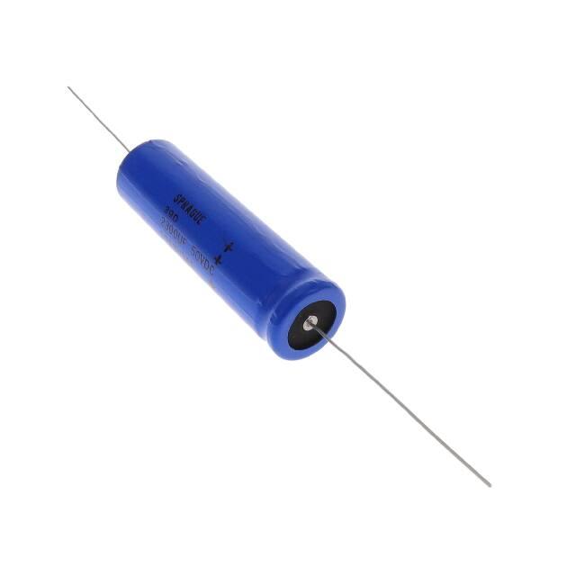

39D www.vishay.com Vishay Sprague Aluminum Capacitors +85 °C, Powerlytic™ Electrolytics FEATURES • Designed for applications requiring greatest possible capacitance in small physical case sizes • Supplement original Type 36D can-type capacitors, offering lower capacitance values in smaller sizes with axial leads QUICK REFERENCE DATA DESCRIPTION VALUE Operating temperature -20 °C to +85 °C Tolerance on CR: 3 WVDC to 75 WVDC 100 WVDC to 450 WVDC +75 %, -10 % +50 %, -10 % • Welds at all critical anode and cathode terminals eliminate riveted or pressure connections to assure freedom from open circuits even when operated in the microvolt or millivolt signal range • Improved molded phenolic and seals Dissipation Factor: 3 WVDC and 6 WVDC 230 % 10 WVDC and 15 WVDC 150 % 25 WVDC and 30 WVDC 60 % 40 WVDC and 50 WVDC 45 % 75 WVDC and 100 WVDC 30 % 150 WVDC to 450 WVDC • Pressure-sensitive safety vent • Service life of 10 years or more in normal circuit applications 18 % 20 to 3140 maximum amperes rms at 120 Hz and +85 °C, depending upon capacitance Ripple current Available Useful life at 85 °C 500 h DC leakage current (after 5 min charge) I = k CV k = 6.0 at +25 °C; k = 36.0 at +85 °C I in μA, C in μF, V in Volts • Capacitors listed have outer plastic-film insulation. For bare case, change last character of part number from 6 to 0 and subtract 0.062" [1.575 mm] from diameter and 0.125" [3.175 mm] from length • Axial lead • Material categorization: for definitions of compliance please see www.vishay.com/doc?99912 DIMENSIONS in inches [millimeters] CASE CODE D L ± 0.020 [0.51] ± 0.062 [1.58] EE 0.510 [13.0] 1.141 [29.0] GJ EJ 0.510 [13.0] 1.641 [41.7] GL CASE CODE D L ± 0.020 [0.51] ± 0.062 [1.58] CASE CODE D L ± 0.020 [0.51] ± 0.062 [1.58] 0.760 [19.3] 1.641 [41.7] JE 1.010 [25.7] 1.141 [29.0] 0.760 [19.3] 2.141 [54.4] JJ 1.010 [25.7] 1.641 [41.7] 2.141 [54.4] EL 0.510 [13.0] 2.141 [54.4] GP 0.760 [19.3] 2.641 [67.1] JL 1.010 [25.7] FE 0.635 [16.1] 1.141 [29.0] HE 0.885 [22.5] 1.141 [29.0] JP 1.010 [25.7] 2.641 [67.1] FJ 0.635 [16.1] 1.641 [41.7] HJ 0.885 [22.5] 1.641 [41.7] JS 1.010 [25.7] 3.141 [79.8] 3.641 [92.5] FL 0.635 [16.1] 2.141 [54.4] HL 0.885 [22.5] 2.141 [54.4] JT 1.010 [25.7] FP 0.635 [16.1] 2.641 [67.1] HP 0.885 [22.5] 2.641 [67.1] - - - GE 0.760 [19.3] 1.141 [29.0] HS 0.885 [22.5] 3.141 [79.8] - - - DIMENSIONS AND AVAILABLE FORMS L CL D 2.50 [63.50] min. PVC sleeve 2.50 [63.50] min. Tinned copper leads No. 20 AWG (0.032" [0.813] Dia.) for D = 0.510" [13.0] and D = 0.635" [16.1] No. 18 AWG (0.040" [1.016] Dia.) for D = 0.760" [19.3] and up Revision: 29-Sep-16 Document Number: 42036 1 For technical questions, contact: aluminumcaps4@vishay.com THIS DOCUMENT IS SUBJECT TO CHANGE WITHOUT NOTICE. THE PRODUCTS DESCRIBED HEREIN AND THIS DOCUMENT ARE SUBJECT TO SPECIFIC DISCLAIMERS, SET FORTH AT www.vishay.com/doc?91000 39D www.vishay.com Vishay Sprague ORDERING EXAMPLE Electrolytic capacitor 39D series: 39D 907 G 003 EJ 6 DESCRIPTION CODE 39D 907 G 003 EJ 6 EXPLANATION Product type Capacitance value (900 μF) Tolerance (G = -10 % / +75 %; F = -10 % / +50 %) Voltage rating at 85 °C (003 = 3 V) Can size (See Dimensions table) Sleeve and sealing (6 = P.V.C. sleeve) Note • For lead (Pb)-free / RoHS compliant products add suffix “E3” to part number. Example: 39D907G003EJ6E3 ELECTRICAL DATA AND ORDERING INFORMATION CAPACITANCE (μF) 400 900 1300 1400 1800 2100 2700 2900 3000 3600 4200 4300 5700 6000 8500 9000 10 000 12 000 15 000 18 000 300 600 900 1000 1200 1500 1900 2000 2100 2500 3000 4000 4200 6000 6300 7500 8500 10 000 12 000 Revision: 29-Sep-16 CASE CODE 3 WVDC AT +85 °C, SURGE = 4 V EE EJ EL GE FJ HE FL GJ JE FP HJ GL GP JJ HP JL HS JP JS JT 6 WVDC AT +85 °C, SURGE = 8 V EE EJ EL GE FJ HE FL GJ JE FP GL GP JJ HP JL HS JP JS JT PART NUMBER 39D407G003EE6 39D907G003EJ6 39D138G003EL6 39D148G003GE6 39D188G003FJ6 39D218G003HE6 39D278G003FL6 39D298G003GJ6 39D308G003JE6 39D368G003FP6 39D428G003HJ6 39D438G003GL6 39D578G003GP6 39D608G003JJ6 39D858G003HP6 39D908G003JL6 39D109G003HS6 39D129G003JP6 39D159G003JS6 39D189G003JT6 39D307G006EE6 39D607G006EJ6 39D907G006EL6 39D108G006GE6 39D128G006FJ6 39D158G006HE6 39D198G006FL6 39D208G006GJ6 39D218G006JE6 39D258G006FP6 39D308G006GL6 39D408G006GP6 39D428G006JJ6 39D608G006HP6 39D638G006JL6 39D758G006HS6 39D858G006JP6 39D109G006JS6 39D129G006JT6 Document Number: 42036 2 For technical questions, contact: aluminumcaps4@vishay.com THIS DOCUMENT IS SUBJECT TO CHANGE WITHOUT NOTICE. THE PRODUCTS DESCRIBED HEREIN AND THIS DOCUMENT ARE SUBJECT TO SPECIFIC DISCLAIMERS, SET FORTH AT www.vishay.com/doc?91000 39D www.vishay.com Vishay Sprague ELECTRICAL DATA AND ORDERING INFORMATION CAPACITANCE (μF) 250 500 800 850 1000 1200 1600 1700 2100 2500 3400 3500 5000 5200 6300 7100 8800 10 000 200 400 600 800 950 1200 1300 1600 1900 2500 2600 3800 4000 4700 5300 6600 8000 100 200 350 450 500 700 750 800 950 1000 1100 1500 1600 1700 2200 2400 2800 3200 4000 4700 Revision: 29-Sep-16 CASE CODE 10 WVDC AT +85 °C, SURGE = 12 V EE EJ EL GE FJ HE FL GJ FP GL GP JJ HP JL HS JP JS JT 15 WVDC AT +85 °C, SURGE = 18 V EE EJ EL FJ HE FL GJ FP GL GP JJ HP JL HS JP JS JT 25 WVDC AT +85 °C, SURGE = 30 V EE EJ EL FJ HE FL GJ JE FP GL HJ GP JJ HL HP JL HS JP JS JT PART NUMBER 39D257G010EE6 39D507G010EJ6 39D807G010EL6 39D857G010GE6 39D108G010FJ6 39D128G010HE6 39D168G010FL6 39D178G010GJ6 39D218G010FP6 39D258G010GL6 39D348G010GP6 39D358G010JJ6 39D508G010HP6 39D528G010JL6 39D638G010HS6 39D718G010JP6 39D888G010JS6 39D109G010JT6 39D207G015EE6 39D407G015EJ6 39D607G015EL6 39D807G015FJ6 39D957G015HE6 39D128G015FL6 39D138G015GJ6 39D168G015FP6 39D198G015GL6 39D258G015GP6 39D268G015JJ6 39D388G015HP6 39D408G015JL6 39D478G015HS6 39D538G015JP6 39D668G015JS6 39D808G015JT6 39D107G025EE6 39D207G025EJ6 39D357G025EL6 39D457G025FJ6 39D507G025HE6 39D707G025FL6 39D757G025GJ6 39D807G025JE6 39D957G025FP6 39D108G025GL6 39D118G025HJ6 39D158G025GP6 39D168G025JJ6 39D178G025HL6 39D228G025HP6 39D248G025JL6 39D288G025HS6 39D328G025JP6 39D408G025JS6 39D478G025JT6 Document Number: 42036 3 For technical questions, contact: aluminumcaps4@vishay.com THIS DOCUMENT IS SUBJECT TO CHANGE WITHOUT NOTICE. THE PRODUCTS DESCRIBED HEREIN AND THIS DOCUMENT ARE SUBJECT TO SPECIFIC DISCLAIMERS, SET FORTH AT www.vishay.com/doc?91000 39D www.vishay.com Vishay Sprague ELECTRICAL DATA AND ORDERING INFORMATION CAPACITANCE (μF) 75 150 250 350 400 500 600 700 850 1100 1200 1700 1800 2100 2400 3000 3600 75 150 200 250 300 350 450 500 600 750 1000 1100 1500 1600 1900 2100 2600 3200 50 100 150 200 250 350 450 500 700 750 800 1100 1300 1500 1900 2300 Revision: 29-Sep-16 CASE CODE 30 WVDC AT +85 °C, SURGE = 40 V EE EJ EL FJ HE FL JE FP GL GP HL HP JL HS JP JS JT 40 WVDC AT +85 °C, SURGE = 50 V EE EJ EL GE FJ HE FL GJ FP GL GP HL HP JL HS JP JS JT 50 WVDC AT +85 °C, SURGE = 65 V EE EJ EL FJ HE FL FP GL GP JJ HL HP HS JP JS JT PART NUMBER 39D756G030EE6 39D157G030EJ6 39D257G030EL6 39D357G030FJ6 39D407G030HE6 39D507G030FL6 39D607G030JE6 39D707G030FP6 39D857G030GL6 39D118G030GP6 39D128G030HL6 39D178G030HP6 39D188G030JL6 39D218G030HS6 39D248G030JP6 39D308G030JS6 39D368G030JT6 39D756G040EE6 39D157G040EJ6 39D207G040EL6 39D257G040GE6 39D307G040FJ6 39D357G040HE6 39D457G040FL6 39D507G040GJ6 39D607G040FP6 39D757G040GL6 39D108G040GP6 39D118G040HL6 39D158G040HP6 39D168G040JL6 39D198G040HS6 39D218G040JP6 39D268G040JS6 39D328G040JT6 39D506G050EE6 39D107G050EJ6 39D157G050EL6 39D207G050FJ6 39D257G050HE6 39D357G050FL6 39D457G050FP6 39D507G050GL6 39D707G050GP6 39D757G050JJ6 39D807G050HL6 39D118G050HP6 39D138G050HS6 39D158G050JP6 39D198G050JS6 39D238G050JT6 Document Number: 42036 4 For technical questions, contact: aluminumcaps4@vishay.com THIS DOCUMENT IS SUBJECT TO CHANGE WITHOUT NOTICE. THE PRODUCTS DESCRIBED HEREIN AND THIS DOCUMENT ARE SUBJECT TO SPECIFIC DISCLAIMERS, SET FORTH AT www.vishay.com/doc?91000 39D www.vishay.com Vishay Sprague ELECTRICAL DATA AND ORDERING INFORMATION CAPACITANCE (μF) 30 75 100 150 200 250 300 350 450 500 700 750 850 1000 1200 1500 15 35 55 60 75 90 110 120 130 150 180 190 250 260 280 370 390 460 520 650 780 10 25 40 50 60 80 85 88 100 120 170 190 250 260 310 350 440 530 Revision: 29-Sep-16 CASE CODE 75 WVDC AT +85 °C, SURGE = 95 V EE EJ EL FJ FL JE FP GL GP HL HP JL HS JP JS JT 100 WVDC AT +85 °C, SURGE = 125 V EE EJ EL GE FJ HE FL GJ JE FP HJ GL GP JJ HL HP JL HS JP JS JT 150 WVDC AT +85 °C, SURGE = 175 V EE EJ EL FJ HE FL GJ JE FP GL GP HL HP JL HS JP JS JT PART NUMBER 39D306G075EE6 39D756G075EJ6 39D107G075EL6 39D157G075FJ6 39D207G075FL6 39D257G075JE6 39D307G075FP6 39D357G075GL6 39D457G075GP6 39D507G075HL6 39D707G075HP6 39D757G075JL6 39D857G075HS6 39D108G075JP6 39D128G075JS6 39D158G075JT6 39D156F100EE6 39D356F100EJ6 39D556F100EL6 39D606F100GE6 39D756F100FJ6 39D906F100HE6 39D117F100FL6 39D127F100GJ6 39D137F100JE6 39D157F100FP6 39D187F100HJ6 39D197F100GL6 39D257F100GP6 39D267F100JJ6 39D287F100HL6 39D377F100HP6 39D397F100JL6 39D467F100HS6 39D527F100JP6 39D657F100JS6 39D787F100JT6 39D106F150EE6 39D256F150EJ6 39D406F150EL6 39D506F150FJ6 39D606F150HE6 39D806F150FL6 39D856F150GJ6 39D886F150JE6 39D107F150FP6 39D127F150GL6 39D177F150GP6 39D197F150HL6 39D257F150HP6 39D267F150JL6 39D317F150HS6 39D357F150JP6 39D447F150JS6 39D537F150JT4 Document Number: 42036 5 For technical questions, contact: aluminumcaps4@vishay.com THIS DOCUMENT IS SUBJECT TO CHANGE WITHOUT NOTICE. THE PRODUCTS DESCRIBED HEREIN AND THIS DOCUMENT ARE SUBJECT TO SPECIFIC DISCLAIMERS, SET FORTH AT www.vishay.com/doc?91000 39D www.vishay.com Vishay Sprague ELECTRICAL DATA AND ORDERING INFORMATION CAPACITANCE (μF) 9 15 25 30 35 40 55 60 75 80 90 120 130 170 180 220 250 310 370 7 15 20 30 35 45 50 60 70 95 100 140 150 180 200 250 300 5 10 15 20 25 30 40 50 65 75 100 120 130 170 200 Revision: 29-Sep-16 CASE CODE 200 WVDC AT +85 °C, SURGE = 250 V EE EJ EL GE FJ HE FL GJ FP HJ GL GP HL HP JL HS JP JS JT 250 WVDC AT +85 °C, SURGE = 300 V EE EJ EL FJ HE FL JE FP GL GP HL HP JL HS JP JS JT 300 WVDC AT +85 °C, SURGE = 350 V EE EJ EL FJ HE FL FP GL GP HL HP HS JP JS JT PART NUMBER 39D905F200EE6 39D156F200EJ6 39D256F200EL6 39D306F200GE6 39D356F200FJ6 39D406F200HE6 39D556F200FL6 39D606F200GJ6 39D756F200FP6 39D806F200HJ6 39D906F200GL6 39D127F200GP6 39D137F200HL6 39D177F200HP6 39D187F200JL6 39D227F200HS6 39D257F200JP6 39D317F200JS6 39D377F200JT6 39D705F250EE6 39D156F250EJ6 39D206F250EL6 39D306F250FJ6 39D356F250HE6 39D456F250FL6 39D506F250JE6 39D606F250FP6 39D706F250GL6 39D956F250GP6 39D107F250HL6 39D147F250HP6 39D157F250JL6 39D187F250HS6 39D207F250JP6 39D257F250JS6 39D307F250JT6 39D505F300EE6 39D106F300EJ6 39D156F300EL6 39D206F300FJ6 39D256F300HE6 39D306F300FL6 39D406F300FP6 39D506F300GL6 39D656F300GP6 39D756F300HL6 39D107F300HP6 39D127F300HS6 39D137F300JP6 39D177F300JS6 39D207F300JT6 Document Number: 42036 6 For technical questions, contact: aluminumcaps4@vishay.com THIS DOCUMENT IS SUBJECT TO CHANGE WITHOUT NOTICE. THE PRODUCTS DESCRIBED HEREIN AND THIS DOCUMENT ARE SUBJECT TO SPECIFIC DISCLAIMERS, SET FORTH AT www.vishay.com/doc?91000 39D www.vishay.com Vishay Sprague ELECTRICAL DATA AND ORDERING INFORMATION CAPACITANCE (μF) CASE CODE 350 WVDC AT +85 °C, SURGE = 400 V PART NUMBER 4 EE 39D405F350EE6 8 EJ 39D805F350EJ6 12 EL 39D126F350EL6 15 FJ 39D156F350FJ6 20 FL 39D206F350FL6 25 GJ 39D256F350GJ6 30 FP 39D306F350FP6 40 GL 39D406F350GL6 50 GP 39D506F350GP6 60 HL 39D606F350HL6 80 HP 39D806F350HP6 100 HS 39D107F350HS6 110 JP 39D117F350JP6 130 JS 39D137F350JS6 160 JT 39D167F350JT6 400 WVDC AT +85 °C, SURGE = 475 V 2 EE 39D205F400EE6 5 EJ 39D505F400EJ6 10 FJ 39D106F400FJ6 15 F 39D156F400FL6 20 F 39D206F400FP6 25 GL 39D256F400GL6 35 GP 39D356F400GP6 40 HL 39D406F400HL6 55 HP 39D556F400HP6 65 HS 39D656F400HS6 75 JP 39D756F400JP6 90 JS 39D906F400JS6 110 JT 39D117F400JT6 450 WVDC AT +85 °C, SURGE = 525 V 1 EE 39D105F450EE6 3 EJ 39D305F450EJ6 5 EL 39D505F450EL6 10 FL 39D106F450FL6 15 FP 39D156F450FP6 20 GL 39D206F450GL6 25 GP 39D256F450GP6 35 HP 39D356F450HP6 45 HS 39D456F450HS6 50 JP 39D506F450JP6 65 JS 39D656F450JS6 75 JT 39D756F450JT6        Statements about product lifetime are based on calculations and internal testing. They should only be interpreted as estimations. Also due to external factors, the lifetime in the field application may deviate from the calculated lifetime. In general, nothing stated herein shall be construed as a guarantee of durability. Revision: 29-Sep-16 Document Number: 42036 7 For technical questions, contact: aluminumcaps4@vishay.com THIS DOCUMENT IS SUBJECT TO CHANGE WITHOUT NOTICE. THE PRODUCTS DESCRIBED HEREIN AND THIS DOCUMENT ARE SUBJECT TO SPECIFIC DISCLAIMERS, SET FORTH AT www.vishay.com/doc?91000 Legal Disclaimer Notice www.vishay.com Vishay Disclaimer ALL PRODUCT, PRODUCT SPECIFICATIONS AND DATA ARE SUBJECT TO CHANGE WITHOUT NOTICE TO IMPROVE RELIABILITY, FUNCTION OR DESIGN OR OTHERWISE. Vishay Intertechnology, Inc., its affiliates, agents, and employees, and all persons acting on its or their behalf (collectively, “Vishay”), disclaim any and all liability for any errors, inaccuracies or incompleteness contained in any datasheet or in any other disclosure relating to any product. Vishay makes no warranty, representation or guarantee regarding the suitability of the products for any particular purpose or the continuing production of any product. To the maximum extent permitted by applicable law, Vishay disclaims (i) any and all liability arising out of the application or use of any product, (ii) any and all liability, including without limitation special, consequential or incidental damages, and (iii) any and all implied warranties, including warranties of fitness for particular purpose, non-infringement and merchantability. Statements regarding the suitability of products for certain types of applications are based on Vishay’s knowledge of typical requirements that are often placed on Vishay products in generic applications. Such statements are not binding statements about the suitability of products for a particular application. It is the customer’s responsibility to validate that a particular product with the properties described in the product specification is suitable for use in a particular application. Parameters provided in datasheets and / or specifications may vary in different applications and performance may vary over time. All operating parameters, including typical parameters, must be validated for each customer application by the customer’s technical experts. Product specifications do not expand or otherwise modify Vishay’s terms and conditions of purchase, including but not limited to the warranty expressed therein. Except as expressly indicated in writing, Vishay products are not designed for use in medical, life-saving, or life-sustaining applications or for any other application in which the failure of the Vishay product could result in personal injury or death. Customers using or selling Vishay products not expressly indicated for use in such applications do so at their own risk. Please contact authorized Vishay personnel to obtain written terms and conditions regarding products designed for such applications. No license, express or implied, by estoppel or otherwise, to any intellectual property rights is granted by this document or by any conduct of Vishay. Product names and markings noted herein may be trademarks of their respective owners. © 2021 VISHAY INTERTECHNOLOGY, INC. ALL RIGHTS RESERVED Revision: 01-Jan-2021 1 Document Number: 91000

物料型号:39D系列
器件简介: - 这些电容器设计用于在小尺寸的物理外壳中提供尽可能大的电容。 - 它们补充了原有的36D型罐式电容器,提供更小尺寸的低电容值,并带有轴向引脚。
引脚分配: - 轴向引脚,对于直径为0.510英寸[13.0毫米]和0.635英寸[16.1毫米]的电容器,使用20号AWG(直径0.032英寸[0.813毫米])的镀锡铜线。 - 对于直径0.760英寸[19.3毫米]及以上的电容器,使用18号AWG(直径0.040英寸[1.016毫米])的镀锡铜线。
参数特性: - 工作温度范围:-20°C至+85°C。 - 公差:根据电容值不同,公差在+75%,-10%到+50%,-10%之间。 - 散逸因子:不同电容值有不同的散逸因子,范围从230%至30%。 - 纹波电流:根据电容值,最大纹波电流从20到3140安培rms,取决于电容值,在120赫兹和+85°C下。 - 85°C下有用寿命:500小时。 - 直流漏电流:根据公式I = kCV,k值随温度变化。
功能详解: - 电容器设计用于在微伏或毫伏信号范围内操作,确保没有开路。 - 改进的模塑酚醛树脂和密封,带有压力敏感的安全泄压阀。 - 在正常电路应用中,预期使用寿命超过10年。
应用信息: - 适用于需要在小尺寸封装中提供大电容的应用。
封装信息: - 提供多种尺寸的封装,具体尺寸和可用形式在文档中有详细表格说明。
订购信息: - 提供了详细的订购代码解释和示例,以及如何根据电容值、公差、电压等级、外壳尺寸和密封材料来订购正确的型号。
