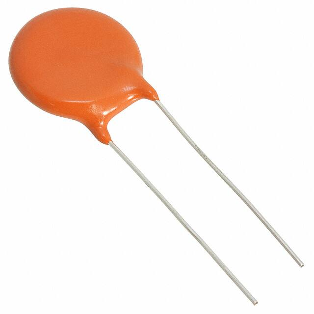

440LD10AP-R 数据手册
440L Series www.vishay.com Vishay Cera-Mite EMI Suppression Capacitor, Ceramic Disc, Class X1, 760 VAC, Class Y1, 500 VAC FEATURES • Complies with IEC 60384-14 • Complies with IEC 60384-14 annex I humidity robustness grade IIIB (highest) • High reliability • Radial leads • High capacitance up to 20 nF • Singlelayer AC disc safety capacitors • Material categorization: for definitions of compliance please see www.vishay.com/doc?99912 APPLICATIONS • • • • • • LINKS TO ADDITIONAL RESOURCES 3D 3D 3D Models Models Related Documents QUICK REFERENCE DATA DESCRIPTION Ceramic dielectric Voltage (VAC) DESIGN VALUE Ceramic class 1 C0G, U2J, P3K, R3L 500 Min. capacitance (pF) 10 Max. capacitance (pF) 47 Mounting X1, Y1 according to IEC 60384-14 Line-to-line filtering (Class X) Line-to-ground filtering (Class Y) Primary and secondary coupling (SMPS) Applications at large temperature and / or high humidity EMI / RFI suppression and filtering 2 C0G, U2J, P3K, R3L X7R, Y5U 760 500 X7R, Y5U 760 68 20 000 Radial The capacitors consist of a ceramic disc of which both sides are silver-plated. Connection leads are made of tinned copper having a diameter of 0.032" (0.81 mm). The capacitors may be supplied with radial kinked or straight leads having a lead spacing of 0.375" (9.5 mm). The standard tolerances are ± 10 % or ± 20 %. Coating is made of flame-retardant epoxy resin in accordance with “UL 94 V-0.” CAPACITANCE RANGE INSULATION RESISTANCE 10 pF to 20 nF Min. 1000 ΩF RATED VOLTAGE TOLERANCE ON CAPACITANCE IEC 60384-14: • X1: 760 VAC, 50 Hz • Y1: 500 VAC, 50 Hz ± 10 %; ± 20 % DISSIPATION FACTOR 2.0 % max. at 1 kHz; 1 V CERAMIC DIELECTRIC C0G, U2J, P3K, R3L (class 1) X7R, Y5U (class 2) CLIMATIC CATEGORY ACC. TO EN 60068-1 25/125/21 OPERATING TEMPERATURE RANGE -30 °C to +125 °C (1) DIELECTRIC STRENGTH BETWEEN LEADS Component test, 100 % test at production line: 4000 VAC, 50 Hz, 2 s As repeated test at customer side admissible only once with: 3600 VAC, 50 Hz, 2 s Random sampling test (destructive test): 4000 VAC, 50 Hz, 60 s DIELECTRIC STRENGTH OF BODY INSULATION 4000 VAC, 50 Hz, 60 s (destructive test) Note (1) For explanation about the difference of operating temperature range and temperature characteristic of capacitance please see www.vishay.com/doc?48299) Revision: 29-Oct-2021 Document Number: 23102 1 For technical questions, contact: ceramitesupport@vishay.com THIS DOCUMENT IS SUBJECT TO CHANGE WITHOUT NOTICE. THE PRODUCTS DESCRIBED HEREIN AND THIS DOCUMENT ARE SUBJECT TO SPECIFIC DISCLAIMERS, SET FORTH AT www.vishay.com/doc?91000 440L Series www.vishay.com Vishay Cera-Mite DIMENSIONS in inches (millimeters) 440LS20-R 1.250 min. (32) Dmax. D max. LS Tinned Copper Leads T max. 0.125 max. (3.2) LO Ø LS 1.625 ± 0.125 (41.3 ± 3.2) Tmax. 0.125 max. (3.2) LO ORDERING INFORMATION, CERAMIC X1 / Y1 CAPACITORS 440L C (pF) C0G 10 U2J 15 P3K 22 R3L 33 47 X7R 68 100 150 220 330 Y5U 470 560 680 1000 1500 2000 2200 2700 2800 3000 3200 3300 3900 4000 4700 5000 5500 5600 6800 8000 9000 10 000 20 000 WIRE SIZE LS LEAD SPACE INCH (mm) ± 1 mm LO LEAD OFFSET INCH (mm) ± 0.5 mm ORDERING CODE 0.032 (0.81) 0.375 (9.5) 0.098 (2.5) 440LQ10-R 20 0.032 (0.81) 0.375 (9.5) 0.110 (2.8) 440LQ15-R 0.190 (4.8) 20 0.032 (0.81) 0.375 (9.5) 0.094 (2.4) 440LQ22-R 0.330 (8.4) 0.330 (8.4) 0.200 (5.1) 0.180 (4.6) 20 20 0.032 (0.81) 0.032 (0.81) 0.375 (9.5) 0.375 (9.5) 0.102 (2.6) 0.083 (2.1) 440LQ33-R 440LQ47-R ± 10 0.330 (8.4) 0.220 (5.6) 0.220 (5.6) 0.235 (6.0) 0.235 (6.0) 0.225 (5.7) 0.375 (9.5) 0.122 (3.1) 0.122 (3.1) 0.138 (3.5) 0.138 (3.5) 0.126 (3.2) 440LQ68-R 440LT10-R 440LT15-R 440LT22-R 440LT33-R ± 20 0.330 (8.4) 0.330 (8.4) 0.330 (8.4) 0.365 (9.3) 0.365 (9.3) 0.400 (10.2) 0.430 (10.9) 0.460 (11.7) 0.460 (11.7) 0.490 (12.4) 0.490 (12.4) 0.490 (12.4) 0.530 (13.5) 0.530 (13.5) 0.620 (15.7) 0.620 (15.7) 0.680 (17.3) 0.680 (17.3) 0.720 (18.3) 0.720 (18.3) 0.790 (20.1) 0.850 (21.6) 0.850 (21.6) 0.230 (5.8) 0.230 (5.8) 0.235 (6.0) 0.225 (5.7) 0.220 (5.6) 0.220 (5.6) 0.225 (5.7) 0.225 (5.7) 0.220 (5.6) 0.225 (5.7) 0.220 (5.6) 0.220 (5.6) 0.220 (5.6) 0.220 (5.6) 0.230 (5.8) 0.225 (5.7) 0.230 (5.8) 0.230 (5.8) 0.235 (6.0) 0.220 (5.6) 0.225 (5.7) 0.230 (5.8) 0.355 (9.0) 0.375 (9.5) 0.130 (3.3) 0.130 (3.3) 0.138 (3.5) 0.126 (3.2) 0.118 (3.0) 0.118 (3.0) 0.126 (3.2) 0.126 (3.2) 0.122 (3.1) 0.126 (3.2) 0.122 (3.1) 0.122 (3.1) 0.118 (3.0) 0.122 (3.1) 0.130 (3.3) 0.126 (3.2) 0.134 (3.4) 0.134 (3.4) 0.138 (3.5) 0.122 (3.1) 0.126 (3.2) 0.134 (3.4) 0.134 (3.4) 440LT47-R 440LT56-R 440LT68-R 440LD10-R 440LD15-R 440LD20-R 440LD22-R 440LD27-R 440LD28-R 440LD30-R 440LD32-R 440LD33-R 440LD39-R 440LD40-R 440LD47-R 440LD50-R 440LD55-R 440LD56-R 440LD68-R 440LD80-R 440LD90-R 440LS10-R 440LS20-R TOL. (%) Dmax. DIAMETER INCH (mm) Tmax. THICKNESS INCH (mm) AWG INCH (mm) ± 10 0.330 (8.4) 0.195 (5.0) 20 ± 10 0.330 (8.4) 0.210 (5.3) ± 10 0.330 (8.4) ± 10 ± 10 20 20 0.032 (0.81) 0.032 (0.81) Notes • Alternate lead spacings are available bulk or tape and reel on request • Minimum lead clearance according to IEC 60384-14: 0.315" (8 mm) Revision: 29-Oct-2021 Document Number: 23102 2 For technical questions, contact: ceramitesupport@vishay.com THIS DOCUMENT IS SUBJECT TO CHANGE WITHOUT NOTICE. THE PRODUCTS DESCRIBED HEREIN AND THIS DOCUMENT ARE SUBJECT TO SPECIFIC DISCLAIMERS, SET FORTH AT www.vishay.com/doc?91000 440L Series www.vishay.com Vishay Cera-Mite WIRE LEAD OPTIONS - BULK PACKAGED Radial leaded capacitors may be ordered with various wire lead options by adding appropriate suffix code to the catalog part number. Example: 440LD22UG-R (suffix code) specifies: #20 AWG wire; LS = 0.375"; inline wire; long lead length, bulk packed WIRE FORM DESCRIPTION LEAD LENGTH FIG. Straight wire 1 Inline wire 2 LEAD SPACING 0.400" (10.0 mm) #20 #22 AWG AWG AD BL UL UM UN UP 0.375" (9.5 mm) #20 #22 AWG AWG AJ BJ UG UJ UH UK Long “LL” Long “LL” Cut “CL” 0.500" (12.7 mm) #20 #22 AWG AWG AM BM UQ US UR UT Notes • Popular wire lead form options are described above; consult factory for other available forms www.vishay.com/doc?23140 • Practical consideration may limit wire options depending on capacitor size - verify special requirements with factory • For detailed information and figures see general information: www.vishay.com/doc?23140 T max. 0.125" (3.2 mm) max. D max. D max. LS LS CL LL LO LL T max. 0.187" (4.8 mm) max. Minimum CL = 0.120" (3 mm) inline wire, LO = 0 Fig. 1 - Straight wire Fig. 2 - Inline wire WIRE INFORMATION #20 AWG 0.032" (0.81) tinned copper wire #22 AWG 0.025" (0.64) tinned copper wire LEAD LENGTH INFORMATION • Standard long lead “LL” length = 1.250" (32 mm) minimum • Cut lead “CL” length may be user specified; if unspecified, Vishay Cera-Mite supplies 0.187" (4.8 mm) EIA standard • Cut lead lengths are measured from bottom of wire seating plane (wire support point on circuit board) • Cut lead length tolerance: + 0.031" / - 0.015" (+ 0.8 mm / - 0.4 mm) TAPE AND REEL OPTIONS Radial leaded parts may be ordered with tape and reel packaging by adding appropriate suffix code to part number, like for wire lead options. TAPE AND REEL PACKAGING PART NUMBER SUFFIX TAPE AND REEL FIG. LS (mm) C (1) 10 MAX. DISC DIAMETER (in) (mm) 0.708 18.0 TAPE AND REEL SUFFIX CODES FOR VARIOUS WIRE FORMS AND SIZES TAPE AND REEL STANDARD EIA STRAIGHT WIRE FIG. 1 INLINE WIRE FIG. 2 #20 AWG #22 AWG #20 AWG #22 AWG AP QX XK XT Note (1) Figure can be found in general information www.vishay.com/doc?23140, section Tape and Reel Options Revision: 29-Oct-2021 Document Number: 23102 3 For technical questions, contact: ceramitesupport@vishay.com THIS DOCUMENT IS SUBJECT TO CHANGE WITHOUT NOTICE. THE PRODUCTS DESCRIBED HEREIN AND THIS DOCUMENT ARE SUBJECT TO SPECIFIC DISCLAIMERS, SET FORTH AT www.vishay.com/doc?91000 440L Series www.vishay.com Vishay Cera-Mite REELING STANDARD EIA-468B EIA lead spacings for tape and reel are based on multiples of 0.100" (2.5 mm) to coordinate with automatic insertion machinery and boards using 0.100" grid convention. Notes • Popular tape and reel options are described above; consult factory for other available options www.vishay.com/doc?23140 • Practical consideration may limit tape and reel options on capacitor size - verify special requirements with factory • For detailed information and figures see general information: www.vishay.com/doc?23140 APPROVALS IEC 60384-14 - Safety tests This approval together with CB test certificate substitutes all national approvals. CB Certificate (www.vishay.com/doc?22237) Y1-capacitor: CB test certificate: DE1-63481 10 pF to 20 nF 500 VAC X1-capacitor: CB test certificate: DE1-63481 10 pF to 20 nF 760 VAC VDE (www.vishay.com/doc?22238) Y1-capacitor: VDE marks approval: 40003985 10 pF to 20 nF 500 VAC X1-capacitor: VDE marks approval: 40003985 10 pF to 20 nF 400 VAC DIN EN 60384-14 VDE 0565-1-1 - Safety tests, annex H (humidity robustness grade IIIB) Underwriters Laboratories Inc. (www.vishay.com/doc?22239) Y1-capacitor: UL test certificate: E99264 10 pF to 20 nF 500 VAC X1-capacitor: UL test certificate: E99264 10 pF to 20 nF 760 VAC UL 60384-14, CSA E60384-1, CSA E60384-14 Fixed capacitors for electromagnetic interference suppression and connection to the supply mains. MARKING Sample CM 440L 102M IEC 60384-14 Y1 500V~ X1 760V~ XX - XXX Notes • Marking IEC 60384-14 not shown on Ø ≤ 9 mm • “XX - XXX” is a placeholder for date code and lot number: “XX -” is the year and month according to IEC 60062 “- XXX” is the last 3 digits of the lot number Revision: 29-Oct-2021 Document Number: 23102 4 For technical questions, contact: ceramitesupport@vishay.com THIS DOCUMENT IS SUBJECT TO CHANGE WITHOUT NOTICE. THE PRODUCTS DESCRIBED HEREIN AND THIS DOCUMENT ARE SUBJECT TO SPECIFIC DISCLAIMERS, SET FORTH AT www.vishay.com/doc?91000 440L Series www.vishay.com Vishay Cera-Mite CAPACITANCE CHANGE VS. TEMPERATURE (TYPICAL) Axis Title Axis Title 10 50 10000 0 NP0 100 -5 10 -10 5 25 45 65 30 N2200 20 1000 10 0 1st line 2nd line 1000 2nd line ΔC/C - Capacitance Change (%) 5 -55 -35 -15 10000 40 1st line 2nd line 2nd line ΔC/C - Capacitance Change (%) N750 N1500 -10 -20 100 -30 -40 -50 10 -60 -55 -35 -15 85 105 125 Temperature (°C) 5 10 1000 5 X7R -5 -10 100 -15 -20 -25 10 -30 45 65 Temperature (°C) Revision: 29-Oct-2021 85 105 125 10000 40 20 0 1000 Y5U 1st line 2nd line 15 2nd line ΔC/C - Capacitance Change (%) 20 1st line 2nd line 2nd line ΔC/C - Capacitance Change (%) 25 25 85 105 125 60 10000 5 65 Axis Title Axis Title -55 -35 -15 45 Temperature (°C) 30 0 25 -20 -40 100 -60 -80 10 -100 -55 -35 -15 5 25 45 65 85 105 125 Temperature (°C) Document Number: 23102 5 For technical questions, contact: ceramitesupport@vishay.com THIS DOCUMENT IS SUBJECT TO CHANGE WITHOUT NOTICE. THE PRODUCTS DESCRIBED HEREIN AND THIS DOCUMENT ARE SUBJECT TO SPECIFIC DISCLAIMERS, SET FORTH AT www.vishay.com/doc?91000 440L Series www.vishay.com Vishay Cera-Mite AC CURRENT VS. VOLTAGE Axis Title Axis Title 1.0 10000 100 10000 0.9 0.8 1000 60 440LQ33-R 40 440LQ22-R 100 440LQ15-R 0.7 440LT68-R 0.6 440LT56-R 0.5 440LT47-R 1000 1st line 2nd line 2nd line AC Current (mA) RMS 440LQ47-R 1st line 2nd line 2nd line AC Current (μA) RMS 80 0.4 440LT33-R 100 0.3 20 440LT22-R 440LT15-R 440LT10-R 440LQ68-R 0.2 440LQ10-R 0.1 10 4000 0 0 1000 2000 3000 0 0 1000 AC Voltage (V) RMS 2000 3000 AC Voltage (V) RMS Axis Title Axis Title 10000 3.0 10000 16 440LS20-R 50 Hz, 22 °C 14 1.0 440LD15-R 440LD10-R 100 0.5 440LT68-R 440LT56-R 440LT47-R 0 0 12 1000 10 1st line 2nd line 1.5 440LD22-R 440LD20-R 1st line 2nd line 2.0 440LD32-R 440LD30-R 440LD28-R 440LD27-R 1000 2nd line AC Current (mA) RMS 2.5 2nd line AC Current (mA) RMS 10 4000 440LS10-R 8 440LD80-R 440LD68-R 100 440LD56-R 440LD47-R 440LD39-R 6 4 2 10 500 1000 1500 2000 2500 3000 3500 4000 0 10 500 1000 1500 2000 2500 3000 3500 4000 0 AC Voltage (V) RMS AC Voltage (V) RMS IMPEDANCE VS. FREQUENCY (Wire Length 10 mm) Axis Title 10000 1000 1000 10 1 440LQ10-R 0.1 440LQ47-R 1st line 2nd line 2nd line Impedance (Ω) 100 100 440LT47-R 440LD47-R 0.01 440LS20-R 0.001 0.1 1 10 100 10 1000 Frequency (MHz) Revision: 29-Oct-2021 Document Number: 23102 6 For technical questions, contact: ceramitesupport@vishay.com THIS DOCUMENT IS SUBJECT TO CHANGE WITHOUT NOTICE. THE PRODUCTS DESCRIBED HEREIN AND THIS DOCUMENT ARE SUBJECT TO SPECIFIC DISCLAIMERS, SET FORTH AT www.vishay.com/doc?91000 440L Series www.vishay.com Vishay Cera-Mite STORAGE The capacitors must not be stored in a corrosive atmosphere, where sulphide or chloride gas, acid, alkali or salt are present. Exposure of the components to moisture, should be avoided. The solderability of the leads is not affected by storage of up to 24 months (temperature +10 °C to +40 °C, relative humidity up to 60 % RH). Class 2 ceramic dielectric capacitors are also subject to aging see general information (www.vishay.com/doc?23140). SOLDERING SOLDERING SPECIFICATIONS Soldering test for capacitors with wire leads: (according to IEC 60068-2-20, solder bath method) Soldering temperature Soldering duration Distance from component body SOLDERABILITY RESISTANCE TO SOLDERING HEAT (235 ± 5) °C (260 ± 5) °C (2 ± 0.5) s (10 ± 1) s ≥ 2 mm ≥ 5 mm SOLDERING RECOMMENDATIONS Ceramic capacitors are very sensitive to rapid changes in temperature (thermal shock) therefore the solder heat resistance specification (see table above) should not be exceeded. Exposing the capacitor to excessive heating may result in thermal shocks that can crack the ceramic body. Similarly, excessive heating can cause the internal solder junction to melt. When soldering radial leaded ceramic capacitors with a soldering iron, it should be performed under the following conditions and should not exceed: • Maximum temperature of iron-tip: 400 °C • Maximum soldering iron wattage: 50 W • Maximum soldering time: 3.5 s Failure to follow the above cautions may result, in worst case, in short circuit or cause fuming or thermo-mechanical damage when the product is used. Leaded ceramic capacitors are not designed for reflow process or dipping the body into a solder melt. CLEANING The components should be cleaned immediately following the soldering operation with vapor degreasers. CLEANING (ULTRASONIC CLEANING) To perform ultrasonic cleaning, observe the following conditions: • Maximum rinse bath capacity output: 20 W/liter • Maximum rinsing time: 300 s • Do not vibrate the PCB/PWB directly • Excessive ultrasonic cleaning may lead to mechanical damage SOLVENT RESISTANCE The coating and marking of the capacitors are resistant to the following test method: IEC 60068-2-45 (method XA) MOUNTING We do not recommend modifying the lead terminals, e.g. bending or cropping. This action could break the coating or crack the ceramic insert. In order to avoid such failures we are offering different lead wire designs (e.g. straight, inline, inside crimp, outside crimp etc.) If however, the lead must be modified in any way, we recommend support of the lead with a clamping fixture next to the coating. If a defined product stop is required for mounting on a PCB, a mechanically formed product stop or a mounting tool should be used. Revision: 29-Oct-2021 Document Number: 23102 7 For technical questions, contact: ceramitesupport@vishay.com THIS DOCUMENT IS SUBJECT TO CHANGE WITHOUT NOTICE. THE PRODUCTS DESCRIBED HEREIN AND THIS DOCUMENT ARE SUBJECT TO SPECIFIC DISCLAIMERS, SET FORTH AT www.vishay.com/doc?91000 440L Series www.vishay.com Vishay Cera-Mite OPERATING VOLTAGE In case the voltage is applied to the circuit, starting as well as stopping, may generate irregular voltage for a transit period because of resonance or switching. Be sure to use a capacitor with a rated voltage range that includes these irregular voltages. OPERATING TEMPERATURE AND SELF-GENERATED HEAT Keep the surface temperature of a capacitor below the upper limit of its rated operating temperature range. Be sure to take into account the heat generated by the capacitor itself. When the capacitor is used in a high frequency, pulse, or similar application, it may have self-generated heat due to dielectric dissipation. Temperature increase due to self-generated heating should not exceed 20 °C while operating at an atmosphere temperature of 25 °C. When measuring, the surface temperature, make sure that the capacitor is not affected by radiant, conductive and convective heat by its surroundings. Excessive heat may lead to thermo-mechanical deterioration of the capacitor's characteristics and reliability. RELATED DOCUMENTS General Information www.vishay.com/doc?23140 CB Test Certificate www.vishay.com/doc?22237 VDE Marks Approval www.vishay.com/doc?22238 UL Test Certificate www.vishay.com/doc?22239 Revision: 29-Oct-2021 Document Number: 23102 8 For technical questions, contact: ceramitesupport@vishay.com THIS DOCUMENT IS SUBJECT TO CHANGE WITHOUT NOTICE. THE PRODUCTS DESCRIBED HEREIN AND THIS DOCUMENT ARE SUBJECT TO SPECIFIC DISCLAIMERS, SET FORTH AT www.vishay.com/doc?91000 Legal Disclaimer Notice www.vishay.com Vishay Disclaimer ALL PRODUCT, PRODUCT SPECIFICATIONS AND DATA ARE SUBJECT TO CHANGE WITHOUT NOTICE TO IMPROVE RELIABILITY, FUNCTION OR DESIGN OR OTHERWISE. Vishay Intertechnology, Inc., its affiliates, agents, and employees, and all persons acting on its or their behalf (collectively, “Vishay”), disclaim any and all liability for any errors, inaccuracies or incompleteness contained in any datasheet or in any other disclosure relating to any product. Vishay makes no warranty, representation or guarantee regarding the suitability of the products for any particular purpose or the continuing production of any product. To the maximum extent permitted by applicable law, Vishay disclaims (i) any and all liability arising out of the application or use of any product, (ii) any and all liability, including without limitation special, consequential or incidental damages, and (iii) any and all implied warranties, including warranties of fitness for particular purpose, non-infringement and merchantability. Statements regarding the suitability of products for certain types of applications are based on Vishay's knowledge of typical requirements that are often placed on Vishay products in generic applications. Such statements are not binding statements about the suitability of products for a particular application. It is the customer's responsibility to validate that a particular product with the properties described in the product specification is suitable for use in a particular application. Parameters provided in datasheets and / or specifications may vary in different applications and performance may vary over time. All operating parameters, including typical parameters, must be validated for each customer application by the customer's technical experts. Product specifications do not expand or otherwise modify Vishay's terms and conditions of purchase, including but not limited to the warranty expressed therein. Hyperlinks included in this datasheet may direct users to third-party websites. These links are provided as a convenience and for informational purposes only. Inclusion of these hyperlinks does not constitute an endorsement or an approval by Vishay of any of the products, services or opinions of the corporation, organization or individual associated with the third-party website. Vishay disclaims any and all liability and bears no responsibility for the accuracy, legality or content of the third-party website or for that of subsequent links. Except as expressly indicated in writing, Vishay products are not designed for use in medical, life-saving, or life-sustaining applications or for any other application in which the failure of the Vishay product could result in personal injury or death. Customers using or selling Vishay products not expressly indicated for use in such applications do so at their own risk. Please contact authorized Vishay personnel to obtain written terms and conditions regarding products designed for such applications. No license, express or implied, by estoppel or otherwise, to any intellectual property rights is granted by this document or by any conduct of Vishay. Product names and markings noted herein may be trademarks of their respective owners. © 2021 VISHAY INTERTECHNOLOGY, INC. ALL RIGHTS RESERVED Revision: 09-Jul-2021 1 Document Number: 91000
