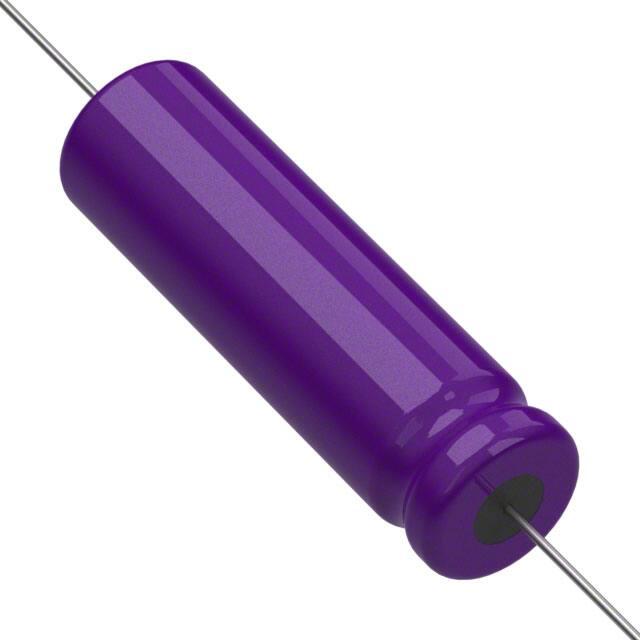

500D www.vishay.com Vishay Sprague Aluminum Capacitors +85 °C, Miniature, General Purpose FEATURES • Increased CV efficiency • New 0.709" [18.0 mm] diameter case size Available • Axial lead • Material categorization: for definitions of compliance please see www.vishay.com/doc?99912 QUICK REFERENCE DATA DESCRIPTION Nominal case size Ø D x L in mm Operating temperature Rated capacitance range, CR Tolerance on CR Rated voltage range, UR Life validation test at 85 °C Shelf life at 85 °C DC leakage current RIPPLE CURRENT MULTIPLIERS VALUE 0.248" x 0.512" [6.3 x 13.0] to 0.709" x 1.574" [18.0 x 40.0] -40 °C to +85 °C (3 WVDC to 250 WVDC) -20 °C to +85 °C (251 WVDC to 450 WVDC) 0.22 μF to 10 000 μF ± 20 % 6.3 WVDC to 450 WVDC 2000 h: ΔCAP ≤ 20 % from initial measurement. ΔESR ≤ 1.5 x initial specified limit. ΔDCL ≤ initial specified limit. 500 h: ΔCAP ≤ 20 % from initial measurement. ΔESR ≤ 1.5 x initial specified limit. ΔDCL ≤ 2.0 x initial specified limit. I = 0.01 CV + 10 μA (3 VDC to 100 VDC) I = 0.03 CV + 20 μA (101 VDC to 450 VDC) I in μA, C in μF, V in Volts TEMPERATURE AMBIENT TEMPERATURE MULTIPLIERS +85 °C 1.0 +75 °C 1.25 ≤ 65 °C 1.5 FREQUENCY (Hz) 50 TO 60 100 TO 120 300 TO 400 1K TO 100K WVDC 0 to 50 0.85 1.0 1.05 1.1 51 to 450 0.80 1.0 1.30 1.5 DIMENSIONS in inches [millimeters] CASE CODE BA BB CB CC DC DD DF DH EF EH FH FK GH GK LS NOMINAL D 0.248 [6.300] 0.248 [6.300] 0.315 [8.000] 0.315 [8.000] 0.374 [9.500] 0.374 [9.500] 0.374 [9.500] 0.374 [9.500] 0.433 [11.000] 0.433 [11.000] 0.492 [12.500] 0.492 [12.500] 0.630 [16.000] 0.630 [16.000] 0.709 [18.000] L 0.512 [13.000] 0.689 [17.500] 0.689 [17.500] 0.807 [20.500] 0.807 [20.500] 0.945 [24.000] 1.260 [32.000] 1.496 [38.000] 1.260 [32.000] 1.496 [38.000] 1.496 [38.000] 1.752 [44.500] 1.496 [38.000] 1.752 [44.500] 1.575 [40.000] STYLE 2 D (max.) 0.276 [7.000] 0.276 [7.000] 0.339 [8.600] 0.339 [8.600] 0.402 [10.200] 0.402 [10.200] 0.402 [10.200] 0.402 [10.200] 0.465 [11.800] 0.465 [11.800] 0.516 [13.100] 0.516 [13.100] 0.654 [16.600] 0.654 [16.600] 0.736 [18.700] L (max.) 0.567 [14.400] 0.756 [19.200] 0.756 [19.200] 0.878 [22.300] 0.878 [22.300] 1.010 [25.500] 1.319 [33.500] 1.567 [39.800] 1.319 [33.500] 1.567 [39.800] 1.567 [39.800] 1.831 [46.500] 1.567 [39.800] 1.831 [46.500] 1.673 [42.500] STYLE 5 D (max.) 0.276 [7.000] 0.276 [7.000] 0.339 [8.600] 0.339 [8.600] 0.402 [10.200] 0.402 [10.200] 0.402 [10.200] 0.402 [10.200] 0.465 [11.800] 0.465 [11.800] 0.516 [13.100] 0.516 [13.100] 0.654 [16.600] 0.654 [16.600] 0.736 [18.700] L (max.) 0.626 [15.900] 0.815 [20.700] 0.815 [20.700] 0.937 [23.800] 0.937 [23.800] 1.063 [27.000] 1.378 [35.000] 1.626 [41.300] 1.378 [35.000] 1.626 [41.300] 1.626 [41.300] 1.890 [48.000] 1.626 [41.300] 1.890 [48.000] 1.693 [43.000] Note • Lead diameter AWG 20 (0.032" [0.81 mm]) Document Number: 42045 1 For technical questions, contact: aluminumcaps4@vishay.com THIS DOCUMENT IS SUBJECT TO CHANGE WITHOUT NOTICE. THE PRODUCTS DESCRIBED HEREIN AND THIS DOCUMENT ARE SUBJECT TO SPECIFIC DISCLAIMERS, SET FORTH AT www.vishay.com/doc?91000 Revision: 12-Jun-17 500D www.vishay.com Vishay Sprague ORDERING EXAMPLE Electrolytic capacitor 500D series: 500D 686 M 6R3 BA 2 A DESCRIPTION CODE EXPLANATION 500D Product type 686 Capacitance value (68 μF) M Tolerance (M = ± 20 %) 6R3 Voltage rating at 85 °C (6R3 = 6.3 V) BA Can size (see Dimensions table) 2 Sleeve and sealing (2 = P.V.C. sleeve; 5 = P.V.C. sleeve with resin end-seal) A Packaging (A = bulk) Note • For lead (Pb)-free / RoHS compliant products add suffix “E3” to part number. Example: 500D686M6R3BA2AE3 ELECTRICAL DATA AND ORDERING INFORMATION CAPACITANCE (μF) PART NUMBER NOMINAL CASE SIZE DxL 6.3 WVDC AT +85 °C, SURGE = 8 V 68 500D686M6R3BA2A 0.248 x 0.512 [6.3 x 13.0] 150 500D157M6R3BB2A 0.248 x 0.689 [6.3 x 17.5] 220 500D227M6R3CB2A 0.315 x 0.689 [8.0 x 17.5] 330 500D337M6R3CC2A 0.315 x 0.807 [8.0 x 20.5] 680 500D687M6R3DC2A 0.374 x 0.807 [9.5 x 20.5] 820 500D827M6R3DD2A 0.374 x 0.945 [9.5 x 24.0] 1200 500D128M6R3DF2A 0.374 x 1.260 [9.5 x 32.0] 2200 500D228M6R3DH2A 0.374 x 1.496 [9.5 x 38.0] 2200 500D228M6R3EF2A 0.433 x 1.260 [11.0 x 32.0] 3300 500D338M6R3EH2A 0.433 x 1.496 [11.0 x 38.0] 3300 500D338M6R3FH2A 0.492 x 1.496 [12.5 x 38.0] 4700 500D478M6R3FK2A 0.492 x 1.752 [12.5 x 44.5] 5600 500D568M6R3GH2A 0.630 x 1.496 [16.0 x 38.0] 8200 500D828M6R3GK2A 0.630 x 1.752 [16.0 x 44.5] 500D109M6R3LS2A 0.709 x 1.575 [18.0 x 40.0] 10 000 10 WVDC AT +85 °C, SURGE = 12 V 47 500D476M010BA2A 0.248 x 0.512 [6.3 x 13.0] 100 500D107M010BB2A 0.248 x 0.689 [6.3 x 17.5] 220 500D227M010CB2A 0.315 x 0.689 [8.0 x 17.5] 330 500D337M010CC2A 0.315 x 0.807 [8.0 x 20.5] 470 500D477M010DC2A 0.374 x 0.807 [9.5 x 20.5] 680 500D687M010DD2A 0.374 x 0.945 [9.5 x 24.0] 1000 500D108M010DF2A 0.374 x 1.260 [9.5 x 32.0] 1500 500D158M010DH2A 0.374 x 1.496 [9.5 x 38.0] 1800 500D188M010EF2A 0.433 x 1.260 [11.0 x 32.0] 2200 500D228M010EH2A 0.433 x 1.496 [11.0 x 38.0] 2700 500D278M010EH2A 0.433 x 1.496 [11.0 x 38.0] 2700 500D278M010FH2A 0.492 x 1.496 [12.5 x 38.0] 3300 500D338M010GH2A 0.630 x 1.496 [16.0 x 38.0] 3900 500D398M010FK2A 0.492 x 1.752 [12.5 x 44.5] 4700 500D478M010GH2A 0.630 x 1.496 [16.0 x 38.0] 6800 500D688M010GK2A 0.630 x 1.752 [16.0 x 44.5] 8200 500D828M010LS2A 0.709 x 1.575 [18.0 x 40.0] Document Number: 42045 2 For technical questions, contact: aluminumcaps4@vishay.com THIS DOCUMENT IS SUBJECT TO CHANGE WITHOUT NOTICE. THE PRODUCTS DESCRIBED HEREIN AND THIS DOCUMENT ARE SUBJECT TO SPECIFIC DISCLAIMERS, SET FORTH AT www.vishay.com/doc?91000 Revision: 12-Jun-17 500D www.vishay.com Vishay Sprague ELECTRICAL DATA AND ORDERING INFORMATION CAPACITANCE (μF) PART NUMBER NOMINAL CASE SIZE DxL 12 WVDC AT +85 °C, SURGE = 15 V 39 500D396M012BA2A 0.248 x 0.512 [6.3 x 13.0] 68 500D686M012BB2A 0.248 x 0.689 [6.3 x 17.5] 150 500D157M012CB2A 0.315 x 0.689 [8.0 x 17.5] 220 500D227M012CC2A 0.315 x 0.807 [8.0 x 20.5] 330 500D337M012DC2A 0.374 x 0.807 [9.5 x 20.5] 560 500D567M012DD2A 0.374 x 0.807 [9.5 x 20.5] 820 500D827M012DF2A 0.374 x 1.260 [9.5 x 32.0] 1200 500D128M012DH2A 0.374 x 1.496 [9.5 x 38.0] 1500 500D158M012EF2A 0.433 x 1.260 [11.0 x 32.0] 2200 500D228M012EH2A 0.433 x 1.496 [11.0 x 38.0] 2200 500D228M012FH2A 0.492 x 1.496 [12.5 x 38.0] 2700 500D278M012FK2A 0.492 x 1.752 [12.5 x 44.5] 3900 500D398M012GH2A 0.630 x 1.496 [16.0 x 38.0] 5600 500D568M012GK2A 0.630 x 1.752 [16.0 x 44.5] 500D688M012LS2A 0.709 x 1.575 [18.0 x 40.0] 6800 16 WVDC AT +85 °C, SURGE = 20 V 33 500D336M016BA2A 0.248 x 0.512 [6.3 x 13.0] 68 500D686M016BB2A 0.248 x 0.689 [6.3 x 17.5] 100 500D107M016CB2A 0.315 x 0.689 [8.0 x 17.5] 150 500D157M016CB2A 0.315 x 0.689 [8.0 x 17.5] 220 500D227M016CC2A 0.315 x 0.807 [8.0 x 20.5 330 500D337M016DC2A 0.374 x 0.807 [9.5 x 20.5] 470 500D477M016DD2A 0.374 x 0.945 [9.5 x 24.0] 680 500D687M016DF2A 0.374 x 1.260 [9.5 x 32.0] 1000 500D108M016DH2A 0.374 x 1.496 [9.5 x 38.0] 1200 500D128M016DH2A 0.374 x 1.496 [9.5 x 38.0] 1200 500D128M016EF2A 0.433 x 1.260 [11.0 x 32.0] 1500 500D158M016EH2A 0.433 x 1.496 [11.0 x 38.0] 1800 500D188M016EH2A 0.433 x 1.496 [11.0 x 38.0] 1800 500D188M016FH2A 0.492 x 1.496 [12.5 x 38.0] 2200 500D228M016FK2A 0.492 x 1.752 [12.5 x 44.5] 2700 500D278M016FK2A 0.492 x 1.752 [12.5 x 44.5] 3300 500D338M016GH2A 0.630 x 1.496 [16.0 x 38.0] 3300 500D338M016GK2A 0.630 x 1.752 [16.0 x 44.5] 4700 500D478M016GK2A 0.630 x 1.752 [16.0 x 44.5] 5600 500D568M016LS2A 0.709 x 1.575 [18.0 x 40.0] 25 WVDC AT +85 °C, SURGE = 35 V 22 500D226M025BA2A 0.248 x 0.512 [6.3 x 13.0] 33 500D336M025BB2A 0.248 x 0.689 [6.3 x 17.5] 47 500D476M025BB2A 0.248 x 0.689 [6.3 x 17.5] 68 500D686M025CB2A 0.315 x 0.689 [8.0 x 17.5] 100 500D107M025CC2A 0.315 x 0.807 [8.0 x 20.5] 150 500D157M025DC2A 0.374 x 0.807 [9.5 x 20.5] 220 500D227M025DC2A 0.374 x 0.807 [9.5 x 20.5] 330 500D337M025DD2A 0.374 x 0.945 [9.5 x 24.0] 330 500D337M025DF2A 0.374 x 1.260 [9.5 x 32.0] 470 500D477M025DF2A 0.374 x 1.260 [9.5 x 32.0] 820 500D827M025DH2A 0.374 x 1.496 [9.5 x 38.0] 680 500D687M025EF2A 0.433 x 1.260 [11.0 x 32.0] Document Number: 42045 3 For technical questions, contact: aluminumcaps4@vishay.com THIS DOCUMENT IS SUBJECT TO CHANGE WITHOUT NOTICE. THE PRODUCTS DESCRIBED HEREIN AND THIS DOCUMENT ARE SUBJECT TO SPECIFIC DISCLAIMERS, SET FORTH AT www.vishay.com/doc?91000 Revision: 12-Jun-17 500D www.vishay.com Vishay Sprague ELECTRICAL DATA AND ORDERING INFORMATION CAPACITANCE (μF) PART NUMBER NOMINAL CASE SIZE DxL 25 WVDC AT +85 °C, SURGE = 35 V 1000 500D108M025FH2A 0.492 x 1.496 [12.5 x 38.0] 1200 500D128M025EH2A 0.433 x 1.496 [11.0 x 38.0] 1200 500D128M025FH2A 0.492 x 1.496 [12.5 x 38.0] 1800 500D188M025FK2A 0.492 x 1.752 [12.5 x 44.5] 1800 500D188M025GH2A 0.630 x 1.496 [16.0 x 38.0] 2200 500D228M025GK2A 0.630 x 1.752 [16.0 x 44.5] 2700 500D278M025GK2A 0.630 x 1.752 [16.0 x 44.5] 3300 500D338M025LS2A 0.709 x 1.575 [18.0 x 40.0] 35 WVDC AT +85 °C, SURGE = 40 V 15 500D156M035BA2A 47 500D476M035CB2A 0.315 x 0.689 [8.0 x 17.5] 330 500D337M035DH2A 0.374 x 1.496 [9.5 x 38.0] 470 500D477M035EH2A 0.433 x 1.496 [11.0 x 38.0] 680 500D687M035FK2A 0.492 x 1.752 [12.5 x 44.5] 500D108M035GH2A 0.630 x 1.496 [16.0 x 38.0] 1000 0.248 x 0.512 [6.3 x 13.0] 40 WVDC AT +85 °C, SURGE = 50 V 15 500D156M040BA2A 0.248 x 0.512 [6.3 x 13.0] 22 500D226M040BB2A 0.248 x 0.689 [6.3 x 17.5] 47 500D476M040CB2A 0.315 x 0.689 [8.0 x 17.5] 68 500D686M040CC2A 0.315 x 0.807 [8.0 x 20.5] 100 500D107M040DC2A 0.374 x 0.807 [9.5 x 20.5] 180 500D187M040DD2A 0.374 x 0.945 [9.5 x 24.0] 270 500D277M040DF2A 0.374 x 1.260 [9.5 x 32.0] 470 500D477M040DH2A 0.374 x 1.496 [9.5 x 38.0] 470 500D477M040EF2A 0.433 x 1.260 [11.0 x 32.0] 680 500D687M040EH2A 0.433 x 1.496 [11.0 x 38.0] 680 500D687M040FH2A 0.492 x 1.496 [12.5 x 38.0] 1000 500D108M040FK2A 0.492 x 1.752 [12.5 x 44.5] 1200 500D128M040GH2A 0.630 x 1.496 [16.0 x 38.0] 1800 500D188M040GK2A 0.630 x 1.752 [16.0 x 44.5] 500D228M040LS2A 0.709 x 1.575 [18.0 x 40.0] 2200 50 WVDC AT +85 °C, SURGE = 65 V 10 500D106M050BA2A 0.248 x 0.512 [6.3 x 13.0] 22 500D226M050BB2A 0.248 x 0.689 [6.3 x 17.5] 33 500D336M050CB2A 0.315 x 0.689 [8.0 x 17.5] 68 500D686M050CC2A 0.315 x 0.807 [8.0 x 20.5] 100 500D107M050DC2A 0.374 x 0.807 [9.5 x 20.5] 150 500D157M050DD2A 0.374 x 0.945 [9.5 x 24.0] 220 500D227M050DF2A 0.374 x 1.260 [9.5 x 32.0] 330 500D337M050DH2A 0.374 x 1.496 [9.5 x 38.0] 330 500D337M050EF2A 0.433 x 1.260 [11.0 x 32.0] 470 500D477M050FH2A 0.492 x 1.496 [12.5 x 38.0] 560 500D567M050EH2A 0.433 x 1.496 [11.0 x 38.0] 680 500D687M050GH2A 0.630 x 1.496 [16.0 x 38.0] 820 500D827M050FK2A 0.492 x 1.752 [12.5 x 44.5] 820 500D827M050GH2A 0.630 x 1.496 [16.0 x 38.0] 1000 500D108M050GK2A 0.630 x 1.752 [16.0 x 44.5] 1500 500D158M050GK2A 0.630 x 1.752 [16.0 x 44.5] 1800 500D188M050LS2A 0.709 x 1.575 [18.0 x 40.0] Document Number: 42045 4 For technical questions, contact: aluminumcaps4@vishay.com THIS DOCUMENT IS SUBJECT TO CHANGE WITHOUT NOTICE. THE PRODUCTS DESCRIBED HEREIN AND THIS DOCUMENT ARE SUBJECT TO SPECIFIC DISCLAIMERS, SET FORTH AT www.vishay.com/doc?91000 Revision: 12-Jun-17 500D www.vishay.com Vishay Sprague ELECTRICAL DATA AND ORDERING INFORMATION CAPACITANCE (μF) PART NUMBER NOMINAL CASE SIZE DxL 63 WVDC AT +85 °C, SURGE = 75 V 6.8 500D685M063BA2A 0.248 x 0.512 [6.3 x 13.0] 15 500D156M063BB2A 0.248 x 0.689 [6.3 x 17.5] 22 500D226M063CB2A 0.315 x 0.689 [8.0 x 17.5] 33 500D336M063CB2A 0.315 x 0.689 [8.0 x 17.5] 47 500D476M063CC2A 0.315 x 0.807 [8.0 x 20.5] 68 500D686M063DC2A 0.374 x 0.807 [9.5 x 20.5] 100 500D107M063DD2A 0.374 x 0.945 [9.5 x 24.0] 150 500D157M063DF2A 0.374 x 1.260 [9.5 x 32.0] 220 500D227M063DH2A 0.374 x 1.496 [9.5 x 38.0] 220 500D227M063EF2A 0.433 x 1.260 [11.0 x 32.0] 270 500D277M063DH2A 0.374 x 1.496 [9.5 x 38.0] 390 500D397M063FH2A 0.492 x 1.496 [12.5 x 38.0] 470 500D477M063EH2A 0.433 x 1.496 [11.0 x 38.0] 470 500D477M063FK2A 0.492 x 1.752 [12.5 x 44.5] 560 500D567M063FK2A 0.492 x 1.752 [12.5 x 44.5] 560 500D567M063GH2A 0.630 x 1.496 [16.0 x 38.0] 1000 500D108M063GK2A 0.630 x 1.752 [16.0 x 44.5] 1200 500D128M063LS2A 0.709 x 1.575 [18.0 x 40.0] 80 WVDC AT +85 °C, SURGE = 100 V 4.7 500D475M080BA2A 0.248 x 0.512 [6.3 x 13.0] 47 500D476M080DC2A 0.374 x 0.807 [9.5 x 20.5] 100 WVDC AT +85 °C, SURGE = 125 V 1.0 500D105M100BA2A 0.248 x 0.512 [6.3 x 13.0] 2.2 500D225M100BA2A 0.248 x 0.512 [6.3 x 13.0] 3.3 500D335M100BA2A 0.248 x 0.512 [6.3 x 13.0] 4.7 500D475M100BB2A 0.248 x 0.689 [6.3 x 17.5] 10 500D106M100CB2A 0.315 x 0.689 [8.0 x 17.5] 15 500D156M100CC2A 0.315 x 0.807 [8.0 x 20.5] 22 500D226M100DC2A 0.374 x 0.807 [9.5 x 20.5] 33 500D336M100DD2A 0.374 x 0.945 [9.5 x 24.0] 39 500D396M100DD2A 0.374 x 0.945 [9.5 x 24.0] 47 500D476M100DF2A 0.374 x 1.260 [9.5 x 32.0] 56 500D566M100DF2A 0.374 x 1.260 [9.5 x 32.0] 100 500D107M100DH2A 0.374 x 1.496 [9.5 x 38.0] 100 500D107M100EF2A 0.433 x 1.260 [11.0 x 32.0] 100 500D107M100EH2A 0.433 x 1.496 [11.0 x 38.0] 150 500D157M100EH2A 0.433 x 1.496 [11.0 x 38.0] 150 500D157M100FH2A 0.492 x 1.496 [12.5 x 38.0] 220 500D227M100FK2A 0.492 x 1.752 [12.5 x 44.5] 220 500D227M100GH2A 0.630 x 1.496 [16.0 x 38.0] 220 500D227M100GK2A 0.630 x 1.752 [16.0 x 44.5] 390 500D397M100GK2A 0.630 x 1.752 [16.0 x 44.5] 470 500D477M100LS2A 0.709 x 1.575 [18.0 x 40.0] 150 WVDC AT +85 °C, SURGE = 175 V 1.0 500D105M150BA2A 0.248 x 0.512 [6.3 x 13.0] 10 500D106M150DC2A 0.374 x 0.807 [9.5 x 20.5] 22 500D226M150DF2A 0.374 x 1.260 [9.5 x 32.0] 33 500D336M150EF2A 0.433 x 1.260 [11.0 x 32.0] 47 500D476M150EH2A 0.433 x 1.496 [11.0 x 38.0] Document Number: 42045 5 For technical questions, contact: aluminumcaps4@vishay.com THIS DOCUMENT IS SUBJECT TO CHANGE WITHOUT NOTICE. THE PRODUCTS DESCRIBED HEREIN AND THIS DOCUMENT ARE SUBJECT TO SPECIFIC DISCLAIMERS, SET FORTH AT www.vishay.com/doc?91000 Revision: 12-Jun-17 500D www.vishay.com Vishay Sprague ELECTRICAL DATA AND ORDERING INFORMATION CAPACITANCE (μF) PART NUMBER NOMINAL CASE SIZE DxL 160 WVDC AT +85 °C, SURGE = 180 V 1.5 500D155M160BA2A 0.248 x 0.512 [6.3 x 13.0] 2.7 500D275M160BB2A 0.248 x 0.689 [6.3 x 17.5] 3.3 500D335M160CB2A 0.315 x 0.689 [8.0 x 17.5] 6.8 500D685M160CC2A 0.315 x 0.807 [8.0 x 20.5] 10 500D106M160DC2A 0.374 x 0.807 [9.5 x 20.5] 15 500D156M160DD2A 0.374 x 0.945 [9.5 x 24.0] 22 500D226M160DF2A 0.374 x 1.260 [9.5 x 32.0] 27 500D276M160DH2A 0.374 x 1.496 [9.5 x 38.0] 33 500D336M160EF2A 0.433 x 1.260 [11.0 x 32.0] 47 500D476M160EH2A 0.433 x 1.496 [11.0 x 38.0] 47 500D476M160FH2A 0.492 x 1.496 [12.5 x 38.0] 56 500D566M160FK2A 0.492 x 1.752 [12.5 x 44.5] 82 500D826M160GH2A 0.630 x 1.496 [16.0 x 38.0] 100 500D107M160GK2A 0.630 x 1.752 [16.0 x 44.5] 500D127M160LS2A 0.709 x 1.575 [18.0 x 40.0] 120 200 WVDC AT +85 °C, SURGE = 250 V 1.2 500D125M200BA2A 0.248 x 0.512 [6.3 x 13.0] 2.2 500D225M200BB2A 0.248 x 0.689 [6.3 x 17.5] 2.2 500D225M200CB2A 0.315 x 0.689 [8.0 x 17.5] 2.7 500D275M200CB2A 0.315 x 0.689 [8.0 x 17.5] 3.3 500D335M200CC2A 0.315 x 0.807 [8.0 x 20.5] 4.7 500D475M200CC2A 0.315 x 0.807 [8.0 x 20.5] 8.2 500D825M200DC2A 0.374 x 0.807 [9.5 x 20.5] 10 500D106M200DD2A 0.374 x 0.945 [9.5 x 24.0] 15 500D156M200DF2A 0.374 x 1.260 [9.5 x 32.0] 22 500D226M200DH2A 0.374 x 1.496 [9.5 x 38.0] 27 500D276M200EF2A 0.433 x 1.260 [11.0 x 32.0] 33 500D336M200EH2A 0.433 x 1.496 [11.0 x 38.0] 33 500D336M200FK2A 0.492 x 1.752 [12.5 x 44.5] 39 500D396M200FH2A 0.492 x 1.496 [12.5 x 38.0] 47 500D476M200FK2A 0.492 x 1.752 [12.5 x 44.5] 68 500D686M200GH2A 0.630 x 1.496 [16.0 x 38.0] 82 500D826M200GK2A 0.630 x 1.752 [16.0 x 44.5] 500D107M200LS2A 0.709 x 1.575 [18.0 x 40.0] 100 250 WVDC AT +85 °C, SURGE = 300 V 1.0 500D105M250BA2A 1.5 500D155M250CB2A 0.248 x 0.512 [6.3 x 13.0] 0.315 x 0.689 [8.0 x 17.5] 1.8 500D185M250BB2A 0.248 x 0.689 [6.3 x 17.5] 2.2 500D225M250CB2A 0.315 x 0.689 [8.0 x 17.5] 2.2 500D225M250CC2A 0.315 x 0.807 [8.0 x 20.5] 3.3 500D335M250CC2A 0.315 x 0.807 [8.0 x 20.5] 4.7 500D475M250DC2A 0.374 x 0.807 [9.5 x 20.5] 6.8 500D685M250DC2A 0.374 x 0.807 [9.5 x 20.5] 8.2 500D825M250DD2A 0.374 x 0.945 [9.5 x 24.0] 10 500D106M250DF2A 0.374 x 1.260 [9.5 x 32.0] 12 500D126M250DF2A 0.374 x 1.260 [9.5 x 32.0] 15 500D156M250EF2A 0.433 x 1.260 [11.0 x 32.0] 18 500D186M250DH2A 0.374 x 1.496 [9.5 x 38.0] 18 500D186M250EF2A 0.433 x 1.260 [11.0 x 32.0] Document Number: 42045 6 For technical questions, contact: aluminumcaps4@vishay.com THIS DOCUMENT IS SUBJECT TO CHANGE WITHOUT NOTICE. THE PRODUCTS DESCRIBED HEREIN AND THIS DOCUMENT ARE SUBJECT TO SPECIFIC DISCLAIMERS, SET FORTH AT www.vishay.com/doc?91000 Revision: 12-Jun-17 500D www.vishay.com Vishay Sprague ELECTRICAL DATA AND ORDERING INFORMATION CAPACITANCE (μF) PART NUMBER NOMINAL CASE SIZE DxL 250 WVDC AT +85 °C, SURGE = 300 V 22 500D226M250EH2A 0.433 x 1.496 [11.0 x 38.0] 27 500D276M250EH2A 0.433 x 1.496 [11.0 x 38.0] 27 500D276M250FH2A 0.492 x 1.496 [12.5 x 38.0] 39 500D396M250FK2A 0.492 x 1.752 [12.5 x 44.5] 47 500D476M250GH2A 0.630 x 1.496 [16.0 x 38.0] 47 500D476M250GK2A 0.630 x 1.752 [16.0 x 44.5] 56 500D566M250GK2A 0.630 x 1.752 [16.0 x 44.5] 500D826M250LS2A 0.709 x 1.575 [18.0 x 40.0] 82 350 WVDC AT +85 °C, SURGE = 400 V 0.47 500D474M350BA2A 0.248 x 0.512 [6.3 x 13.0] 0.82 500D824M350BB2A 0.248 x 0.689 [6.3 x 17.5] 1.0 500D105M350CB2A 0.315 x 0.689 [8.0 x 17.5] 1.2 500D125M350CB2A 0.315 x 0.689 [8.0 x 17.5] 1.8 500D185M350CC2A 0.315 x 0.807 [8.0 x 20.5] 2.2 500D225M350DC2A 0.374 x 0.807 [9.5 x 20.5] 3.3 500D335M350DC2A 0.374 x 0.807 [9.5 x 20.5] 3.9 500D395M350DD2A 0.374 x 0.945 [9.5 x 24.0] 4.7 500D475M350DF2A 0.374 x 1.260 [9.5 x 32.0] 5.6 500D565M350DF2A 0.374 x 1.260 [9.5 x 32.0] 8.2 500D825M350DH2A 0.374 x 1.496 [9.5 x 38.0] 10 500D106M350EF2A 0.433 x 1.260 [11.0 x 32.0] 10.0 500D106M350EH2A 0.433 x 1.496 [11.0 x 38.0] 12 500D126M350EH2A 0.433 x 1.496 [11.0 x 38.0] 15 500D156M350FH2A 0.492 x 1.496 [12.5 x 38.0] 18 500D186M350FK2A 0.492 x 1.752 [12.5 x 44.5] 22 500D226M350GH2A 0.630 x 1.496 [16.0 x 38.0] 33 500D336M350GK2A 0.630 x 1.752 [16.0 x 44.5] 39 500D396M350LS2A 0.709 x 1.575 [18.0 x 40.0] 400 WVDC AT +85 °C, SURGE = 450 V 0.27 500D274M400BA2A 0.56 500D564M400BB2A 0.248 x 0.512 [6.3 x 13.0] 0.248 x 0.689 [6.3 x 17.5] 0.68 500D684M400CB2A 0.315 x 0.689 [8.0 x 17.5] 1.0 500D105M400CC2A 0.315 x 0.807 [8.0 x 20.5] 1.5 500D155M400DC2A 0.374 x 0.807 [9.5 x 20.5] 2.2 500D225M400DC2A 0.374 x 0.807 [9.5 x 20.5] 2.7 500D275M400DD2A 0.374 x 0.945 [9.5 x 24.0] 3.9 500D395M400DF2A 0.374 x 1.260 [9.5 x 32.0] 5.6 500D565M400DH2A 0.374 x 1.496 [9.5 x 38.0] 6.8 500D685M400EF2A 0.433 x 1.260 [11.0 x 32.0] 10 500D106M400EH2A 0.433 x 1.496 [11.0 x 38.0] 10 500D106M400FK2A 0.492 x 1.752 [12.5 x 44.5] 12 500D126M400FH2A 0.492 x 1.496 [12.5 x 38.0] 15 500D156M400FK2A 0.492 x 1.752 [12.5 x 44.5] 18 500D186M400GH2A 0.630 x 1.496 [16.0 x 38.0] 22 500D226M400GK2A 0.630 x 1.752 [16.0 x 44.5] 39 500D396M400LS2A 0.709 x 1.575 [18.0 x 40.0] Document Number: 42045 7 For technical questions, contact: aluminumcaps4@vishay.com THIS DOCUMENT IS SUBJECT TO CHANGE WITHOUT NOTICE. THE PRODUCTS DESCRIBED HEREIN AND THIS DOCUMENT ARE SUBJECT TO SPECIFIC DISCLAIMERS, SET FORTH AT www.vishay.com/doc?91000 Revision: 12-Jun-17 500D www.vishay.com Vishay Sprague ELECTRICAL DATA AND ORDERING INFORMATION CAPACITANCE (μF) PART NUMBER NOMINAL CASE SIZE DxL 450 WVDC AT +85 °C, SURGE = 500 V 0.22 500D224M450BA2A 0.248 x 0.512 [6.3 x 13.0] 0.47 500D474M450BB2A 0.248 x 0.689 [6.3 x 17.5] 0.56 500D564M450CB2A 0.315 x 0.689 [8.0 x 17.5] 0.82 500D824M450CC2A 0.315 x 0.807 [8.0 x 20.5] 1.0 500D105M450DC2A 0.374 x 0.807 [9.5 x 20.5] 1.8 500D185M450DC2A 0.374 x 0.807 [9.5 x 20.5] 2.2 500D225M450DD2A 0.374 x 0.945 [9.5 x 24.0] 2.2 500D225M450DF2A 0.374 x 1.260 [9.5 x 32.0] 3.3 500D335M450DF2A 0.374 x 1.260 [9.5 x 32.0] 4.7 500D475M450DH2A 0.374 x 1.496 [9.5 x 38.0] 5.6 500D565M450EF2A 0.433 x 1.260 [11.0 x 32.0] 8.2 500D825M450EH2A 0.433 x 1.496 [11.0 x 38.0] 10 500D106M450FH2A 0.492 x 1.496 [12.5 x 38.0] 10 500D106M450GK2A 0.630 x 1.752 [16.0 x 44.5] 12 500D126M450FK2A 0.492 x 1.752 [12.5 x 44.5] 15 500D156M450GH2A 0.630 x 1.496 [16.0 x 38.0] 18 500D186M450GK2A 0.630 x 1.752 [16.0 x 44.5] 33 500D336M450LS2A 0.709 x 1.575 [18.0 x 40.0] Statements about product lifetime are based on calculations and internal testing. They should only be interpreted as estimations. Also due to external factors, the lifetime in the field application may deviate from the calculated lifetime. In general, nothing stated herein shall be construed as a guarantee of durability. Document Number: 42045 8 For technical questions, contact: aluminumcaps4@vishay.com THIS DOCUMENT IS SUBJECT TO CHANGE WITHOUT NOTICE. THE PRODUCTS DESCRIBED HEREIN AND THIS DOCUMENT ARE SUBJECT TO SPECIFIC DISCLAIMERS, SET FORTH AT www.vishay.com/doc?91000 Revision: 12-Jun-17 Legal Disclaimer Notice www.vishay.com Vishay Disclaimer ALL PRODUCT, PRODUCT SPECIFICATIONS AND DATA ARE SUBJECT TO CHANGE WITHOUT NOTICE TO IMPROVE RELIABILITY, FUNCTION OR DESIGN OR OTHERWISE. Vishay Intertechnology, Inc., its affiliates, agents, and employees, and all persons acting on its or their behalf (collectively, “Vishay”), disclaim any and all liability for any errors, inaccuracies or incompleteness contained in any datasheet or in any other disclosure relating to any product. Vishay makes no warranty, representation or guarantee regarding the suitability of the products for any particular purpose or the continuing production of any product. To the maximum extent permitted by applicable law, Vishay disclaims (i) any and all liability arising out of the application or use of any product, (ii) any and all liability, including without limitation special, consequential or incidental damages, and (iii) any and all implied warranties, including warranties of fitness for particular purpose, non-infringement and merchantability. Statements regarding the suitability of products for certain types of applications are based on Vishay’s knowledge of typical requirements that are often placed on Vishay products in generic applications. Such statements are not binding statements about the suitability of products for a particular application. It is the customer’s responsibility to validate that a particular product with the properties described in the product specification is suitable for use in a particular application. Parameters provided in datasheets and / or specifications may vary in different applications and performance may vary over time. All operating parameters, including typical parameters, must be validated for each customer application by the customer’s technical experts. Product specifications do not expand or otherwise modify Vishay’s terms and conditions of purchase, including but not limited to the warranty expressed therein. Except as expressly indicated in writing, Vishay products are not designed for use in medical, life-saving, or life-sustaining applications or for any other application in which the failure of the Vishay product could result in personal injury or death. Customers using or selling Vishay products not expressly indicated for use in such applications do so at their own risk. Please contact authorized Vishay personnel to obtain written terms and conditions regarding products designed for such applications. No license, express or implied, by estoppel or otherwise, to any intellectual property rights is granted by this document or by any conduct of Vishay. Product names and markings noted herein may be trademarks of their respective owners. © 2021 VISHAY INTERTECHNOLOGY, INC. ALL RIGHTS RESERVED Revision: 01-Jan-2021 1 Document Number: 91000

器件简介: - 这些电容器是Vishay Sprague生产的,设计用于在+85°C的工作温度下提供高效率的电容性能。 - 它们是小型通用目的电容器,具有增加的CV(电容-电压)效率。
引脚分配: - 电容器采用轴向引脚设计。
参数特性: - 工作温度范围从-40°C到+85°C,部分型号可扩展至-20°C至+85°C。 - 电容值范围从0.22μF到10,000μF。 - 公差为±20%。 - 额定电压范围从6.3VDC到450VDC。 - 在85°C下进行2000小时的寿命验证测试,电容值下降不超过20%,等效串联电阻(AESR)不超过初始规格限制的1.5倍。
