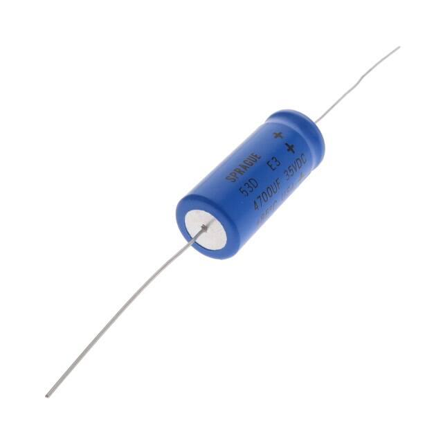

53D472G035HL6E3
53D472G035HL6E3
    TFUNK(威世)
    插件,D22.5xL54.4mm
    4700 µF 35 V 铝电解电容器 轴向,CAN 54 毫欧 @ 120Hz 85°C 时为 1000 小时
53D472G035HL6E3 数据手册
53D www.vishay.com Vishay Sprague Aluminum Capacitors +85 °C, Tubular, Axial Lead, General Purpose FEATURES • General purpose capacitor • Rugged construction Available • Largest CV ratings in axial leaded capacitor • Material categorization: for definitions of compliance please see www.vishay.com/doc?99912 QUICK REFERENCE DATA RIPPLE CURRENT MULTIPLIERS DESCRIPTION VALUE Nominal case size  Ø D x L in mm Operating temperature 1.7 +45 °C and below 2.0 FREQUENCY (Hz) 50 TO 60 300 TO 400 1000 AND UP -10 %, +50 %; -10 %, +75 % 0 to 50 0.85 1.10 1.15 6.3 WVDC to 450 WVDC 51 to 299 0.85 1.15 1.20 Axial leads 300 to up 0.80 1.30 1.40 1000 h: CAP  15 % from initial measurement. ESR  1.5 x initial specified limit. DCL  initial specified limit. LOW TEMPERATURE PERFORMANCE CAPACITANCE RATIO C-40 °C / C+25 °C MINIMUM AT 120 Hz 500 h: CAP  10 % from initial measurement. ESR  1.3 x initial specified limit. DCL  2.0 x initial specified limit. DC leakage current (after 5 min charge) 1.4 +65 °C WVDC Termination Shelf life at 85 °C MULTIPLIERS +75 °C -40 °C to +85 °C Rated voltage range, UR Life validation test at 85 °C AMBIENT TEMPERATURE 15 μF to 220 000 μF Rated capacitance range, CR Tolerance on CR TEMPERATURE 0.75" x 1.125" [19.05 x 28.575] to 1.375" x 4.125" [34.925 x 104.775] Rated Voltage (WVDC) I = k CV k = 6.0 at +25 °C; k = 36.0 at +85 °C I in μA, C in μF, V in Volts Capacitance Remaining 0 to 40 35 41 to 63 45 64 to 100 60 101 to 350 20 351 to 450 15 ESR RATIO ESR-40 °C / ESR+25 °C MAXIMUM AT 120 Hz Rated Voltage (WVDC) Multiplier 0 to 40 60 41 to 63 55 64 to 100 65 101 to 350 180 351 to 450 190 DIMENSIONS in inches [millimeters] CASE CODE STYLE 6 AND 7 D L TYPICAL WEIGHT CASE CODE GE 0.760 ± 0.020 [19.3 ± 0.51] 1.141 ± 0.062 [29.0 ± 1.58] 0.46 oz. (13 g) GJ 0.760 ± 0.020 [19.3 ± 0.51] 1.641 ± 0.062 [41.7 ± 1.58] GS 0.760 ± 0.020 [19.3 ± 0.51] GT HE STYLE 6 AND 7 D L TYPICAL WEIGTH GL 0.760 ± 0.020 [19.3 ± 0.51] 2.141 ± 0.062 [54.4 ± 1.58] 0.74 oz. (21 g) 0.67 oz. (19 g) GP 0.760 ± 0.020 [19.3 ± 0.51] 2.641 ± 0.062 [67.1 ± 1.58] 0.88 oz. (25 g) 3.141 ± 0.062 [79.8 ± 1.58] 1.16 oz. (33 g) KS 1.135 ± 0.020 [28.8 ± 0.51] 3.141 ± 0.062 [79.8 ± 1.58] 2.54 oz. (72 g) 0.760 ± 0.020 [19.3 ± 0.51] 3.641 ± 0.062 [92.5 ± 1.58] 1.34 oz. (38 g) KT 1.135 ± 0.020 [28.8 ± 0.51] 3.641 ± 0.062 [92.5 ± 1.58] 2.96 oz. (84 g) 0.885 ± 0.020 [22.5 ± 0.51] 1.141 ± 0.062 [29.0 ± 1.58] 0.63 oz. (18 g) KD 1.135 ± 0.020 [28.8 ± 0.51] 4.141 ± 0.062 [105.2 ± 1.58] 3.35 oz. (95 g) Revision: 20-Jul-16 Document Number: 42037 1 For technical questions, contact: aluminumcaps4@vishay.com THIS DOCUMENT IS SUBJECT TO CHANGE WITHOUT NOTICE. THE PRODUCTS DESCRIBED HEREIN AND THIS DOCUMENT ARE SUBJECT TO SPECIFIC DISCLAIMERS, SET FORTH AT www.vishay.com/doc?91000 53D www.vishay.com Vishay Sprague DIMENSIONS in inches [millimeters] CASE CODE HJ HL HP HS HT JE JJ JL JP JS JT KE KJ KL KP STYLE 6 AND 7 D L TYPICAL WEIGHT 0.885 ± 0.020 [22.5 ± 0.51] 0.885 ± 0.020 [22.5 ± 0.51] 0.885 ± 0.020 [22.5 ± 0.51] 0.885 ± 0.020 [22.5 ± 0.51] 0.885 ± 0.020 [22.5 ± 0.51] 1.010 ± 0.020 [25.7 ± 0.51] 1.010 ± 0.020 [25.7 ± 0.51] 1.010 ± 0.020 [25.7 ± 0.51] 1.010 ± 0.020 [25.7 ± 0.51] 1.010 ± 0.020 [25.7 ± 0.51] 1.010 ± 0.020 [25.7 ± 0.51] 1.135 ± 0.020 [28.8 ± 0.51] 1.135 ± 0.020 [28.8 ± 0.51] 1.135 ± 0.020 [28.8 ± 0.51] 1.135 ± 0.020 [28.8 ± 0.51] 1.641 ± 0.062 [41.7 ± 1.58] 2.141 ± 0.062 [54.4 ± 1.58] 2.641 ± 0.062 [67.1 ± 1.58] 3.141 ± 0.062 [79.8 ± 1.58] 3.641 ± 0.062 [92.5 ± 1.58] 1.141 ± 0.062 [29.0 ± 1.58] 1.641 ± 0.062 [41.7 ± 1.58] 2.141 ± 0.062 [54.4 ± 1.58] 2.641 ± 0.062 [67.1 ± 1.58] 3.141 ± 0.062 [79.8 ± 1.58] 3.641 ± 0.062 [92.5 ± 1.58] 1.141 ± 0.062 [29.0 ± 1.58] 1.641 ± 0.062 [41.7 ± 1.58] 2.141 ± 0.062 [54.4 ± 1.58] 2.641 ± 0.062 [67.1 ± 1.58] 0.95 oz. (27 g) 1.02 oz. (29 g) 1.38 oz. (39 g) 1.73 oz. (49 g) 2.08 oz. (59 g) 0.81 oz. (23 g) 1.02 oz. (29 g) 1.55 oz. (44 g) 1.87 oz. (53 g) 2.22 oz. (63 g) 2.54 oz. (72 g) 0.92 oz. (26 g) 1.31 oz. (37 g) 1.73 oz. (49 g) 2.15 oz. (61 g) STYLE 6 AND 7 CASE CODE LE LJ LL LP LS LT LD ME MJ ML MP MS MT MD D L TYPICAL WEIGTH 1.260 ± 0.020 [32.0 ± 0.51] 1.260 ± 0.020 [32.0 ± 0.51] 1.260 ± 0.020 [32.0 ± 0.51] 1.260 ± 0.020 [32.0 ± 0.51] 1.260 ± 0.020 [32.0 ± 0.51] 1.260 ± 0.020 [32.0 ± 0.51] 1.260 ± 0.020 [32.0 ± 0.51 1.375 ± 0.020 [34.9 ± 0.51] 1.375 ± 0.020 [34.9 ± 0.51] 1.375 ± 0.020 [34.9 ± 0.51] 1.375 ± 0.020 [34.9 ± 0.51] 1.375 ± 0.020 [34.9 ± 0.51] 1.375 ± 0.020 [34.9 ± 0.51] 1.375 ± 0.020 [34.9 ± 0.51] 1.141 ± 0.062 [29.0 ± 1.58] 1.641 ± 0.062 [41.7 ± 1.58] 2.141 ± 0.062 [54.4 ± 1.58] 2.641 ± 0.062 [67.1 ± 1.58] 3.141 ± 0.062 [79.8 ± 1.58] 3.641 ± 0.062 [92.5 ± 1.58] 4.141 ± 0.062 [105.2 ± 1.58] 1.141 ± 0.062 [29.0 ± 1.58] 1.641 ± 0.062 [41.7 ± 1.58] 2.141 ± 0.062 [54.4 ± 1.58] 2.641 ± 0.062 [67.1 ± 1.58] 3.141 ± 0.062 [79.8 ± 1.58] 3.641 ± 0.062 [92.5 ± 1.58] 4.141 ± 0.062 [105.2 ± 1.58] 1.13 oz. (32 g) 1.62 oz. (46 g) 2.11 oz. (60 g) 2.65 oz. (75 g) 3.14 oz. (89 g) 3.63 oz. (103 g) 4.16 oz. (118 g) 1.38 oz. (39 g) 1.98 oz. (56 g) 2.57 oz. (73 g) 3.21 oz. (91 g) 3.81 oz. (108 g) 4.44 oz. (126 g) 5.04 oz. (143 g) - - - - DIMENSIONS AND AVAILABLE FORMS L CL D 63.50 min. PVC sleeve 63.50 min. Lead diameter No. 18 AWG (0.040" [1.016 mm] Dia.) ORDERING EXAMPLE Electrolytic capacitor 53D series: 53D 282 G 025 GJ 6 DESCRIPTION CODE 53D 282 G 025 GJ 6 EXPLANATION Product type Capacitance value (2800 μF) Tolerance (G = -10 % / +75 %; F = -10 % / +50 %) Voltage rating at 85 °C (025 = 25 V) Can size (see Dimensions table) Sleeve and sealing (6 = P.V.C. sleeve) Note • For lead (Pb)-free / RoHS compliant products add suffix “E3” to part number. Example: 53D282G025GJ6E3 Revision: 20-Jul-16 Document Number: 42037 2 For technical questions, contact: aluminumcaps4@vishay.com THIS DOCUMENT IS SUBJECT TO CHANGE WITHOUT NOTICE. THE PRODUCTS DESCRIBED HEREIN AND THIS DOCUMENT ARE SUBJECT TO SPECIFIC DISCLAIMERS, SET FORTH AT www.vishay.com/doc?91000 53D www.vishay.com Vishay Sprague ELECTRICAL DATA AND ORDERING INFORMATION MAX. ESR AT +25 °C 120 Hz (m) MAX. RMS RIPPLE AT +85 °C 120 Hz (mA) CAPACITANCE (μF) CASE CODE PART NUMBER 6900.0 HJ 53D692G016HJ6 73 2150 10 000.0 HL 53D103G016HL6 52 2840 2800.0 GJ 53D282G025GJ6 16 WVDC AT +85 °C, SURGE = 18 V 25 WVDC AT +85 °C, SURGE = 35 V 103 1650 4300.0 HJ 53D432G025HJ6 72 2170 6200.0 HL 53D622G025HL6 51 2870 11 000.0 JP 53D113G025JP6 33 4230 1100.0 GE 53D112G035GE6 219 980 2100.0 GJ 53D212G035GJ6 111 1590 35 WVDC AT +85 °C, SURGE = 45 V 3200.0 HJ 53D322G035HJ6 77 2090 4700.0 HL 53D472G035HL6 54 2780 8300.0 JP 53D832G035JP6 34 4110 50 WVDC AT +85 °C, SURGE = 70 V 1000.0 GE 53D102G050GE6 231 950 1300.0 GJ 53D132G050GJ6 131 1470 1900.0 HJ 53D192G050HJ6 94 1900 2800.0 HL 53D282G050HL6 65 2540 3800.0 JL 53D382G050JL6 51 3090 5000.0 JP 53D502G050JP6 40 3810 1000.0 GJ 53D102G063GJ6 145 1400 2200.0 HL 53D222G063HL6 86 2210 350.0 JL 53D351F200JL6 499 1000 460.0 JP 53D461F200JP6 379 1250 56.0 GE 53D560F250GE6 100.0 GJ 53D101F250GJ6 1593 420 130.0 HJ 53D131F250HJ6 1238 520 63 WVDC AT +85 °C, SURGE = 80 V 200 WVDC AT +85 °C, SURGE = 250 V 250 WVDC AT +85 °C, SURGE = 300 V 3035 263 400 WVDC AT +85 °C, SURGE = 450 V 100.0 JL 53D101F400JL6 1524 560 140.0 JS 53D141F400JS6 1084 790 150.0 JS 53D151F400JS6 1011 820        Statements about product lifetime are based on calculations and internal testing. They should only be interpreted as estimations. Also due to external factors, the lifetime in the field application may deviate from the calculated lifetime. In general, nothing stated herein shall be construed as a guarantee of durability. Revision: 20-Jul-16 Document Number: 42037 3 For technical questions, contact: aluminumcaps4@vishay.com THIS DOCUMENT IS SUBJECT TO CHANGE WITHOUT NOTICE. THE PRODUCTS DESCRIBED HEREIN AND THIS DOCUMENT ARE SUBJECT TO SPECIFIC DISCLAIMERS, SET FORTH AT www.vishay.com/doc?91000 Legal Disclaimer Notice www.vishay.com Vishay Disclaimer ALL PRODUCT, PRODUCT SPECIFICATIONS AND DATA ARE SUBJECT TO CHANGE WITHOUT NOTICE TO IMPROVE RELIABILITY, FUNCTION OR DESIGN OR OTHERWISE. Vishay Intertechnology, Inc., its affiliates, agents, and employees, and all persons acting on its or their behalf (collectively, “Vishay”), disclaim any and all liability for any errors, inaccuracies or incompleteness contained in any datasheet or in any other disclosure relating to any product. Vishay makes no warranty, representation or guarantee regarding the suitability of the products for any particular purpose or the continuing production of any product. To the maximum extent permitted by applicable law, Vishay disclaims (i) any and all liability arising out of the application or use of any product, (ii) any and all liability, including without limitation special, consequential or incidental damages, and (iii) any and all implied warranties, including warranties of fitness for particular purpose, non-infringement and merchantability. Statements regarding the suitability of products for certain types of applications are based on Vishay’s knowledge of typical requirements that are often placed on Vishay products in generic applications. Such statements are not binding statements about the suitability of products for a particular application. It is the customer’s responsibility to validate that a particular product with the properties described in the product specification is suitable for use in a particular application. Parameters provided in datasheets and / or specifications may vary in different applications and performance may vary over time. All operating parameters, including typical parameters, must be validated for each customer application by the customer’s technical experts. Product specifications do not expand or otherwise modify Vishay’s terms and conditions of purchase, including but not limited to the warranty expressed therein. Except as expressly indicated in writing, Vishay products are not designed for use in medical, life-saving, or life-sustaining applications or for any other application in which the failure of the Vishay product could result in personal injury or death. Customers using or selling Vishay products not expressly indicated for use in such applications do so at their own risk. Please contact authorized Vishay personnel to obtain written terms and conditions regarding products designed for such applications. No license, express or implied, by estoppel or otherwise, to any intellectual property rights is granted by this document or by any conduct of Vishay. Product names and markings noted herein may be trademarks of their respective owners. © 2021 VISHAY INTERTECHNOLOGY, INC. ALL RIGHTS RESERVED Revision: 01-Jan-2021 1 Document Number: 91000
53D472G035HL6E3
物料型号:53D系列
器件简介:这是一系列通用目的的铝电解电容器,具有坚固的结构和轴向引线。
引脚分配:轴向引线。
参数特性: - 额定电容范围:15F至220,000F - 电容公差:-10%,+50%;-10%,+75% - 额定电压范围:6.3V至450V - 工作温度:-40°C至+85°C
功能详解: - 电容器在85°C下经过1000小时的寿命验证测试,电容变化不超过初始测量值的15%。 - 85°C下的货架寿命为500小时,电容变化不超过初始测量值的10%。
应用信息:适用于一般用途,具有最大的CV(电容-电压)等级。
封装信息: - 提供多种尺寸和重量的封装选项。
此外,文档还提供了详细的电气数据和订购信息,包括不同电容值、案例代码、部件编号、最大ESR(等效串联电阻)值和最大RMS纹波电流值。还提供了低温性能数据和尺寸信息。
