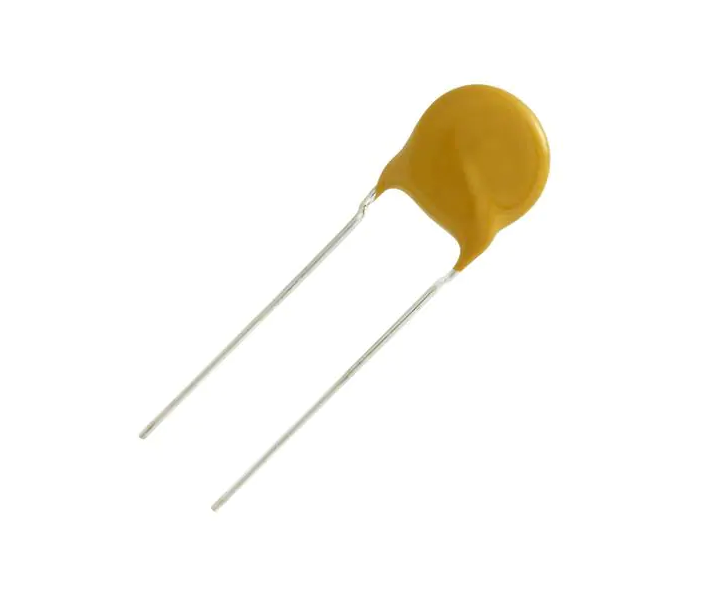

    贴片电容(MLCC) 径向 15pF ±5% 2KV N2200
564R2DF0Q15 数据手册
561R and 564R Series www.vishay.com Vishay Cera-Mite Lower Voltage Ceramic Singlelayer DC Disc Capacitors 1 kVDC to 3 kVDC Low Dissipation Factor FEATURES • Low losses • High stability • Low DF minimizes self heating at HF • Ideal for high switching to 100 kHz • Radial leads • Material categorization: for definitions of compliance please see www.vishay.com/doc?99912 APPLICATIONS • Switching power supplies • HF ballast QUICK REFERENCE DATA DESCRIPTION Ceramic Class 1 DESIGN C0G, N1500, N2000, N2200, N2500, N2800 Ceramic Dielectric Voltage (VDC) • Snubber and HV circuits VALUE 1000 2000 Min. Capacitance (pF) 10 10 10 Max. Capacitance (pF) 6800 6800 4700 Mounting 3000 Radial INSULATION RESISTANCE Min. 50 000 M TOLERANCE ON CAPACITANCE The capacitors consist of a ceramic disc of which both sides are silver-plated. Connection leads are made of tinned copper having diameters of 0.022" (0.51 mm) or 0.025" (0.64 mm). The capacitors may be supplied with radial kinked or straight leads having lead spacing of 0.250" (6.35 mm) or 0.375" (9.5 mm). The standard tolerances are ± 5 %, ± 10 %. Coating is made of flammable retardant epoxy resin in accordance with “UL 94 V-0”. ± 5 %, ± 10 % CAPACITANCE RANGE DISSIPATION FACTOR 10 pF to 6800 pF 0.1 % max. at 1 kHz; 1 V RATED VOLTAGE CATEGORY TEMPERATURE RANGE -55 °C to +125 °C 1000 VDC (500 VRMS) 2000 VDC (1000 VRMS) 3000 VDC (1500 VRMS) CLIMATIC CATEGORY ACC. TO EN 60068-1 DIELECTRIC STRENGTH BETWEEN LEADS 55/125/21 Component test, 100 % test at production line: OPERATING TEMPERATURE RANGE 1000 VDC 2000 VDC 3000 VDC -55 °C to +105 °C (1) Note (1) For explanation about the difference of operating temperature range and temperature characteristic of capacitance, please see www.vishay.com/doc?48299 Revision: 23-Jul-2021 2500 VDC, 2 s 4000 VDC, 2 s 6000 VDC, 2 s CERAMIC DIELECTRIC C0G, N1500, N2000, N2200, N2500, N2800 (Class 1) Document Number: 23115 1 For technical questions, contact: ceramitesupport@vishay.com THIS DOCUMENT IS SUBJECT TO CHANGE WITHOUT NOTICE. THE PRODUCTS DESCRIBED HEREIN AND THIS DOCUMENT ARE SUBJECT TO SPECIFIC DISCLAIMERS, SET FORTH AT www.vishay.com/doc?91000 561R and 564R Series www.vishay.com Vishay Cera-Mite DIMENSIONS in inches (millimeters) Fig. 1 1.250 min. (32) Dmax. LO LS Tinned Copper Leads Ø 0.187 (4.8) Tmax. ORDERING INFORMATION, CERAMIC 1 kVDC LOW DISSIPATION FACTOR C (pF) TOL. (%) Dmax. DIAMETER INCH (mm) Tmax. THICKNESS INCH (mm) ±5 0.250 (6.4) 0.156 (4.0) LO LS LEAD SPACE LEAD OFFSET INCH (mm) INCH (mm) ± 0.5 mm ± 1 mm WIRE SIZE FIG. AWG INCH (mm) 22 0.025 (0.64) ORDERING CODE C0G (NP0) 10 12 0.250 (6.4) 0.043 (1.1) 0.051 (1.3) 1 561R1DF0Q10 561R1DF0Q12 N1500 22 0.043 (1.1) 561R1DF0Q22 47 0.071 (1.8) 561R1DF0Q47 56 ±5 0.250 (6.4) 0.156 (4.0) 0.250 (6.4) 0.055 (1.4) 22 0.025 (0.64) 1 561R1DF0Q56 68 0.059 (1.5) 561R1DF0Q68 82 0.047 (1.2) 561R1DF0Q82 N2200 33 ± 10 0.250 (6.4) 0.156 (4.0) 0.250 (6.4) 0.043 (1.1) 22 0.025 (0.64) 1 561R1DF0Q33 N2000 100 0.059 (1.5) 120 0.055 (1.4) 150 ± 10 0.250 (6.4) 0.156 (4.0) 0.250 (6.4) 180 0.043 (1.1) 561R1DF0T10 22 0.025 (0.64) 1 0.043 (1.1) 561R1DF0T12 561R1DF0T15 561R1DF0T18 N2500 220 270 ± 10 0.250 (6.4) 0.156 (4.0) 0.250 (6.4) 0.059 (1.5) 0.043 (1.1) 22 0.025 (0.64) 1 561R1DF0T22 561R1DF0T27 N2800 330 0.047 (1.2) 0.250 (6.4) 390 470 560 0.290 (7.4) 680 820 1000 0.370 (9.4) 1200 1500 ± 10 0.156 (4.0) 0.250 (6.4) 561R1DF0T33 0.047 (1.2) 561R1DF0T39 0.059 (1.5) 561R1DF0T47 0.055 (1.4) 561R1DF0T56 0.047 (1.2) 561R1DF0T68 0.043 (1.1) 561R1DF0T82 0.055 (1.4) 561R1DF0D10 0.047 (1.2) 561R1DF0D12 0.405 (10.3) 0.047 (1.2) 1800 0.440 (11.2) 0.051 (1.3) 561R1DF0D18 2200 0.460 (11.7) 0.047 (1.2) 561R1DF0D22 2700 0.490 (12.4) 0.047 (1.2) 561R1DF0D27 3300 0.530 (13.5) 0.047 (1.2) 561R1DF0D33 3900 0.560 (14.2) 0.047 (1.2) 561R1DF0D39 4700 0.630 (16.0) 0.047 (1.2) 561R1DF0D47 5600 0.680 (17.3) 0.047 (1.2) 561R1DF0D56 6800 0.760 (19.3) 0.047 (1.2) 561R1DF0D68 Revision: 23-Jul-2021 0.156 (4.0) 0.375 (9.5) 22 0.025 (0.64) 1 561R1DF0D15 Document Number: 23115 2 For technical questions, contact: ceramitesupport@vishay.com THIS DOCUMENT IS SUBJECT TO CHANGE WITHOUT NOTICE. THE PRODUCTS DESCRIBED HEREIN AND THIS DOCUMENT ARE SUBJECT TO SPECIFIC DISCLAIMERS, SET FORTH AT www.vishay.com/doc?91000 561R and 564R Series www.vishay.com Vishay Cera-Mite ORDERING INFORMATION, CERAMIC 2 kVDC LOW DISSIPATION FACTOR C (pF) TOL. (%) Dmax. DIAMETER INCH (mm) Tmax. THICKNESS INCH (mm) LO LS LEAD SPACE LEAD OFFSET INCH (mm) INCH (mm) ± 0.5 mm ± 1 mm WIRE SIZE AWG INCH (mm) FIG. ORDERING CODE N1500 33 39 0.195 (5.0) ±5 0.290 (7.4) 47 0.180 (4.6) 0.098 (2.5) 0.250 (6.4) 0.170 (4.3) 0.083 (2.1) 564R2DF0Q33 20 0.032 (0.81) 1 0.071 (1.8) 564R2DF0Q39 564R2DF0Q47 N2000 56 0.210 (5.3) 0.110 (2.8) 564R2DF0Q56 68 0.190 (4.8) 0.091 (2.3) 564R2DF0Q68 82 ±5 0.290 (7.4) 100 0.175 (4.5) 0.250 (6.4) 0.170 (4.3) 0.075 (1.9) 20 0.032 (0.81) 1 0.071 (1.8) 564R2DF0Q82 564R2DF0T10 N2500 120 150 180 0.290 (7.4) ± 10 0.185 (4.7) 0.087 (2.2) 564R2DF0T12 0.170 (4.3) 0.071 (1.8) 564R2DF0T15 0.185 (4.7) 0.250 (6.4) 0.071 (1.8) 20 0.032 (0.81) 1 564R2DF0T18 270 0.330 (8.4) 0.170 (4.3) 0.079 (2.0) 564R2DF0T27 470 0.400 (10.2) 0.170 (4.3) 0.075 (1.9) 564R2DF0T47 220 0.290 (7.4) 0.170 (4.3) 0.087 (2.2) 564R2DF0T22 330 0.330 (8.4) 0.185 (4.7) 0.083 (2.1) 564R2DF0T33 N2800 390 0.330 (8.4) 0.175 (4.5) 0.075 (1.9) 564R2DF0T39 560 0.400 (10.2) 0.185 (4.7) 0.087 (2.2) 564R2DF0T56 680 0.400 (10.2) 0.170 (4.3) 0.075 (1.9) 564R2DF0T68 0.175 (4.5) 820 0.430 (10.9) 1000 0.460 (11.7) 1500 0.530 (13.5) 1800 0.560 (14.2) 2200 ± 10 2300 2400 0.680 (17.3) 0.250 (6.4) 0.170 (4.3) 0.075 (1.9) 564R2DF0T82 0.075 (1.9) 564R2DF0D10 0.071 (1.8) 564R2DF0D15 0.170 (4.3) 0.071 (1.8) 0.180 (4.6) 0.083 (2.1) 0.175 (4.5) 0.079 (2.0) 564R2DF0D23 0.175 (4.5) 0.075 (1.9) 564R2DF0D24 0.071 (1.8) 564R2DF0D27 0.071 (1.8) 564R2DF0D33 0.075 (1.9) 564R2DF0D39 2700 0.032 (0.81) 1 564R2DF0D18 564R2DF0D22 3300 0.720 (18.3) 3900 0.790 (20.1) 4700 0.900 (22.9) 0.180 (4.6) 0.083 (2.1) 564R2DF0D47 5600 0.900 (22.9) 0.170 (4.3) 0.075 (1.9) 564R2DF0D56 6800 0.950 (24.1) 0.170 (4.3) 0.071 (1.8) 564R2DF0D68 Revision: 23-Jul-2021 0.170 (4.3) 0.375 (9.5) 20 Document Number: 23115 3 For technical questions, contact: ceramitesupport@vishay.com THIS DOCUMENT IS SUBJECT TO CHANGE WITHOUT NOTICE. THE PRODUCTS DESCRIBED HEREIN AND THIS DOCUMENT ARE SUBJECT TO SPECIFIC DISCLAIMERS, SET FORTH AT www.vishay.com/doc?91000 561R and 564R Series www.vishay.com Vishay Cera-Mite ORDERING INFORMATION, CERAMIC 3 kVDC LOW DISSIPATION FACTOR C (pF) TOL. (%) Dmax. DIAMETER INCH (mm) Tmax. THICKNESS INCH (mm) LO LS LEAD SPACE LEAD OFFSET INCH (mm) INCH (mm) ± 0.5 mm ± 1 mm WIRE SIZE AWG INCH (mm) FIG. ORDERING CODE N1500 10 0.185 (4.7) 27 33 ±5 0.290 (7.4) 39 47 0.330 (8.4) 0.087 (2.2) 0.220 (5.6) 0.195 (5.0) 564R3DF0Q10 0.122 (3.1) 0.250 (6.4) 0.098 (2.5) 564R3DF0Q27 20 0.032 (0.81) 1 564R3DF0Q33 0.190 (4.8) 0.094 (2.4) 564R3DF0Q39 0.225 (5.7) 0.126 (3.2) 564R3DF0Q47 N2200 12 22 ±5 0.290 (7.4) 0.210 (5.3) 0.330 (8.4) 0.210 (5.3) 0.250 (6.4) 0.110 (2.8) 0.110 (2.8) 20 0.032 (0.81) 1 20 0.032 (0.81) 1 564R3DF0Q12 564R3DF0Q22 N2000 56 68 0.210 (5.3) ±5 0.290 (7.4) 82 0.190 (4.8) 0.110 (2.8) 0.250 (6.4) 0.098 (2.5) 564R3DF0Q56 564R3DF0Q68 0.185 (4.7) 0.091 (2.3) 564R3DF0Q82 0.290 (7.4) 0.205 (5.2) 0.106 (2.7) 564R3DF0T10 0.290 (7.4) 0.190 (4.8) 0.330 (8.4) 0.190 (4.8) N2500 100 120 ± 10 220 0.250 (6.4) 0.091 (2.3) 20 0.032 (0.81) 1 564R3DF0T12 0.091 (2.3) 564R3DF0T22 N2800 150 0.290 (7.4) 0.200 (5.1) 0.091 (2.3) 564R3DF0T15 180 0.290 (7.4) 0.190 (4.8) 0.091 (2.3) 564R3DF0T18 270 0.330 (8.4) 0.205 (5.2) 0.110 (2.8) 564R3DF0T27 330 0.330 (8.4) 0.190 (4.8) 0.091 (2.3) 564R3DF0T33 390 0.400 (10.2) 0.215 (5.5) 0.102 (2.6) 564R3DF0T39 470 0.400 (10.2) 0.195 (5.0) 0.087 (2.2) 564R3DF0T47 560 0.430 (10.9) 0.200 (5.1) 0.102 (2.6) 564R3DF0T56 680 0.460 (11.7) 0.195 (5.0) 0.087 (2.2) 564R3DF0T68 820 0.250 (6.4) 0.490 (12.5) 0.195 (5.0) 0.102 (2.6) 1000 0.530 (13.5) 0.190 (4.8) 0.091 (2.3) 564R3DF0D10 1200 0.560 (14.2) 0.091 (2.3) 564R3DF0D12 1500 0.620 (15.8) 0.091 (2.3) 564R3DF0D15 1800 0.680 (17.3) 0.098 (2.5) 564R3DF0D18 2200 0.720 (18.3) 0.094 (2.4) 564R3DF0D22 2700 0.790 (20.1) 0.190 (4.8) 0.087 (2.2) 564R3DF0D27 3300 0.900 (22.9) 0.200 (5.1) 0.102 (2.6) 564R3DF0D33 4700 0.950 (24.1) 0.185 (4.7) 0.087 (2.2) 564R3DF0D47 ± 10 0.190 (4.8) 0.375 (9.5) 20 0.032 (0.81) 1 564R3DF0T82 TAPE AND REEL OPTIONS Part number codes and specifications for tape and reel packaging are found in the general information document www.vishay.com/doc?23140. Revision: 23-Jul-2021 Document Number: 23115 4 For technical questions, contact: ceramitesupport@vishay.com THIS DOCUMENT IS SUBJECT TO CHANGE WITHOUT NOTICE. THE PRODUCTS DESCRIBED HEREIN AND THIS DOCUMENT ARE SUBJECT TO SPECIFIC DISCLAIMERS, SET FORTH AT www.vishay.com/doc?91000 561R and 564R Series www.vishay.com Vishay Cera-Mite CAPACITANCE CHANGE VS. TEMPERATURE (TYPICAL) Temperature Characteristics for 1DFO, 2DFO & 3DFO Series Percent Capacitance Change 15 % 10 % 5% 0% NP0 5% Temperature Characteristic 10 % Material ppm/°C Tol. N1500 NP0 0 ± 30 - 1500 ± 250 15 % N1500 N2000 N2000 - 2000 ± 500 N2200 N2200 - 2200 ± 500 N2500 20 % N2500 - 2500 ± 500 N2800 N2800 - 2800 ± 500 25 % - 35 - 25 -15 - 5 5 15 25 35 45 55 65 75 85 95 105 Temperature °C POWER RATING 1DFO Series 500 VRMS Low DF 2DFO Series 1000 VRMS Low DF 1100 550 150 pF 1DFOT15 500 270 pF 1DFOT27 400 350 390 pF 1DFOT39 300 1000 pF 1DFOD10 250 Voltage (VRMS) Voltage (VRMS) 1000 47 pF 2DFOQ47 900 450 2400 pF 1DFOD24 200 760 150 pF 2DFOT15 600 500 390 pF 2DFOT39 400 1800 pF 2DFOD18 300 6800 pF 1DFOD68 150 82 pF 2DFOQ82 800 200 100 6800 pF 2DFOD68 100 0 10 20 30 40 50 60 70 80 90 0 100 10 20 30 40 50 60 70 80 90 100 Frequency (kHz) Frequency (kHz) 3DFO Series 1500 VRMS Low DF 1600 22 pF 3DFOQ22 1400 39 pF 3DFOQ39 Voltage (VRMS) 1200 1000 68 pF 3DFOQ68 800 600 150 pF 3DFOT15 400 1000 pF 3DFOD10 4700 pF 3DFOD47 200 0 10 20 30 40 50 60 70 80 90 100 Frequency (kHz) Notes • Power ratings are based on still air 60 °C ambient with additional 30 °C rise due to self heating. Thermal effects such as forced air cooling, component encapsulation or other heat-sinking techniques will alter ratings. Actual circuit for application recommended • For convenience, power rating charts are shown to 100 kHz. Higher frequency operation is permissible with appropriate derating. Consult us for application suggestions Revision: 23-Jul-2021 Document Number: 23115 5 For technical questions, contact: ceramitesupport@vishay.com THIS DOCUMENT IS SUBJECT TO CHANGE WITHOUT NOTICE. THE PRODUCTS DESCRIBED HEREIN AND THIS DOCUMENT ARE SUBJECT TO SPECIFIC DISCLAIMERS, SET FORTH AT www.vishay.com/doc?91000 561R and 564R Series www.vishay.com Vishay Cera-Mite STORAGE The capacitors must not be stored in a corrosive atmosphere, where sulphide or chloride gas, acid, alkali or salt are present. Exposure of the components to moisture, should be avoided. The solderability of the leads is not affected by storage of up to 24 months (temperature +10 °C to +40 °C, relative humidity up to 60 % RH). Class 2 ceramic dielectric capacitors are also subject to aging see general information (www.vishay.com/doc?23140). SOLDERING SOLDERING SPECIFICATIONS Soldering test for capacitors with wire leads: (according to IEC 60068-2-20, solder bath method) Soldering temperature Soldering duration Distance from component body SOLDERABILITY RESISTANCE TO SOLDERING HEAT (235 ± 5) °C (260 ± 5) °C (2 ± 0.5) s (10 ± 1) s  2 mm  5 mm SOLDERING RECOMMENDATIONS Ceramic capacitors are very sensitive to rapid changes in temperature (thermal shock) therefore the solder heat resistance specification (see table above) should not be exceeded. Exposing the capacitor to excessive heating may result in thermal shocks that can crack the ceramic body. Similarly, excessive heating can cause the internal solder junction to melt. When soldering radial leaded ceramic capacitors with a soldering iron, it should be performed under the following conditions and should not exceed: • Maximum temperature of iron-tip: 400 °C • Maximum soldering iron wattage: 50 W • Maximum soldering time: 3.5 s Failure to follow the above cautions may result, in worst case, in short circuit or cause fuming or thermo-mechanical damage when the product is used. Leaded ceramic capacitors are not designed for reflow process or dipping the body into a solder melt. CLEANING The components should be cleaned immediately following the soldering operation with vapor degreasers. CLEANING (ULTRASONIC CLEANING) To perform ultrasonic cleaning, observe the following conditions: • Maximum rinse bath capacity output: 20 W/liter • Maximum rinsing time: 300 s • Do not vibrate the PCB/PWB directly • Excessive ultrasonic cleaning may lead to mechanical damage SOLVENT RESISTANCE The coating and marking of the capacitors are resistant to the following test method: IEC 60068-2-45 (method XA) MOUNTING We do not recommend modifying the lead terminals, e.g. bending or cropping. This action could break the coating or crack the ceramic insert. In order to avoid such failures we are offering different lead wire designs (e.g. straight, inline, inside crimp, outside crimp etc.) If however, the lead must be modified in any way, we recommend support of the lead with a clamping fixture next to the coating. If a defined product stop is required for mounting on a PCB, a mechanically formed product stop or a mounting tool should be used. OPERATING VOLTAGE In case the voltage is applied to the circuit, starting as well as stopping, may generate irregular voltage for a transit period because of resonance or switching. Be sure to use a capacitor with a rated voltage range that includes these irregular voltages. RELATED DOCUMENTS General Information Revision: 23-Jul-2021 www.vishay.com/doc?23140 Document Number: 23115 6 For technical questions, contact: ceramitesupport@vishay.com THIS DOCUMENT IS SUBJECT TO CHANGE WITHOUT NOTICE. THE PRODUCTS DESCRIBED HEREIN AND THIS DOCUMENT ARE SUBJECT TO SPECIFIC DISCLAIMERS, SET FORTH AT www.vishay.com/doc?91000 Legal Disclaimer Notice www.vishay.com Vishay Disclaimer ALL PRODUCT, PRODUCT SPECIFICATIONS AND DATA ARE SUBJECT TO CHANGE WITHOUT NOTICE TO IMPROVE RELIABILITY, FUNCTION OR DESIGN OR OTHERWISE. Vishay Intertechnology, Inc., its affiliates, agents, and employees, and all persons acting on its or their behalf (collectively, “Vishay”), disclaim any and all liability for any errors, inaccuracies or incompleteness contained in any datasheet or in any other disclosure relating to any product. Vishay makes no warranty, representation or guarantee regarding the suitability of the products for any particular purpose or the continuing production of any product. To the maximum extent permitted by applicable law, Vishay disclaims (i) any and all liability arising out of the application or use of any product, (ii) any and all liability, including without limitation special, consequential or incidental damages, and (iii) any and all implied warranties, including warranties of fitness for particular purpose, non-infringement and merchantability. Statements regarding the suitability of products for certain types of applications are based on Vishay's knowledge of typical requirements that are often placed on Vishay products in generic applications. Such statements are not binding statements about the suitability of products for a particular application. It is the customer's responsibility to validate that a particular product with the properties described in the product specification is suitable for use in a particular application. Parameters provided in datasheets and / or specifications may vary in different applications and performance may vary over time. All operating parameters, including typical parameters, must be validated for each customer application by the customer's technical experts. Product specifications do not expand or otherwise modify Vishay's terms and conditions of purchase, including but not limited to the warranty expressed therein. Hyperlinks included in this datasheet may direct users to third-party websites. These links are provided as a convenience and for informational purposes only. Inclusion of these hyperlinks does not constitute an endorsement or an approval by Vishay of any of the products, services or opinions of the corporation, organization or individual associated with the third-party website. Vishay disclaims any and all liability and bears no responsibility for the accuracy, legality or content of the third-party website or for that of subsequent links. Except as expressly indicated in writing, Vishay products are not designed for use in medical, life-saving, or life-sustaining applications or for any other application in which the failure of the Vishay product could result in personal injury or death. Customers using or selling Vishay products not expressly indicated for use in such applications do so at their own risk. Please contact authorized Vishay personnel to obtain written terms and conditions regarding products designed for such applications. No license, express or implied, by estoppel or otherwise, to any intellectual property rights is granted by this document or by any conduct of Vishay. Product names and markings noted herein may be trademarks of their respective owners. © 2021 VISHAY INTERTECHNOLOGY, INC. ALL RIGHTS RESERVED Revision: 09-Jul-2021 1 Document Number: 91000
