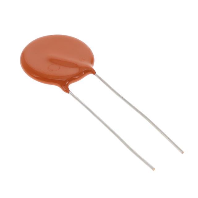

    0.02 µF ±20% 2000V(2kV) 陶瓷电容器 Z5U 径向,圆片式
564RZ5UAA202EP203M 数据手册
564R and 565R Series www.vishay.com Vishay Cera-Mite Lower Voltage Ceramic Singlelayer DC Disc Capacitors 2 kVDC to 7.5 kVDC FEATURES • Low losses • High capacitance in small sizes • High stability • Radial leads • Material categorization: for definitions of compliance please see www.vishay.com/doc?99912 APPLICATIONS • Lighting ballasts • SMPS • DC and pulse high voltage QUICK REFERENCE DATA DESCRIPTION Ceramic class DESIGN VALUE 1 Ceramic dielectric U2J, R3L C0G, U2J, R3L X7R, Y5S, Y5U, Z5U, Y5V Voltage (VDC) Min. capacitance (pF) Max. capacitance (pF) Mounting 3000 6000 2000 2 X5F, X5R, X5S, X7R, Y5S, Y5U, Z5U 3000 100 47 10 10 33 47 X5F, X5S, Y5U, Z5U X5F, Y5U, Z5U 6000 7500 100 100 100 000 33 000 10 000 2500 Radial INSULATION RESISTANCE 2 kVDC 3 kVDC 6 kVDC 7.5 kVDC min. 10 000 MΩ min. 50 000 MΩ (1) min. 75 000 MΩ min. 200 000 MΩ Note (1) Exemption: 565R30GASS33 min. 25 000 MΩ TOLERANCE ON CAPACITANCE The capacitors consist of a ceramic disc of which both sides are silver-plated. Connection leads are made of tinned copper having diameters of 0.025" (0.64 mm) or 0.032" (0.81 mm). The capacitors may be supplied with radial kinked or straight leads having lead spacing of 0.250" (6.35 mm) or 0.375" (9.5 mm) or 0.500" (12.7 mm). The standard tolerances are ± 10 % or ± 20 %. Coating is made of resin coating or flame retardant epoxy resin in accordance with “UL 94 V-0”. CAPACITANCE RANGE 10 pF to 0.10 μF RATED VOLTAGE 2 kVDC 3 kVDC 6 kVDC 7.5 kVDC DIELECTRIC STRENGTH BETWEEN LEADS Class 1: 0.2 % max. at 1 MHz; 1 V Class 2: 2.0 % max. at 1 kHz; 1 V Component test, 100 % test at product line: 2 kVDC 3600 VDC, 2 s 5000 VDC, 2 s 3 kVDC 6 kVDC 10 500 VDC, 2 s 11 250 VDC, 2 s 7.5 kVDC CATEGORY TEMPERATURE RANGE CERAMIC DIELECTRIC ± 10 %, ± 20 %, -20 % to +80 % DISSIPATION FACTOR -25 °C to +85 °C CLIMATIC CATEGORY ACC. TO EN 60068-1 C0G, U2J, R3L (Class 1) X7R, X5F, X5S, Y5S, Y5U, Y5V, Z5U (Class 2) 25/085/21 OPERATING TEMPERATURE RANGE -25 °C to +105 °C (1) Note (1) For explanation about the difference of operating temperature range and temperature characteristic of capacitance, please see www.vishay.com/doc?48299 Revision: 09-Aug-2021 Document Number: 23118 1 For technical questions, contact: ceramitesupport@vishay.com THIS DOCUMENT IS SUBJECT TO CHANGE WITHOUT NOTICE. THE PRODUCTS DESCRIBED HEREIN AND THIS DOCUMENT ARE SUBJECT TO SPECIFIC DISCLAIMERS, SET FORTH AT www.vishay.com/doc?91000 564R and 565R Series www.vishay.com Vishay Cera-Mite DIMENSIONS in inches (millimeters) 1.250 min. (32) Dmax. LO LS Tinned copper leads Ø Tmax. ORDERING INFORMATION, CERAMIC 2 kVDC C (pF) TOL. (%) Dmax. DIAMETER INCH (mm) Tmax. THICKNESS INCH (mm) LO LS LEAD SPACE LEAD OFFSET INCH (mm) INCH (mm) ± 0.5 mm ± 1 mm WIRE SIZE AWG INCH (mm) ORDERING CODE X7R 0.190 (4.8) 100 220 0.180 (4.6) 330 0.330 (8.4) 470 560 0.185 (4.7) 680 1000 0.170 (4.3) ± 10 0.400 (10.2) 1500 0.175 (4.4) 0.250 (6.4) 0.160 (4.1) 1800 0.460 (11.7) 2200 3300 0.530 (13.5) 3900 0.170 (4.3) 0.680 (17.3) 4700 0.375 (9.5) 0.075 (1.9) 564R20TST10 0.071 (1.8) 564R20TST22 0.075 (1.9) 564R20TST33 0.063 (1.6) 564R20TST47 0.087 (2.2) 564R20TST56 0.075 (1.9) 564R20TST68 0.083 (2.1) 20 0.032 (0.81) 564R20TSD10 0.063 (1.6) 564R20TSD15 0.055 (1.4) 564R20TSD18 0.067 (1.7) 564R20TSD22 0.063 (1.6) 564R20TSD33 0.075 (1.9) 564R20TSD39 0.071 (1.8) 564R20TSD47 0.067 (1.7) 564R20TSSD10 Y5S 1000 2200 0.330 (8.4) ± 20 0.175 (4.4) 0.460 (11.7) 0.170 (4.3) 0.790 (20.0) 0.190 (4.8) 0.330 (8.4) 0.170 (4.3) 0.330 (8.4) 0.170 (4.3) 1800 0.360 (9.1) 0.170 (4.3) 2200 0.400 (10.2) 5600 0.250 (6.4) 0.375 (9.5) 0.071 (1.8) 20 0.032 (0.81) 0.091 (2.3) 564R20TSSD22 564R20TSSD56 Y5U 1000 1500 ± 20 0.250 (6.4) 0.067 (1.7) 0.071 (1.8) 20 0.032 (0.81) 564R20GAD10 564R20GAD15 Z5U 3300 ± 20 0.430 (10.9) 4700 0.530 (13.5) 6800 0.560 (14.2) 0.175 (4.4) 0.170 (4.3) 0.250 (6.4) 0.375 (9.5) 0.071 (1.8) 564R20GAD18 0.075 (1.9) 564R20GAD22 0.071 (1.8) 20 0.032 (0.81) 564R20GAD33 0.075 (1.9) 564R20GAD47 0.067 (1.7) 564R20GAD68 Y5V 0.01 μF 0.05 μF 0.620 (15.7) ± 20 0.10 μF Revision: 09-Aug-2021 0.170 (4.3) 0.950 (24.1) 0.174 (4.4) 0.950 (24.1) 0.240 (6.1) 0.067 (1.7) 0.375 (9.5) 20 0.067 (1.7) 20 0.067 (1.7) 22 0.032 (0.81) 0.025 (0.64) 564R20GASS10 564R20GAS50 565R20GAP10 Document Number: 23118 2 For technical questions, contact: ceramitesupport@vishay.com THIS DOCUMENT IS SUBJECT TO CHANGE WITHOUT NOTICE. THE PRODUCTS DESCRIBED HEREIN AND THIS DOCUMENT ARE SUBJECT TO SPECIFIC DISCLAIMERS, SET FORTH AT www.vishay.com/doc?91000 564R and 565R Series www.vishay.com Vishay Cera-Mite ORDERING INFORMATION, CERAMIC 3 kVDC C (pF) U2J (N750) 10 R3L (N2200) 22 27 33 X5F 56 68 270 X5R 330 X5S 470 X7R 47 100 150 220 390 680 1000 1500 1800 2200 2700 3300 3900 4700 6800 Y5S 1000 1500 1800 2200 2700 3300 3900 4700 5600 6800 Y5U 680 0.010 μF Z5U 1000 1500 1800 2200 2700 3300 3900 4700 6800 8200 0.020 μF 0.033 μF TOL. (%) Dmax. DIAMETER INCH (mm) Tmax. THICKNESS INCH (mm) LS LEAD SPACE INCH (mm) ± 1 mm LO LEAD OFFSET INCH (mm) ± 0.5 mm AWG INCH (mm) ± 20 0.330 (8.4) 0.210 (5.3) 0.250 (6.4) 0.110 (2.8) 20 0.032 (0.81) 564R30GAQ10 ± 20 0.330 (8.4) 0.200 (5.1) 0.190 (4.8) 0.170 (4.3) 0.250 (6.4) 0.102 (2.6) 0.091 (2.3) 0.071 (1.8) 20 0.032 (0.81) 564R30GAQ22 564R30GAQ27 564R30GAQ33 ± 20 0.330 (8.4) 0.190 (4.8) 0.200 (5.1) 0.180 (4.6) 0.250 (6.4) 0.091 (2.3) 0.102 (2.6) 0.083 (2.1) 20 0.032 (0.81) 564R30GAQ56 564R30GAQ68 564R30GAT27 ± 20 0.330 (8.4) 0.175 (4.4) 0.250 (6.4) 0.075 (1.9) 20 0.032 (0.81) 564R30GAT33 ± 20 0.330 (8.4) 0.175 (4.4) 0.250 (6.4) 0.075 (1.9) 20 0.032 (0.81) 564R30GAT47 0.250 (6.4) 0.130 (3.3) 0.083 (2.1) 0.091 (2.3) 0.075 (1.9) 0.083 (2.1) 0.079 (2.0) 0.032 (0.81) 564R30GAQ47 564R30GAT10 564R30GAT15 564R30GAT22 564R30GAT39 564R30TST68 564R30TSD10 564R30TSD15 564R30TSD18 564R30TSD22 564R30TSD27 564R30TSD33 564R30TSD39 564R30TSD47 564R30TSD68 20 0.032 (0.81) 564R30TSSD10 564R30TSSD15 564R30TSSD18 564R30TSSD22 564R30TSSD27 564R30TSSD33 564R30TSSD39 564R30TSSD47 564R30TSSD56 564R30TSSD68 20 0.032 (0.81) 564R30GAT68 564R30GAS10 ± 20 0.330 (8.4) 0.230 (5.8) 0.180 (4.6) 0.190 (4.8) 0.175 (4.4) 0.400 (10.2) 0.490 (12.5) 0.530 (13.5) ± 10 0.620 (15.7) 0.720 (18.3) 0.900 (22.9) ± 20 0.400 (10.2) 0.460 (11.7) 0.490 (12.4) 0.530 (13.5) 0.560 (14.2) 0.620 (15.7) 0.180 (4.6) 0.190 (4.8) 0.180 (4.6) 0.185 (4.7) 0.170 (4.3) 0.185 (4.7) 0.175 (4.4) 0.185 (4.7) ± 20 Revision: 09-Aug-2021 0.375 (9.5) 20 0.087 (2.2) 0.079 (2.0) 0.083 (2.1) 0.075 (1.9) 0.087 (2.2) 0.075 (1.9) 0.087 (2.2) 0.098 (2.5) 0.190 (4.8) 0.250 (6.4) 0.091 (2.3) 0.087 (2.2) 0.083 (2.1) 0.087 (2.2) 0.185 (4.7) 0.680 (17.3) ± 20 0.091 (2.3) 0.185 (4.7) WIRE SIZE 0.375 (9.5) 0.790 (20.0) 0.900 (22.9) 0.190 (4.8) 0.205 (5.2) 0.330 (8.4) 0.720 (18.3) 0.175 (4.4) 0.185 (4.7) 0.330 (8.4) 0.360 (9.1) 0.400 (10.2) 0.430 (10.9) 0.460 (11.7) 0.195 (5.0) 0.190 (4.8) 0.530 (13.5) 0.185 (4.7) 0.620 (15.7) 0.195 (5.0) 0.720 (18.3) 0.200 (5.1) 0.720 (18.3) 0.900 (22.9) 0.265 (6.7) 0.240 (6.1) 0.091 (2.3) 0.102 (2.6) 0.250 (6.4) 0.375 (9.5) 0.075 (1.9) 0.091 (2.3) 0.250 (6.4) 0.098 (2.5) 0.091 (2.3) 0.098 (2.5) 0.091 (2.3) 0.098 (2.5) 0.087 (2.2) 0.200 (5.1) 20 0.032 (0.81) 22 22 0.025 (0.64) 0.025 (0.64) 0.091 (2.3) 0.375 (9.5) 0.102 (2.6) 0.087 (2.2) 0.087 (2.2) ORDERING CODE 564R30GAD10 564R30GAD15 564R30GAD18 564R30GAD22 564R30GAD27 564R30GAD33 564R30GAD39 564R30GAD47 564R30GAD68 564R30GAD82 565R30GASS20 565R30GASS33 Document Number: 23118 3 For technical questions, contact: ceramitesupport@vishay.com THIS DOCUMENT IS SUBJECT TO CHANGE WITHOUT NOTICE. THE PRODUCTS DESCRIBED HEREIN AND THIS DOCUMENT ARE SUBJECT TO SPECIFIC DISCLAIMERS, SET FORTH AT www.vishay.com/doc?91000 564R and 565R Series www.vishay.com Vishay Cera-Mite ORDERING INFORMATION, CERAMIC 6 kVDC C (pF) TOL. (%) Dmax. DIAMETER INCH (mm) Tmax. THICKNESS INCH (mm) LS LEAD SPACE INCH (mm) ± 1 mm LO LEAD OFFSET INCH (mm) ± 0.5 mm ± 20 0.400 (10.2) 0.220 (5.6) 0.375 (9.5) ± 20 0.460 (11.7) 0.240 (6.1) 0.375 (9.5) 0.230 (5.8) 0.375 (9.5) WIRE SIZE ORDERING CODE AWG INCH (mm) 0.122 (3.1) 20 0.032 (0.81) 564R60GAQ10 0.142 (3.6) 20 0.032 (0.81) 564R60GAQ22 20 0.032 (0.81) 20 0.032 (0.81) 20 0.032 (0.81) 20 0.032 (0.81) C0G (NP0) 10 U2J (N750) 22 R3L (N2200) 33 47 ± 20 0.400 (10.2) 0.460 (11.7) 0.130 (3.3) 0.126 (3.2) 564R60GAQ33 564R60GAQ47 X5F 100 220 ± 20 0.400 (10.2) ± 20 0.400 (10.2) ± 20 0.400 (10.2) 0.240 (6.1) 0.265 (6.7) 0.375 (9.5) 0.142 (3.6) 0.165 (4.2) 564R60GAT10 564R60GAT22 X5S 330 0.260 (6.6) 0.375 (9.5) 0.161 (4.1) 564R60GAT33 Y5U 470 560 0.290 (7.4) 0.240 (6.1) 0.375 (9.5) 0.193 (4.9) 0.142 (3.6) 564R60GAT47 564R60GAT56 Z5U 1000 0.400 (10.2) 0.270 (6.9) 0.173 (4.4) 564R60GAD10 1500 0.460 (11.7) 0.280 (7.1) 0.157 (4.0) 564R60GAD15 0.530 (13.5) 0.240 (6.1) 2200 3300 ± 20 0.620 (15.7) 4700 0.790 (20.0) 0.010 μF 0.950 (24.1) 0.375 (9.5) 0.260 (6.6) 0.250 (6.4) 0.142 (3.6) 0.169 (4.3) 20 0.032 (0.81) 564R60GAD22 564R60GAD33 0.161 (4.1) 564R60GAD47 0.150 (3.8) 564R60GAS10 ORDERING INFORMATION, CERAMIC 7.5 kVDC C (pF) TOL. (%) Dmax. DIAMETER INCH (mm) Tmax. THICKNESS INCH (mm) LS LEAD SPACE INCH (mm) ± 1 mm LO LEAD OFFSET INCH (mm) ± 0.5 mm WIRE SIZE AWG INCH (mm) 20 0.032 (0.81) ORDERING CODE X5F 100 470 0.530 (13.5) 0.310 (7.9) 0.620 (15.7) 0.270 (6.9) + 80 / - 20 0.620 (15.7) 0.320 (8.1) 0.500 (12.7) 0.181 (4.6) 20 0.032 (0.81) 564R75GAD10 + 80 / - 20 0.620 (15.7) 0.280 (7.1) 0.500 (12.7) 0.181 (4.6) 20 0.032 (0.81) 564R75GAD25 ± 20 0.500 (12.7) 0.181 (4.6) 0.161 (4.1) 564R75GAT10 564R75GAT47 Y5U 1000 Z5U 2500 TAPE AND REEL OPTIONS Part number codes and specifications for tape and reel packaging are found in the general information document www.vishay.com/doc?23140. Revision: 09-Aug-2021 Document Number: 23118 4 For technical questions, contact: ceramitesupport@vishay.com THIS DOCUMENT IS SUBJECT TO CHANGE WITHOUT NOTICE. THE PRODUCTS DESCRIBED HEREIN AND THIS DOCUMENT ARE SUBJECT TO SPECIFIC DISCLAIMERS, SET FORTH AT www.vishay.com/doc?91000 564R and 565R Series www.vishay.com Vishay Cera-Mite CAPACITANCE CHANGE VS. TEMPERATURE (TYPICAL) Axis Title Axis Title 10 50 10000 NP0 0 100 -5 10 -55 -35 -15 5 25 45 65 20 1000 10 0 N2200 -10 -20 100 -30 -40 -50 Temperature dependence of the capacitance -10 30 10 -60 -55 -35 -15 85 105 125 5 Temperature (°C) 45 65 85 105 125 Axis Title Axis Title 30 10000 10000 10 1000 5 X5F 0 -5 100 -10 -15 10 -55 -35 -15 5 25 45 65 15 10 1000 5 X7R 0 -5 -10 100 -15 -20 -25 Temperature dependence of the capacitance -20 20 Temperature dependence of the capacitance 10 -30 -55 -35 -15 85 105 125 Temperature (°C) 5 Axis Title 1000 1st line 2nd line 5 0 -5 -10 100 -15 -20 -25 10 -30 65 Temperature (°C) Revision: 09-Aug-2021 85 105 125 10000 40 20 Y5U Y5V 1000 0 1st line 2nd line Y5S 2nd line Capacitance Change ΔC/C (%) 15 45 85 105 125 Temperature dependence of the capacitance 20 25 65 Axis Title Temperature dependence of the capacitance 5 45 60 10000 -55 -35 -15 25 Temperature (°C) 30 10 1st line 2nd line 15 2nd line Capacitance Change ΔC/C (%) 25 1st line 2nd line 2nd line Capacitance Change ΔC/C (%) 25 Temperature (°C) 20 2nd line Capacitance Change ΔC/C (%) 1st line 2nd line 1000 2nd line Capacitance Change ΔC/C (%) 5 25 10000 40 1st line 2nd line 2nd line Capacitance Change ΔC/C (%) N750 Temperature dependence of the capacitance -20 -40 100 -60 -80 10 -100 -55 -35 -15 5 25 45 65 85 105 125 Temperature (°C) Document Number: 23118 5 For technical questions, contact: ceramitesupport@vishay.com THIS DOCUMENT IS SUBJECT TO CHANGE WITHOUT NOTICE. THE PRODUCTS DESCRIBED HEREIN AND THIS DOCUMENT ARE SUBJECT TO SPECIFIC DISCLAIMERS, SET FORTH AT www.vishay.com/doc?91000 564R and 565R Series www.vishay.com Vishay Cera-Mite Axis Title 10000 60 40 Z5U 20 1000 0 1st line 2nd line 2nd line Capacitance Change ΔC/C (%) Temperature dependence of the capacitance -20 -40 100 -60 -80 10 -100 -15 5 25 45 65 85 105 125 Temperature (°C) STORAGE The capacitors must not be stored in a corrosive atmosphere, where sulphide or chloride gas, acid, alkali or salt are present. Exposure of the components to moisture, should be avoided. The solderability of the leads is not affected by storage of up to 24 months (temperature +10 °C to +40 °C, relative humidity up to 60 % RH). Class 2 ceramic dielectric capacitors are also subject to aging see general information (www.vishay.com/doc?23140). SOLDERING SOLDERING SPECIFICATIONS Soldering test for capacitors with wire leads: (according to IEC 60068-2-20, solder bath method) Soldering temperature Soldering duration Distance from component body SOLDERABILITY RESISTANCE TO SOLDERING HEAT (235 ± 5) °C (260 ± 5) °C (2 ± 0.5) s (10 ± 1) s ≥ 2 mm ≥ 5 mm SOLDERING RECOMMENDATIONS Ceramic capacitors are very sensitive to rapid changes in temperature (thermal shock) therefore the solder heat resistance specification (see table above) should not be exceeded. Exposing the capacitor to excessive heating may result in thermal shocks that can crack the ceramic body. Similarly, excessive heating can cause the internal solder junction to melt. When soldering radial leaded ceramic capacitors with a soldering iron, it should be performed under the following conditions and should not exceed: • Maximum temperature of iron-tip: 400 °C • Maximum soldering iron wattage: 50 W • Maximum soldering time: 3.5 s Failure to follow the above cautions may result, in worst case, in short circuit or cause fuming or thermo-mechanical damage when the product is used. Leaded ceramic capacitors are not designed for reflow process or dipping the body into a solder melt. CLEANING The components should be cleaned immediately following the soldering operation with vapor degreasers. CLEANING (ULTRASONIC CLEANING) To perform ultrasonic cleaning, observe the following conditions: • Maximum rinse bath capacity output: 20 W/liter • Maximum rinsing time: 300 s • Do not vibrate the PCB/PWB directly • Excessive ultrasonic cleaning may lead to mechanical damage Revision: 09-Aug-2021 Document Number: 23118 6 For technical questions, contact: ceramitesupport@vishay.com THIS DOCUMENT IS SUBJECT TO CHANGE WITHOUT NOTICE. THE PRODUCTS DESCRIBED HEREIN AND THIS DOCUMENT ARE SUBJECT TO SPECIFIC DISCLAIMERS, SET FORTH AT www.vishay.com/doc?91000 564R and 565R Series www.vishay.com Vishay Cera-Mite SOLVENT RESISTANCE The coating and marking of the capacitors are resistant to the following test method: IEC 60068-2-45 (method XA) MOUNTING We do not recommend modifying the lead terminals, e.g. bending or cropping. This action could break the coating or crack the ceramic insert. In order to avoid such failures we are offering different lead wire designs (e.g. straight, inline, inside crimp, outside crimp etc.) If however, the lead must be modified in any way, we recommend support of the lead with a clamping fixture next to the coating. If a defined product stop is required for mounting on a PCB, a mechanically formed product stop or a mounting tool should be used. OPERATING VOLTAGE In case the voltage is applied to the circuit, starting as well as stopping, may generate irregular voltage for a transit period because of resonance or switching. Be sure to use a capacitor with a rated voltage range that includes these irregular voltages. OPERATING TEMPERATURE AND SELF-GENERATED HEAT Keep the surface temperature of a capacitor below the upper limit of its rated operating temperature range. Be sure to take into account the heat generated by the capacitor itself. When the capacitor is used in a high frequency, pulse, or similar application, it may have self-generated heat due to dielectric dissipation. Temperature increase due to self-generated heating should not exceed 20 °C while operating at an atmosphere temperature of 25 °C. When measuring, the surface temperature, make sure that the capacitor is not affected by radiant, conductive and convective heat by its surroundings. Excessive heat may lead to thermo-mechanical deterioration of the capacitor's characteristics and reliability. RELATED DOCUMENTS General Information Revision: 09-Aug-2021 www.vishay.com/doc?23140 Document Number: 23118 7 For technical questions, contact: ceramitesupport@vishay.com THIS DOCUMENT IS SUBJECT TO CHANGE WITHOUT NOTICE. THE PRODUCTS DESCRIBED HEREIN AND THIS DOCUMENT ARE SUBJECT TO SPECIFIC DISCLAIMERS, SET FORTH AT www.vishay.com/doc?91000 Legal Disclaimer Notice www.vishay.com Vishay Disclaimer ALL PRODUCT, PRODUCT SPECIFICATIONS AND DATA ARE SUBJECT TO CHANGE WITHOUT NOTICE TO IMPROVE RELIABILITY, FUNCTION OR DESIGN OR OTHERWISE. Vishay Intertechnology, Inc., its affiliates, agents, and employees, and all persons acting on its or their behalf (collectively, “Vishay”), disclaim any and all liability for any errors, inaccuracies or incompleteness contained in any datasheet or in any other disclosure relating to any product. Vishay makes no warranty, representation or guarantee regarding the suitability of the products for any particular purpose or the continuing production of any product. To the maximum extent permitted by applicable law, Vishay disclaims (i) any and all liability arising out of the application or use of any product, (ii) any and all liability, including without limitation special, consequential or incidental damages, and (iii) any and all implied warranties, including warranties of fitness for particular purpose, non-infringement and merchantability. Statements regarding the suitability of products for certain types of applications are based on Vishay's knowledge of typical requirements that are often placed on Vishay products in generic applications. Such statements are not binding statements about the suitability of products for a particular application. It is the customer's responsibility to validate that a particular product with the properties described in the product specification is suitable for use in a particular application. Parameters provided in datasheets and / or specifications may vary in different applications and performance may vary over time. All operating parameters, including typical parameters, must be validated for each customer application by the customer's technical experts. Product specifications do not expand or otherwise modify Vishay's terms and conditions of purchase, including but not limited to the warranty expressed therein. Hyperlinks included in this datasheet may direct users to third-party websites. These links are provided as a convenience and for informational purposes only. Inclusion of these hyperlinks does not constitute an endorsement or an approval by Vishay of any of the products, services or opinions of the corporation, organization or individual associated with the third-party website. Vishay disclaims any and all liability and bears no responsibility for the accuracy, legality or content of the third-party website or for that of subsequent links. Except as expressly indicated in writing, Vishay products are not designed for use in medical, life-saving, or life-sustaining applications or for any other application in which the failure of the Vishay product could result in personal injury or death. Customers using or selling Vishay products not expressly indicated for use in such applications do so at their own risk. Please contact authorized Vishay personnel to obtain written terms and conditions regarding products designed for such applications. No license, express or implied, by estoppel or otherwise, to any intellectual property rights is granted by this document or by any conduct of Vishay. Product names and markings noted herein may be trademarks of their respective owners. © 2023 VISHAY INTERTECHNOLOGY, INC. ALL RIGHTS RESERVED Revision: 01-Jan-2023 1 Document Number: 91000
564RZ5UAA202EP203M
物料型号:564R和565R系列
器件简介:这些是低压陶瓷电容器,具有从2 kVDC到7.5 kVDC的额定电压。
引脚分配:电容器具有径向引脚,引脚间距有0.250" (6.35 mm)、0.375" (9.5 mm)或0.500" (12.7 mm)的选项。
参数特性: - 绝缘电阻:最小2 kVDC 10,000 MΩ起 - 电容公差:±10%, ±20%, -20%至+80% - 耗散因数:Class 1最大0.2%(1 MHz, 1 V),Class 2最大2.0%(1 kHz, 1 V) - 工作温度范围:-25°C至+105°C - 气候类别:根据EN 60068-1 25/085/21
功能详解: - 低损耗 - 小尺寸下高电容 - 高稳定性 - 径向引线 - 材料分类:符合性定义请见www.vishay.com/doc?99912
应用信息: - 照明镇流器 - 交换式电源供应器(SMPS) - 直流和脉冲高压
封装信息: - 电容器由陶瓷圆盘构成,两面都镀有银 - 连接引线由直径为0.025" (0.64 mm)或0.032" (0.81 mm)的镀锡铜制成 - 标准公差为±10%或±20% - 涂层为树脂涂层或符合“UL 94 V-0”的阻燃环氧树脂
