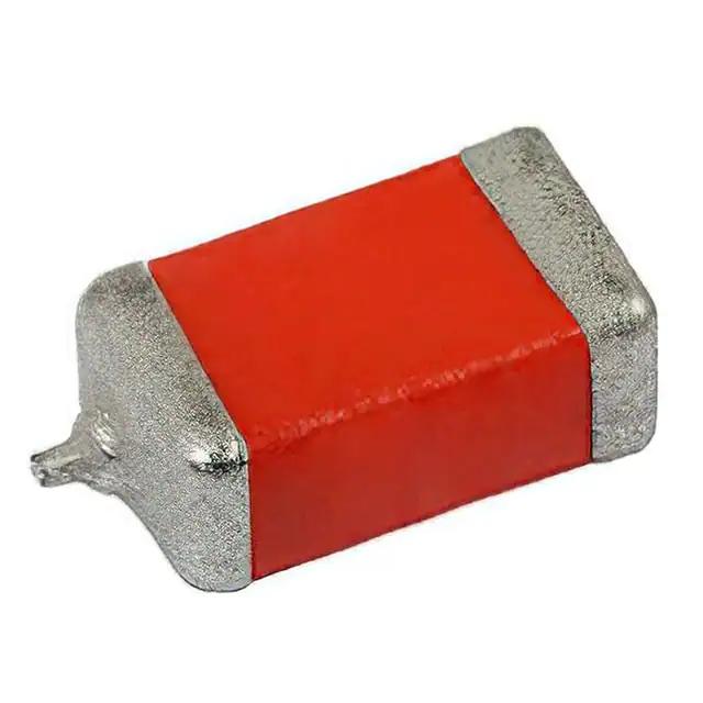

695D www.vishay.com Vishay Sprague Solid Tantalum Chip Capacitors, TANTAMOUNT™, Conformal Coated FEATURES • Pad compatible with MIL-PRF-55365/4 (CWR06) 194D and Available • 8 mm, 12 mm 16 mm tape to EIA-481 and reeling per IEC 286-3. 7" [178 mm] standard 13" [330 mm] available Available • Terminations: 100 % tin (2) standard, tin / lead available • Material categorization: for definitions of compliance please see www.vishay.com/doc?99912 PERFORMANCE CHARACTERISTICS www.vishay.com/doc?40194 Operating Temperature: -55 °C to +125 °C (above 85 °C, voltage derating is required) Capacitance Range: 1.0 μF to 270 μF Capacitance Tolerance: ± 10 %, ± 20 % standard Voltage Rating: 4 VDC to 50 VDC Moisture Sensitivity Level 2a Available Note * This datasheet provides information about parts that are RoHS-compliant and / or parts that are non RoHS-compliant. For example, parts with lead (Pb) terminations are not RoHS-compliant. Please see the information / tables in this datasheet for details ORDERING INFORMATION 695D 475 X0 004 A 2 T TYPE CAPACITANCE CAPACITANCE TOLERANCE DC VOLTAGE RATING AT +85 °C CASE CODE TERMINATION REEL SIZE AND PACKAGING This is expressed in picofarads. The first two digits are the significant figures. The third is the number of zeros to follow. X0 = ± 20 % X9 = ± 10 % This is expressed in volts. To complete the three-digit block, zeros precede the voltage rating. A decimal point is indicated by an “R” (6R3 = 6.3 V). See Ratings and Case Codes table 2 = 100 % tin 4 = gold plated 8 = solder plated (60/40) Special order T = tape and reel 7" [178 mm] reel W = 13" [330 mm] reel See tape and reel specifications Notes • Preferred tolerance and reel sizes are in bold • We reserve the right to supply higher voltage ratings and tighter capacitance tolerance capacitors in the same case size DIMENSIONS in inches [millimeters] Tantalum wire nib identifies anode (+) terminal W L MAX. D REF. B J MAX. J MAX. A H CASE CODE A B D E F G H L (MAX.) 0.134 [3.4] 0.185 [4.7] 0.185 [4.7] 0.236 [6.0] 0.256 [6.5] 0.300 [7.6] 0.303 [7.7] D (REF.) 0.100 [2.54] 0.150 [3.81] 0.140 [3.56] 0.200 [5.08] 0.220 [5.59] 0.260 [6.60] 0.265 [6.73] W 0.050 ± 0.015 [1.27 ± 0.38] 0.050 ± 0.015 [1.27 ± 0.38] 0.095 ± 0.015 [2.41 ± 0.38] 0.095 ± 0.015 [2.41 ± 0.38] 0.135 ± 0.015 [3.43 ± 0.38] 0.100 ± 0.015 [2.54 ± 0.38] 0.150 ± 0.015 [3.81 ± 0.38] H 0.050 ± 0.015 [1.27 ± 0.38] 0.050 ± 0.015 [1.27 ± 0.38] 0.050 ± 0.015 [1.27 ± 0.38] 0.050 ± 0.015 [1.27 ± 0.38] 0.070 ± 0.015 [1.78 ± 0.38] 0.100 ± 0.015 [2.54 ± 0.38] 0.110 ± 0.015 [2.79 ± 0.38] A 0.023 ± 0.010 [0.584 ± 0.25] 0.040 ± 0.015 [1.02 ± 0.38] 0.040 ± 0.015 [1.02 ± 0.38] 0.040 ± 0.015 [1.02 ± 0.38] 0.040 ± 0.015 [1.02 ± 0.38] 0.040 ± 0.015 [1.02 ± 0.38] 0.050 ± 0.015 [1.27 ± 0.38] B 0.067 ± 0.015 [1.70 ± 0.38] 0.120 ± 0.015 [3.05 ± 0.38] 0.110 ± 0.020 [2.79 ± 0.51] 0.170 ± 0.020 [4.32 ± 0.51] 0.185 ± 0.020 [4.70 ± 0.51] 0.220 ± 0.020 [5.59 ± 0.51] 0.220 ± 0.020 [5.59 ± 0.51] J (MAX.) 0.004 [0.10] 0.004 [0.10] 0.004 [0.10] 0.004 [0.10] 0.004 [0.10] 0.004 [0.10] 0.004 [0.10] Note • The anode termination (D less B) will be a minimum of 0.25 mm (0.010"). Revision: 17-Jul-2018 Document Number: 40038 1 For technical questions, contact: tantalum@vishay.com THIS DOCUMENT IS SUBJECT TO CHANGE WITHOUT NOTICE. THE PRODUCTS DESCRIBED HEREIN AND THIS DOCUMENT ARE SUBJECT TO SPECIFIC DISCLAIMERS, SET FORTH AT www.vishay.com/doc?91000 695D www.vishay.com Vishay Sprague RATINGS AND CASE CODES μF 4V 6V 10 V 15 V 20 V 25 V 35 V 50 V 0.10 A 0.15 A 0.22 A 0.33 A B B D 0.47 A 0.68 1.0 B A B D A B D D 1.5 A B D D E 2.2 A B D E F A B D D F F B D D E F G 3.3 4.7 A A 6.8 B B D D E F F H 10 B D D D F F G H 15 D D D E F G H 22 D D E F G H 33 E E F F G H 47 F F F G H 68 F F G H 100 F G G H 120 G G H 150 G H H 180 H H 220 H H 270 H STANDARD RATINGS MAX. DF AT +25 °C 120 Hz (%) MAX. ESR AT +25 °C 100 kHz () MAX. RIPPLE 100 kHz IRMS (A) 0.5 6 11.000 0.07 0.5 6 9.000 0.09 695D106(1)004B(2)(3) 0.5 6 8.500 0.09 D 695D156(1)004D(2)(3) 0.6 6 2.200 0.20 22 D 695D226(1)004D(2)(3) 0.9 6 2.000 0.21 33 E 695D336(1)004E(2)(3) 1.3 6 1.500 0.25 47 F 695D476(1)004F(2)(3) 1.9 6 1.000 0.33 CAPACITANCE (μF) CASE CODE PART NUMBER 4.7 A 695D475(1)004A(2)(3) 6.8 B 695D685(1)004B(2)(3) 10 B 15 MAX. DCL AT +25 °C (μA) 4 VDC AT +85 °C; 2.7 VDC AT +125 °C 68 F 695D686(1)004F(2)(3) 2.7 6 0.900 0.35 100 F 695D107(1)004F(2)(3) 4.0 8 0.900 0.35 120 G 695D127(1)004G(2)(3) 4.8 8 0.700 0.41 150 G 695D157(1)004G(2)(3) 6.0 8 0.650 0.43 180 H 695D187(1)004H(2)(3) 7.2 8 0.400 0.61 220 H 695D227(1)004H(2)(3) 8.8 8 0.350 0.65 270 H 695D277(1)004H(2)(3) 10.8 8 0.350 0.65 Note • Part number definitions: (1) Tolerance: for 10 % tolerance, specify “X9”; for 20 % tolerance, change to “X0” (2) Termination: for 100 % tin specify “2”; for gold plated specify “4”, for solder plated 60/40 specify “8” (3) Packaging code: for 7" reels specify “T”, for 13" reels specify “W” Revision: 17-Jul-2018 Document Number: 40038 2 For technical questions, contact: tantalum@vishay.com THIS DOCUMENT IS SUBJECT TO CHANGE WITHOUT NOTICE. THE PRODUCTS DESCRIBED HEREIN AND THIS DOCUMENT ARE SUBJECT TO SPECIFIC DISCLAIMERS, SET FORTH AT www.vishay.com/doc?91000 695D www.vishay.com Vishay Sprague STANDARD RATINGS MAX. DF AT +25 °C 120 Hz (%) MAX. ESR AT +25 °C 100 kHz () MAX. RIPPLE 100 kHz IRMS (A) 0.5 6 11.000 0.07 0.5 6 9.000 0.07 695D106(1)006D(2)(3) 0.6 6 8.500 0.10 695D156(1)006D(2)(3) 0.9 6 2.200 0.20 D 695D226(1)006D(2)(3) 1.3 6 2.000 0.32 33 E 695D336(1)006E(2)(3) 2.0 6 1.500 0.25 47 F 695D476(1)006F(2)(3) 2.8 6 1.000 0.33 68 F 695D686(1)006F(2)(3) 4.1 6 0.900 0.35 100 G 695D107(1)006G(2)(3) 6.0 8 0.900 0.37 120 G 695D127(1)006G(2)(3) 7.2 8 0.700 0.41 150 H 695D157(1)006H(2)(3) 9.0 8 0.650 0.48 180 H 695D187(1)006H(2)(3) 10.8 8 0.400 0.61 220 H 695D227(1)006H(2)(3) 13.2 8 0.350 0.65 0.07 CAPACITANCE (μF) CASE CODE PART NUMBER 4.7 A 695D475(1)006A(2)(3) 6.8 B 695D685(1)006B(2)(3) 10 D 15 D 22 MAX. DCL AT +25 °C (μA) 6 VDC AT +85 °C; 4 VDC AT +125 °C 10 VDC AT +85 °C; 7 VDC AT +125 °C 3.3 A 695D335(1)010A(2)(3) 0.5 6 11.500 4.7 B 695D475(1)010B(2)(3) 0.5 6 10.600 0.08 6.8 D 695D685(1)010D(2)(3) 0.7 6 2.600 0.18 10 D 695D106(1)010D(2)(3) 1.0 6 2.500 0.18 15 D 695D156(1)010D(2)(3) 1.5 6 2.200 0.2 22 E 695D226(1)010E(2)(3) 2.2 6 2.000 0.22 33 F 695D336(1)010F(2)(3) 3.3 6 1.200 0.3 47 F 695D476(1)010F(2)(3) 4.7 6 1.000 0.33 68 G 695D686(1)010G(2)(3) 6.8 6 0.750 0.4 100 G 695D107(1)010G(2)(3) 10 8 0.750 0.4 120 H 695D127(1)010H(2)(3) 12 8 0.450 0.58 150 H 695D157(1)010H(2)(3) 15 8 0.400 0.61 15 VDC AT +85 °C; 10 VDC AT +125 °C 1.5 A 695D155(1)015A(2)(3) 0.5 6 14.000 0.07 2.2 A 695D225(1)015A(2)(3) 0.5 6 12.000 0.07 3.3 B 695D335(1)015B(2)(3) 0.5 6 10.800 0.08 4.7 D 695D475(1)015D(2)(3) 0.7 6 2.800 0.17 6.8 D 695D685(1)015D(2)(3) 1.0 6 2.600 0.18 10 D 695D106(1)015D(2)(3) 1.5 6 2.500 0.18 15 E 695D156(1)015E(2)(3) 2.3 6 2.300 0.20 22 F 695D226(1)015F(2)(3) 3.3 6 1.400 0.28 33 F 695D336(1)015F(2)(3) 5.0 6 1.200 0.30 47 G 695D476(1)015G(2)(3) 7.1 6 0.800 0.39 68 H 695D686(1)015H(2)(3) 10.2 6 0.500 0.55 100 H 695D107(1)015H(2)(3) 15.0 8 0.450 0.58 Note • Part number definitions: (1) Tolerance: for 10 % tolerance, specify “X9”; for 20 % tolerance, change to “X0” (2) Termination: for 100 % tin specify “2”; for gold plated specify “4”, for solder plated 60/40 specify “8” (3) Packaging code: for 7" reels specify “T”, for 13" reels specify “W” Revision: 17-Jul-2018 Document Number: 40038 3 For technical questions, contact: tantalum@vishay.com THIS DOCUMENT IS SUBJECT TO CHANGE WITHOUT NOTICE. THE PRODUCTS DESCRIBED HEREIN AND THIS DOCUMENT ARE SUBJECT TO SPECIFIC DISCLAIMERS, SET FORTH AT www.vishay.com/doc?91000 695D www.vishay.com Vishay Sprague STANDARD RATINGS MAX. DF AT +25 °C 120 Hz (%) MAX. ESR AT +25 °C 100 kHz () MAX. RIPPLE 100 kHz IRMS (A) 0.5 4 15.000 0.06 695D155(1)020B(2)(3) 0.5 6 12.000 0.08 695D225(1)020B(2)(3) 0.5 6 11.000 0.08 D 695D335(1)020D(2)(3) 0.7 6 3.000 0.17 D 695D475(1)020D(2)(3) 0.9 6 2.800 0.17 6.8 E 695D685(1)020E(2)(3) 1.4 6 2.550 0.19 10 F 695D106(1)020F(2)(3) 2.0 6 1.800 0.25 CAPACITANCE (μF) CASE CODE PART NUMBER 1.0 A 695D105(1)020A(2)(3) 1.5 B 2.2 B 3.3 4.7 MAX. DCL AT +25 °C (μA) 20 VDC AT +85 °C; 13 VDC AT +125 °C 15 F 695D156(1)020F(2)(3) 3.0 6 1.500 0.27 22 G 695D226(1)020G(2)(3) 4.4 6 0.900 0.37 33 G 695D336(1)020G(2)(3) 6.6 6 0.800 0.39 47 H 695D476(1)020H(2)(3) 9.4 6 0.500 0.55 0.47 A 695D474(1)025A(2)(3) 0.5 4 17.000 0.06 25 VDC AT +85 °C; 17 VDC AT +125 °C 0.68 A 695D684(1)025A(2)(3) 0.5 4 15.000 0.06 1.0 B 695D105(1)025B(2)(3) 0.5 4 13.000 0.08 1.5 D 695D155(1)025D(2)(3) 0.5 6 4.200 0.14 2.2 D 695D225(1)025D(2)(3) 0.6 6 3.500 0.16 3.3 D 695D335(1)025D(2)(3) 0.8 6 3.000 0.17 4.7 E 695D475(1)025E(2)(3) 1.2 6 2.750 0.19 6.8 F 695D685(1)025F(2)(3) 1.7 6 2.000 0.23 10 F 695D106(1)025F(2)(3) 2.5 6 1.800 0.25 15 G 695D156(1)025G(2)(3) 3.8 6 1.000 0.35 22 H 695D226(1)025H(2)(3) 5.5 6 0.700 0.46 33 H 695D336(1)025H(2)(3) 8.3 6 0.800 0.50 0.22 A 695D224(1)035A(2)(3) 0.5 4 20.000 0.05 35 VDC AT +85 °C; 23 VDC AT +125 °C 0.33 A 695D334(1)035A(2)(3) 0.5 4 18.000 0.06 0.47 B 695D474(1)035B(2)(3) 0.5 4 15.000 0.07 0.68 B 695D684(1)035B(2)(3) 0.5 4 14.000 0.07 1.0 D 695D105(1)035D(2)(3) 0.5 4 8.000 0.10 1.5 D 695D155(1)035D(2)(3) 0.5 6 4.200 0.14 2.2 E 695D225(1)035E(2)(3) 0.8 6 4.000 0.15 3.3 F 695D335(1)035F(2)(3) 1.2 6 3.200 0.19 4.7 F 695D475(1)035F(2)(3) 1.6 6 2.700 0.20 0.23 6.8 F 695D685(1)035F(2)(3) 2.4 6 2.000 10 G 695D106(1)035G(2)(3) 3.5 6 1.300 0.30 15 H 695D156(1)035H(2)(3) 5.3 6 0.800 0.43 Note • Part number definitions: (1) Tolerance: for 10 % tolerance, specify “X9”; for 20 % tolerance, change to “X0” (2) Termination: for 100 % tin specify “2”; for gold plated specify “4”, for solder plated 60/40 specify “8” (3) Packaging code: for 7" reels specify “T”, for 13" reels specify “W” Revision: 17-Jul-2018 Document Number: 40038 4 For technical questions, contact: tantalum@vishay.com THIS DOCUMENT IS SUBJECT TO CHANGE WITHOUT NOTICE. THE PRODUCTS DESCRIBED HEREIN AND THIS DOCUMENT ARE SUBJECT TO SPECIFIC DISCLAIMERS, SET FORTH AT www.vishay.com/doc?91000 695D www.vishay.com Vishay Sprague STANDARD RATINGS CAPACITANCE (μF) CASE CODE PART NUMBER 0.10 0.15 0.22 0.33 0.47 0.68 1.0 1.5 2.2 3.3 4.7 6.8 10 A A B B D D D E F F G H H 695D104(1)050A(2)(3) 695D154(1)050A(2)(3) 695D224(1)050B(2)(3) 695D334(1)050B(2)(3) 695D474(1)050D(2)(3) 695D684(1)050D(2)(3) 695D105(1)050D(2)(3) 695D155(1)050E(2)(3) 695D225(1)050F(2)(3) 695D335(1)050F(2)(3) 695D475(1)050G(2)(3) 695D685(1)050H(2)(3) 695D106(1)050H(2)(3) MAX. DCL AT +25 °C (μA) MAX. DF AT +25 °C 120 Hz (%) MAX. ESR AT +25 °C 100 kHz () MAX. RIPPLE 100 kHz IRMS (A) 4 4 4 4 4 4 4 6 6 6 6 6 6 32.000 30.000 18.000 16.000 9.000 8.500 8.000 5.500 3.900 3.200 2.500 1.200 1.000 0.04 0.04 0.06 0.07 0.10 0.10 0.10 0.13 0.17 0.19 0.22 0.35 0.39 50 VDC AT +85 °C; 33 VDC AT +125 °C 0.5 0.5 0.5 0.5 0.5 0.5 0.5 0.8 1.1 1.7 2.4 3.4 5.0 Note • Part number definitions: (1) Tolerance: for 10 % tolerance, specify “X9”; for 20 % tolerance, change to “X0” (2) Termination: for 100 % tin specify “2”; for gold plated specify “4”, for solder plated 60/40 specify “8” (3) Packaging code: for 7" reels specify “T”, for 13" reels specify “W” TYPICAL CURVES AT +25 °C, IMPEDANCE AND ESR VS. FREQUENCY “A CASE” “B CASE” 10 000 10 000 IMPEDANCE ESR IMPEDANCE ESR 1000 1000 0.15 μ F, 50 VDC 100   100 3.3 μ F, 50 VDC 1 100 1K 10K 100K 1 1M 0.33 μ F,50 VDC 6.8 μ F, 5 VDC 10 10 100 1K 10K 100K 1M FREQUENCY IN Hz FREQUENCY IN Hz “E CASE” “D CASE ” 1000 IMPEDANCE ESR 1000 IMPEDANCE ESR 100 100  1 μ F, 50 VDC 10 10 1.5 μ F, 50 VDC 22 μ F, 6 VDC 1 0.1 100 1K Revision: 17-Jul-2018 22 μ F, 10 VDC 1 10K FRE QUENCY IN Hz 100K 1M 0.1 100 1K 10K 100K 1M FREQUENCY IN Hz Document Number: 40038 5 For technical questions, contact: tantalum@vishay.com THIS DOCUMENT IS SUBJECT TO CHANGE WITHOUT NOTICE. THE PRODUCTS DESCRIBED HEREIN AND THIS DOCUMENT ARE SUBJECT TO SPECIFIC DISCLAIMERS, SET FORTH AT www.vishay.com/doc?91000 695D www.vishay.com Vishay Sprague TYPICAL CURVES AT +25 °C, IMPEDANCE AND ESR VS. FREQUENCY “F CASE” “G CASE” IMPEDANCE ESR 100 IMPEDANCE ESR 100 10 4.7 μ F, 35 VDC 1 4.7 μ F, 50 VDC   10 1 100 μ F, 10 VDC 0.1 0.1 33 μ F, 10 VDC 0.01 100 0.01 1K 10K FREQUENCY IN Hz 100K 100 1M 1K 10K 100K 1M FREQUENCY IN Hz “H CASE ” IMPEDANCE ESR 100 10 1 6.8 μ F, 50 VDC 220 μ F, 6 VDC 0.1 0.01 100 1K 10K 100K 1M FRE QUENCY IN Hz POWER DISSIPATION CASE CODE MAXIMUM PERMISSIBLE POWER DISSIPATION AT +25 °C (W) IN FREE AIR A 0.060 B 0.075 D 0.085 E 0.095 F 0.110 G 0.120 H 0.150 Revision: 17-Jul-2018 Document Number: 40038 6 For technical questions, contact: tantalum@vishay.com THIS DOCUMENT IS SUBJECT TO CHANGE WITHOUT NOTICE. THE PRODUCTS DESCRIBED HEREIN AND THIS DOCUMENT ARE SUBJECT TO SPECIFIC DISCLAIMERS, SET FORTH AT www.vishay.com/doc?91000 695D www.vishay.com Vishay Sprague STANDARD PACKAGING QUANTITY CASE CODE UNITS PER REEL 7" REEL 13" REEL A 2500 10 000 B 2500 10 000 D 2500 10 000 E 2500 10 000 F 1000 4000 G 1500 5000 H 600 2500 PRODUCT INFORMATION Conformal Coated Guide Pad Dimensions www.vishay.com/doc?40150 Packaging Dimensions Moisture Sensitivity (MSL) www.vishay.com/doc?40135 SELECTOR GUIDES Solid Tantalum Selector Guide www.vishay.com/doc?49053 Solid Tantalum Chip Capacitors www.vishay.com/doc?40091 FAQ Frequently Asked Questions Revision: 17-Jul-2018 www.vishay.com/doc?40110 Document Number: 40038 7 For technical questions, contact: tantalum@vishay.com THIS DOCUMENT IS SUBJECT TO CHANGE WITHOUT NOTICE. THE PRODUCTS DESCRIBED HEREIN AND THIS DOCUMENT ARE SUBJECT TO SPECIFIC DISCLAIMERS, SET FORTH AT www.vishay.com/doc?91000 Conformal Coated Guide www.vishay.com Vishay Sprague Guide for Conformal Coated Tantalum Capacitors INTRODUCTION Tantalum electrolytic capacitors are the preferred choice in applications where volumetric efficiency, stable electrical parameters, high reliability, and long service life are primary considerations. The stability and resistance to elevated temperatures of the tantalum / tantalum oxide / manganese dioxide system make solid tantalum capacitors an appropriate choice for today's surface mount assembly technology. Vishay Sprague has been a pioneer and leader in this field, producing a large variety of tantalum capacitor types for consumer, industrial, automotive, military, and aerospace electronic applications. Tantalum is not found in its pure state. Rather, it is commonly found in a number of oxide minerals, often in combination with Columbium ore. This combination is known as “tantalite” when its contents are more than one-half tantalum. Important sources of tantalite include Australia, Brazil, Canada, China, and several African countries. Synthetic tantalite concentrates produced from tin slags in Thailand, Malaysia, and Brazil are also a significant raw material for tantalum production. Electronic applications, and particularly capacitors, consume the largest share of world tantalum production. Other important applications for tantalum include cutting tools (tantalum carbide), high temperature super alloys, chemical processing equipment, medical implants, and military ordnance. Vishay Sprague is a major user of tantalum materials in the form of powder and wire for capacitor elements and rod and sheet for high temperature vacuum processing. THE BASICS OF TANTALUM CAPACITORS Most metals form crystalline oxides which are non-protecting, such as rust on iron or black oxide on copper. A few metals form dense, stable, tightly adhering, electrically insulating oxides. These are the so-called “valve” metals and include titanium, zirconium, niobium, tantalum, hafnium, and aluminum. Only a few of these permit the accurate control of oxide thickness by electrochemical means. Of these, the most valuable for the electronics industry are aluminum and tantalum. Capacitors are basic to all kinds of electrical equipment, from radios and television sets to missile controls and automobile ignitions. Their function is to store an electrical charge for later use. Capacitors consist of two conducting surfaces, usually metal plates, whose function is to conduct electricity. They are separated by an insulating material or dielectric. The dielectric used in all tantalum electrolytic capacitors is tantalum pentoxide. Tantalum pentoxide compound possesses high-dielectric strength and a high-dielectric constant. As capacitors are being manufactured, a film of tantalum pentoxide is applied to their electrodes by means of an electrolytic process. The film is applied in various thicknesses and at various voltages and although transparent to begin with, it takes on different colors as light refracts through it. This coloring occurs on the tantalum electrodes of all types of tantalum capacitors. Revision: 10-Mar-2020 Rating for rating, tantalum capacitors tend to have as much as three times better capacitance / volume efficiency than aluminum electrolytic capacitors. An approximation of the capacitance / volume efficiency of other types of capacitors may be inferred from the following table, which shows the dielectric constant ranges of the various materials used in each type. Note that tantalum pentoxide has a dielectric constant of 26, some three times greater than that of aluminum oxide. This, in addition to the fact that extremely thin films can be deposited during the electrolytic process mentioned earlier, makes the tantalum capacitor extremely efficient with respect to the number of microfarads available per unit volume. The capacitance of any capacitor is determined by the surface area of the two conducting plates, the distance between the plates, and the dielectric constant of the insulating material between the plates. COMPARISON OF CAPACITOR DIELECTRIC CONSTANTS DIELECTRIC Air or vacuum e DIELECTRIC CONSTANT 1.0 Paper 2.0 to 6.0 Plastic 2.1 to 6.0 Mineral oil 2.2 to 2.3 Silicone oil 2.7 to 2.8 Quartz 3.8 to 4.4 Glass 4.8 to 8.0 Porcelain 5.1 to 5.9 Mica 5.4 to 8.7 Aluminum oxide 8.4 Tantalum pentoxide 26 Ceramic 12 to 400K In the tantalum electrolytic capacitor, the distance between the plates is very small since it is only the thickness of the tantalum pentoxide film. As the dielectric constant of the tantalum pentoxide is high, the capacitance of a tantalum capacitor is high if the area of the plates is large: eA C = ------t where C = capacitance e = dielectric constant A = surface area of the dielectric t = thickness of the dielectric Tantalum capacitors contain either liquid or solid electrolytes. In solid electrolyte capacitors, a dry material (manganese dioxide) forms the cathode plate. A tantalum lead is embedded in or welded to the pellet, which is in turn connected to a termination or lead wire. The drawings show the construction details of the surface mount types of tantalum capacitors shown in this catalog. Document Number: 40150 1 For technical questions, contact: tantalum@vishay.com THIS DOCUMENT IS SUBJECT TO CHANGE WITHOUT NOTICE. THE PRODUCTS DESCRIBED HEREIN AND THIS DOCUMENT ARE SUBJECT TO SPECIFIC DISCLAIMERS, SET FORTH AT www.vishay.com/doc?91000 Conformal Coated Guide www.vishay.com SOLID ELECTROLYTE TANTALUM CAPACITORS Solid electrolyte capacitors contain manganese dioxide, which is formed on the tantalum pentoxide dielectric layer by impregnating the pellet with a solution of manganous nitrate. The pellet is then heated in an oven, and the manganous nitrate is converted to manganese dioxide. The pellet is next coated with graphite, followed by a layer of metallic silver, which provides a conductive surface between the pellet and the can in which it will be enclosed. After assembly, the capacitors are tested and inspected to assure long life and reliability. It offers excellent reliability and high stability for consumer and commercial electronics with the added feature of low cost. Surface mount designs of “Solid Tantalum” capacitors use lead frames or lead frameless designs as shown in the accompanying drawings. TANTALUM CAPACITORS FOR ALL DESIGN CONSIDERATIONS Solid electrolyte designs are the least expensive for a given rating and are used in many applications where their very small size for a given unit of capacitance is of importance. They will typically withstand up to about 10 % of the rated DC working voltage in a reverse direction. Also important are their good low temperature performance characteristics and freedom from corrosive electrolytes. Vishay Sprague patented the original solid electrolyte capacitors and was the first to market them in 1956. Vishay Sprague has the broadest line of tantalum capacitors and has continued its position of leadership in this field. Data sheets covering the various types and styles of Vishay Sprague capacitors for consumer and entertainment electronics, industry, and military applications are available where detailed performance characteristics must be specified. Vishay Sprague TYPE 194D SnPb or Gold Plated Ni Cathode End Cap Termination SnPb or Gold Plated Ni Anode End Cap Termination Cathode Backfill Conductive Silver Epoxy Adhesive Sintered Tantalum Pellet MnO2/Carbon/ Silver Coating Sponge Teflon Anode Backfill TYPE T96 Intermediate Cathode Silver Fuse Cathode Termination (Silver + Ni/Sn or Ni/SnPb Plating) Encapsulation MnO2/Carbon/ Silver Coating Epoxy Tower/ Sponge Teflon Anode Termination (Silver + Ni/Sn or Sintered Tantalum Ni/SnPb Plating) Pellet TYPE 195D, 572D, 591D, 592D / W, 594D, 595D, 695D, T95, 14002 Cathode Termination (Silver + Ni/Sn/Plating) Encapsulation TYPE T98 Encapsulation Anode Termination (Silver + Ni/Sn/Plating) Intermediate Cathode Silver Fuse MnO2 /Carbon/Silver Coating Sintered Tantalum Pellet Sponge Teflon/Epoxy Tower TYPE 597D / T97 / 13008 Cathode Termination (Silver + Ni/Sn/Plating) Encapsulation Anode Termination (Silver + Ni/Sn/Plating) Cathode Termination (Silver + Ni/Sn or Ni/SnPb Plating) Encapsulation MnO2/Carbon/ Silver Coating Epoxy Tower/ Sponge Teflon Anode Termination (Silver + Ni/Sn or Sintered Tantalum Ni/SnPb Plating) Pellet MnO2/Carbon/Silver Coating Sintered Tantalum Pellet Revision: 10-Mar-2020 Silver Epoxy Sponge Teflon/Epoxy Tower Document Number: 40150 2 For technical questions, contact: tantalum@vishay.com THIS DOCUMENT IS SUBJECT TO CHANGE WITHOUT NOTICE. THE PRODUCTS DESCRIBED HEREIN AND THIS DOCUMENT ARE SUBJECT TO SPECIFIC DISCLAIMERS, SET FORTH AT www.vishay.com/doc?91000 Conformal Coated Guide www.vishay.com Vishay Sprague COMMERCIAL PRODUCTS SOLID TANTALUM CAPACITORS - CONFORMAL COATED SERIES 592W 592D 591D 595D 594D PRODUCT IMAGE Surface mount TANTAMOUNT™ chip, conformal coated TYPE FEATURES Low profile, robust design for use in pulsed applications Low profile, maximum CV Low profile, low ESR, maximum CV Maximum CV Low ESR, maximum CV TEMPERATURE RANGE -55 °C to +125 °C (above 40 °C, voltage deratig is required) CAPACITANCE RANGE 330 μF to 2200 μF 1 μF to 2200 μF 1 μF to 1500 μF 0.1 μF to 1500 μF 1 μF to 1500 μF 6 V to 10 V 4 V to 50 V 4 V to 50 V 4 V to 50 V 4 V to 50 V ± 20 % ± 10 %, ± 20 % ± 10 %, ± 20 % ± 10 %, ± 20 % ± 10 %, ± 20 % VOLTAGE RANGE CAPACITANCE TOLERANCE -55 °C to +125 °C (above 85 °C, voltage derating is required) LEAKAGE CURRENT 0.01 CV or 0.5 μA, whichever is greater DISSIPATION FACTOR 14 % to 45 % 4 % to 50 % 4 % to 50 % 4 % to 20 % 4 % to 20 % CASE CODES C, M, X S, A, B, C, D, R, M, X A, B, C, D, R, M T, S, A, B, C, D, G, M, R B, C, D, R TERMINATION 100 % matte tin 100 % matte tin standard, tin / lead and gold plated available SOLID TANTALUM CAPACITORS - CONFORMAL COATED SERIES 597D 572D 695D 195D 194D US and European case sizes Industrial version of CWR06 / CWR16 PRODUCT IMAGE TYPE FEATURES TANTAMOUNT™ chip, conformal coated Ultra low ESR, maximum CV, multi-anode TEMPERATURE RANGE CAPACITANCE RANGE VOLTAGE RANGE Low profile, maximum CV Pad compatible with 194D and CWR06 -55 °C to +125 °C (above 85 °C, voltage derating is required) 10 μF to 2200 μF 2.2 μF to 220 μF 0.1 μF to 270 μF 0.1 μF to 330 μF 0.1 μF to 330 μF 4 V to 75 V 4 V to 35 V 4 V to 50 V 2 V to 50 V 4 V to 50 V CAPACITANCE TOLERANCE ± 10 %, ± 20 % LEAKAGE CURRENT 0.01 CV or 0.5 μA, whichever is greater DISSIPATION FACTOR 6 % to 20 % 6 % to 26 % 4 % to 8 % 4 % to 8 % 4 % to 10 % CASE CODES V, D, E, R, F, Z, M, H P, Q, S, A, B, T A, B, D, E, F, G, H C, S, V, X, Y, Z, R, A, B, D, E, F, G, H A, B, C, D, E, F, G, H TERMINATION 100 % matte tin standard, tin / lead solder plated available 100 % matte tin standard, gold plated available Revision: 10-Mar-2020 100 % matte tin standard, tin / lead and gold plated available Gold plated standard; tin / lead solder plated and hot solder dipped available Document Number: 40150 3 For technical questions, contact: tantalum@vishay.com THIS DOCUMENT IS SUBJECT TO CHANGE WITHOUT NOTICE. THE PRODUCTS DESCRIBED HEREIN AND THIS DOCUMENT ARE SUBJECT TO SPECIFIC DISCLAIMERS, SET FORTH AT www.vishay.com/doc?91000 Conformal Coated Guide www.vishay.com Vishay Sprague HIGH RELIABILITY PRODUCTS SOLID TANTALUM CAPACITORS - CONFORMAL COATED SERIES CWR06 CWR16 CWR26 13008 14002 PRODUCT IMAGE TYPE FEATURES TANTAMOUNT™ chip, conformal coated MIL-PRF-55365/4 qualified TEMPERATURE RANGE CAPACITANCE RANGE VOLTAGE RANGE CAPACITANCE TOLERANCE LEAKAGE CURRENT DISSIPATION FACTOR CASE CODES TERMINATION MIL-PRF-55365/13 MIL-PRF-55365/13 qualified qualified DLA approved -55 °C to +125 °C (above 85 °C, voltage derating is required) 0.10 μF to 100 μF 0.33 μF to 330 μF 10 μF to 100 μF 10 μF to 1500 μF 4.7 μF to 680 μF 4 V to 50 V 4 V to 35 V 15 V to 35 V 4 V to 63 V 4 V to 50 V ± 5 %, ± 10 %, ± 20 % ± 5 %, ± 10 %, ± 20 % ± 5 %, ± 10 %, ± 20 % ± 10 %, ± 20 % ± 10 %, ± 20 % 0.01 CV or 1.0 μA, whichever is greater 6 % to 10 % 6 % to 10 % A, B, C, D, E, F, G, H A, B, C, D, E, F, G, H 0.01 CV or 0.5 μA, whichever is greater 6 % to 12 % 6 % to 20 % 6 % to 14 % F, G, H V, E, F, R, Z, D, M, H, N B, C, D, R Gold plated; tin / lead; tin / lead solder fused Tin / lead SOLID TANTALUM CAPACITORS - CONFORMAL COATED SERIES T95 T96 T97 T98 PRODUCT IMAGE TYPE FEATURES TANTAMOUNT™ chip, Hi-Rel COTS, conformal coated TEMPERATURE RANGE CAPACITANCE RANGE VOLTAGE RANGE CAPACITANCE TOLERANCE High reliability, built in fuse High reliability CASE CODES TERMINATION Revision: 10-Mar-2020 High reliability, ultra low ESR, built in fuse, multi-anode -55 °C to +125 °C (above 85 °C, voltage derating is required) 0.15 μF to 680 μF 10 μF to 680 μF 10 μF to 2200 μF 10 μF to 1500 μF 4 V to 50 V 4 V to 50 V 4 V to 75 V 4 V to 75 V ± 10 %, ± 20 % ± 10 %, ± 20 % ± 10 %, ± 20 % ± 10 %, ± 20 % LEAKAGE CURRENT DISSIPATION FACTOR High reliability, ultra low ESR, multi-anode 0.01 CV or 0.5 μA, whichever is greater 4 % to 14 % 6 % to 14 % 6 % to 20 % 6 % to 10 % A, B, C, D, R, S, V, X, Y, Z R V, E, F, R, Z, D, M, H, N V, E, F, R, Z, M, H 100 % matte tin, tin / lead Document Number: 40150 4 For technical questions, contact: tantalum@vishay.com THIS DOCUMENT IS SUBJECT TO CHANGE WITHOUT NOTICE. THE PRODUCTS DESCRIBED HEREIN AND THIS DOCUMENT ARE SUBJECT TO SPECIFIC DISCLAIMERS, SET FORTH AT www.vishay.com/doc?91000 Conformal Coated Guide www.vishay.com Vishay Sprague TAPE AND REEL PACKAGING in inches [millimeters] 0.157 ± 0.004 [4.0 ± 0.10] T2 (max.) Deformation between embossments 0.024 [0.600] max. 0.059 + 0.004 - 0.0 [1.5 + 0.10 - 0.0] Top cover tape A0 K0 B1 (max.) (6) Top cover tape For tape feeder reference only including draft. Concentric around B0 0.004 [0.10] max. 10 pitches cumulative tolerance on tape ± 0.008 [0.200] Embossment 0.079 ± 0.002 0.069 ± 0.004 [2.0 ± 0.05] [1.75 ± 0.10] 0.030 [0.75] min. (3) B0 F 20° W Maximum component rotation 0.030 [0.75] min. (4) (Side or front sectional view) Center lines of cavity P1 USER DIRECTION OF FEED D1 (min.) for components (5) . 0.079 x 0.047 [2.0 x 1.2] and larger Maximum cavity size (1) Cathode (-) R min. Anode (+) DIRECTION OF FEED 20° maximum component rotation Typical component cavity center line B0 A0 (Top view) Typical component center line Bending radius (2) 3.937 [100.0] 0.039 [1.0] max. Tape 0.039 [1.0] max. 0.9843 [250.0] Camber (Top view) Allowable camber to be 0.039/3.937 [1/100] Non-cumulative over 9.843 [250.0] R minimum: 8 mm = 0.984" (25 mm) 12 mm and 16 mm = 1.181" (30 mm) Tape and reel specifications: all case sizes are available on plastic embossed tape per EIA-481. Standard reel diameter is 7" (178 mm). Lengthwise orientation at capacitors in tape Cathode (-) DIRECTION OF FEED Anode (+) H-Case only Notes • Metric dimensions will govern. Dimensions in inches are rounded and for reference only (1) A , B , K , are determined by the maximum dimensions to the ends of the terminals extending from the component body and / or the body 0 0 0 dimensions of the component. The clearance between the ends of the terminals or body of the component to the sides and depth of the cavity (A0, B0, K0) must be within 0.002" (0.05 mm) minimum and 0.020" (0.50 mm) maximum. The clearance allowed must also prevent rotation of the component within the cavity of not more than 20° (2) Tape with components shall pass around radius “R” without damage. The minimum trailer length may require additional length to provide “R” minimum for 12 mm embossed tape for reels with hub diameters approaching N minimum (3) This dimension is the flat area from the edge of the sprocket hole to either outward deformation of the carrier tape between the embossed cavities or to the edge of the cavity whichever is less (4) This dimension is the flat area from the edge of the carrier tape opposite the sprocket holes to either the outward deformation of the carrier tape between the embossed cavity or to the edge of the cavity whichever is less (5) The embossed hole location shall be measured from the sprocket hole controlling the location of the embossment. Dimensions of embossment location shall be applied independent of each other (6) B dimension is a reference dimension tape feeder clearance only 1 Revision: 10-Mar-2020 Document Number: 40150 5 For technical questions, contact: tantalum@vishay.com THIS DOCUMENT IS SUBJECT TO CHANGE WITHOUT NOTICE. THE PRODUCTS DESCRIBED HEREIN AND THIS DOCUMENT ARE SUBJECT TO SPECIFIC DISCLAIMERS, SET FORTH AT www.vishay.com/doc?91000 Conformal Coated Guide www.vishay.com Vishay Sprague CARRIER TAPE DIMENSIONS in inches [millimeters] TAPE WIDTH W D0 8 mm 0.315 + 0.012 / - 0.004 [8.0 + 0.3 / - 0.1] 12 mm 0.479 + 0.012 / - 0.004 [12.0 + 0.3 / - 0.1] 16 mm 0.635 + 0.012 / - 0.004 [16.0 + 0.3 / - 0.1] 24 mm 0.945 ± 0.012 [24.0 ± 0.3] P2 F 0.078 ± 0.0019 [2.0 ± 0.05] 0.059 + 0.004 / - 0 [1.5 + 0.1 / - 0] E1 0.14 ± 0.0019 [3.5 ± 0.05] 0.216 ± 0.0019 [5.5 ± 0.05] 0.078 ± 0.004 [2.0 ± 0.1] E2 min. 0.246 [6.25] 0.324 ± 0.004 [1.75 ± 0.1] 0.403 [10.25] 0.295 ± 0.004 [7.5 ± 0.1] 0.570 [14.25] 0.453 ± 0.004 [11.5 ± 0.1] 0.876 [22.25] CARRIER TAPE DIMENSIONS in inches [millimeters] TYPE 592D 592W 591D 595D 594D 695D Revision: 10-Mar-2020 CASE CODE TAPE WIDTH W IN mm A 8 B 12 P1 K0 max. B1 max. 0.157 ± 0.004 [4.0 ± 0.10] 0.058 [1.47] 0.149 [3.78] 0.088 [2.23] 0.166 [4.21] C 12 0.088 [2.23] 0.290 [7.36] D 12 0.088 [2.23] 0.300 [7.62] M 16 0.091 [2.30] 0.311 [7.90] R 12 0.088 [2.23] 0.296 [7.52] S 8 T 12 X 24 A 8 B 12 C 12 D 12 G 12 H 12 M 12 R 12 S 8 T 8 A 8 B 12 D 12 E 12 0.315 ± 0.004 [8.0 ± 0.10] 0.157 ± 0.004 [4.0 ± 0.10] 0.472 ± 0.004 [12.0 ± 0.10] 0.157 ± 0.004 [4.0 ± 0.10] 0.315 ± 0.004 [8.0 ± 0.10] 0.058 [1.47] 0.139 [3.53] 0.088 [2.23] 0.166 [4.21] 0.011 [2.72] 0.594 [15.1] 0.063 [1.60] 0.152 [3.86] 0.088 [2.23] 0.166 [4.21] 0.118 [2.97] 0.290 [7.36] 0.119 [3.02] 0.296 [7.52] 0.111 [2.83] 0.234 [5.95] 0.098 [2.50] 0.232 [5.90] 0.157 ± 0.004 [4.0 ± 0.10] 0.085 [2.15] 0.152 [3.85] 0.315 ± 0.004 [8.0 ± 0.10] 0.148 [3.78] 0.296 [7.52] 0.058 [1.47] 0.149 [3.78] 0.157 ± 0.004 [4.0 ± 0.10] 0.157 ± 0.004 [4.0 ± 0.10] 0.054 [1.37] 0.093 [2.36] 0.058 [1.47] 0.139 [3.53] 0.059 [1.50] 0.189 [4.80] 0.063 [1.62] 0.191 [4.85] 0.074 [1.88] 0.239 [6.07] 0.075 [1.93] 0.259 [6.58] F 12 0.315 ± 0.004 [8.0 ± 0.10] G 12 0.157 ± 0.004 [4.0 ± 0.10] 0.109 [2.77] 0.301 [7.65] H 16 0.315 ± 0.004 [8.0 ± 0.10] 0.124 [3.15] 0.31 [7.87] Document Number: 40150 6 For technical questions, contact: tantalum@vishay.com THIS DOCUMENT IS SUBJECT TO CHANGE WITHOUT NOTICE. THE PRODUCTS DESCRIBED HEREIN AND THIS DOCUMENT ARE SUBJECT TO SPECIFIC DISCLAIMERS, SET FORTH AT www.vishay.com/doc?91000 Conformal Coated Guide www.vishay.com Vishay Sprague CARRIER TAPE DIMENSIONS in inches [millimeters] TYPE A B C D E TAPE WIDTH W IN mm 8 12 8 12 12 F 12 G 12 H (1) 12 R 12 S V X Y Z A B P P Q S T A B C D E F G H D E F H M N R 8 8 12 12 12 8 12 8 8 8 8 12 8 12 12 12 12 12 16 16 16 16 16 16 16 16 16 V 12 Z 16 A B C D R S V X Y Z B C D R 8 12 12 12 12 8 8 12 12 12 12 12 12 12 CASE CODE 195D 572D 194D CWR06 CWR16 CWR26 597D T97 13008 T95 14002 T96 R 16 T98 F M Z 16 16 16 P1 K0 max. B1 max. 0.157 ± 0.004 [4.0 ± 0.10] 0.058 [1.47] 0.059 [1.50] 0.054 [1.37] 0.067 [1.70] 0.074 [1.88] 0.139 [3.53] 0.189 [4.80] 0.093 [2.36] 0.179 [4.55] 0.239 [6.07] 0.076 [1.93] 0.259 [6.58] 0.109 [2.77] 0.301 [7.65] 0.122 [3.11] 0.163 [4.14] 0.315 ± 0.004 [8.0 ± 0.10] 0.157 ± 0.004 [4.0 ± 0.10] 0.472 ± 0.004 [12.0 ± 0.1] 0.315 ± 0.004 [8.0 ± 0.10] 0.157 ± 0.004 [4.0 ± 0.10] 0.157 ± 0.004 [4.0 ± 0.10] 0.157 ± 0.004 [4.0 ± 0.10] 0.315 ± 0.004 [8.0 ± 0.10] 0.317 ± 0.004 [8.0 ± 0.10] 0.476 ± 0.004 [12.0 ± 0.1] 0.317 ± 0.004 [8.0 ± 0.10] 0.476 ± 0.004 [12.0 ± 0.1] 0.157 ± 0.004 [4.0 ± 0.10] 0.317 ± 0.004 [8.0 ± 0.10] 0.157 ± 0.004 [4.0 ± 0.10] 0.157 ± 0.004 [4.0 ± 0.10] 0.317 ± 0.004 [8.0 ± 0.10] 0.476 ± 0.004 [12.0 ± 0.1] 0.476 ± 0.004 [12.0 ± 0.1] 0.149 [3.78] 0.296 [7.52] 0.058 [1.47] 0.060 [1.52] 0.069 [1.75] 0.089 [2.26] 0.114 [2.89] 0.058 [1.47] 0.087 [2.20] 0.043 [1.10] 0.052 [1.32] 0.054 [1.37] 0.058 [1.47] 0.061 [1.55] 0.069 [1.75] 0.073 [1.85] 0.069 [1.75] 0.068 [1.72] 0.074 [1.88] 0.091 [2.31] 0.134 [3.40] 0.129 [3.28] 0.150 [3.80] 0.173 [4.40] 0.205 [5.20] 0.224 [5.70] 0.193 [4.90] 0.283 [7.20] 0.159 [4.05] 0.149 [3.78] 0.150 [3.80] 0.296 [7.52] 0.296 [7.52] 0.288 [7.31] 0.149 [3.78] 0.166 [4.21] 0.102 [2.60] 0.106 [2.70] 0.140 [3.55] 0.149 [3.78] 0.164 [4.16] 0.139 [3.53] 0.189 [4.80] 0.244 [6.20] 0.191 [4.85] 0.239 [6.07] 0.262 [6.65] 0.289 [7.34] 0.319 [8.10] 0.313 [7.95] 0.343 [8.70] 0.309 [7.85] 0.313 [7.95] 0.339 [8.60] 0.323 [8.20] 0.313 [7.95] 0.088 [2.23] 0.300 [7.62] 0.239 [6.06] 0.311 [7.90] 0.063 [1.60] 0.088 [2.23] 0.117 [2.97] 0.119 [3.02] 0.149 [3.78] 0.058 [1.47] 0.060 [1.52] 0.069 [1.75] 0.089 [2.26] 0.114 [2.89] 0.088 [2.23] 0.117 [2.97] 0.119 [3.02] 0.149 [3.78] 0.152 [3.86] 0.166 [4.21] 0.290 [7.36] 0.296 [7.52] 0.296 [7.52] 0.149 [3.78] 0.150 [3.80] 0.296 [7.52] 0.296 [7.52] 0.288 [7.31] 0.166 [4.21] 0.290 [7.36] 0.296 [7.52] 0.296 [7.52] 0.159 [4.05] 0.313 [7.95] 0.239 [6.06] 0.193 [4.90] 0.272 [6.90] 0.311 [7.90] 0.339 [8.60] 0.307 [7.80] Note (1) H case only, packaging code T: lengthwise orientation at capacitors in tape Revision: 10-Mar-2020 Document Number: 40150 7 For technical questions, contact: tantalum@vishay.com THIS DOCUMENT IS SUBJECT TO CHANGE WITHOUT NOTICE. THE PRODUCTS DESCRIBED HEREIN AND THIS DOCUMENT ARE SUBJECT TO SPECIFIC DISCLAIMERS, SET FORTH AT www.vishay.com/doc?91000 Conformal Coated Guide www.vishay.com Vishay Sprague PAD DIMENSIONS in inches [millimeters] B C B A CASE CODE WIDTH (A) PAD METALLIZATION (B) SEPARATION (C) 592D / W - 591D A 0.075 [1.9] 0.050 [1.3] 0.050 [1.3] B 0.118 [3.0] 0.059 [1.5] 0.059 [1.5] C 0.136 [3.5] 0.090 [2.3] 0.122 [3.1] D 0.180 [4.6] 0.090 [2.3] 0.134 [3.4] M 0.256 [6.5] R 0.240 [6.1] Anode pad: 0.095 [2.4] Cathode pad: 0.067 [1.7] Anode pad: 0.095 [2.4] Cathode pad: 0.067 [1.7] 0.138 [3.5] 0.118 [3.0] S 0.067 [1.7] 0.032 [0.8] 0.043 [1.1] X 0.310 [7.9] 0.120 [3.0] 0.360 [9.2] T 0.059 [1.5] 0.028 [0.7] 0.024 [0.6] S 0.067 [1.7] 0.032 [0.8] 0.043 [1.1] A 0.083 [2.1] 0.050 [1.3] 0.050 [1.3] 595D - 594D B 0.118 [3.0] 0.059 [1.5] 0.059 [1.5] C 0.136 [3.5] 0.090 [2.3] 0.122 [3.1] D 0.180 [4.6] 0.090 [2.3] 0.134 [3.4] G 0.156 [4.05] 0.090 [2.3] 0.082 [2.1] M 0.110 [2.8] 0.087 [2.2] 0.134 [3.4] R 0.248 [6.3] 0.090 [2.3] 0.140 [3.6] 0.028 [0.7] 195D A 0.067 [1.7] 0.043 [1.1] B 0.063 [1.6] 0.047 [1.2] 0.047 [1.2] C 0.059 [1.5] 0.031 [0.8] 0.024 [0.6] D 0.090 [2.3] 0.055 [1.4] 0.047 [1.2] E 0.090 [2.3] 0.055 [1.4] 0.079 [2.0] F 0.140 [3.6] 0.063 [1.6] 0.087 [2.2] G 0.110 [2.8] 0.059 [1.5] 0.126 [3.2] H 0.154 [3.9] 0.063 [1.6] 0.140 [3.6] N 0.244 [6.2] 0.079 [2.0] 0.118 [3.0] R 0.248 [6.3] 0.090 [2.3] 0.140 [3.6] S 0.079 [2.0] 0.039 [1.0] 0.039 [1.0] V 0.114 [2.9] 0.039 [1.0] 0.039 [1.0] X 0.118 [3.0] 0.067 [1.7] 0.122 [3.1] Y 0.118 [3.0] 0.067 [1.7] 0.122 [3.1] Z 0.118 [3.0] 0.067 [1.7] 0.122 [3.1] Revision: 10-Mar-2020 Document Number: 40150 8 For technical questions, contact: tantalum@vishay.com THIS DOCUMENT IS SUBJECT TO CHANGE WITHOUT NOTICE. THE PRODUCTS DESCRIBED HEREIN AND THIS DOCUMENT ARE SUBJECT TO SPECIFIC DISCLAIMERS, SET FORTH AT www.vishay.com/doc?91000 Conformal Coated Guide www.vishay.com Vishay Sprague PAD DIMENSIONS in inches [millimeters] B C B A CASE CODE WIDTH (A) PAD METALLIZATION (B) SEPARATION (C) 0.50 [1.3] 0.70 [1.8] 0.70 [1.8] 0.70 [1.8] 0.70 [1.8] 0.70 [1.8] 0.70 [1.8] 0.90 [2.3] 0.040 [1.0] 0.055 [1.4] 0.120 [3.0] 0.070 [1.8] 0.120 [3.0] 0.140 [3.6] 0.170 [4.3] 0.170 [4.3] 0.059 [1.5] 0.090 [2.3] 0.090 [2.3] 0.090 [2.3] 0.040 [1.02] 0.040 [1.02] 0.065 [1.65] 0.059 [1.5] 0.120 [3.1] 0.136 [3.47] 0.140 [3.6] 0.040 [1.02] 0.040 [1.02] 0.122 [3.1] 0.059 [1.5] 0.090 [2.3] 0.090 [2.3] 0.090 [2.3] 0.059 [1.5] 0.120 [3.1] 0.136 [3.47] 0.140 [3.6] 0.090 [2.3] 0.140 [3.6] 0.090 [2.3] 0.090 [2.3] 0.090 [2.3] 0.140 [3.6] 0.140 [3.6] 0.140 [3.6] CWR06 / CWR16 / CWR26 - 194D - 695D A 0.065 [1.6] B 0.065 [1.6] C 0.065 [1.6] D 0.115 [2.9] E 0.115 [2.9] F 0.150 [3.8] G 0.125 [3.2] H 0.165 [4.2] T95 B 0.120 [3.0] C 0.136 [3.5] D 0.180 [4.6] R 0.248 [6.3] S 0.080 [2.03] V 0.114 [2.9] X, Y, Z 0.114 [2.9] 14002 B 0.120 [3.0] C 0.136 [3.5] D 0.180 [4.6] R 0.248 [6.3] T96 R 0.248 [6.3] 597D - T97 - T98 - 13008 D, E, V 0.196 [4.9] F, R, Z 0.260 [6.6] M, H, N 0.284 [7.2] PAD DIMENSIONS in inches [millimeters] B C B1 A CASE CODE 572D A Q S B P T Revision: 10-Mar-2020 WIDTH (A) PAD METALLIZATION (B) PAD METALLIZATION (B1) SEPARATION (C) 0.079 [2.0] 0.079 [2.0] 0.079 [2.0] 0.110 [2.8] 0.055 [1.4] 0.110 [2.8] 0.039 [1.0] 0.039 [1.0] 0.039 [1.0] 0.039 [1.0] 0.024 [0.6] 0.035 [0.9] 0.035 [0.9] 0.035 [0.9] 0.035 [0.9] 0.035 [0.9] 0.024 [0.6] 0.031 [0.8] 0.047 [1.2] 0.047 [1.2] 0.047 [1.2] 0.055 [1.4] 0.035 [0.9] 0.055 [1.4] Document Number: 40150 9 For technical questions, contact: tantalum@vishay.com THIS DOCUMENT IS SUBJECT TO CHANGE WITHOUT NOTICE. THE PRODUCTS DESCRIBED HEREIN AND THIS DOCUMENT ARE SUBJECT TO SPECIFIC DISCLAIMERS, SET FORTH AT www.vishay.com/doc?91000 Conformal Coated Guide www.vishay.com Vishay Sprague RECOMMENDED REFLOW PROFILES Capacitors should withstand reflow profile as per J-STD-020 standard, three cycles. Tp tp TEMPERATURE (°C) Max. ramp-up rate = 3 °C/s Max. ramp-down rate = 6 °C/s TL Ts max. TC - 5 °C tL Preheat area Ts min. ts 25 Time 25 °C to peak TIME (s) PROFILE FEATURE SnPb EUTECTIC ASSEMBLY LEAD (Pb)-FREE ASSEMBLY Temperature min. (Ts min.) 100 °C 150 °C Temperature max. (Ts max.) 150 °C 200 °C 60 s to 120 s 60 s to 120 s 3 °C/s max. 3 °C/s max. 183 °C 217 °C 60 s to 150 s 60 s to 150 s Preheat / soak Time (ts) from (Ts min. to Ts max.) Ramp-up Ramp-up rate (TL to Tp) Liquidus temperature (TL) Time (tL) maintained above TL Peak package body temperature (Tp) Time (tp)* within 5 °C of the specified classification temperature (Tc) Depends on type and case – see table below 20 s 30 s Ramp-down rate (Tp to TL) 6 °C/s max. 6 °C/s max. Time 25 °C to peak temperature 6 min max. 8 min max. Ramp-down PEAK PACKAGE BODY TEMPERATURE (Tp) TYPE / CASE CODE PEAK PACKAGE BODY TEMPERATURE (Tp) SnPb EUTECTIC PROCESS LEAD (Pb)-FREE PROCESS 591D / 592D - all cases, except X25H, M and R cases 235 °C 260 °C 591D / 592D - X25H, M and R cases 220 °C 250 °C 594D / 595D - all cases except C, D, and R 235 °C 260 °C 594D / 595D - C, D, and R case 220 °C 250 °C n/a 260 °C 572D all cases T95 A, B, S, V, X, Y cases 235 °C 260 °C T95 C, D, R, and Z cases 220 °C 250 °C 14002 B case 235 °C n/a 14002 C, D, and R cases 220 °C n/a T96 R case 220 °C 250 °C 195D all cases, except G, H, R, and Z 235 °C 260 °C 195D G, H, R, and Z cases 220 °C 250 °C 695D all cases, except G and H cases 235 °C 260 °C 695D G, H cases 220 °C 250 °C 597D, T97, T98 all cases, except V case 220 °C 250 °C 597D, T97, T98 V case 235 °C 260 °C 194D all cases, except H and G cases 235 °C 260 °C 194D H and G cases 220 °C 250 °C Revision: 10-Mar-2020 Document Number: 40150 10 For technical questions, contact: tantalum@vishay.com THIS DOCUMENT IS SUBJECT TO CHANGE WITHOUT NOTICE. THE PRODUCTS DESCRIBED HEREIN AND THIS DOCUMENT ARE SUBJECT TO SPECIFIC DISCLAIMERS, SET FORTH AT www.vishay.com/doc?91000 Conformal Coated Guide www.vishay.com Vishay Sprague GUIDE TO APPLICATION 1. AC Ripple Current: the maximum allowable ripple current shall be determined from the formula: I RM S = 5. Power Dissipation: power dissipation will be affected by the heat sinking capability of the mounting surface. Non-sinusoidal ripple current may produce heating effects which differ from those shown. It is important that the equivalent IRMS value be established when calculating permissible operating levels. (Power dissipation calculated using derating factor (see paragraph 4)). 6. 6.1 Attachment: Soldering: capacitors can be attached by conventional soldering techniques: vapor phase, convection reflow, infrared reflow, and hot plate methods. The soldering profile charts show recommended time / temperature conditions for soldering. Preheating is recommended. The recommended maximum ramp rate is 2 °C per second. Attachment with a soldering iron is not recommended due to the difficulty of controlling temperature and time at temperature. The soldering iron must never come in contact with the capacitor. For details see www.vishay.com/doc?40214. 7. Recommended Mounting Pad Geometries: the nib must have sufficient clearance to avoid electrical contact with other components. The width dimension indicated is the same as the maximum width of the capacitor. This is to minimize lateral movement. 8. Cleaning (Flux Removal) After Soldering: TANTAMOUNT™ capacitors are compatible with all commonly used solvents such as TES, TMS, Prelete, Chlorethane, Terpene and aqueous cleaning media. However, CFC / ODS products are not used in the production of these devices and are not recommended. Solvents containing methylene chloride or other epoxy solvents should be avoided since these will attack the epoxy encapsulation material. P -----------R ESR where, P= power dissipation in W at +25 °C as given in the tables in the product datasheets (Power Dissipation). RESR = the capacitor equivalent series resistance at the specified frequency 2. AC Ripple Voltage: the maximum allowable ripple voltage shall be determined from the formula: V RMS = I RM S x Z or, from the formula: P V R MS = Z -----------R ESR where, P= power dissipation in W at +25 °C as given in the tables in the product datasheets (Power Dissipation). RESR = the capacitor equivalent series resistance at the specified frequency Z= the capacitor impedance at the specified frequency 2.1 The sum of the peak AC voltage plus the applied DC voltage shall not exceed the DC voltage rating of the capacitor. 2.2 The sum of the negative peak AC voltage plus the applied DC voltage shall not allow a voltage reversal exceeding 10 % of the DC working voltage at +25 °C. 3. Reverse Voltage: solid tantalum capacitors are not intended for use with reverse voltage applied. However, they have been shown to be capable of withstanding momentary reverse voltage peaks of up to 10 % of the DC rating at 25 °C and 5 % of the DC rating at +85 °C. 4. Temperature Derating: if these capacitors are to be operated at temperatures above +25 °C, the permissible RMS ripple current shall be calculated using the derating factors as shown: TEMPERATURE +25 °C +85 °C +125 °C Revision: 10-Mar-2020 DERATING FACTOR 1.0 0.9 0.4 Document Number: 40150 11 For technical questions, contact: tantalum@vishay.com THIS DOCUMENT IS SUBJECT TO CHANGE WITHOUT NOTICE. THE PRODUCTS DESCRIBED HEREIN AND THIS DOCUMENT ARE SUBJECT TO SPECIFIC DISCLAIMERS, SET FORTH AT www.vishay.com/doc?91000 Typical Performance Characteristics www.vishay.com Vishay Sprague Conformal Coated Tantalum Capacitors ELECTRICAL PERFORMANCE CHARACTERISTICS ITEM Category temperature range Capacitance tolerance Dissipation factor ESR Leakage current Capacitance change by temperature Reverse voltage Ripple current Maximum operating and surge voltages vs. temperature Recommended voltage derating guidelines (below 85 °C) PERFORMANCE CHARACTERISTICS -55 °C to +85 °C (to +125 °C with voltage derating) ± 20 %, ± 10 %, tested via bridge method, at 25 °C, 120 Hz Limits per Standard Ratings table. Tested via bridge method, at 25 °C, 120 Hz Limits per Standard Ratings table. Tested via bridge method, at 25 °C, 100 kHz After application of rated voltage applied to capacitors for 5 min using a steady source of power with 1 k resistor in series with the capacitor under test, leakage current at 25 °C is not more than 0.01 CV or 0.5 μA, whichever is greater. Note that the leakage current varies with temperature and applied voltage. See graph below for the appropriate adjustment factor. For capacitance value  300 μF For capacitance value > 300 μF +12 % max. (at +125 °C) +20 % max. (at +125 °C) +10 % max. (at +85 °C) +15 % max. (at +85 °C) -10 % max. (at -55 °C) -15 % max. (at -55 °C) Capacitors are capable of withstanding peak voltages in the reverse direction equal to: 10 % of the DC rating at +25 °C 5 % of the DC rating at +85 °C 1 % of the DC rating at +125 °C Vishay does not recommend intentional or repetitive application of reverse voltage. For maximum ripple current values (at 25 °C) refer to relevant datasheet. If capacitors are to be used at temperatures above +25 °C, the permissible RMS ripple current (or voltage) shall be calculated using the derating factors: 1.0 at +25 °C 0.9 at +85 °C 0.4 at +125 °C +85 °C +125 °C RATED VOLTAGE SURGE VOLTAGE CATEGORY VOLTAGE SURGE VOLTAGE (V) (V) (V) (V) 2.0 2.7 1.3 1.7 4.0 5.2 2.7 3.4 6.3 8.0 4.0 5.0 10 13 7.0 8.0 15 / 16 20 10 12 20 26 13 16 25 32 17 20 35 46 23 28 40 52 26 31 50 65 33 40 50 (1) 60 33 40 63 (2) 75 42 50 75 (2) 75 50 50 VOLTAGE RAIL CAPACITOR VOLTAGE RATING  3.3 6.3 5 10 10 20 12 25 15 35  24 50 or series configuration 28 63 or series configuration  32 75 or series configuration Notes • All information presented in this document reflects typical performance characteristics • For more information about recommended voltage derating see: www.vishay.com/doc?40246 (1) Capacitance value 15 μF and higher (2) For 597D only Revision: 22-Oct-2020 Document Number: 40194 1 For technical questions, contact: tantalum@vishay.com THIS DOCUMENT IS SUBJECT TO CHANGE WITHOUT NOTICE. THE PRODUCTS DESCRIBED HEREIN AND THIS DOCUMENT ARE SUBJECT TO SPECIFIC DISCLAIMERS, SET FORTH AT www.vishay.com/doc?91000 Typical Performance Characteristics www.vishay.com Vishay Sprague TYPICAL LEAKAGE CURRENT TEMPERATURE FACTOR 100 Leakage Current Factor +125 °C 10 +85 °C +55 °C +25 °C 1.0 0 °C 0.1 -55 °C 0.01 0.001 0 10 20 30 40 50 60 70 80 90 100 Percent of Rated Voltage Notes • At +25 °C, the leakage current shall not exceed the value listed in the Standard Ratings table • At +85 °C, the leakage current shall not exceed 10 times the value listed in the Standard Ratings table • At +125 °C, the leakage current shall not exceed 12 times the value listed in the Standard Ratings table ENVIRONMENTAL PERFORMANCE CHARACTERISTICS ITEM CONDITION POST TEST PERFORMANCE Surge voltage Post application of surge voltage (as specified in the table above) in series with a 33  resistor at the rate of 30 s ON, 30 s OFF, for 1000 successive test cycles at 85 °C MIL-PRF-55365 Capacitance change Dissipation factor Leakage current Within ± 10 % of initial value Initial specified limit Initial specified limit Life test at +85 °C 2000 h application of rated voltage at 85 °C MIL-STD-202, method 108 Capacitance change Dissipation factor Leakage current Within ± 10 % of initial value Initial specified limit Shall not exceed 125 % of initial limit Life test at +125 °C 1000 h application 2/3 of rated voltage at 125 °C  MIL-STD-202, method 108 Capacitance change: Cap.  600 μF Cap. > 600 μF Dissipation factor Leakage current  Within ± 10 % of initial value Within ± 20 % of initial value Initial specified limit Shall not exceed 125 % of initial limit Humidity test At 40 °C / 90 % RH, 1000 h, no voltage applied MIL-STD-202, method 103 Capacitance change: Cap.  600 μF Cap. > 600 μF Dissipation factor Leakage current  Within ± 10 % of initial value Within ± 20 % of initial value Not to exceed 150 % of initial limit Shall not exceed 200 % of initial limit Moisture resistance MIL-STD-202, method 106 at rated voltage, 20 cycles Capacitance change: Cap.  600 μF Cap. > 600 μF Dissipation factor Leakage current  Within ± 15 % of initial value Within ± 20 % of initial value Shall not exceed 150 % of initial limit Shall not exceed 200 % of initial limit Thermal shock At -55 °C / +125 °C, for 5 cycles, 30 min at each temperature MIL-STD-202, method 107 Capacitance change: Cap.  600 μF Cap. > 600 μF Dissipation factor Leakage current  Within ± 10 % of initial value Within ± 20 % of initial value Initial specified limit Initial specified limit Revision: 22-Oct-2020 Document Number: 40194 2 For technical questions, contact: tantalum@vishay.com THIS DOCUMENT IS SUBJECT TO CHANGE WITHOUT NOTICE. THE PRODUCTS DESCRIBED HEREIN AND THIS DOCUMENT ARE SUBJECT TO SPECIFIC DISCLAIMERS, SET FORTH AT www.vishay.com/doc?91000 Typical Performance Characteristics www.vishay.com Vishay Sprague MECHANICAL PERFORMANCE CHARACTERISTICS ITEM CONDITION POST TEST PERFORMANCE Terminal strength / Shear force test Apply a pressure load of 5 N for 10 s ± 1 s horizontally to the center of capacitor side body AEC-Q200-006 Capacitance change Dissipation factor Leakage current Within ± 10 % of initial value Initial specified limit Initial specified limit There shall be no mechanical or visual damage to capacitors post-conditioning. Vibration MIL-STD-202, method 204, condition D, 10 Hz to 2000 Hz, 20 g peak, 8 h, at rated voltage Electrical measurements are not applicable, since the same parts are used for shock (specified pulse) test. There shall be no mechanical or visual damage to capacitors post-conditioning. Shock (specified pulse) MIL-STD-202, method 213, condition I, 100 g peak Capacitance change: Cap.  600 μF Cap. > 600 μF Dissipation factor Leakage current  Within ± 10 % of initial value Within ± 20 % of initial value Initial specified limit Initial specified limit There shall be no mechanical or visual damage to capacitors post-conditioning. Within ± 10 % of initial value Initial specified limit Initial specified limit Resistance to solder heat MIL-STD-202, method 210, condition J (SnPb terminations) and K (lead (Pb)-free terminations), one heat cycle Capacitance change Dissipation factor Leakage current Solderability EIA / IPC / JEDEC J-STD-002 Test B (SnPb) and B1 (lead (Pb)-free). Preconditioning per category C. Capacitors with SnPb and lead (Pb)-free terminations are backward and forward compatible. Does not apply to gold terminations. Solder coating of all capacitors shall meet specified requirements. Flammability Revision: 22-Oct-2020 There shall be no mechanical or visual damage to capacitors post-conditioning. Encapsulation materials meet UL 94 V-0 with an oxygen index of 32 % Document Number: 40194 3 For technical questions, contact: tantalum@vishay.com THIS DOCUMENT IS SUBJECT TO CHANGE WITHOUT NOTICE. THE PRODUCTS DESCRIBED HEREIN AND THIS DOCUMENT ARE SUBJECT TO SPECIFIC DISCLAIMERS, SET FORTH AT www.vishay.com/doc?91000 Legal Disclaimer Notice www.vishay.com Vishay Disclaimer ALL PRODUCT, PRODUCT SPECIFICATIONS AND DATA ARE SUBJECT TO CHANGE WITHOUT NOTICE TO IMPROVE RELIABILITY, FUNCTION OR DESIGN OR OTHERWISE. Vishay Intertechnology, Inc., its affiliates, agents, and employees, and all persons acting on its or their behalf (collectively, “Vishay”), disclaim any and all liability for any errors, inaccuracies or incompleteness contained in any datasheet or in any other disclosure relating to any product. Vishay makes no warranty, representation or guarantee regarding the suitability of the products for any particular purpose or the continuing production of any product. To the maximum extent permitted by applicable law, Vishay disclaims (i) any and all liability arising out of the application or use of any product, (ii) any and all liability, including without limitation special, consequential or incidental damages, and (iii) any and all implied warranties, including warranties of fitness for particular purpose, non-infringement and merchantability. Statements regarding the suitability of products for certain types of applications are based on Vishay’s knowledge of typical requirements that are often placed on Vishay products in generic applications. Such statements are not binding statements about the suitability of products for a particular application. It is the customer’s responsibility to validate that a particular product with the properties described in the product specification is suitable for use in a particular application. Parameters provided in datasheets and / or specifications may vary in different applications and performance may vary over time. All operating parameters, including typical parameters, must be validated for each customer application by the customer’s technical experts. Product specifications do not expand or otherwise modify Vishay’s terms and conditions of purchase, including but not limited to the warranty expressed therein. Except as expressly indicated in writing, Vishay products are not designed for use in medical, life-saving, or life-sustaining applications or for any other application in which the failure of the Vishay product could result in personal injury or death. Customers using or selling Vishay products not expressly indicated for use in such applications do so at their own risk. Please contact authorized Vishay personnel to obtain written terms and conditions regarding products designed for such applications. No license, express or implied, by estoppel or otherwise, to any intellectual property rights is granted by this document or by any conduct of Vishay. Product names and markings noted herein may be trademarks of their respective owners. © 2021 VISHAY INTERTECHNOLOGY, INC. ALL RIGHTS RESERVED Revision: 01-Jan-2021 1 Document Number: 91000
695D157X9006H2T
物料型号:VISHAY 695D系列,这是一款固体钽电容器,具有不同的封装尺寸和电压等级。
器件简介:Vishay Sprague生产的TANTAMOUNT™系列固体钽电容器,采用共形涂层,适用于表面贴装技术,具有良好的电气性能和高可靠性。
引脚分配:文档中提到了不同的封装类型,例如A、B、D、E、F、G、H等,每种封装类型都有其特定的尺寸和引脚分配。阳极(+)端通常由钽线突出部分标识。
参数特性: - 工作温度范围:-55°C至+125°C(超过85°C时需要电压降额) - 电容范围:1.0μF至270μF - 电容公差:±10%或±20%标准 - 电压等级:4VDC至50VDC - 湿度敏感性等级:2a
功能详解:这些电容器具有低等效串联电阻(ESR)和高电容稳定性,适用于脉冲应用和高温环境。
应用信息:适用于消费电子、工业、汽车、军事和航空电子应用。
封装信息:提供了不同尺寸的封装信息,包括长度(L MAX)、参考直径(D REF)、宽度(W)、高度(H)、端子间距(A)、端子宽度(B)和端子突出最大尺寸(J MAX)。
