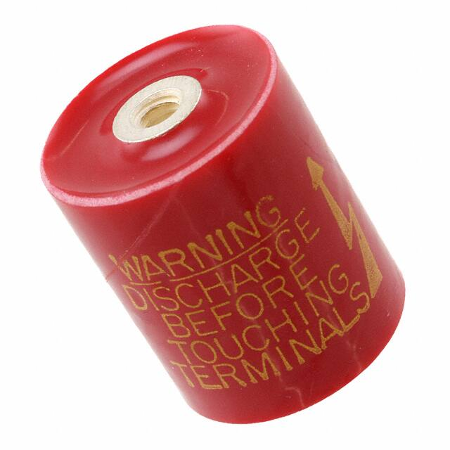

715C..DK... www.vishay.com Vishay Cera-Mite High Voltage Class 2 Ceramic DC Disc Capacitors, 10 kVDC to 40 kVDC / 3.5 kVAC to 14 kVAC, Screw Terminal Mounting FEATURES • • • • • • • Class 2 ceramic (Y5U) Low inductance High insulation resistance Epoxy coating Screw terminal mounting Ceramic singlelayer capacitor Material categorization: for definitions of compliance please see www.vishay.com/doc?99912 APPLICATIONS • • • • • DESIGN SUPPORT TOOLS AVAILABLE 3D 3D 3D Models High voltage power supplies CO2 lasers X-ray equipment Welding equipment Industrial QUICK REFERENCE DATA DESCRIPTION Ceramic Class Ceramic Dielectric Type Voltage (VDC) Min. Capacitance (pF) Max. Capacitance (pF) Mounting 715C10DK### 10 000 10 000 20 000 VALUE 2 Y5U 715C20DK### 20 000 500 6800 Screw terminal 715C15DK### 15 000 1500 10 000 715C30DK### 30 000 500 4700 DIELECTRIC STRENGTH RATED VOLTAGE 150 % of rated voltage, charging current limited to 50 mA. • • • • • DISSIPATION FACTOR tan   20 x 10-3 (1 kHz) INSULATION RESISTANCE Min. 200 000 M or 1000 F min. at 25 °C. CORONA LIMIT < 5 pC at 50 % rated AC voltage. OPERATING TEMPERATURE RANGE -30 °C to +85 °C 715C40DK### 40 000 300 3300 (1) 10 kVDC (3.5 kVRMS) 15 kVDC (5.3 kVRMS) 20 kVDC (7.0 kVRMS) 30 kVDC (10.6 kVRMS) 40 kVDC (14.0 kVRMS) Note (1) All kV RMS up to 60 Hz MATERIAL Capacitor elements made from class 2 ceramic in a molded epoxy case. Screw terminals: brass, silver plated. MARKING 300 pF to 20 nF Type designator, capacitance value, rated DC voltage, ceramic material code, production date code, Cera-mite logo. CAPACITANCE TOLERANCES POWER DISSIPATION -20 % to +80 % Limit to 20 °C rise above ambient, measured on case. CAPACITANCE RANGE CERAMIC DIELECTRIC Y5U (Class 2) Revision: 07-Mar-2019 Document Number: 22168 1 For technical questions, contact: powcap@vishay.com THIS DOCUMENT IS SUBJECT TO CHANGE WITHOUT NOTICE. THE PRODUCTS DESCRIBED HEREIN AND THIS DOCUMENT ARE SUBJECT TO SPECIFIC DISCLAIMERS, SET FORTH AT www.vishay.com/doc?91000 715C..DK... www.vishay.com Vishay Cera-Mite DIMENSIONS Hmax. Dmax. 8-32NC-2B tapped holes Notes • Screw torque limit must be 12 inch pounds. Use #8-32, 3/16" long screw to prevent bottoming • M5 metric terminals available on request, consult factory ORDERING INFORMATION 715C15DKD20 15 kVDC 2000 pF -20 % TO +80 % Y5U MODEL RATED VOLTAGE CAPACITANCE VALUE TOLERANCE CERAMIC SAP PART NUMBER, ELECTRICAL, AND DIMENSIONAL DATA in millimeters (inches) MODEL 715C10DK### 715C10DKS10 715C10DKS20 715C15DK### 715C15DKD15 715C15DKD20 715C15DKD33 715C15DKD47 715C15DKS10 715C20DK### 715C20DKT50 715C20DKD10 715C20DKD13 715C20DKD25 715C20DKD33 715C20DKD47 715C20DKD68 715C30DK### 715C30DKT50 715C30DKD10 715C30DKD25 715C30DKD33 715C30DKD47 715C40DK### 715C40DKT30 715C40DKT50 715C40DKT78 715C40DKD10 715C40DKD16 715C40DKD25 715C40DKD33 Revision: 07-Mar-2019 CERAMIC CAPACITANCE VALUES (pF) RATED VOLTAGE (kVDC) RATED VOLTAGE (kVRMS) Dmax. Hmax. Y5U 10 000 20 000 10 3.5 45.7 (1.80) 54.1 (2.13) 22.0 (0.87) 19.8 (0.78) Y5U 1500 2000 3300 4700 10 000 5.3 26.7 (1.05) 33.0 (1.30) 39.4 (1.55) 33.0 (1.30) 45.7 (1.80) 22.9 (0.90) Y5U 500 1000 1300 2500 3300 4700 6800 7.0 22.4 (0.88) 31.8 (1.25) 33.0 (1.30) 39.4 (1.55) 45.7 (1.80) 54.1 (2.13) 61.5 (2.42) 25.4 (1.00) Y5U 500 1000 2500 3300 4700 10.6 26.7 (1.05) 33.0 (1.30) 45.7 (1.80) 54.1 (2.13) 61.5 (2.42) Y5U 300 500 780 1000 1600 2500 3300 14.0 22.4 (0.88) 26.7 (1.05) 33.0 (1.30) 39.4 (1.55) 45.7 (1.80) 54.1 (2.13) 58.4 (2.30) 15 20 30 40 34.5 (1.36) 30.0 (1.18) 34.5 (1.36) Document Number: 22168 2 For technical questions, contact: powcap@vishay.com THIS DOCUMENT IS SUBJECT TO CHANGE WITHOUT NOTICE. THE PRODUCTS DESCRIBED HEREIN AND THIS DOCUMENT ARE SUBJECT TO SPECIFIC DISCLAIMERS, SET FORTH AT www.vishay.com/doc?91000 715C..DK... www.vishay.com Vishay Cera-Mite ᐃC/C (%) CAPACITANCE CHANGE VS. VOLTAGE (typical) 10 0 -10 -20 -30 -40 -50 -60 -70 -80 -90 -100 ΔC/C = f (UR) Y5U 0 10 20 30 40 50 60 70 80 90 100 UN (%) RELATED DOCUMENTS General Information www.vishay.com/doc?23140 3D Models www.vishay.com/doc?22174 Revision: 07-Mar-2019 Document Number: 22168 3 For technical questions, contact: powcap@vishay.com THIS DOCUMENT IS SUBJECT TO CHANGE WITHOUT NOTICE. THE PRODUCTS DESCRIBED HEREIN AND THIS DOCUMENT ARE SUBJECT TO SPECIFIC DISCLAIMERS, SET FORTH AT www.vishay.com/doc?91000 Legal Disclaimer Notice www.vishay.com Vishay Disclaimer  ALL PRODUCT, PRODUCT SPECIFICATIONS AND DATA ARE SUBJECT TO CHANGE WITHOUT NOTICE TO IMPROVE RELIABILITY, FUNCTION OR DESIGN OR OTHERWISE. Vishay Intertechnology, Inc., its affiliates, agents, and employees, and all persons acting on its or their behalf (collectively, “Vishay”), disclaim any and all liability for any errors, inaccuracies or incompleteness contained in any datasheet or in any other disclosure relating to any product. Vishay makes no warranty, representation or guarantee regarding the suitability of the products for any particular purpose or the continuing production of any product. To the maximum extent permitted by applicable law, Vishay disclaims (i) any and all liability arising out of the application or use of any product, (ii) any and all liability, including without limitation special, consequential or incidental damages, and (iii) any and all implied warranties, including warranties of fitness for particular purpose, non-infringement and merchantability. Statements regarding the suitability of products for certain types of applications are based on Vishay’s knowledge of typical requirements that are often placed on Vishay products in generic applications. Such statements are not binding statements about the suitability of products for a particular application. It is the customer’s responsibility to validate that a particular product with the properties described in the product specification is suitable for use in a particular application. Parameters provided in datasheets and / or specifications may vary in different applications and performance may vary over time. All operating parameters, including typical parameters, must be validated for each customer application by the customer’s technical experts. Product specifications do not expand or otherwise modify Vishay’s terms and conditions of purchase, including but not limited to the warranty expressed therein. Except as expressly indicated in writing, Vishay products are not designed for use in medical, life-saving, or life-sustaining applications or for any other application in which the failure of the Vishay product could result in personal injury or death. Customers using or selling Vishay products not expressly indicated for use in such applications do so at their own risk. Please contact authorized Vishay personnel to obtain written terms and conditions regarding products designed for such applications. No license, express or implied, by estoppel or otherwise, to any intellectual property rights is granted by this document or by any conduct of Vishay. Product names and markings noted herein may be trademarks of their respective owners. © 2017 VISHAY INTERTECHNOLOGY, INC. ALL RIGHTS RESERVED Revision: 08-Feb-17 1 Document Number: 91000
