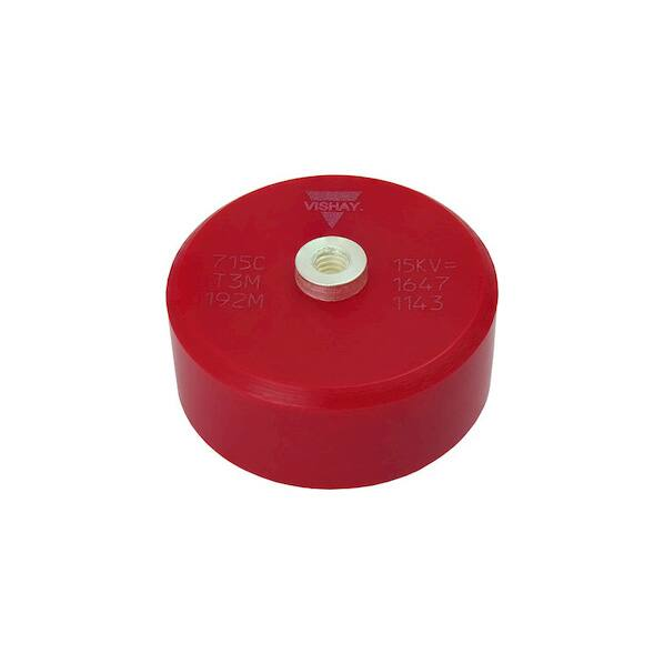

715C..KT... www.vishay.com Vishay Cera-Mite High Voltage Class 1 Ceramic AC and DC Disc Capacitors, 10 kVDC to 50 kVDC / 7 kVAC to 34 kVAC, Screw Terminal Mounting FEATURES • Low dissipation factor of 0.2 % at 1 kHz • N4700 (T3M) class 1, strontium-based ceramic dielectric • Negligible piezoelectric / electrostrictive effect • Low inductance • High insulation resistance • Epoxy coating • Screw terminal mounting • Ceramic singlelayer capacitor • Material categorization: for definitions of compliance please see www.vishay.com/doc?99912 APPLICATIONS DESIGN SUPPORT TOOLS click logo to get started Models Available • • • • • High voltage power supplies CO2 lasers X-ray equipment Welding equipment Industrial QUICK REFERENCE DATA DESCRIPTION Ceramic Class Ceramic Dielectric Type Voltage (VDC) Min. Capacitance (pF) Max. Capacitance (pF) Mounting 715C10KT### 10 000 560 8000 715C15KT### 15 000 370 5300 VALUE 1 N4700 715C20KT### 715C30KT### 20 000 30 000 200 190 4000 2700 Screw terminal DIELECTRIC STRENGTH RATED VOLTAGE 150 % of rated voltage, charging current limited to 50 mA • • • • • • DISSIPATION FACTOR tan   2 x 10-3 (1 kHz) INSULATION RESISTANCE Min. 200 000 M or 1000 F min. at 25 °C CORONA LIMIT < 5 pC at 50 % of rated AC voltage 715C40KT### 40 000 100 2000 715C50KT### 50 000 100 1700 (1) 10 kVDC (7 kVRMS) 15 kVDC (10 kVRMS) 20 kVDC (14 kVRMS) 30 kVDC (20 kVRMS) 40 kVDC (27 kVRMS) 50 kVDC (34 kVRMS) Note (1) All kVRMS values up to 60 Hz MATERIAL -30 °C to +85 °C Capacitor elements made from class 1 ceramic in a molded epoxy case. Screw terminals: brass, silver plated. CAPACITANCE RANGE MARKING 100 pF to 8 nF Type designator, capacitance value, rated DC voltage, ceramic material code, production date code, Cera-Mite logo. OPERATING TEMPERATURE RANGE CAPACITANCE TOLERANCES ± 20 % POWER DISSIPATION CERAMIC DIELECTRIC Limit to 20 °C rise above ambient, measured on case. N4700 (class 1) Revision: 13-Aug-2018 Document Number: 22210 1 For technical questions, contact: powcap@vishay.com THIS DOCUMENT IS SUBJECT TO CHANGE WITHOUT NOTICE. THE PRODUCTS DESCRIBED HEREIN AND THIS DOCUMENT ARE SUBJECT TO SPECIFIC DISCLAIMERS, SET FORTH AT www.vishay.com/doc?91000 715C..KT... www.vishay.com Vishay Cera-Mite DIMENSIONS in millimeters (inches) H ± 1 (0.04) D ± 1 (0.04) 8-32NC-2B tapped holes standard terminal (1) or M4 / M5 tapped holes (2) Notes (1) Use #8-32, 3/16" long screw to prevent bottoming (2) To order metric terminals add “M4” or “M5” suffix to model number, use screw length of 4 mm or 5 mm respectively to prevent bottoming ORDERING INFORMATION 715C15KTD33 15 kVDC 3300 pF ± 20 % N4700 MODEL RATED VOLTAGE CAPACITANCE VALUE TOLERANCE CERAMIC SAP PART NUMBER, ELECTRICAL, AND DIMENSIONAL DATA MODEL CERAMIC CAPACITANCE VALUES (pF) RATED VOLTAGE (kVDC) RATED VOLTAGE (kVRMS) D ± 1 mm (0.04") H WITH #8-32 TERMINALS ± 1 mm (0.04") H WITH M4 METRIC TERMINALS ± 1 mm (0.04") H WITH M5 METRIC TERMINALS ± 1 mm (0.04") 715C10KT### 715C10KTT56 560 21 (0.83) 715C10KTT68 680 21 (0.83) 715C10KTT82 820 25 (0.98) 715C10KTD10 1000 25 (0.98) 715C10KTD12 1200 30 (1.18) 715C10KTD18 1800 715C10KTD22 N4700 2200 10 7 30 (1.18) 37 (1.46) 715C10KTD28 2800 37 (1.46) 715C10KTD39 3900 44 (1.73) 715C10KTD50 5000 52 (2.05) 715C10KTD68 6800 56 (2.20) 715C10KTD80 8000 60 (2.36) 715C15KTT37 370 21 (0.83) 715C15KTT56 560 25 (0.98) n/a 18 (0.71) 16 (0.63) 19 (0.75) 715C15KT### 715C15KTT75 750 30 (1.18) 715C15KTD10 1000 32 (1.26) 715C15KTD11 1100 32 (1.26) 715C15KTD15 1500 715C15KTD19 N4700 1900 15 10 37 (1.46) 37 (1.46) 715C15KTD27 2700 44 (1.73) 715C15KTD33 3300 48 (1.89) 715C15KTD34 3400 52 (2.05) 715C15KTD47 4700 56 (2.20) 715C15KTD53 5300 60 (2.36) Revision: 13-Aug-2018 n/a 20 (0.79) 18 (0.71) 22 (0.87) Document Number: 22210 2 For technical questions, contact: powcap@vishay.com THIS DOCUMENT IS SUBJECT TO CHANGE WITHOUT NOTICE. THE PRODUCTS DESCRIBED HEREIN AND THIS DOCUMENT ARE SUBJECT TO SPECIFIC DISCLAIMERS, SET FORTH AT www.vishay.com/doc?91000 715C..KT... www.vishay.com Vishay Cera-Mite SAP PART NUMBER, ELECTRICAL, AND DIMENSIONAL DATA MODEL 715C20KT### 715C20KTT20 715C20KTT28 715C20KTT40 715C20KTT56 715C20KTT70 715C20KTT88 715C20KTD10 715C20KTD14 715C20KTD17 715C20KTD22 715C20KTD25 715C20KTD33 715C20KTD40 715C30KT### 715C30KTT19 715C30KTT20 715C30KTT33 715C30KTT40 715C30KTT59 715C30KTT70 715C30KTT94 715C30KTD12 715C30KTD15 715C30KTD17 715C30KTD22 715C30KTD27 715C40KT### 715C40KTT10 715C40KTT14 715C40KTT20 715C40KTT30 715C40KTT40 715C40KTT44 715C40KTT56 715C40KTT70 715C40KTT85 715C40KTD10 715C40KTD13 715C40KTD15 715C40KTD20 715C50KT### 715C50KTT10 715C50KTT15 715C50KTT20 715C50KTT33 715C50KTT40 715C50KTT47 715C50KTT56 715C50KTT70 715C50KTT85 715C50KTD10 715C50KTD13 715C50KTD15 715C50KTD17 CERAMIC CAPACITANCE VALUES (pF) N4700 200 280 400 560 700 880 1000 1400 1700 2200 2500 3300 4000 N4700 N4700 N4700 Revision: 13-Aug-2018 190 200 330 400 590 700 940 1200 1500 1700 2200 2700 100 140 200 300 400 440 560 700 850 1000 1300 1500 2000 100 150 200 330 400 470 560 700 850 1000 1300 1500 1700 RATED VOLTAGE (kVDC) 20 30 40 50 RATED VOLTAGE (kVRMS) D ± 1 mm (0.04") 14 21 (0.83) 21 (0.83) 25 (0.98) 25 (0.98) 30 (1.18) 30 (1.18) 32 (1.26) 37 (1.46) 44 (1.73) 48 (1.89) 48 (1.89) 56 (2.20) 60 (2.36) 20 27 34 21 (0.83) 21 (0.83) 25 (0.98) 32 (1.26) 32 (1.26) 37 (1.46) 37 (1.46) 44 (1.73) 48 (1.89) 48 (1.89) 56 (2.20) 60 (2.36) 21 (0.83) 21 (0.83) 25 (0.98) 32 (1.26) 32 (1.26) 32 (1.26) 37 (1.46) 37 (1.46) 44 (1.73) 44 (1.73) 48 (1.89) 52 (2.05) 60 (2.36) 21 (0.83) 21 (0.83) 25 (0.98) 30 (1.18) 32 (1.26) 37 (1.46) 37 (1.46) 44 (1.73) 44 (1.73) 48 (1.89) 52 (2.05) 56 (2.20) 60 (2.36) H WITH #8-32 TERMINALS ± 1 mm (0.04") H WITH M4 METRIC TERMINALS ± 1 mm (0.04") H WITH M5 METRIC TERMINALS ± 1 mm (0.04") n/a 23 (0.91) 21 (0.83) 24 (0.94) n/a 27 (1.06) 25 (0.98) 29 (1.14) n/a 29 (1.14) 31 (1.22) 33 (1.30) n/a n/a 32 (1.26) 34 (1.34) 35 (1.38) n/a Document Number: 22210 3 For technical questions, contact: powcap@vishay.com THIS DOCUMENT IS SUBJECT TO CHANGE WITHOUT NOTICE. THE PRODUCTS DESCRIBED HEREIN AND THIS DOCUMENT ARE SUBJECT TO SPECIFIC DISCLAIMERS, SET FORTH AT www.vishay.com/doc?91000 715C..KT... www.vishay.com Vishay Cera-Mite CAPACITANCE CHANGE VS. TEMPERATURE (typical) Axis Title 10000 15 1000 5 1st line 2nd line 2nd line ΔC/C0 - Capacitance Change (%) 25 -5 100 -15 10 -25 -40 -20 0 20 40 60 80 100 T - Temperature (°C) DISSIPATION FACTOR VS. TEMPERATURE (typical) Axis Title 10000 0.8 1000 0.6 1st line 2nd line 2nd line DF - Dissipation Factor (%) 1.0 0.4 100 0.2 10 0 -40 -20 0 20 40 60 80 100 T - Temperature (°C) CAPACITANCE CHANGE VS. VOLTAGE (typical) Axis Title 10000 -2 -4 -6 1000 -8 1st line 2nd line 2nd line ΔC/C0 - Capacitance Change (%) 0 -10 -12 100 -14 -16 -18 10 -20 0 20 40 60 80 100 UR - Rated Voltage (%) Revision: 13-Aug-2018 Document Number: 22210 4 For technical questions, contact: powcap@vishay.com THIS DOCUMENT IS SUBJECT TO CHANGE WITHOUT NOTICE. THE PRODUCTS DESCRIBED HEREIN AND THIS DOCUMENT ARE SUBJECT TO SPECIFIC DISCLAIMERS, SET FORTH AT www.vishay.com/doc?91000 715C..KT... www.vishay.com Vishay Cera-Mite CAPACITANCE CHANGE VS. FREQUENCY (typical) Axis Title 10000 -1 -2 -3 1000 -4 1st line 2nd line 2nd line ΔC/C0 - Capacitance Change (%) 0 -5 -6 100 -7 -8 -9 -10 1 10 100 10 1000 f - Frequency (kHz) DISSIPATION FACTOR VS. FREQUENCY (typical) Axis Title 10000 8 1000 6 1st line 2nd line 2nd line DF - Dissipation Factor (%) 10 4 100 2 0 1 10 100 10 1000 f - Frequency (kHz) Revision: 13-Aug-2018 Document Number: 22210 5 For technical questions, contact: powcap@vishay.com THIS DOCUMENT IS SUBJECT TO CHANGE WITHOUT NOTICE. THE PRODUCTS DESCRIBED HEREIN AND THIS DOCUMENT ARE SUBJECT TO SPECIFIC DISCLAIMERS, SET FORTH AT www.vishay.com/doc?91000 715C..KT... www.vishay.com Vishay Cera-Mite TEST METHODS NO. ITEM SPECIFICATION SAMPLE SIZE TEST METHOD 100 % TEST LOT BY LOT 1 Appearance No remarkable damage 100 % Visual check 2 Capacitance Within the specified tolerance 100 % Measured at 22 °C ± 2 °C with max. 5 VRMS at 1.0 kHz ± 0.1 kHz 3 Dissipation factor 0.2 % max. 100 % Measured at 22 °C ± 2 °C with max. 5 VRMS at 1.0 kHz ± 0.1 kHz 4 Insulation resistance 200 G min. 100 % Measured with DC 180 V within 60 s of charging 5 Dielectric strength between terminals No failure 100 % Tested with 150 % of rated DC-voltage for min. 3 s in insulating fluid or oil (charge / discharge current < 50 mA) 5 pC max. 10 pieces Measured with 50 % of rated AC voltage SAMPLE TEST LOT BY LOT 6 Partial discharge 7 Temperature characteristics C = -4700 ppm/K ± 1000 ppm/K (temp. range: +20 °C to +85 °C) 2 pieces Measured at 20 °C / 50 °C / 85 °C / 20 °C Capacitance change at 85 °C shall not exceed the specified limit 8 Strength of terminals #8-32 and M4: > 1.5 Nm; M5: > 2 Nm 10 pieces Tested with a torque meter 9 Life test No failure 3 pieces Tested with 125 % of rated DC voltage for 100 h +24 h / -0 h at 85 °C ± 2 °C in oil TYPE TEST / ON DEMAND TEST 10 Dielectric strength between terminals No failure 100 % Tested with 150 % of rated AC voltage for min. 30 s in insulating fluid or oil 11 Lightning pulse 1.2/50 μs No failure 100 % Tested with 150 % of rated DC voltage 5 x positive plus 1 x negative 12 Temperature cycle No failure (no. 1 to 6 within spec. after test) 5 pieces per lot 10 cycles -30 °C / +85 °C Dwell 60 min., rise / fall 60 min. 13 Humidity No failure (no. 1 to 5 within spec. after test) 5 pieces per lot Tested with 0 applied voltage for 500 h +24 h / -0 h at 93 % ± 2 % RH and 40 °C ± 2 °C DESTRUCTIVE TEST / RELEASE TEST 14 AC breakdown No failure < 200 % of rated AC voltage 10 pieces per lot Raise AC voltage with 500 V/s ± 100 V/s until breakdown. Tested in insulating fluid or oil 15 DC breakdown No failure < 200 % of rated DC voltage 10 pieces per lot Raise DC voltage with 500 V/s ± 100 V/s until breakdown. Tested in insulating fluid or oil 16 Lightning pulse 1.2/50 μs No failure < 200 % of rated DC voltage 10 pieces per lot Start at 150 % of rated DC voltage 1 x positive plus 1 x negative Raise voltage by 5 kV per step 17 Life test No failure 5 pieces per lot Tested with 125 % of rated DC voltage for 250 h +24 h / -0 h at 85 °C ± 2 °C in oil RELATED DOCUMENTS General Information Revision: 13-Aug-2018 www.vishay.com/doc?23140 Document Number: 22210 6 For technical questions, contact: powcap@vishay.com THIS DOCUMENT IS SUBJECT TO CHANGE WITHOUT NOTICE. THE PRODUCTS DESCRIBED HEREIN AND THIS DOCUMENT ARE SUBJECT TO SPECIFIC DISCLAIMERS, SET FORTH AT www.vishay.com/doc?91000 Legal Disclaimer Notice www.vishay.com Vishay Disclaimer ALL PRODUCT, PRODUCT SPECIFICATIONS AND DATA ARE SUBJECT TO CHANGE WITHOUT NOTICE TO IMPROVE RELIABILITY, FUNCTION OR DESIGN OR OTHERWISE. Vishay Intertechnology, Inc., its affiliates, agents, and employees, and all persons acting on its or their behalf (collectively, “Vishay”), disclaim any and all liability for any errors, inaccuracies or incompleteness contained in any datasheet or in any other disclosure relating to any product. Vishay makes no warranty, representation or guarantee regarding the suitability of the products for any particular purpose or the continuing production of any product. To the maximum extent permitted by applicable law, Vishay disclaims (i) any and all liability arising out of the application or use of any product, (ii) any and all liability, including without limitation special, consequential or incidental damages, and (iii) any and all implied warranties, including warranties of fitness for particular purpose, non-infringement and merchantability. Statements regarding the suitability of products for certain types of applications are based on Vishay’s knowledge of typical requirements that are often placed on Vishay products in generic applications. Such statements are not binding statements about the suitability of products for a particular application. It is the customer’s responsibility to validate that a particular product with the properties described in the product specification is suitable for use in a particular application. Parameters provided in datasheets and / or specifications may vary in different applications and performance may vary over time. All operating parameters, including typical parameters, must be validated for each customer application by the customer’s technical experts. Product specifications do not expand or otherwise modify Vishay’s terms and conditions of purchase, including but not limited to the warranty expressed therein. Except as expressly indicated in writing, Vishay products are not designed for use in medical, life-saving, or life-sustaining applications or for any other application in which the failure of the Vishay product could result in personal injury or death. Customers using or selling Vishay products not expressly indicated for use in such applications do so at their own risk. Please contact authorized Vishay personnel to obtain written terms and conditions regarding products designed for such applications. No license, express or implied, by estoppel or otherwise, to any intellectual property rights is granted by this document or by any conduct of Vishay. Product names and markings noted herein may be trademarks of their respective owners. © 2021 VISHAY INTERTECHNOLOGY, INC. ALL RIGHTS RESERVED Revision: 01-Jan-2021 1 Document Number: 91000
