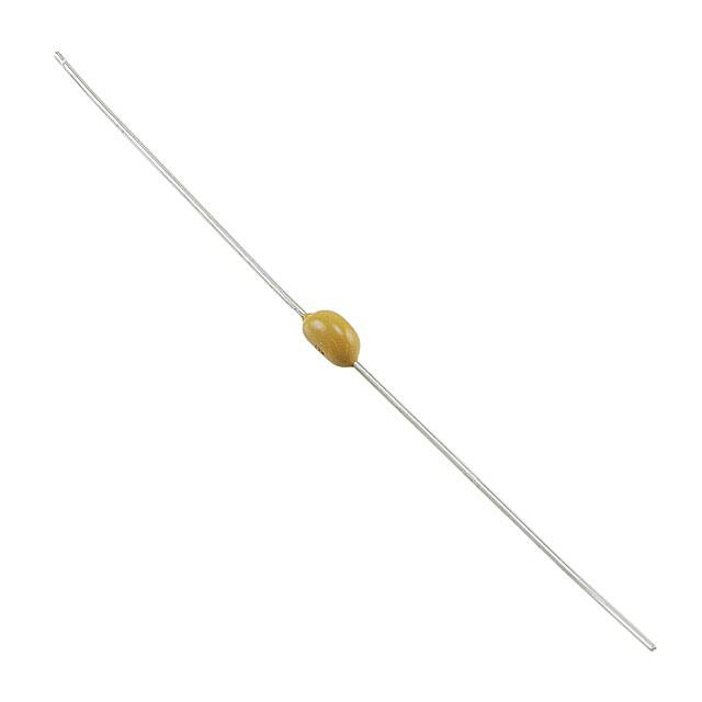

    贴片电容(MLCC) 轴向 82nF ±20% 100V X7R
A823M20X7RH5TAA 数据手册
A Series www.vishay.com Vishay BCcomponents Axial Leaded Multilayer Ceramic Capacitors for General Purpose Class 1, Class 2 and Class 3, 50 VDC, 100 VDC, 200 VDC, 500 VDC FEATURES • • • • High capacitance with small size High reliability Axial mounting style Material categorization: For definitions of compliance please see www.vishay.com/doc?99912 APPLICATIONS • Temperature compensation • Coupling and decoupling QUICK REFERENCE DATA DESCRIPTION VALUE Ceramic Class Ceramic Dielectric 1 2 3 C0G X7R Y5V Voltage (VDC) 50 100 200 500 50 100 200 500 50 100 Min. Capacitance (pF) 10 10 33 33 100 100 100 100 10 000 10 000 Max. Capacitance (pF) 10 000 5600 2200 1000 1 000 000 220 000 47 000 33 000 1 000 000 220 000 Mounting Axial MARKING CAPACITANCE RANGE Marking indicates capacitance value and tolerance in accordance with “EIA 198” and voltage marks. 10 pF to 1 μF TOLERANCE ON CAPACITANCE OPERATING TEMPERATURE RANGE ± 5 %, ± 10 %, ± 20 %, + 80 %/- 20 % C0G, X7R: - 55 °C to + 125 °C Y5V: - 30 °C to + 85 °C RATED VOLTAGE 50 VDC, 100 VDC, 200 VDC, 500 VDC TEMPERATURE CHARACTERISTICS Class 1: C0G Class 2: X7R Class 3: Y5V TEST VOLTAGE • 50 VDC and 100 VDC: 250 % of rated voltage • 200 VDC: 150 % of rated voltage + 100 VDC • 500 VDC: 130 % of rated voltage + 100 VDC SECTIONAL SPECIFICATIONS Climatic category (acc. to EN 60058-1) Class 1 and 2: 55/125/21 Class 3: 30/85/21 APPROVALS EIA 198 IEC 60384-9 INSULATION RESISTANCE AT 500 VDC • 50 VDC and 100 VDC: 100 G or 1000 F whichever is less at rated voltage within 2 min of charging • 200 VDC and 500 VDC: 10 G or 100 F whichever is less at rated voltage within 2 min of charging DISSIPATION FACTOR Class 1: DESIGN • The capacitors consist of a general purpose MLCC • The lead wires are 0.5 mm and are made of 100 % tinned copper clad steel wire • Coating is made of yellow colored flame retardant epoxy resin in accordance with UL 94 V-0 Revision: 20-Aug-13 Class 2: Class 3: 0.1 % max. when C  30 pF (at 1 MHz; 1 V where C  1000 pF,  and at 1 kHz; 1 V where C > 1000 pF) For C < 30 pF: DF = 100/(400 + 20 x C) DF = Disspation factor in %; C = Capacitance value in pF 2.5 % max. (at 1 kHz; 1 V) 5 % max. (at 1 kHz; 1 V) Document Number: 45164 1 For technical questions, contact: cmll@vishay.com THIS DOCUMENT IS SUBJECT TO CHANGE WITHOUT NOTICE. THE PRODUCTS DESCRIBED HEREIN AND THIS DOCUMENT ARE SUBJECT TO SPECIFIC DISCLAIMERS, SET FORTH AT www.vishay.com/doc?91000 A Series www.vishay.com Vishay BCcomponents DIMENSIONS (in millimeters) ØD Lb 52.4 ± 1.5 SIZE CODE 15 20 LbMAX. 3.8 5.1 ØDMAX. 2.6 3.1 Note • The leads are matte tinned FeCu wire. MARKING CAPACITANCE VALUE < 100 pF Side one Side two BC XXt DDD T V XX: Capacitance code t: Tolerance code Logo mark (BC or Vishay) DDD: Date code CAPACITANCE VALUE ≥ 100 pF T: T.C. code V: Voltage code Side one Side two BC XXX DDD t T V XXX: Capacitance code Logo mark (BC or Vishay) t: Tolerance code T: T.C. code V: Voltage code DDD: Date code MARKING CODE DESCRIPTION DDD xxx t v T Date Code The first digit is the year, the last two digits are the week. For example: 109 = 2011, 9th week 217 = 2012, 17th week Capacitance Code Two significant digits followed by one digit for the multiplier as given below. 1 = * 10, 2 = * 100, 3 = * 1000, 4 = * 10 000, 5 = * 100 000 Tolerance Code J=±5% K = ± 10 % M = ± 20 % Z = + 80 %/- 20 % Voltage Code 1 = 100 V 2 = 200 V 4 = 500 V 5 = 50 V T.C. Code A = C0G (NP0) C = X7R Y = Y5V Note • The capacitance code indicates actual capacitance in pF when capacitance value < 100 pF. ORDERING CODE INFORMATION A 104 K 15 X7R F 5 TAA 1 234 5 67 8 9 10 11 12 13 14 15 Product Type Capacitance (pF) Capacitance Tolerance Size Code TC Code Rated Voltage Lead Diameter Packaging A = Axial leaded MLCC The first two digits are the significant figures of capacitance and the last digit is a multiplier as follows: 0=*1 1 = * 10 2 = * 100 3 = * 1000 4 = * 10 000 5 = * 100 000 J=±5% K = ± 10 % M = ± 20 % Z = + 80 %/- 20 % Please refer to relevant datasheet Please refer to relevant datasheet F = 50 VDC H = 100 VDC K = 200 VDC L = 500 VDC 5 = 0.50 mm ± 0.05 mm TAA = Reel UAA = Ammo Revision: 20-Aug-13 Document Number: 45164 2 For technical questions, contact: cmll@vishay.com THIS DOCUMENT IS SUBJECT TO CHANGE WITHOUT NOTICE. THE PRODUCTS DESCRIBED HEREIN AND THIS DOCUMENT ARE SUBJECT TO SPECIFIC DISCLAIMERS, SET FORTH AT www.vishay.com/doc?91000 A Series www.vishay.com Vishay BCcomponents ORDERING CODES DIELECTRIC C0G CAP. (pF) 50 VDC 100 VDC 200 VDC 500 VDC 10 A100#15C0GF5### A100#15C0GH5### - - 12 A120#15C0GF5### A120#15C0GH5### - - 15 A150#15C0GF5### A150#15C0GH5### - - 18 A180#15C0GF5### A180#15C0GH5### - - 22 A220#15C0GF5### A220#15C0GH5### - - 27 A270#15C0GF5### A270#15C0GH5### - - 33 A330#15C0GF5### A330#15C0GH5### A330#15C0GK5### A330#15C0GL5### 39 A390#15C0GF5### A390#15C0GH5### A390#15C0GK5### A390#15C0GL5### 47 A470#15C0GF5### A470#15C0GH5### A470#15C0GK5### A470#15C0GL5### 56 A560#15C0GF5### A560#15C0GH5### A560#15C0GK5### A560#15C0GL5### 68 A680#15C0GF5### A680#15C0GH5### A680#15C0GK5### A680#15C0GL5### 82 A820#15C0GF5### A820#15C0GH5### A820#15C0GK5### A820#15C0GL5### 100 A101#15C0GF5### A101#15C0GH5### A101#15C0GK5### A101#15C0GL5### 120 A121#15C0GF5### A121#15C0GH5### A121#15C0GK5### A121#15C0GL5### 150 A151#15C0GF5### A151#15C0GH5### A151#15C0GK5### A151#15C0GL5### 180 A181#15C0GF5### A181#15C0GH5### A181#15C0GK5### A181#15C0GL5### 220 A221#15C0GF5### A221#15C0GH5### A221#15C0GK5### A221#15C0GL5### 270 A271#15C0GF5### A271#15C0GH5### A271#15C0GK5### A271#15C0GL5### 330 A331#15C0GF5### A331#15C0GH5### A331#15C0GK5### A331#15C0GL5### 390 A391#15C0GF5### A391#15C0GH5### A391#15C0GK5### A391#15C0GL5### 470 A471#15C0GF5### A471#15C0GH5### A471#15C0GK5### A471#20C0GL5### 560 A561#15C0GF5### A561#15C0GH5### A561#15C0GK5### A561#20C0GL5### 680 A681#15C0GF5### A681#15C0GH5### A681#15C0GK5### A681#20C0GL5### 820 A821#15C0GF5### A821#15C0GH5### A821#15C0GK5### A821#20C0GL5### 1000 A102#15C0GF5### A102#20C0GH5### A102#20C0GK5### A102#20C0GL5### 1200 A122#15C0GF5### A122#20C0GH5### A122#20C0GK5### - 1500 A152#15C0GF5### A152#20C0GH5### A152#20C0GK5### - 1800 A182#15C0GF5### A182#20C0GH5### A182#20C0GK5### - 2200 A222#15C0GF5### A222#20C0GH5### A222#20C0GK5### - 2700 A272#20C0GF5### A272#20C0GH5### - - 3300 A332#20C0GF5### A332#20C0GH5### - - 3900 A392#20C0GF5### A392#20C0GH5### - - 4700 A472#20C0GF5### A472#20C0GH5### - - 5600 A562#20C0GF5### A562#20C0GH5### - - 6800 A682#20C0GF5### - - - 8200 A822#20C0GF5### - - - 10 000 A103#20C0GF5### - - - Notes • Lead diameter is 0.5 mm • # 5th digit is capacitance tolerance code: ± 5 % = J; ± 10 % = K • # 13th, 14th and 15th digits are packaging code: Reel = TAA; Ammo = UAA Revision: 20-Aug-13 Document Number: 45164 3 For technical questions, contact: cmll@vishay.com THIS DOCUMENT IS SUBJECT TO CHANGE WITHOUT NOTICE. THE PRODUCTS DESCRIBED HEREIN AND THIS DOCUMENT ARE SUBJECT TO SPECIFIC DISCLAIMERS, SET FORTH AT www.vishay.com/doc?91000 A Series www.vishay.com Vishay BCcomponents DIELECTRIC X7R CAP. (pF) 50 VDC 100 VDC 200 VDC 500 VDC 100 A101#15X7RF5### A101#15X7RH5### A101#15X7RK5### A101#15X7RL5### 120 A121#15X7RF5### A121#15X7RH5### A121#15X7RK5### A121#15X7RL5### 150 A151#15X7RF5### A151#15X7RH5### A151#15X7RK5### A151#15X7RL5### 180 A181#15X7RF5### A181#15X7RH5### A181#15X7RK5### A181#15X7RL5### 220 A221#15X7RF5### A221#15X7RH5### A221#15X7RK5### A221#15X7RL5### 270 A271#15X7RF5### A271#15X7RH5### A271#15X7RK5### A271#15X7RL5### 330 A331#15X7RF5### A331#15X7RH5### A331#15X7RK5### A331#15X7RL5### 390 A391#15X7RF5### A391#15X7RH5### A391#15X7RK5### A391#15X7RL5### 470 A471#15X7RF5### A471#15X7RH5### A471#15X7RK5### A471#15X7RL5### 560 A561#15X7RF5### A561#15X7RH5### A561#15X7RK5### A561#15X7RL5### 680 A681#15X7RF5### A681#15X7RH5### A681#15X7RK5### A681#15X7RL5### 820 A821#15X7RF5### A821#15X7RH5### A821#15X7RK5### A821#15X7RL5### 1000 A102#15X7RF5### A102#15X7RH5### A102#15X7RK5### A102#15X7RL5### 1200 A122#15X7RF5### A122#15X7RH5### A122#15X7RK5### A122#15X7RL5### 1500 A152#15X7RF5### A152#15X7RH5### A152#15X7RK5### A152#15X7RL5### 1800 A182#15X7RF5### A182#15X7RH5### A182#15X7RK5### A182#15X7RL5### 2200 A222#15X7RF5### A222#15X7RH5### A222#15X7RK5### A222#15X7RL5### 2700 A272#15X7RF5### A272#15X7RH5### A272#15X7RK5### A272#15X7RL5### 3300 A332#15X7RF5### A332#15X7RH5### A332#15X7RK5### A332#20X7RL5### 3900 A392#15X7RF5### A392#15X7RH5### A392#15X7RK5### A392#20X7RL5### 4700 A472#15X7RF5### A472#15X7RH5### A472#15X7RK5### A472#20X7RL5### 5600 A562#15X7RF5### A562#15X7RH5### A562#15X7RK5### A562#20X7RL5### 6800 A682#15X7RF5### A682#15X7RH5### A682#15X7RK5### A682#20X7RL5### 8200 A822#15X7RF5### A822#15X7RH5### A822#15X7RK5### A822#20X7RL5### 10 000 A103#15X7RF5### A103#15X7RH5### A103#15X7RK5### A103#20X7RL5### 12 000 A123#15X7RF5### A123#15X7RH5### A123#15X7RK5### A123#20X7RL5### 15 000 A153#15X7RF5### A153#15X7RH5### A153#15X7RK5### A153#20X7RL5### 18 000 A183#15X7RF5### A183#15X7RH5### A183#15X7RK5### A183#20X7RL5### 22 000 A223#15X7RF5### A223#15X7RH5### A223#15X7RK5### A223#20X7RL5### 27 000 A273#15X7RF5### A273#20X7RH5### A273#20X7RK5### A273#20X7RL5### 33 000 A333#15X7RF5### A333#20X7RH5### A333#20X7RK5### A333#20X7RL5### 39 000 A393#15X7RF5### A393#20X7RH5### A393#20X7RK5### - 47 000 A473#15X7RF5### A473#20X7RH5### A473#20X7RK5### - 56 000 A563#15X7RF5### A563#20X7RH5### - - 68 000 A683#15X7RF5### A683#20X7RH5### - - 82 000 A823#15X7RF5### A823#20X7RH5### - - 100 000 A104#15X7RF5### A104#20X7RH5### - - 150 000 A154#20X7RF5### A154#20X7RH5### - - 220 000 A224#20X7RF5### A224#20X7RH5### - - 330 000 A334#20X7RF5### - - - 470 000 A474#20X7RF5### - - - 560 000 A564#20X7RF5### - - 680 000 A684#20X7RF5### - - - 1 000 000 A105#20X7RF5### - - - Notes • Lead diameter is 0.5 mm • # 5th digit is capacitance tolerance code: ± 10 % = K; ± 20 % = M • # 13th, 14th and 15th digits are packaging code: Reel = TAA; Ammo = UAA Revision: 20-Aug-13 Document Number: 45164 4 For technical questions, contact: cmll@vishay.com THIS DOCUMENT IS SUBJECT TO CHANGE WITHOUT NOTICE. THE PRODUCTS DESCRIBED HEREIN AND THIS DOCUMENT ARE SUBJECT TO SPECIFIC DISCLAIMERS, SET FORTH AT www.vishay.com/doc?91000 A Series www.vishay.com Vishay BCcomponents DIELECTRIC Y5V CAP. (pF) 50 VDC 100 VDC 10 000 A103Z15Y5VF5### A103Z15Y5VH5### 15 000 A153Z15Y5VF5### A153Z15Y5VH5### 22 000 A223Z15Y5VF5### A223Z15Y5VH5### 33 000 A333Z15Y5VF5### A333Z15Y5VH5### 47 000 A473Z15Y5VF5### A473Z15Y5VH5### 68 000 A683Z15Y5VF5### A683Z15Y5VH5### 100 000 A104Z15Y5VF5### A104Z15Y5VH5### 150 000 A154Z15Y5VF5### A154Z20Y5VH5### 220 000 A224Z15Y5VF5### A224Z20Y5VH5### 330 000 A334Z20Y5VF5### - 470 000 A474Z20Y5VF5### - 680 000 A684Z20Y5VF5### - 1 000 000 A105Z20Y5VF5### - Notes • Lead diameter is 0.5 mm • Tolerance is + 80 %/- 20 % • # 13th, 14th and 15th digits are packaging code: Reel = TAA; Ammo = UAA TAPING AND PACKAGING LABELLING For example: Each reel is provided with a label showing the following details: Manufacturer, A style, capacitance, tolerance, batch number, quantity of components, rated voltage, dielectric. On special request other designations can be shown. PACKAGING QUANTITIES AND BOX DIMENSIONS SMALLEST PACKAGING QUANTITY (SPQ) BOX DIMENSIONS L x W x H (mm) 15, 20 7000 370 x 370 x 90 15, 20 4000 265 x 85 x 95 PACKAGING SIZE CODE Tape on reel Ammopack Revision: 20-Aug-13 Document Number: 45164 5 For technical questions, contact: cmll@vishay.com THIS DOCUMENT IS SUBJECT TO CHANGE WITHOUT NOTICE. THE PRODUCTS DESCRIBED HEREIN AND THIS DOCUMENT ARE SUBJECT TO SPECIFIC DISCLAIMERS, SET FORTH AT www.vishay.com/doc?91000 A Series www.vishay.com Vishay BCcomponents CAPACITORS ON BANDOLIER FOR DIPPED AXIAL A P C H S M B T DIMENSIONS PARAMETER Inside tape spacing SYMBOL B (1) mm INCH 52.4 ± 1.5 2.062 ± 0.059 Center to tape spacing C ± 0.8 ± 0.031 Cumulative pitch, 6 consecutive components P ± 1.5 ± 0.059 Components pitch A 5.0 ± 0.5 0.197 ± 0.015 Lead bend M < 1.2 < 0.047 Exposed adhesive S < 0.51 > 0.020 Tape width T 6.35 0.250 Lead sandwich H > 3.96 > 0.156 Note (1) Inside tape spacing 26.0 mm + 1.51 mm/- 0.0 mm is available on request Revision: 20-Aug-13 Document Number: 45164 6 For technical questions, contact: cmll@vishay.com THIS DOCUMENT IS SUBJECT TO CHANGE WITHOUT NOTICE. THE PRODUCTS DESCRIBED HEREIN AND THIS DOCUMENT ARE SUBJECT TO SPECIFIC DISCLAIMERS, SET FORTH AT www.vishay.com/doc?91000 A Series www.vishay.com Vishay BCcomponents REEL DATA REEL A maximum of 0.5 % of the total number of capacitors per reel may be missing. 69.85 ± 1.5 A maximum of 1 consecutive vacant positions is followed by 6 consecutive components. 355.6 Max. Tape begins and ends with a minimum of 4 empty positions (180 mm tape). Maximum of 5 splicers per reel. Direction of unreeling Arbor hole Ø 28 ± 1 REEL DIMENSIONS A K H1 L REEL SIZE A (mm) Outer diameter 355.6 max. 28 ± 1 L Hole diameter K Core diameter 90 H1 Internal width 69.9 ± 1.5 AMMOPACK DATA AMMOPACK A maximum of 0.5 % of the total number of capacitors per reel may be missing. A maximum of 1 consecutive vacant positions is followed by 6 consecutive components. w = 85 Tape begins and ends with a minimum of 4 empty positions (180 mm tape). T = 95 Maximum of 5 splicers per reel. The cumulative pitch tolerance over 20 consecutive units is not to exceed ± 1.0 mm. L = 265 RELATED DOCUMENTS General Information Revision: 20-Aug-13 www.vishay.com/doc?45163 Document Number: 45164 7 For technical questions, contact: cmll@vishay.com THIS DOCUMENT IS SUBJECT TO CHANGE WITHOUT NOTICE. THE PRODUCTS DESCRIBED HEREIN AND THIS DOCUMENT ARE SUBJECT TO SPECIFIC DISCLAIMERS, SET FORTH AT www.vishay.com/doc?91000 Legal Disclaimer Notice www.vishay.com Vishay Disclaimer ALL PRODUCT, PRODUCT SPECIFICATIONS AND DATA ARE SUBJECT TO CHANGE WITHOUT NOTICE TO IMPROVE RELIABILITY, FUNCTION OR DESIGN OR OTHERWISE. Vishay Intertechnology, Inc., its affiliates, agents, and employees, and all persons acting on its or their behalf (collectively, “Vishay”), disclaim any and all liability for any errors, inaccuracies or incompleteness contained in any datasheet or in any other disclosure relating to any product. Vishay makes no warranty, representation or guarantee regarding the suitability of the products for any particular purpose or the continuing production of any product. To the maximum extent permitted by applicable law, Vishay disclaims (i) any and all liability arising out of the application or use of any product, (ii) any and all liability, including without limitation special, consequential or incidental damages, and (iii) any and all implied warranties, including warranties of fitness for particular purpose, non-infringement and merchantability. Statements regarding the suitability of products for certain types of applications are based on Vishay's knowledge of typical requirements that are often placed on Vishay products in generic applications. Such statements are not binding statements about the suitability of products for a particular application. It is the customer's responsibility to validate that a particular product with the properties described in the product specification is suitable for use in a particular application. Parameters provided in datasheets and / or specifications may vary in different applications and performance may vary over time. All operating parameters, including typical parameters, must be validated for each customer application by the customer's technical experts. Product specifications do not expand or otherwise modify Vishay's terms and conditions of purchase, including but not limited to the warranty expressed therein. Hyperlinks included in this datasheet may direct users to third-party websites. These links are provided as a convenience and for informational purposes only. Inclusion of these hyperlinks does not constitute an endorsement or an approval by Vishay of any of the products, services or opinions of the corporation, organization or individual associated with the third-party website. Vishay disclaims any and all liability and bears no responsibility for the accuracy, legality or content of the third-party website or for that of subsequent links. Except as expressly indicated in writing, Vishay products are not designed for use in medical, life-saving, or life-sustaining applications or for any other application in which the failure of the Vishay product could result in personal injury or death. Customers using or selling Vishay products not expressly indicated for use in such applications do so at their own risk. Please contact authorized Vishay personnel to obtain written terms and conditions regarding products designed for such applications. No license, express or implied, by estoppel or otherwise, to any intellectual property rights is granted by this document or by any conduct of Vishay. Product names and markings noted herein may be trademarks of their respective owners. © 2021 VISHAY INTERTECHNOLOGY, INC. ALL RIGHTS RESERVED Revision: 09-Jul-2021 1 Document Number: 91000
A823M20X7RH5TAA
物料型号:VISHAY品牌的A系列轴向引线多层陶瓷电容器,具有不同的电压等级(50VDC, 100VDC, 200VDC, 500VDC)和电容值。
器件简介:这些电容器具有高电容与小尺寸的特点,高可靠性,并且采用轴向安装方式。材料分类符合www.vishay.com/doc?99912的定义,有Pb和RoHS合规选项。
引脚分配:电容器由通用品MLCC组成,引线直径为0.5mm,由100%镀锡铜包钢丝制成。
参数特性: - 电容范围:10pF至1μF - 电容公差:±5%, ±10%, ±20%, +80%/-20% - 额定电压:50VDC, 100VDC, 200VDC, 500VDC - 测试电压:依据不同的额定电压有不同的测试电压标准 - 绝缘电阻:在500VDC下,50VDC和100VDC的电容器为100GΩ或1000ΩF(取较小者),200VDC和500VDC的电容器为10GΩ或100ΩF(取较小者)
功能详解:适用于温度补偿、耦合和去耦。
应用信息:适用于需要温度补偿、耦合和去耦的场合。
封装信息:提供了详细的尺寸信息,包括最大长度、外径等,并且说明了引线为亚光镀锡的铁铜线。
标记信息:标记表明了电容值和公差,符合“EIA 198”标准,并且有电压标记。
订购代码信息:提供了详细的订购代码表,包括产品类型、电容值、电容公差、尺寸代码、温度系数代码、额定电压、引线直径和包装信息。
