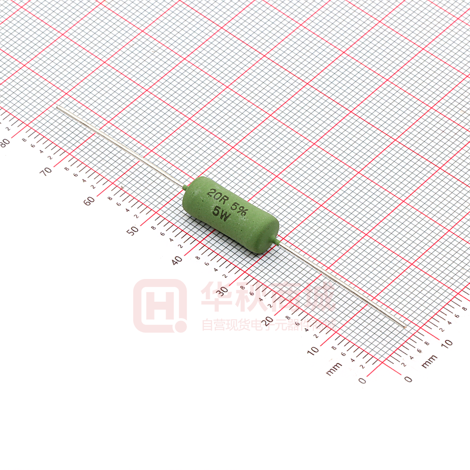

    TFUNK(威世)
    插件,D7.5xL18mm
    插件电阻 20Ω ±5% 5W -80ppm/℃~-10ppm/℃
AC05000002009JAC00 数据手册
AC.. Series www.vishay.com Vishay Draloric Cemented Wirewound Resistors FEATURES • All welded construction • Ceramic core • Non-flammable cement coating • Tinned copper-clad iron leads (for axial parts) • High power dissipation in small volume • Ideal for pulse application • Material categorization: For definitions of compliance please see www.vishay.com/doc?99912 STANDARD ELECTRICAL SPECIFICATIONS MODEL POWER RATING P40 °C W POWER RESISTANCE RANGE (1) RESISTANCE RANGE (1) RESISTANCE RANGE (1) LIMITING RATING   TOLERANCE  VOLTAGE P70 °C TCR = TCR = ±% TCR= ± 100 ppm/K Umax. - 10 ppm/K to - 80 ppm/K 100 ppm/K to 180 ppm/K W AC01 1 0.9 P x R 0.10 to 33 36 to 2.4K n/a 5 AC03 (2) 3 2.5 P x R 0.10 to 390 430 to 3.3K 3.6K to 5.1K 5 AC04 4 3.5 P x R 0.10 to 620 680 to 6.8K n/a 5 AC05 5 4.7 P x R 0.10 to 910 1K to 10K n/a 5 AC07 7 5.8 P x R 0.10 to 1.5K 1.6K to 15K n/a 5 AC10 10 8.4 P x R 0.22 to 560 620 to 27K n/a 5 Notes (1) Resistance value to be selected for ± 5 % from E24 (2) AC03 WSZ: P 40 °C = 1.8 W; P70 °C = 1.5 W PART NUMBER AND PRODUCT DESCRIPTION Part Number: AC03000001509JAC00 A C 0 3 0 0 0 0 0 1 5 0 9 J A TOLERANCE PACKAGING CODE CODE MODEL VARIANT TCR/MATERIAL VALUE AC01000 = AC01 AC03000 = AC03 AC04000 = AC04 AC05000 = AC05 AC07000 = AC07 AC10000 = AC10 0 = Neutral 1 = RT 2 = SWI = Special winding (3) 3 = DK SP 20 mm (4) 4 = DK LP 33 mm (4) 5 = DK LP 17.8 mm (4) 6 = NI = Non inductive (7) 7 = DK LP 25.4 mm (4) 9 = WSZ 6720 8 = DK SP 25.4 mm Z = Value overflow (Special) C = E/K 25.4 mm (4) 0 = Standard 3 digit value 1 digit multiplier MULTIPLIER 7 = *10-3 8 = *10-2 9 = *10-1 0 = *100 1 = *101 2 = *102 5 = 10-4 J = ± 5.0 % (See Packaging table) C 0 0 SPECIAL The 5 digit BV number will be encoded using a 36 character code. This code contains numbers 0...9 and letters A...Z (36 characters total) and allows to encode at least 46 655 five digit BV numbers. 00 = Standard Product Description: AC03 15R 5 % AC AC03 MODEL (5) 15R VALUE (5) 5% AC TOLERANCE CODE (5) PACKAGING DESCRIPTION (6) Notes (3) Special winding on request (4) Other dimensions and variants on request (5) See “Part Number and Product Description” (6) See “Packaging Table” (7) Resistance range on request Revision: 13-Jan-14 Document Number: 28730 1 For technical questions, contact: ww1resistors@vishay.com THIS DOCUMENT IS SUBJECT TO CHANGE WITHOUT NOTICE. THE PRODUCTS DESCRIBED HEREIN AND THIS DOCUMENT ARE SUBJECT TO SPECIFIC DISCLAIMERS, SET FORTH AT www.vishay.com/doc?91000 AC.. Series www.vishay.com Vishay Draloric PACKAGING TABLE AMMO MODEL LOOSE PIECES PACK. CODE PACK. DESC. 1000 A1 A1 AC01RT 2500 AE AE AC03 500 AC AC AC01 AC01 DK/EK AC03 DK/EK BLISTER PIECES PACK. CODE PACK. DESC. 500 LC LC 500 LC LC AC03 WSZ AC04 500 AC AC 500 AC AC 500 AC AC 250 AB AB AC04 DK/EK AC05 AC05 DK/EK AC07 AC07 DK/EK AC10 500 LC LC 500 LC LC 250 LB LB PIECES PACK. CODE PACK. DESC. 1250 BM BM DIMENSIONS G L D x (Lacquer) d For packaging dimensions see: www.vishay.com/doc?28721 DIMENSIONS - Resistor types, mass and relevant physical dimensions DIMENSIONS in millimeters [inches] MODEL xmax. G WEIGHT g PER UNIT 2 63 ± 1 [2.480 ± 0.039] 0.52 2 63 ± 1 [2.480 ± 0.039] 0.75 3 63 ± 1 [2.480 ± 0.039] 1.10 3 63 ± 1 [2.480 ± 0.039] 1.90 26 [1.024] 3 73 ± 1 [2.874 ± 0.039] 2.60 44 [1.732] 3 88 ± 1 [3.465 ± 0.039] 4.50 Dmax. Lmax. AC01 4.3 [0.169] 11 [0.433] AC03 4.8 [0.189] 13 [0.512] AC04 5.5 [0.217] 16.5 [0.650] AC05 7.5 [0.295] 18 [0.709] AC07 7.5 [0.295] AC10 8.0 [0.315] Revision: 13-Jan-14 d 0.8 ± 0.03 [0.031 ± 0.001] Document Number: 28730 2 For technical questions, contact: ww1resistors@vishay.com THIS DOCUMENT IS SUBJECT TO CHANGE WITHOUT NOTICE. THE PRODUCTS DESCRIBED HEREIN AND THIS DOCUMENT ARE SUBJECT TO SPECIFIC DISCLAIMERS, SET FORTH AT www.vishay.com/doc?91000 AC.. Series www.vishay.com Vishay Draloric BENDING FORMS L ØD KINK TYPE S = EK Ød h S TYPE Ød P Ø Dmax. L h±1 P±1 AC01 Smax. 17.8 (1) 0.8 AC03 - AC05 (1) 8 25.4 AC07 2 33.0 P1 ØD L Ød h DOUBLE KINK SP = DK SP c S TYPE Ød Ø Dmax. L h±1 P1 ± 1 P2 ± 3 19.8 17.8 22.0 20.0 27.4 25.4 AC01 AC03 - AC05 0.8 (1) (1) P2 ØB 8 AC07 35.0 ØB c 2 1.0 ± 0.1 4.5 ± 1 Smax. ØB c 2 1.0 ± 0.1 4.5 ± 1 33.0 P1 ØD Smax. L Ød h DOUBLE KINK LP = DK LP c S TYPE Ød Ø Dmax. L h±1 AC01 - AC03 AC03 - AC05 0.8 AC07 (1) (1) P2 ØB 8 P1 ± 1 P2 ± 3 17.8 17.8 25.4 25.4 33.0 33.0 Note (1) See table DIMENSIONS Revision: 13-Jan-14 Document Number: 28730 3 For technical questions, contact: ww1resistors@vishay.com THIS DOCUMENT IS SUBJECT TO CHANGE WITHOUT NOTICE. THE PRODUCTS DESCRIBED HEREIN AND THIS DOCUMENT ARE SUBJECT TO SPECIFIC DISCLAIMERS, SET FORTH AT www.vishay.com/doc?91000 AC.. Series www.vishay.com Vishay Draloric BENDING FORMS A L a I ØD WSZ b H F E Solder pad dimensions Ød TYPE Ød Ø Dmax. A L F H E a b l AC03 WSZ 0.8 (1) 17 ± 0.5 11 - 12 4.8 ± 0.5 3.6 ± 0.5 5.0 ± 0.5 2.5 5.5 14.5 Δh1 P P2 ØD L H1 H H0 1 max. W2 d RADIAL TAPED = RT t L1 P1 F W0 W1 W P0 D0 Direction of Unreeling TYPE AC01 Lead Ø Ød 0.8 Diameter ØD (1) Length L (1) Pitch of components P 12.7 ± 1.0 Pitch of spocket holes (2) P0 12.7 ± 0.3 Distance between hole center and resistor center P1 3.85 ± 0.7 Distance between hole center and lead center P2 6.35 ± 1.0 Lead spacing F 5.0 + 0.6, - 0.1 h1 2 max. W 18.0 ± 0.5 Width of adhesive tape W0 12.0 ± 0.5 Position of holes W1 9.0 ± 0.5 Position of adhesive tape W2 0.5 max. Body to hole center H 19.5 ± 1.0 Lead crimp to hole center (3) H0 16.0 ± 0.5 Hole Ø D0 4.0 ± 0.2 t 0.9 max. Angle of insertion Width of carrier tape Thickness of tape (4) Height for cutting L1 11 max. Height for insertion H1 32 max. Notes (1) See table DIMENSIONS (2) Test over 10 holes - 9 intervals P 12.7 x 9 = 114.3 ± 0.5 0 (3) Parallelism, < 0.5 mm (4) Thickness of carrier tape: 0.55 mm ± 0.1 Revision: 13-Jan-14 Document Number: 28730 4 For technical questions, contact: ww1resistors@vishay.com THIS DOCUMENT IS SUBJECT TO CHANGE WITHOUT NOTICE. THE PRODUCTS DESCRIBED HEREIN AND THIS DOCUMENT ARE SUBJECT TO SPECIFIC DISCLAIMERS, SET FORTH AT www.vishay.com/doc?91000 AC.. Series www.vishay.com Vishay Draloric PULSE DIAGRAMS 10 000 1000 tp/ti = 1000 1R0 R10 10R 100R 2K0 tp/ti = 200 100 10 Pmax. (W) Pmax. (W) 10 000 tp/ti = 50 tp/ti = 1000 1000 R10 1R0 10R 110R 4K7 tp/ti = 200 tp/ti = 50 100 tp/ti = 10 tp/ti = 10 10 tp/ti = 2 tp/ti = 2 1 0.00001 0.0001 0.001 0.01 0.1 1 0.00001 1 0.0001 0.001 0.01 0.1 ti (s) AC01 Pulse on a regular basis; maximum permissible peak pulse power ( Pˆ max.) as a function of pulse duration (ti) AC03 Pulse on a regular basis; maximum permissible peak pulse power ( Pˆ max.) as a function of pulse duration (ti) 10 000 tp/ti = 1000 Pmax. (W) Pmax. (W) 10 000 1000 R10 1R0 10R 100R 6K8 tp/ti = 200 tp/ti = 50 1000 100 tp/ti = 10 tp/ti = 2 1 0.00001 0.0001 10 0.001 0.01 0.1 tp/ti = 1000 tp/ti = 200 1R1 R10 11R 100R 8K2 tp/ti = 50 100 10 tp/ti = 10 tp/ti = 2 1 0.00001 1 0.0001 0.001 0.01 0.1 1 ti (s) AC05 Pulse on a regular basis; maximum permissible peak pulse power ( Pˆ max.) as a function of pulse duration (ti) 10 000 Pmax. (W) Pmax. (W) 10 000 tp/ti = 1000 tp/ti = 200 1R1 R10 11R 100R 15K 1000 tp/ti = 50 tp/ti = 10 tp/ti = 1000 R68 2R2 33R 240R 15K tp/ti = 200 1000 100 tp/ti = 50 tp/ti = 10 tp/ti = 2 tp/ti = 2 10 1 0.00001 10 ti (s) AC04 Pulse on a regular basis; maximum permissible peak pulse power ( Pˆ max.) as a function of pulse duration (ti) 100 1 ti (s) 10 0.0001 0.001 0.01 0.1 1 10 ti (s) AC07 Pulse on a regular basis; maximum permissible peak pulse power ( Pˆ max.) as a function of pulse duration (ti) Revision: 13-Jan-14 1 0.00001 0.0001 0.001 0.01 0.1 1 10 ti (s) AC10 Pulse on a regular basis; maximum permissible peak pulse power ( Pˆ max.) as a function of pulse duration (ti) Document Number: 28730 5 For technical questions, contact: ww1resistors@vishay.com THIS DOCUMENT IS SUBJECT TO CHANGE WITHOUT NOTICE. THE PRODUCTS DESCRIBED HEREIN AND THIS DOCUMENT ARE SUBJECT TO SPECIFIC DISCLAIMERS, SET FORTH AT www.vishay.com/doc?91000 AC.. Series www.vishay.com Vishay Draloric PULSE DIAGRAMS 1000 Pulse Energy (Ws/Ω) Pulse Energy (Ws/Ω) 100 10 1 0.1 0.01 100 10 1 0.1 0.01 0.001 0.001 0.0001 0.0001 0.00001 0.1 1 10 100 1000 0.1 10 000 1 10 100 1000 AC01 Pulse capability; E (Ws) as a function of R () AC03 Pulse capability; E (Ws) as a function of R () 1000 Pulse Energy (Ws/Ω) Pulse Energy (Ws/Ω) 1000 100 10 1 0.1 100 10 1 0.1 0.01 0.01 0.001 0.001 0.0001 0.0001 0.1 1 10 100 1000 10 000 0.1 1 10 100 R (Ω) 1000 10 000 R (Ω) AC04 Pulse capability; E (Ws) as a function of R () AC05 Pulse capability; E (Ws) as a function of R () 1000 Pulse Energy (Ws/Ω) 1000 Pulse Energy (Ws/Ω) 10 000 R (Ω) R (Ω) 100 10 1 0.1 100 10 1 0.1 0.01 0.01 0.001 0.001 0.0001 0.0001 0.1 1 10 100 1000 10 000 R (Ω) AC07 Pulse capability; E (Ws) as a function of R () Revision: 13-Jan-14 0.1 1 10 100 1000 10 000 100 000 R (Ω) AC10 Pulse capability; E (Ws) as a function of R () Document Number: 28730 6 For technical questions, contact: ww1resistors@vishay.com THIS DOCUMENT IS SUBJECT TO CHANGE WITHOUT NOTICE. THE PRODUCTS DESCRIBED HEREIN AND THIS DOCUMENT ARE SUBJECT TO SPECIFIC DISCLAIMERS, SET FORTH AT www.vishay.com/doc?91000 AC.. Series www.vishay.com Vishay Draloric RATED POWER IN % FUNCTIONAL PERFORMANCE 120 100 80 60 40 20 0 - 40 0 TEMPERATURE IN K Derating 50 100 40 70 150 200 250 300 350 AMBIENT TEMPERATURE IN °C 350 AC10 AC07 300 AC03 250 AC04 AC05 200 150 100 50 AC01 0 0 5 Temperature Rise 10 15 POWER IN W PERFORMANCE TEST Climatic Category (LCT/UCT/Days) PERMISSIBLE CHANGE 40/200/56 Climatic Sequence, IEC 60115-1, 4.23 R = ± (1 % R + 0.05 ) Damp Heat, Steady State, IEC 60115-1, 4.24 (40 ± 2) °C, 56 days, (93 ± 3) % RH R = ± (5 % R + 0.1 ) Endurance at room temperature (116 % P70), 1000 h, IEC 60115-1, 4.25.2 R = ± (5 % R + 0.1 ) Endurance at UCT, 200 °C (30 % P70), 1000 h, IEC 60115-1, 4.25.3 R = ± (5 % R + 0.1 ) Resistance to Soldering Heat, IEC 60115-1, 4.18 (260 ± 5) °C, (10 ± 1) s R = ± (0.5 % R + 0.05 ) Robustness of Termination, IEC 60115-1, 4.16 10N R = ± (0.5 % R + 0.05 ) Short Time Overload, IEC 60115-1, 4.13 10 x Rated Power for 5 s Revision: 13-Jan-14 R = ± (2 % R + 0.1 ) Document Number: 28730 7 For technical questions, contact: ww1resistors@vishay.com THIS DOCUMENT IS SUBJECT TO CHANGE WITHOUT NOTICE. THE PRODUCTS DESCRIBED HEREIN AND THIS DOCUMENT ARE SUBJECT TO SPECIFIC DISCLAIMERS, SET FORTH AT www.vishay.com/doc?91000 AC.. Series www.vishay.com Vishay Draloric HISTORICAL 12NC INFORMATION • The resistors had a 12-digit ordering code starting with 23. • The subsequent 7 digits indicated the resistor type, specification and packaging. • The remaining 3 digits indicated the resistance value: - The first 2 digits indicated the resistance value. - The last digit indicated the resistance decade in accordance with resistance decade table. Resistance Decade RESISTANCE DECADE LAST DIGIT 0.1  to 0.91  7 1 to 9.1  8 10  to 91  9 100  to 910  1 1 k to 9.1 k 2 10 k to 56 k 3 12NC Example The 12NC code of an AC01 resistor, value 47  supplied in ammopack of 1000 units was: 2306 328 33479.  HISTORICAL 12NC - Resistor type and packaging 23.. ... ..... BANDOLIER IN AMMOPACK TYPE RADIAL AC01 STRAIGHT LEADS 2500 units 250 units 500 units 1000 units 06 328 90... (2) - - 06 328 33... AC03 (1) - - 22 329 03... - AC04 (1) - - 22 329 04... - (1) - - 22 329 05... - AC07 (1) - - 22 329 07... - AC10 - - - - AC05 Notes (1) Products with bent leads and bulk packaging (100 pieces) are available on request (2) Radial parts with tin plated copper leads Revision: 13-Jan-14 Document Number: 28730 8 For technical questions, contact: ww1resistors@vishay.com THIS DOCUMENT IS SUBJECT TO CHANGE WITHOUT NOTICE. THE PRODUCTS DESCRIBED HEREIN AND THIS DOCUMENT ARE SUBJECT TO SPECIFIC DISCLAIMERS, SET FORTH AT www.vishay.com/doc?91000 Legal Disclaimer Notice www.vishay.com Vishay Disclaimer ALL PRODUCT, PRODUCT SPECIFICATIONS AND DATA ARE SUBJECT TO CHANGE WITHOUT NOTICE TO IMPROVE RELIABILITY, FUNCTION OR DESIGN OR OTHERWISE. Vishay Intertechnology, Inc., its affiliates, agents, and employees, and all persons acting on its or their behalf (collectively, “Vishay”), disclaim any and all liability for any errors, inaccuracies or incompleteness contained in any datasheet or in any other disclosure relating to any product. Vishay makes no warranty, representation or guarantee regarding the suitability of the products for any particular purpose or the continuing production of any product. To the maximum extent permitted by applicable law, Vishay disclaims (i) any and all liability arising out of the application or use of any product, (ii) any and all liability, including without limitation special, consequential or incidental damages, and (iii) any and all implied warranties, including warranties of fitness for particular purpose, non-infringement and merchantability. Statements regarding the suitability of products for certain types of applications are based on Vishay’s knowledge of typical requirements that are often placed on Vishay products in generic applications. Such statements are not binding statements about the suitability of products for a particular application. It is the customer’s responsibility to validate that a particular product with the properties described in the product specification is suitable for use in a particular application. Parameters provided in datasheets and/or specifications may vary in different applications and performance may vary over time. All operating parameters, including typical parameters, must be validated for each customer application by the customer’s technical experts. Product specifications do not expand or otherwise modify Vishay’s terms and conditions of purchase, including but not limited to the warranty expressed therein. Except as expressly indicated in writing, Vishay products are not designed for use in medical, life-saving, or life-sustaining applications or for any other application in which the failure of the Vishay product could result in personal injury or death. Customers using or selling Vishay products not expressly indicated for use in such applications do so at their own risk. Please contact authorized Vishay personnel to obtain written terms and conditions regarding products designed for such applications. No license, express or implied, by estoppel or otherwise, to any intellectual property rights is granted by this document or by any conduct of Vishay. Product names and markings noted herein may be trademarks of their respective owners. Material Category Policy Vishay Intertechnology, Inc. hereby certifies that all its products that are identified as RoHS-Compliant fulfill the definitions and restrictions defined under Directive 2011/65/EU of The European Parliament and of the Council of June 8, 2011 on the restriction of the use of certain hazardous substances in electrical and electronic equipment (EEE) - recast, unless otherwise specified as non-compliant. Please note that some Vishay documentation may still make reference to RoHS Directive 2002/95/EC. We confirm that all the products identified as being compliant to Directive 2002/95/EC conform to Directive 2011/65/EU. Vishay Intertechnology, Inc. hereby certifies that all its products that are identified as Halogen-Free follow Halogen-Free requirements as per JEDEC JS709A standards. Please note that some Vishay documentation may still make reference to the IEC 61249-2-21 definition. We confirm that all the products identified as being compliant to IEC 61249-2-21 conform to JEDEC JS709A standards. Revision: 02-Oct-12 1 Document Number: 91000
