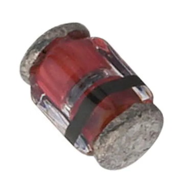

    特性:集成静电放电保护环。 极低的正向电压。 通过AEC-Q101认证。 无卤,符合RoHS标准。应用:需要极低正向电压的应用
BAS385-TR 数据手册
BAS385 www.vishay.com Vishay Semiconductors Small Signal Schottky Diode FEATURES • Integrated discharge protection ring against static • Very low forward voltage • Material categorization: for definitions of compliance please see www.vishay.com/doc?99912 APPLICATIONS LINKS TO ADDITIONAL RESOURCES • Applications where a very low forward voltage is required 3D 3D 3D Models MECHANICAL DATA Case: MicroMELF Weight: approx. 12 mg Cathode band color: black Packaging codes/options: TR3/10K per 13" reel (8 mm tape), 10K/box TR/2.5K per 7" reel (8 mm tape), 12.5K/box PARTS TABLE PART TYPE DIFFERENTIATION ORDERING CODE CIRCUIT CONFIGURATION REMARKS VR = 30 V BAS385-TR3 or BAS385-TR Single Tape and reel BAS385 ABSOLUTE MAXIMUM RATINGS (Tamb = 25 °C, unless otherwise specified) PARAMETER TEST CONDITION SYMBOL VALUE VR 30 V tp = 10 ms IFSM 5 A tp ≤ 1 s IFRM 300 mA IF 200 mA IFAV 200 mA Reverse voltage Peak forward surge current Repetitive peak forward current Forward continuous current Average forward current VRWM = 25 V UNIT THERMAL CHARACTERISTICS (Tamb = 25 °C, unless otherwise specified) PARAMETER Junction to ambient air Junction temperature Storage temperature range TEST CONDITION SYMBOL VALUE UNIT On PC board 50 mm x 50 mm x 1.6 mm RthJA 320 K/W Tj 125 °C Tstg -65 to +150 °C Rev: 2.3, 26-Nov-2021 Document Number: 85504 1 For technical questions within your region: DiodesAmericas@vishay.com, DiodesAsia@vishay.com, DiodesEurope@vishay.com THIS DOCUMENT IS SUBJECT TO CHANGE WITHOUT NOTICE. THE PRODUCTS DESCRIBED HEREIN AND THIS DOCUMENT ARE SUBJECT TO SPECIFIC DISCLAIMERS, SET FORTH AT www.vishay.com/doc?91000 BAS385 www.vishay.com Vishay Semiconductors ELECTRICAL CHARACTERISTICS (Tamb = 25 °C, unless otherwise specified) PARAMETER TEST CONDITION SYMBOL MAX. UNIT IF = 0.1mA VF 240 mV TYP. IF = 1 mA VF 320 mV IF = 10 mA VF 400 mV IF = 30 mA VF 500 mV IF = 100 mA VF 800 mV VR = 25 V, tp = 300 μs IR 2.3 μA VR = 1 V, f = 1 MHz CD 10 pF Forward voltage Reserve current MIN. Diode capacitance 1000 200 VR = 30 V 180 IF - Forward Current (mA) PR - Reverse Power Dissipation (mW) TYPICAL CHARACTERISTICS (Tamb = 25 °C, unless otherwise specified) 160 140 RthJA = 540 kW 120 PR - Limit at 100 % VR 100 80 PR - Limit at 80 % VR 60 40 100 Tj = 25 °C 10 1 20 0.1 0 25 50 75 100 125 0 150 0.5 1.0 1.5 VF - Forward Voltage (V) 15824 Tj - Junction Temperature (°C) 15822 Fig. 3 - Forward Current vs. Forward Voltage Fig. 1 - Max. Reverse Power Dissipation vs. Junction Temperature 1000 10 VR = VRRM 100 10 f = 1 MHz 9 CD - Diode Capacitance (pF) IR - Reverse Current (µA) Tj = 125 °C 8 7 6 5 4 3 2 1 0 1 25 15823 50 75 100 125 0.1 150 Tj - Junction Temperature (°C) Fig. 2 - Reverse Current vs. Junction Temperature 15825 1 10 100 VR - Reverse Voltage (V) Fig. 4 - Diode Capacitance vs. Reverse Voltage Rev: 2.3, 26-Nov-2021 Document Number: 85504 2 For technical questions within your region: DiodesAmericas@vishay.com, DiodesAsia@vishay.com, DiodesEurope@vishay.com THIS DOCUMENT IS SUBJECT TO CHANGE WITHOUT NOTICE. THE PRODUCTS DESCRIBED HEREIN AND THIS DOCUMENT ARE SUBJECT TO SPECIFIC DISCLAIMERS, SET FORTH AT www.vishay.com/doc?91000 BAS385 www.vishay.com Vishay Semiconductors Fig. 5 - Board for RthJA Definition (in mm) 0.71 1.3 1.27 9.9 0.152 10 25 0.355 2.5 24 95 10329 PACKAGE DIMENSIONS in millimeters (inches): MicroMELF 0.6 (0.024) * 1.1 (0.043) 1.2 (0.047) < 1. surface plan gl 1 (0.039) 35 ( as 0.0 s 53 ) surface plan Cathode indification 0.25 (0.010) 0.15 (0.006) > R2.5 (0.098) glass 2 (0.079) 1.8 (0.071) * The gap between plug and glass can be either on cathode or anode side Foot print recommendation: Wave soldering 2.4 (0.094) 2.8 (0.110) 0.8 (0.031) 0.9 (0.035) 0.9 (0.035) 1.4 (0.055) 1.2 (0.047) 0.8 (0.031) Reflow soldering 0.8 (0.031) 1 (0.039) Created - Date: 26.July.1996 Rev. 13 - Date: 07.June.2006 Document no.:6.560-5007.01-4 96 12072 Rev: 2.3, 26-Nov-2021 Document Number: 85504 3 For technical questions within your region: DiodesAmericas@vishay.com, DiodesAsia@vishay.com, DiodesEurope@vishay.com THIS DOCUMENT IS SUBJECT TO CHANGE WITHOUT NOTICE. THE PRODUCTS DESCRIBED HEREIN AND THIS DOCUMENT ARE SUBJECT TO SPECIFIC DISCLAIMERS, SET FORTH AT www.vishay.com/doc?91000 Legal Disclaimer Notice www.vishay.com Vishay Disclaimer ALL PRODUCT, PRODUCT SPECIFICATIONS AND DATA ARE SUBJECT TO CHANGE WITHOUT NOTICE TO IMPROVE RELIABILITY, FUNCTION OR DESIGN OR OTHERWISE. Vishay Intertechnology, Inc., its affiliates, agents, and employees, and all persons acting on its or their behalf (collectively, “Vishay”), disclaim any and all liability for any errors, inaccuracies or incompleteness contained in any datasheet or in any other disclosure relating to any product. Vishay makes no warranty, representation or guarantee regarding the suitability of the products for any particular purpose or the continuing production of any product. To the maximum extent permitted by applicable law, Vishay disclaims (i) any and all liability arising out of the application or use of any product, (ii) any and all liability, including without limitation special, consequential or incidental damages, and (iii) any and all implied warranties, including warranties of fitness for particular purpose, non-infringement and merchantability. Statements regarding the suitability of products for certain types of applications are based on Vishay's knowledge of typical requirements that are often placed on Vishay products in generic applications. Such statements are not binding statements about the suitability of products for a particular application. It is the customer's responsibility to validate that a particular product with the properties described in the product specification is suitable for use in a particular application. Parameters provided in datasheets and / or specifications may vary in different applications and performance may vary over time. All operating parameters, including typical parameters, must be validated for each customer application by the customer's technical experts. Product specifications do not expand or otherwise modify Vishay's terms and conditions of purchase, including but not limited to the warranty expressed therein. Hyperlinks included in this datasheet may direct users to third-party websites. These links are provided as a convenience and for informational purposes only. Inclusion of these hyperlinks does not constitute an endorsement or an approval by Vishay of any of the products, services or opinions of the corporation, organization or individual associated with the third-party website. Vishay disclaims any and all liability and bears no responsibility for the accuracy, legality or content of the third-party website or for that of subsequent links. Except as expressly indicated in writing, Vishay products are not designed for use in medical, life-saving, or life-sustaining applications or for any other application in which the failure of the Vishay product could result in personal injury or death. Customers using or selling Vishay products not expressly indicated for use in such applications do so at their own risk. Please contact authorized Vishay personnel to obtain written terms and conditions regarding products designed for such applications. No license, express or implied, by estoppel or otherwise, to any intellectual property rights is granted by this document or by any conduct of Vishay. Product names and markings noted herein may be trademarks of their respective owners. © 2024 VISHAY INTERTECHNOLOGY, INC. ALL RIGHTS RESERVED Document Number: 91000 1 For technical questions, contact: THIS DOCUMENT IS SUBJECT TO CHANGE WITHOUT NOTICE. THE PRODUCTS DESCRIBED HEREIN AND THIS DOCUMENT ARE SUBJECT TO SPECIFIC DISCLAIMERS, SET FORTH AT www.vishay.com/doc?91000 Revision: 01-Jan-2024
