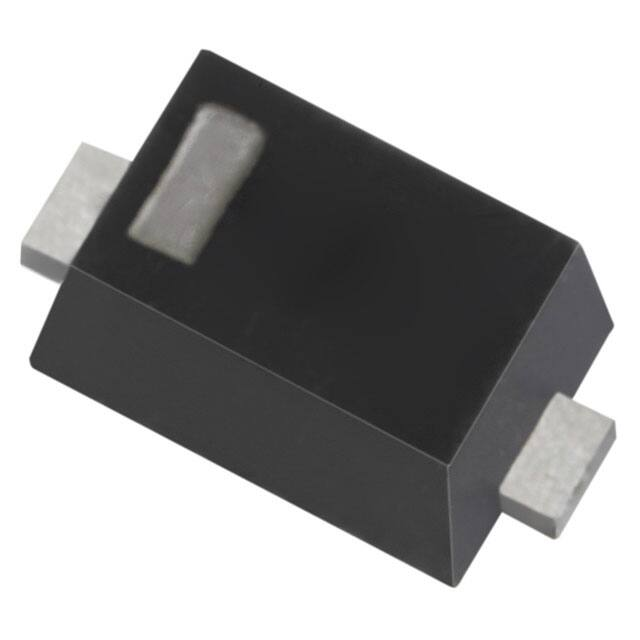

BAS70-02V-G3-08 数据手册
BAS70-02V www.vishay.com Vishay Semiconductors Small Signal Schottky Diode FEATURES • This diode features very low turn-on voltage and fast switching 2 1 • This device is protected by a PN junction guard ring against excessive voltage, such as electrostatic discharges 22321 • AEC-Q101 qualified available LINKS TO ADDITIONAL RESOURCES • Space saving SOD-523 package 3D 3D • Base P/N-G3 - RoHS-compliant, commercial grade 3D Models MECHANICAL DATA • Base P/N-HG3 - RoHS-compliant, AEC-Q101 qualified Case: SOD-523 Weight: approx. 1.4 mg Molding compound flammability rating: UL 94 V-0 Terminals: high temperature soldering guaranteed: 260 °C/10 s at terminals Packaging codes / options: 08/8K per 7" reel (8 mm tape) • Material categorization: for definitions of compliance please see www.vishay.com/doc?99912 PARTS TABLE PART BAS70-02V ORDERING CODE AEC-Q101 QUALIFIED BAS70-02V-G3-08 no BAS70-02V-HG3-08 yes CIRCUIT CONFIGURATION TYPE MARKING REMARKS Single :X Tape and reel ABSOLUTE MAXIMUM RATINGS (Tamb = 25 °C, unless otherwise specified) PARAMETER Repetitive peak reverse voltage Forward continuous current TEST CONDITION SYMBOL VRRM IF VALUE 70 100 tp = 10 ms square wave, Tj = 25 °C prior to surge IFSM 600 mA on FR-4 board with recommended soldering footprint Ptot 150 mW TEST CONDITION SYMBOL VALUE UNIT on FR-4 board according to JEDEC® 51-3 with recommended soldering footprint RthJA 680 K/W RthJL 480 K/W Tj 125 °C Operating temperature range Top -55 to +125 °C Storage temperature range Tstg -65 to +150 °C Surge forward current Power dissipation UNIT V mA THERMAL CHARACTERISTICS (Tamb = 25 °C, unless otherwise specified) PARAMETER Thermal resistance junction to ambient air Thermal resistance junction to lead Junction temperature ELECTRICAL CHARACTERISTICS (Tamb = 25 °C, unless otherwise specified) PARAMETER Reserve breakdown voltage Leakage current Forward voltage Diode capacitance Reserve recovery time TEST CONDITION IR = 10 μA (pulsed) VR = 50 V, tp < 300 μs tp < 300 μs, IF = 1.0 mA tp < 300 μs, IF = 15 mA VR = 0 V, f = 1 MHz IF = 10 mA, IR = 10 mA, iR = 1 mA, RL = 100 Ω SYMBOL V(BR) IR VF VF CD trr MIN. 70 TYP. MAX. 20 100 410 1000 2 UNIT V nA mV mV pF 5 ns 1.5 Rev. 1.6, 20-Jan-2022 Document Number: 85652 1 For technical questions within your region: DiodesAmericas@vishay.com, DiodesAsia@vishay.com, DiodesEurope@vishay.com THIS DOCUMENT IS SUBJECT TO CHANGE WITHOUT NOTICE. THE PRODUCTS DESCRIBED HEREIN AND THIS DOCUMENT ARE SUBJECT TO SPECIFIC DISCLAIMERS, SET FORTH AT www.vishay.com/doc?91000 BAS70-02V www.vishay.com Vishay Semiconductors 0.1 [0.004] max. 0.20 [0.008] 0.08 [0.003] 0.75 [0.029] 0.1 [0.004] 0.3 [0.012] 0.55 [0.021] PACKAGE DIMENSIONS in millimeters [inches]: SOD-523 0.9 [0.035] 0.85 [0.033] min. 0.17 [0.007] 0.37 [0.015] 0.7 [0.028] 1.7 [0.067] 1.5 [0.059] 1.3 [0.051] 1.1 [0.043] 0.5 [0.020] 0.35 [0.014] 0.18 [0.007] Footprint recommendation: 1.45 [0.057] Document no.: S8-V-3880.02-003 (4) Created - Date: 04. April 2017 Rev. 4 - Date: 03. Aug. 2020 23093 0.35 [0.014] Rev. 1.6, 20-Jan-2022 Document Number: 85652 2 For technical questions within your region: DiodesAmericas@vishay.com, DiodesAsia@vishay.com, DiodesEurope@vishay.com THIS DOCUMENT IS SUBJECT TO CHANGE WITHOUT NOTICE. THE PRODUCTS DESCRIBED HEREIN AND THIS DOCUMENT ARE SUBJECT TO SPECIFIC DISCLAIMERS, SET FORTH AT www.vishay.com/doc?91000 Legal Disclaimer Notice www.vishay.com Vishay Disclaimer ALL PRODUCT, PRODUCT SPECIFICATIONS AND DATA ARE SUBJECT TO CHANGE WITHOUT NOTICE TO IMPROVE RELIABILITY, FUNCTION OR DESIGN OR OTHERWISE. Vishay Intertechnology, Inc., its affiliates, agents, and employees, and all persons acting on its or their behalf (collectively, “Vishay”), disclaim any and all liability for any errors, inaccuracies or incompleteness contained in any datasheet or in any other disclosure relating to any product. Vishay makes no warranty, representation or guarantee regarding the suitability of the products for any particular purpose or the continuing production of any product. To the maximum extent permitted by applicable law, Vishay disclaims (i) any and all liability arising out of the application or use of any product, (ii) any and all liability, including without limitation special, consequential or incidental damages, and (iii) any and all implied warranties, including warranties of fitness for particular purpose, non-infringement and merchantability. Statements regarding the suitability of products for certain types of applications are based on Vishay's knowledge of typical requirements that are often placed on Vishay products in generic applications. Such statements are not binding statements about the suitability of products for a particular application. It is the customer's responsibility to validate that a particular product with the properties described in the product specification is suitable for use in a particular application. Parameters provided in datasheets and / or specifications may vary in different applications and performance may vary over time. All operating parameters, including typical parameters, must be validated for each customer application by the customer's technical experts. Product specifications do not expand or otherwise modify Vishay's terms and conditions of purchase, including but not limited to the warranty expressed therein. Hyperlinks included in this datasheet may direct users to third-party websites. These links are provided as a convenience and for informational purposes only. Inclusion of these hyperlinks does not constitute an endorsement or an approval by Vishay of any of the products, services or opinions of the corporation, organization or individual associated with the third-party website. Vishay disclaims any and all liability and bears no responsibility for the accuracy, legality or content of the third-party website or for that of subsequent links. Except as expressly indicated in writing, Vishay products are not designed for use in medical, life-saving, or life-sustaining applications or for any other application in which the failure of the Vishay product could result in personal injury or death. Customers using or selling Vishay products not expressly indicated for use in such applications do so at their own risk. Please contact authorized Vishay personnel to obtain written terms and conditions regarding products designed for such applications. No license, express or implied, by estoppel or otherwise, to any intellectual property rights is granted by this document or by any conduct of Vishay. Product names and markings noted herein may be trademarks of their respective owners. © 2024 VISHAY INTERTECHNOLOGY, INC. ALL RIGHTS RESERVED Document Number: 91000 1 For technical questions, contact: THIS DOCUMENT IS SUBJECT TO CHANGE WITHOUT NOTICE. THE PRODUCTS DESCRIBED HEREIN AND THIS DOCUMENT ARE SUBJECT TO SPECIFIC DISCLAIMERS, SET FORTH AT www.vishay.com/doc?91000 Revision: 01-Jan-2024
