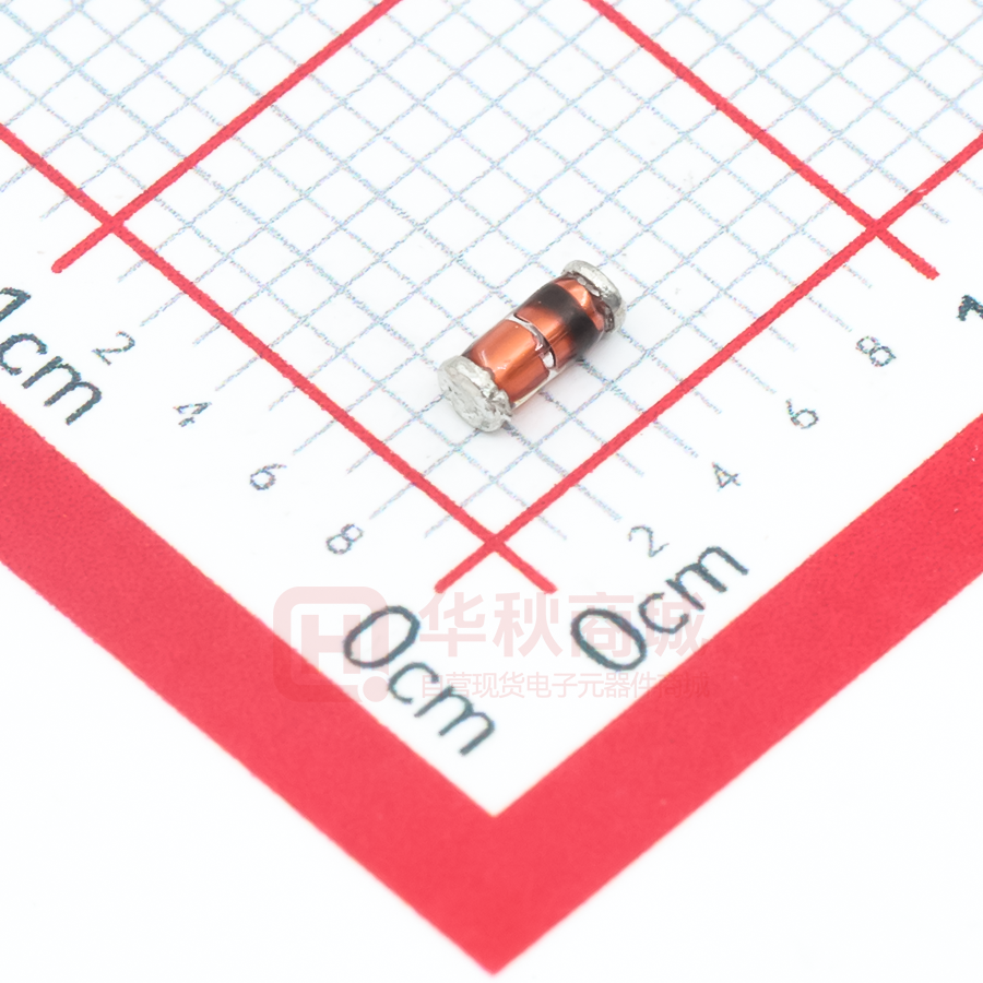

BAS81, BAS82, BAS83 www.vishay.com Vishay Semiconductors Small Signal Schottky Diodes FEATURES • Integrated discharge protection ring against static • Low capacitance • Low leakage current • Low forward voltage drop • Very low switching time • Material categorization: for definitions of compliance please see www.vishay.com/doc?99912 LINKS TO ADDITIONAL RESOURCES 3D 3D APPLICATIONS 3D Models • HF-detector MECHANICAL DATA • Protection circuit Case: MiniMELF (SOD-80) • Diode for low currents with a low supply voltage Weight: approx. 31 mg • Small battery charger Cathode band color: black • Power supplies Packaging codes/options: • DC/DC converter for notebooks GS18/10K per 13" reel (8 mm tape), 10K/box GS08/2.5K per 7" reel (8 mm tape), 12.5K/box PARTS TABLE PART TYPE DIFFERENTIATION ORDERING CODE CIRCUIT CONFIGURATION REMARKS BAS81 VR = 40 V BAS81-GS18 or BAS81-GS08 Single Tape and reel BAS82 VR = 50 V BAS82-GS18 or BAS82-GS08 Single Tape and reel BAS83 VR = 60 V BAS83-GS18 or BAS83-GS08 Single Tape and reel ABSOLUTE MAXIMUM RATINGS (Tamb = 25 °C, unless otherwise specified) PARAMETER TEST CONDITION Reverse voltage Peak forward surge current PART SYMBOL VALUE UNIT BAS81 VR 40 V BAS82 VR 50 V BAS83 VR 60 V IFSM 500 mA IFRM 150 mA IF 30 mA tp = 1 s Repetitive peak forward current Forward continuous current THERMAL CHARACTERISTICS (Tamb = 25 °C, unless otherwise specified) PARAMETER Thermal resistance junction to ambient air Junction temperature Storage temperature range TEST CONDITION SYMBOL VALUE UNIT On PC board 50 mm x 50 mm x 1.6 mm RthJA 320 K/W Tj 125 °C Tstg -65 to +150 °C Rev. 2.1, 16-Nov-2021 Document Number: 85509 1 For technical questions within your region: DiodesAmericas@vishay.com, DiodesAsia@vishay.com, DiodesEurope@vishay.com THIS DOCUMENT IS SUBJECT TO CHANGE WITHOUT NOTICE. THE PRODUCTS DESCRIBED HEREIN AND THIS DOCUMENT ARE SUBJECT TO SPECIFIC DISCLAIMERS, SET FORTH AT www.vishay.com/doc?91000 BAS81, BAS82, BAS83 www.vishay.com Vishay Semiconductors ELECTRICAL CHARACTERISTICS (Tamb = 25 °C, unless otherwise specified) PARAMETER TEST CONDITION SYMBOL IF = 0.1 mA VF IF = 1 mA VF 410 mV IF = 15 mA VF 1000 mV VR = VRmax. IR 200 nA VR = 1 V, f = 1 MHz CD 1.6 pF Forward voltage Reserve current Diode capacitance MIN. TYP. MAX. UNIT 330 mV TYPICAL CHARACTERISTICS (Tamb = 25 °C, unless otherwise specified) PR - Reverse Power Dissipation (mW) 14 1000 VR = 60 V I F - Forward Current (mA) 12 RthJA = 540 K/W 10 8 6 Limit at PPRR - Limit at100 100%%VRVR 4 PR - Limit at 80 % VR 100 Tj = 125 °C 10 Tj = 25 °C 1 0.1 2 0.01 0 25 50 75 100 125 Tj - Junction Temperature (°C) 15794 0 150 1 1.5 2.0 V F - Forward Voltage (V) 15796 Fig. 3 - Forward Current vs. Forward Voltage Fig. 1 - Max. Reverse Power Dissipation vs. Junction Temperature 1000 2.0 CD - Diode Capacitance (pF) V R = V RRM I R - Reverse Current (µA) 0.5 100 10 1 f = 1 MHz 1.8 1.6 1.4 1.2 1.0 0.8 0.6 0.4 0.2 0.1 25 15795 0 50 75 100 125 0.1 150 Tj - Junction Temperature (°C) Fig. 2 - Reverse Current vs. Junction Temperature 15797 1 10 100 VR - Reverse Voltage (V) Fig. 4 - Diode Capacitance vs. Reverse Voltage Rev. 2.1, 16-Nov-2021 Document Number: 85509 2 For technical questions within your region: DiodesAmericas@vishay.com, DiodesAsia@vishay.com, DiodesEurope@vishay.com THIS DOCUMENT IS SUBJECT TO CHANGE WITHOUT NOTICE. THE PRODUCTS DESCRIBED HEREIN AND THIS DOCUMENT ARE SUBJECT TO SPECIFIC DISCLAIMERS, SET FORTH AT www.vishay.com/doc?91000 BAS81, BAS82, BAS83 www.vishay.com Vishay Semiconductors PACKAGE DIMENSIONS in millimeters (inches): MiniMELF (SOD-80) 1.6 (0.063) 1.4 (0.055) Cathode indentification * 0.47 (0.019) max. 3.7 (0.146) 3.3 (0.130) * The gap between plug and glass can be either on cathode or anode side 2.5 (0.098) max. 1.25 (0.49) min. 2 (0.079) min. Foot print recommendation: 5 (0.197) ref. Document no.:6.560-5005.01-4 Rev. 8 - Date: 07.June.2006 96 12070 Rev. 2.1, 16-Nov-2021 Document Number: 85509 3 For technical questions within your region: DiodesAmericas@vishay.com, DiodesAsia@vishay.com, DiodesEurope@vishay.com THIS DOCUMENT IS SUBJECT TO CHANGE WITHOUT NOTICE. THE PRODUCTS DESCRIBED HEREIN AND THIS DOCUMENT ARE SUBJECT TO SPECIFIC DISCLAIMERS, SET FORTH AT www.vishay.com/doc?91000 Legal Disclaimer Notice www.vishay.com Vishay Disclaimer ALL PRODUCT, PRODUCT SPECIFICATIONS AND DATA ARE SUBJECT TO CHANGE WITHOUT NOTICE TO IMPROVE RELIABILITY, FUNCTION OR DESIGN OR OTHERWISE. Vishay Intertechnology, Inc., its affiliates, agents, and employees, and all persons acting on its or their behalf (collectively, “Vishay”), disclaim any and all liability for any errors, inaccuracies or incompleteness contained in any datasheet or in any other disclosure relating to any product. Vishay makes no warranty, representation or guarantee regarding the suitability of the products for any particular purpose or the continuing production of any product. To the maximum extent permitted by applicable law, Vishay disclaims (i) any and all liability arising out of the application or use of any product, (ii) any and all liability, including without limitation special, consequential or incidental damages, and (iii) any and all implied warranties, including warranties of fitness for particular purpose, non-infringement and merchantability. Statements regarding the suitability of products for certain types of applications are based on Vishay's knowledge of typical requirements that are often placed on Vishay products in generic applications. Such statements are not binding statements about the suitability of products for a particular application. It is the customer's responsibility to validate that a particular product with the properties described in the product specification is suitable for use in a particular application. Parameters provided in datasheets and / or specifications may vary in different applications and performance may vary over time. All operating parameters, including typical parameters, must be validated for each customer application by the customer's technical experts. Product specifications do not expand or otherwise modify Vishay's terms and conditions of purchase, including but not limited to the warranty expressed therein. Hyperlinks included in this datasheet may direct users to third-party websites. These links are provided as a convenience and for informational purposes only. Inclusion of these hyperlinks does not constitute an endorsement or an approval by Vishay of any of the products, services or opinions of the corporation, organization or individual associated with the third-party website. Vishay disclaims any and all liability and bears no responsibility for the accuracy, legality or content of the third-party website or for that of subsequent links. Except as expressly indicated in writing, Vishay products are not designed for use in medical, life-saving, or life-sustaining applications or for any other application in which the failure of the Vishay product could result in personal injury or death. Customers using or selling Vishay products not expressly indicated for use in such applications do so at their own risk. Please contact authorized Vishay personnel to obtain written terms and conditions regarding products designed for such applications. No license, express or implied, by estoppel or otherwise, to any intellectual property rights is granted by this document or by any conduct of Vishay. Product names and markings noted herein may be trademarks of their respective owners. © 2024 VISHAY INTERTECHNOLOGY, INC. ALL RIGHTS RESERVED Document Number: 91000 1 For technical questions, contact: THIS DOCUMENT IS SUBJECT TO CHANGE WITHOUT NOTICE. THE PRODUCTS DESCRIBED HEREIN AND THIS DOCUMENT ARE SUBJECT TO SPECIFIC DISCLAIMERS, SET FORTH AT www.vishay.com/doc?91000 Revision: 01-Jan-2024
