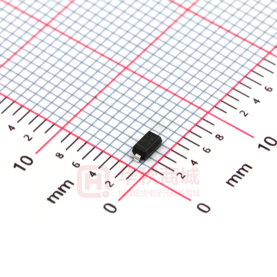

BAT46W www.vishay.com Vishay Semiconductors Small Signal Schottky Diode FEATURES • For general purpose applications • This diode features very low turn-on voltage and fast switching • This device is protected by a PN junction guard ring against excessive voltage, such as electrostatic discharges • AEC-Q101 qualified MECHANICAL DATA • Base P/N-E3 - RoHS-compliant, commercial grade Case: SOD-123 • Base P/N-HE3 - RoHS-compliant, AEC-Q101 qualified Weight: approx. 10.3 mg • Material categorization: For definitions of compliance please see www.vishay.com/doc?99912 Packaging codes/options: 18/10K per 13" reel (8 mm tape), 10K/box 08/3K per 7" reel (8 mm tape), 15K/box PARTS TABLE PART BAT46W ORDERING CODE BAT46W-E3-08 or BAT46W-E3-18 BAT46W-HE3-08 or BAT46W-HE3-18 INTERNAL CONSTRUCTION TYPE MARKING REMARKS Single Diode L6 Tape and reel UNIT ABSOLUTE MAXIMUM RATINGS (Tamb = 25 °C, unless otherwise specified) PARAMETER SYMBOL VALUE Repetitive peak reverse voltage VRRM 100 V Forward continuous current (1) IF 150 mA tp < 1 s,  < 0.5 IFRM 350 mA tp < 10 ms IFSM 750 mA Tamb = 65 °C Ptot 150 mW SYMBOL VALUE UNIT RthJA 300 K/W Tj 125 °C Operating temperature range Top - 55 to + 125 °C Storage temperature range Tstg - 55 to + 150 °C Repetitive peak forward current (1) Surge forward current (1) Power dissipation (1) TEST CONDITION Note (1) Valid provided that electrodes are kept at ambient temperature THERMAL CHARACTERISTICS (Tamb = 25 °C, unless otherwise specified) PARAMETER TEST CONDITION Thermal resistance junction to ambient air (1) Junction temperature Note (1) Valid provided that electrodes are kept at ambient temperature Rev. 1.9, 25-Feb-13 Document Number: 85663 1 For technical questions within your region: DiodesAmericas@vishay.com, DiodesAsia@vishay.com, DiodesEurope@vishay.com THIS DOCUMENT IS SUBJECT TO CHANGE WITHOUT NOTICE. THE PRODUCTS DESCRIBED HEREIN AND THIS DOCUMENT ARE SUBJECT TO SPECIFIC DISCLAIMERS, SET FORTH AT www.vishay.com/doc?91000 BAT46W www.vishay.com Vishay Semiconductors ELECTRICAL CHARACTERISTICS (Tamb = 25 °C, unless otherwise specified) PARAMETER TEST CONDITION SYMBOL MIN. Reverse breakdown voltage IR = 100 μA (pulsed) V(BR) 100 Leakage current (1) MAX. UNIT V VR = 1.5 V IR 0.5 μA VR = 1.5 V, Tj = 60 °C IR 5 μA μA VR = 10 V IR 0.8 VR = 10 V, Tj = 60 °C IR 7.5 μA VR = 50 V IR 2 μA VR = 50 V, Tj = 60 °C IR 15 μA VR = 75 V IR 5 μA VR = 75 V, Tj = 60 °C IR 20 μA IF = 0.1 mA VF 250 mV IF = 10 mA VF 450 mV IF = 250 mA VF 1000 mV VR = 0 V, f = 1 MHz CD 10 pF VR = 1 V, f = 1 MHz CD 6 pF Forward voltage (1) Diode capacitance TYP. Note (1) Pulse test; t  300 μs,  < 2 % p TYPICAL CHARACTERISTICS (Tamb = 25 °C, unless otherwise specified) 250 T j = 60 °C 100 Ptot - Power Dissipation (mW) I F - Forward Current (mA) 1000 10 25 °C 1 0.1 0.01 150 100 50 0 0 18546 0.2 0.4 0.6 0.8 1 VF - Forward Voltage (V) 0 1.2 18548 Fig. 1 - Typical Instantaneous Forward Characteristics IR - Reverse Leakage Current (µA) 200 50 100 150 200 Tamb - Ambient Temperature (°C) Fig. 3 - Admissible Power Dissipation vs. Ambient Temperature 100 10 T j = 60 °C 1 Tj = 25 °C 0.1 0.01 0 20 40 60 80 100 VR - Reverse Voltage (V) 18547 Fig. 2 - Typical Reverse Characteristics Rev. 1.9, 25-Feb-13 Document Number: 85663 2 For technical questions within your region: DiodesAmericas@vishay.com, DiodesAsia@vishay.com, DiodesEurope@vishay.com THIS DOCUMENT IS SUBJECT TO CHANGE WITHOUT NOTICE. THE PRODUCTS DESCRIBED HEREIN AND THIS DOCUMENT ARE SUBJECT TO SPECIFIC DISCLAIMERS, SET FORTH AT www.vishay.com/doc?91000 BAT46W www.vishay.com Vishay Semiconductors 0.10 (0.004) 0.15 (0.006) 8° 0.45 (0.018) 0.25 (0.010) 0° to 0.2 (0.008) 1 (0.039) 1.35 (0.053) 0.1 (0.004) max. PACKAGE DIMENSIONS in millimeters (inches): SOD-123 0.5 (0.020) ref. Cathode bar Mounting Pad Layout 2.85 (0.112) 2.55 (0.100) 0.85 (0.033) 2.5 (0.098) 0.85 (0.033) 3.55 (0.140) 1.7 (0.067) 3.85 (0.152) 1.40 (0.055) 0.45 (0.018) 0.65 (0.026) 0.85 (0.033) Rev. 4 - Date: 24. Sep. 2009 Document no.: S8-V-3910.01-001 (4) 17432 Rev. 1.9, 25-Feb-13 Document Number: 85663 3 For technical questions within your region: DiodesAmericas@vishay.com, DiodesAsia@vishay.com, DiodesEurope@vishay.com THIS DOCUMENT IS SUBJECT TO CHANGE WITHOUT NOTICE. THE PRODUCTS DESCRIBED HEREIN AND THIS DOCUMENT ARE SUBJECT TO SPECIFIC DISCLAIMERS, SET FORTH AT www.vishay.com/doc?91000 Legal Disclaimer Notice www.vishay.com Vishay Disclaimer  ALL PRODUCT, PRODUCT SPECIFICATIONS AND DATA ARE SUBJECT TO CHANGE WITHOUT NOTICE TO IMPROVE RELIABILITY, FUNCTION OR DESIGN OR OTHERWISE. Vishay Intertechnology, Inc., its affiliates, agents, and employees, and all persons acting on its or their behalf (collectively, “Vishay”), disclaim any and all liability for any errors, inaccuracies or incompleteness contained in any datasheet or in any other disclosure relating to any product. Vishay makes no warranty, representation or guarantee regarding the suitability of the products for any particular purpose or the continuing production of any product. To the maximum extent permitted by applicable law, Vishay disclaims (i) any and all liability arising out of the application or use of any product, (ii) any and all liability, including without limitation special, consequential or incidental damages, and (iii) any and all implied warranties, including warranties of fitness for particular purpose, non-infringement and merchantability. Statements regarding the suitability of products for certain types of applications are based on Vishay’s knowledge of typical requirements that are often placed on Vishay products in generic applications. Such statements are not binding statements about the suitability of products for a particular application. It is the customer’s responsibility to validate that a particular product with the properties described in the product specification is suitable for use in a particular application. Parameters provided in datasheets and / or specifications may vary in different applications and performance may vary over time. All operating parameters, including typical parameters, must be validated for each customer application by the customer’s technical experts. Product specifications do not expand or otherwise modify Vishay’s terms and conditions of purchase, including but not limited to the warranty expressed therein. Except as expressly indicated in writing, Vishay products are not designed for use in medical, life-saving, or life-sustaining applications or for any other application in which the failure of the Vishay product could result in personal injury or death. Customers using or selling Vishay products not expressly indicated for use in such applications do so at their own risk. Please contact authorized Vishay personnel to obtain written terms and conditions regarding products designed for such applications. No license, express or implied, by estoppel or otherwise, to any intellectual property rights is granted by this document or by any conduct of Vishay. Product names and markings noted herein may be trademarks of their respective owners. © 2017 VISHAY INTERTECHNOLOGY, INC. ALL RIGHTS RESERVED Revision: 08-Feb-17 1 Document Number: 91000

物料型号:BAT46W
器件简介:这是一种小信号肖特基二极管,适用于一般用途,具有非常低的导通电压和快速开关特性。此外,该设备采用PN结保护环,以防止静电放电等过高电压。
引脚分配:文档中没有明确提供引脚分配信息,但通常肖特基二极管会有阳极和阴极两个引脚。
参数特性: - 重复峰值反向电压(VRRM):100V - 正向连续电流(IF):150mA - 重复峰值正向电流(IFRM):350mA - 浪涌正向电流(IFSM):750mA - 总功耗(Ptot):150mW - 热阻(RthJA):300 K/W - 结温(Tj):最高125°C - 工作温度范围(Top):-55°C 至 +125°C - 存储温度范围(Tstg):-55°C 至 +150°C
功能详解:BAT46W二极管具有低正向电压降和快速恢复时间,适合在高速开关和整流应用中使用。其PN结保护环提供了对静电放电的额外保护。
应用信息:适用于一般用途的高速开关和整流应用。
封装信息:提供SOD-123封装,有两种基础型号:E3和HE3,分别对应商业级和AEC-Q101认证级。重量约为10.3毫克。包装选项包括每13英寸卷18,000或10,000个,以及每7英寸卷3,000或8,000个。
